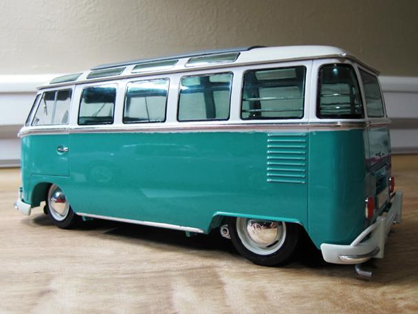

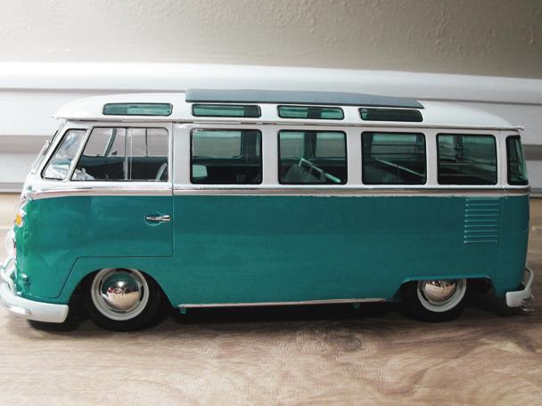

VanGoGo Posted February 1 Posted February 1 I live in a rural area with no hobby stores, and want to tint the windows on a current build. I don't use an airbrush, no local stores carry spray tint, I tried Rit dye which did not work, then saw this on YouTube...I tried his method using prismacolor wide tipped markers, and got great results. Just thought I would share: 1

VanGoGo Posted February 3 Author Posted February 3 The spray tint or using an air brush are probably the best way to go, but the results with the pen are not bad, it was so easy I had to try it, and i have a big set of markers that I never use (left over from my drawing days) 1
