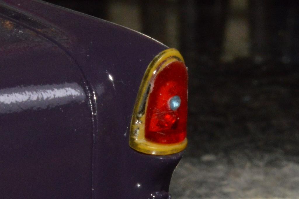

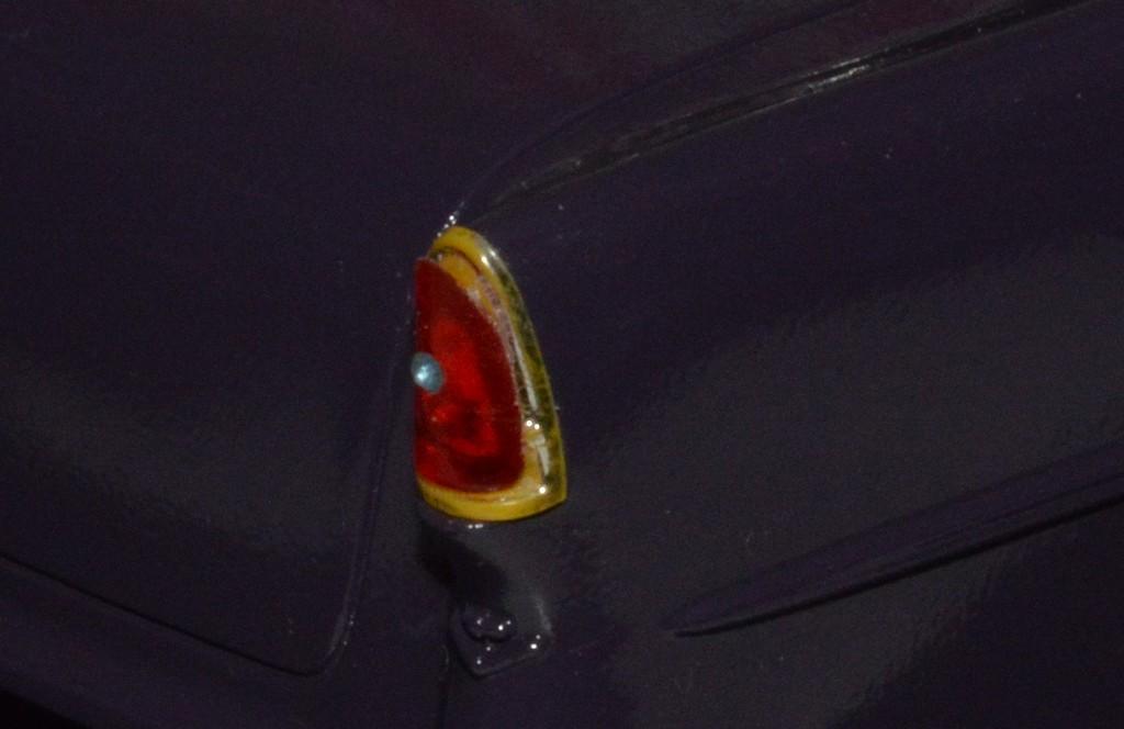

Straightliner59 Posted February 15 Author Posted February 15 Thanks to everyone for your feedback/input/expertise! On a flyer, I took a look an AMT Nomad I have an in the stash. As stated earlier, I cut the lenses from a Badman taillight, leaving only the bezel/base. I did some rough sanding on the AMT taillight lens, to make it fit--it was too thick at the bottom, and protruded too far. I made a divot for the Blue Dot. It's a tad big, but some darker blue should tone it down. I need to decide what to do for the reflectors, inside, and do some finish sanding on the lens, so it rests flat, on the base. I think I can be happy with this! 1
