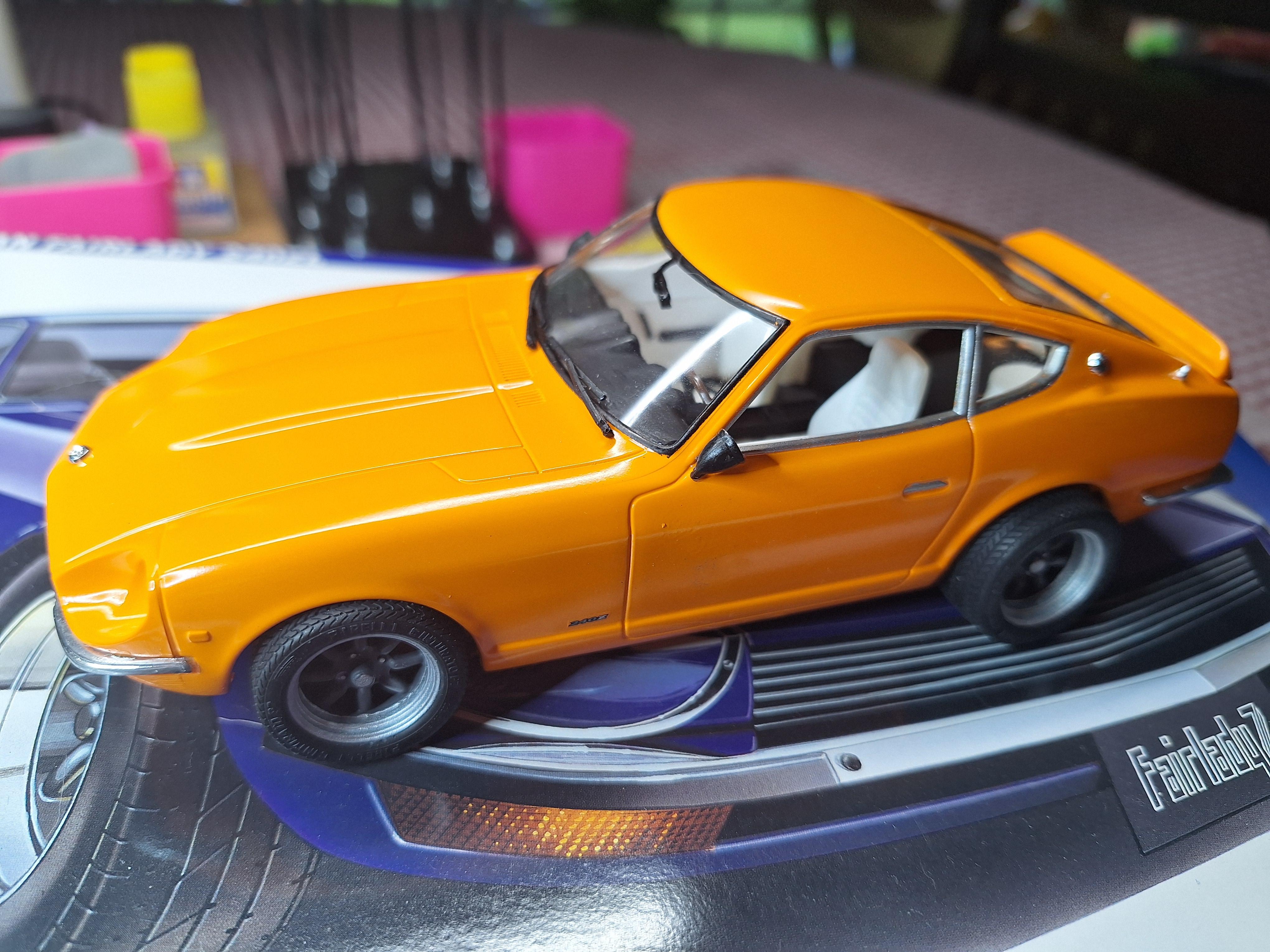

I purchased a compressor with tank from Amazon for about $90 and a NEOECO J83 airbrush. Both have worked great. Compressor is very quiet, doesn't startle me on startup. Was using my 5 gal shop compressor  at the noise was unbearable. NEOECO airbrush performs very well for model painting, probably not for artistic use. Lots of adjustability. Can spray fine or heavy amounts. I like to spray final gloss coats pretty heavy to get a high shine and have had no problems. Clean by spraying with your compatible thinner. Attached is a picture of some results
