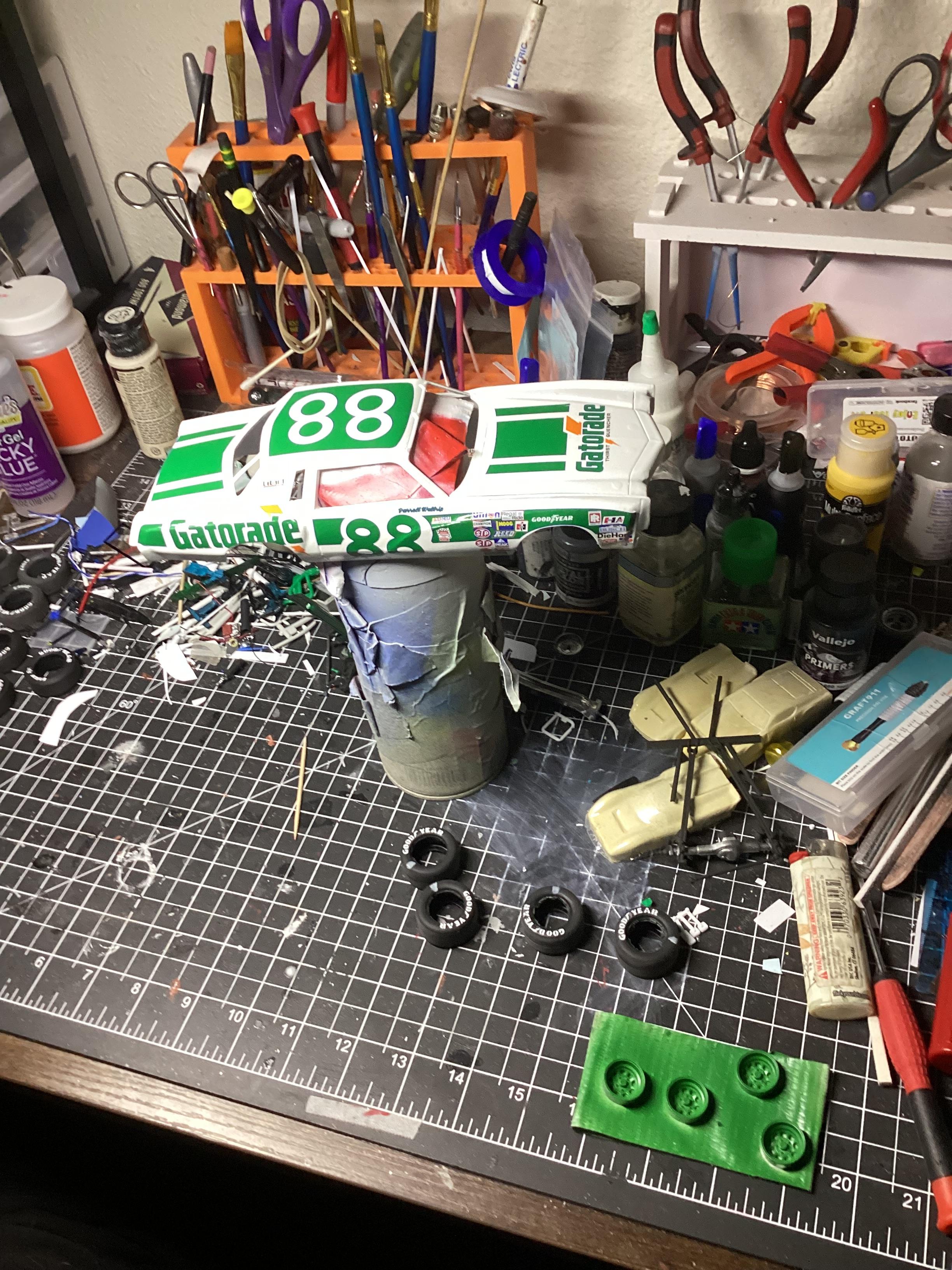

Belugawrx Posted April 14 Author Posted April 14 (edited) Decal Day !! These Power Slide decals are awesome..didn't use a drop of Set or Sol A little clean up of decal adhesive in some places and wait till tomorrow to clear it again with Alclad Aqua Gloss Clear. Cheers Edited April 14 by Belugawrx 3 1
Belugawrx Posted April 18 Author Posted April 18 So... As I was cleaning the body, noticed that the pin stripes were on the wrong body line over the front 1/4 after much hemming and hawing..I dove in, had to fix it Had to change out some of the sponsor decals in front of the wheel arch , and used up the extra pinstripes for the Olds (same sheet), but 4 hours later and alot of MicroSol..... Also made up a drivers net out of window screen, masking tape, and 0.40 silver wire Out of clear and into final assembly...heading to Nascar 'Under Glass' in a couple days Cheers 2
