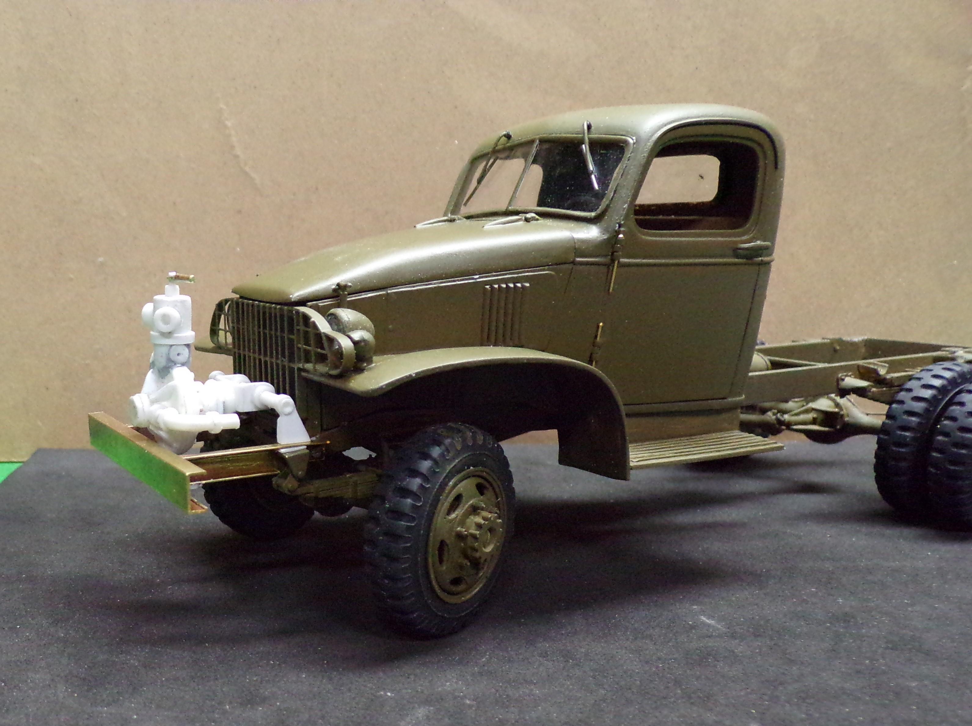

In the photos are also the grill guard, made of strip brass and brass wire soldered together.  The parts next to the grill are the components of the steering knuckles for the front axle.  They are made of brass channel and tube stock, again soldered together.  Both are now made up and will show in a couple of future photos.  The aluminum turning is the master for the Barton American pump that will be mounted on the front of the truck.  The mold is ready for a pour so that the pump can be built up.

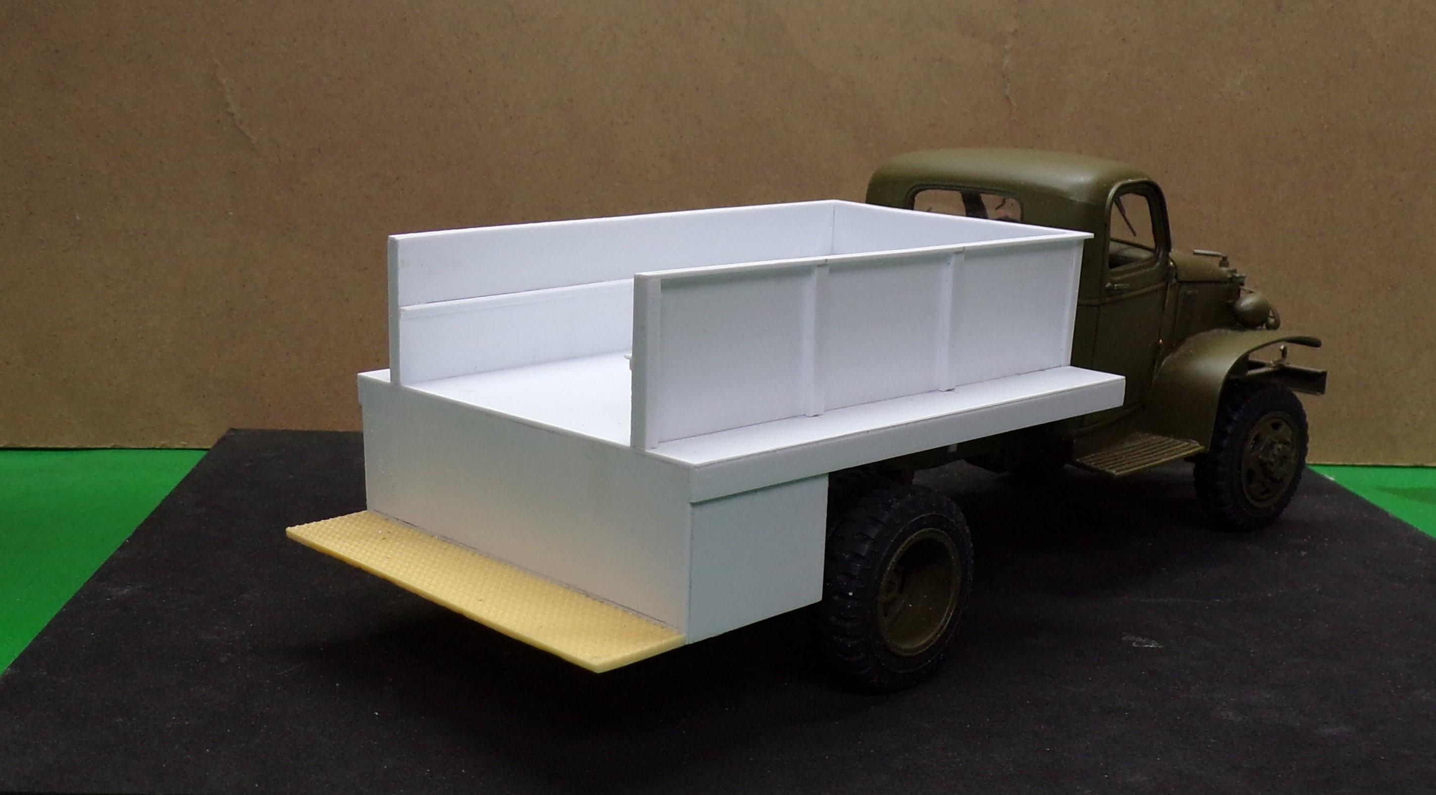

Update on the build.  Got some painting done and work was started on the Barton front mounted pump and the body.  Body stock is 0.030" Evergreen sheet and strip.  Hose reels need to be built for under the front of the body on both sides.  Plumbing for the pump still needed as well.
