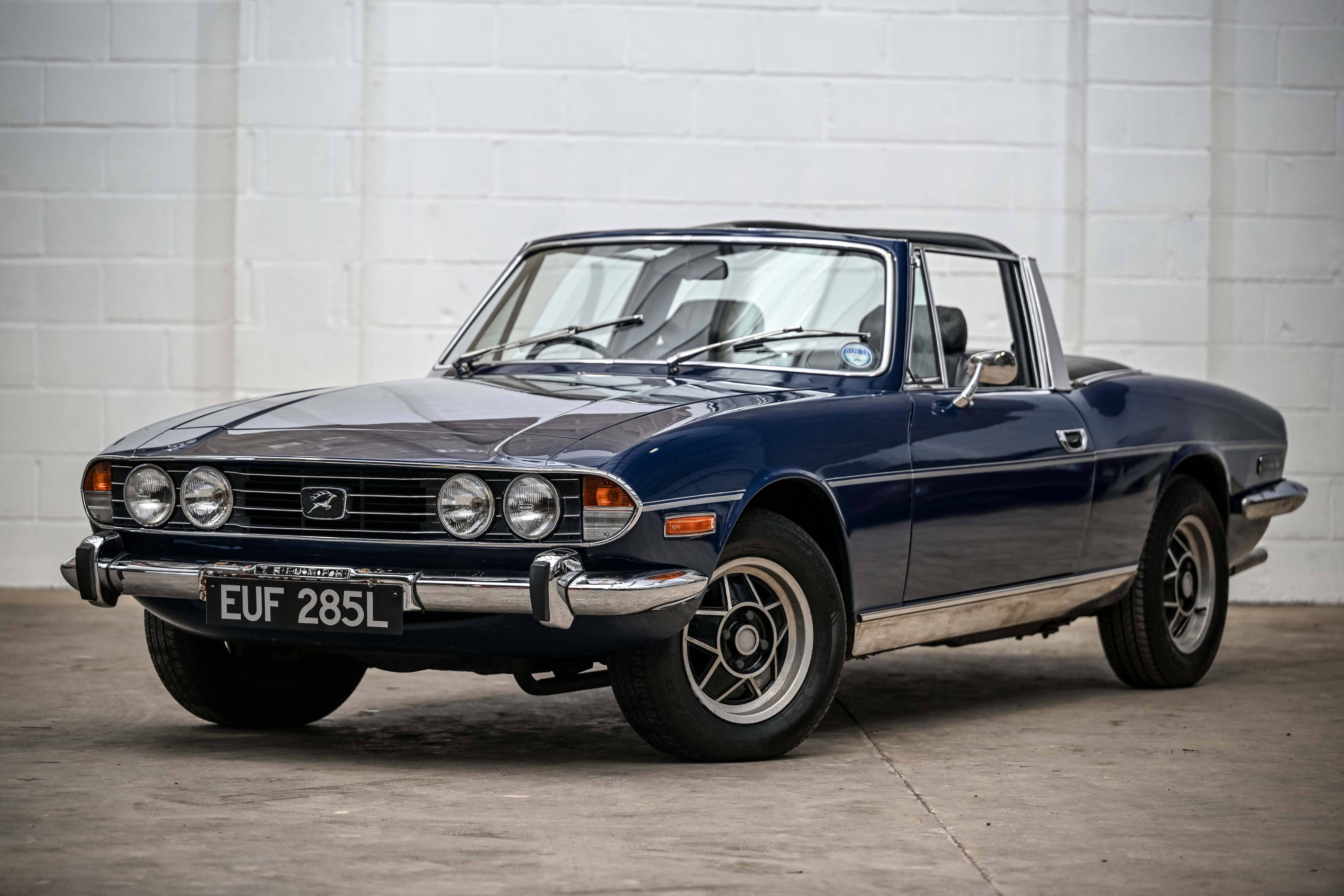

Ace-Garageguy Posted June 19 Author Posted June 19 The first really idiotic design stuff I encountered up close and personal was on the Triumph Stag engine, which I worked on at a dealership when they were new. The engine was a SOHC V8 derived from a joint Triumph/Saab inline 4. Saab's little 3-cylinder 2-stroke ring-dings were legendary, but there was just too much reinventing the wheel on their OHC 4-stroke 4, and Triumph really should have known better. The water pump was buried under the intake manifold on the V8 because the designers of the 4 were trying to save length for FWD installations (Saab 99). The timing chains were barely adequate and stretched early. The cylinder heads were retained by studs that went in at different angles. When the heads inevitably warped and blew head gaskets, the studs often seized in the block. Because they went in at different angles, they had to be removed before you could get a head off...but they were too short to get a standard stud puller on. Of course they were provided with a little slot for a screwdriver on the top end, but it failed if the stud was the least bit reluctant to turn. AND...because the head studs went in at different angles, you were severely limited in how much meat could be removed from a warped head. Engine swaps were almost a necessity. I personally did 3 SBC swaps, one SBF, and have seen aluminum Olds, Buick, and Rover V8 swaps, and a few V6 Buicks. If you ever encounter a SBC or SBF equipped Stag, IF there's no hole in the hood, I probably did it. I built custom headers for all of mine, so the engine sat lower in the bay, and no need to cut a hole in the hood for air filter clearance. Stags had a multitude of other designed-in problems including power steering rack seal issues, window regulators, etc., but I loved them anyway. With styling by Giovanni Michelotti, a full convertible top, an optional hard top, and an integral padded roll bar, they were striking visually and comfortable, and though the OEM engines were junk, they sounded heavenly. 2 1
johnyrotten Posted June 19 Posted June 19 On 6/19/2025 at 12:36 PM, Ace-Garageguy said: If you ever encounter a SBC or SBF equipped Stag, IF there's no hole in the hood, I probably did it. I built custom headers for all of mine, so the engine sat lower in the bay, and no need to cut a hole in the hood for air filter clearance. Expand You take the time to properly troubleshoot the issue and find an appropriate solution with serviceability in mind. They cut the hole for the easy route I take it. 1
