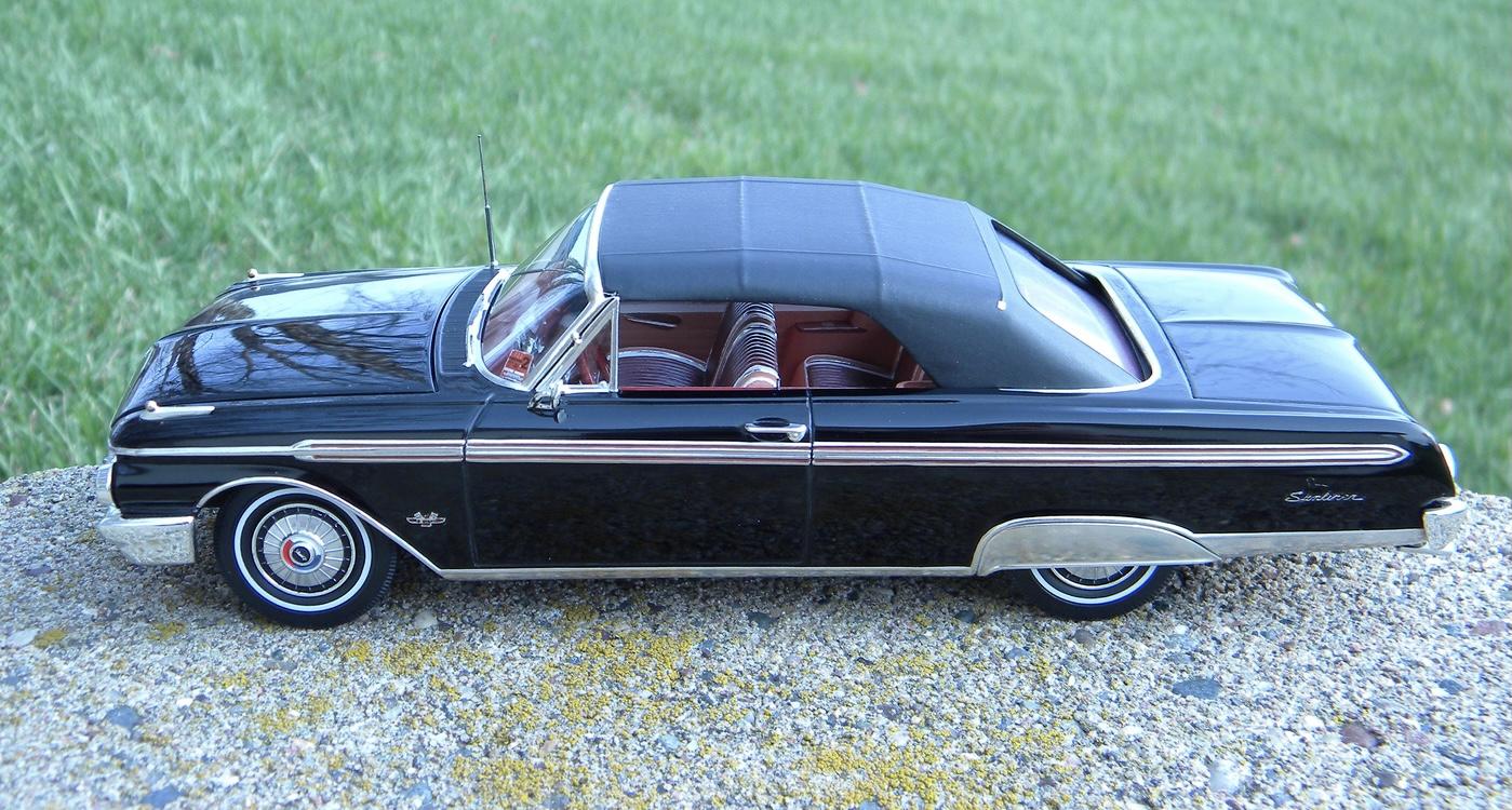

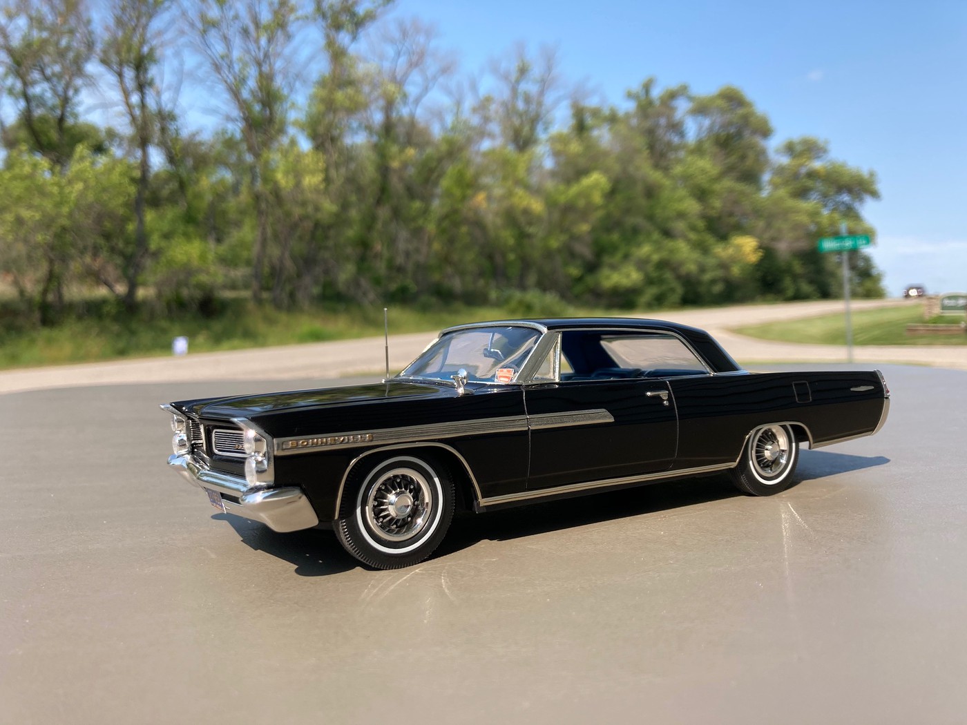

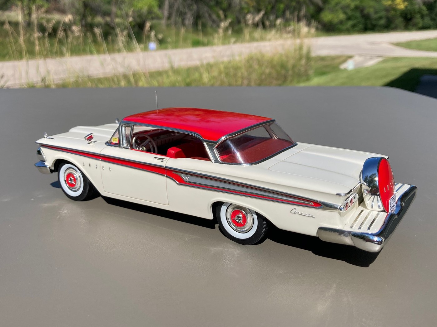

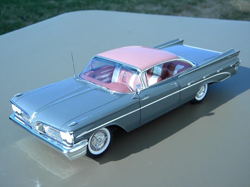

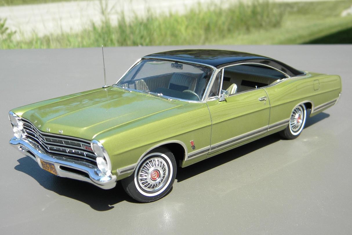

StevenGuthmiller Posted Saturday at 01:39 AM Posted Saturday at 01:39 AM 32 minutes ago, rossfox said: Will foil work on very small parts like door handles? I don't have much hardly experience with BMF except around windows and didn't do very well with that. I will certainly try that as Molotow has been a hard go with me. I have gotten it on the paint in many places and ruined a good to me paint job. So foil will stick and work on very small pieces then?? Certainly! Just be sure that you have the correct foil, (original, or “new improved) Stay away from the “Ultra Bright” foil. It’s much harder to work with. Before I began replacing door handles on my projects with resin/3-D printed parts, I always used foil for everything, including door handles. You just need to take your time. These are all finished with BMF, and I have many more examples in my collection. Steve 3
