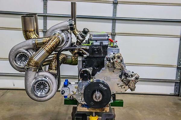

johnyrotten Posted Wednesday at 04:22 PM Posted Wednesday at 04:22 PM (edited) 2 hours ago, Ace-Garageguy said: I always kinda liked the sequential twin-turbo setups that used a small one to make boost early, and a larger one to really pour on the coal as revs came up I've seen diesel guys do this to make absolutely absurd amounts of power, and then split blocks in half. I've seen video of a triple turbo set up on diesel drag truck,pretty amazing stuff. Edited Wednesday at 04:25 PM by johnyrotten 1

JollySipper Posted Thursday at 12:33 AM Author Posted Thursday at 12:33 AM 8 hours ago, johnyrotten said: I've seen diesel guys do this to make absolutely absurd amounts of power, and then split blocks in half. I've seen video of a triple turbo set up on diesel drag truck,pretty amazing stuff. So, the turbo closest to the engine gets it off the line, and the other two come on in sequence?
Ace-Garageguy Posted Thursday at 01:00 AM Posted Thursday at 01:00 AM (edited) 2 hours ago, JollySipper said: So, the turbo closest to the engine gets it off the line, and the other two come on in sequence? If I'm understanding the plumbing in that setup correctly, all three turbines are driven directly all the time by engine exhaust straight from the exhaust ports. The two compressor outputs farthest from the engine are directed into the compressor inlet of the unit closer to the engine, where it's compressed further, achieving even higher pressure at its compressor outlet...and the plumbing from that outlet is missing in the photo. Presumably the output from the third compressor...the one closest to the engine...would be directed to an intercooler before being delivered to the intake manifold. That's not the layout of the sequential system I was referring to. ------------------------------------------------------------------ This is closer to what I was referring to, where the smaller turbo on the right spools up faster, giving some boost al lower RPM, and as engine speed increases and exhaust gas volume and heat climb, the larger turbo on the left begins to provide increased boost. EDIT: The illustration below is missing some elements and can be somewhat confusing as a consequence. Just goes to show that as usual, everything posted on the internet isn't necessarily absolutely correct information. SEE VIDEO BELOW: https://www.youtube.com/watch?v=__xVz4G-uZo&ab_channel=MarineEngineeringHub Edited Thursday at 03:04 AM by Ace-Garageguy 1 1
johnyrotten Posted Thursday at 09:16 AM Posted Thursday at 09:16 AM 8 hours ago, JollySipper said: So, the turbo closest to the engine gets it off the line, and the other two come on in sequence? It's two 88's feeding a 106mm. This kind of set up is "easier" on the turbos, less wear and tear, and for situations where you can't source an appropriate sized primary or secondary turbo,as I understand it. Boost in the neighborhood of 130 pounds. I believe the two smaller units are acting as one,and supplies the volume to the larger. 2
