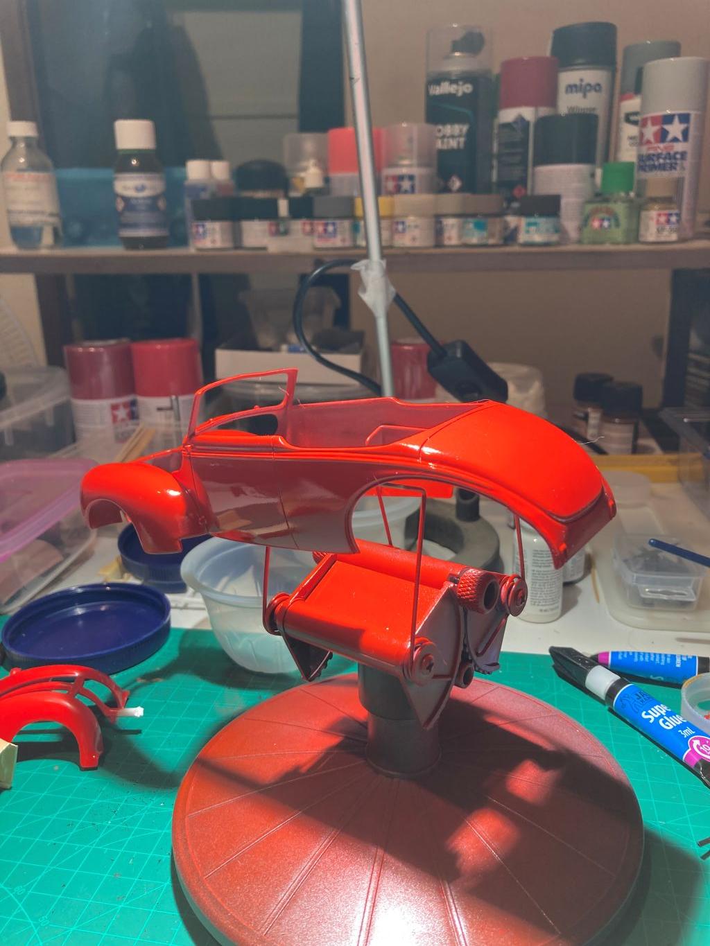

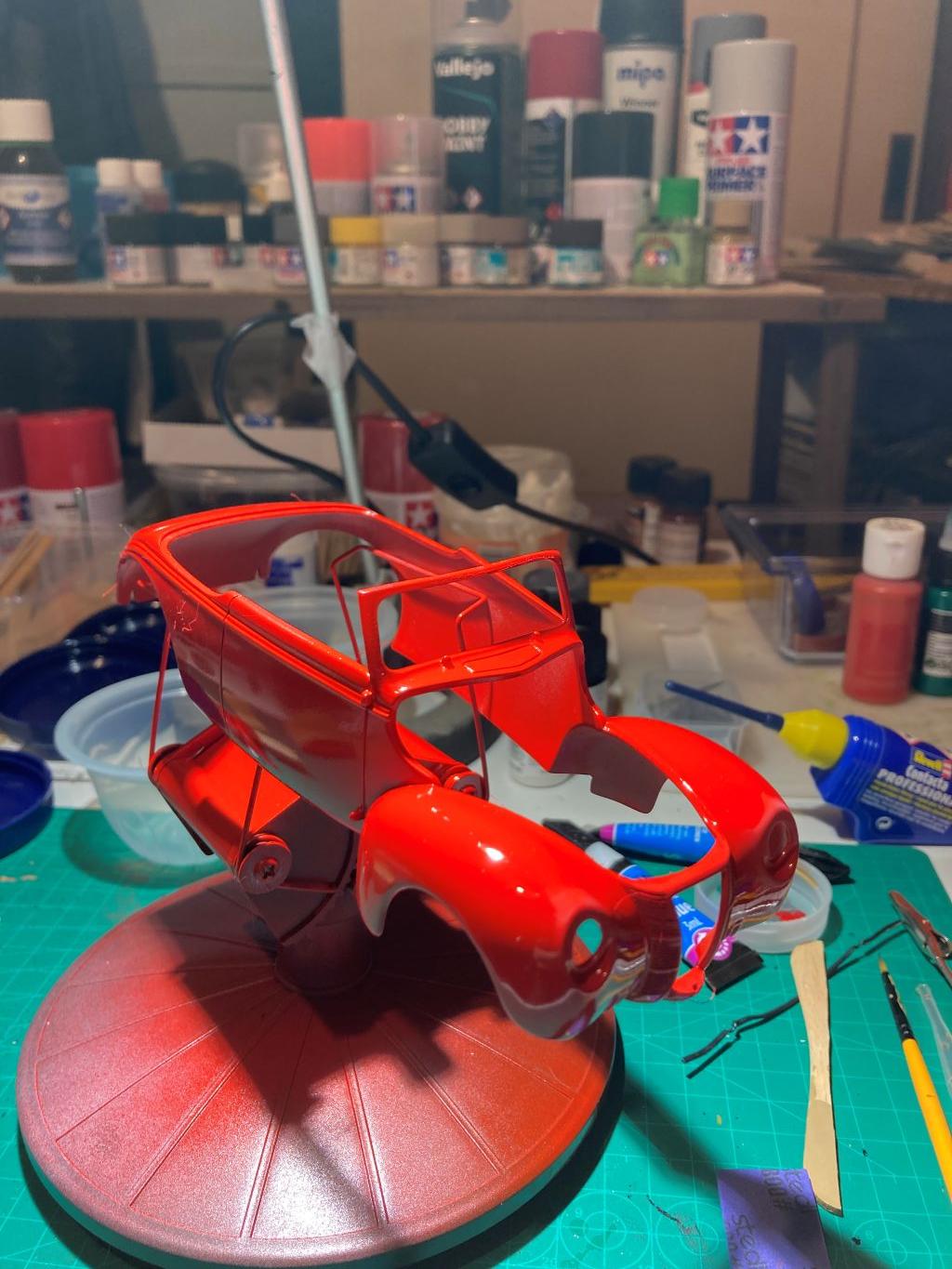

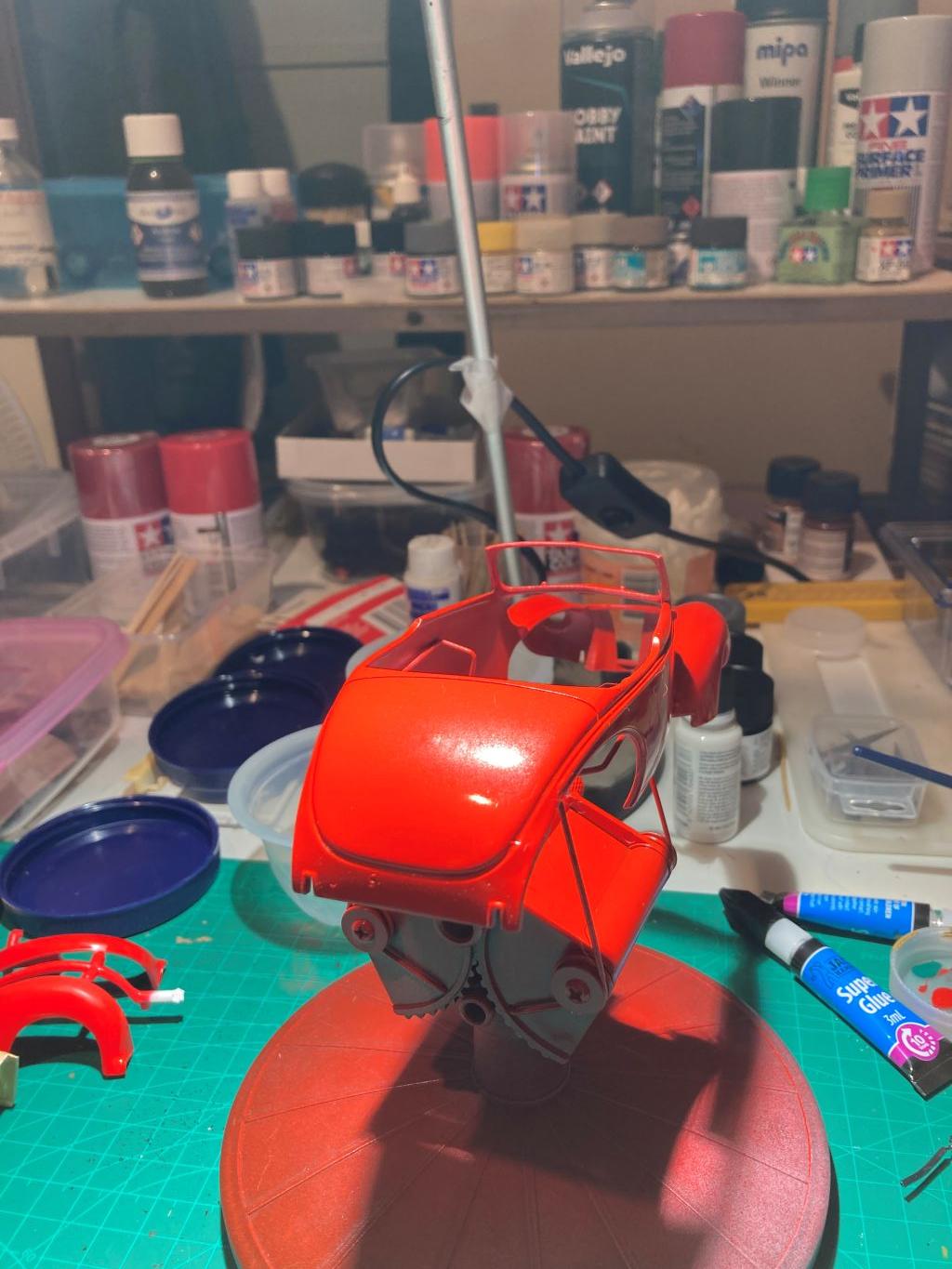

Donny Posted August 14 Author Posted August 14 Okay guys, this is where I'm at. First color, know it's not very good, but my first shot. Where do I go from here, polish, w&d, not sure of the next right move. Not sure if it's good enough to proceed, so need your help/advice. I have Mothers polish I can use when necessary. Thanks Don Don 2
Donny Posted August 14 Author Posted August 14 1 hour ago, Donny said: Okay guys, this is where I'm at. First color, know it's not very good, but my first shot. Where do I go from here, polish, w&d, not sure of the next right move. Not sure if it's good enough to proceed, so need your help/advice. I have Mothers polish I can use when necessary. Thanks Don Don I meant to add, it actually looks better real than in those pics
TopherMcGinnis Posted August 14 Posted August 14 It looks good to me. Your next step will depend on what you are wanting. If you want a super slick and a mirror like finish, you may want to wet sand the surface up to 12000 and polish. I'd park it on my shelf as is. 2
Bainford Posted August 14 Posted August 14 Yup, it's looking pretty good, and as Topher says, how far you wish to carry the finish depends entirely on what you wish to accomplish. At this stage of your development, I would just focus on getting a decent coat of paint laid down (which you appear to have), and getting it cleanly built. Full-on cutting & polishing the paint is a tedious exercise requiring experience to get it right. A lot of paint jobs can get ruined in the accumulation of those skills. Don't worry about that stuff for now. You can give the body a quick rub with the Mother's polish if you wish, but even then, I would paint a junk body or something and practice on that in order to assess how quickly the polish removes paint. If you do give it a rub, avoid edges and high spots on the body, as some polishes will remove paint from these areas faster than you may expect. The colour looks great. I think you are on to a good looking build here. Focus on getting it together cleanly and you will have a successful build for the shelf. Getting to that point will be satisfying, and success breeds confidence. Also, especially when starting out, it is way too easy in this hobby to get bogged down with a project, which creates frustration, and it ends up back in the box. It's double easy to do when many of your peers (the forum members) have been at this for more decades than they care to recall, and have spent much time over the years experimenting with alternate products, processes, and techniques. Keep it simple at first. Remember, every build is merely practice for the next one. 3
espo Posted August 14 Posted August 14 The finish looks pretty nice in the photos. Depending on how smooth the paint surface is, maybe even try some polishing with Tamiya polishing compound or some comparable product. Micro Fiber towel or a baby diaper, preferable empty, as an applicator and polishing.
Donny Posted August 14 Author Posted August 14 2 hours ago, Bainford said: Yup, it's looking pretty good, and as Topher says, how far you wish to carry the finish depends entirely on what you wish to accomplish. At this stage of your development, I would just focus on getting a decent coat of paint laid down (which you appear to have), and getting it cleanly built. Full-on cutting & polishing the paint is a tedious exercise requiring experience to get it right. A lot of paint jobs can get ruined in the accumulation of those skills. Don't worry about that stuff for now. You can give the body a quick rub with the Mother's polish if you wish, but even then, I would paint a junk body or something and practice on that in order to assess how quickly the polish removes paint. If you do give it a rub, avoid edges and high spots on the body, as some polishes will remove paint from these areas faster than you may expect. The colour looks great. I think you are on to a good looking build here. Focus on getting it together cleanly and you will have a successful build for the shelf. Getting to that point will be satisfying, and success breeds confidence. Also, especially when starting out, it is way too easy in this hobby to get bogged down with a project, which creates frustration, and it ends up back in the box. It's double easy to do when many of your peers (the forum members) have been at this for more decades than they care to recall, and have spent much time over the years experimenting with alternate products, processes, and techniques. Keep it simple at first. Remember, every build is merely practice for the next one. Thank you for your comments and advice Trevor, I am pretty happy (with the paint), how it has turned out for my first one, and I will leave it as such. I don't want to try for a better finish and mess it up. So on with build/finish. Don 1
Donny Posted August 14 Author Posted August 14 1 hour ago, espo said: The finish looks pretty nice in the photos. Depending on how smooth the paint surface is, maybe even try some polishing with Tamiya polishing compound or some comparable product. Micro Fiber towel or a baby diaper, preferable empty, as an applicator and polishing. Thanks David, the paint is pretty smooth, feels nice. A couple of spots I noticed a tiny bit of crazing, but not enough to worry about, and it would be extremely difficult to fix them, so leave well alone I think. Don
Donny Posted August 14 Author Posted August 14 9 hours ago, TopherMcGinnis said: It looks good to me. Your next step will depend on what you are wanting. If you want a super slick and a mirror like finish, you may want to wet sand the surface up to 12000 and polish. I'd park it on my shelf as is. Thank you mate, think I'll leave the 12000 until the next build with a bit more experience. Don

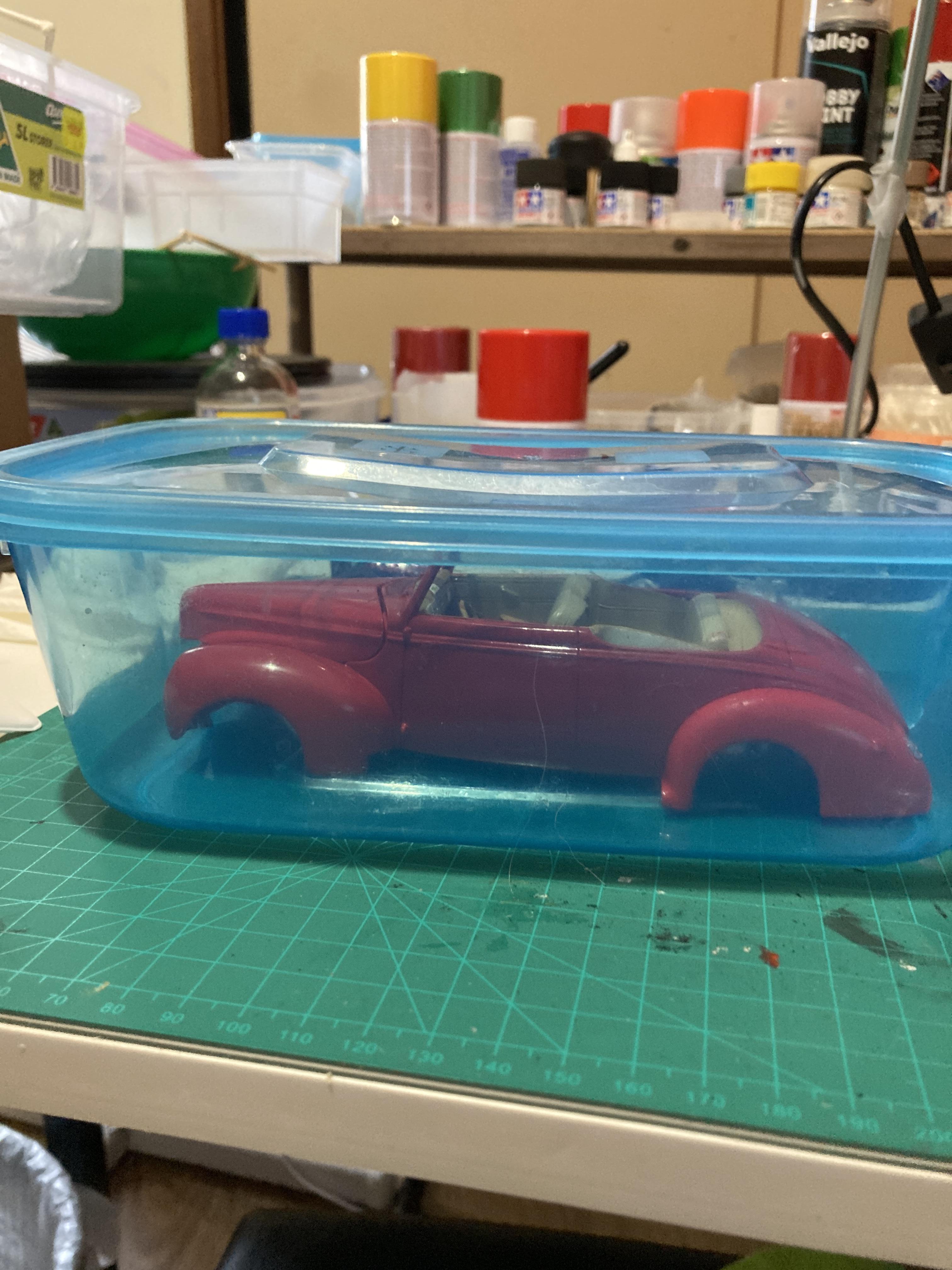

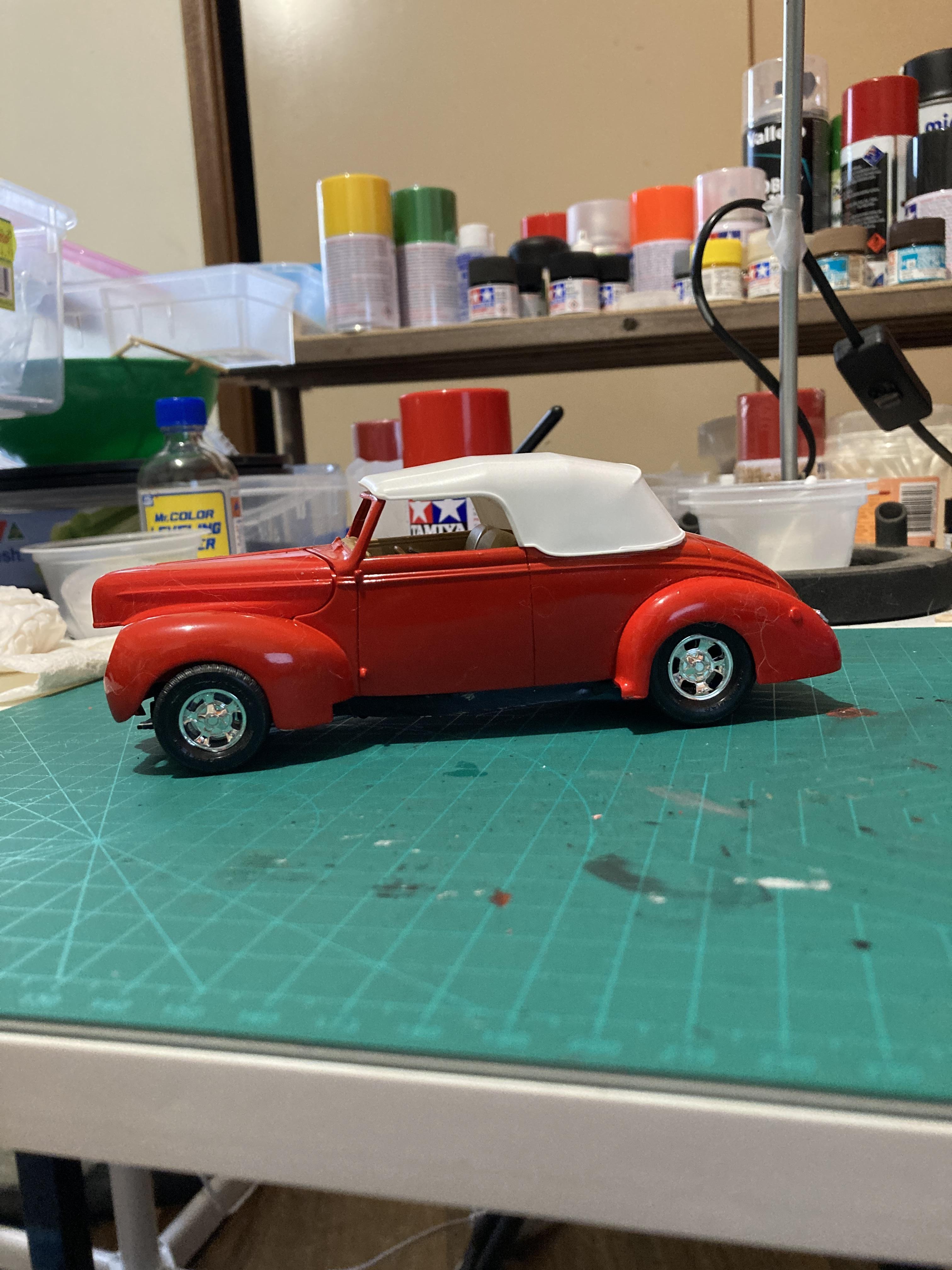

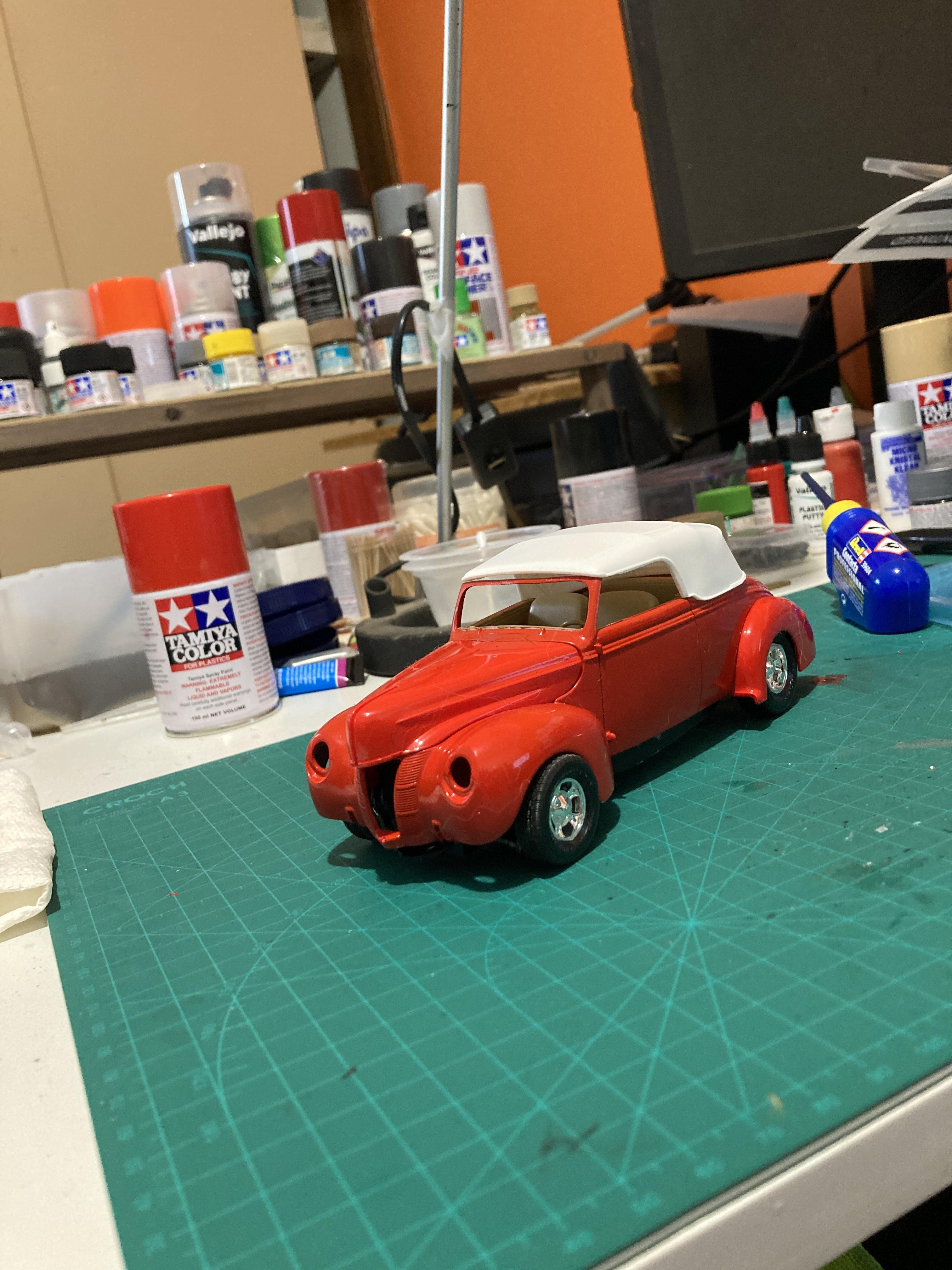

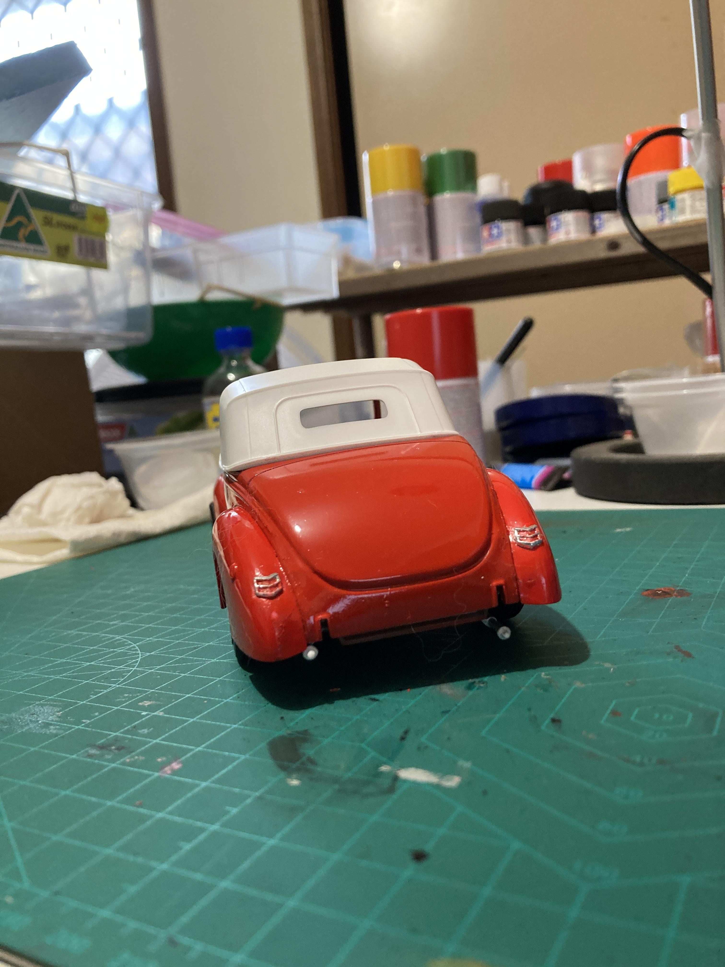

Donny Posted August 21 Author Posted August 21 Morning guys, I am nearing the end of the initial journey, still a little bit to go, a few more days should see it completed. So far, It's not too bad, but not as good as I hoped. Anyway onward and upward as they say. The construction side was quite good, I didn't run into too many problems, but the paint, different story, that's a real skill, and I need a LOT of practice. I've included a few pics, and if you are wondering about the last two, the container with the car in it, is just what I do to preserve them as I build, keep the dust and hair off them, or as much as possible, as I have a problem - first pic. LOL They are Ragdolls, my wife's cats that she bred for about fifteen years - and as you can see, real "fur" balls and they shed, and if you know anything about cats, they go everywhere. Sorry pics are side on, I loaded the wrong file
stitchdup Posted August 22 Posted August 22 9 hours ago, Donny said: Morning guys, I am nearing the end of the initial journey, still a little bit to go, a few more days should see it completed. So far, It's not too bad, but not as good as I hoped. Anyway onward and upward as they say. The construction side was quite good, I didn't run into too many problems, but the paint, different story, that's a real skill, and I need a LOT of practice. I've included a few pics, and if you are wondering about the last two, the container with the car in it, is just what I do to preserve them as I build, keep the dust and hair off them, or as much as possible, as I have a problem - first pic. LOL They are Ragdolls, my wife's cats that she bred for about fifteen years - and as you can see, real "fur" balls and they shed, and if you know anything about cats, they go everywhere. Sorry pics are side on, I loaded the wrong file appologies Donny, i rotated your pics and now theres a gap for some reason. 1
Donny Posted August 22 Author Posted August 22 All good Les, thanks for doing that. They are bloody awful, look like they are painted with a brush - badly. I'm not going to post anymore pics until it's finished, and I can do it properly. My MIL got rushed to hospital this morning, and our house is in a bit of turmoil. Hence the scrappy post. Those cats cause me a heap of drama - hair wise, which is why, in between working on my models, I put them in those airtight containers. Don

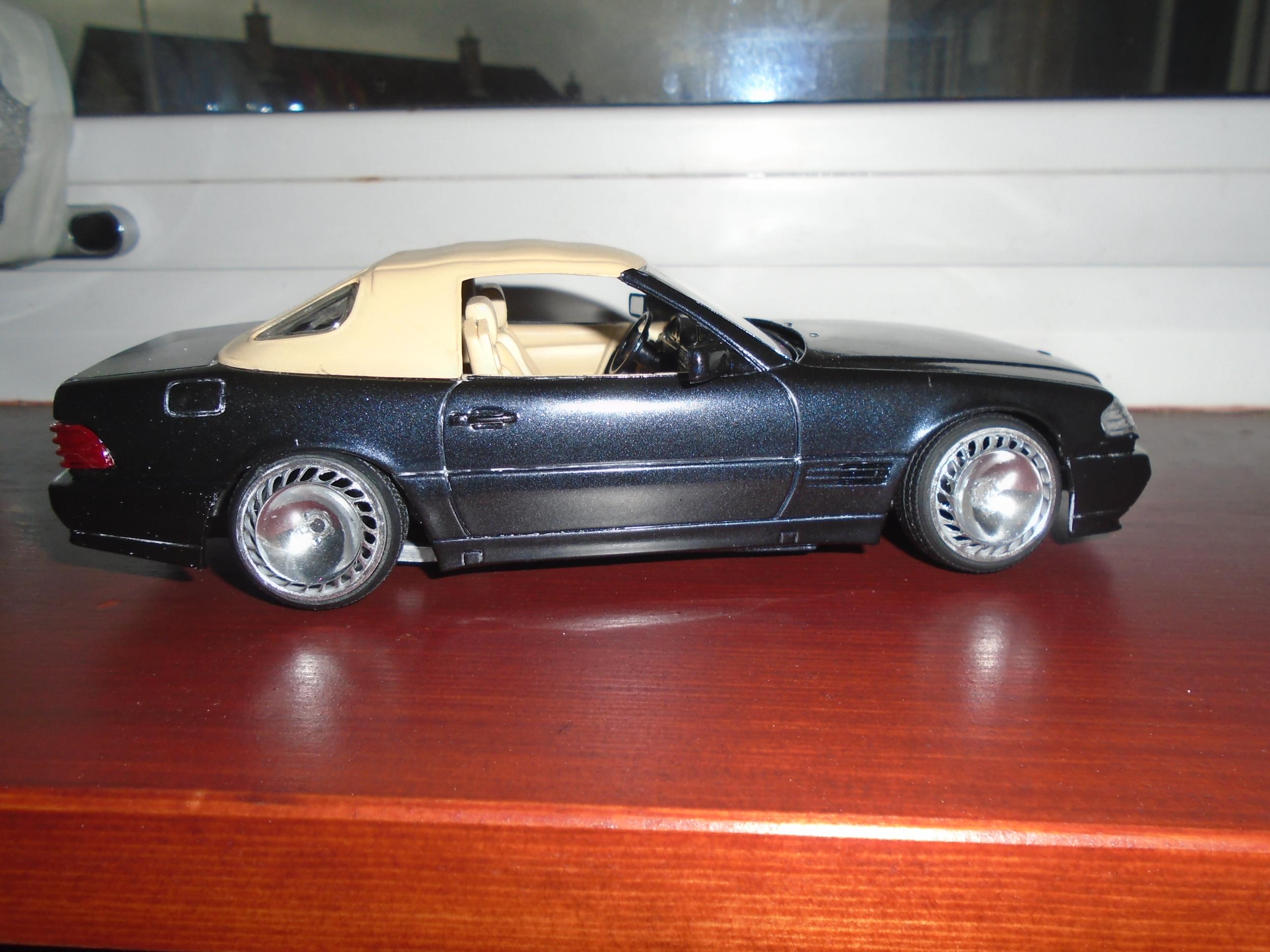

stitchdup Posted August 22 Posted August 22 3 minutes ago, Donny said: All good Les, thanks for doing that. They are bloody awful, look like they are painted with a brush - badly. I'm not going to post anymore pics until it's finished, and I can do it properly. My MIL got rushed to hospital this morning, and our house is in a bit of turmoil. Hence the scrappy post. Those cats cause me a heap of drama - hair wise, which is why, in between working on my models, I put them in those airtight containers. Don No worries mate. I hope the MIL is ok. We all look at our models and sometimes only see what we did wrong, and I'm as guilty of it as anybody else. What we need to do is look for the parts we are happy with more often. For example, when i look at this one all i see are the flaws (and they are many including poor paint) 2

meechum68 Posted August 22 Posted August 22 I love the look, and the color is spot on for that look. 1
