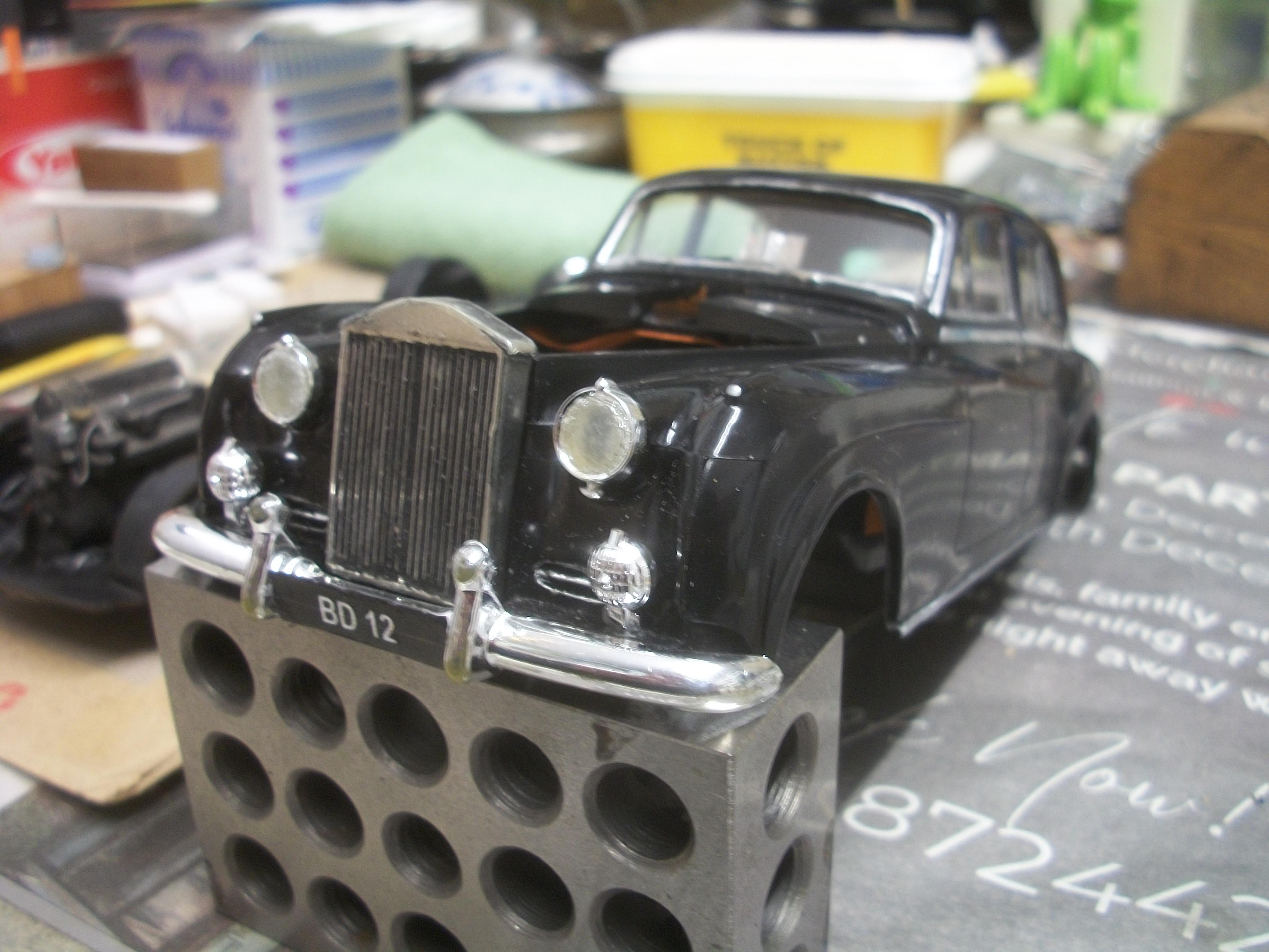

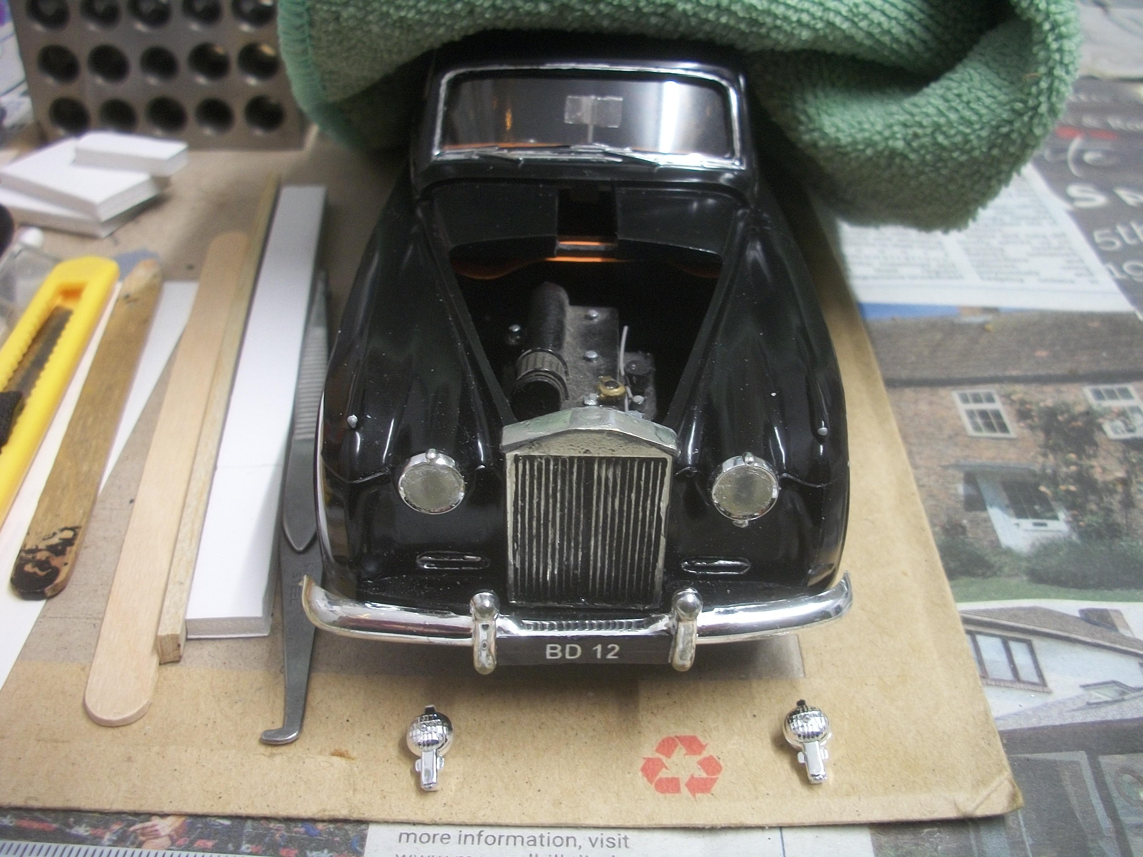

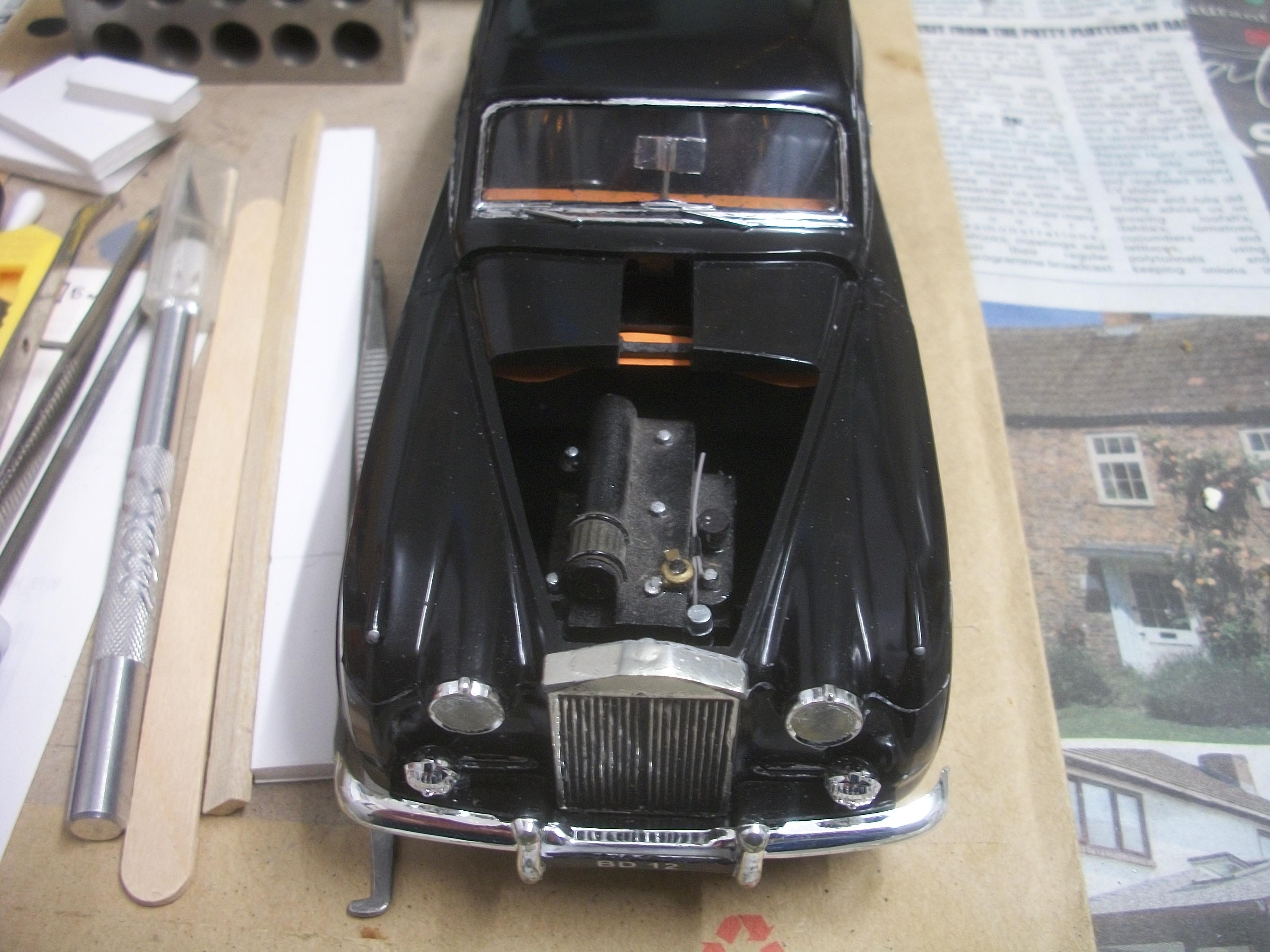

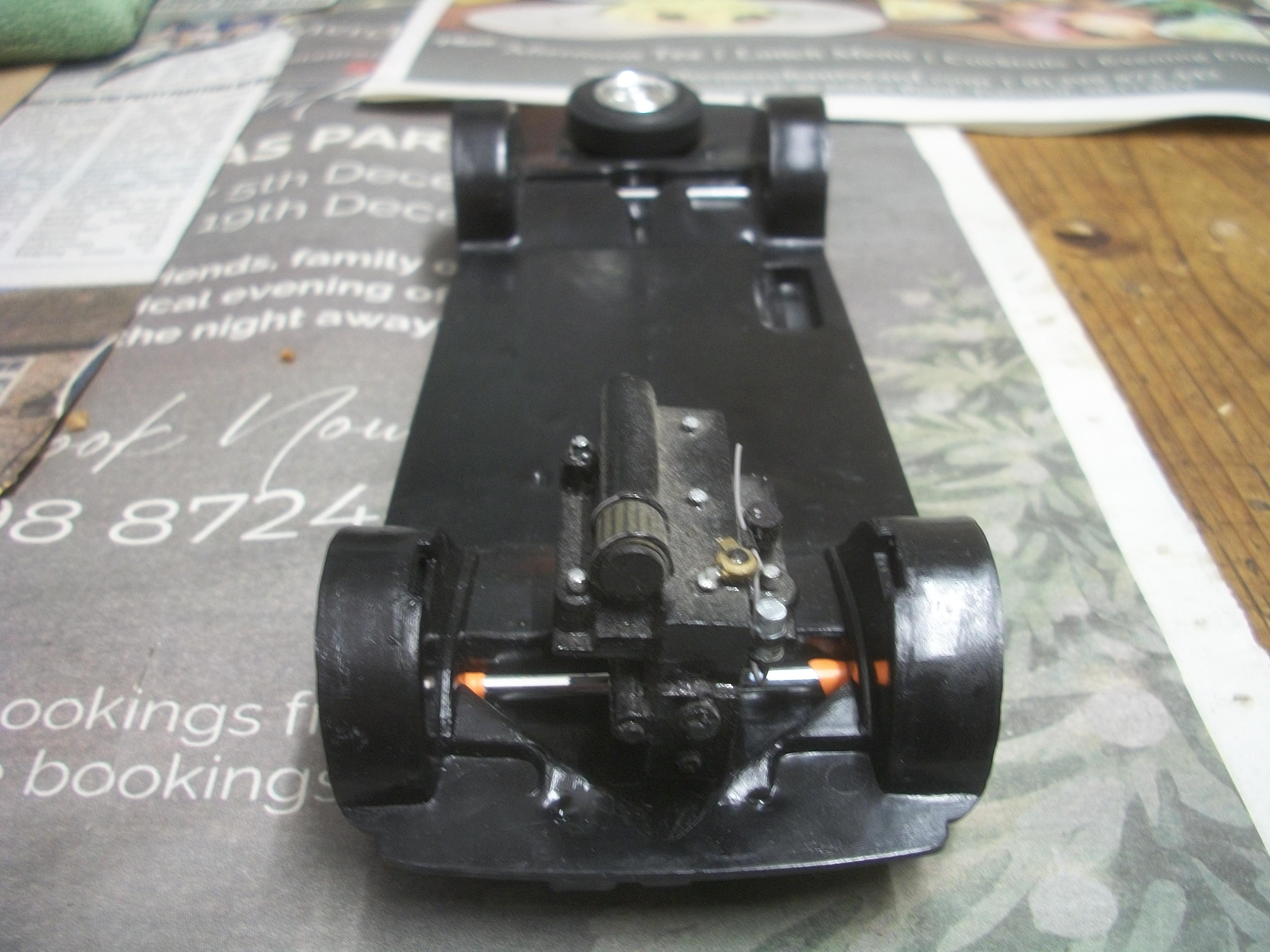

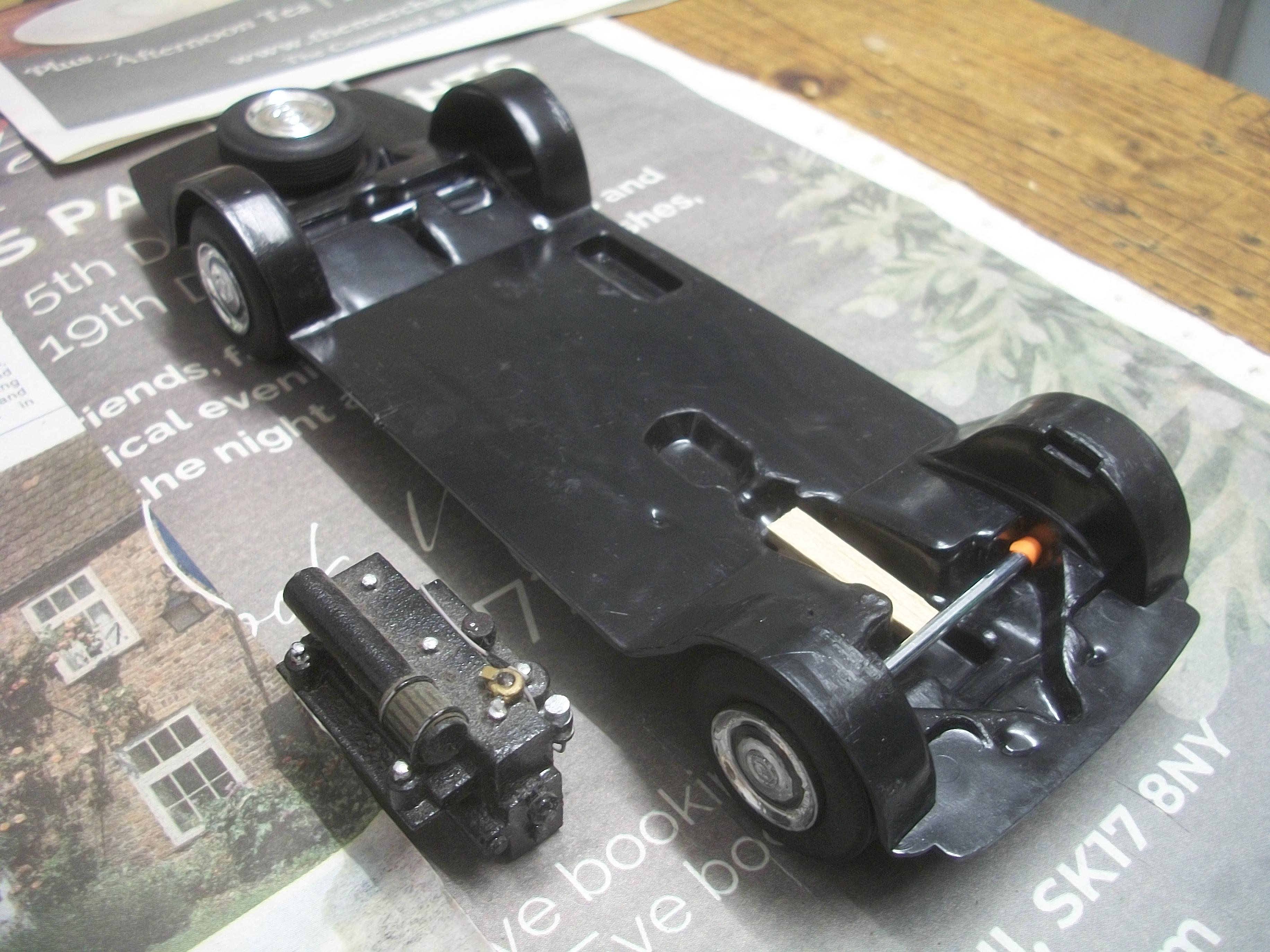

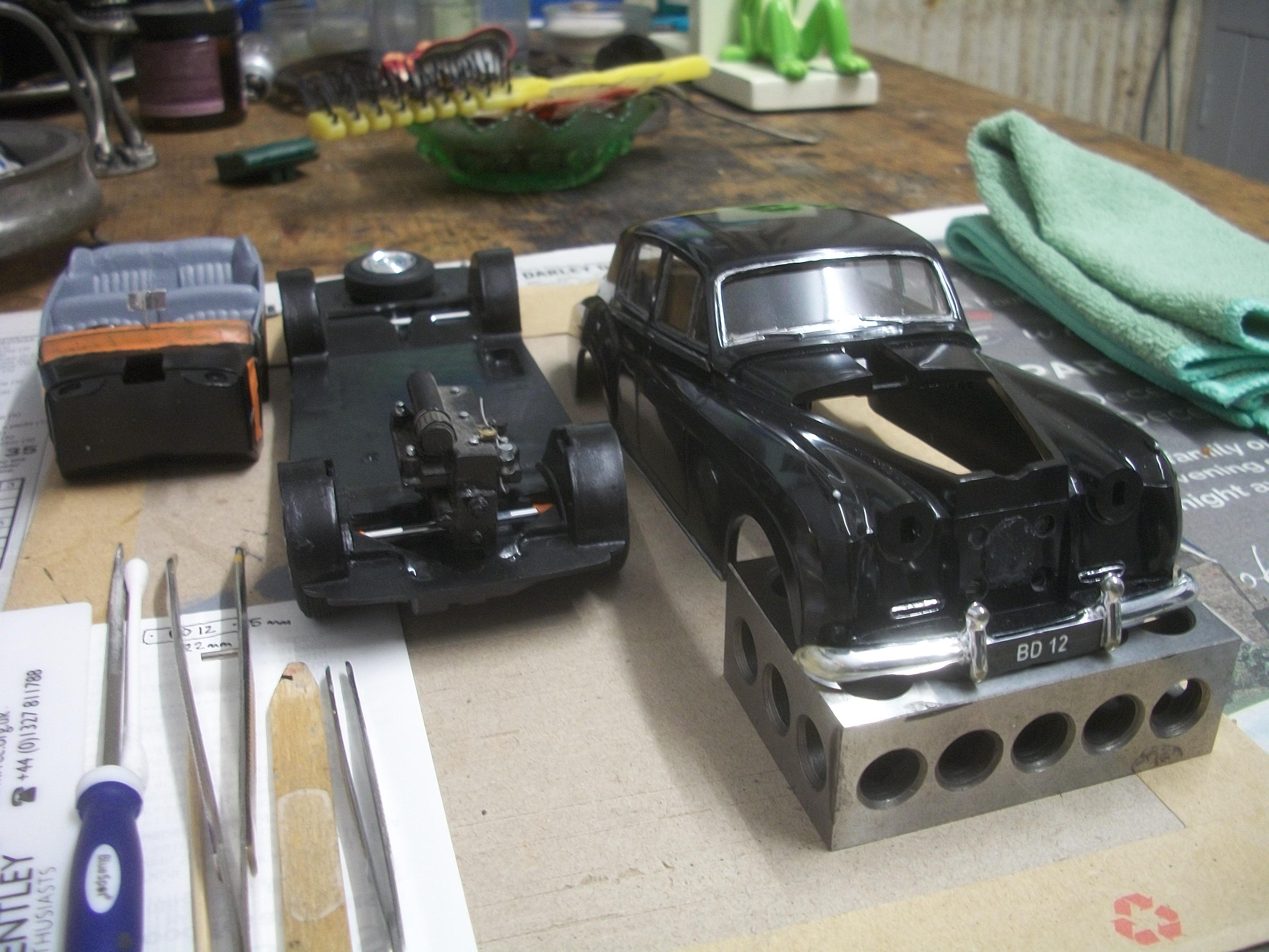

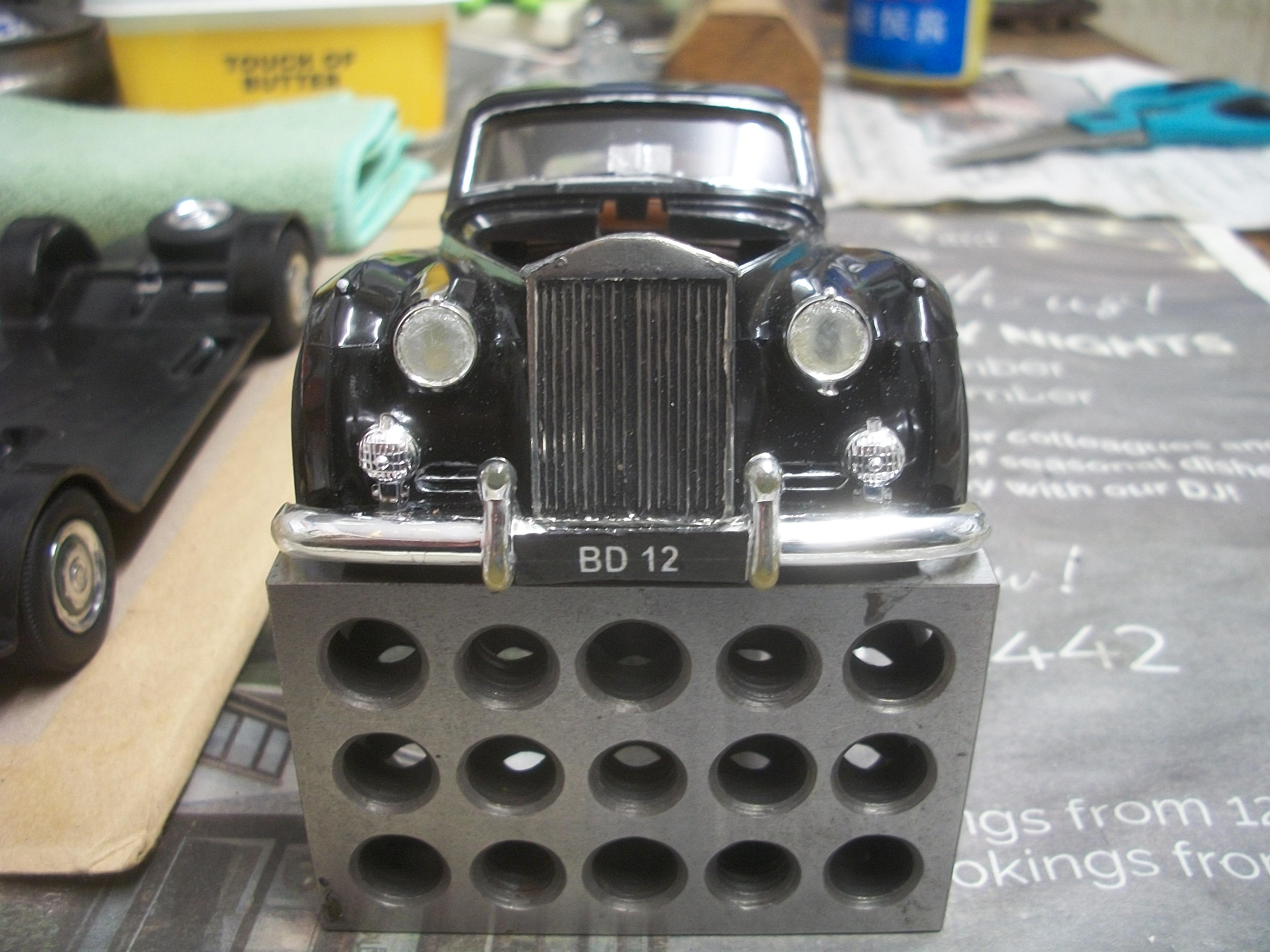

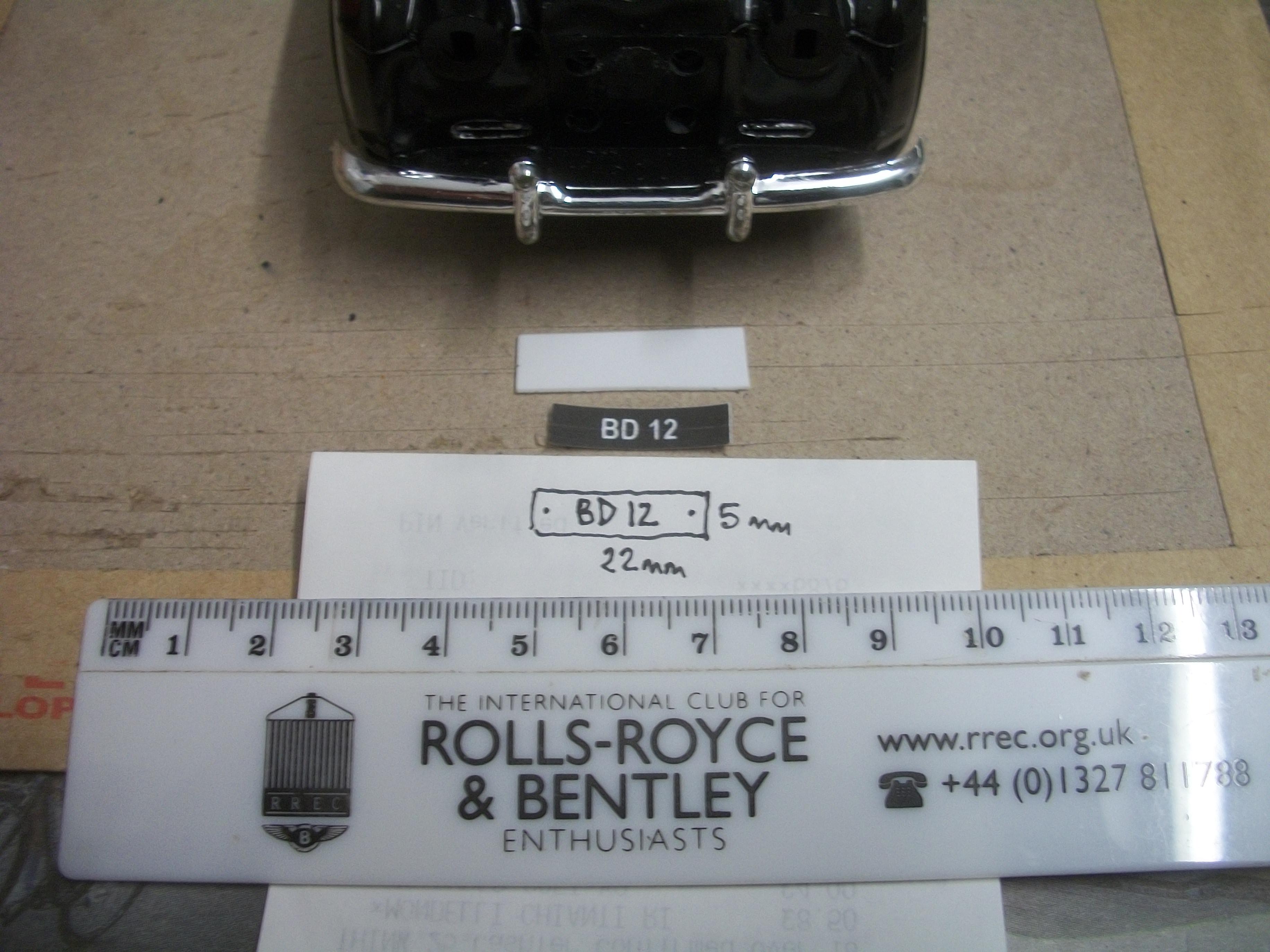

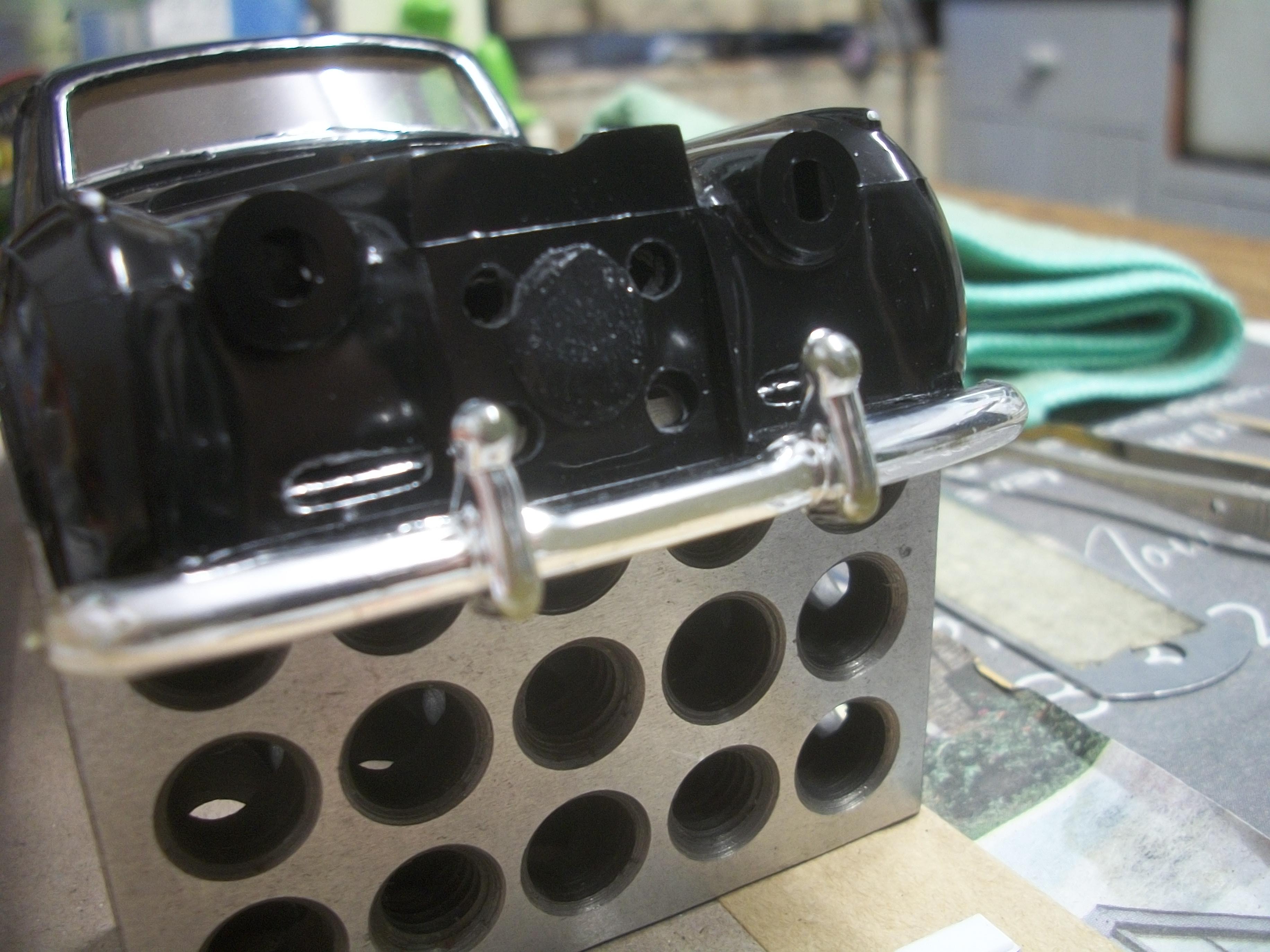

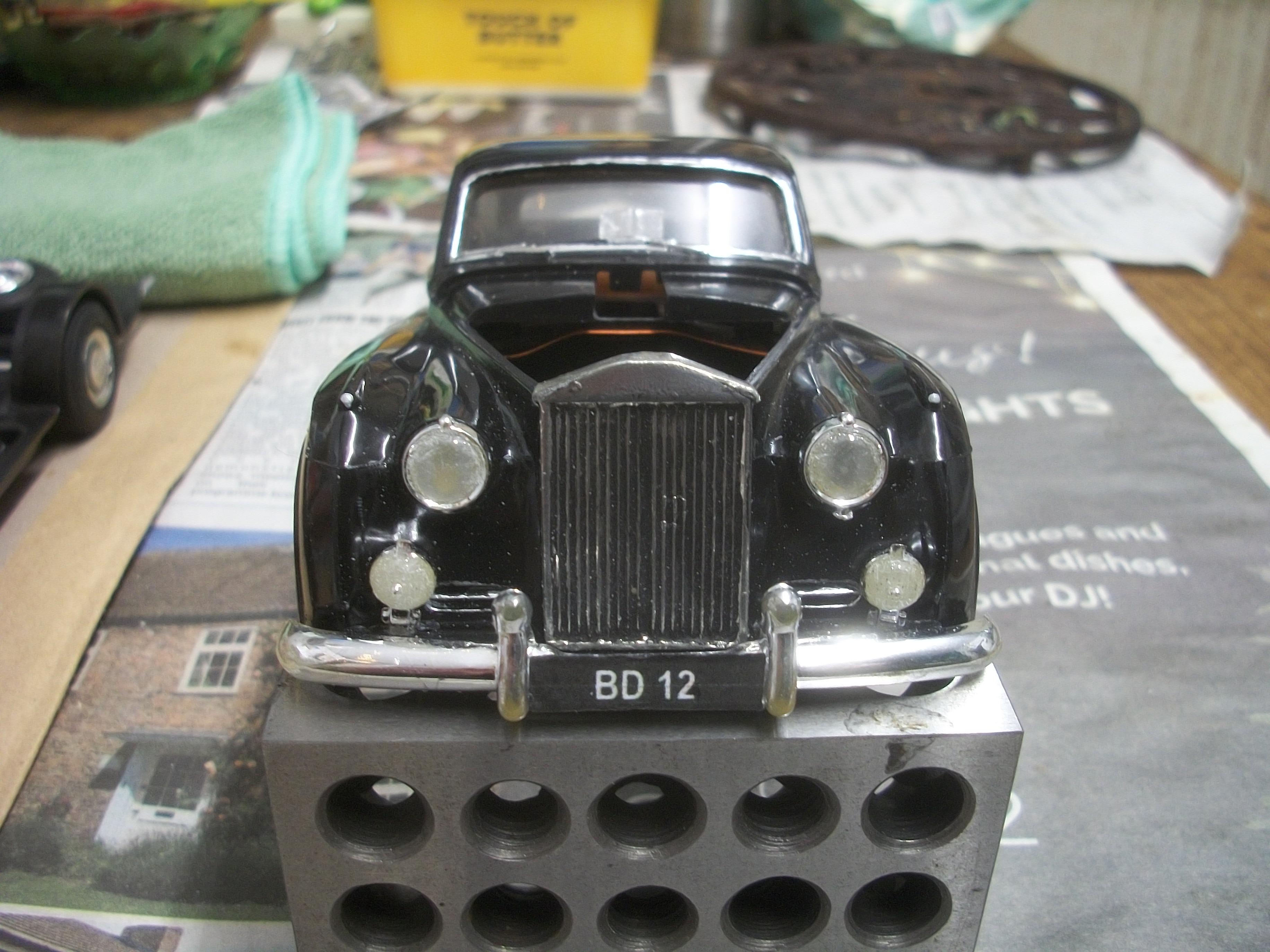

Anglia105E Posted October 15 Author Posted October 15 This evening, the front registration number plate ' BD 12 ' was PVA glued to a piece of styrene sheet that was measured and cut to 22 mm x 5 mm. The number plate is now mounted onto the front bumper, in between the two overriders . . . Also measured and cut to size was a length of balsa wood, to form the spacer piece that goes under the rear sump of the engine. A smaller piece of balsa was placed under the back end of the main piece, and both were glued onto the chassis with PVA. Both the number plate and engine block spacers are being allowed to set overnight. David

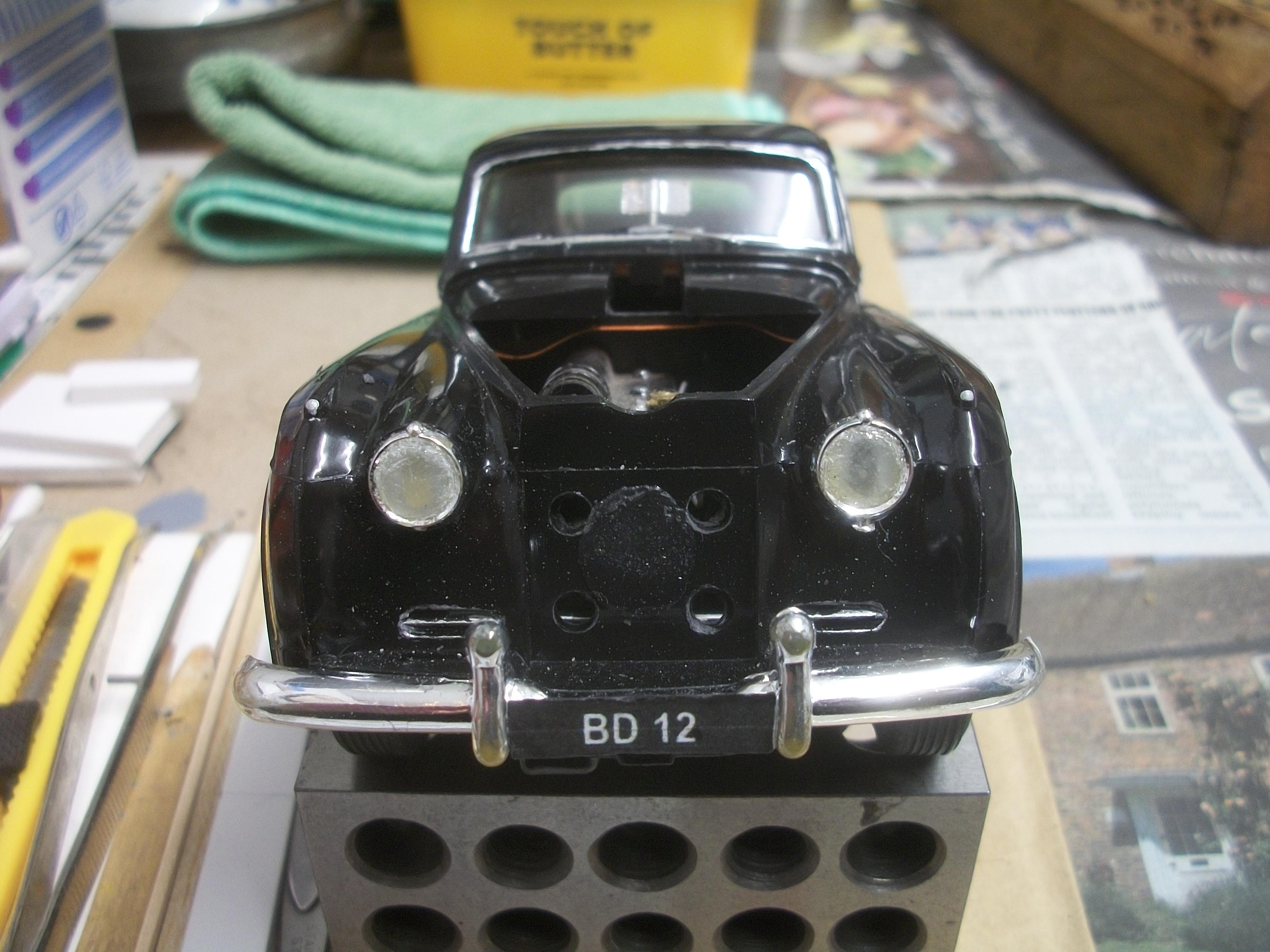

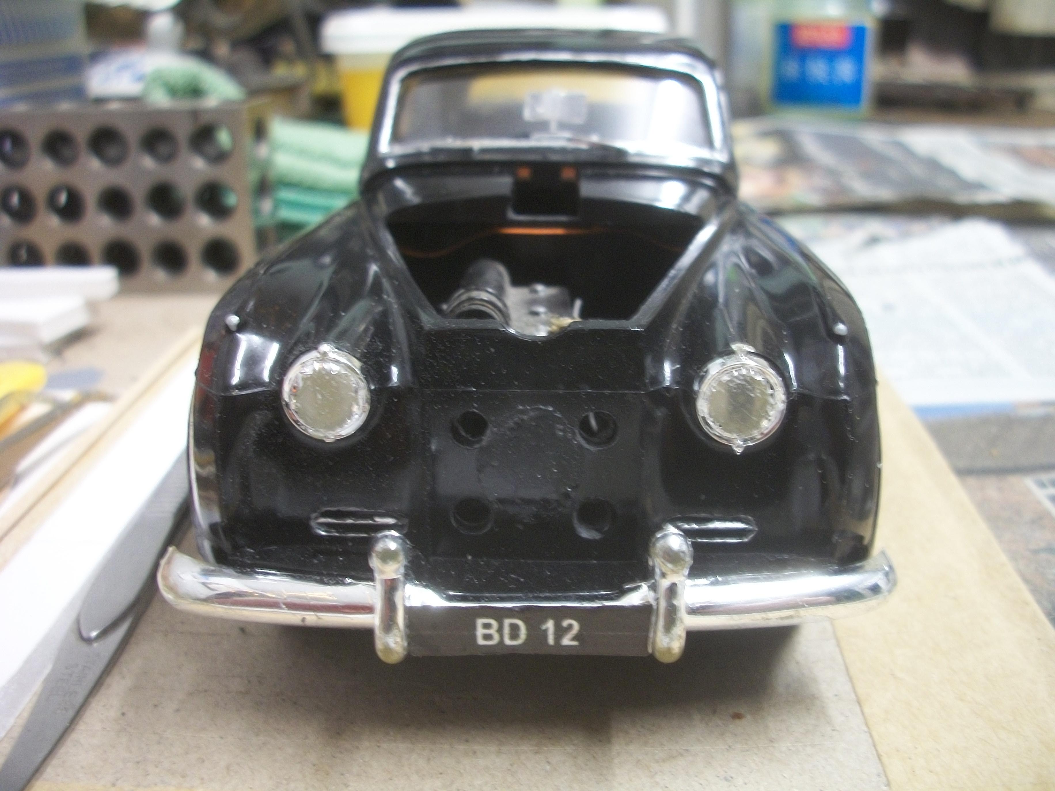

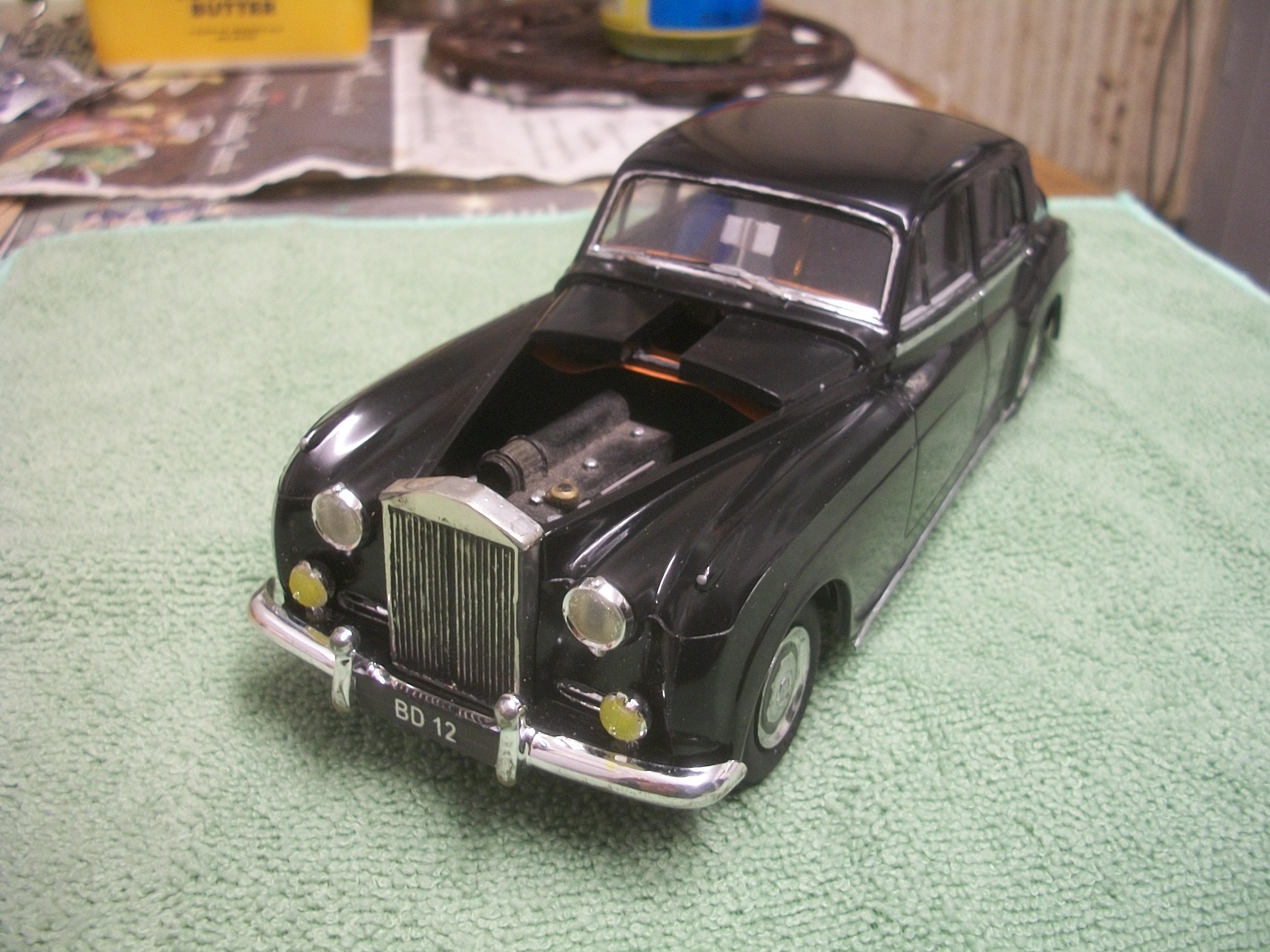

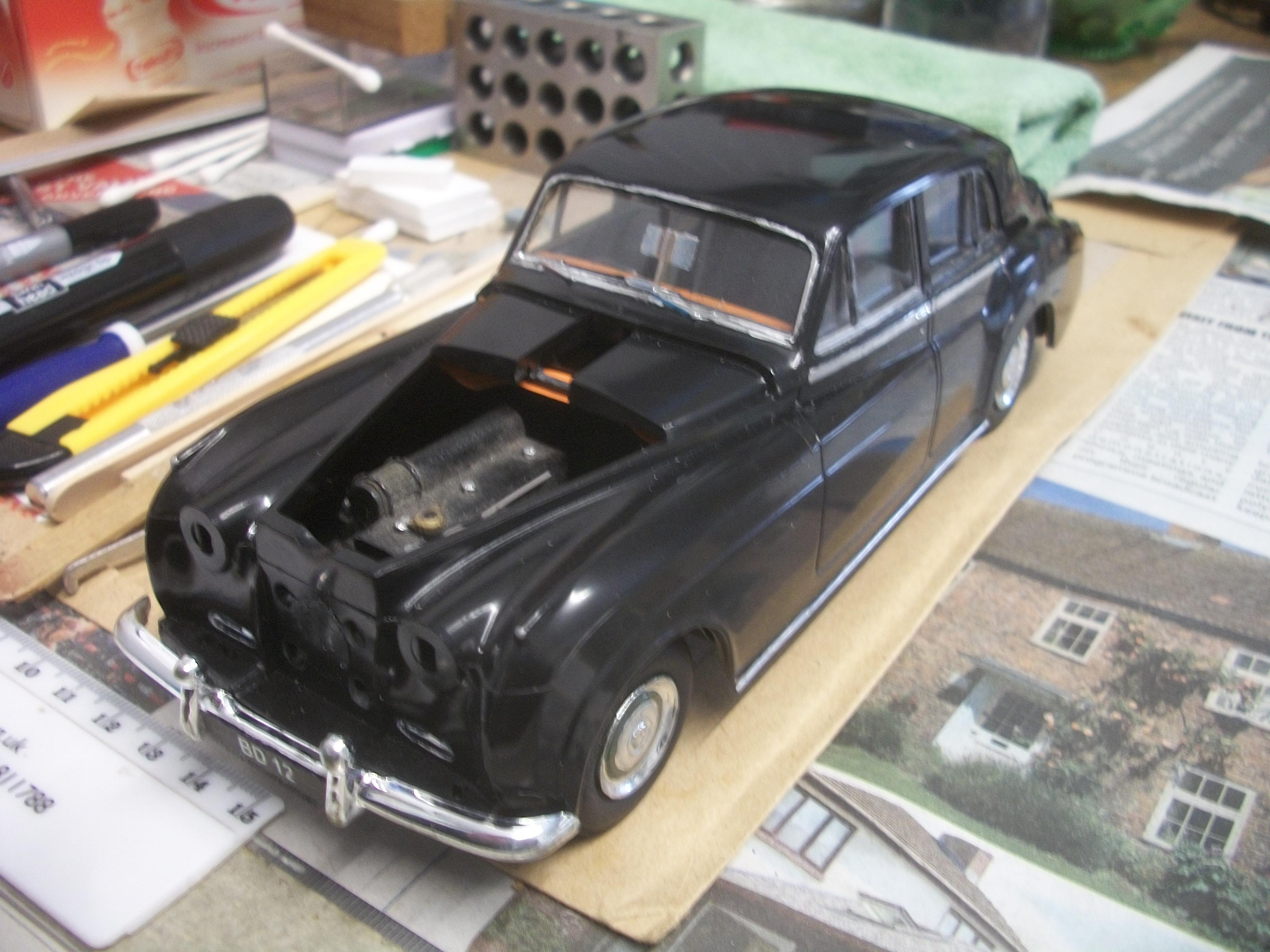

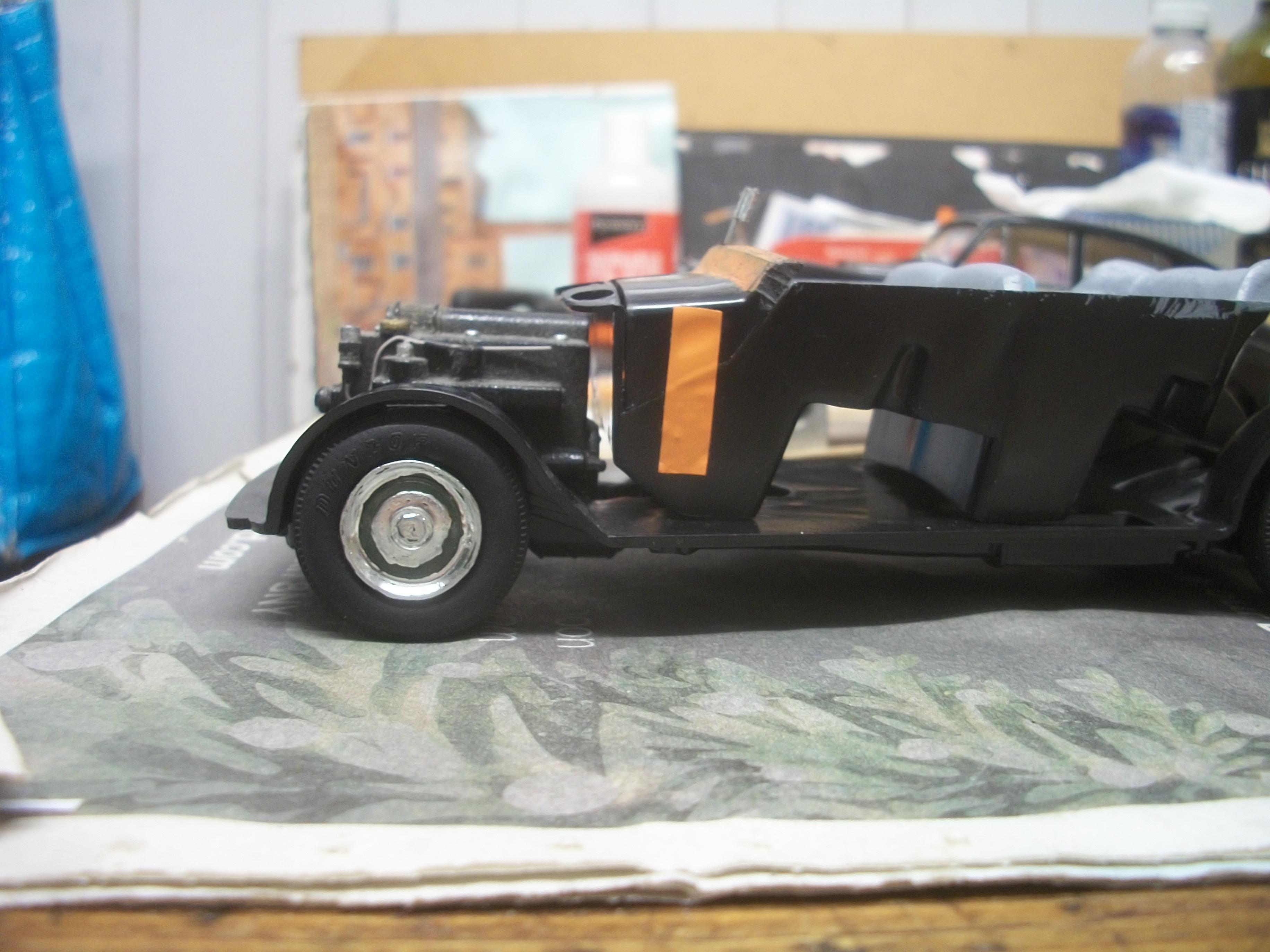

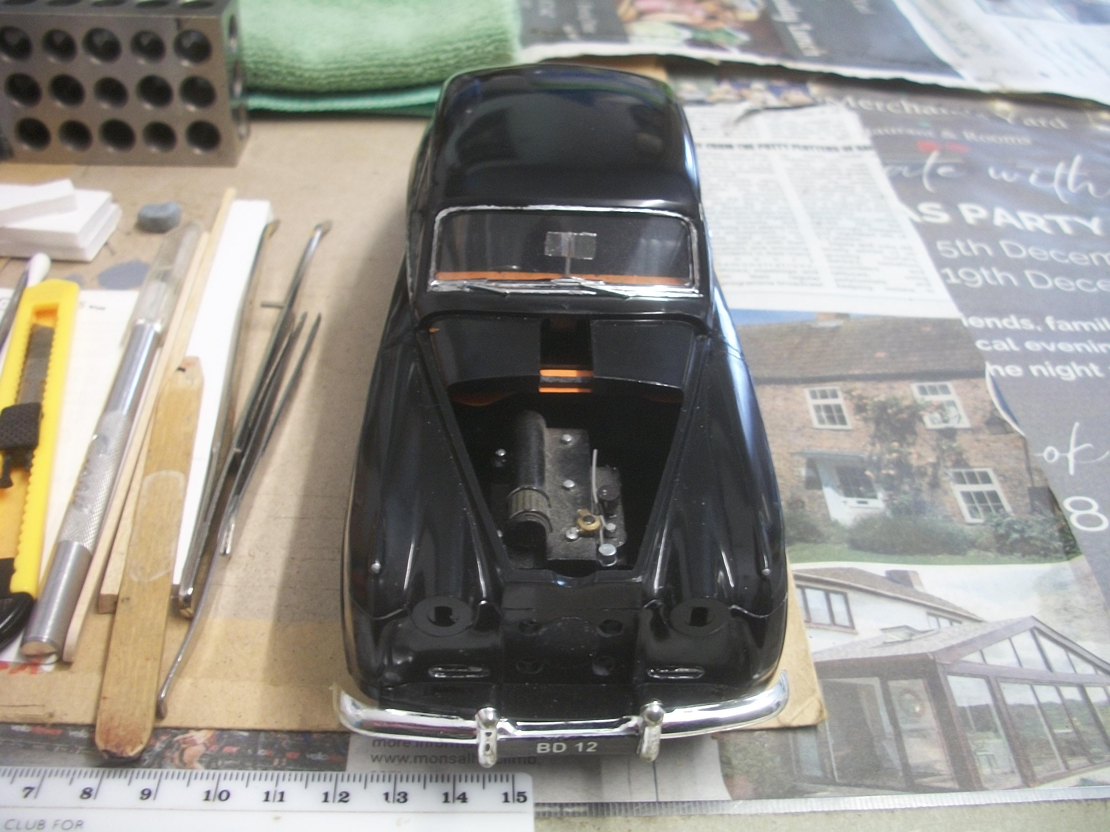

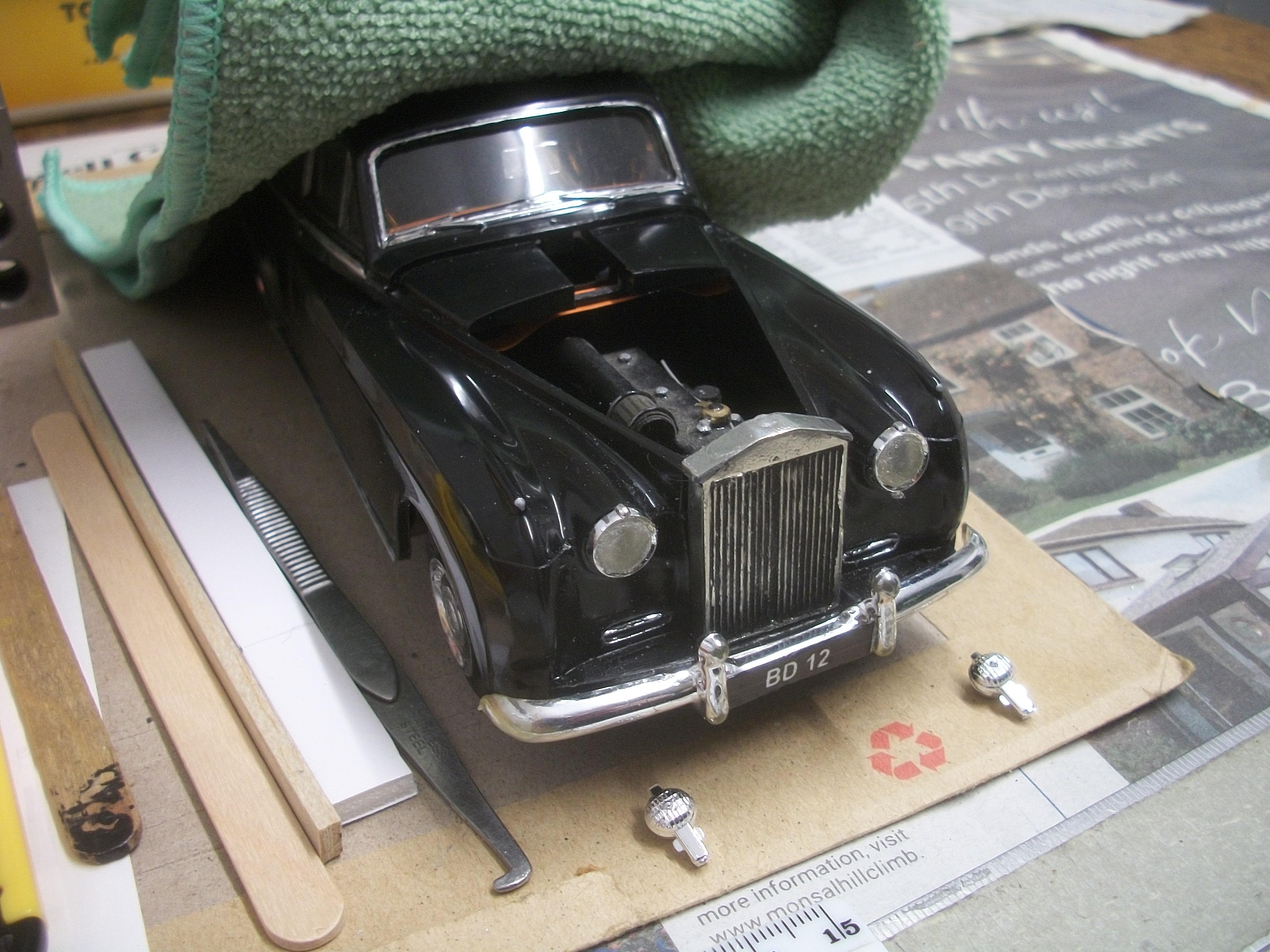

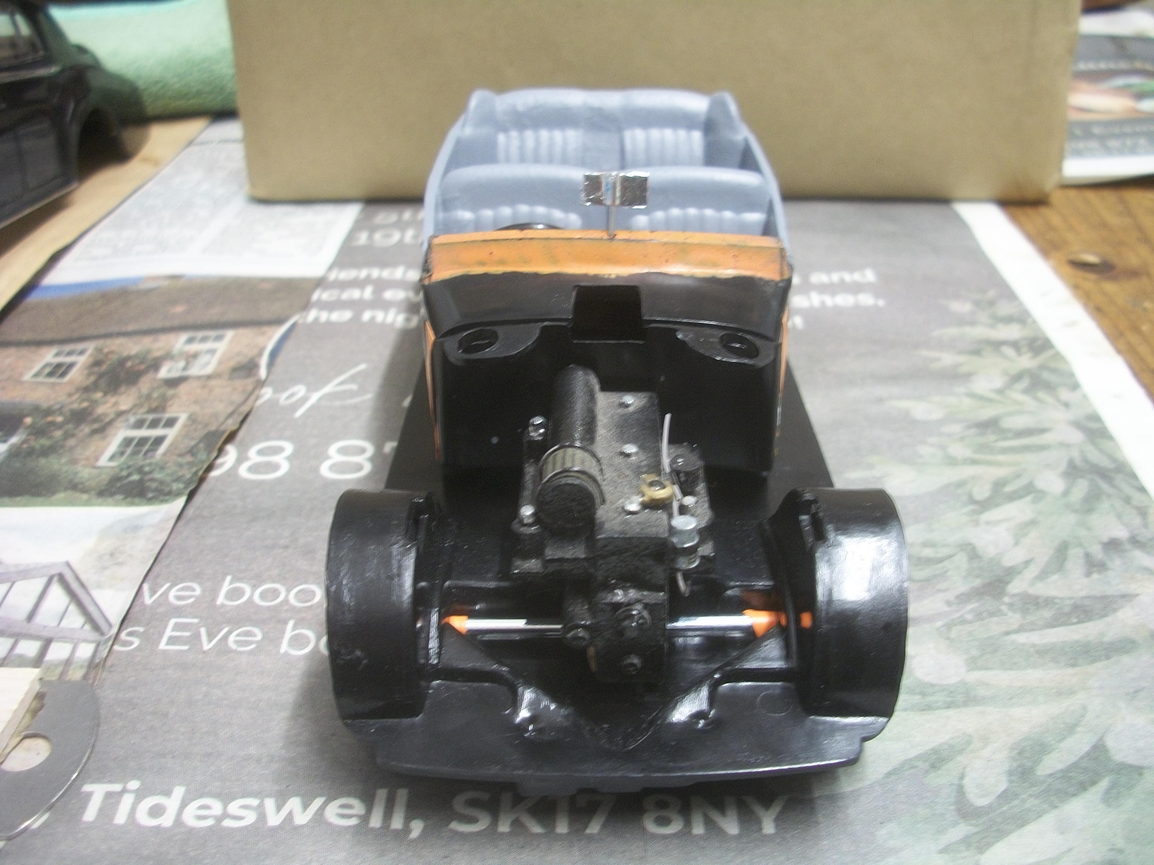

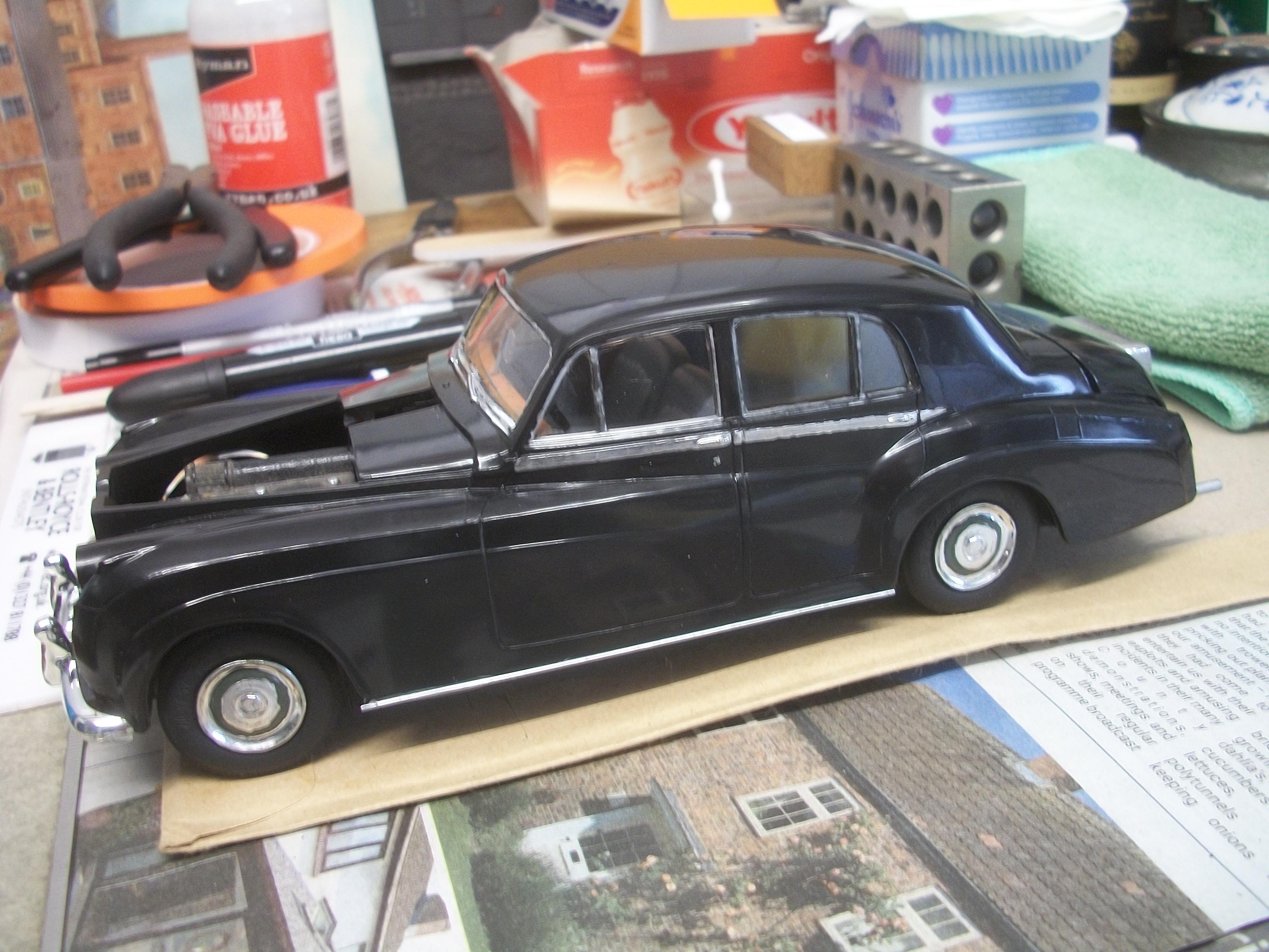

Anglia105E Posted October 16 Author Posted October 16 Here are three photos of the recent work . . . This is body on rolling chassis, with interior tub dry fitted, and the engine is test fitted only at this stage. David 1

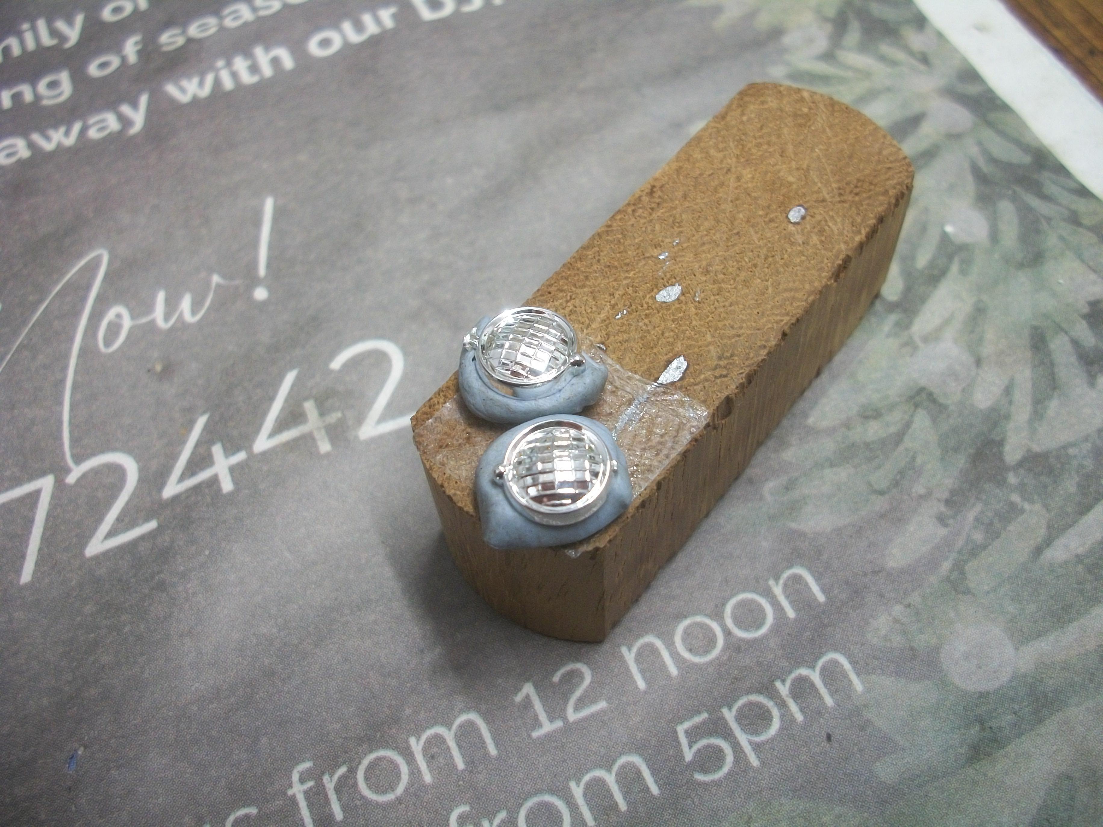

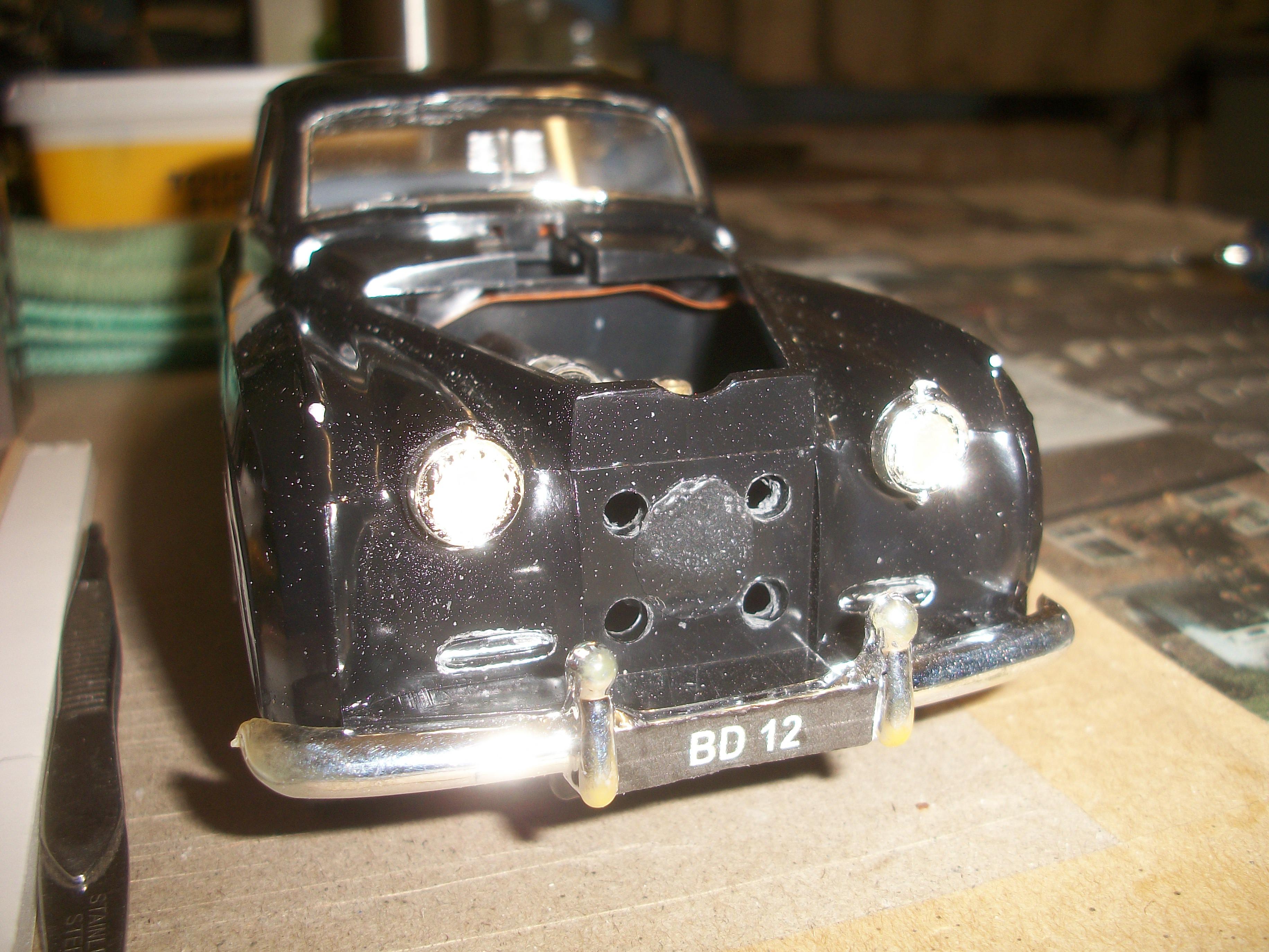

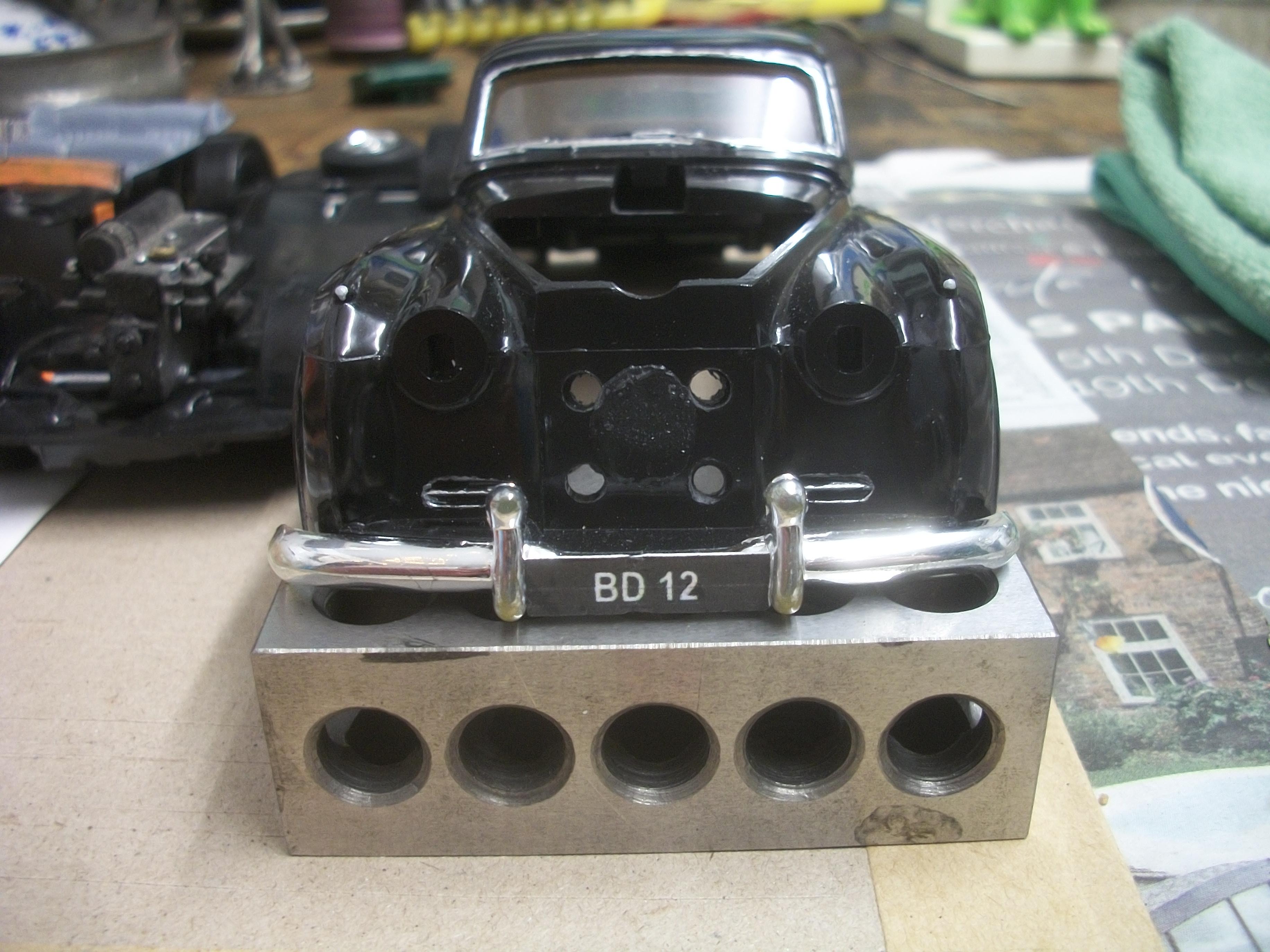

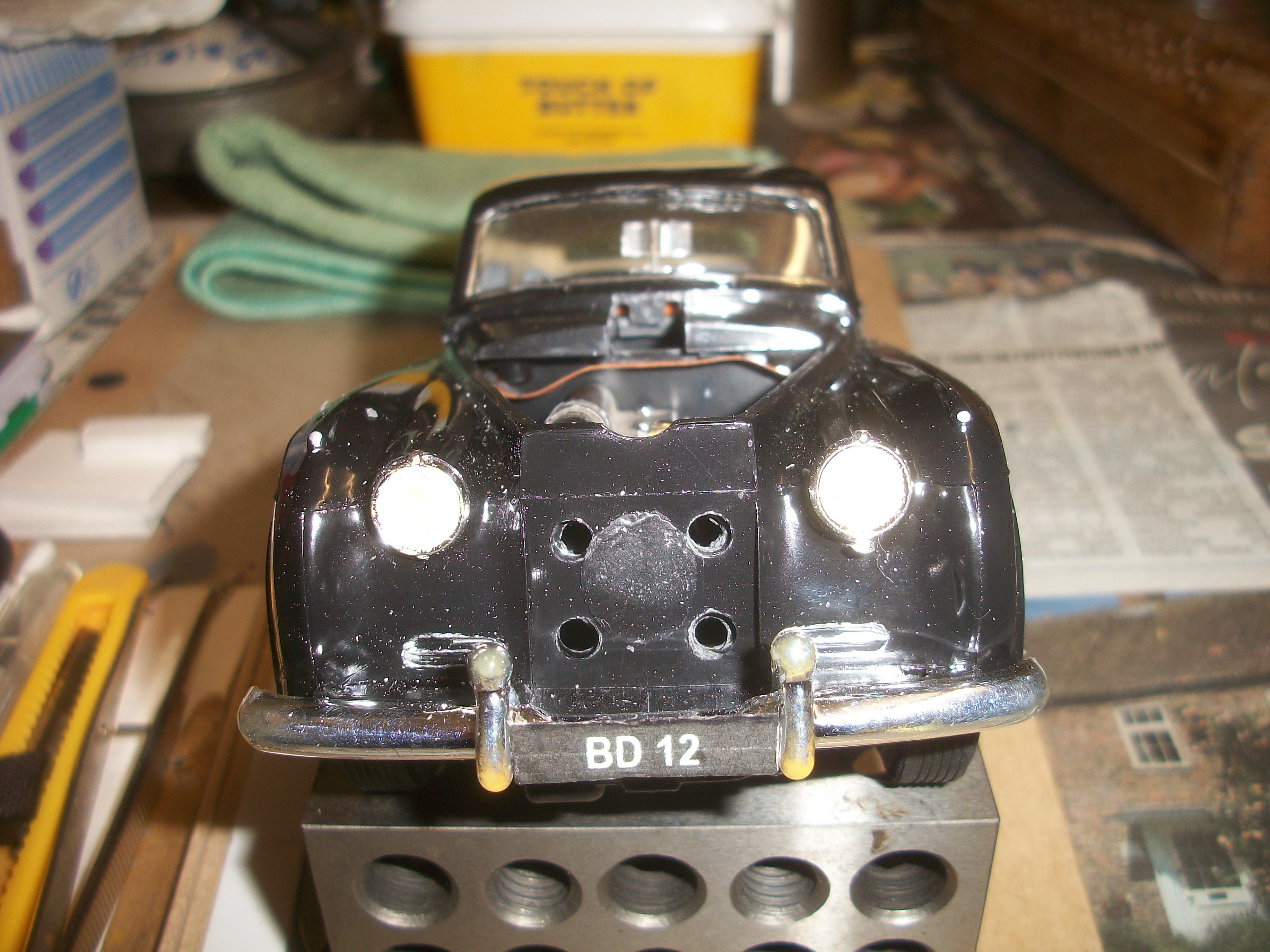

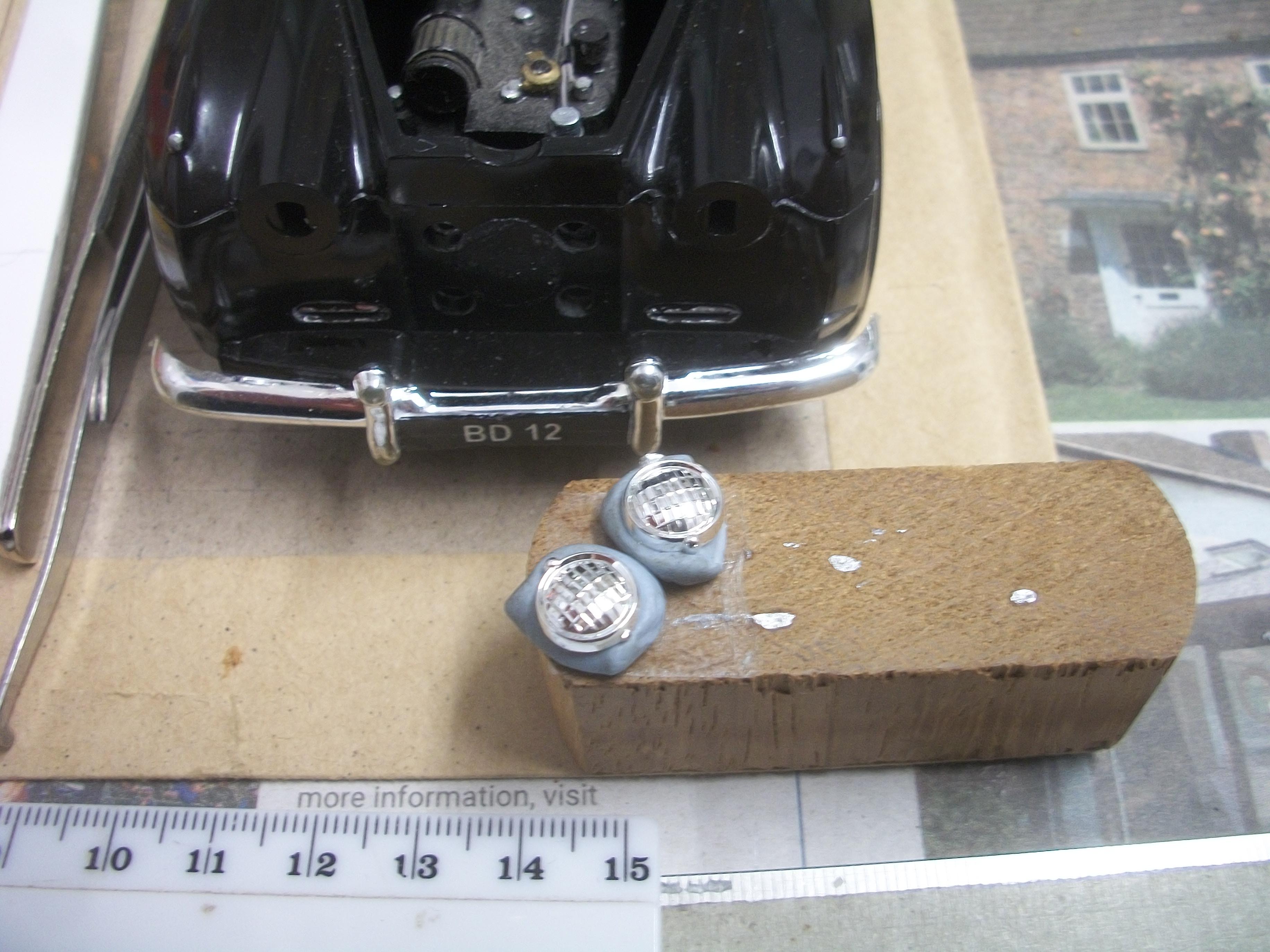

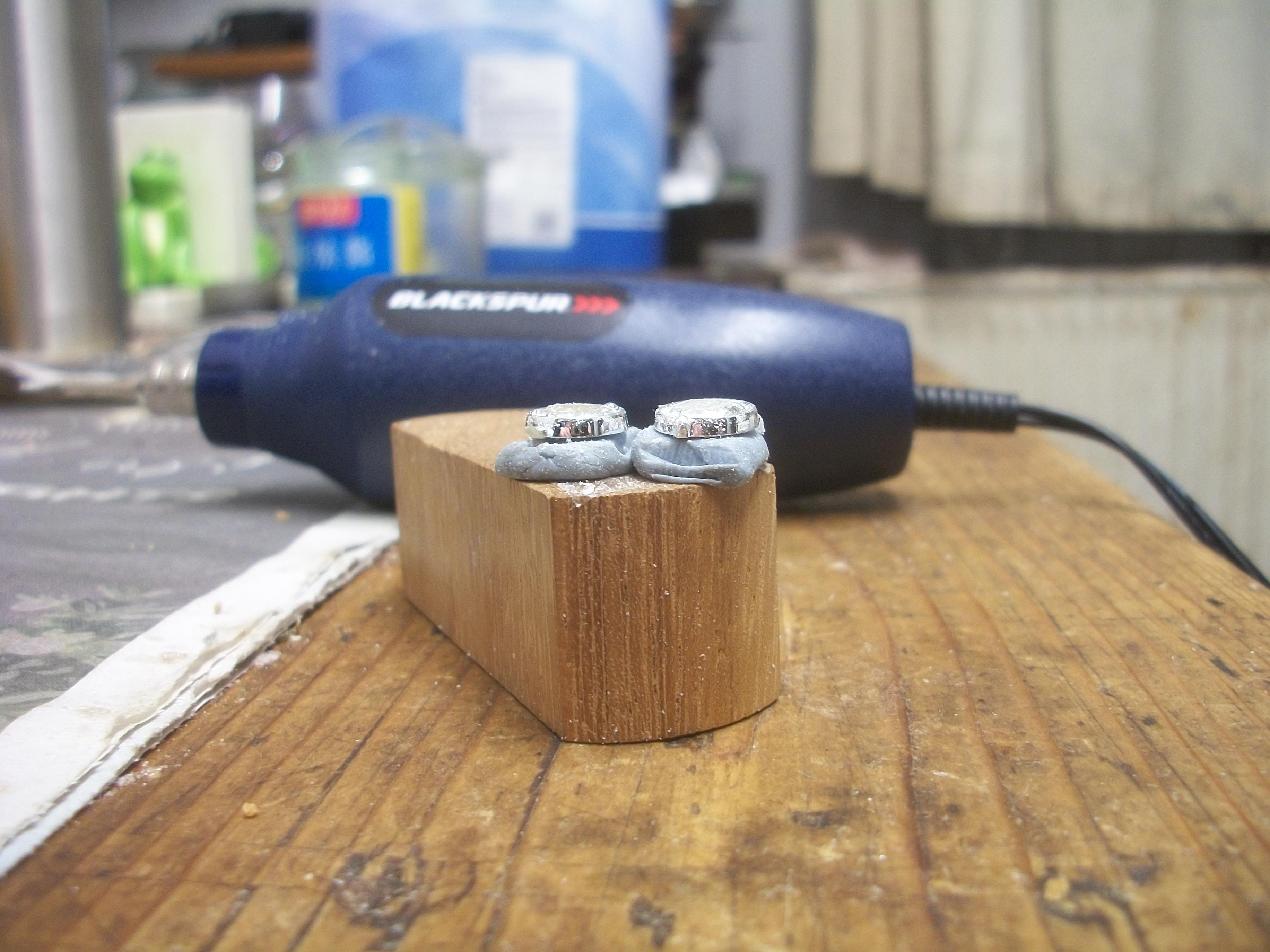

Anglia105E Posted October 17 Author Posted October 17 The kit supplied headlamps for this car have convex lenses, but I tend to prefer the flat lenses, much like you would find on the earlier cars such as the Silver Wraith and the Phantom I, II and III . . . To this end, I have used the mini grinder to remove excess material from the outer lens. Previous builds featured matt white painted headlamp lenses, but now that I have removed the chrome this has revealed clear plastic underneath. I won't be painting these lenses as they look good as they are. The following photos show the lenses before I tidy up the bits of chrome at the outer edges . . . David 1

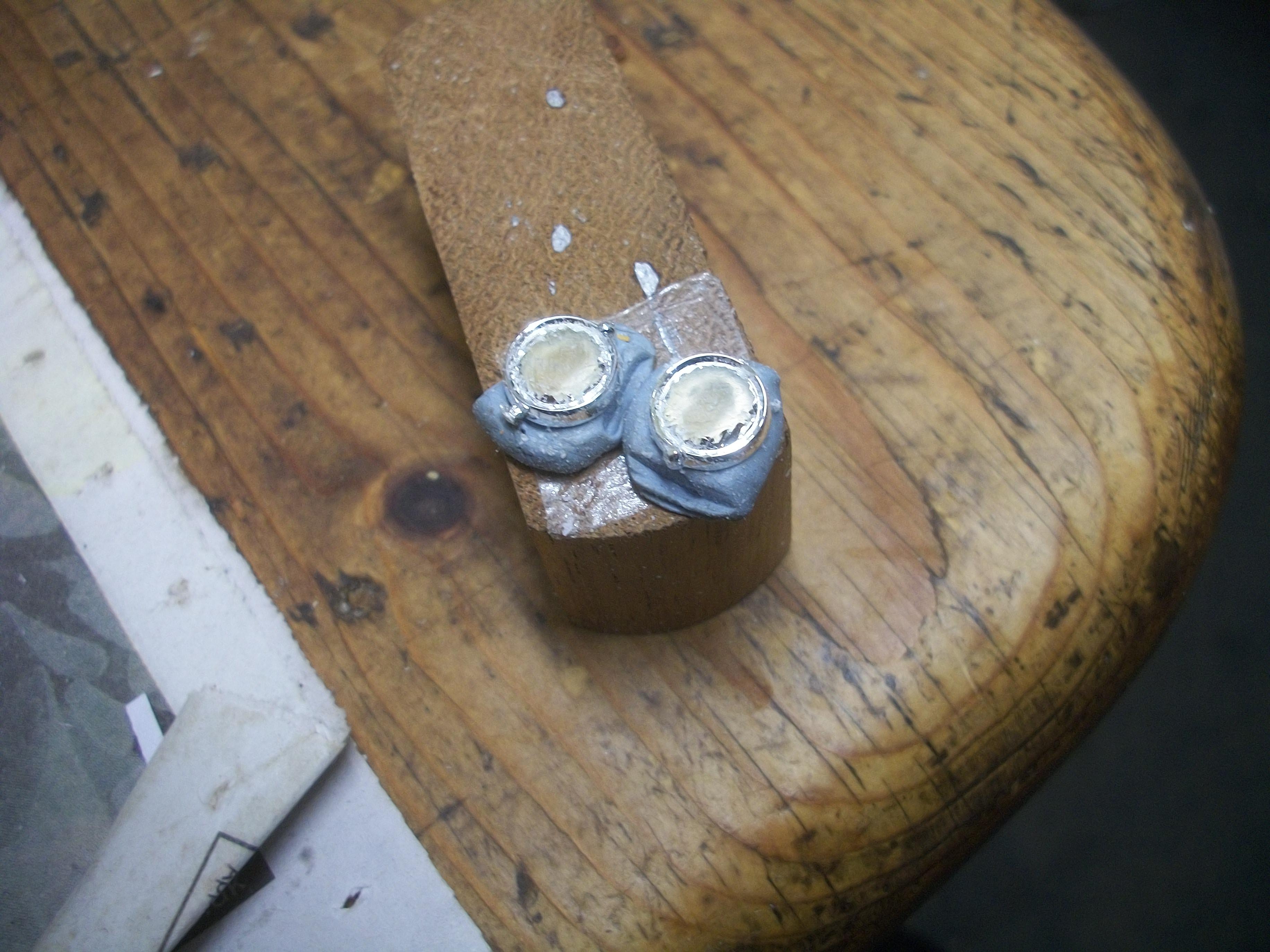

Anglia105E Posted October 19 Author Posted October 19 Last night I prepared the two front fog lamps . . . The two square mounting holes needed enlarging slightly, so that the two lamps could be inserted tightly. Later, the chrome will be removed from the fog lamp lenses and then yellow Sharpie will be applied . . . Some of the real cars had yellow lenses, while others had clear lenses with yellow bulbs inside the fog lamps. David

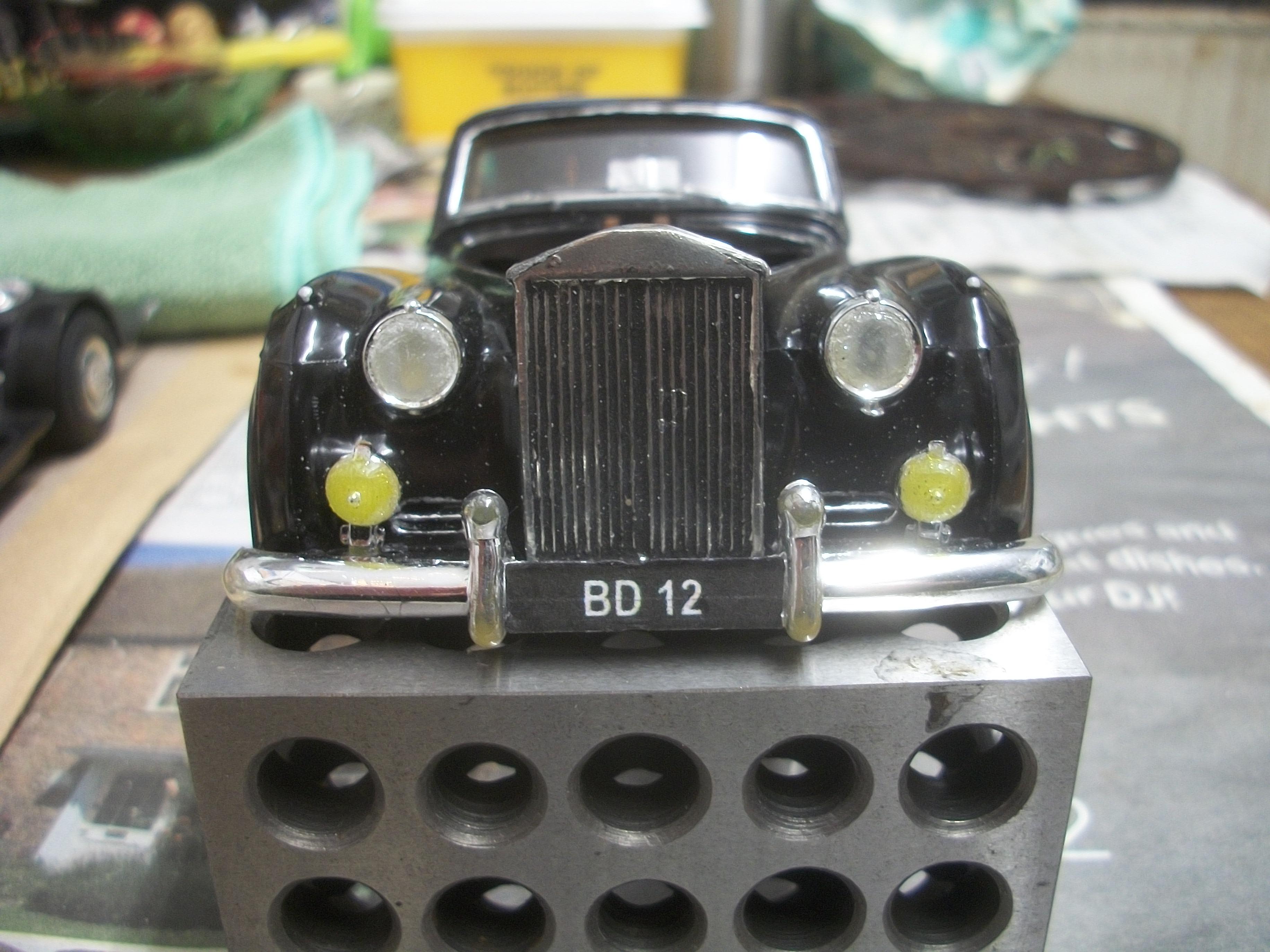

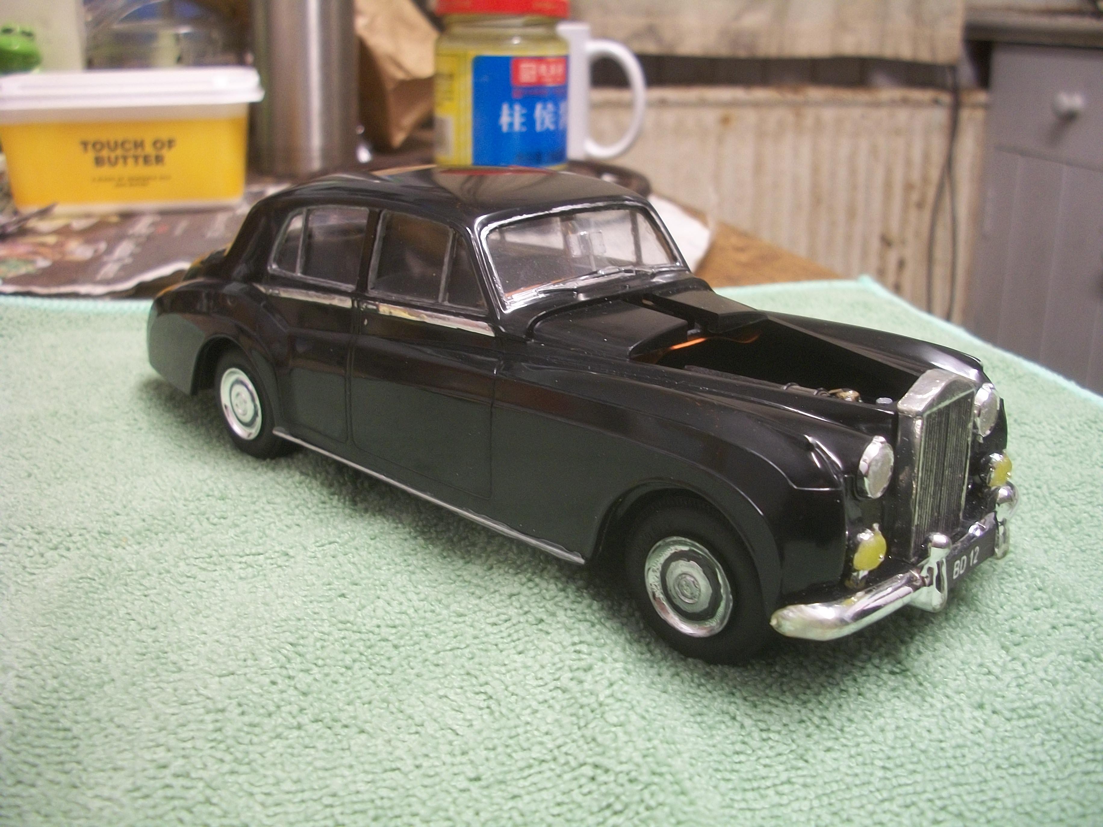

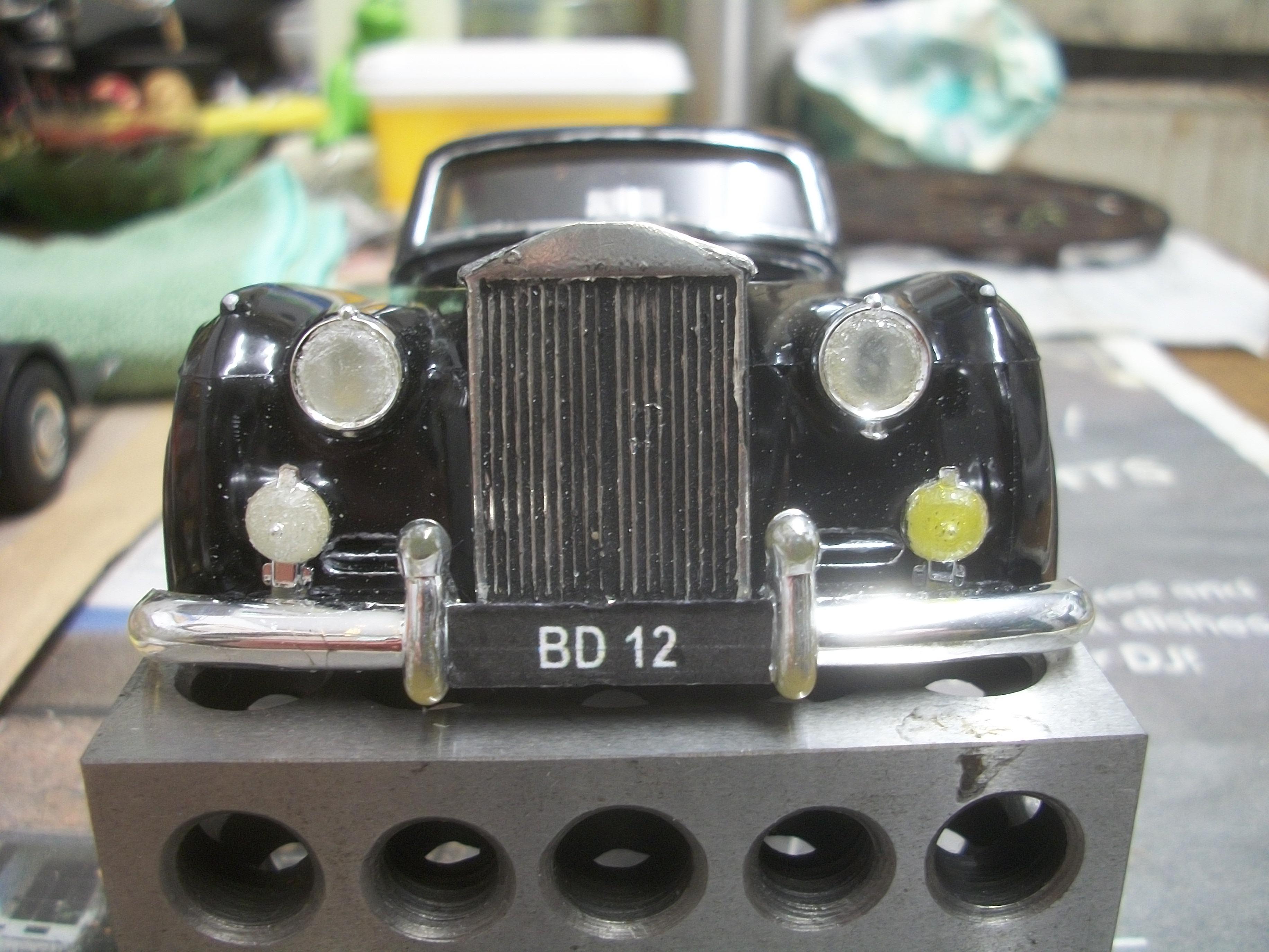

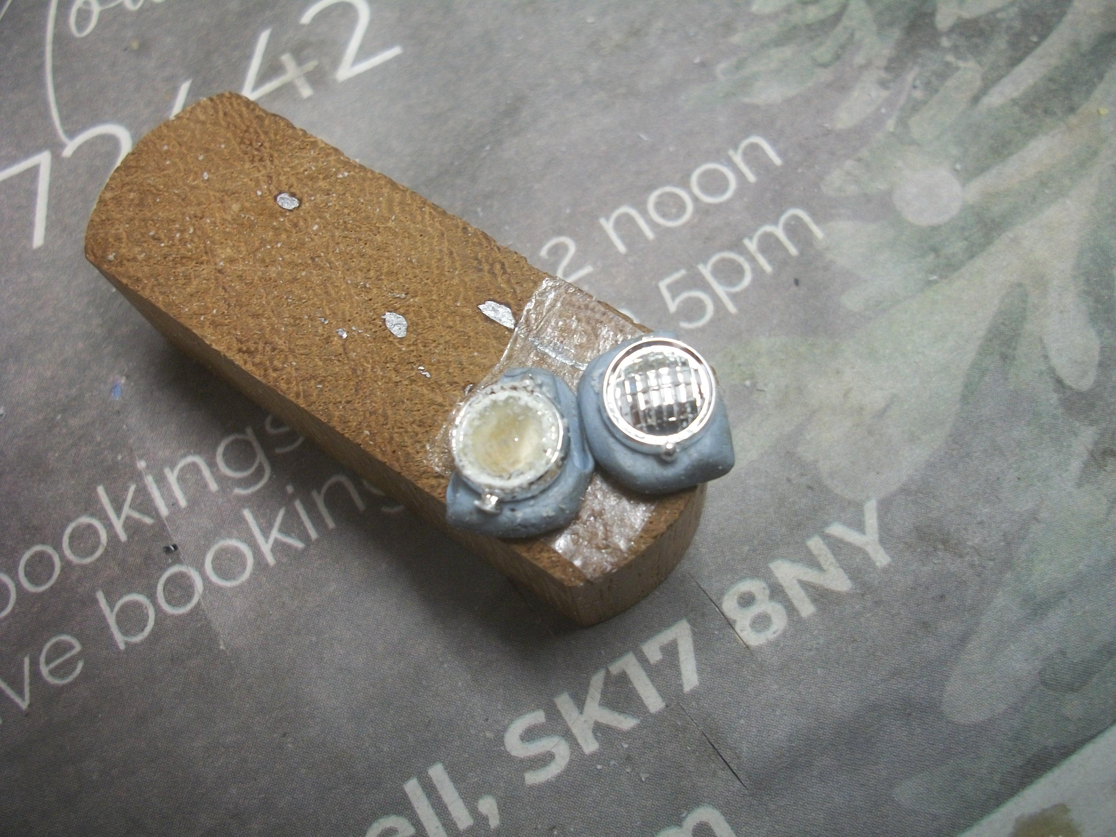

Anglia105E Posted October 19 Author Posted October 19 Today I managed to remove the chrome from the fog lamp lenses, this time using the tip of a sharp knife rather than the mini grinder. This is partly due to the small size of these lamps and also because there is a tiny dot of chrome that needs to be visible in the very centre of each lens. Once mounted onto the body, I coated the lenses with yellow Sharpie, which is precisely the correct shade of yellow as it happens. I forgot to mention previously that these fog lamps were set up to flash as direction indicators when the Silver Cloud was turning right or left. David 2
johnyrotten Posted October 19 Posted October 19 45 minutes ago, Anglia105E said: Today I managed to remove the chrome from the fog lamp lenses, this time using the tip of a sharp knife rather than the mini grinder. This is partly due to the small size of these lamps and also because there is a tiny dot of chrome that needs to be visible in the very centre of each lens. Once mounted onto the body, I coated the lenses with yellow Sharpie, which is precisely the correct shade of yellow as it happens. I forgot to mention previously that these fog lamps were set up to flash as direction indicators when the Silver Cloud was turning right or left. David This all looks really good David. The more realistic the headlights look really adds to any model. Those have just the right translucency. Nice work.
Anglia105E Posted October 19 Author Posted October 19 20 minutes ago, johnyrotten said: This all looks really good David. The more realistic the headlights look really adds to any model. Those have just the right translucency. Nice work. Thanks John . . . I am quite pleased with both the headlamps and the fog lamps. The front of the car is slowly taking shape. David

Anglia105E Posted October 21 Author Posted October 21 Turning my attention to the radiator grill shell, I found the courage to mount the Spirit of Ecstasy. First a hole was drilled in the centre of the shell and then a tiny piece of cotton bud stalk was super glued in place. The base of the original part had broken off, so I super glued the grille mascot onto the fabricated base part. Here are two photos of the grille shell. David 1
Anglia105E Posted October 22 Author Posted October 22 Today I had an idea, which I hope will work. Placing a small piece of orange tape over the RR logo on a second radiator shell, I have cut out the rectangle precisely. The radiator shell for the actual model has no RR logo. Then I removed the tape from the second part and placed this onto the actual part. Liquid Chrome has been applied to the base of the mascot and also to the open area of the orange tape. This will be allowed 24 hours to dry fully. When the tape is removed later I hope to see a raised area of rectangular chrome. David 1
