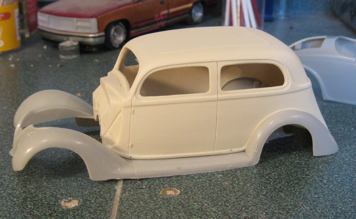

Can-Con Posted August 25 Posted August 25 (edited) I'v decided this will be my next project. AMT kit with a Flintstone resin body and 3-D printed artilery wheels. Haven't decided on very dark blue or a dark orange yet. Not even sure on the engine either but it'll be a Ford engine. either a flathead or 302. Edited August 25 by Can-Con 9

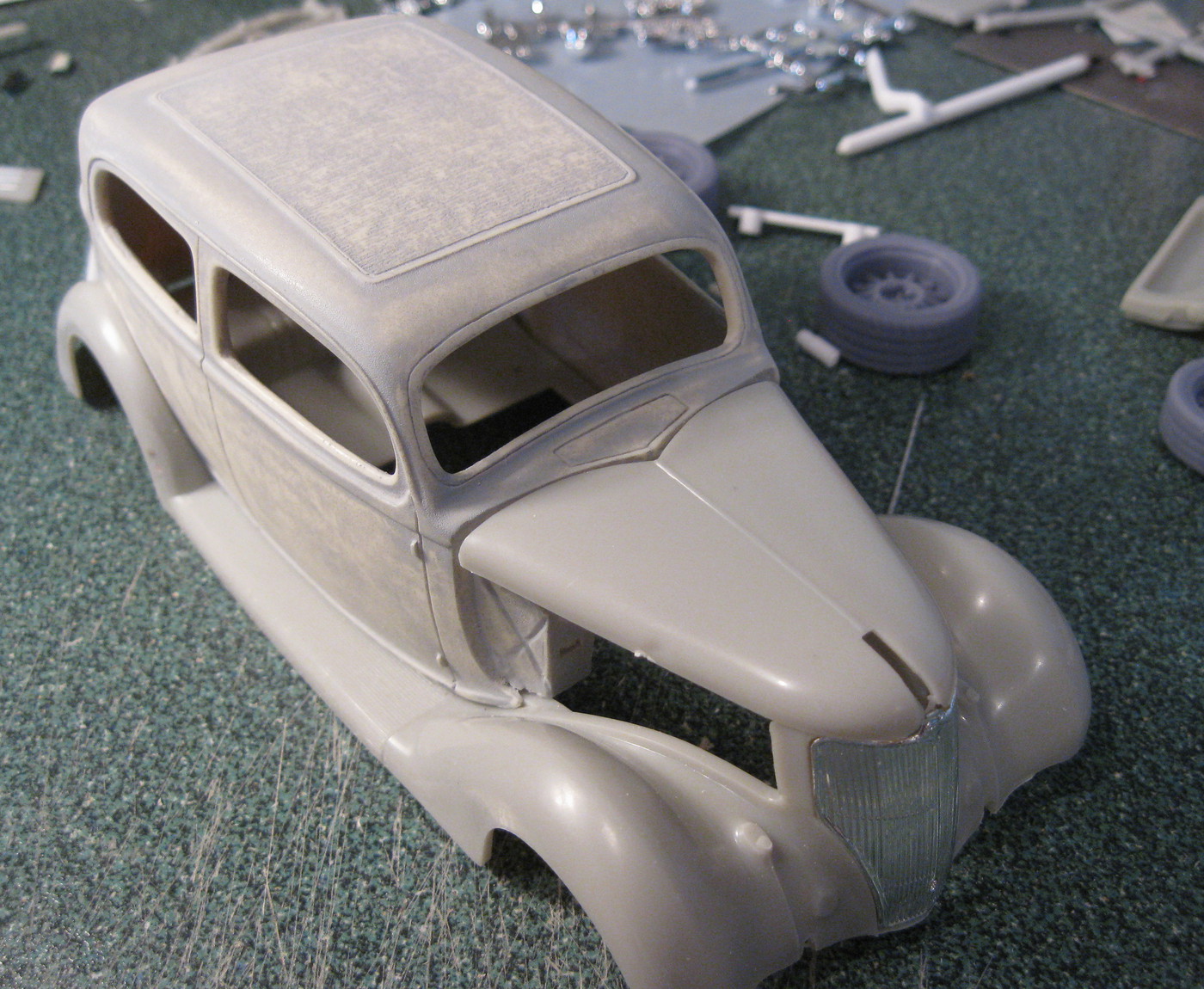

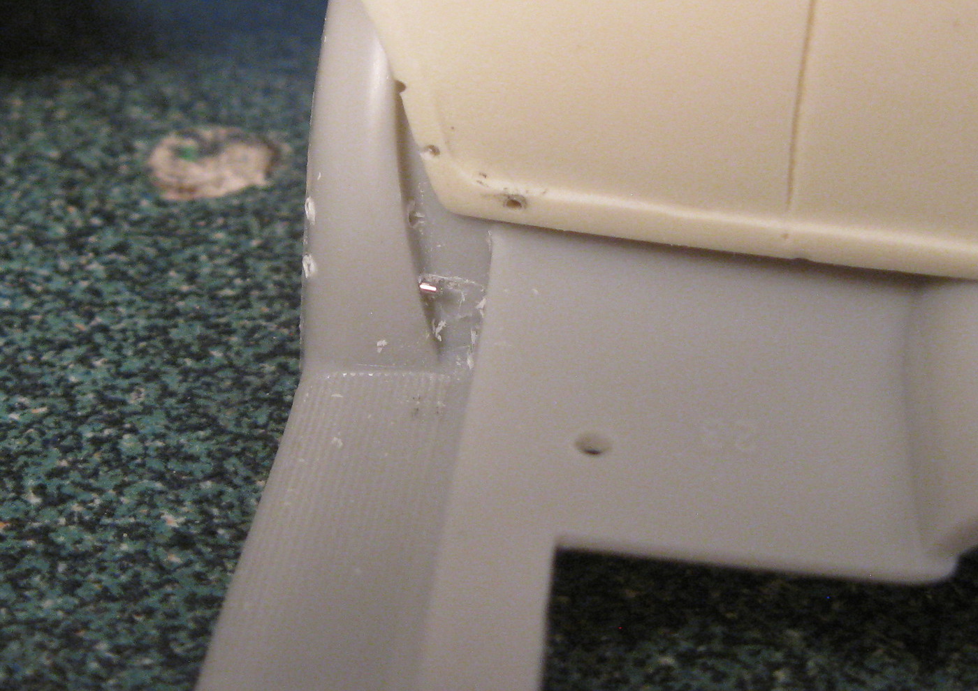

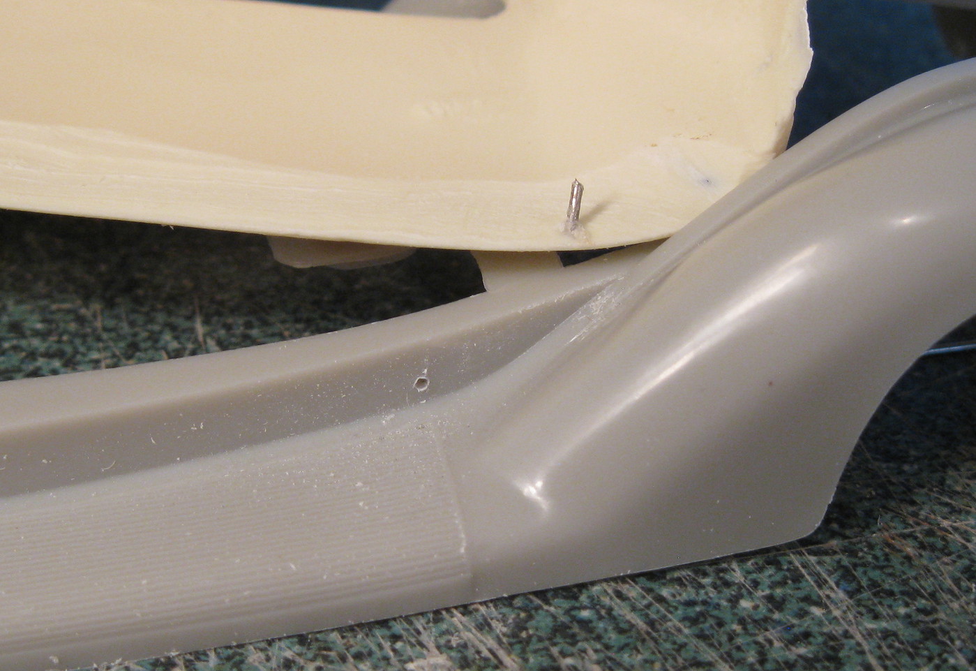

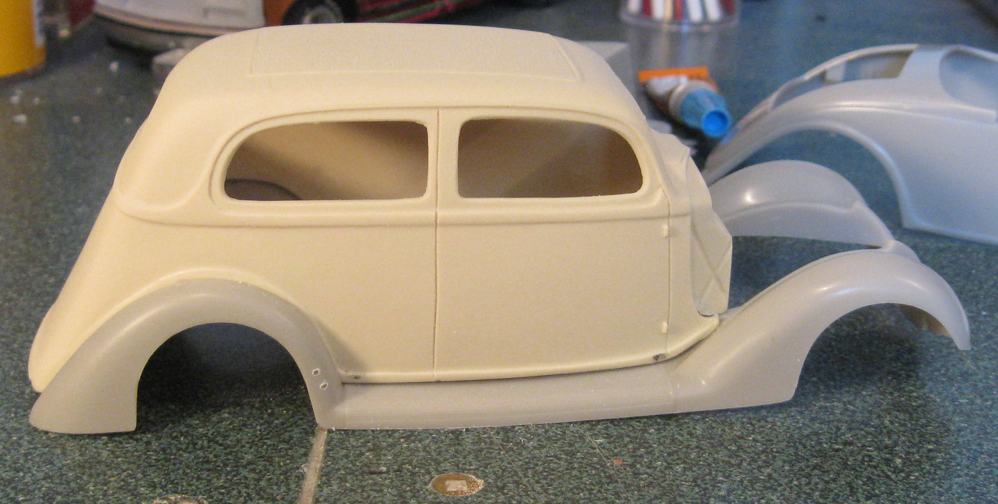

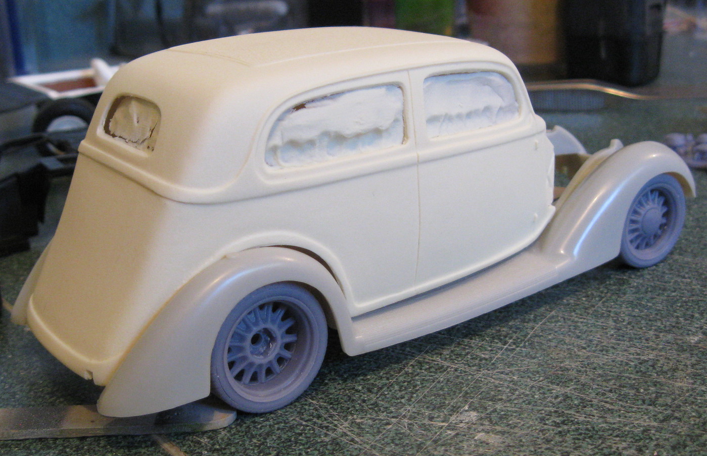

Can-Con Posted September 14 Author Posted September 14 .I did some cleanup on the body around the window openings. The body is quite thick and uneven so it'll take more work. I also pinned the body/fender assembly. held the body in place. drilled some holes and put lengths cut from strait pins in. glued the pins to the fenders in back and body in front. Now the body will stay put and I can easily pit them and take them apart during assembly 3

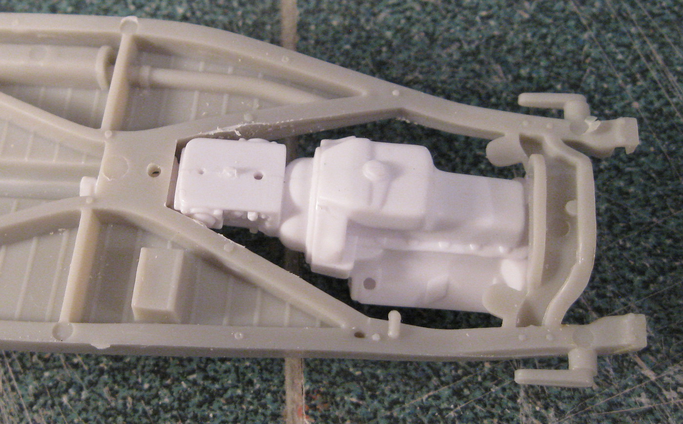

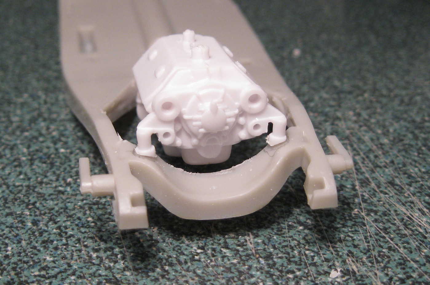

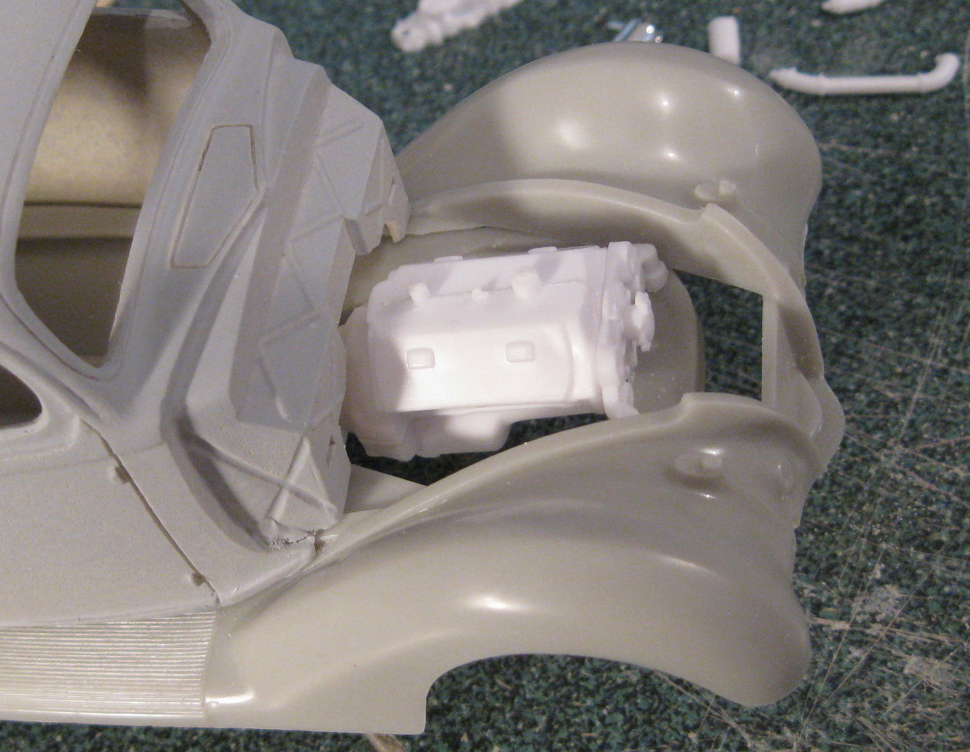

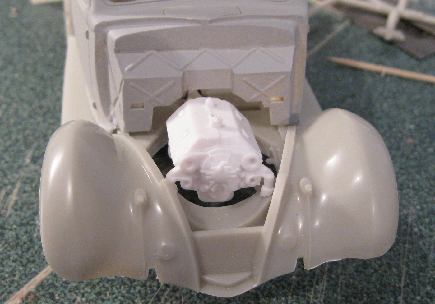

Can-Con Posted September 22 Author Posted September 22 Decided to use the tri-carb flathead from the Revell '32 sedan. fit in with minor mods, kinda surprised it was so easy actually. Only mod I had to do to the engine was file down the attached motor mounts. On the frame I cut out the small tranny mount and engine mounts and added pins that will go into holes drilled in the mounts on the engine. Pretty simple swap. 4 1
stavanzer Posted September 22 Posted September 22 That engine mount looks very clean. I am surprised how you have gotten the body to fit. It looks reat now. Where did you get the Wheels? I'd like to get a set of 'em.... Thanks. 1

Can-Con Posted September 22 Author Posted September 22 7 minutes ago, stavanzer said: That engine mount looks very clean. I am surprised how you have gotten the body to fit. It looks reat now. Where did you get the Wheels? I'd like to get a set of 'em.... Thanks. Thanks Alex. It took a lot of grinding. Not done yet, have to radius around the window openings and true them up before I can start paint. My buddy Steve-O printed them for me. I think he bought the file from Z-Force but it may have been another vendor. 1

Glassparman Posted September 23 Posted September 23 I love the body pinning idea. I could have used that recently with a tough build. 1

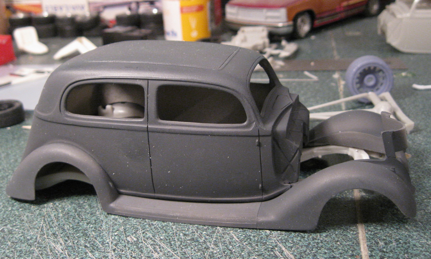

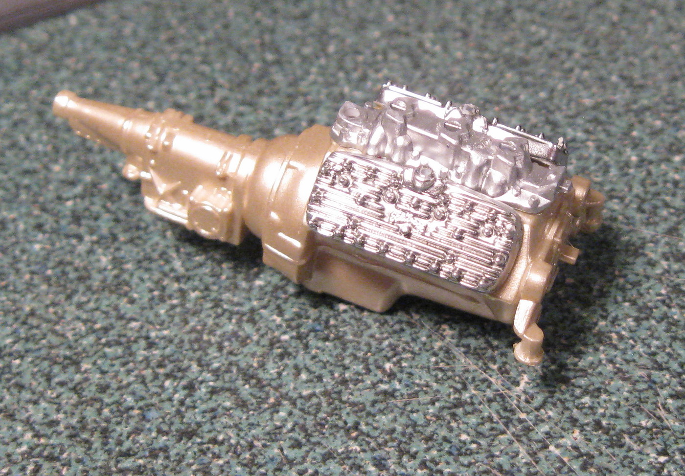

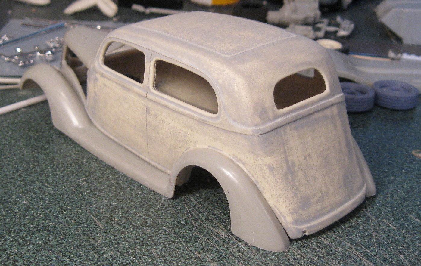

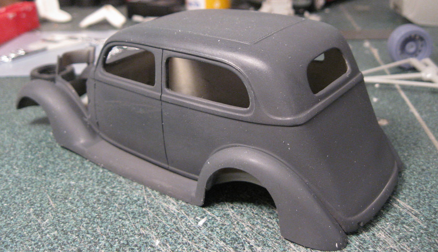

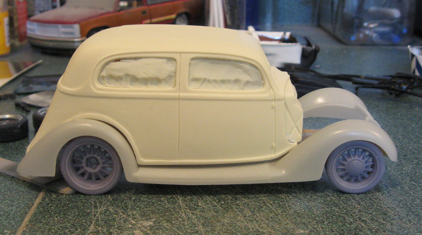

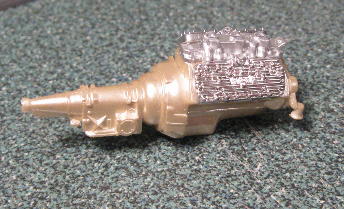

Can-Con Posted October 4 Author Posted October 4 Did some work on the resin body. Primed it and wet sanded it out. You can see it was not exactly smooth with a rough surface and it looks like the master could have used some more sanding itself before casting. Looks like it was meant to be used with the older 3 window coupe/roadster versions of the kit but I'm using one of the 5 window kits so I'll have to re-work the hood to better match up with the body. Also did a lot of contour work around the window openings so it looks closer to the real car's openings. I think I'm gonna re-scribe the trim around the windshield too as it's not very well done. Started on the engine from the Revell '32 sedan kit. Did a thin wash on the heads and shot them with some Tamiya semi-gloss clear. 6
