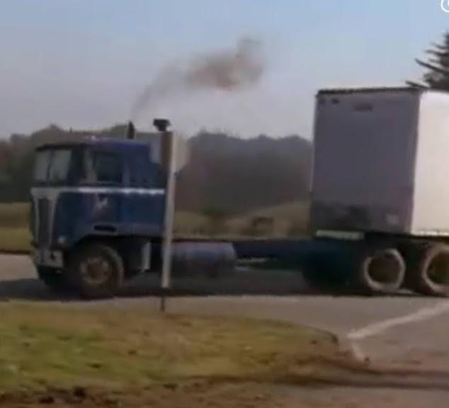

Back to business. I've been curious about the origins of this rig that was in Movin' On. Was it an old dromedary chassis that had the box removed and the company bought for the episode or something else? As poor as the pictures are I couldn't really see any evidence of it carrying a body or platform of any sort and they certainly hadn't spent money on painting the thing! The fifth wheel was also in the normal position over the drives, not set back as in most droms, and it had a normal pogo stick.

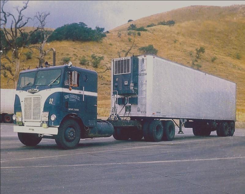

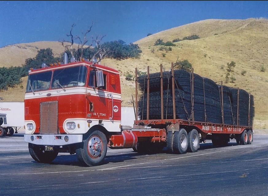

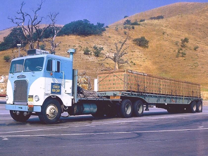

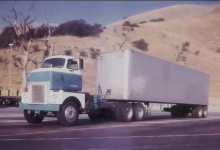

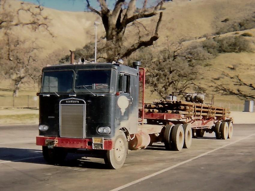

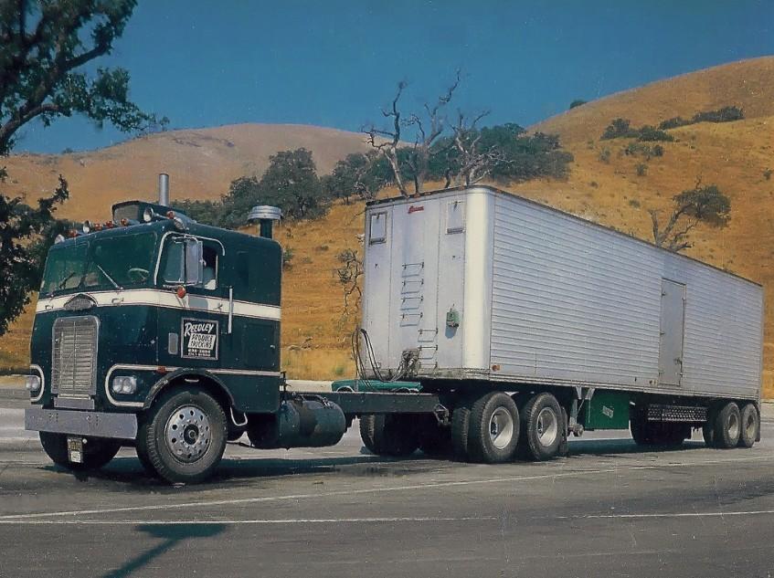

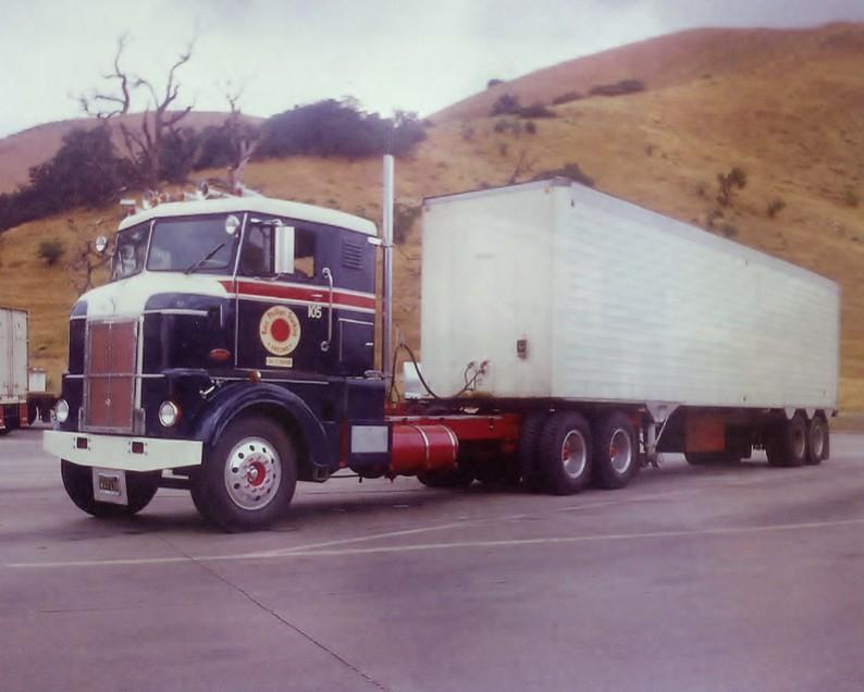

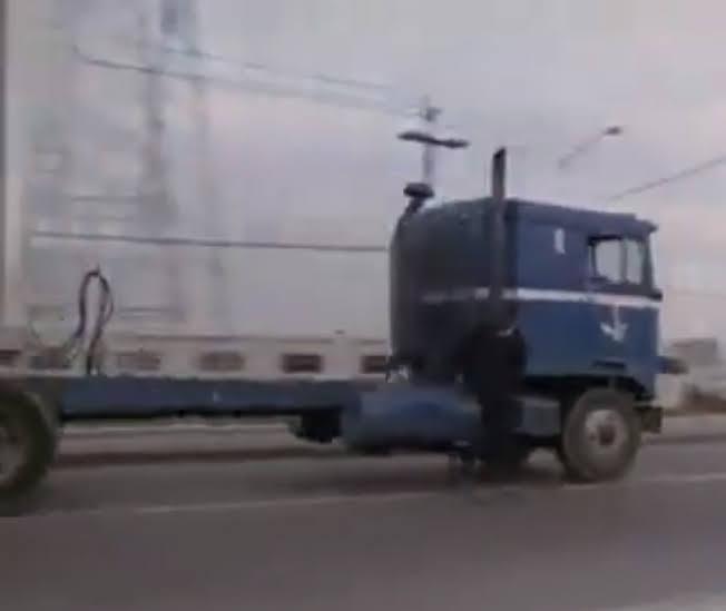

Then I saw another picture of a very similar length tractor on interwebs which took me to a Curbside Classics article that shed new light on the subject. These were insanely long chassis used to exploit the bridge laws in California. Although the federal bridge laws applied by then, each state was free to employ it's own existing bridge laws within state boundaries if that gave a weight advantage to trucks within the state. In California, if the front axle was a certain distance away from the drives, more weight was permitted.
That IH is so ugly it's beautiful!
I don't know what either of those two figures were but if you look at the photos they're all a very similar length, which shows that they were each building to a specific number. Some companies have elected to use the extra space for a dromedary setup (which changed the category of the truck and permitted even more weight) but not all. (Question still unanswered: why not just build a conventional? I can only think of unladen weight but not certain.)
All that suggests strongly to me that the K100 in Movin' On is one of these "California specials". To add weight to that the episode was filmed around San Francisco apparently so that puts it in its home state.

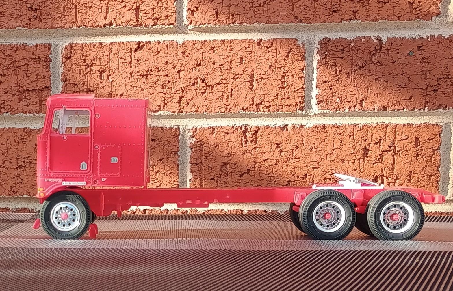

These things are just so American I've got to do my own. I've got a K100 Aerodyne that I got for £10 a while ago and a spare T600 chassis with the Reyco spring suspension which would be more fitting than the KW 8 bag on the Aerodyne. That will also help with the stretch.
I'm trying to establish a frame length. Looking at the photo of the blue KW it appears to be 4 cab lengths and, judging on the cab being an 82 inch sleeper, that gives me 328 inches. In scale that's 10 and a quarter. I'm not far off but I think a bit more is needed.

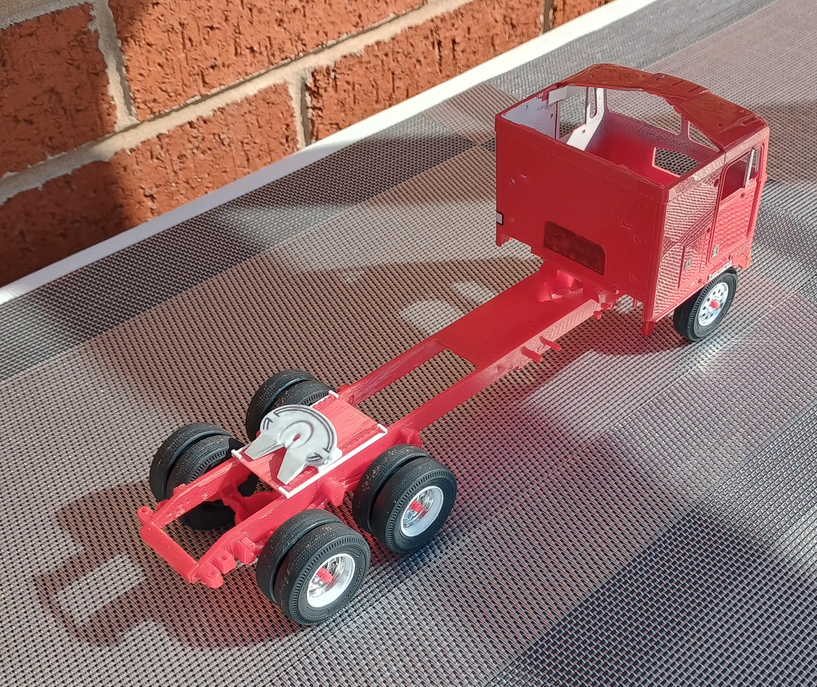

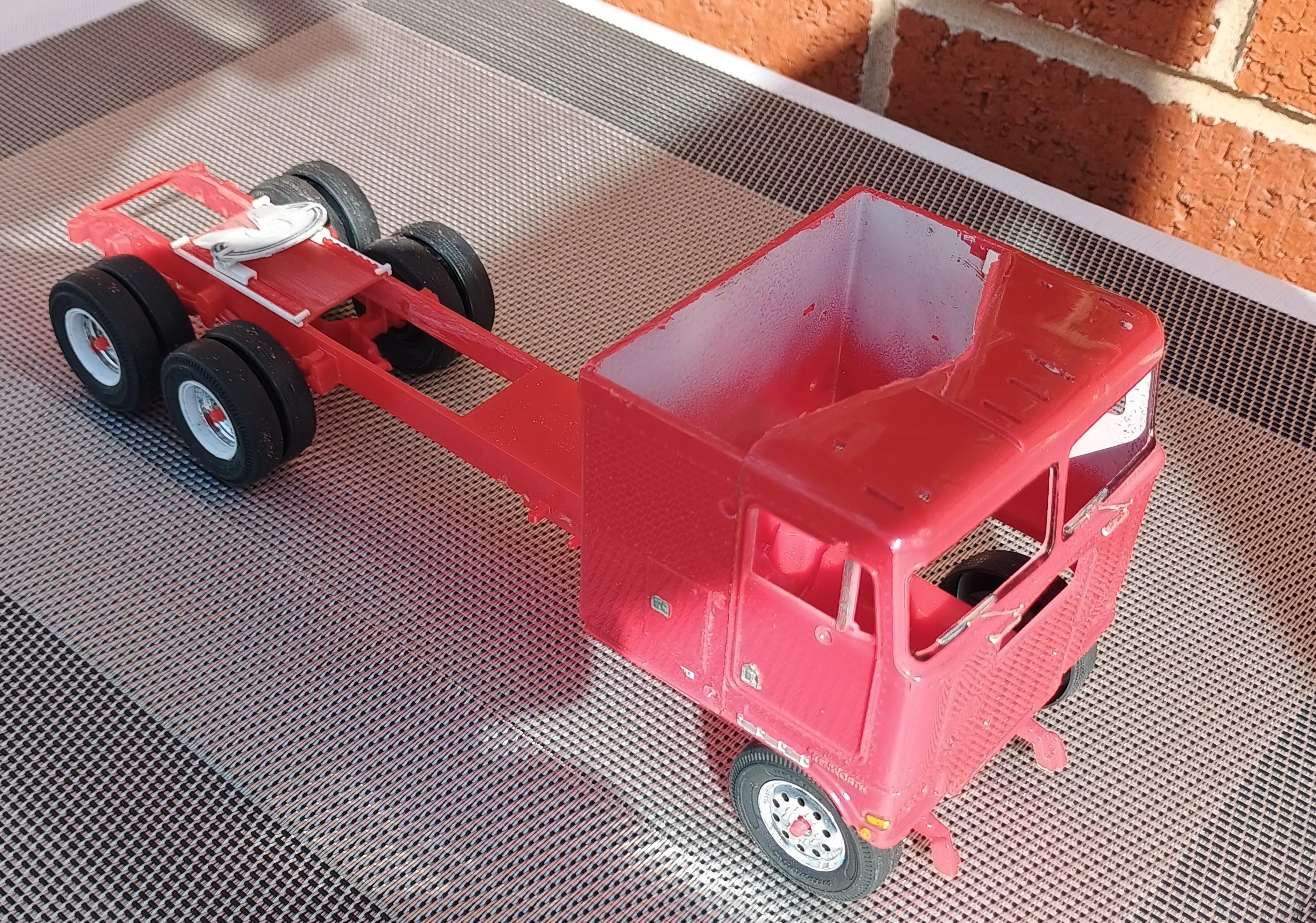

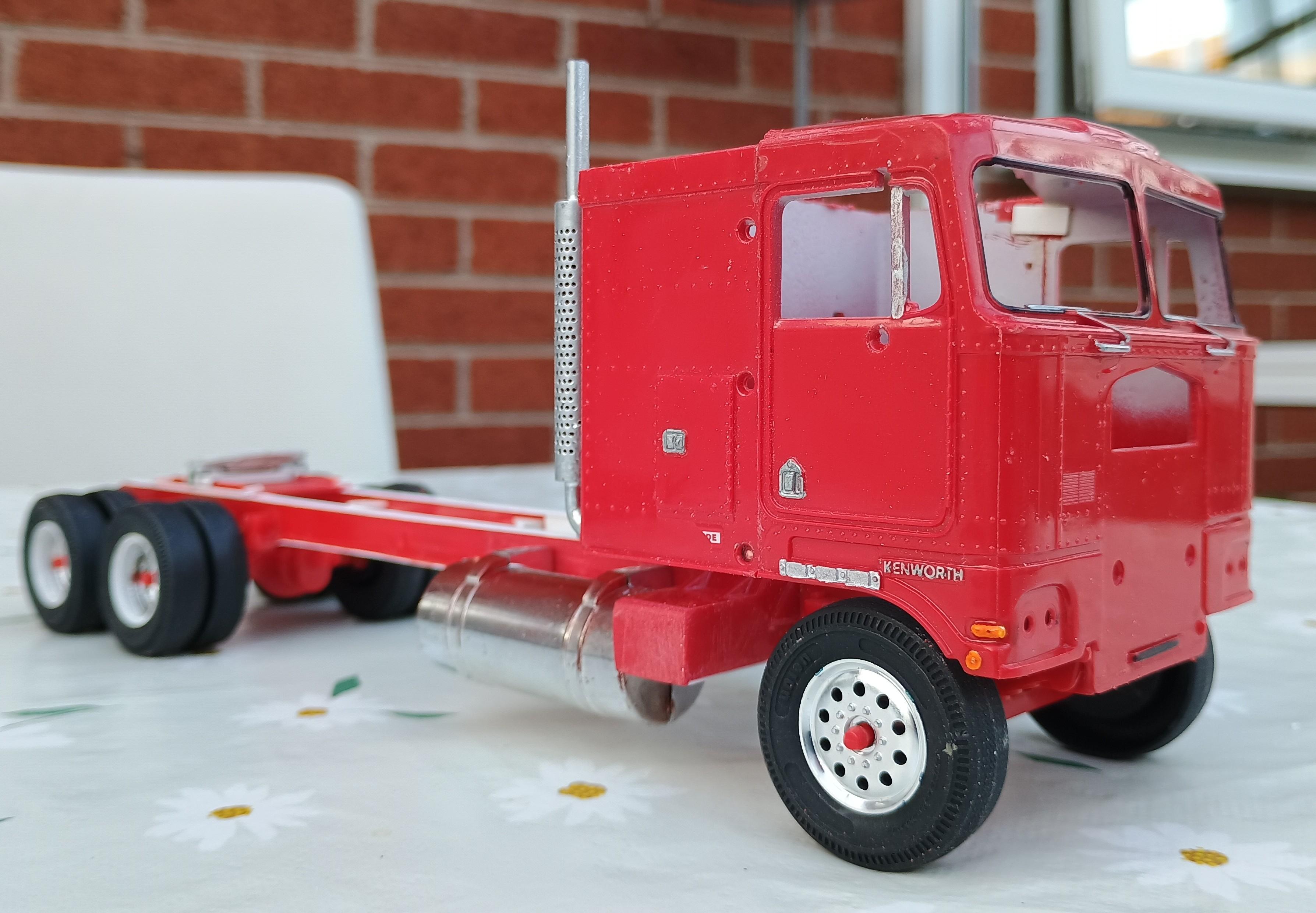

So far I've decapped the cab, cut it down to a single sleeper. Adjusted the rear wheel rims, built a Holland fifth wheel and made the slider functional. It's going to be a 'no front brakes ' rig because I think these would have been. It was thought to reduce the likelihood of a jack-knife.

Stole half an hour last night chop the T600 frame and splice in the K100 front half. It looked far too long until I put it at a certain angle with a trailer on, then it looked just the right proportions.

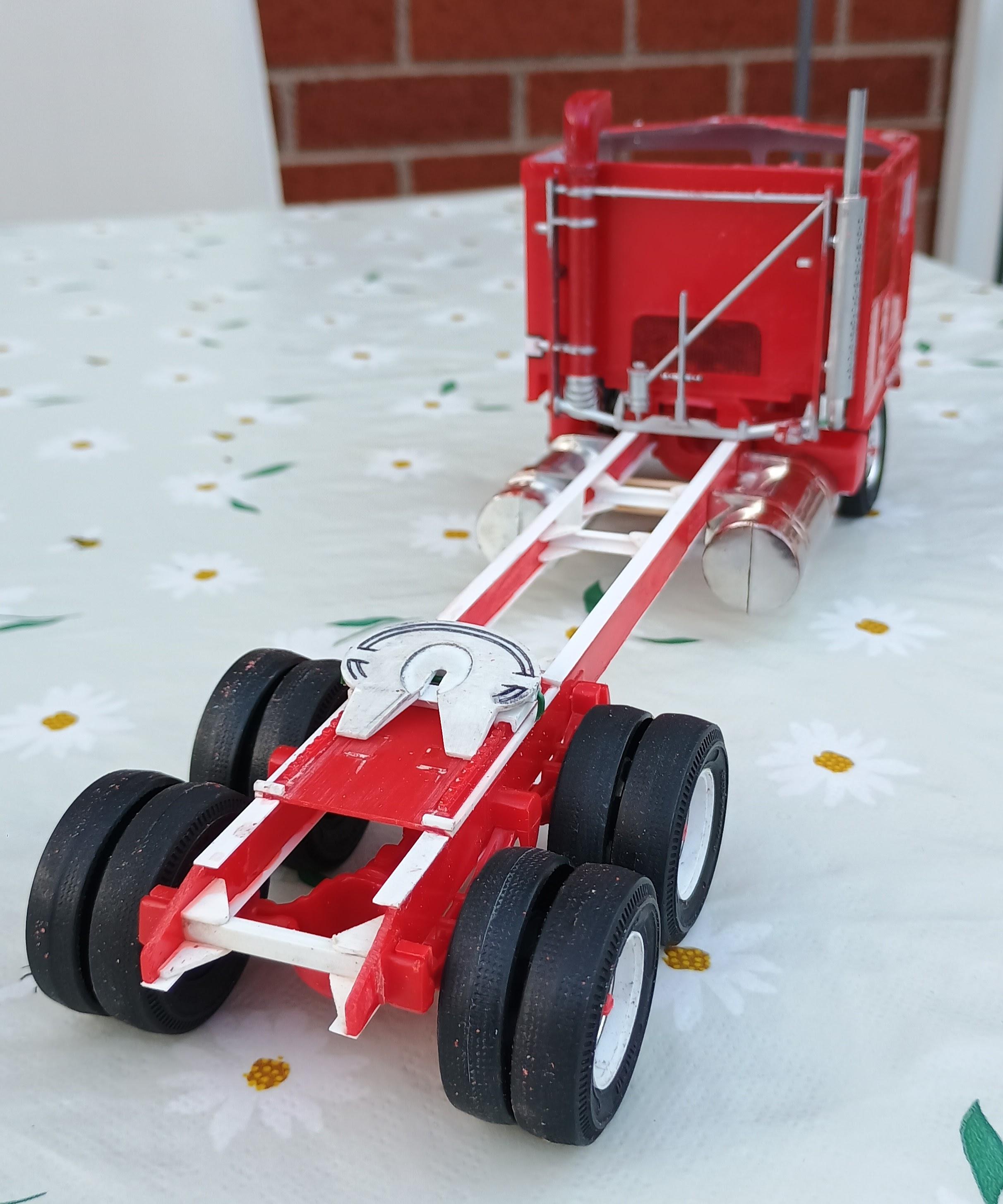

Did some detailing work on the chassis, added crossmembers and top and bottom flanges on the chassis. Makes it look better and makes it stonger to boot.
  • Like 4

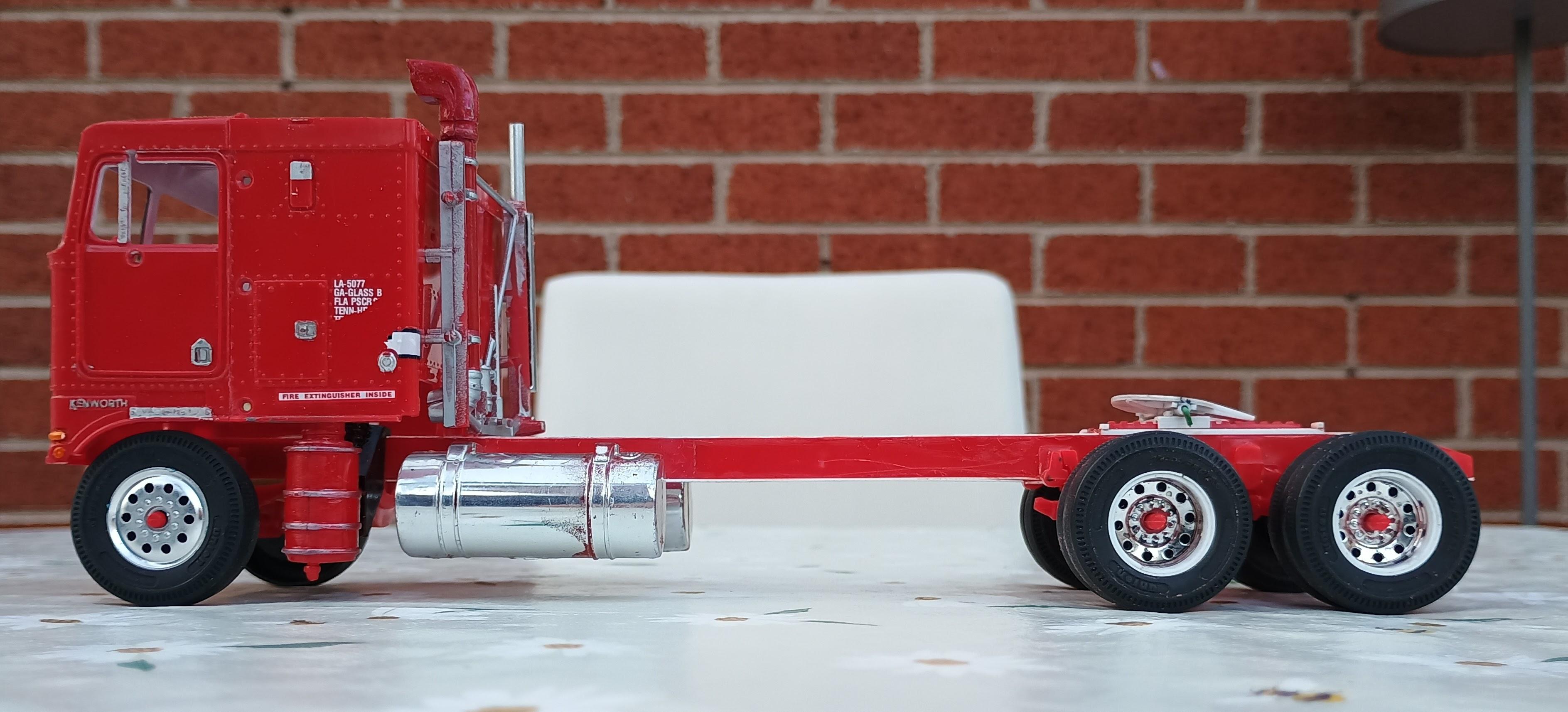

Had a proper session at the bench yesterday. Got my wheels painted so they look like whole units. Cut the transmission out for remodelling.
I only want one exhaust stack so cut the air intake out of the frame and mounted one from a 352 where the second stack was. Then i had to replace the missing support bars with brass tube. The frame for the intake and exhaust clips to the backmof the cab on this kit, so I made brackets and chassis mounted it as per the real thing.
Spent a few hours rounding off some 1mm square rod, slicing it into tiny flakes, dropping them and crawling around on the floor looking for them and gluing them to the chassis as bolt heads. Helps the appearance no end. I wanted the rear of the frame to be left open like i did with Sundance so I made some upright sockets for the mudflap mounts and put my mudflaps on a chunky paperclip. Finally I filled and sanded the frame where there were sink holes etc... and rounded off the top and bottom edges of the frame rails.

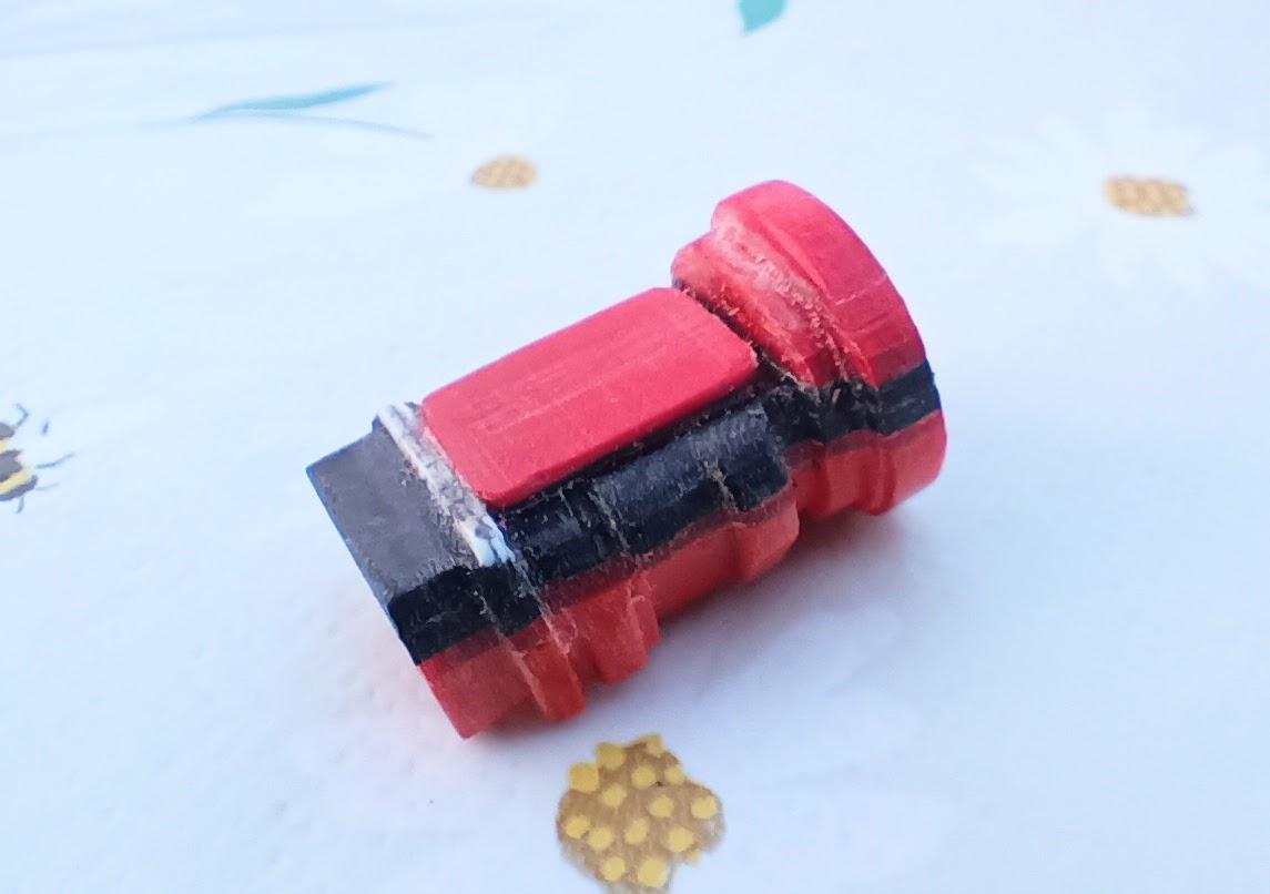

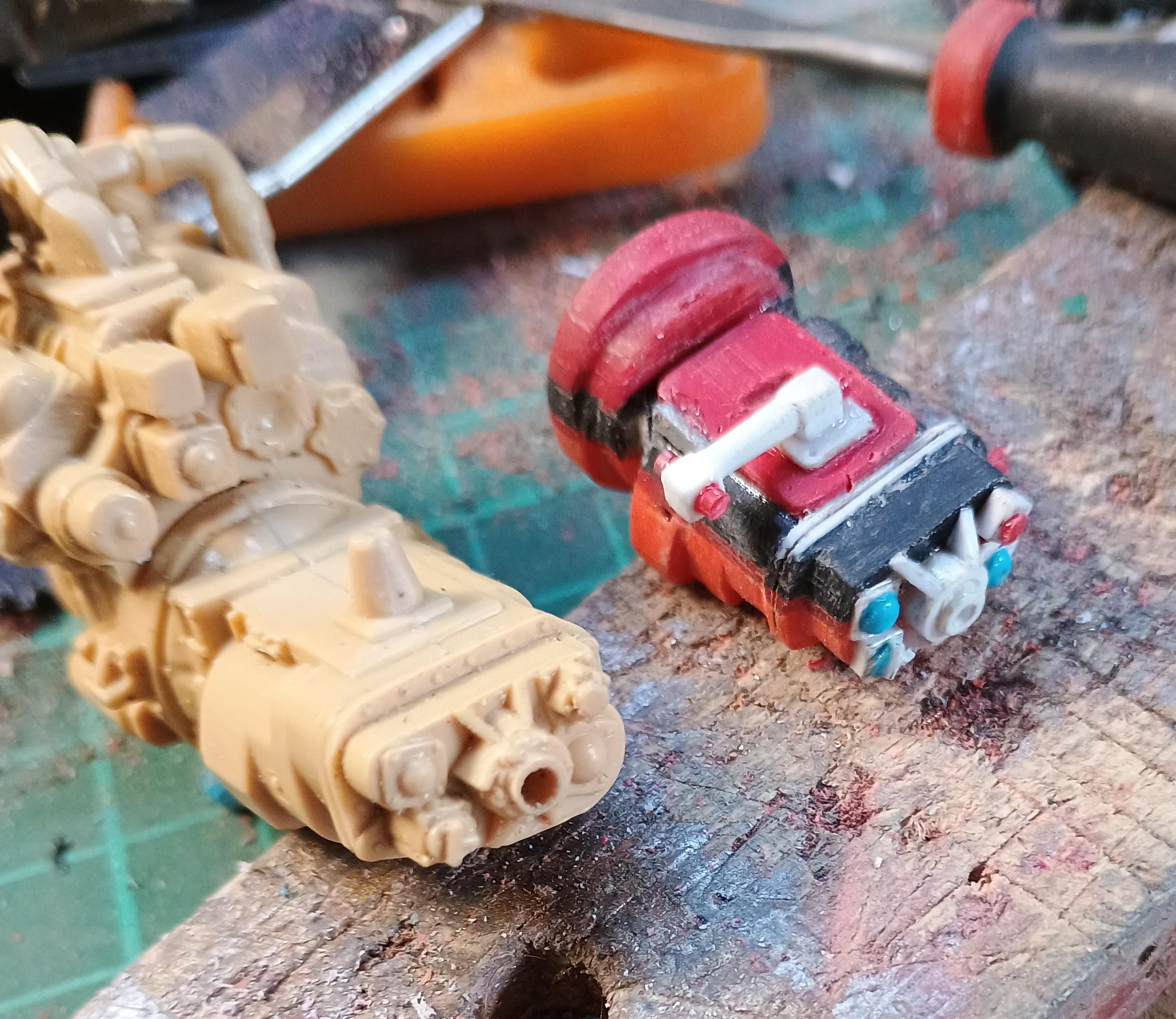

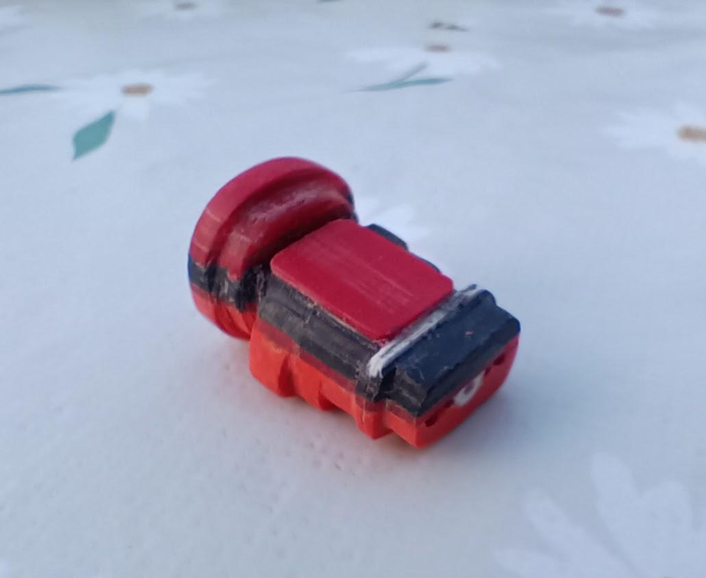

The shortening of the cab exposes what passes for a transmission in these kits, it's just a relief of the lower edge which is ok in the as-built configuration. I wanted a more realistic appearance so cut the kit piece out. I was going to try and use it for this stage but it's so poor that I ditched it and used the one from the Peterbilt 352 Caboverdose. That one isn't brilliant but it is much more in proportion.
I levelled the top surface and then built up layers of offcuts, there's a piece of red chassis and two black mudflaps in the main casing, then a little tower of chassis & cab shrapnel for the bell housing. Bit of filing and shaping, added a top cover and it looks like a Fuller. A few added details to the rear casing, then a selector housing and we're done!
  • Like 3
Wow, Steve … that is true modelling in its purest form.  Awesome work. I have to keep reminding myself this is 1/32 not 1/25. Big difference. You have amazing talents.
  • Like 1

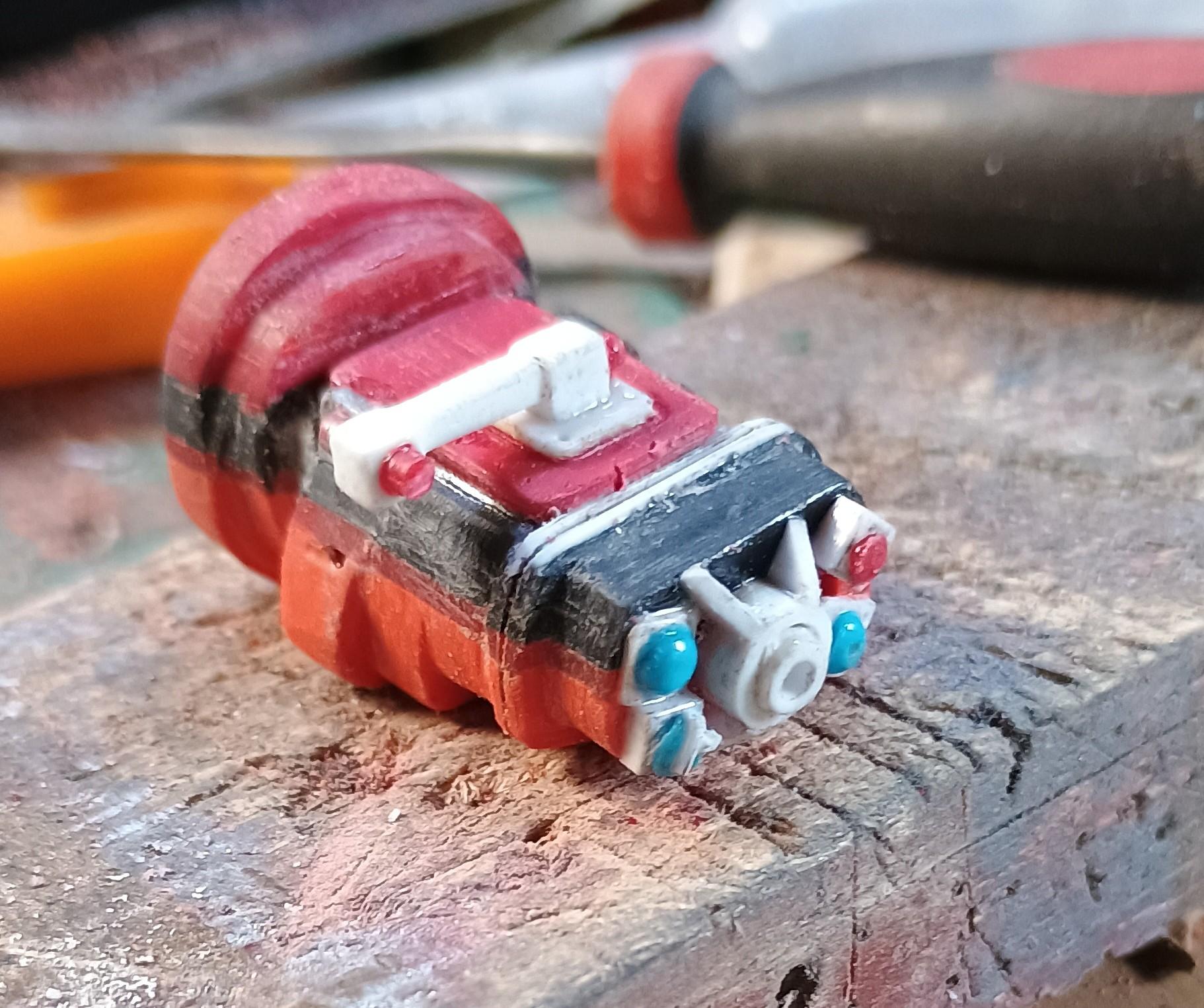

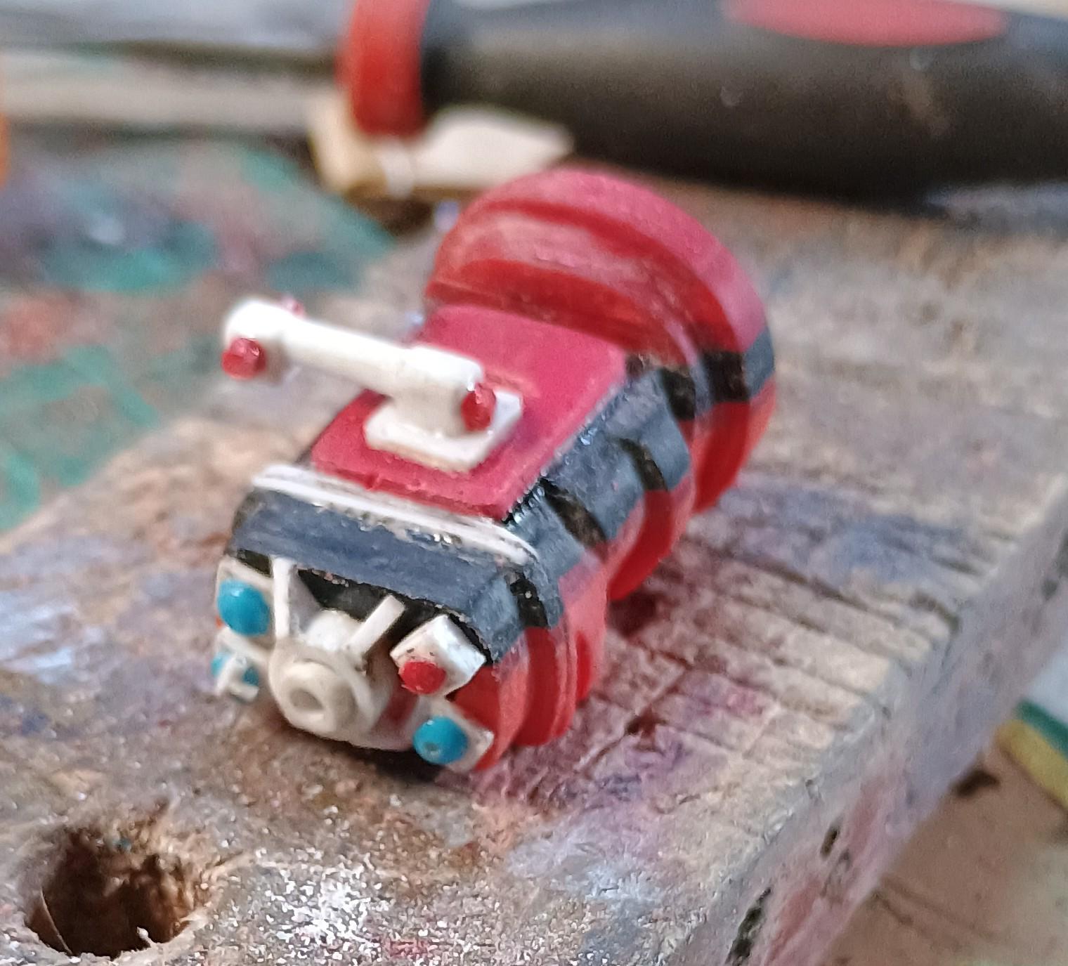

Finished my transmission. Just shaped little bits of plastic shrapnel to form the range-change and splitter cylinders and the remote shift housing. Quite happy with it. Used the one from the LTL9000 and some photos from the interwebs for reference.
