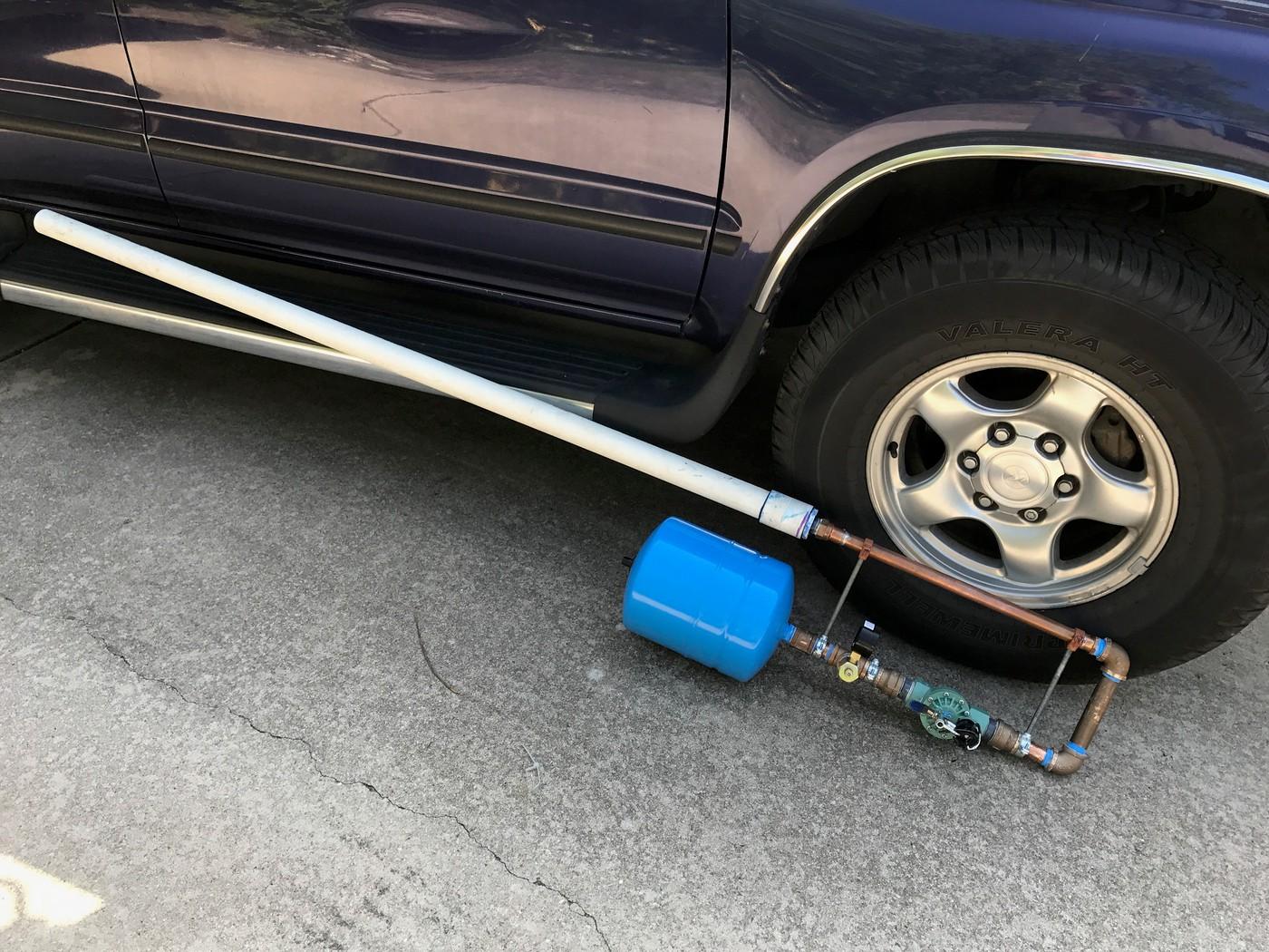

LDO Posted September 6 Author Posted September 6 (edited) This is the bait launcher. Cool for sitting on the ground and slinging frozen liver into a lake. Not so much for launching projectiles made of pipe insulation. It has a pressure gauge so that it can have consistent trajectory. The trigger is a modified sprinkler valve that opens and closes so fast that it uses 35psi from a tank aired up to 60psi. I want the RPG to have everything in a straight line. Better for a toy that looks somewhat like a shoulder fired rocket launcher. Edited September 6 by LDO 1
JollySipper Posted September 6 Posted September 6 That reminds me of the potato launchers that were popular around here for a while! Much cooler as a bait launcher................ The way a lot of them worked involved hairspray and a grill lighter! 1
