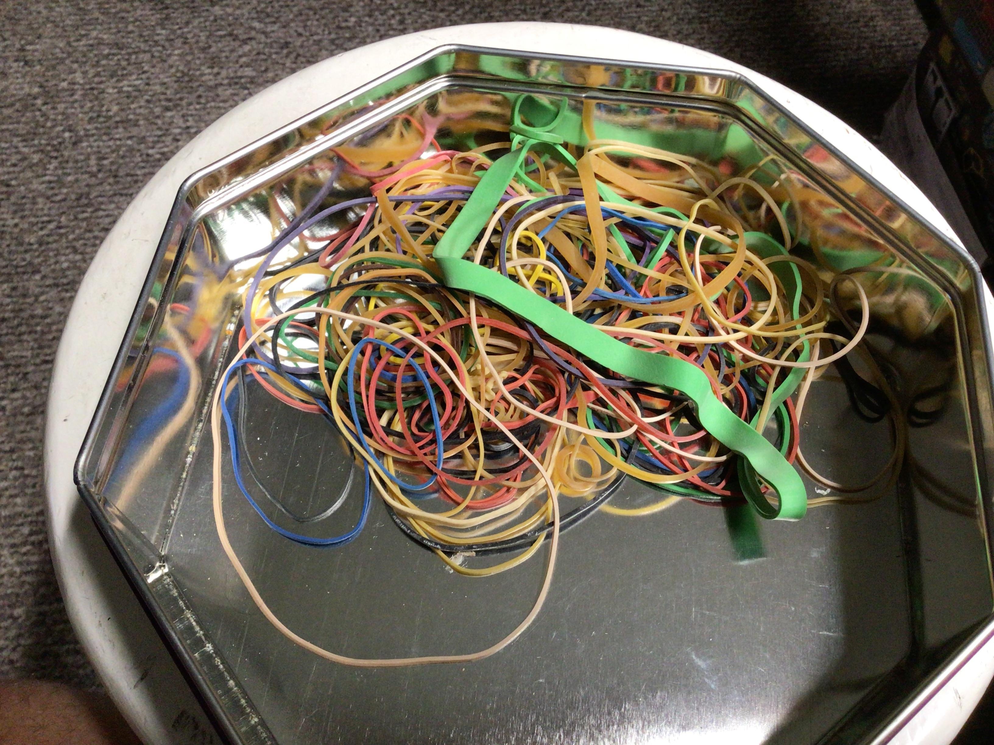

NOBLNG Posted October 16 Author Posted October 16 (edited) On 9/12/2025 at 10:28 AM, mcs1056 said: You must have gotten a Monday morning caliper. Seems like mine was made on a Wednesday, right after lunch. The one I just bought gradually gets worse, being a 16th off by three inches. Definitely clamp material. You will require at least one of these precision constrictor bands to perform the conversion . I believe they are color coded for different clamping pressures…best to invest in the entire set like I did to cover all possible scenarios. A bit of an investment, but well worth it in my opinion.😜 Edit: If anyone is interested…I can do a tutorial on how one of these can be manipulated to double or even triple the original constriction values.🤓 Edited October 16 by NOBLNG 1 2
