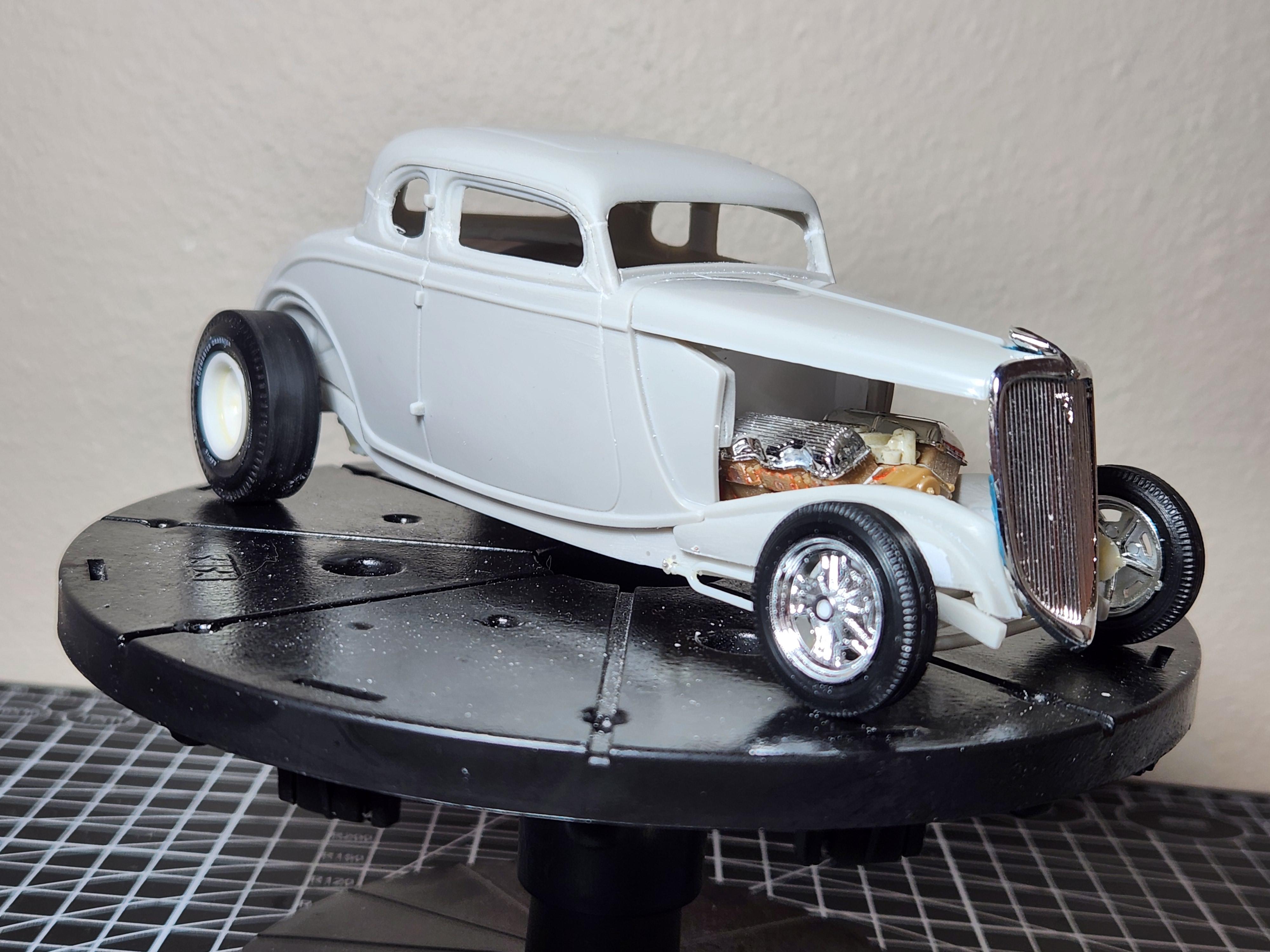

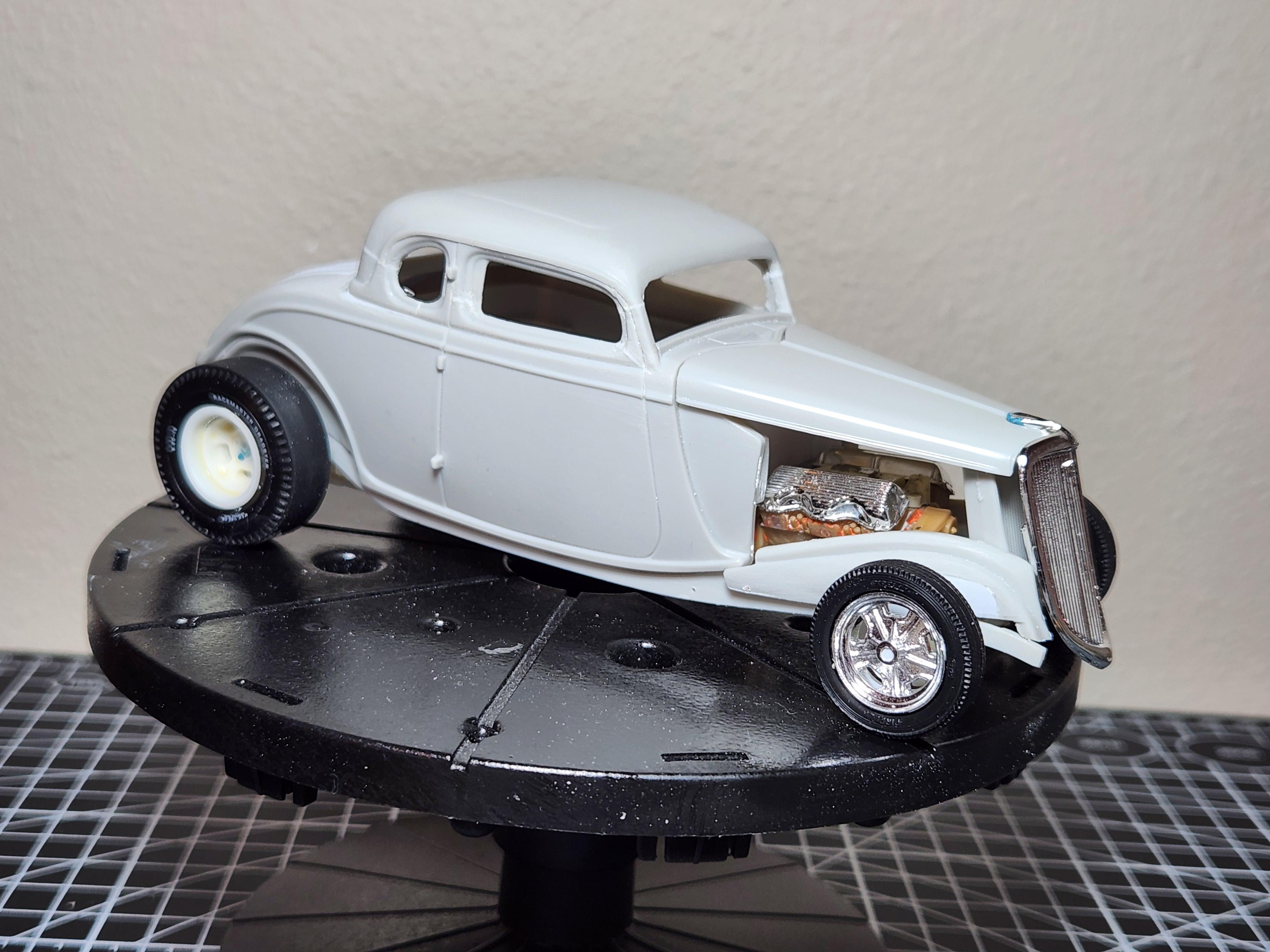

I actually was really inspired by this song and did a moch-up, the rear wheel combo might not be the best, pie crust slicks and smaller window slot mags. I also threw a couple speed parts on a built up amt 57 Chevy 409.20250924_205441.jpg.1a91caa8ecb67f128028e82ca2830843.jpg20250930_185753.jpg.1a206de194f628cf4bacac21cfb02eab.jpg

Your Mock Up looks really nice. I agree about older window Mags and the narrow piecrust slicks. The engine seem a good choice for the era.

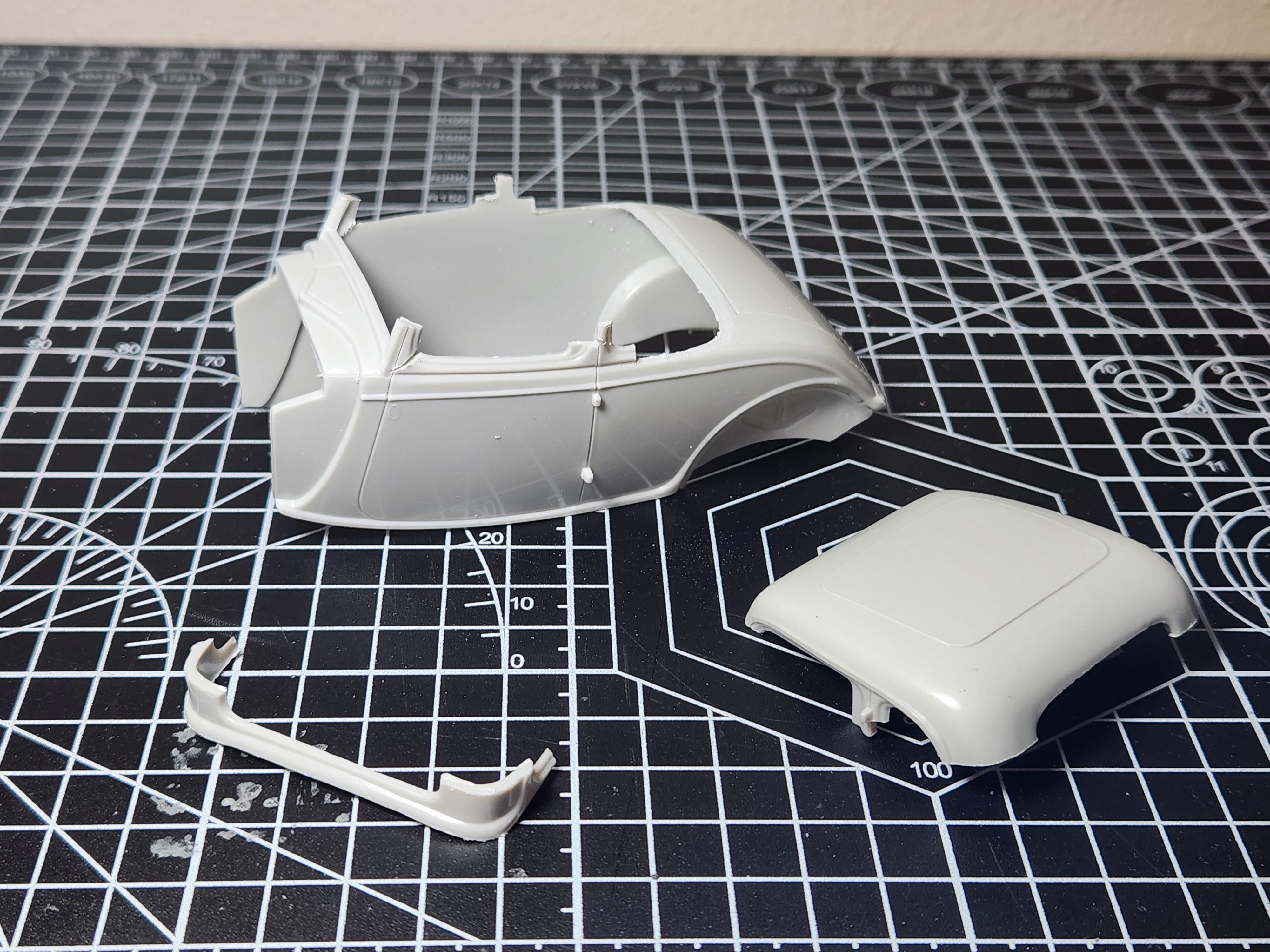

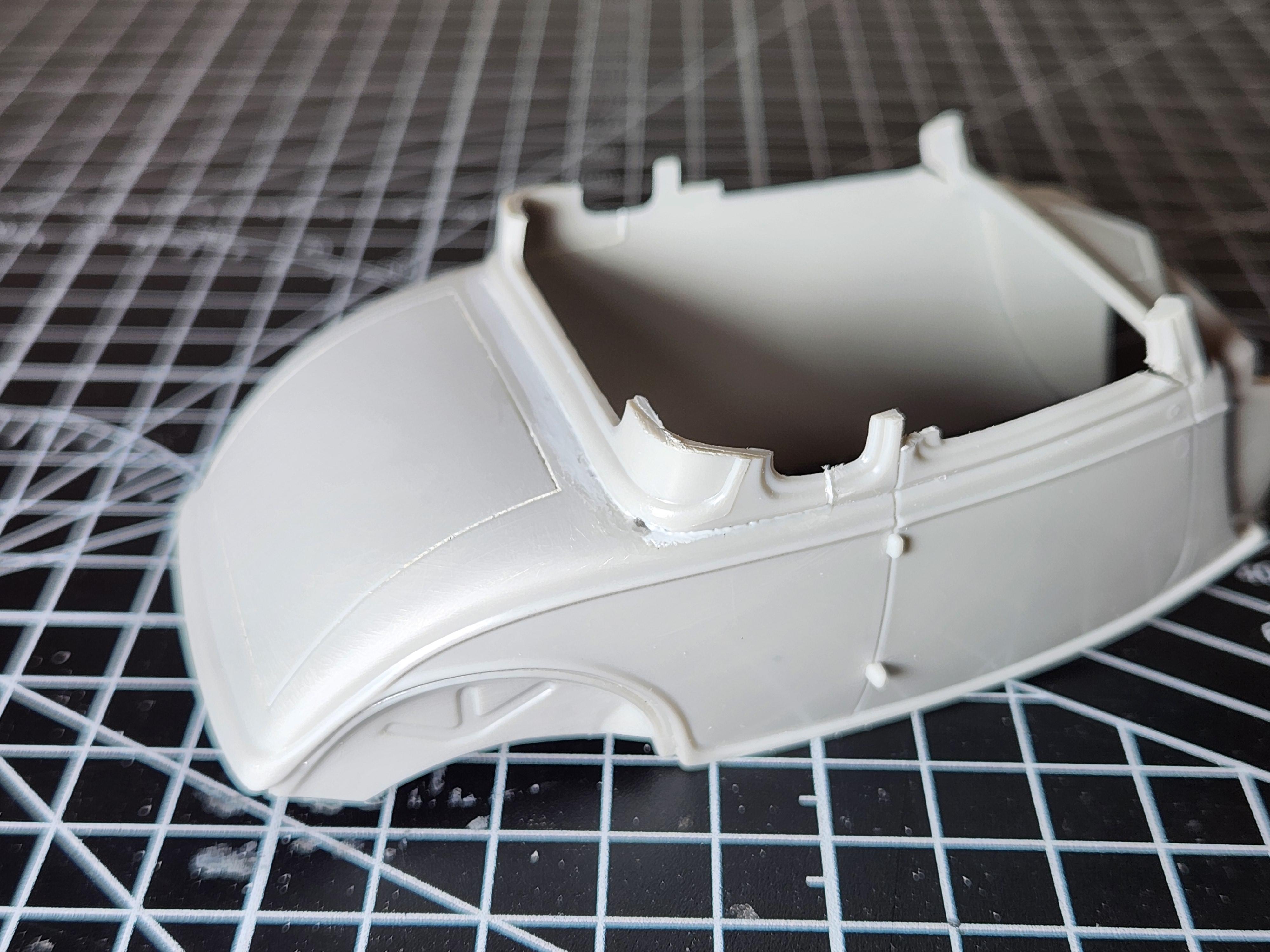

Alright guys, after knocking out a couple of other projects I decided to try chopping this body. I followed @Kit Karson's awesome step by step tutorial on chopping this thing, so at least that made it a little easier on my end. 20251105_194304.jpg.cf2aa38c7414742d3faf32840587c96a.jpg

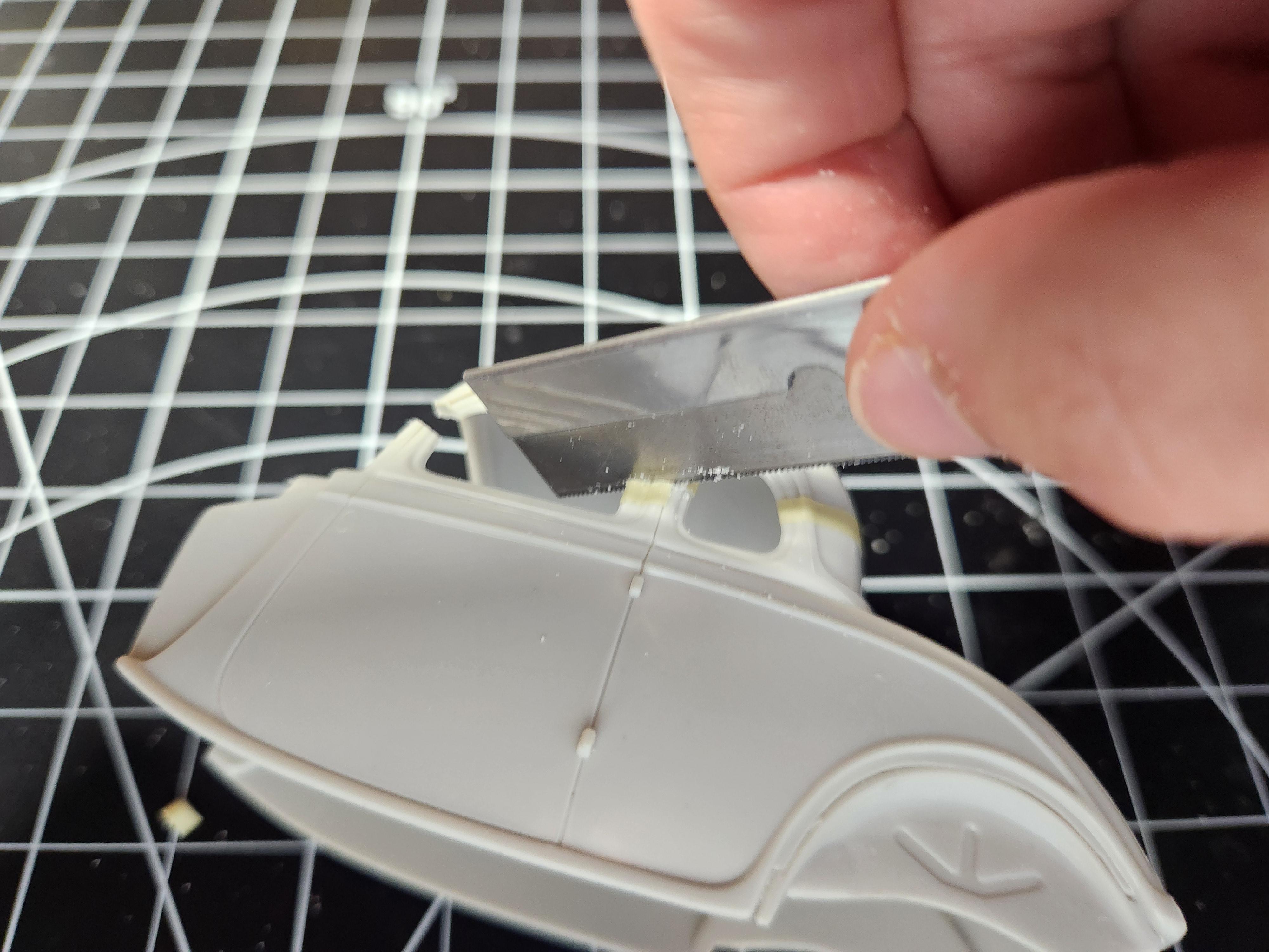

Time to mark those cuts and go crazy with the razor saw!20251105_195926.jpg.5841767106a86af8cea7fc86d21203cf.jpg
Heres all 3 pieces needed for this chop.20251105_202714.jpg.ad27f955969549f34bb16417910d9a88.jpg

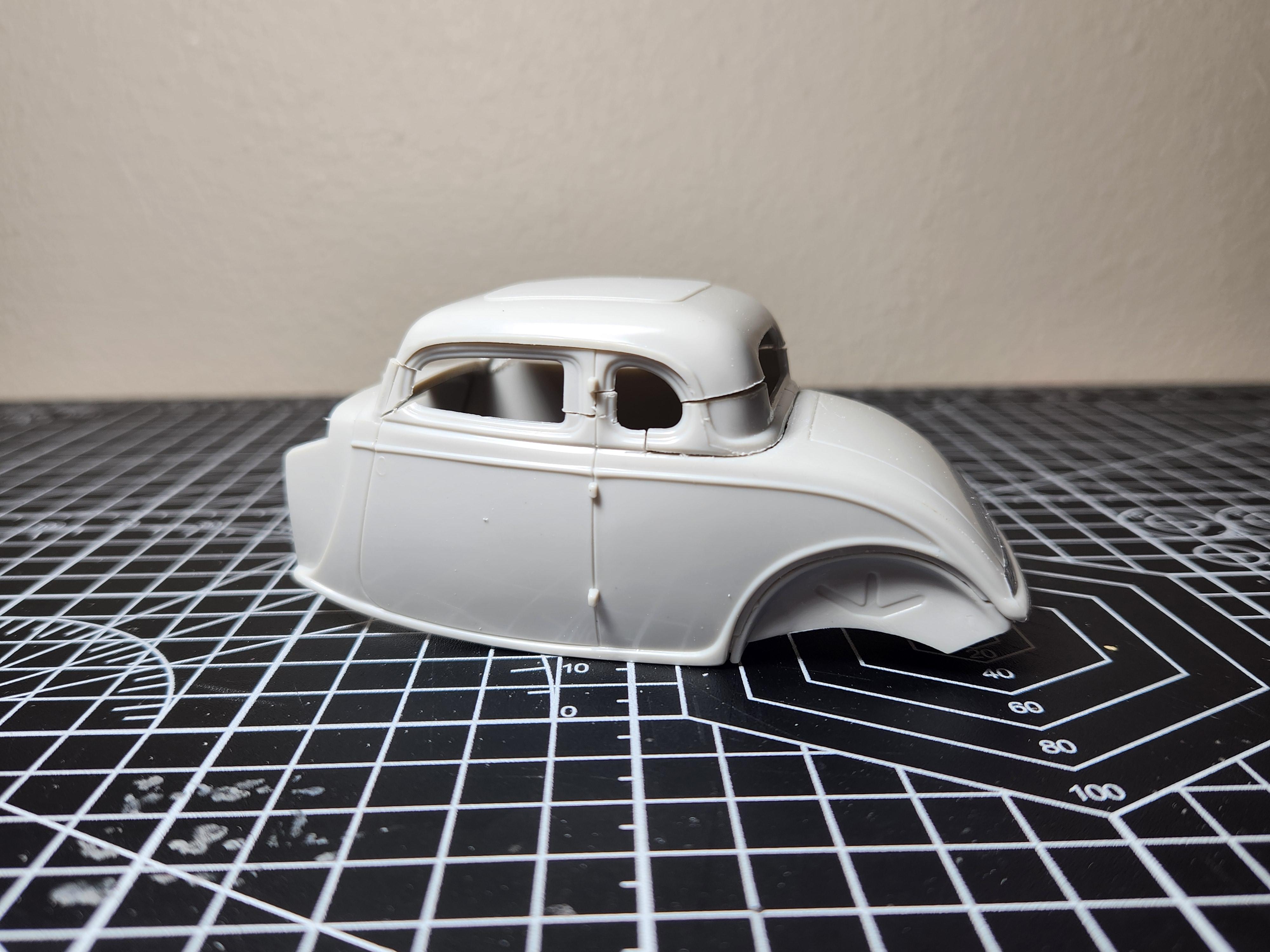

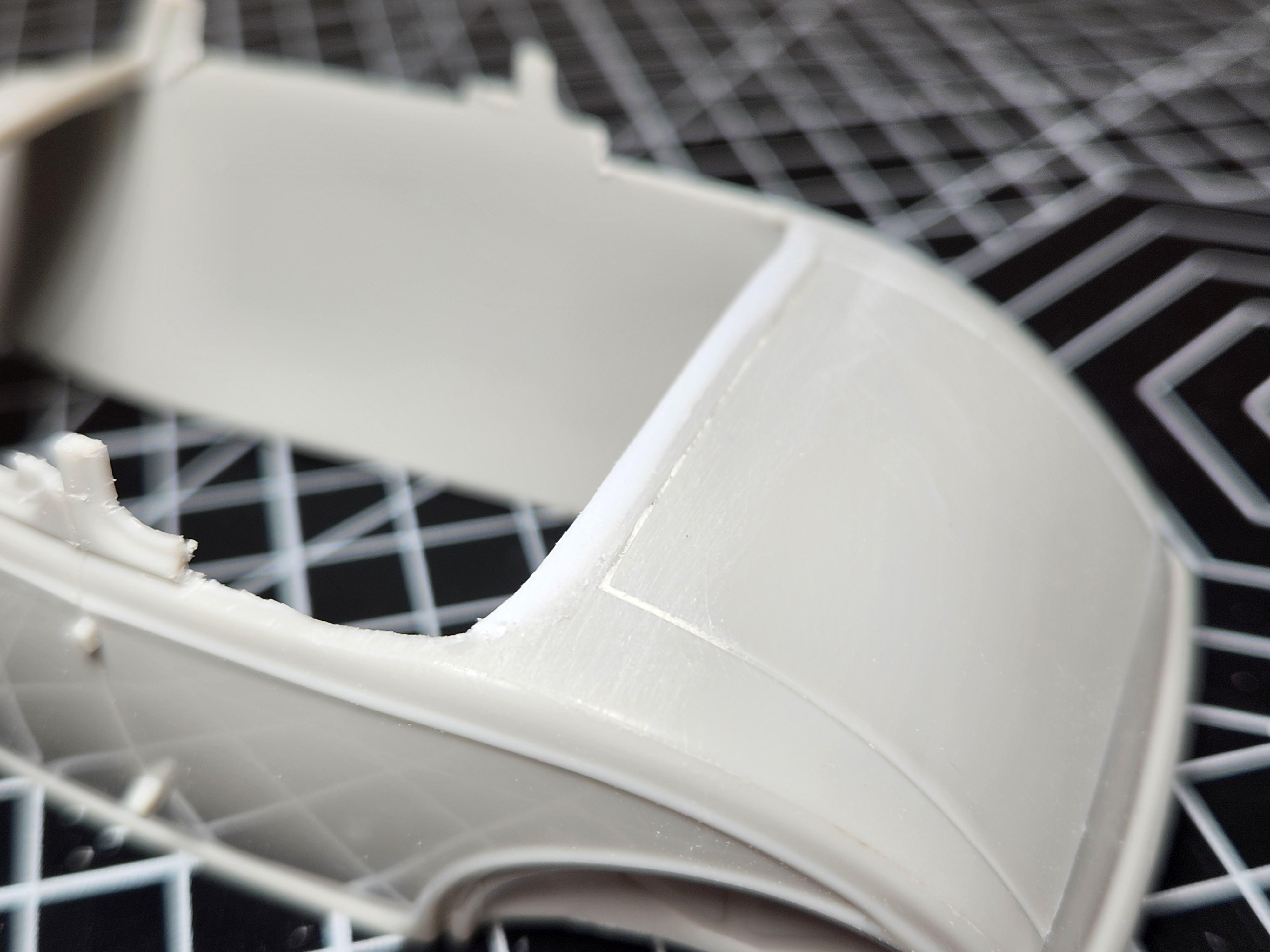

I got the rear segment in place last night. I had to raise the area that was cut at an angle to be level. I also had to add some more material to the edge sence the c pillar had to be moved forward. 20251106_141545.jpg.4c5b3c9f9878d9f0f78954d6cf493467.jpg20251106_155120.jpg.420d091768c893365731fbcbe80c36f5.jpg20251106_155128.jpg.c9b108546c943b8b82f72b5ab17c58c7.jpg20251106_155107.jpg.c938862909a27cbadd4fd026fae2bb3a.jpg
  • Like 1

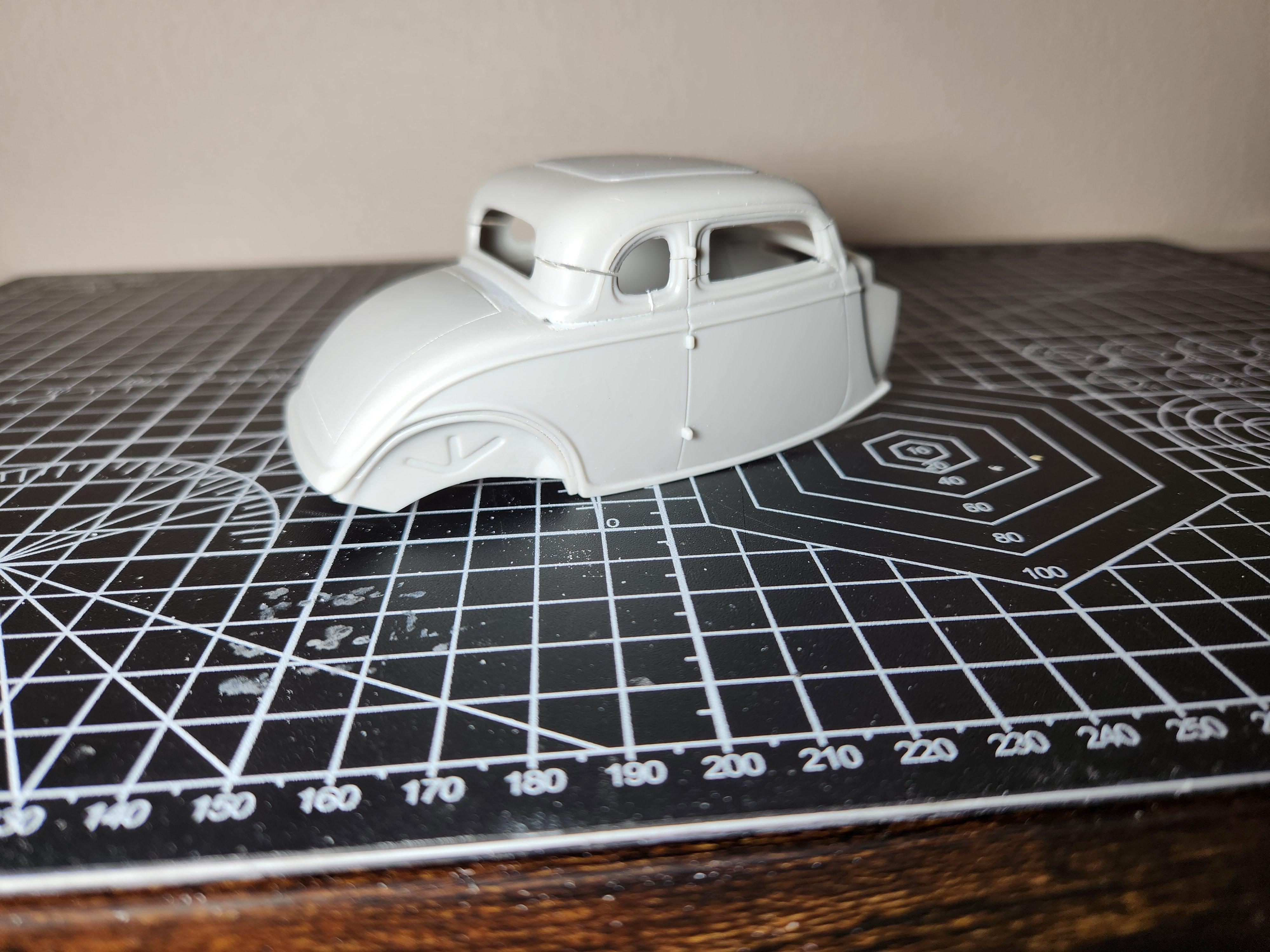

A nice method to cut a 33/34 5W top. No need to add a stretch piece between the A-B and B-C pillars which is always hard to get right with a 5W. And it looks more stock than stretching and you can keep the top insert if you want - a lot of the early comp coupes kept them
  • Like 1

Thanks! I also like how this chop gives your windshield more of a layed back look.

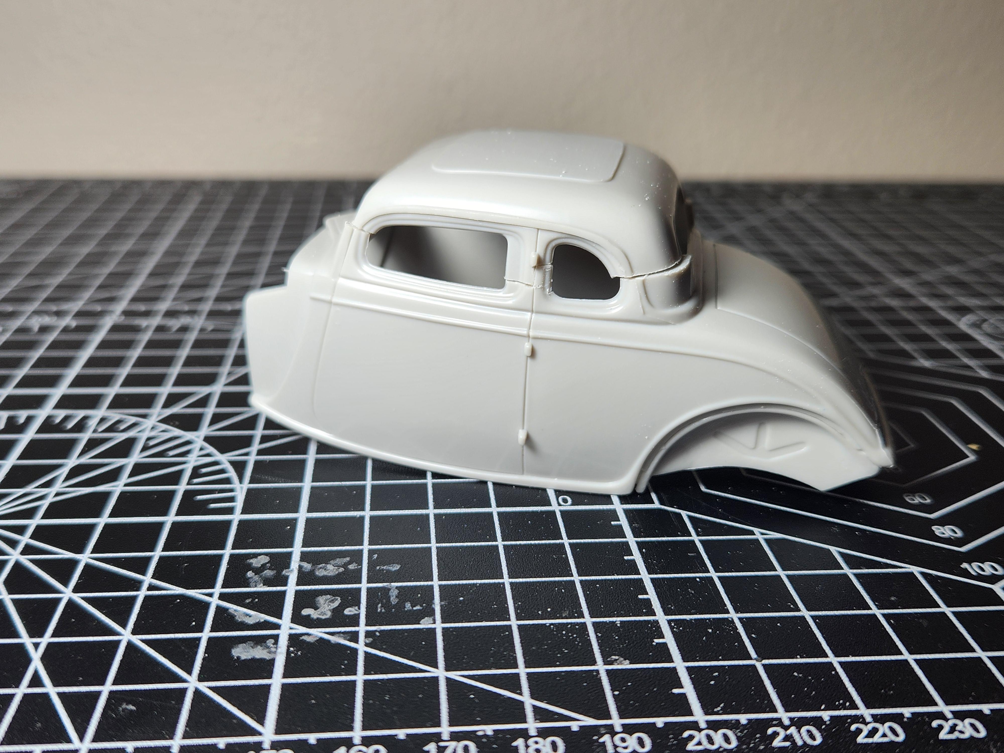

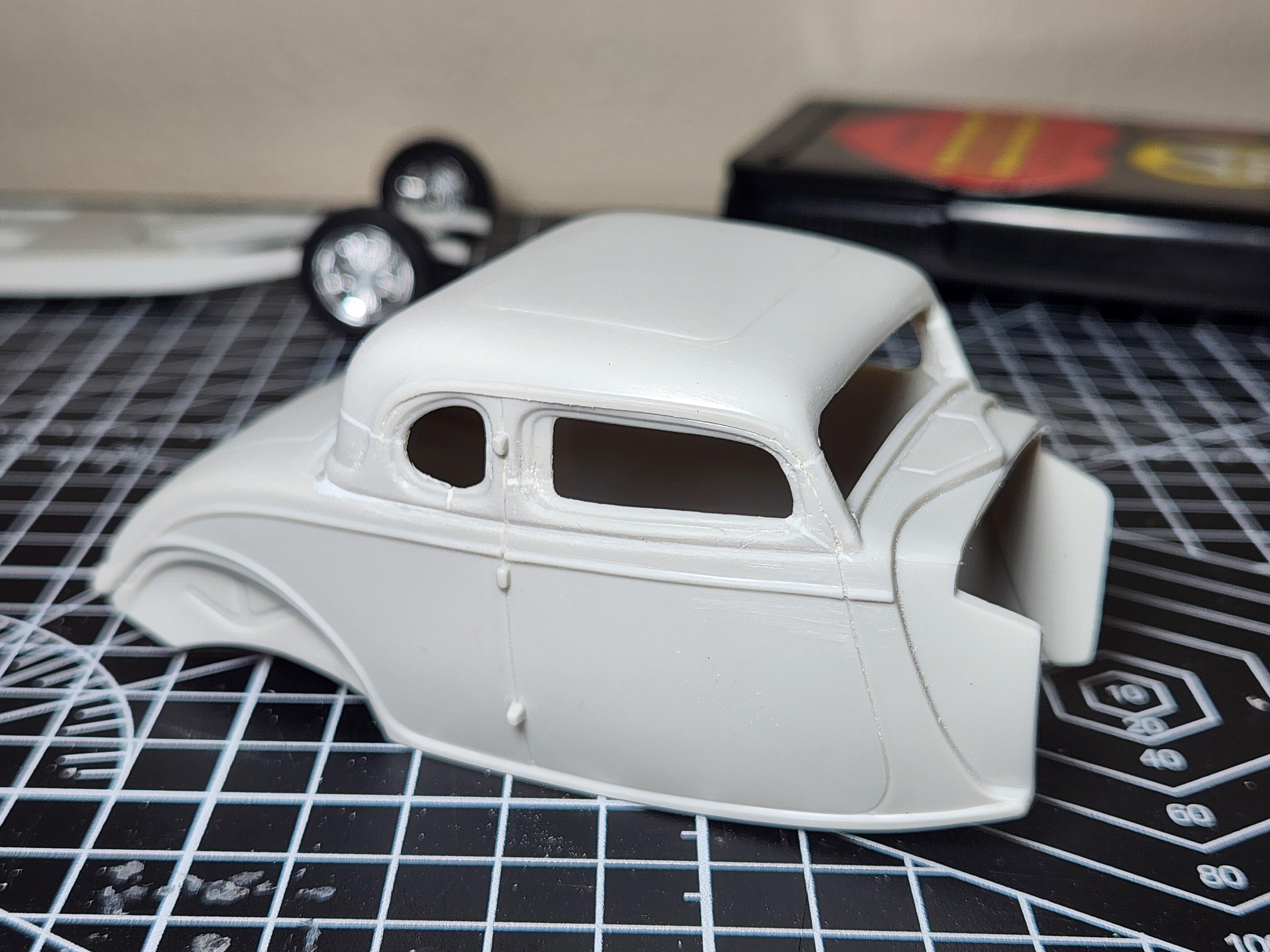

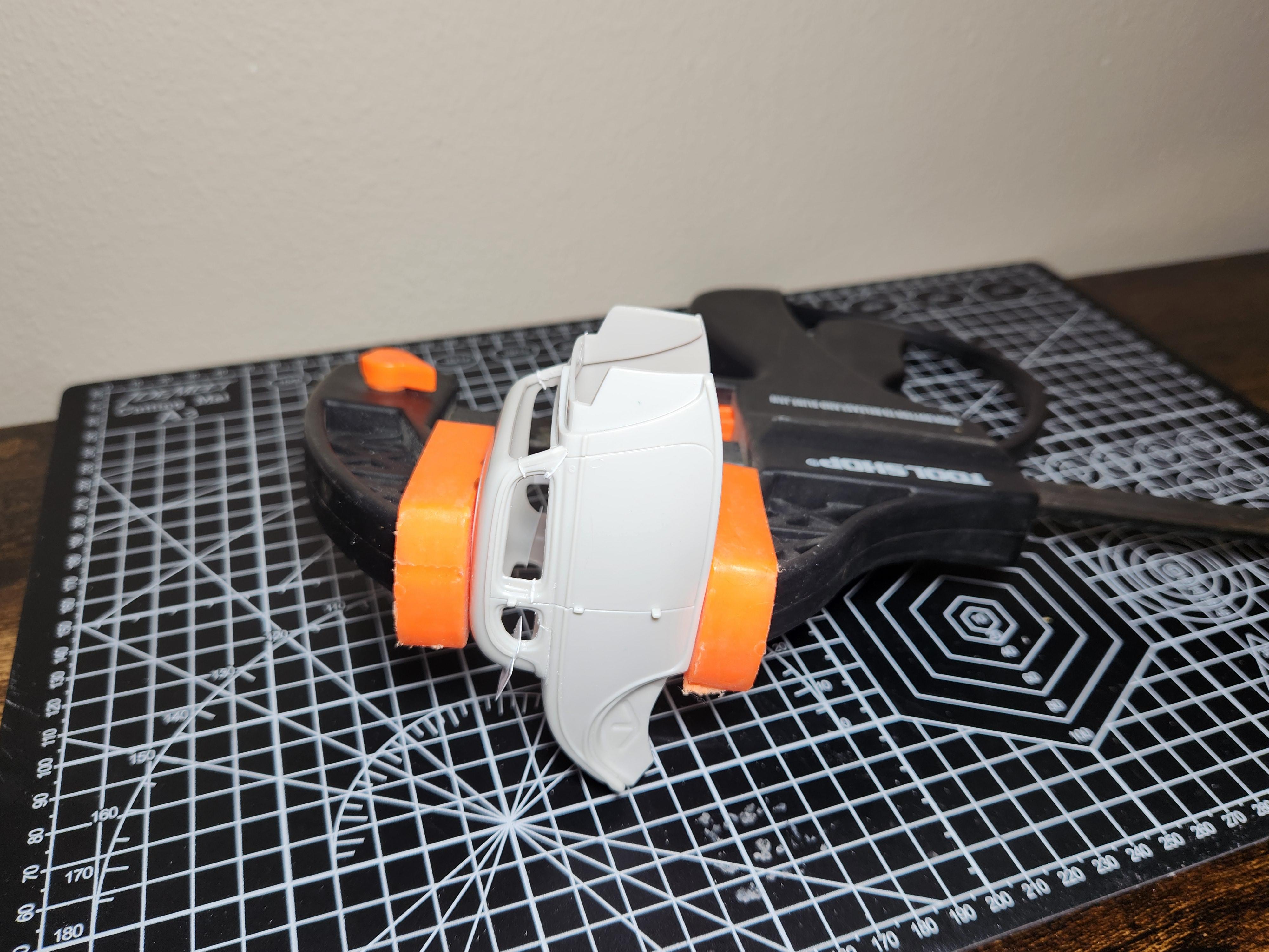

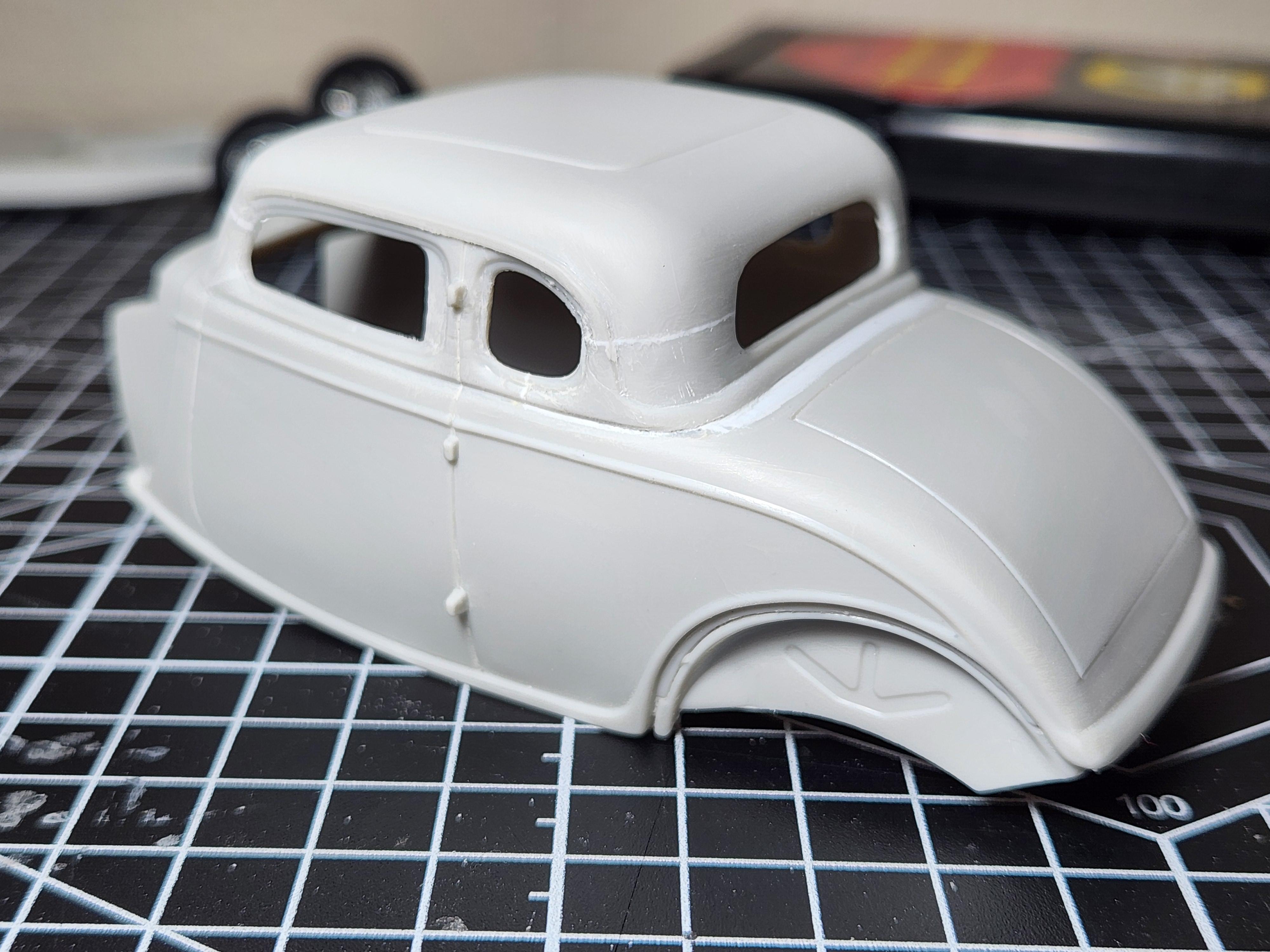

Alright, finished up the chop. I glued the top on and did the rough sanding around the window openings. 20251107_163530.jpg.9bab4abfbd24e3f103a5716b575e3d35.jpg20251107_201055.jpg.2556cbfd2853cee3e4534127c498778e.jpg20251107_201040.jpg.8fb98e8a5b447a7dd54c902c79dfd6cb.jpg

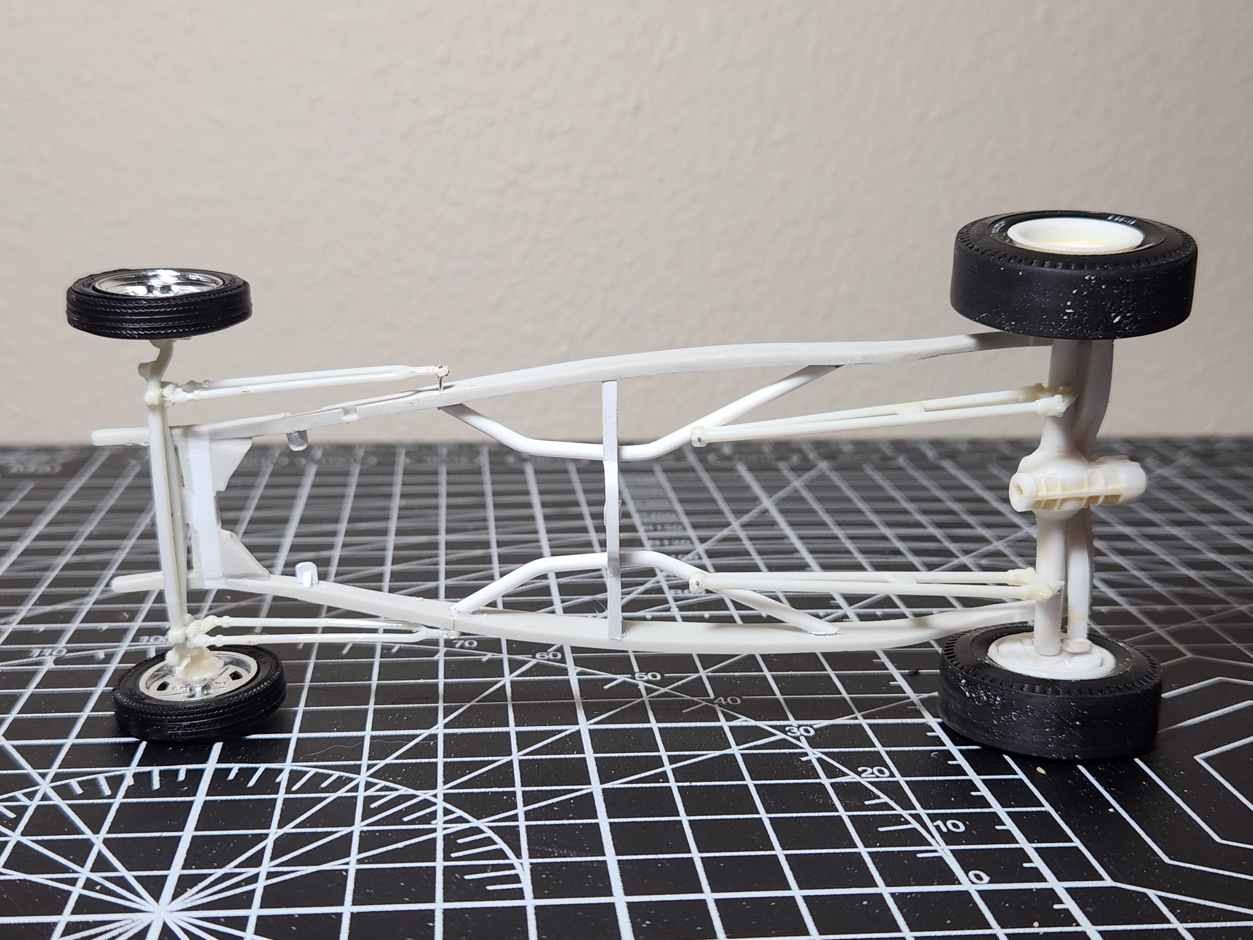

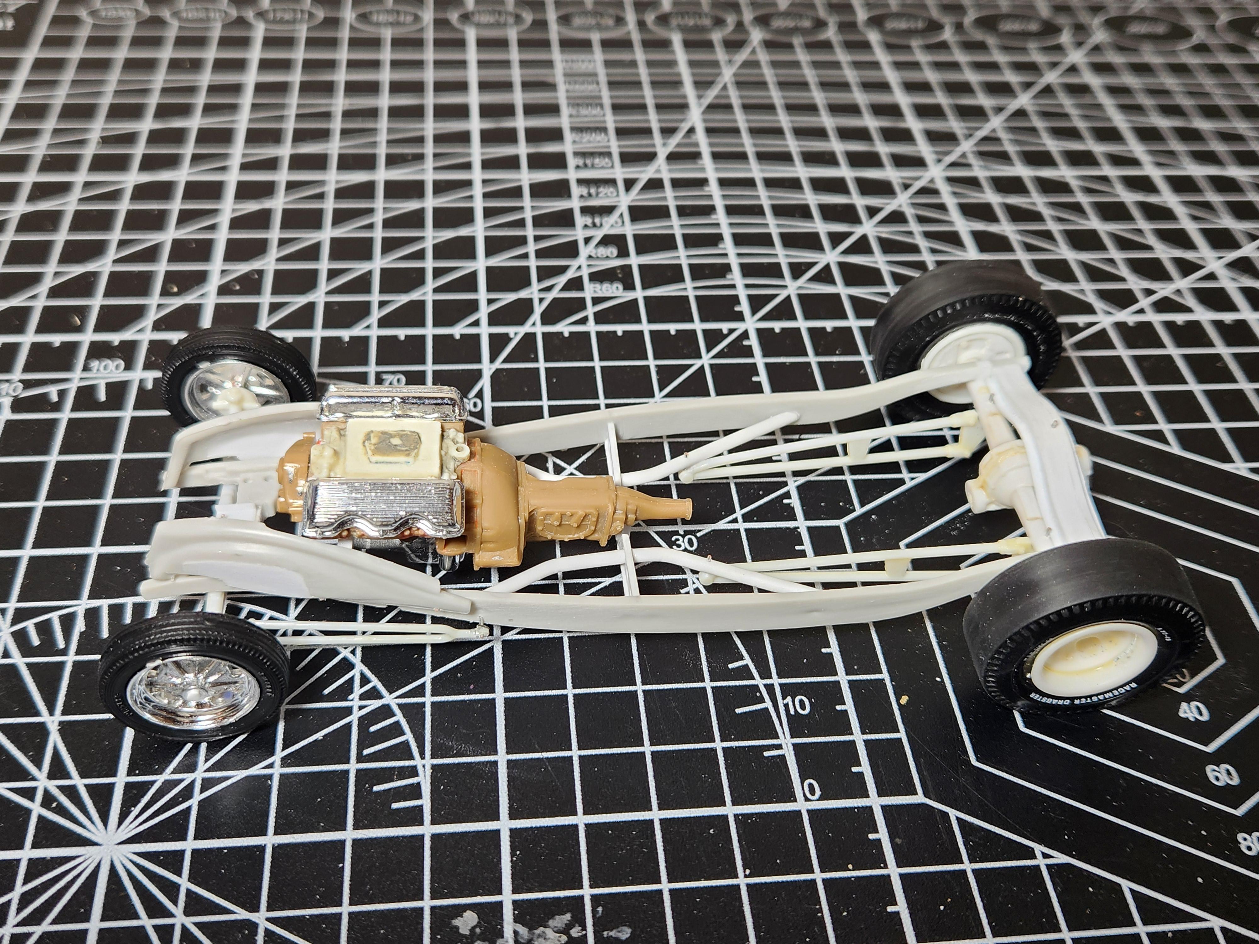

I did get some things chipped away at though. I cut the floor out of the frame and started work on angling the rear up and bobbing it. I also scratch built a model a style rear cross member. And the quick change is out of the monogram t bucket. The front wheels are out of a polar lights funny car and the tires are the Perelli front runners out of the Revell 31 sedan. The rear wheels believe it or not are are the front wheels out of the AMT 40 Willys, sanded down the rim for a better look because the amt rims always seamed to thick. I also cleaned up the engine by taking off the heads and actually gluing them on correctly, I also stripped the brush painted paint off to reveal that 90s AMT brown plastic because this is out of the amt 57 Chevy with the yellow car on the front.20251113_080649.jpg.30dad3621289d790dff59d9fce4f9fae.jpg20251113_080654.jpg.eff12e4ea099a8076b94d4d3d096fc43.jpg20251113_080700.jpg.c867bf5ce24881160095bbf36c17b220.jpg20251113_080711.jpg.3b946e68a540e05aec7c9b1054bb360c.jpg20251113_080728.jpg.09c0059d9d19380f0f3699a9bcec3432.jpg20251113_080816.jpg.090cb58a206e95fa193bade3055b21ea.jpg20251113_080845.jpg.b1796b2943f509ab6d639bdb982c17ce.jpg

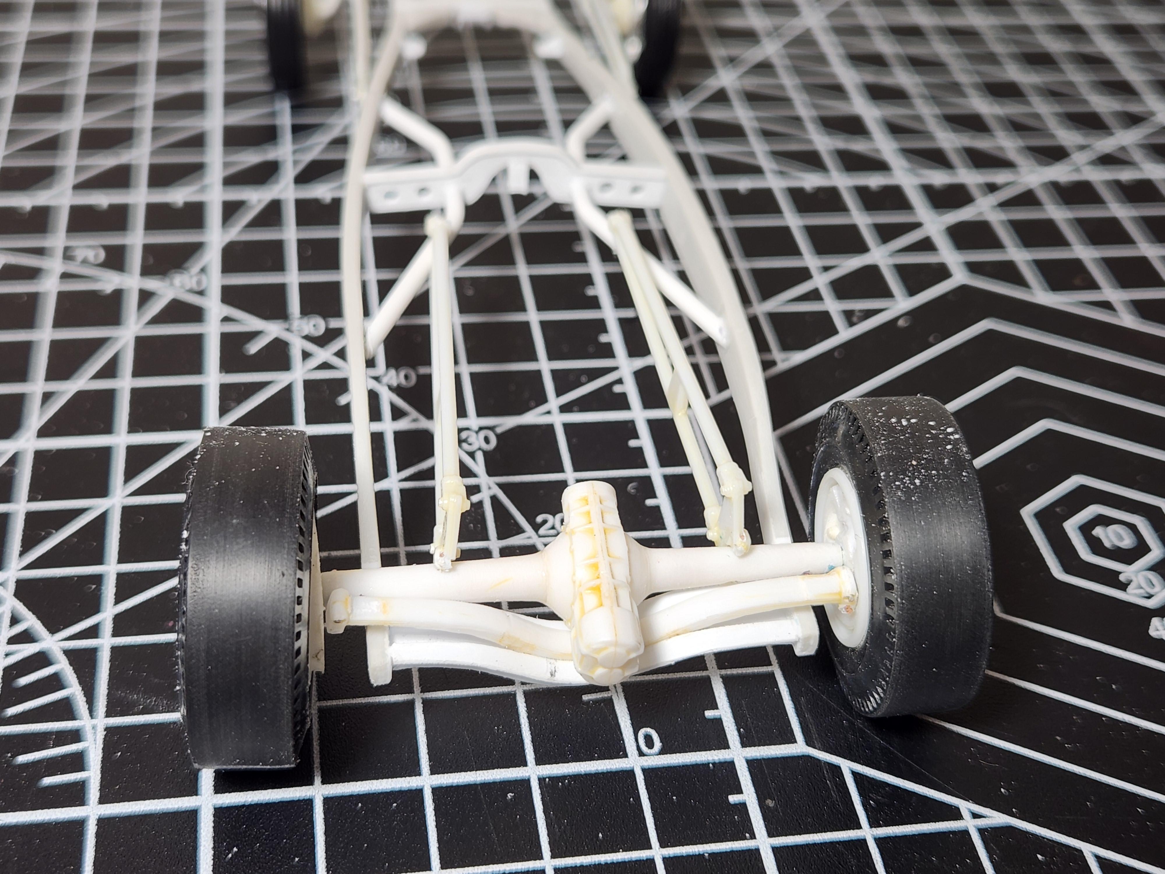

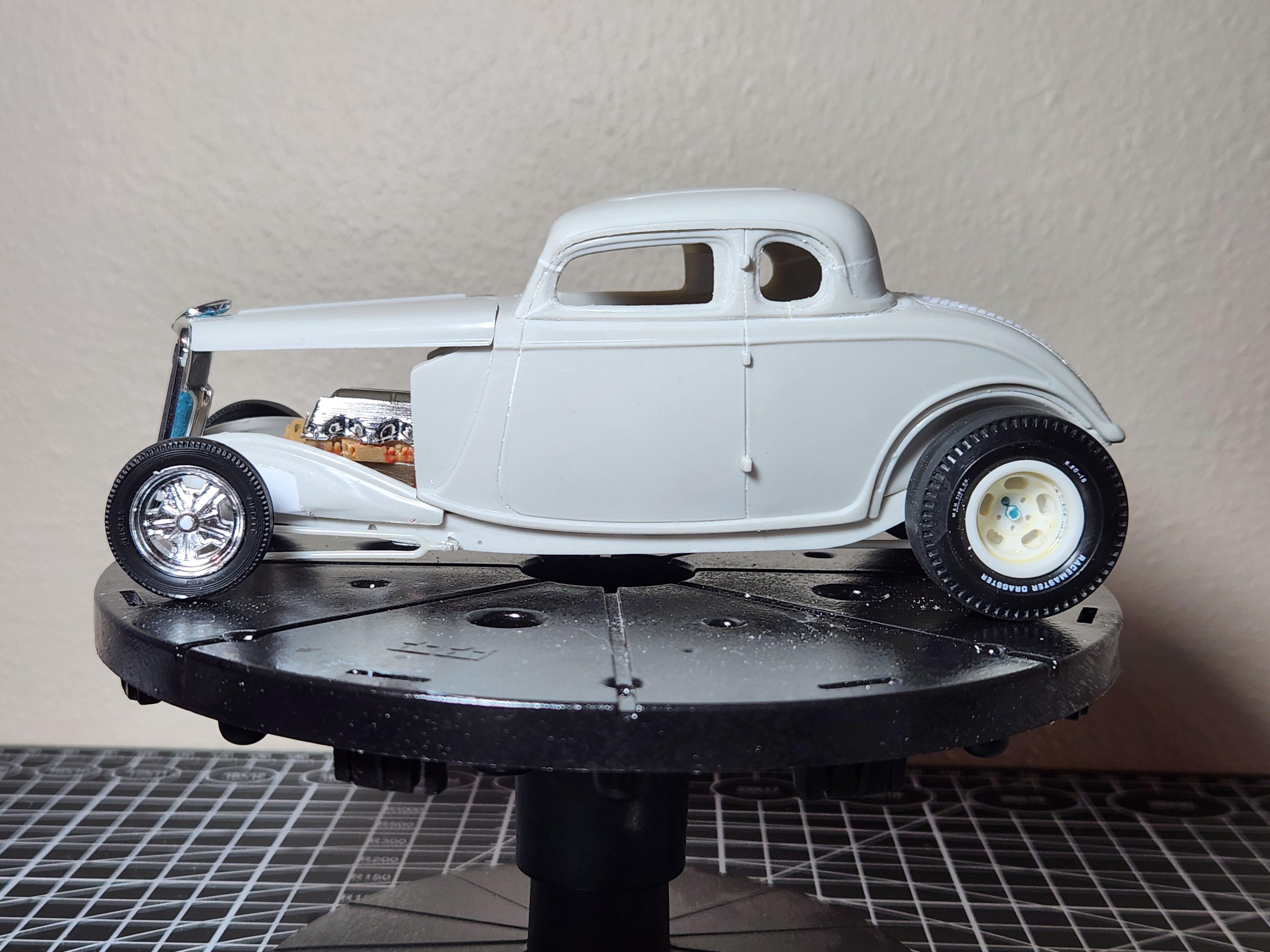

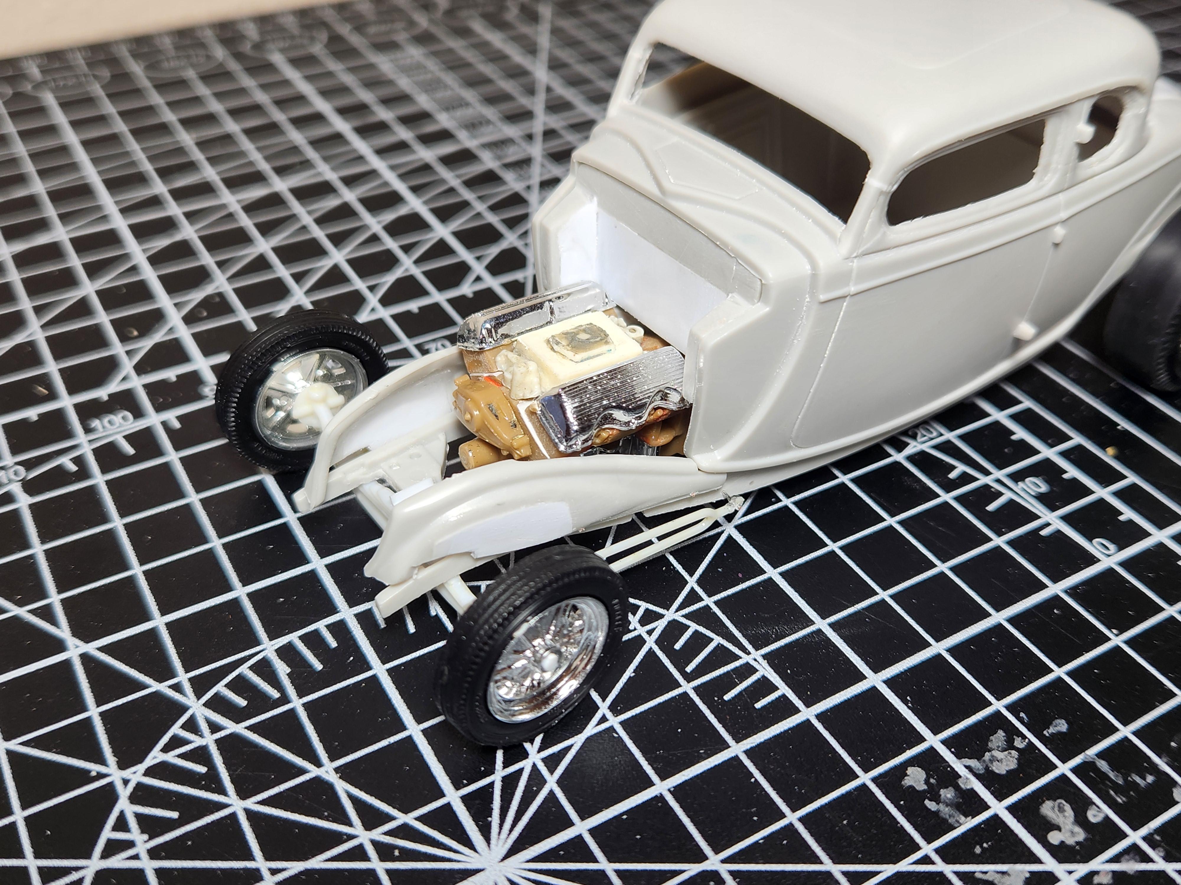

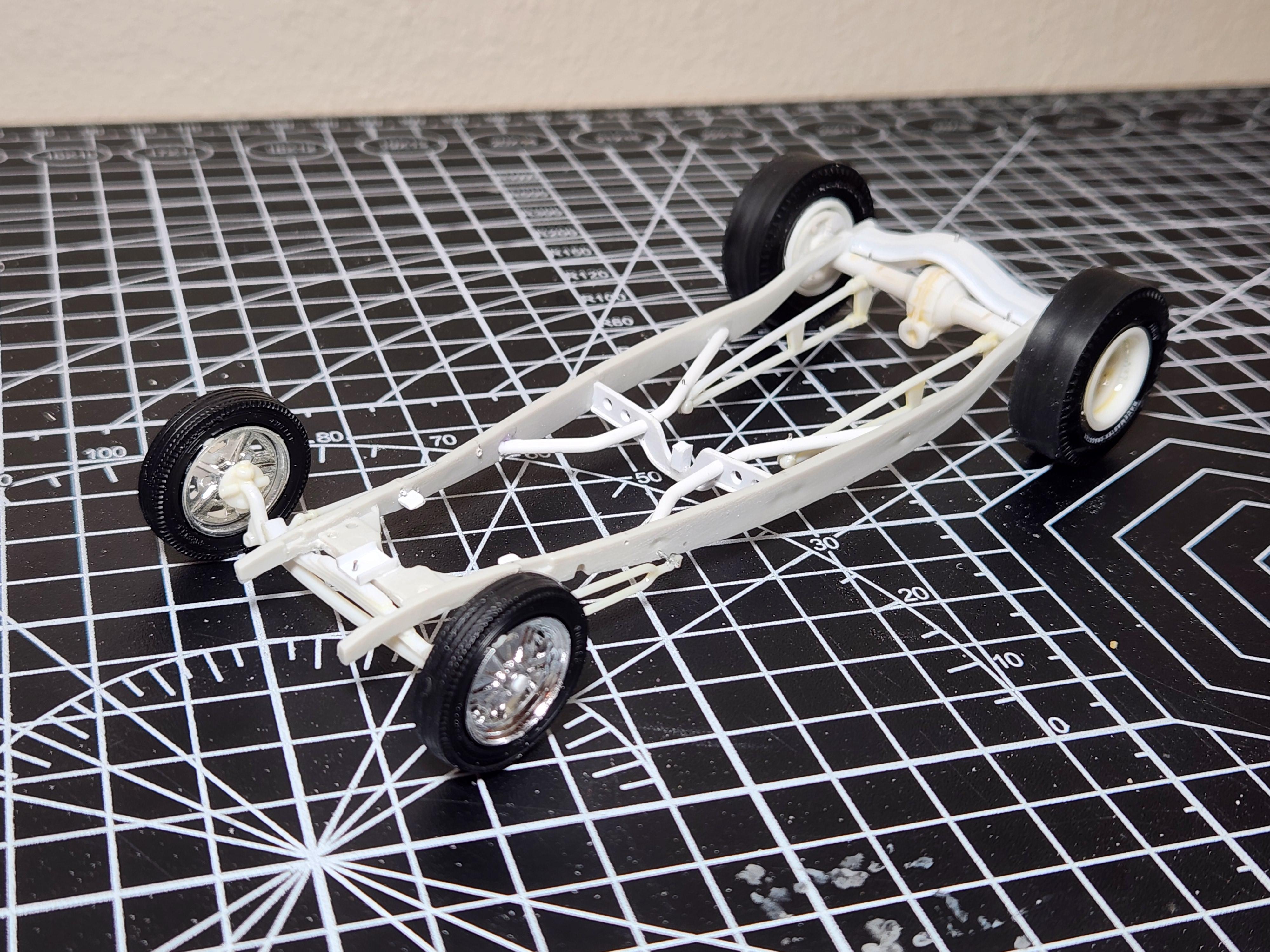

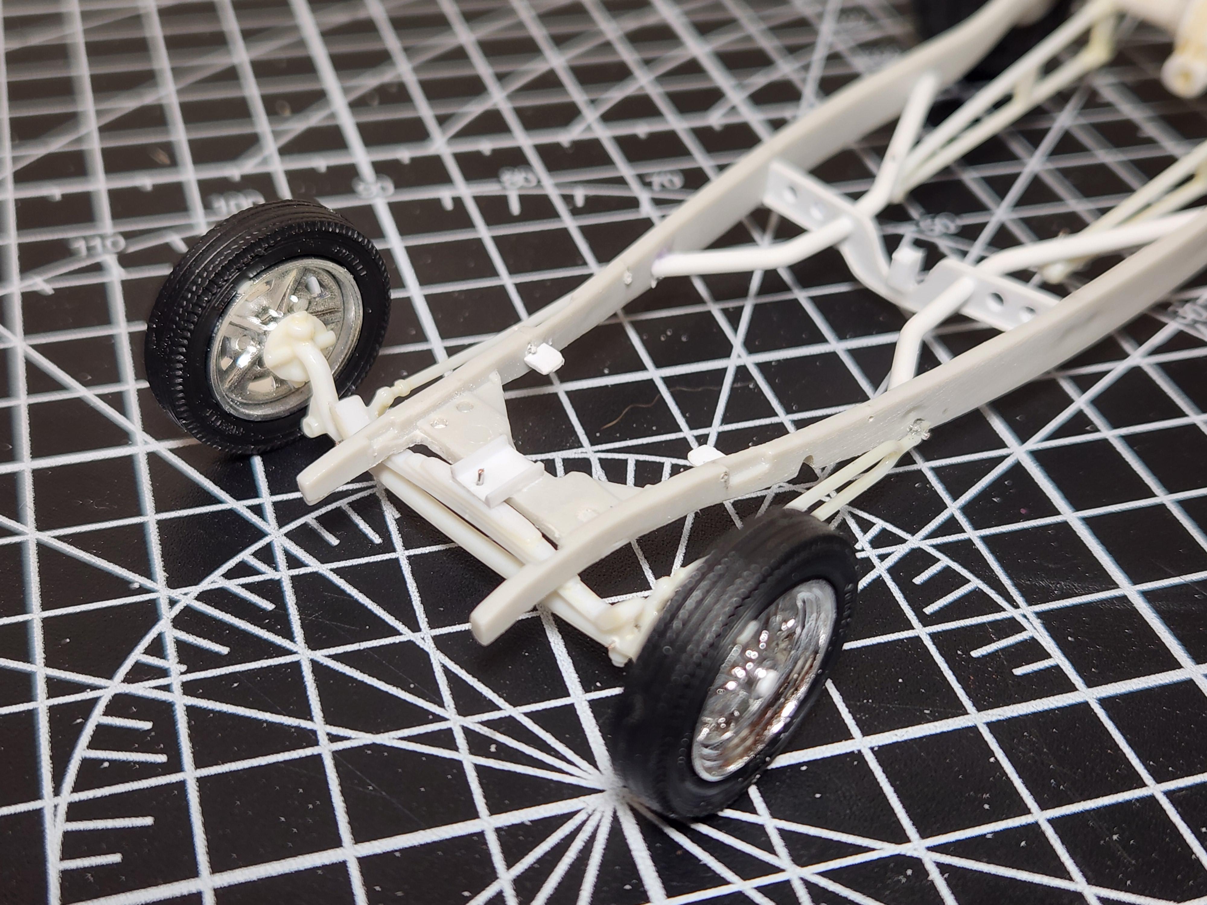

Alright, ive have been doing quite a bit of kitbashing and scratch building lately. The chassis is 95% there, shock mounts still have to be added. I added a scratch built transmission mount (with the wholes as well for a little nod to a 40 ford x member) and a tube x member. I then used the front suspension from the revell 32 Ford with the coupe hairpins in the front. The rear as mentioned is the monogram t bucket and then I added the links from the 32 ford. Here are some picks from the first moch-up after most of the work.20251114_211128.jpg.14f8257ef5c809b6d09dabd16372a59e.jpg20251114_211141.jpg.7090f35c2297ffb48d47500d7c0058f1.jpg
I really didnt like how far back the front axle set so flattened the stock brace and added a suicide perch off of it to move it forward. This is exactly the look I was going for. The engine bay is much longer on this car so it is going to be way nicer to put the belts and stuff on this W head. Sence I will probably also be street driven it wilk need a fan anyway.20251115_115736.jpg.2404106824bd1d19c4bbadf1e08b8d5c.jpg20251115_115716.jpg.343225fedd79633c5c17611e70418783.jpg20251115_115643.jpg.6148819dafb8640a072404d51cb1223a.jpg20251115_115659.jpg.0c0b49290259e6890d956f87e3f6d2f3.jpg20251115_115614.jpg.8284120a1fb87c50306880f6352d8f4d.jpg20251115_115547.jpg.1e34a29947e6abd73a7511927b46e31a.jpg20251115_115421.jpg.6279ed9f8caa53dfe852d0910d32d9bf.jpg20251115_115432.jpg.3ed789a6bd3a2df867248720d3016784.jpg20251115_115450.jpg.0c75d087bf098328898fe8e65856a132.jpg

Nice work on the chop and the clean scratch built bits but I thought it looked OK in the first pic with the tall top also.

Yeah, tall tops look okay, but I really like chopped 33-34 fords, especially when they are hot rods!
This a very interesting build, I really like your roof chop technique. Looking forward to more of this one....

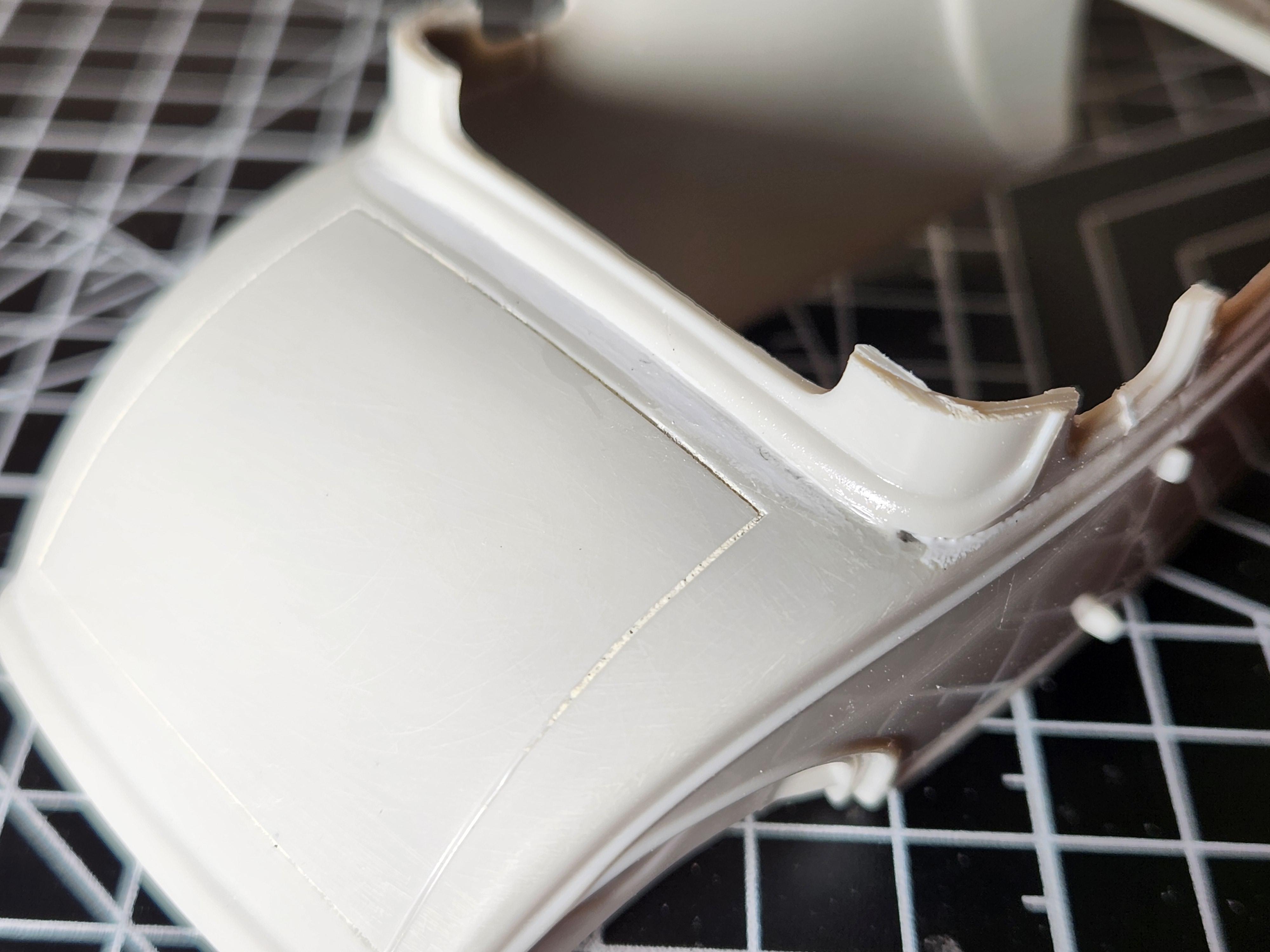

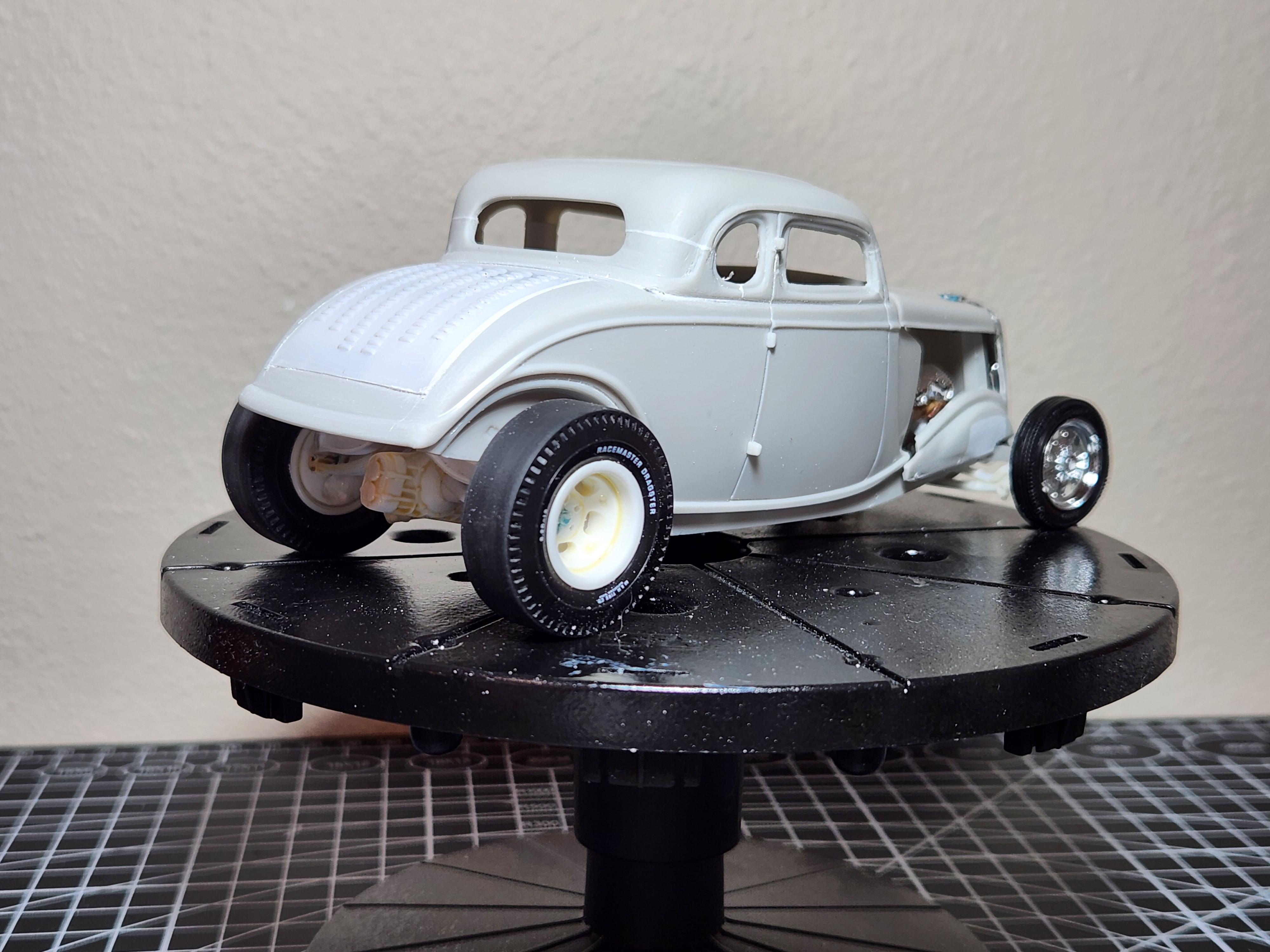

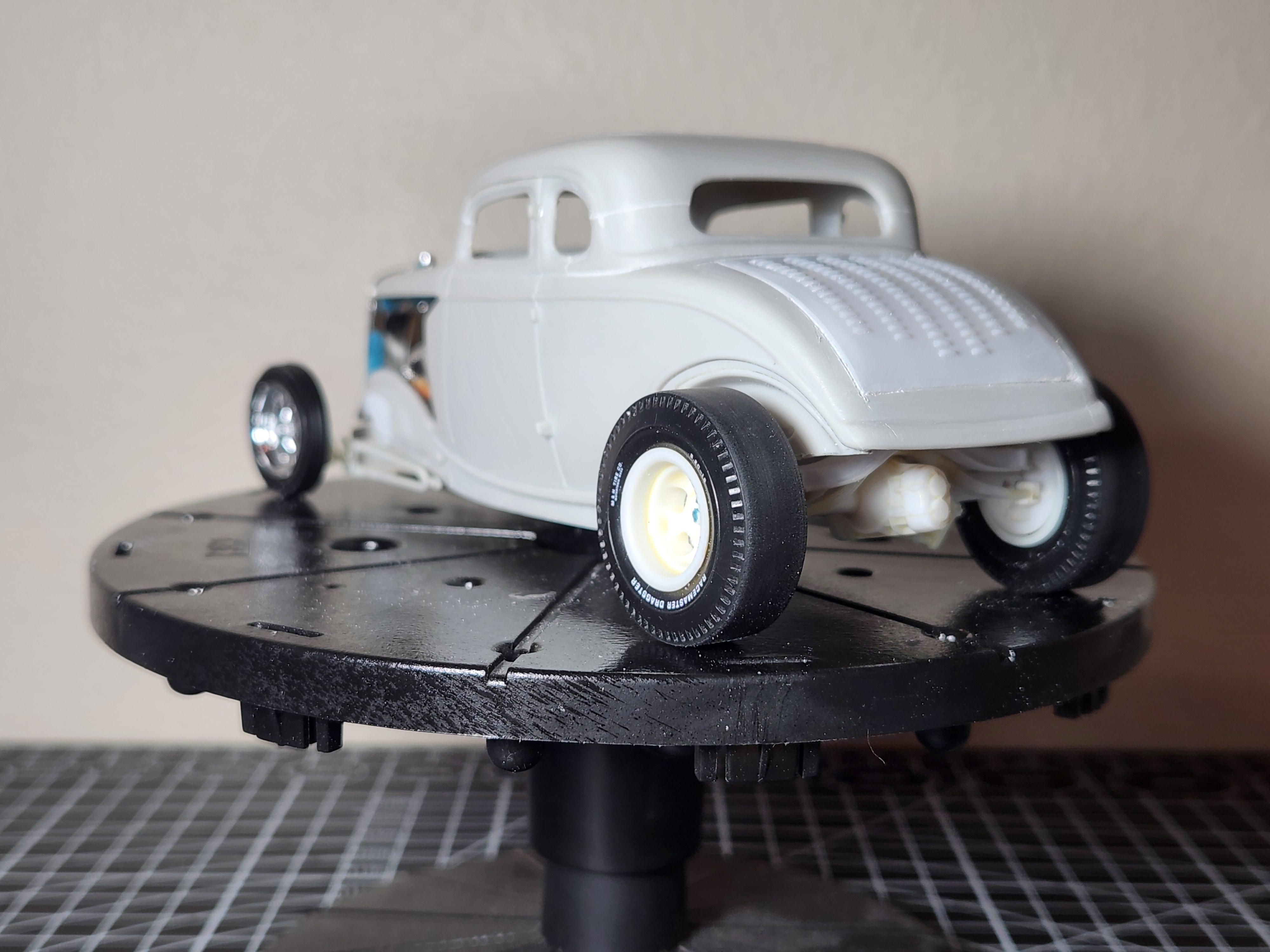

Alright guys, I got some good bench tlme in this week and managed to scratch build a floor. Made a template out of card stock until it fit then I traced that out onto evergreen sheet and cut it out. then I glued that all together and added some custom bead rolling designs with half round severgreen.20251211_080041.jpg.7b90cb92c407c403b0a117f69ff0d908.jpg20251211_080132.jpg.55520eb41f6f9a01ab3b961efb9f1954.jpg20251211_080146.jpg.63bdc5bc790dc64c13a71d1d75030c2b.jpg

Elliot, looking very nice!  It takes some guts to do the chop and you've pulled it off, thanks for the detailed step-by-step sequence. Excellent!  Mike..
