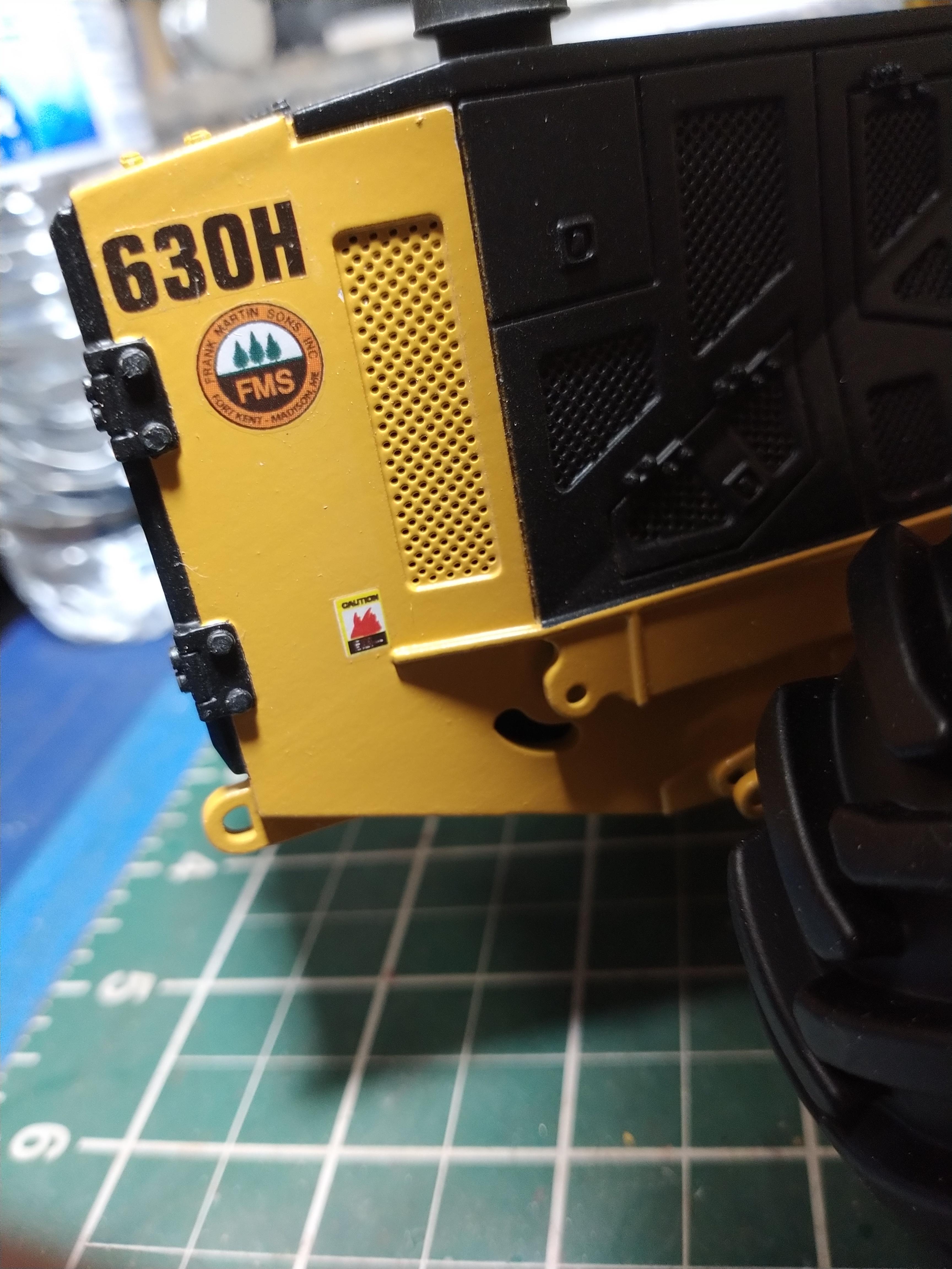

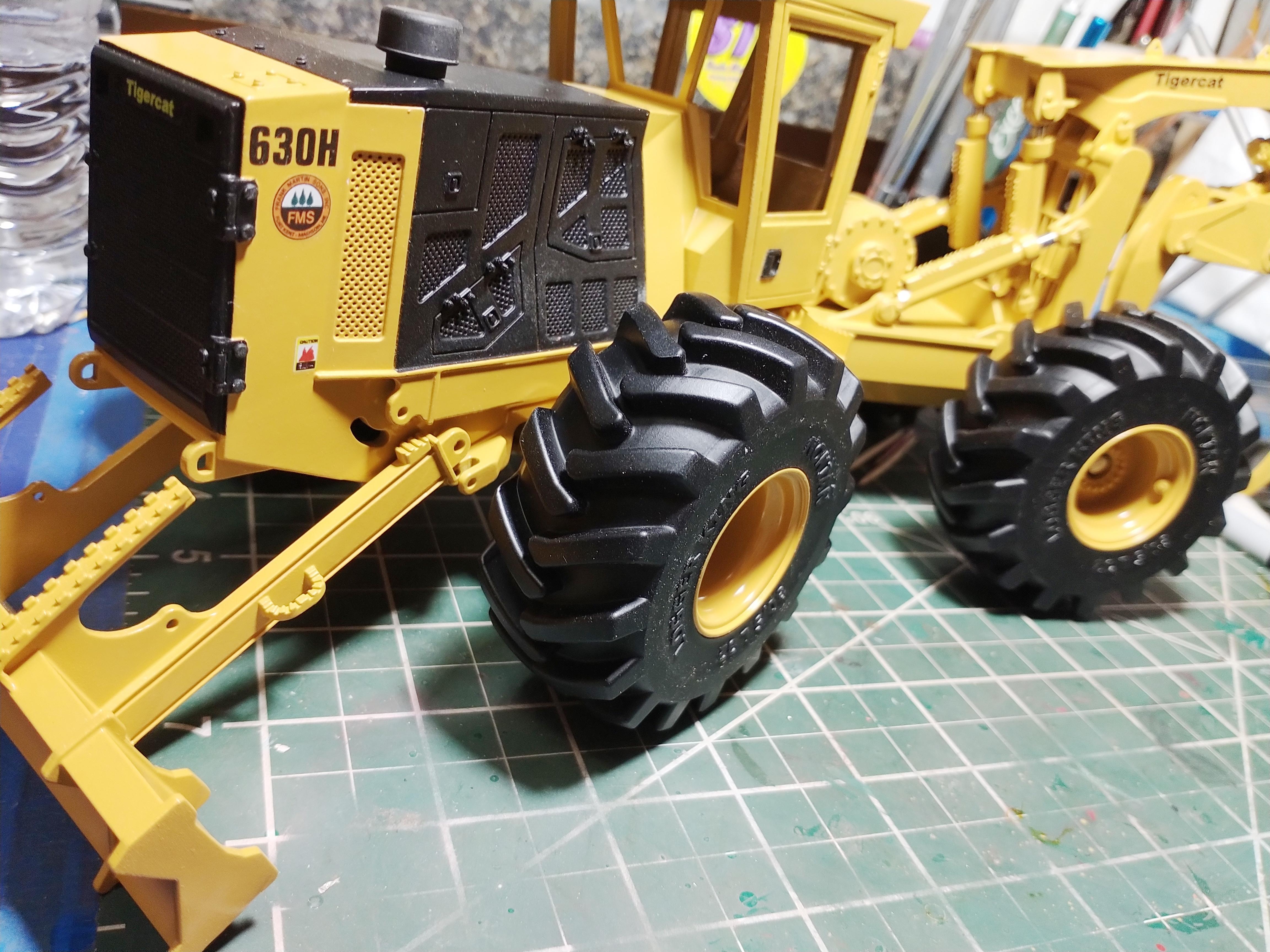

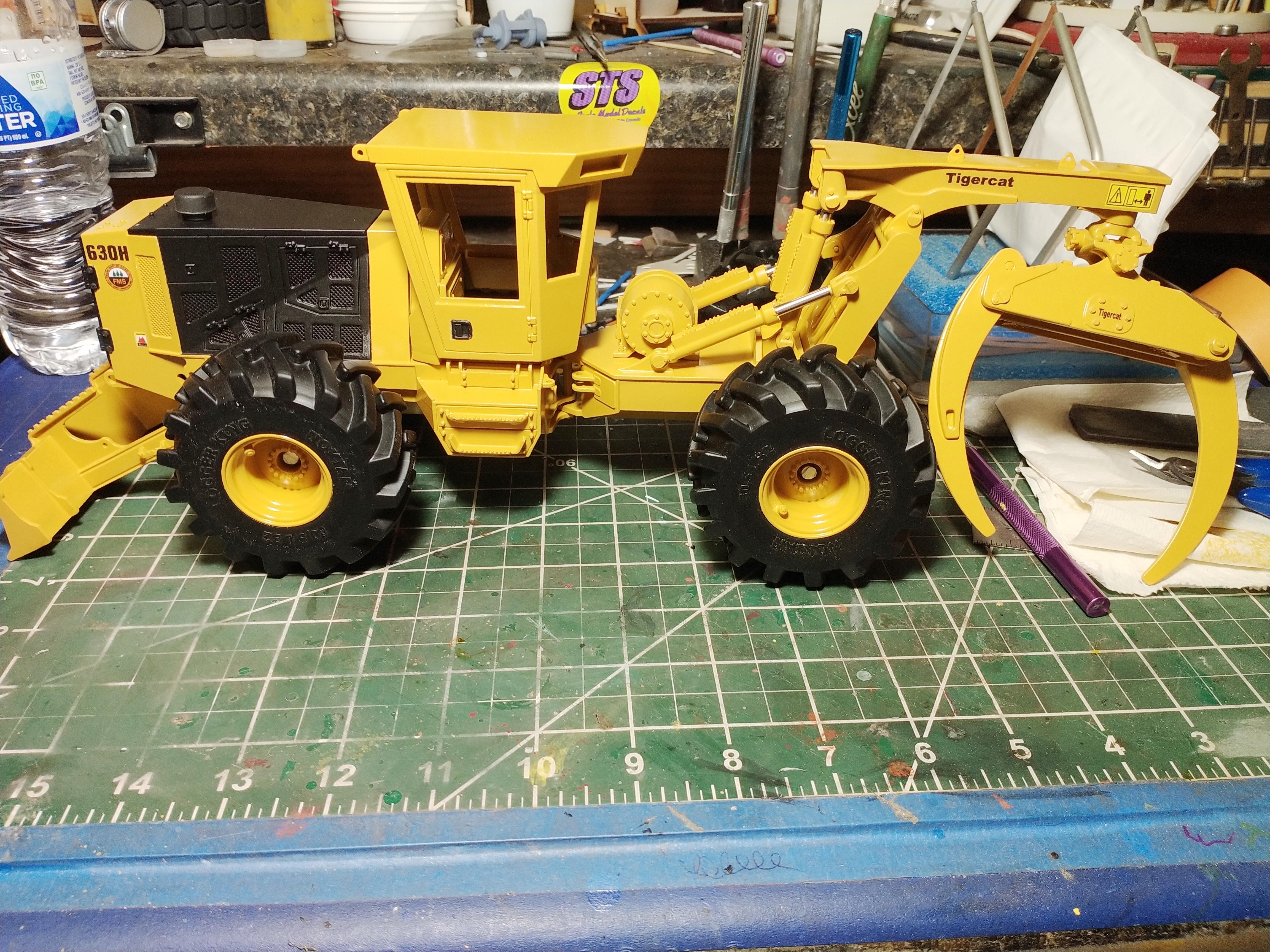

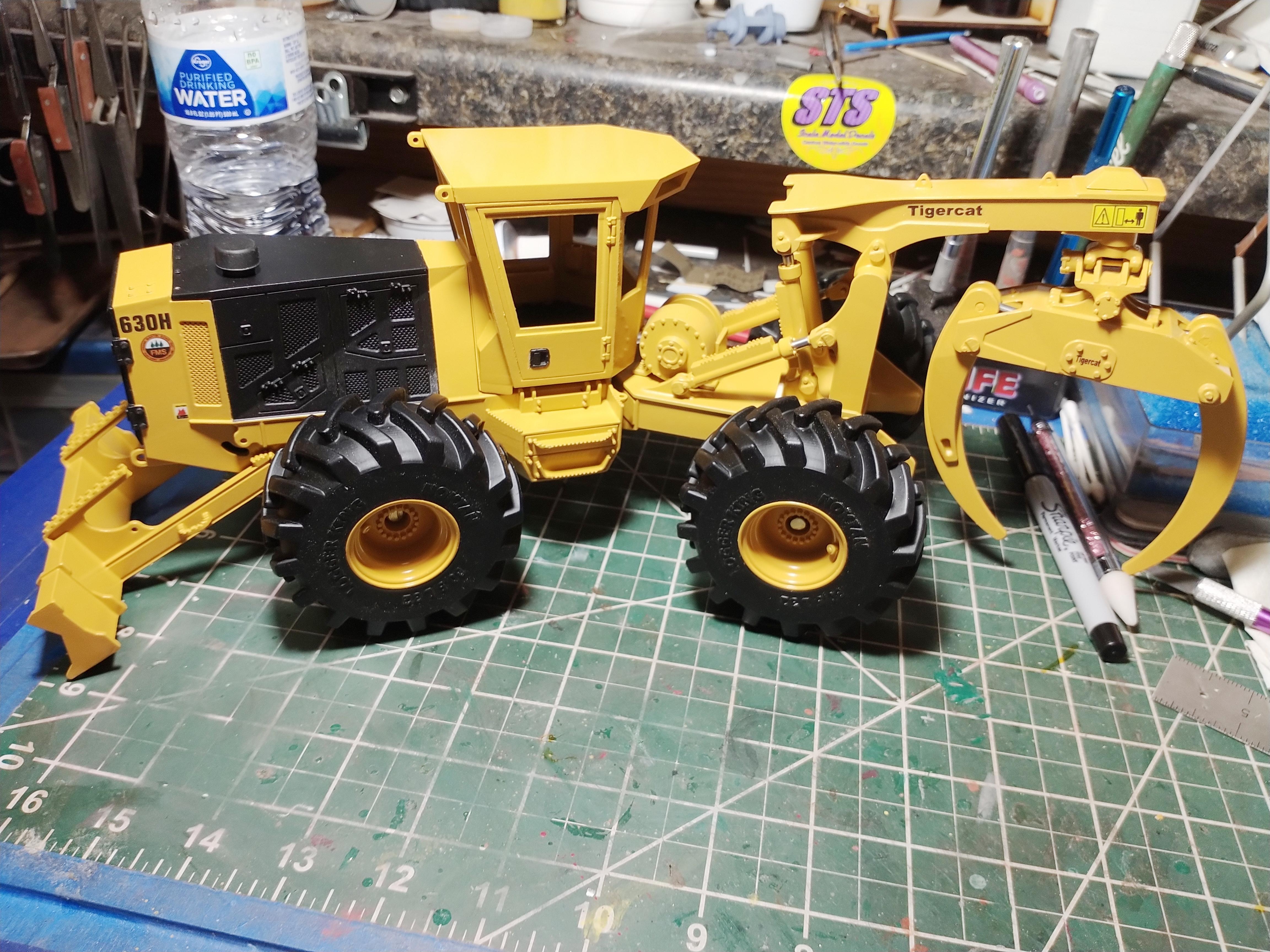

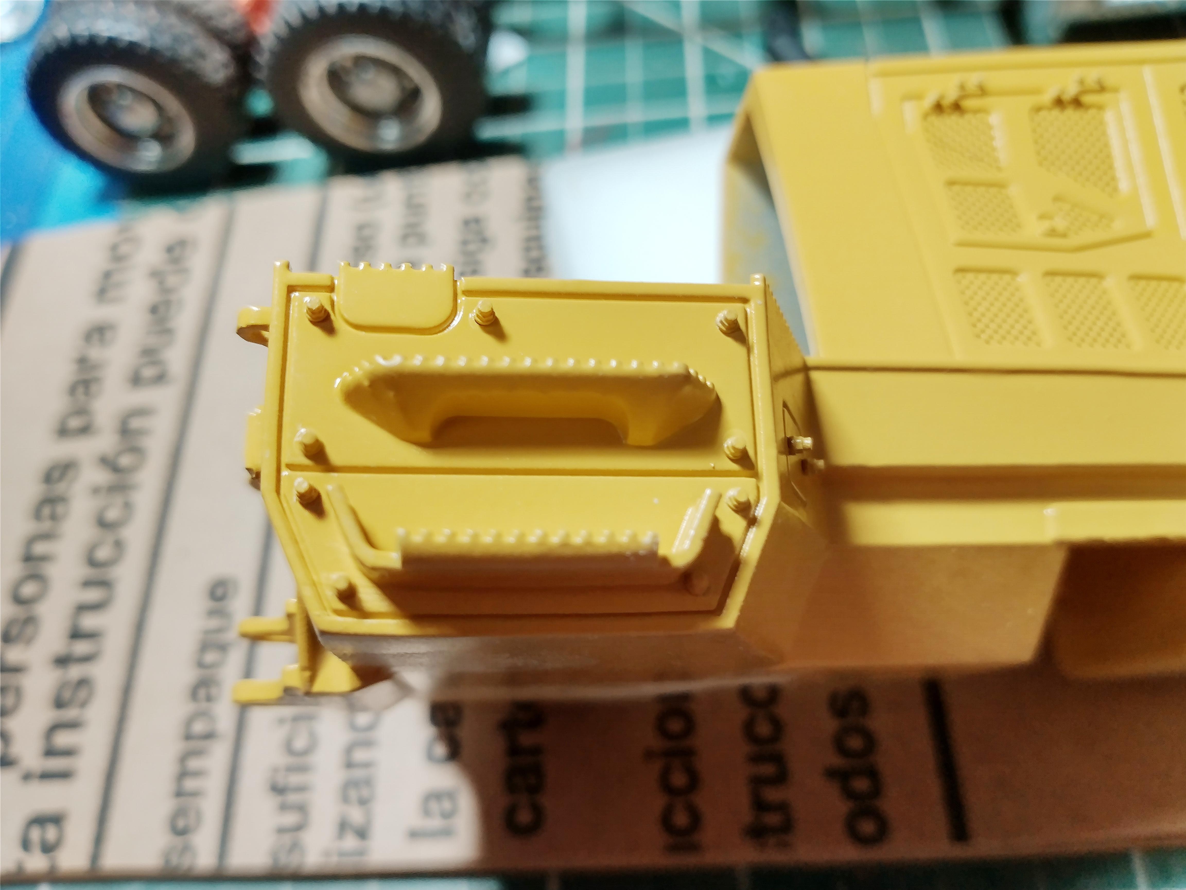

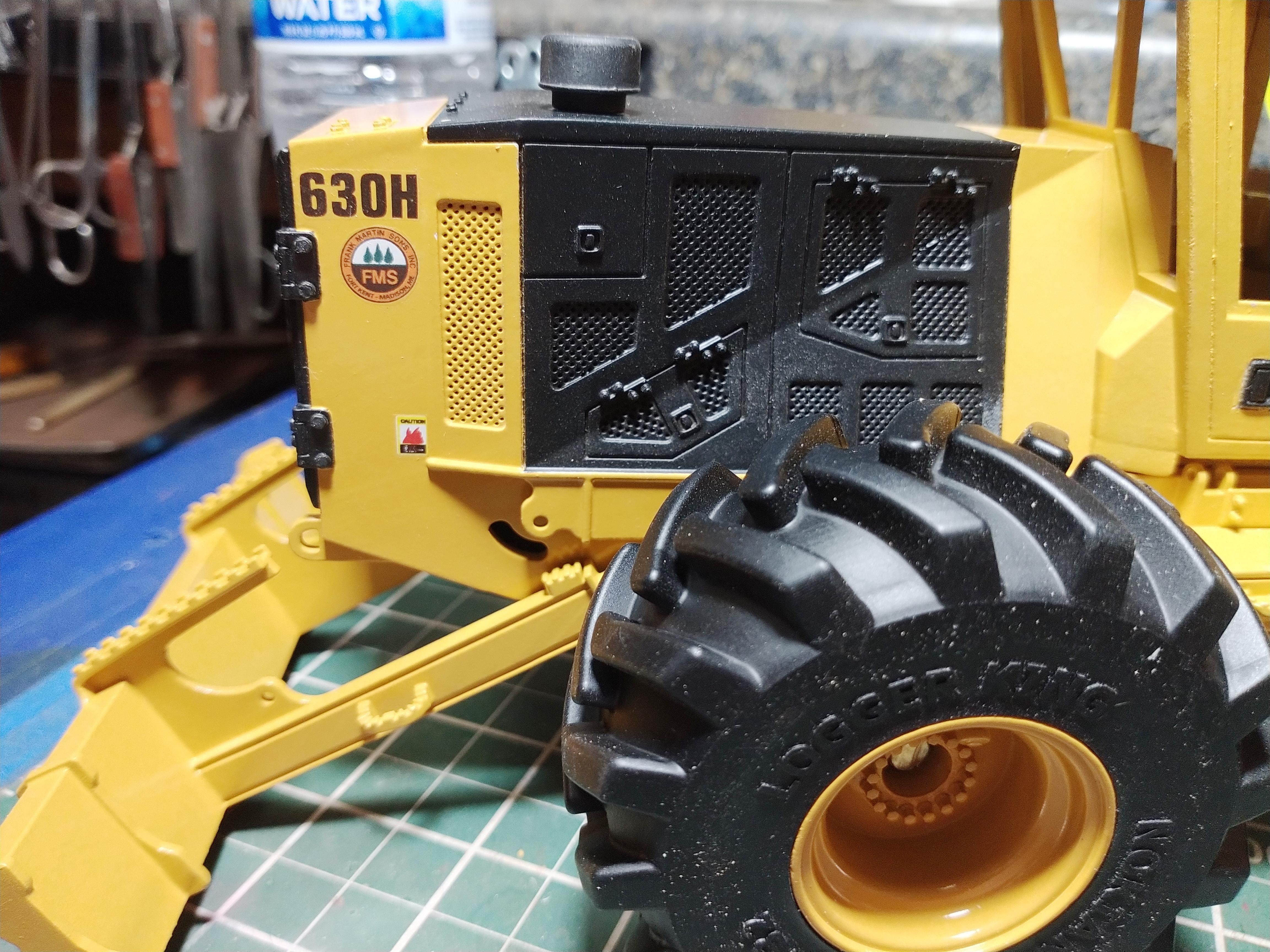

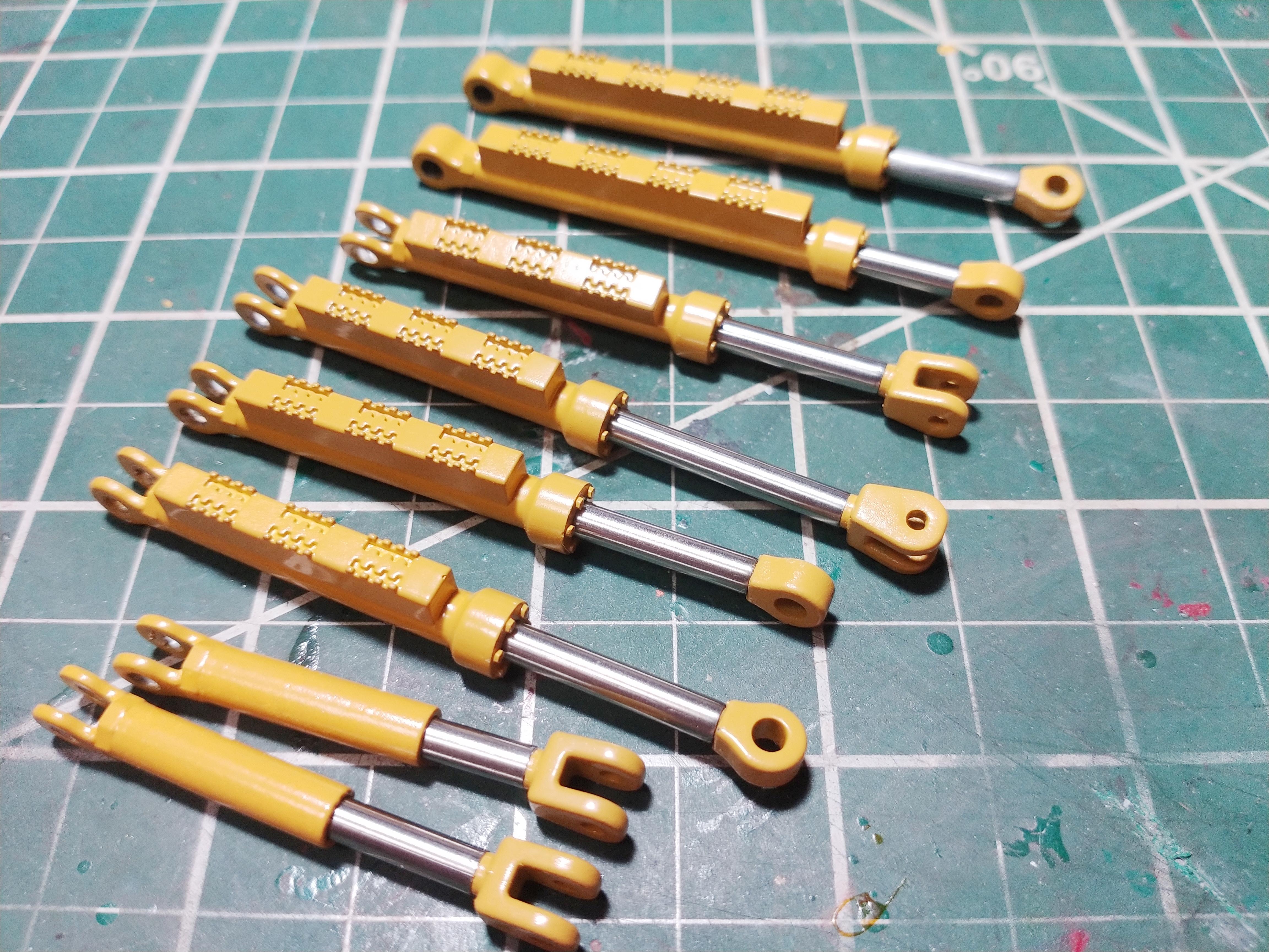

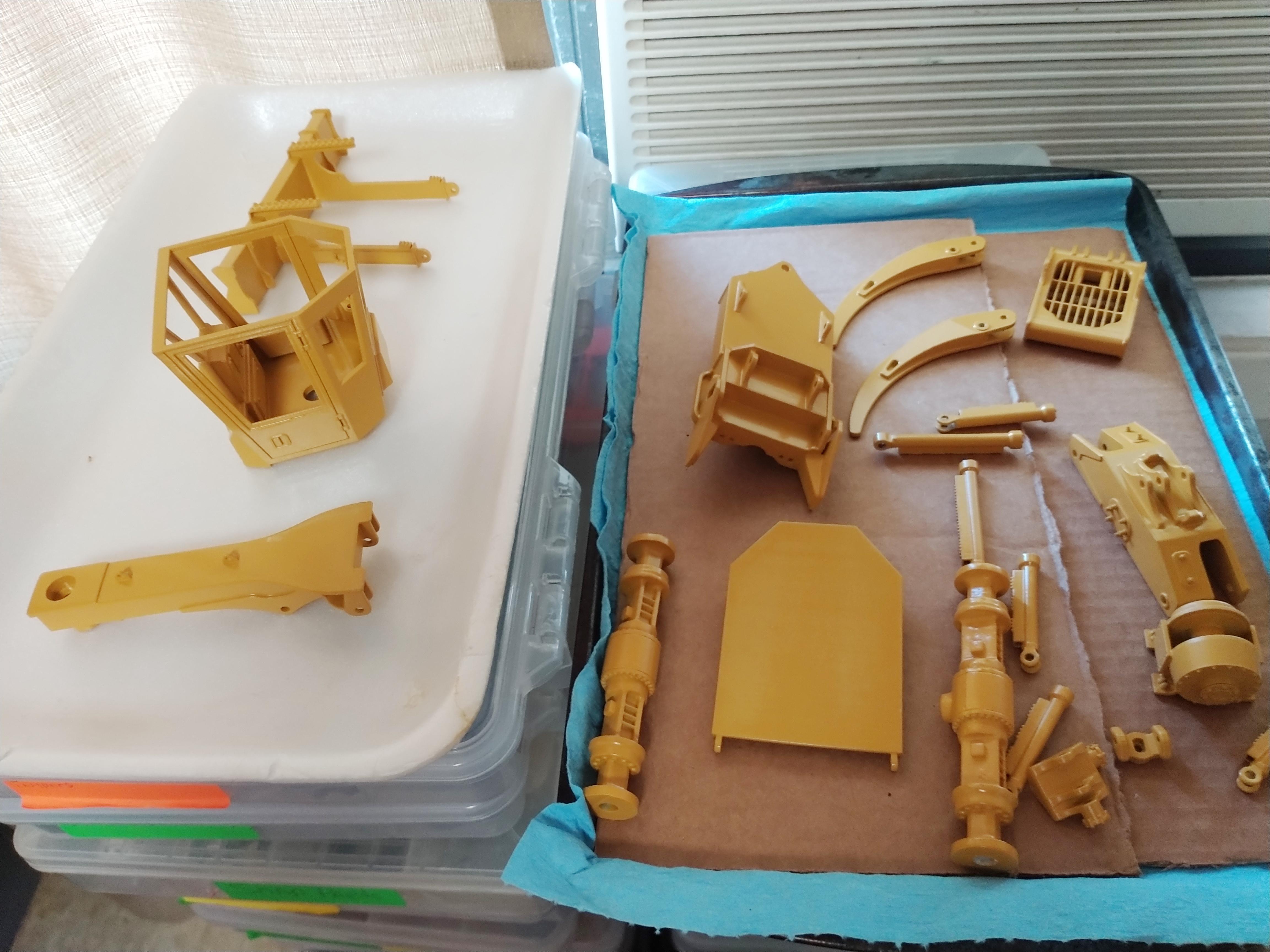

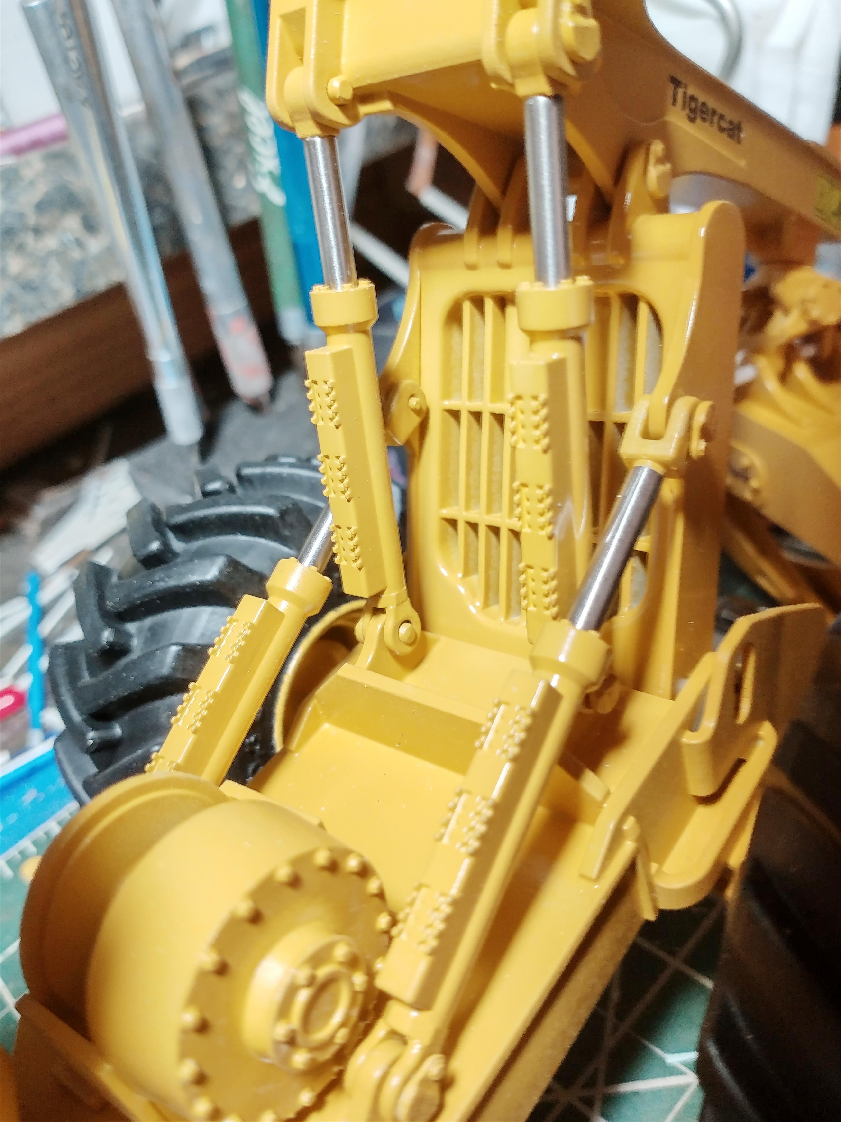

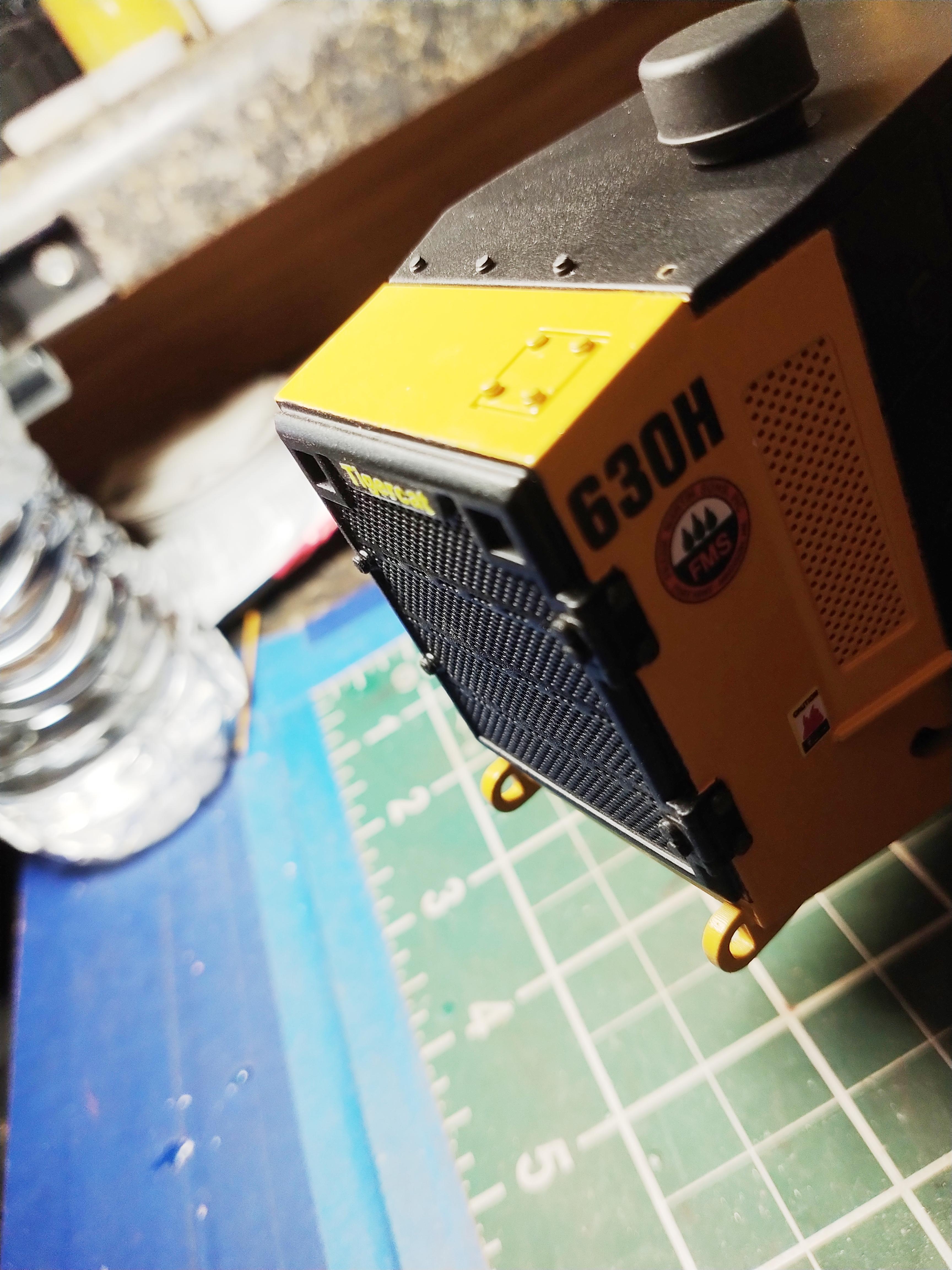

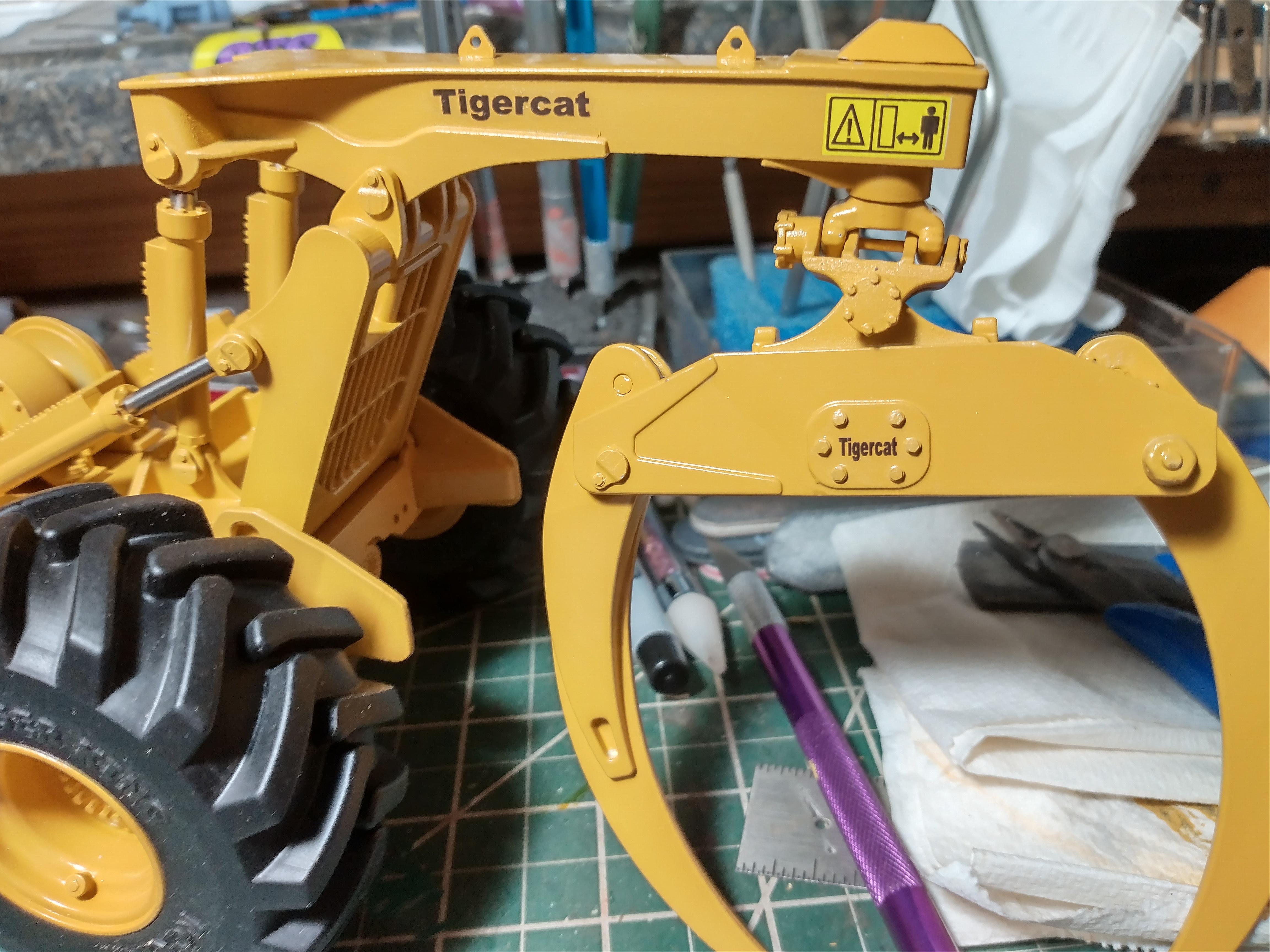

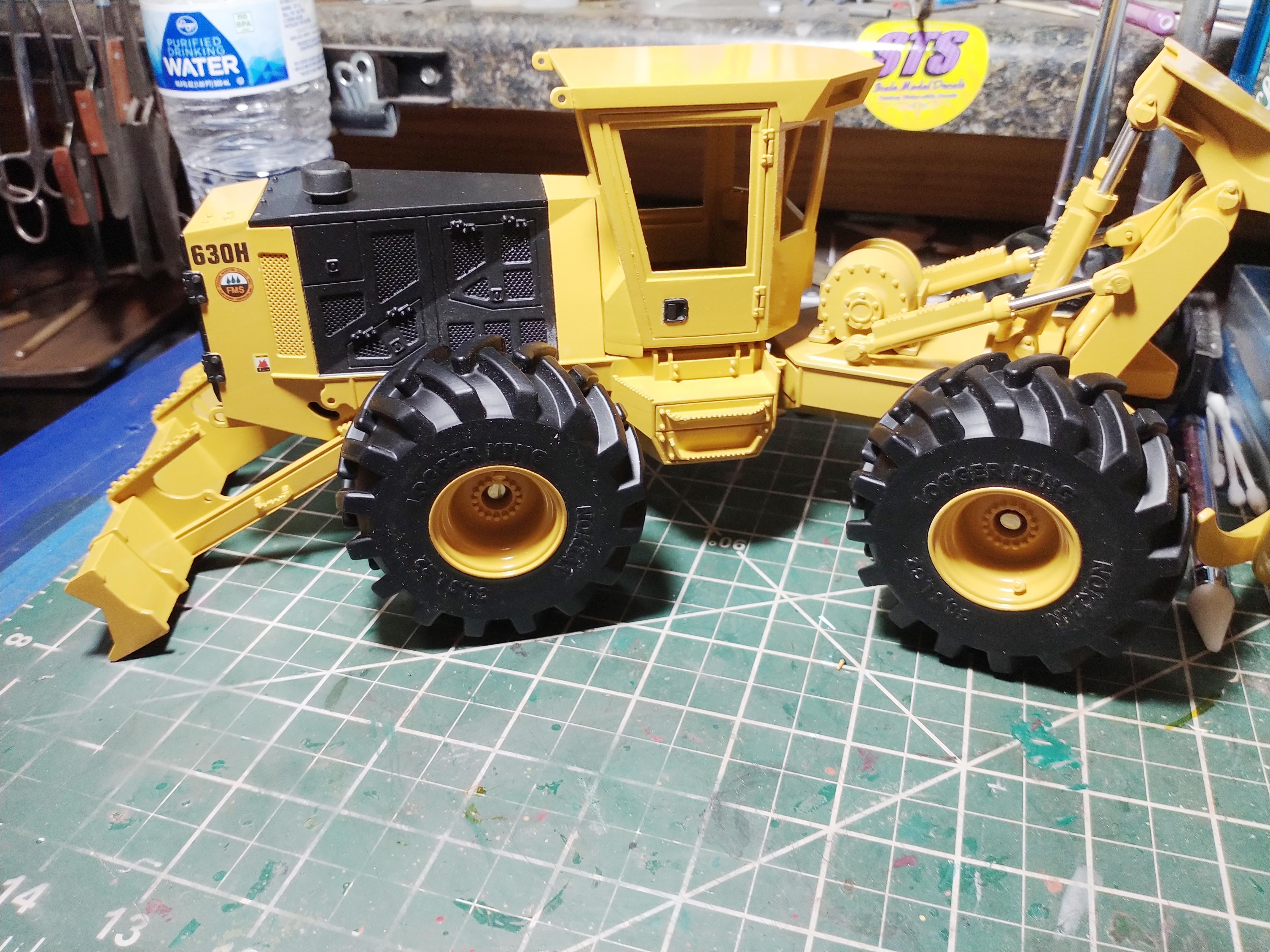

Swamp Dog Posted Wednesday at 06:24 PM Posted Wednesday at 06:24 PM Been working on this off & on for a few months. everything has been painted. the hardest part so far was adding the small engine cover bolts. cylinder shaft are made with uxcell 304 Stainless Steel and inter K&S tubing. looks way more better than any painted or bare metal foil plastic. i had to use two different size as i could not find the right OD & ID in the same size tubing. mounted cylinders beside the blade and cylinders on each side of the pivot point. installed the log grapples, added decals. i just temporary pined the two half's together sat the cab , winch, blade & tires on it to see what it looks like. a 3/16 brass rod runs thru the axles to inside the tires. sure gonna be hard for me to dirty it up...lol..still a long way to go. 12

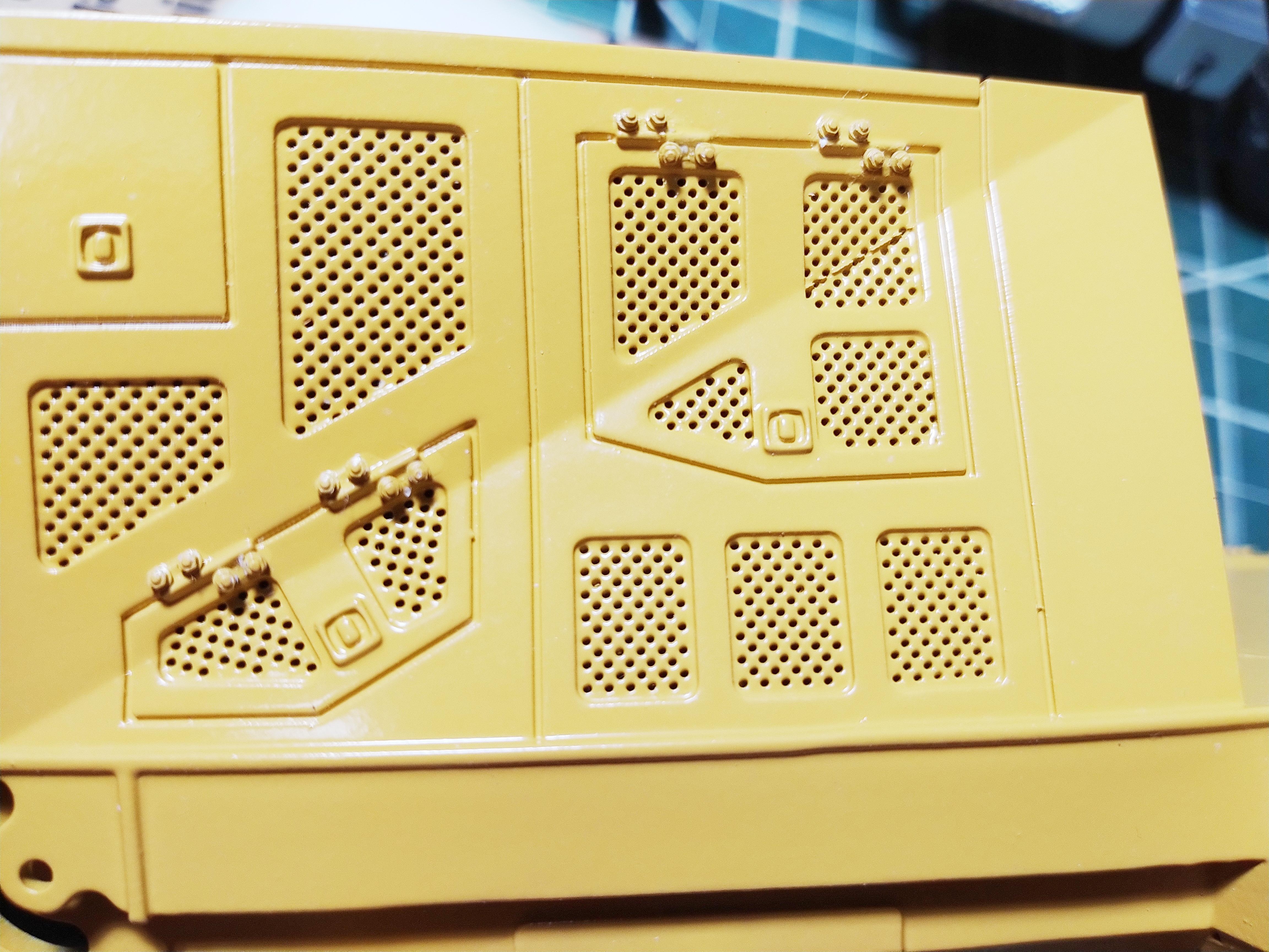

Swamp Dog Posted Wednesday at 06:27 PM Author Posted Wednesday at 06:27 PM woops i see one of my hood bolts fell out.. gonna fire that mechanic..lol 4
Gary Chastain Posted Wednesday at 08:49 PM Posted Wednesday at 08:49 PM Ok David, is this kit? Or are you scratch building this one? Either way, wow, what a cool build. 1

Scott Eriksen Posted Thursday at 01:08 AM Posted Thursday at 01:08 AM (edited) Is that a diecast kit? Looks good! ..........oh wait I should read everything 1st before typing,,,lol 3D PRINT! awesome ,,,,,,,,,engine detail ?? Edited Thursday at 01:11 AM by Scott Eriksen 1
Swamp Dog Posted Thursday at 11:37 PM Author Posted Thursday at 11:37 PM (edited) On 10/8/2025 at 3:49 PM, Gary Chastain said: Ok David, is this kit? Or are you scratch building this one? Either way, wow, what a cool build. thanks Gary, its 3D Printed. Edited Friday at 12:09 AM by Swamp Dog

Swamp Dog Posted Friday at 12:08 AM Author Posted Friday at 12:08 AM 22 hours ago, Scott Eriksen said: Is that a diecast kit? Looks good! ..........oh wait I should read everything 1st before typing,,,lol 3D PRINT! awesome ,,,,,,,,,engine detail ?? thank you Scott, no engine. 1
The Brush Posted Friday at 10:55 AM Posted Friday at 10:55 AM (edited) This is the one of best 3D printed models i`ve seen , finish & detail are spot on. Well done. Edited Friday at 03:57 PM by The Brush spelling 1

Chariots of Fire Posted 17 hours ago Posted 17 hours ago That's really something! However, I have never seen one quite so clean and neat! Time to get it just a little bit dirty and with the paint taken off the claw and plow! 😎
Rockford Posted 15 hours ago Posted 15 hours ago On 10/8/2025 at 7:27 PM, Swamp Dog said: woops i see one of my hood bolts fell out.. gonna fire that mechanic..lol You only ever need half the bolts the manufacturer supplies. The rest are spares. 2
Swamp Dog Posted 13 hours ago Author Posted 13 hours ago 3 hours ago, Chariots of Fire said: That's really something! However, I have never seen one quite so clean and neat! Time to get it just a little bit dirty and with the paint taken off the claw and plow! 😎 i have not made up my mind yet if im gonna leave it as a new Skidder headed to the woods on mud it up yet. ether way it will be on a trailer hooked to a R Mack. 1
Chariots of Fire Posted 13 hours ago Posted 13 hours ago No mud. Just a little wear at typical places where the paint would rub off.😃 1

Chariots of Fire Posted 9 hours ago Posted 9 hours ago 2 hours ago, bytownshaker said: Wow! one of the most amazing projects I've seen in a while. It will hard to dirty it up but it bring out all the detail. Maybe not so much. Things like hydraulic fluid around pistons, grease drippings around articulation points, etc. bright shiny bare metal for the grabber surface and blade on the rear, dusty but not muddy tires, slightly worn tire contact surfaces. Even worn off paint where the operator walks and grab handles, door edges where constant contact wears the paint off. These kinds of things are easy to do with light washes, weathering powders and the like and they don't take away from the details of the piece. They just enhance without making it look like a muddy mess. 1
