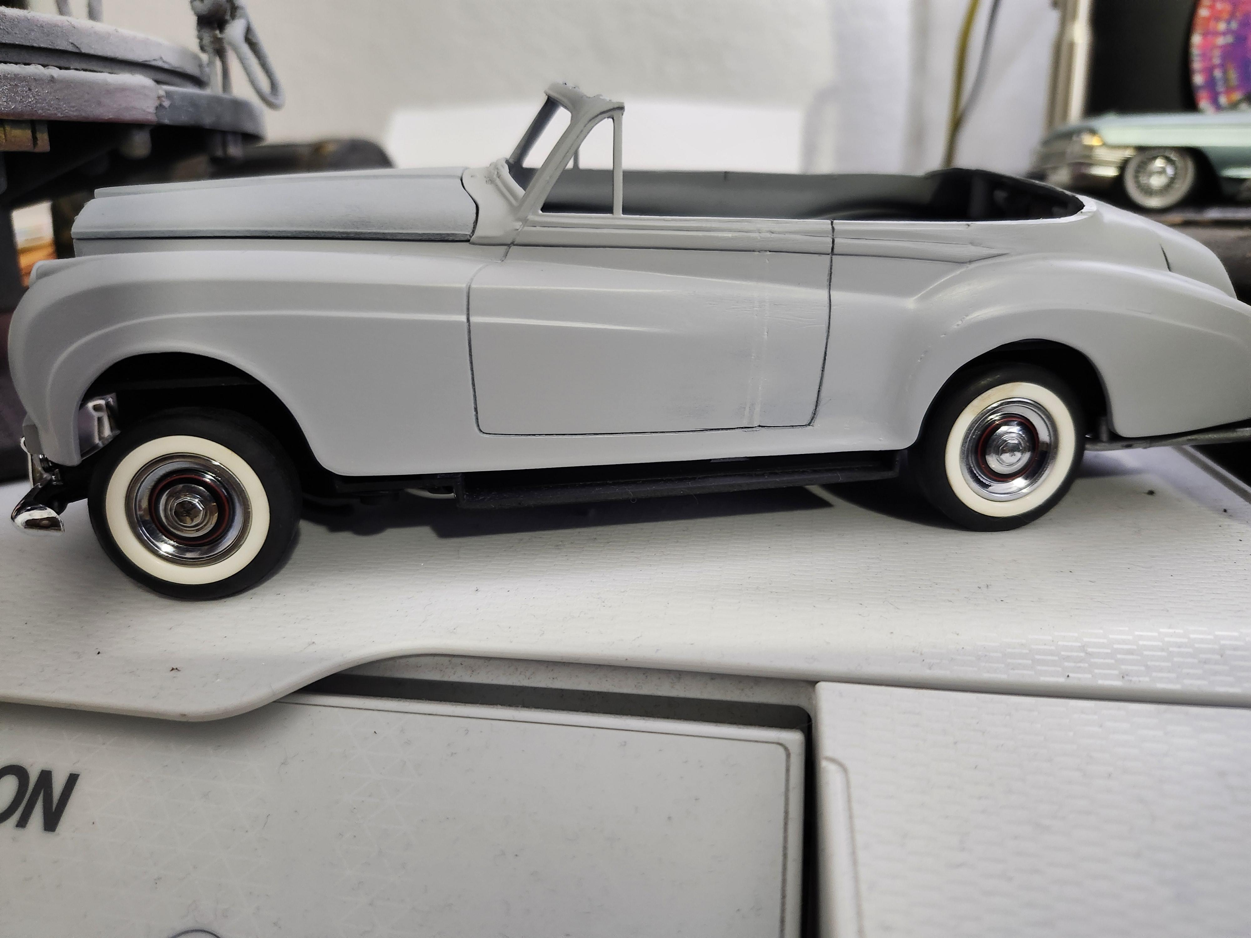

Perspect Scale Modelworks Posted October 17 Posted October 17 After reading Tomy124's post asking for ideas on making convertible boots, I was motivated to start a project I've been thinking about for a very long time (as if I don't have way too much on my plate already). I don't post WIPs very often because I can be an extremely slow builder, and many times when I get into a groove, I fail to stop and take pictures. Hopefully this will help me stay focused and get it done. This is the kit I built many years ago. This is what I'm aiming for: And this is where I am so far: It was a bit painful cutting her up, but hopefully it will be worth it. My hesitation has been how to make the boot, so we'll see what happens. 8

Perspect Scale Modelworks Posted October 17 Author Posted October 17 (edited) 2 hours ago, Big Messer said: Looks like the front door should be longer and the wheelbase shorter. Pretty common. When doing a conversion like this I first take pictures of the original model and then mess with them in any photo editing program. Yes, the front door will be extended rearward. Fortunately the wheelbase can go unchanged. According to my research, the drophead wheelbase is about 127 inches, or 3226 mm. My measurement for the 1/24 scale model is 128.35 mm, which would be 3081 mm in 1:1. So I'll be a bit short but close enough for me, and I think visually it should be ok. Edited October 17 by Perspect Scale Modelworks 1

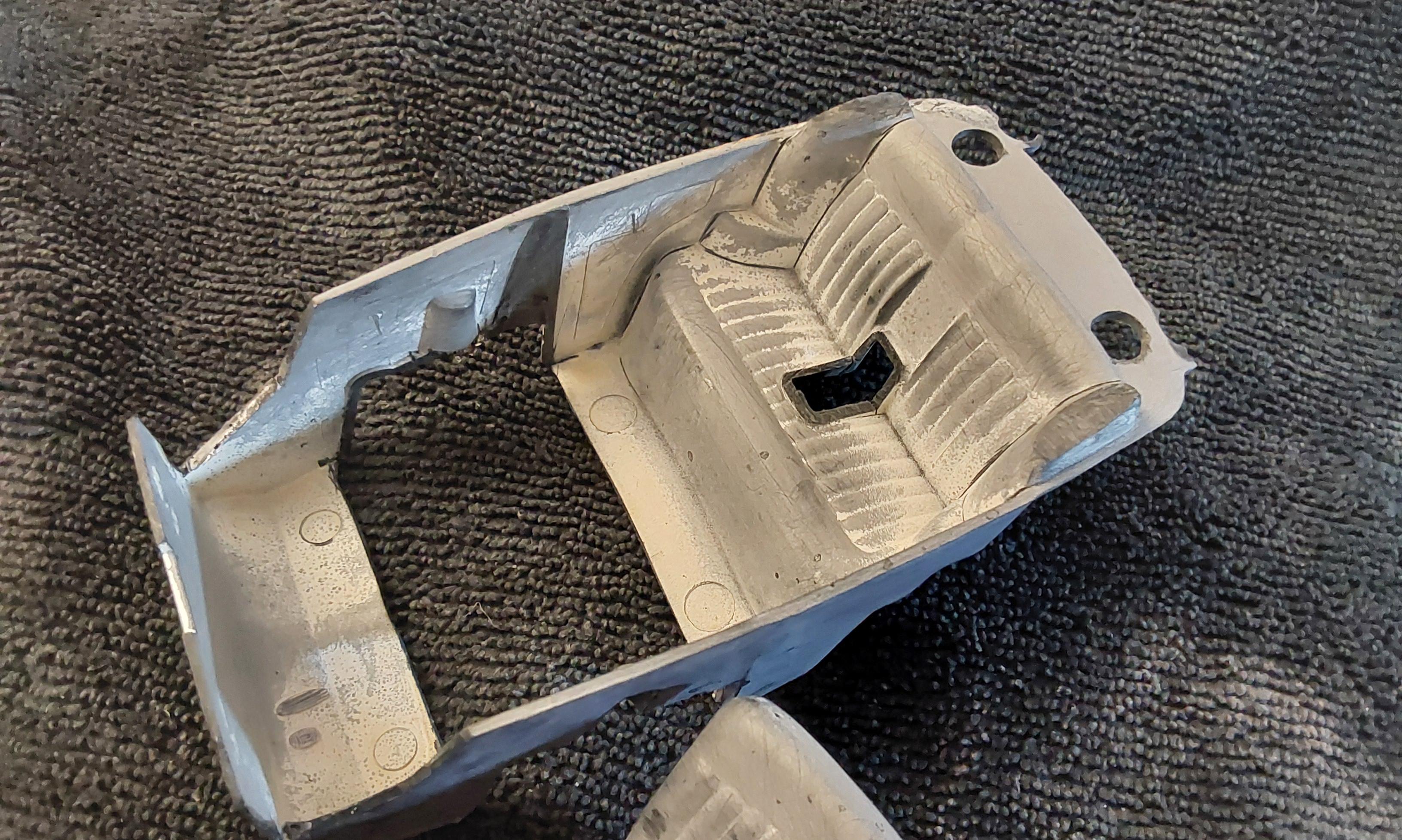

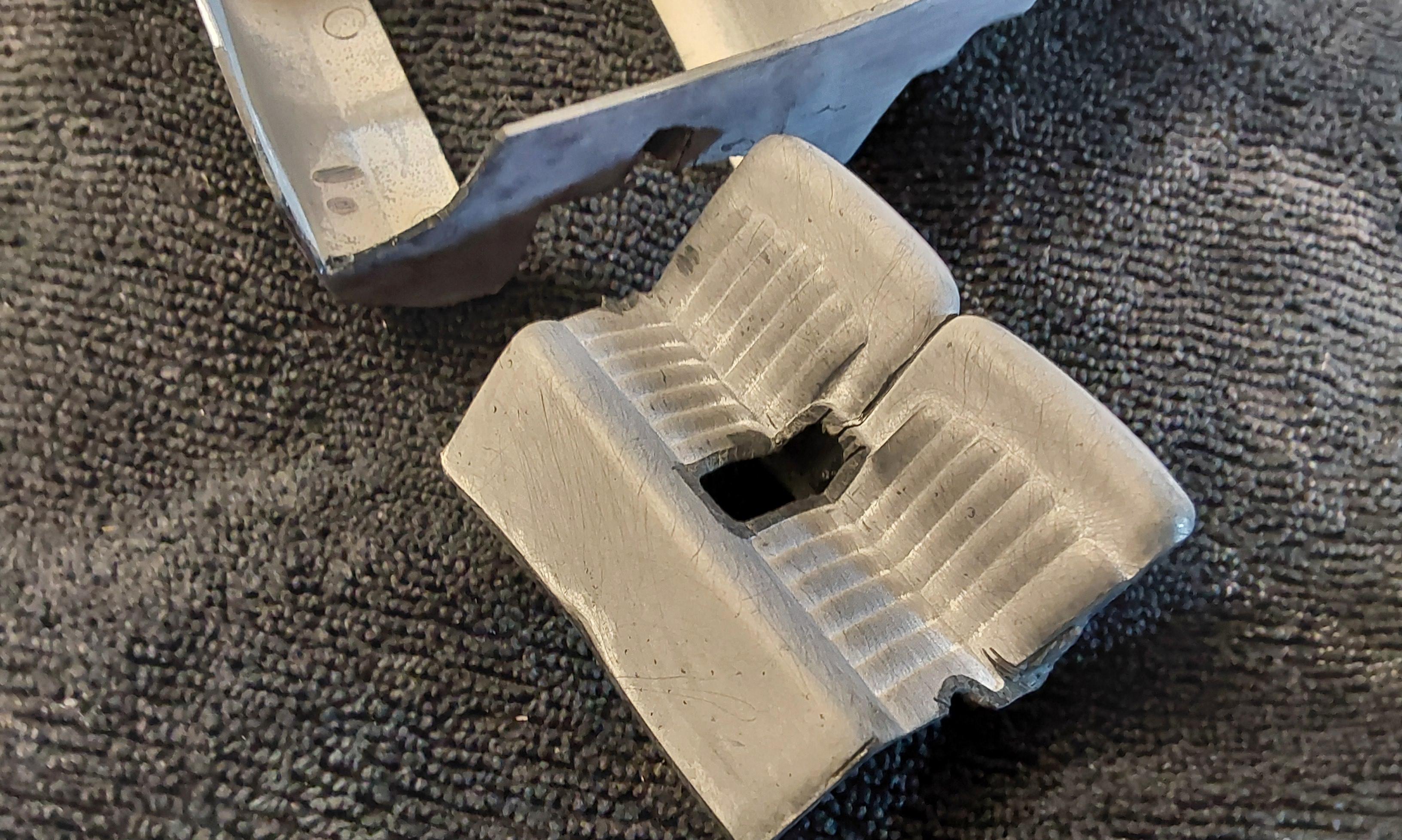

Perspect Scale Modelworks Posted October 17 Author Posted October 17 Since the interior will be exposed, I'll have to correct the door panels. I removed the front seat, which I'll clean up and try to make a bit more realistic as much as I can. I'll probably put the center armrest in the up position on the rear seat as well. 3

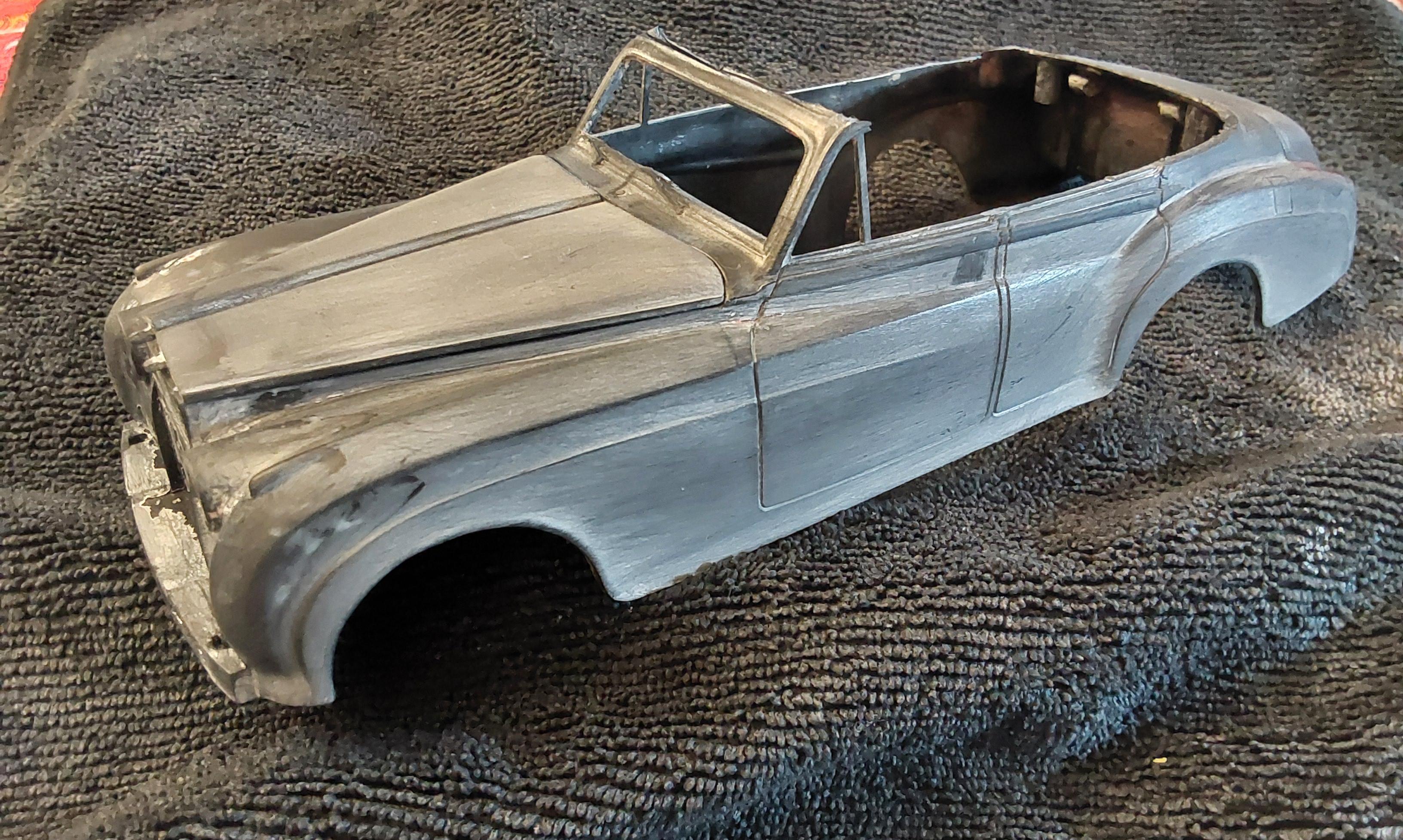

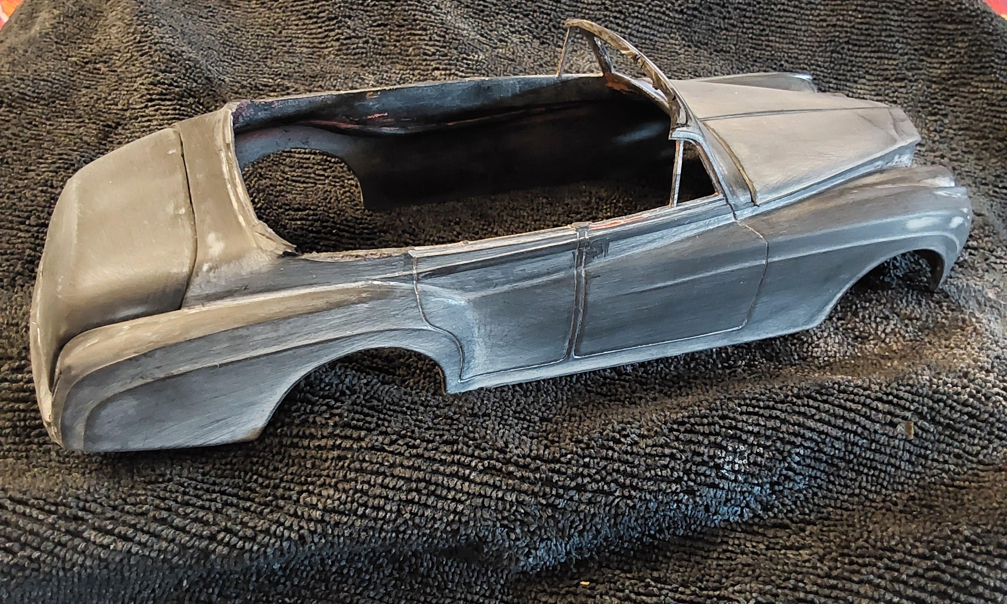

Perspect Scale Modelworks Posted October 31 Author Posted October 31 (edited) I figured before I went any further, it might be a good idea to strip the paint from the body and interior. I don't remember what paint I used but it sure was tough to get off. After a week soaking in the purple pond, the paint only faded but would not come off. I bought a fresh yellow can of Easy-Off which took two rounds of about 2 days each, to strip the paint. After all of that I still had to sand a few spots. There's still some fine tuning to be done before I shoot some primer and see what I have. The interior may need another shot of Easy-Off. Edited October 31 by Perspect Scale Modelworks Spelling 3

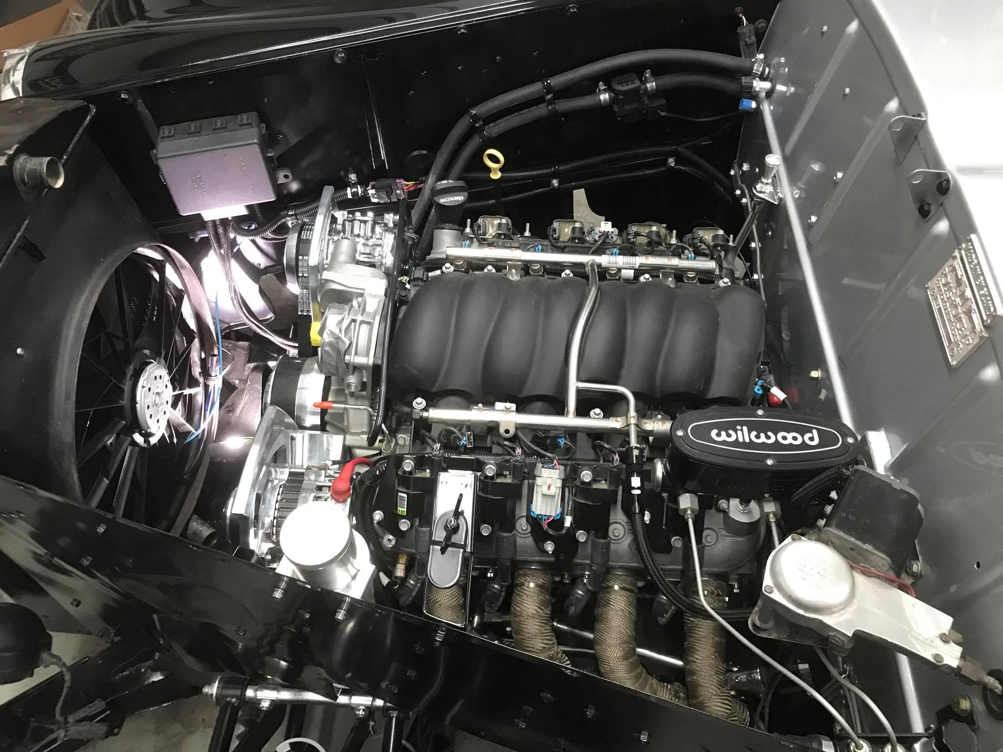

Perspect Scale Modelworks Posted October 31 Author Posted October 31 5 hours ago, Big Messer said: If you feel courageous enough to take apart the Franklin to make a copy of the engine... The Franklin's are 1955, I6, so that wouldn't work for the Silver Cloud II. But, there's always this option: However, I should be able to use the grill, lights, bumpers, and door handles from the Franklin if I can snag one at a reasonable (low) price.
