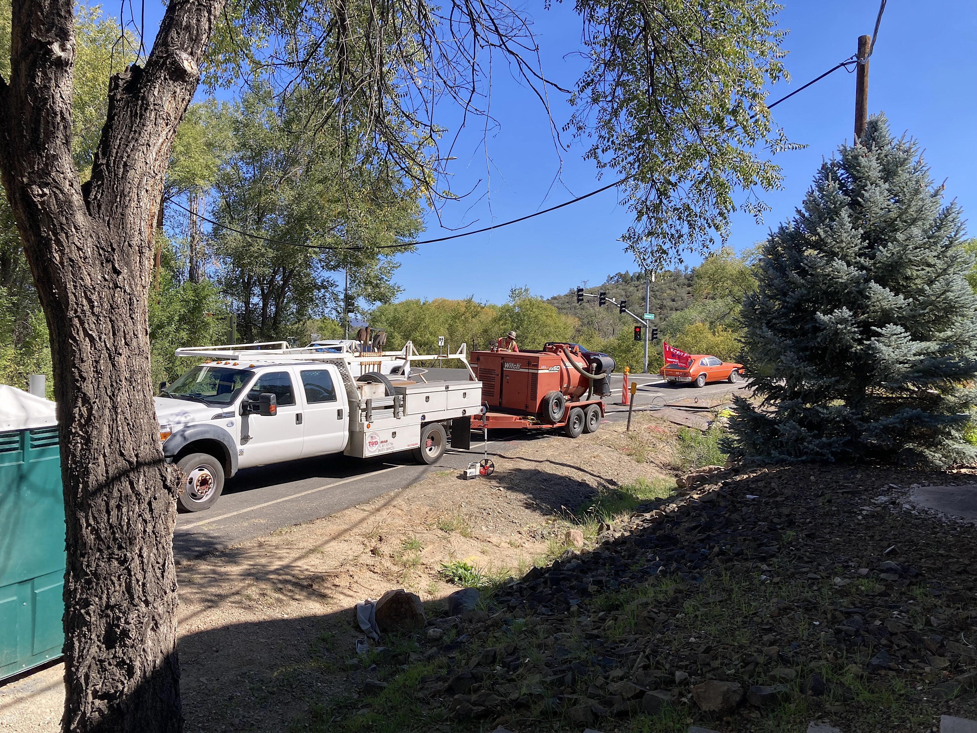

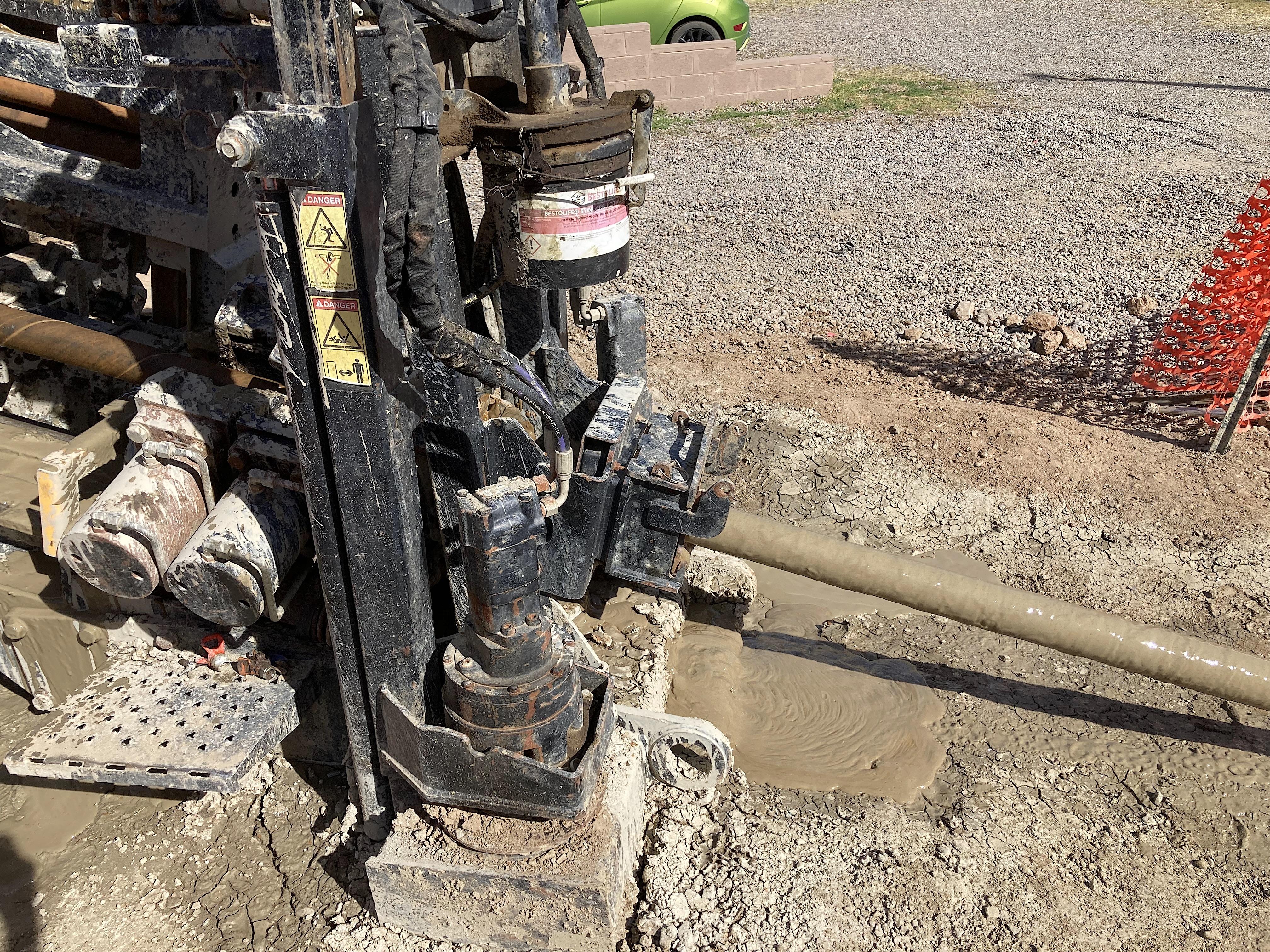

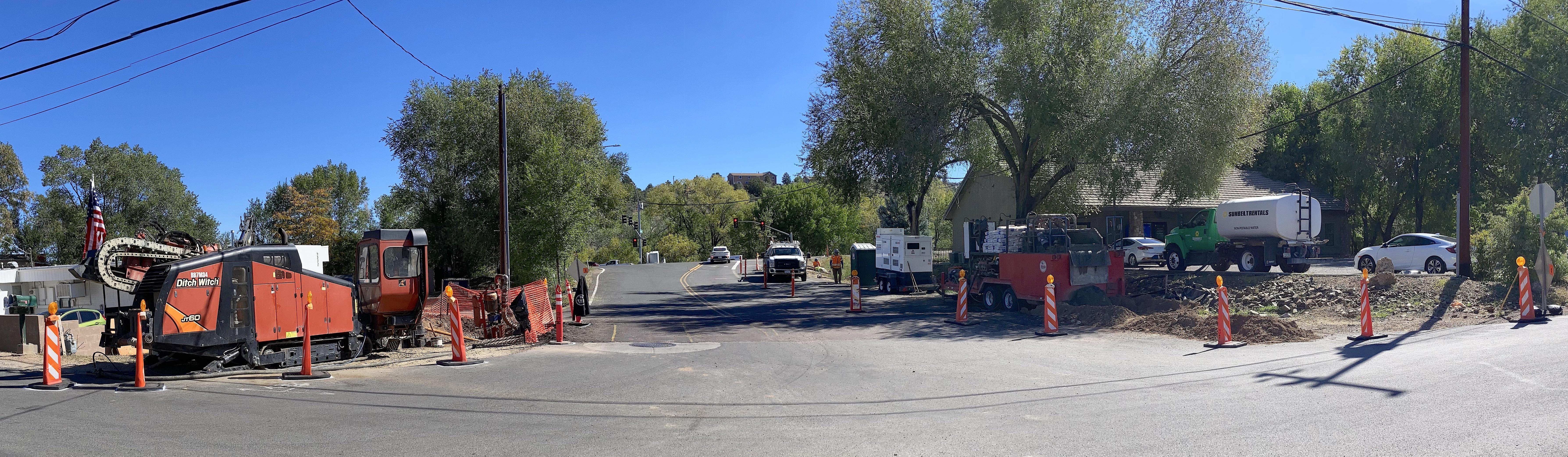

Had to expand on just "boring machine" otherwise no clicks or favs. 😂  I'm one of five on a local Water Improvement District board, with a Manager who does the 24/7 repairs, plus projects like this.  Subcontracted out with a California company.  Last Administration "IRA" grant money, that is administered through the County, found a huge leak under the highway to bypass.  I watched a You Tube University video so now I'm an expert. 🙄  I got the basic idea so I could ask not so dumb questions, and the guy running the rig was glad to show me.  If you want a huge scratch-built project, this is it.  Think of a drag race team, but super slow and muddy. 😏

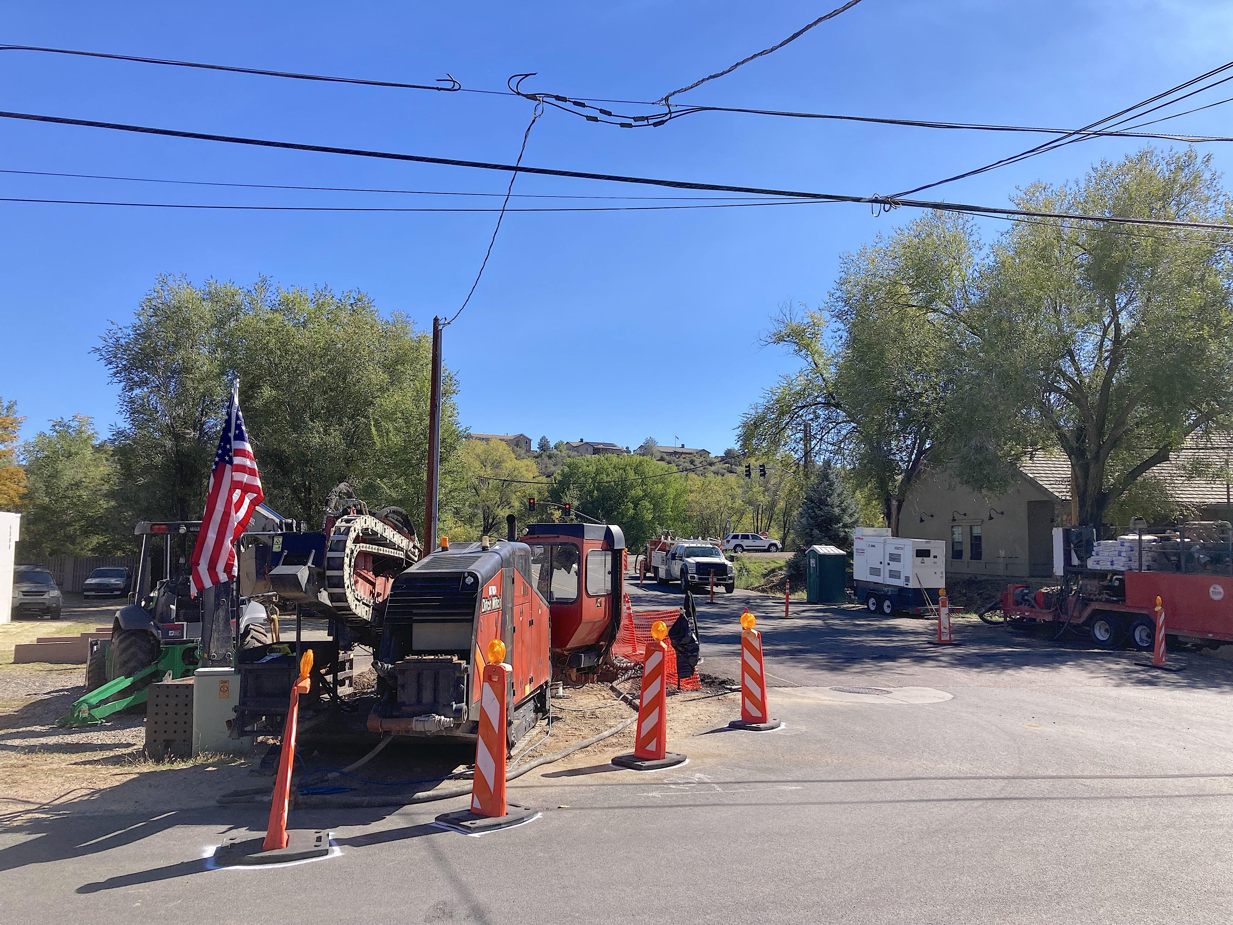

Overall panorama of the whole job.   This would make a cool diorama.  Include the outhouse! 🤪
I bet everyone only sees the orange machine.

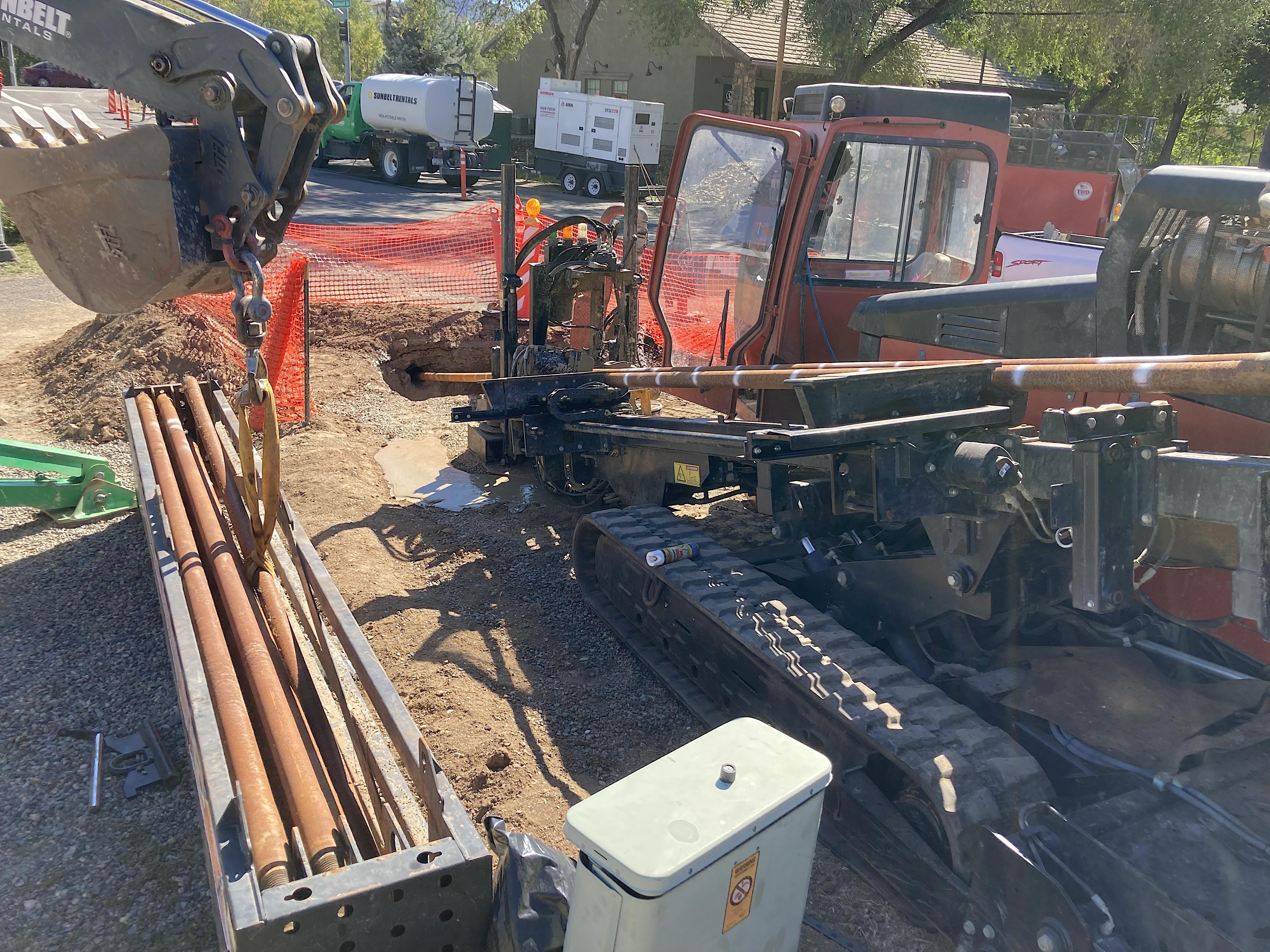

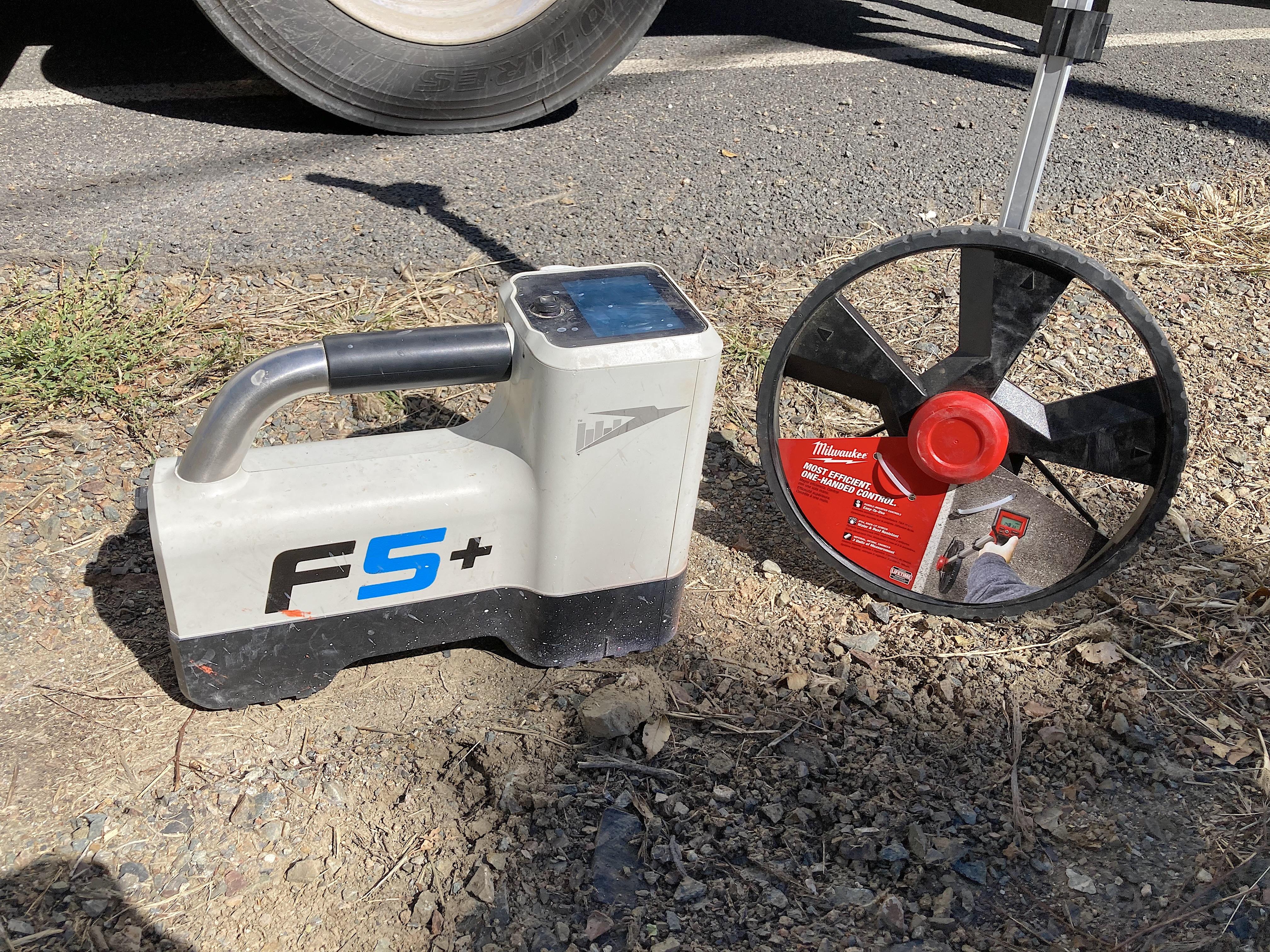

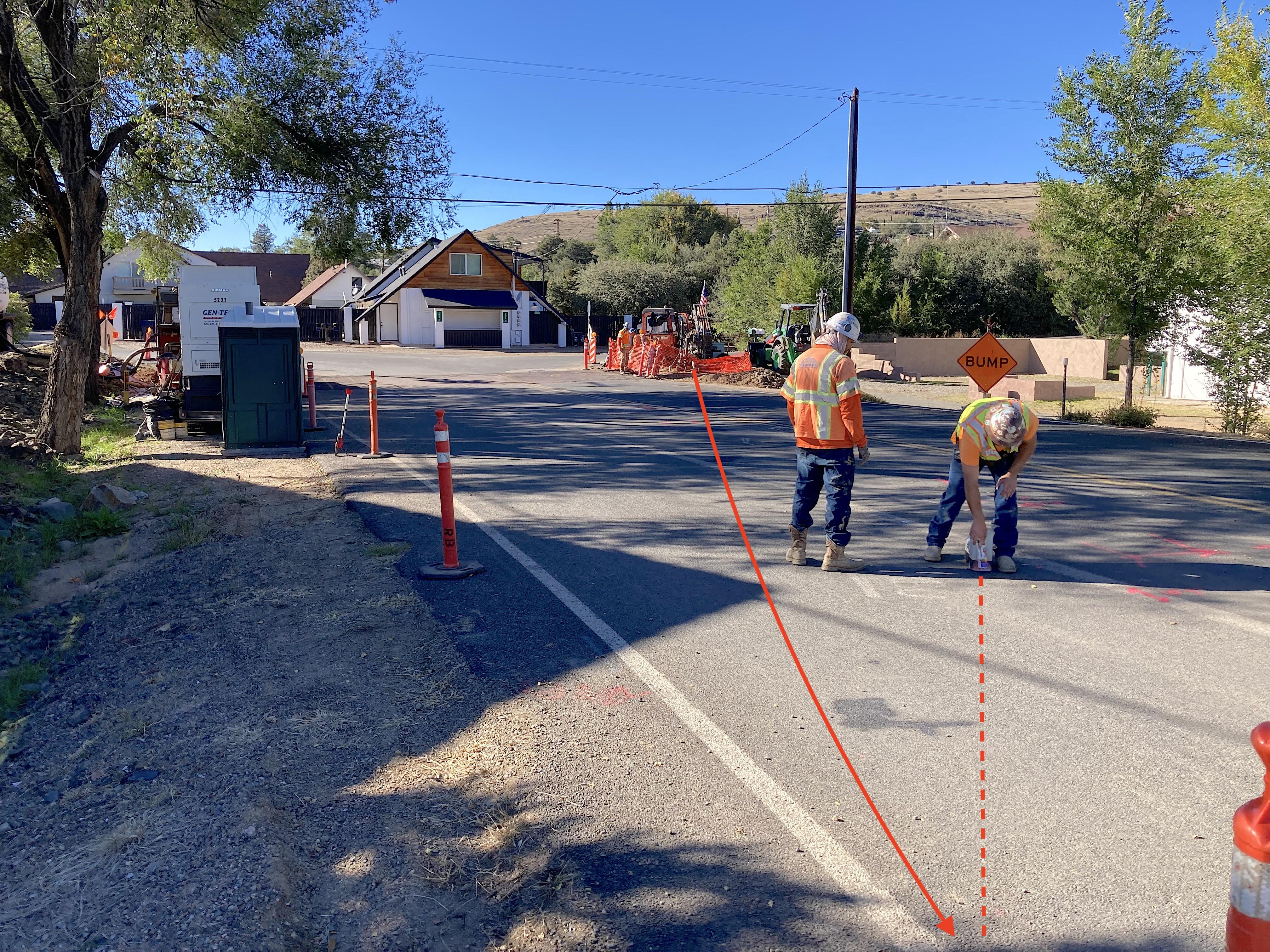

This detects the beacon, to know where the drill bit is.

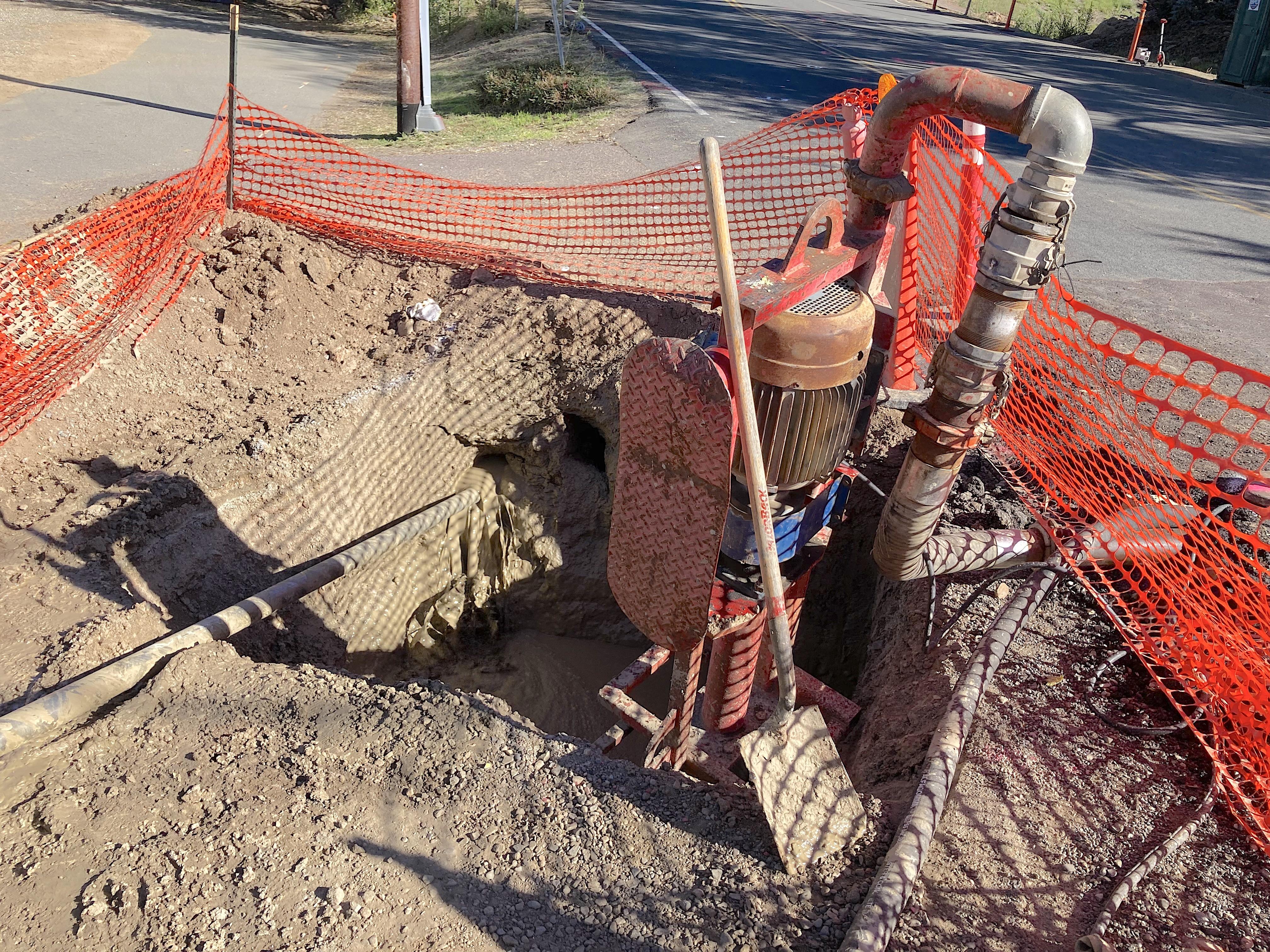

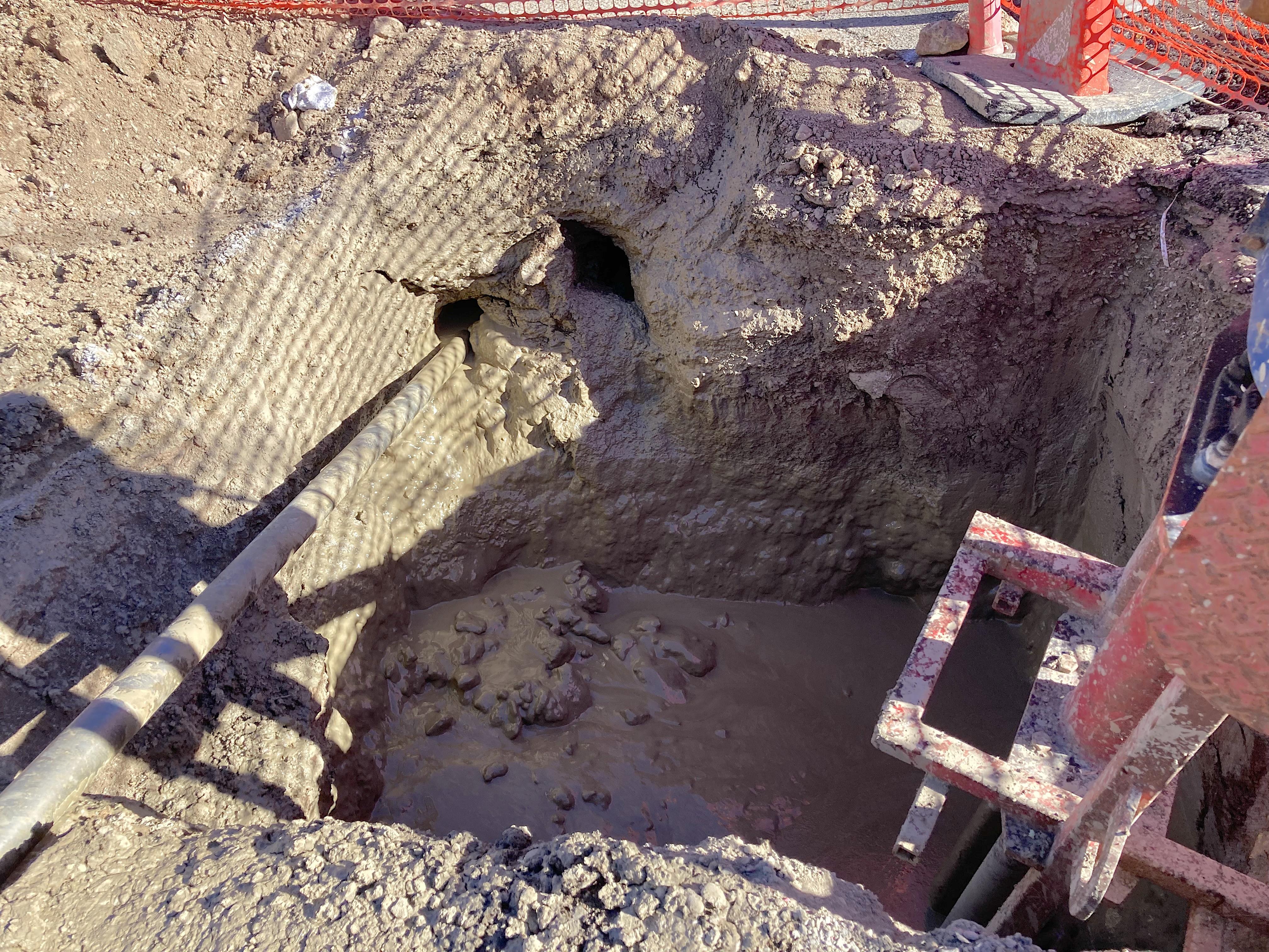

This day it was pot-holing for the gas pipeline, 10 feet apart.  Pinto is a local resident. 🤫

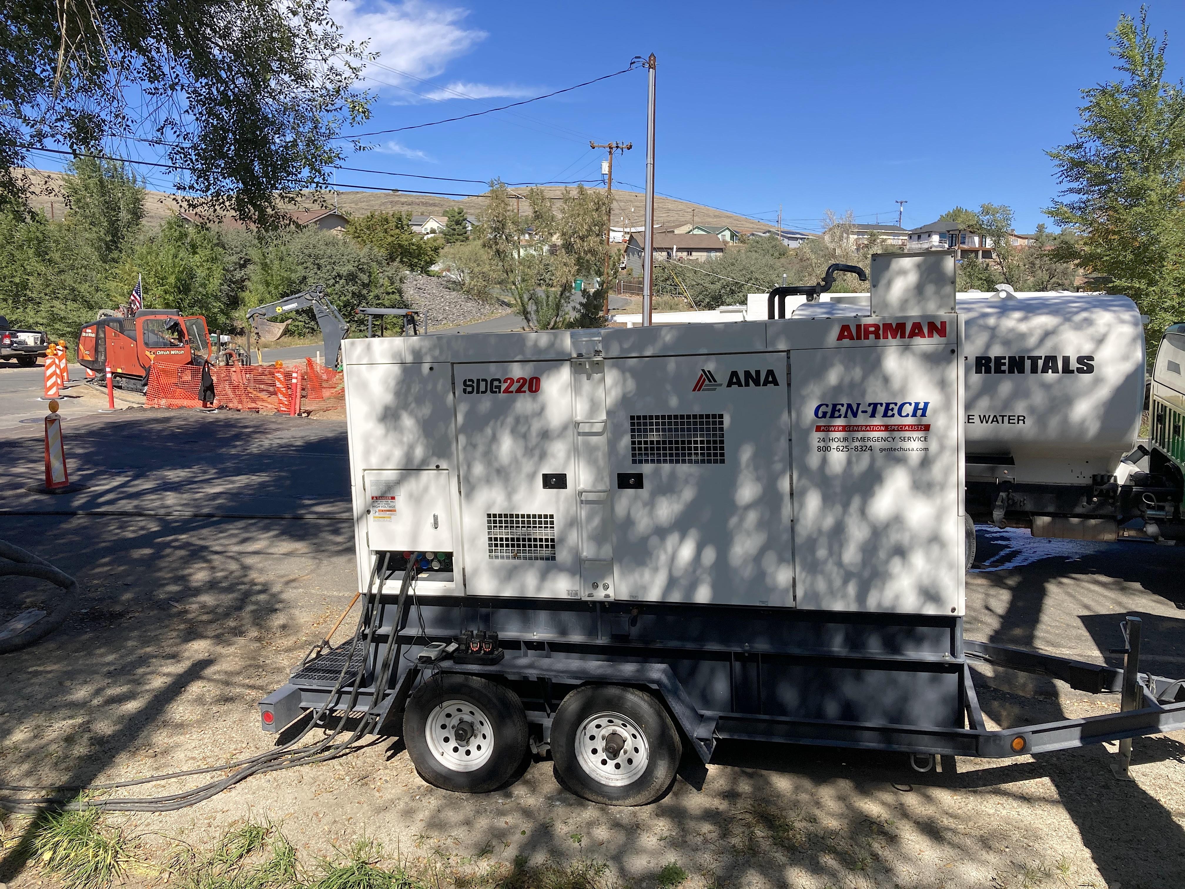

This generator is for the mud/lubricant trailer, to run several big pumps.  A few hoses and cable run over the road.

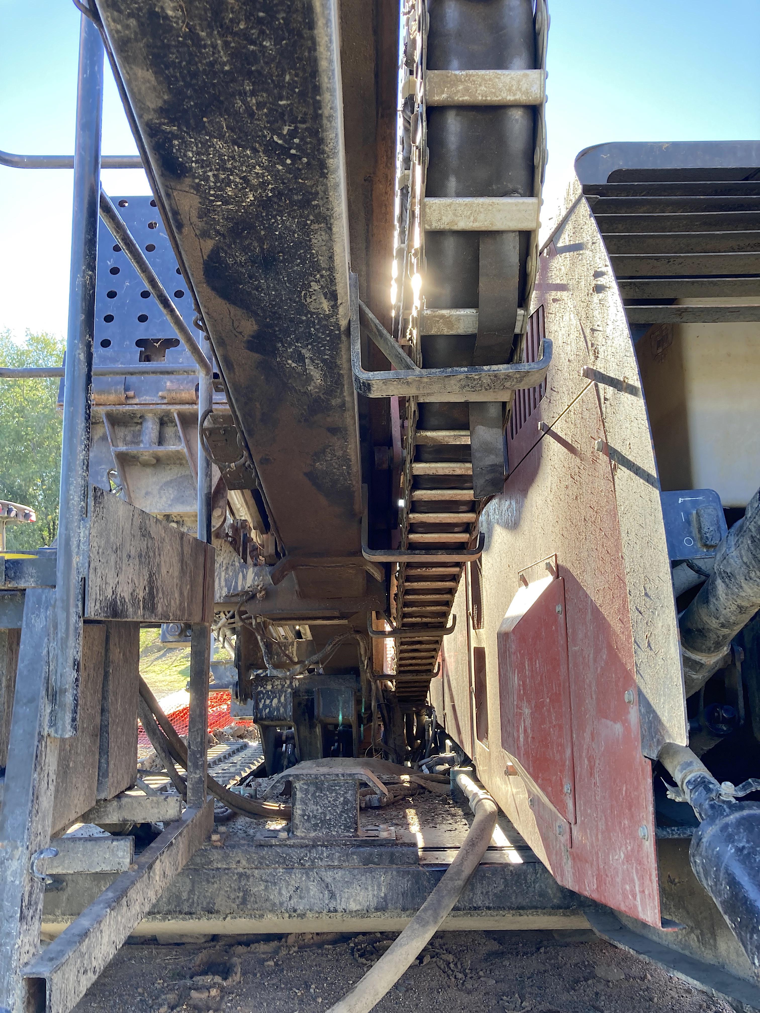

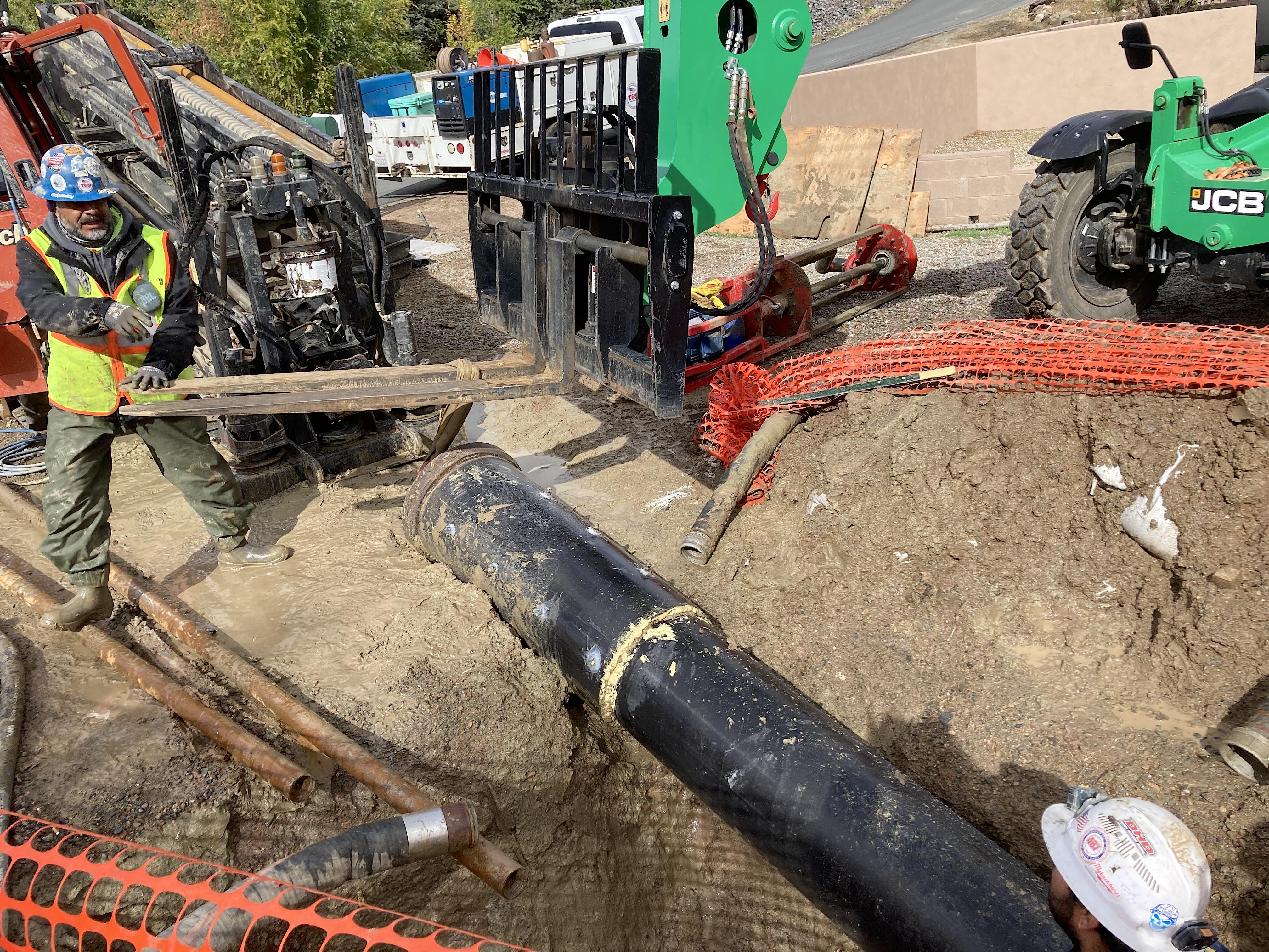

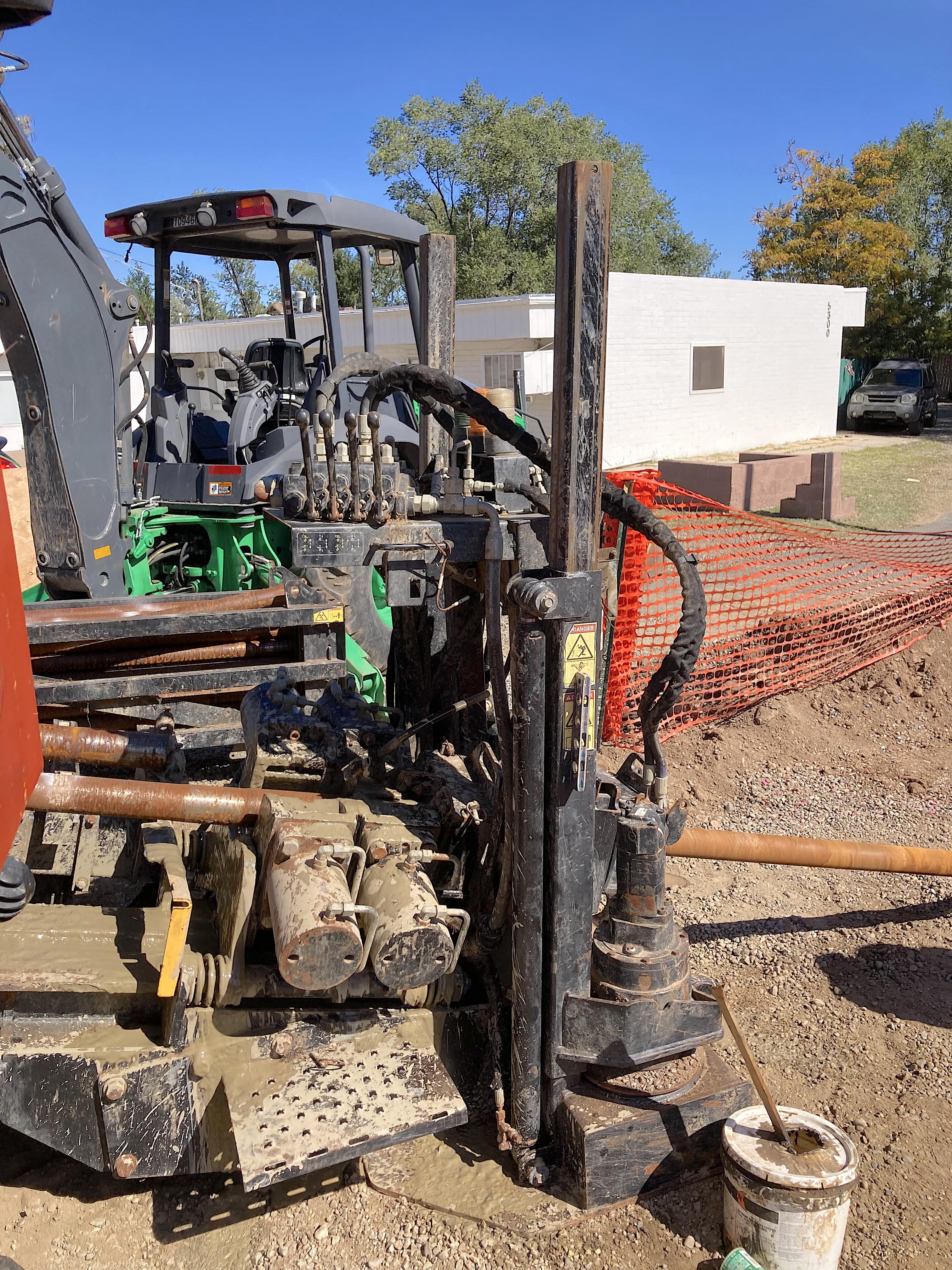

There is a backhoe, water truck and several pickups besides the actual machine.  Two hydraulic vices to un/screw the pipe.
The hoe had lifted the pipe rack onto the machine since I took this picture.

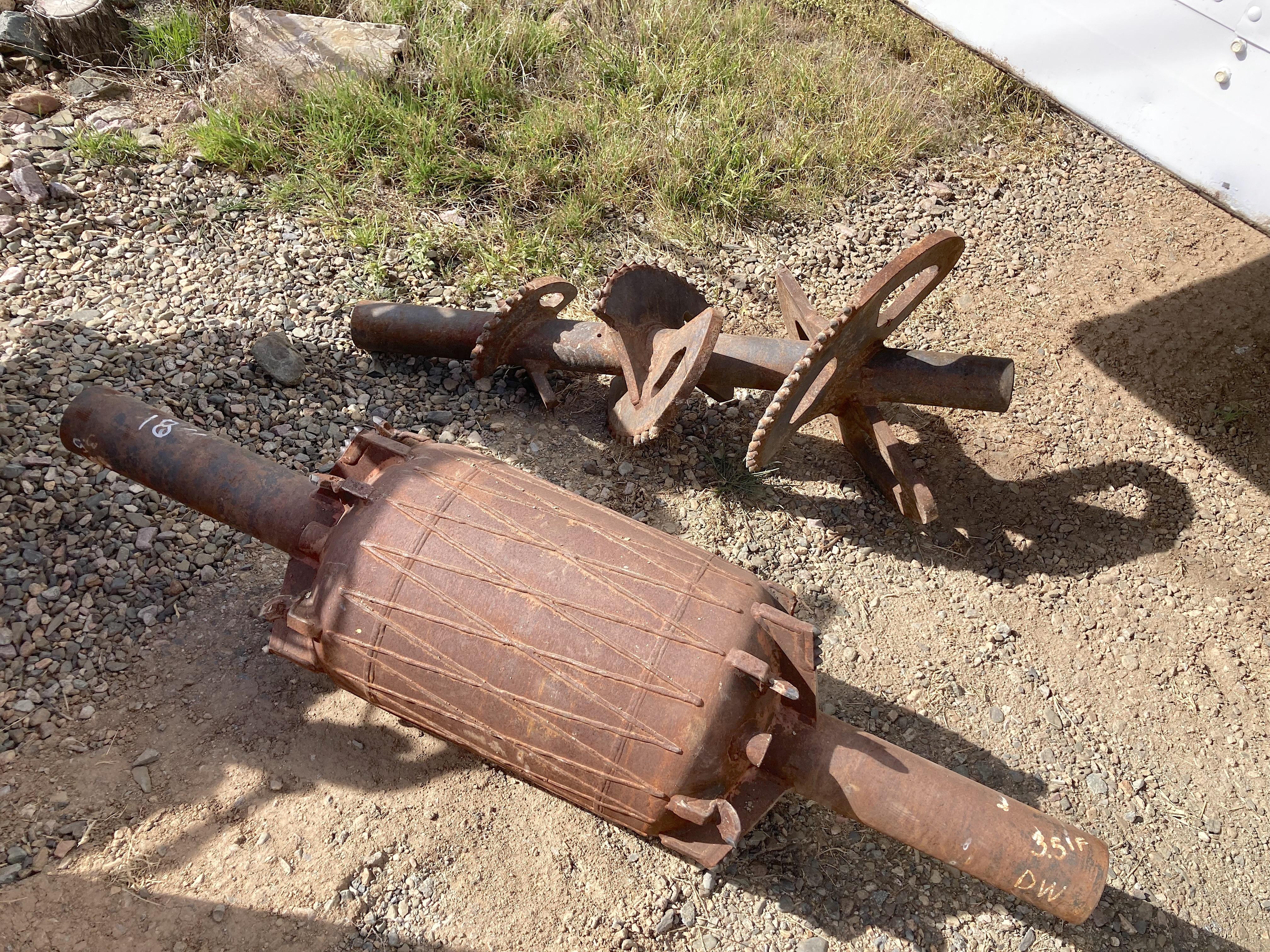

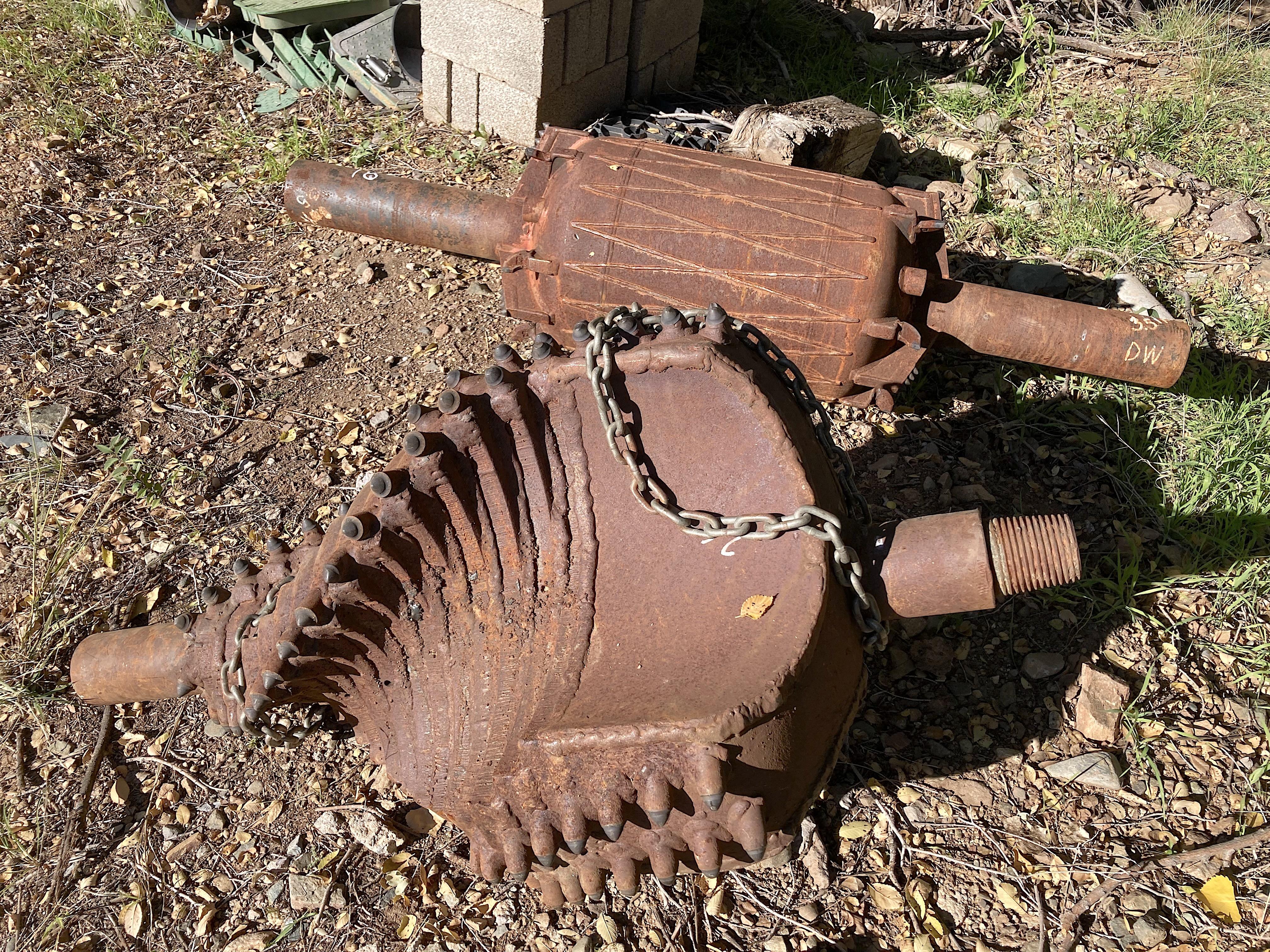

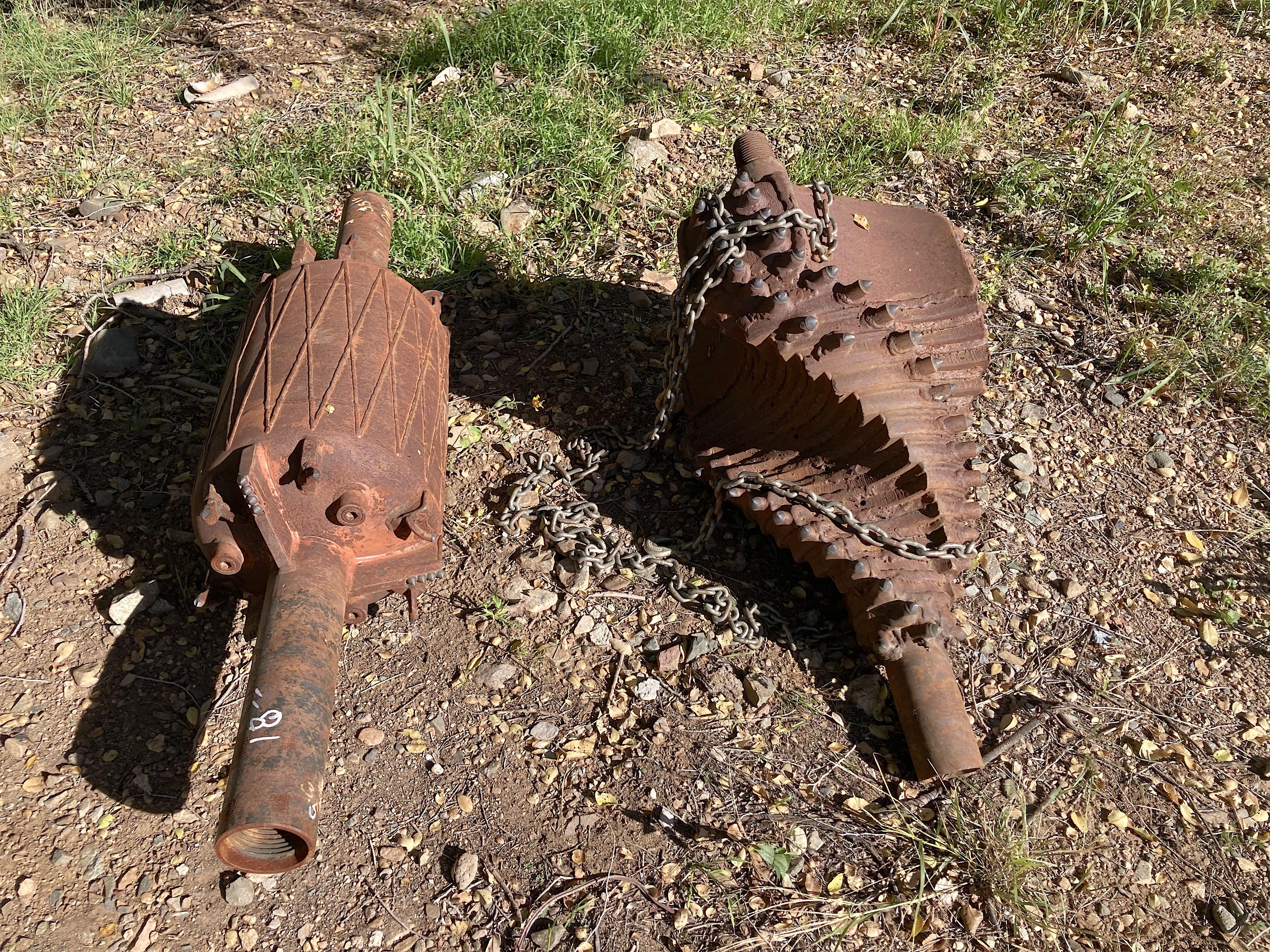

This morning I went to the other side of the highway first.  The drum and auger are for reaming the pilot hole bigger, then the water pipe is shoved through.

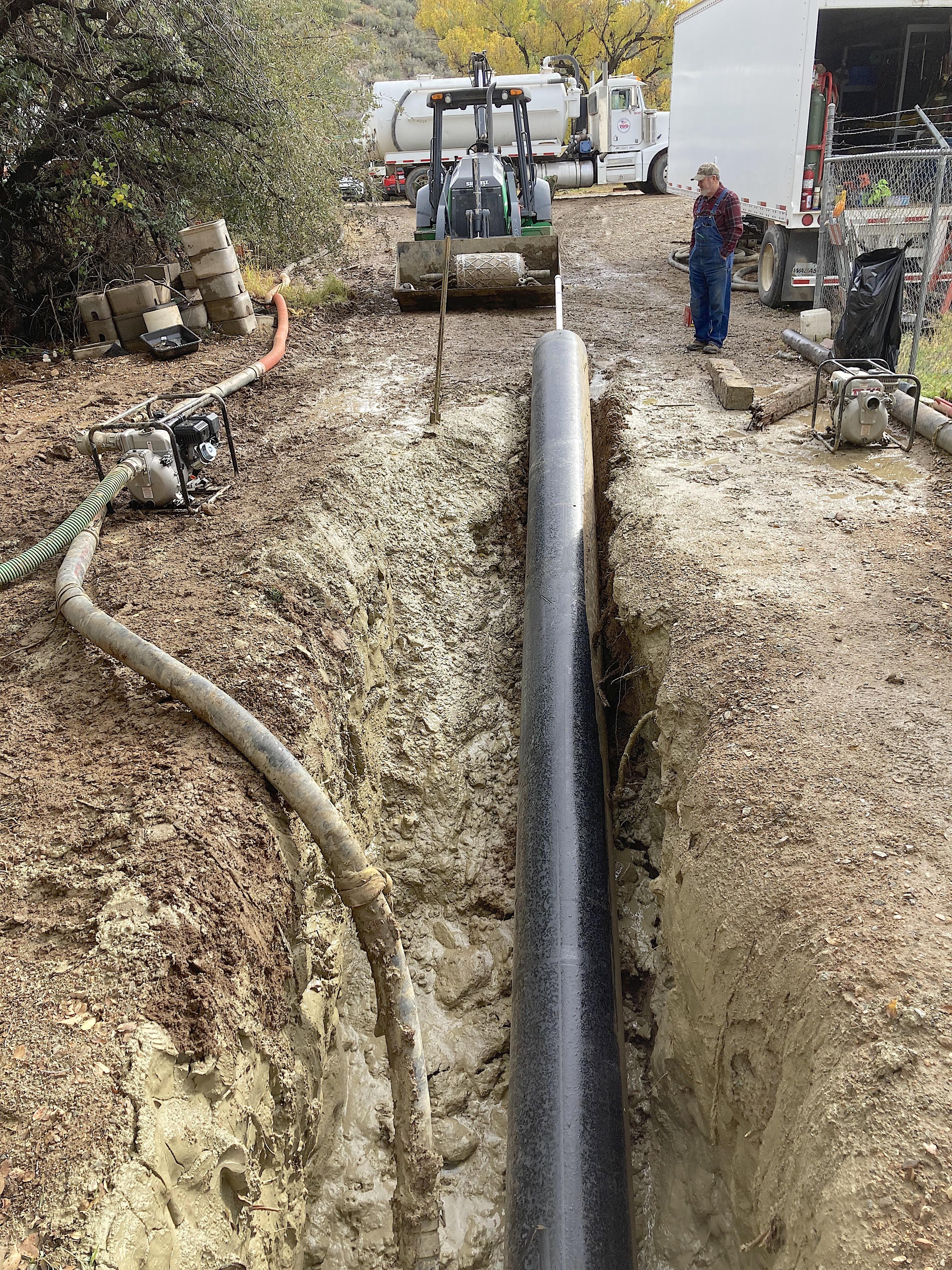

With the temporary pipe that bypasses the old main under the highway, we have saved about 100,000 gallons a month.  Yes, this old system was built when Studebakers were new, been losing about an acre foot a month.  They ran into problems, had to restart a deeper hole.
They are using the instrument to see where the tip is, about 12 feet deep now.
Just thought someone would like to see such a project.  Hope to get more pictures, but have a wedding to attend tomorrow (Sat.), they were going to work.

I need to get to the job today, this was Saturday.  Imagine having to maintain where the drilling fluid goes into the pipe going under the road.
The business end.

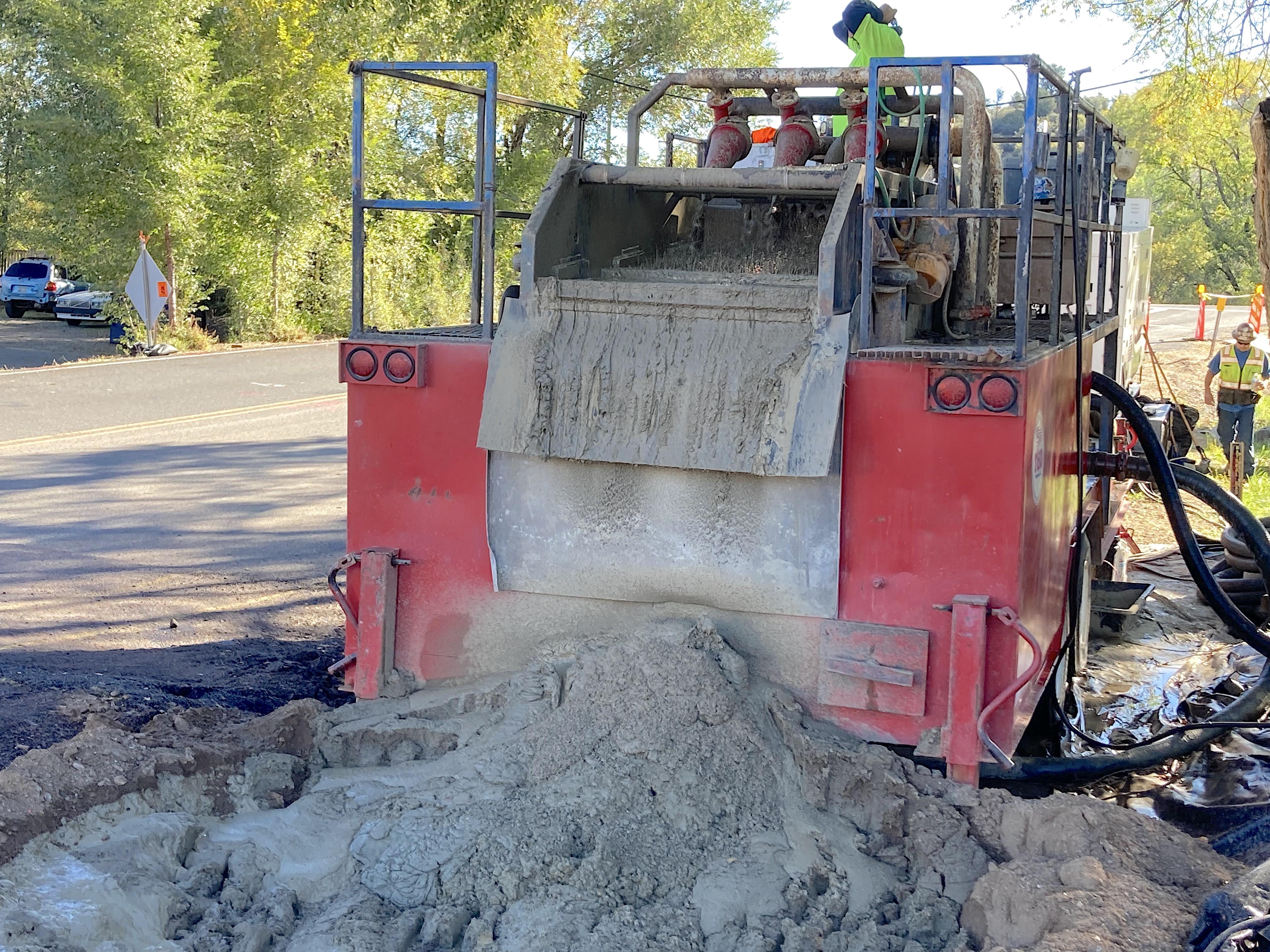

This trailer sifts out the clay and rock by vibrating.

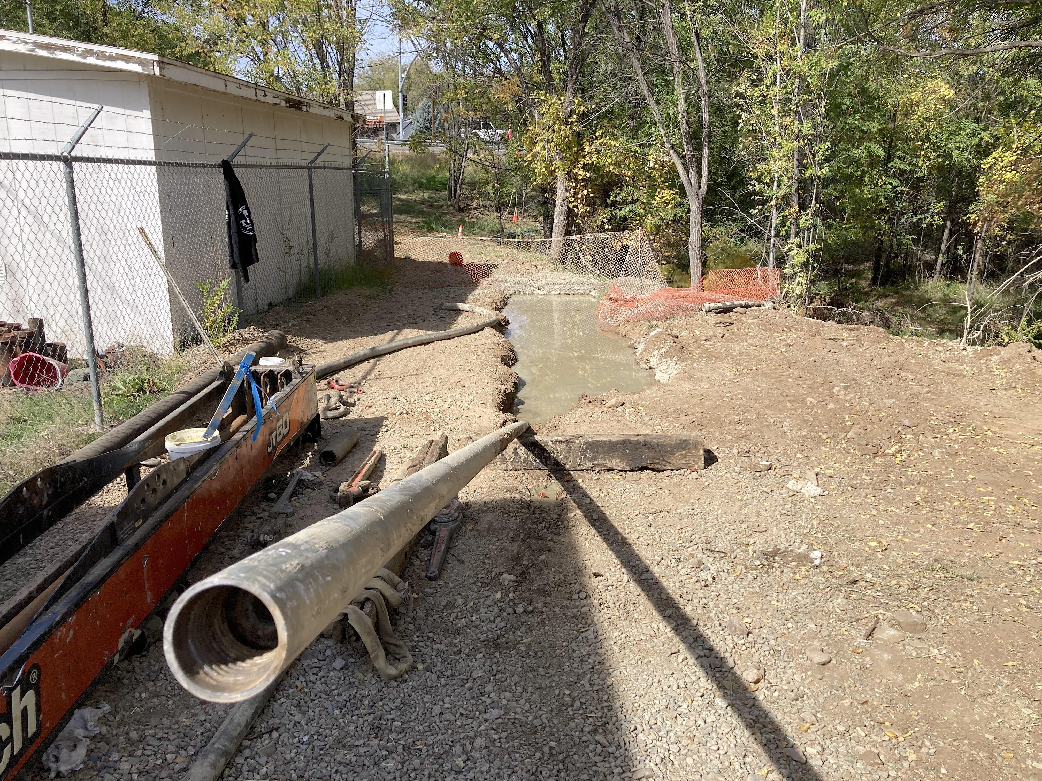

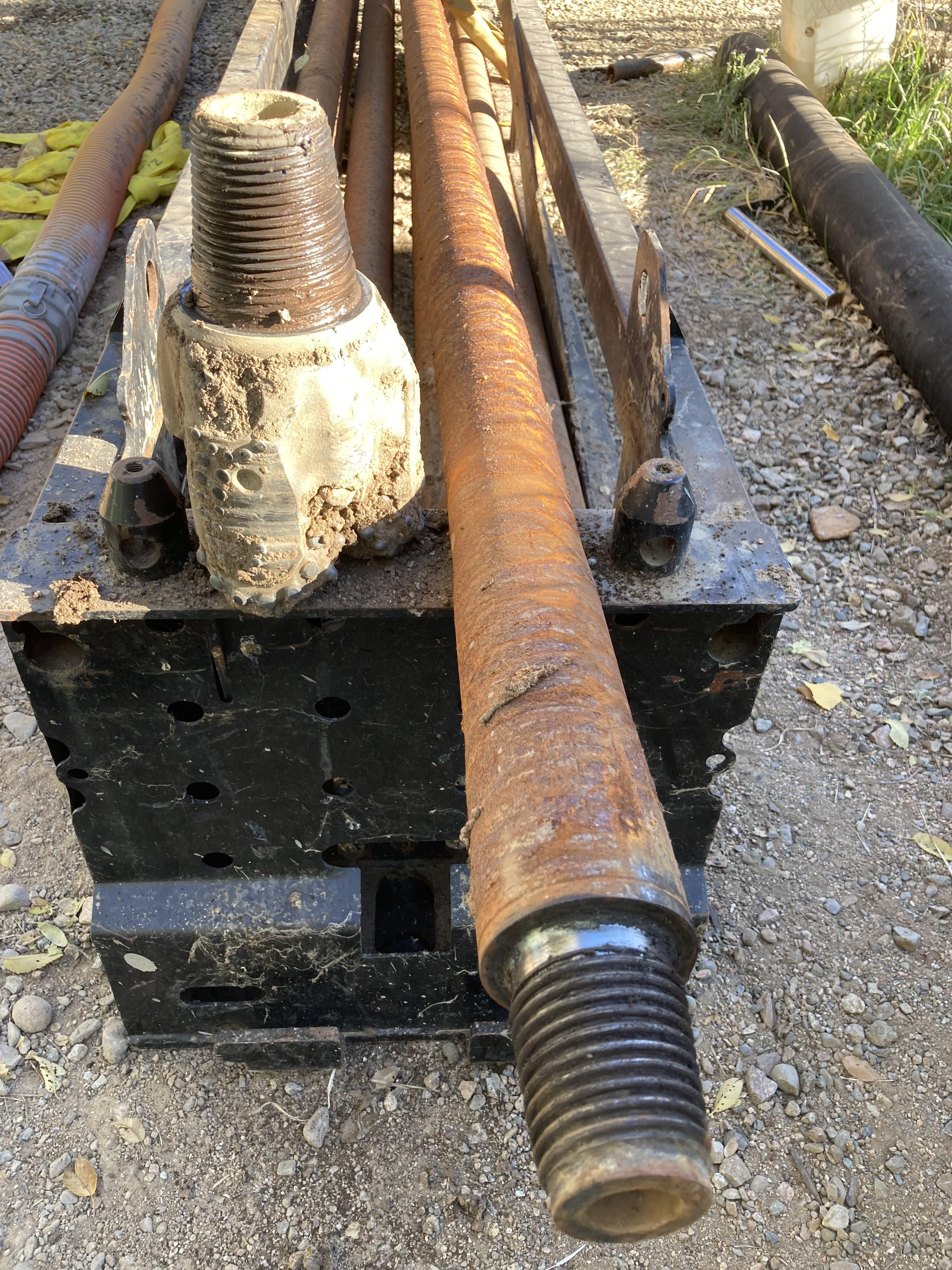

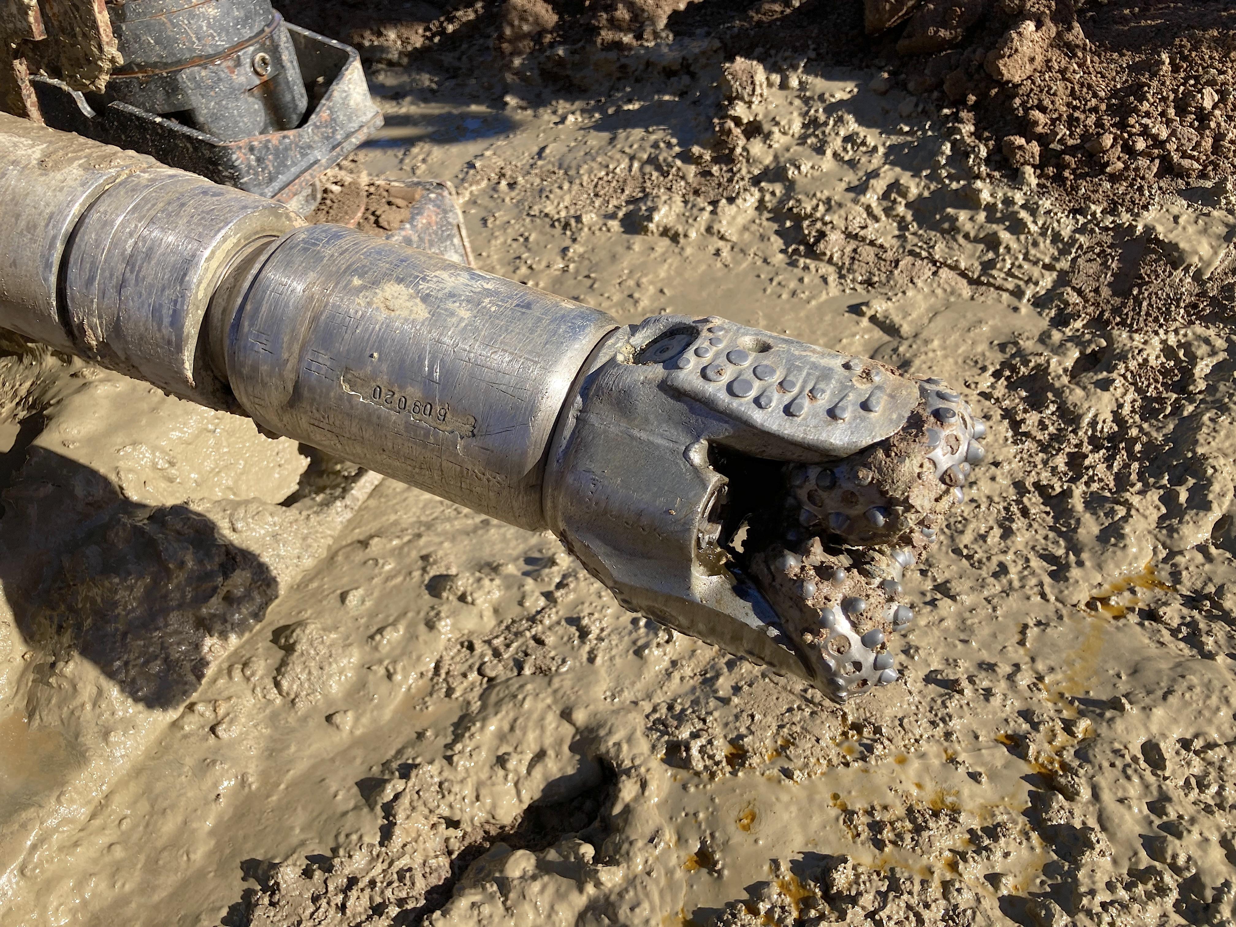

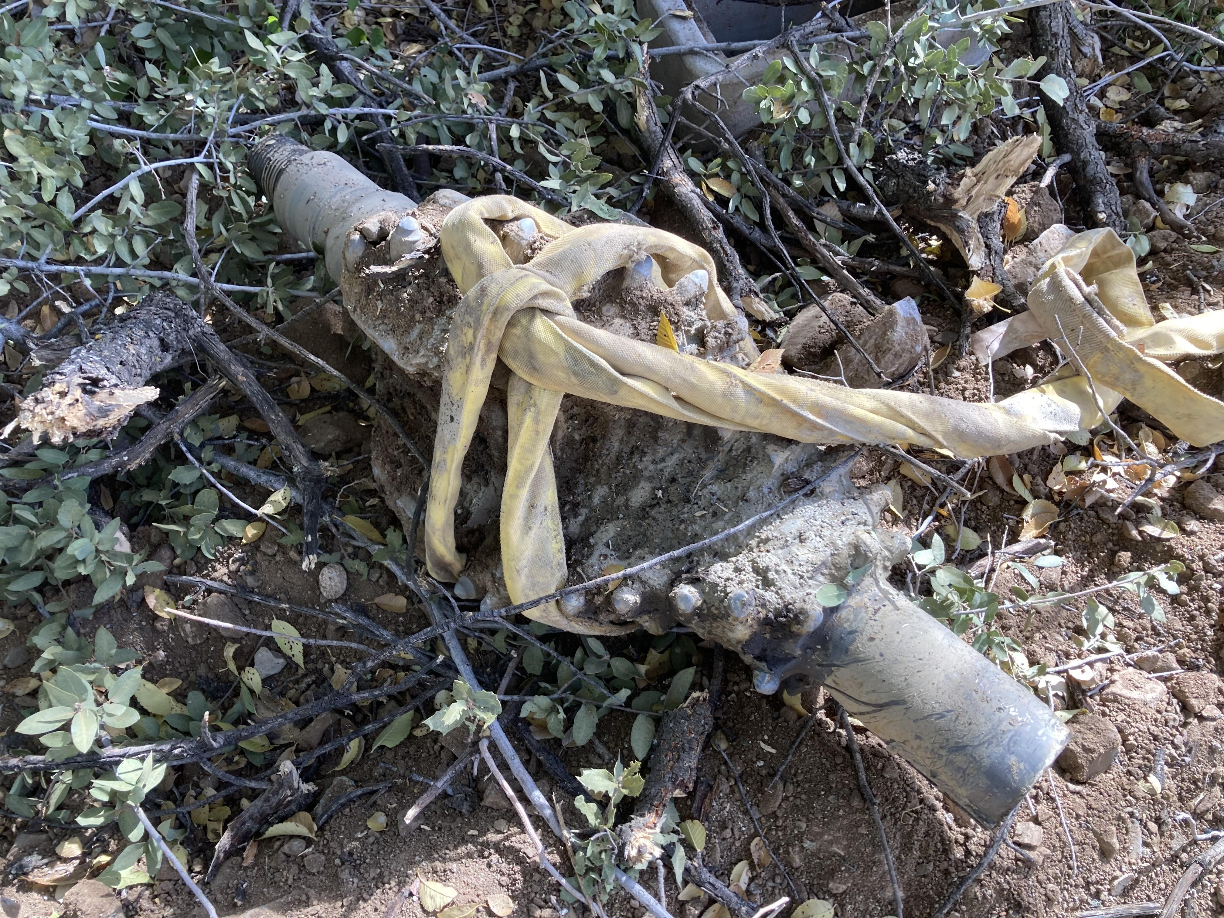

This is the drill head pipe, the slight bend is intentional, for the direction.
The bit that got across first.
The Ditch Witch pulling pipe out.
The third bit will be this one.
The tail end, another bit is in the middle going back.

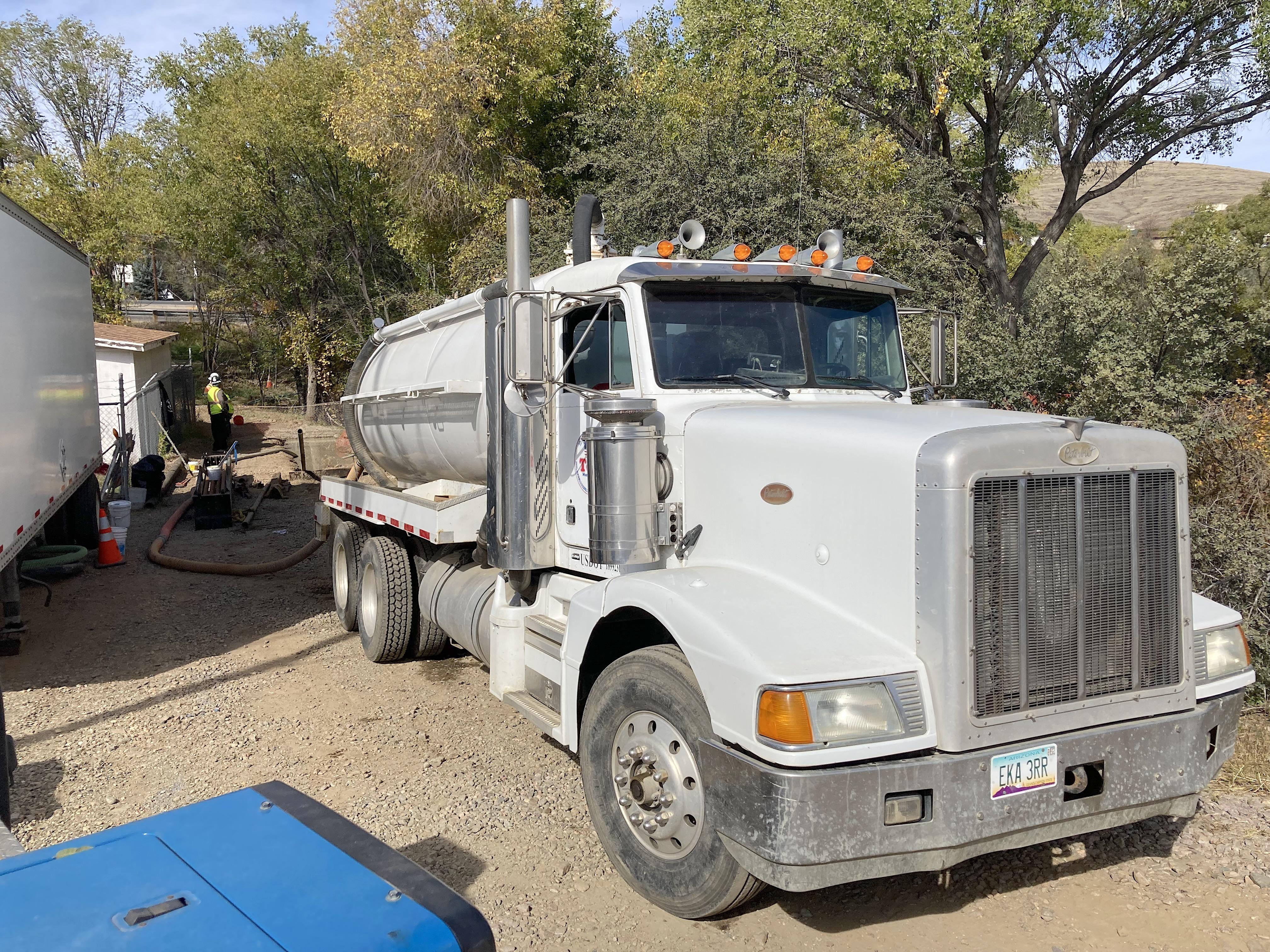

This truck is sucking up the fluid, taking it back to the other side several times a day.

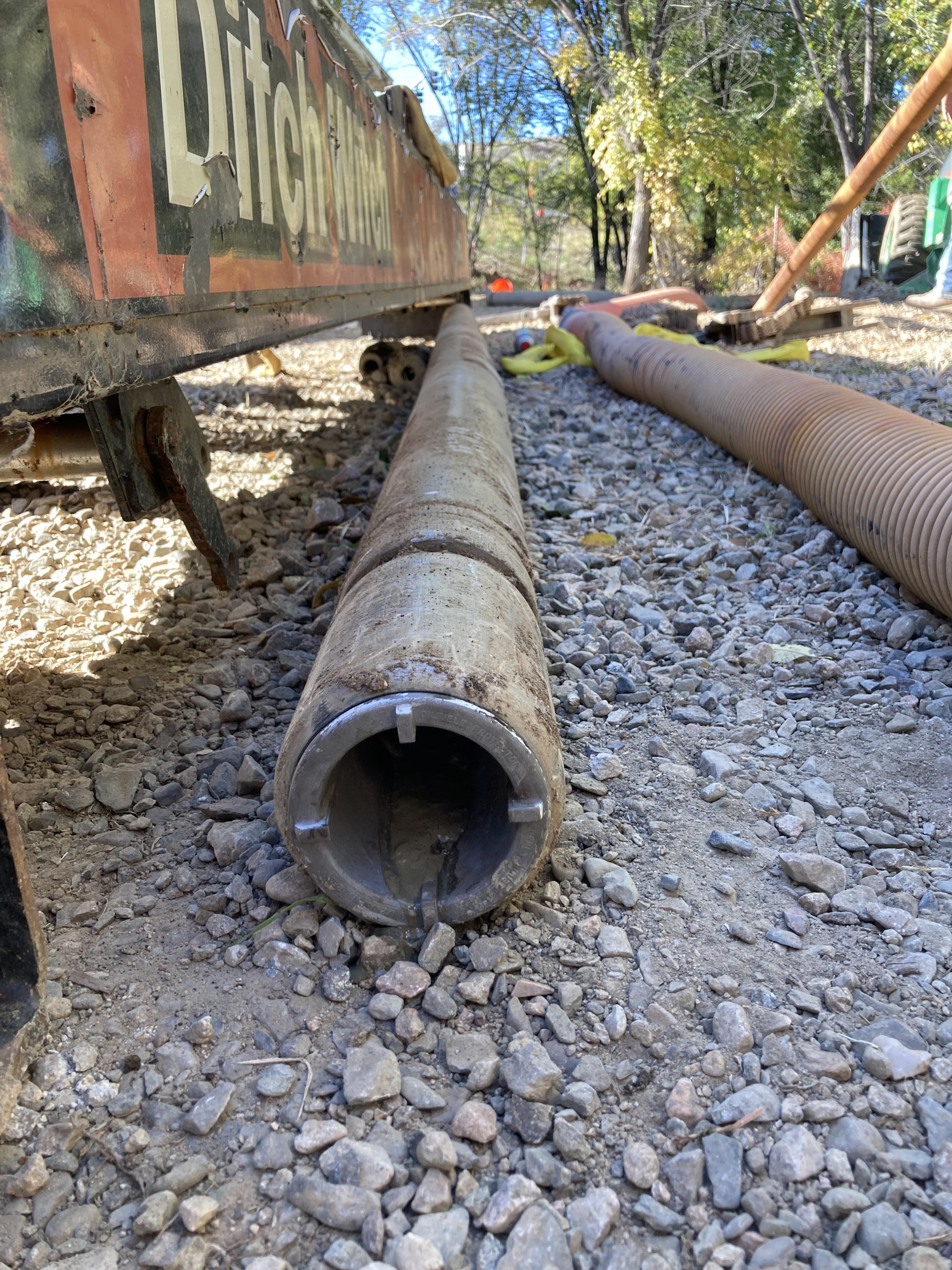

More augers to use.

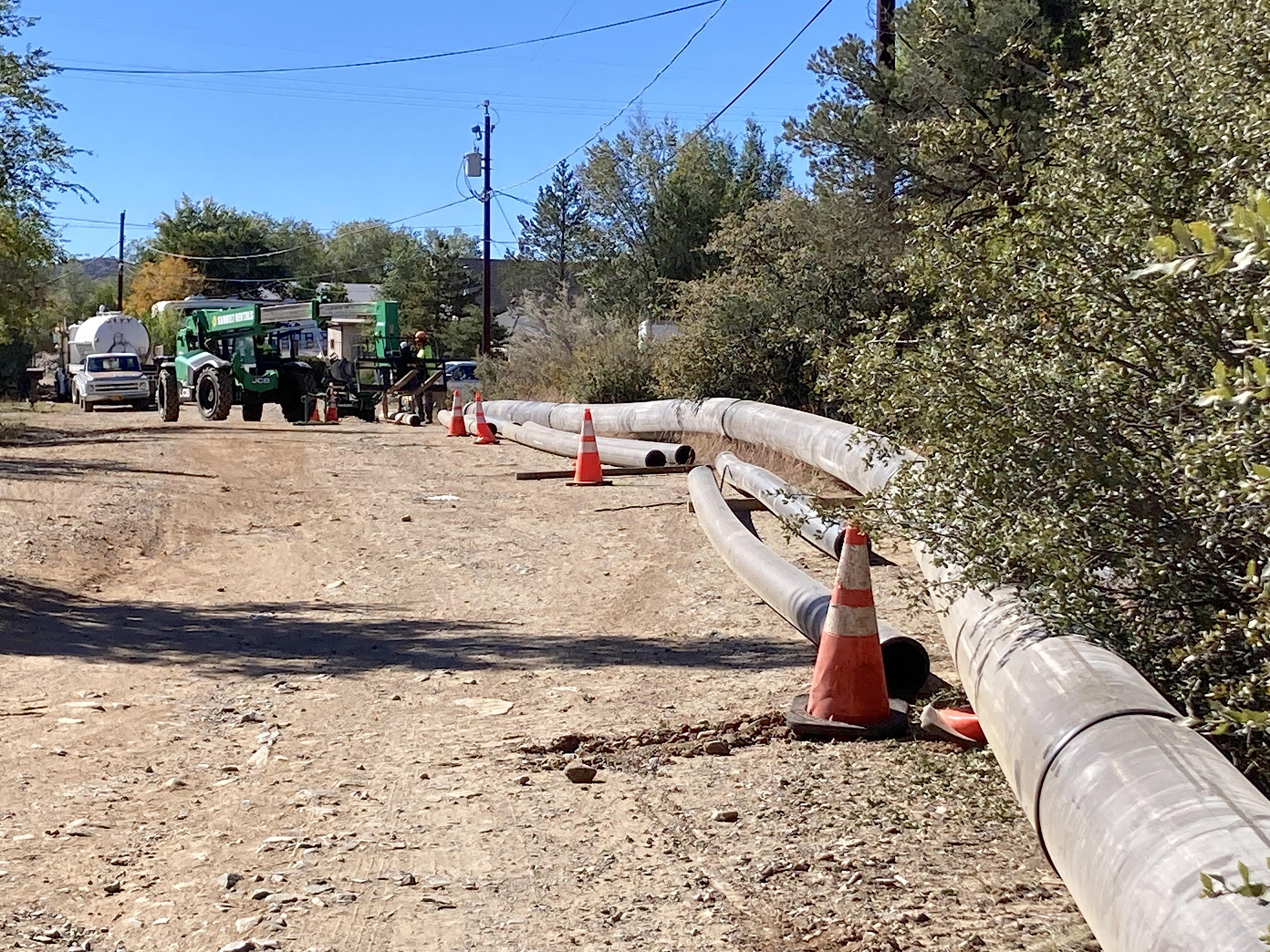

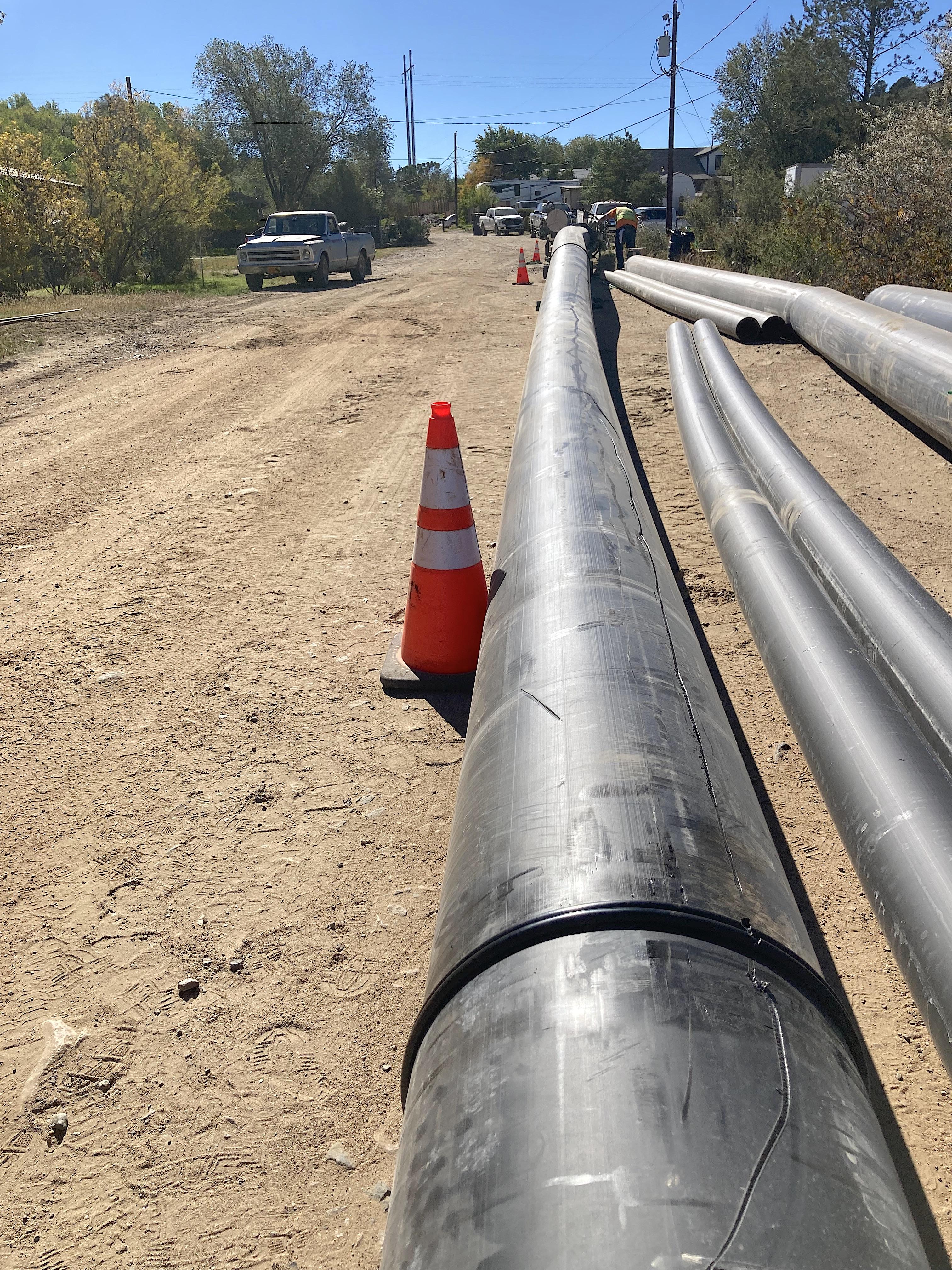

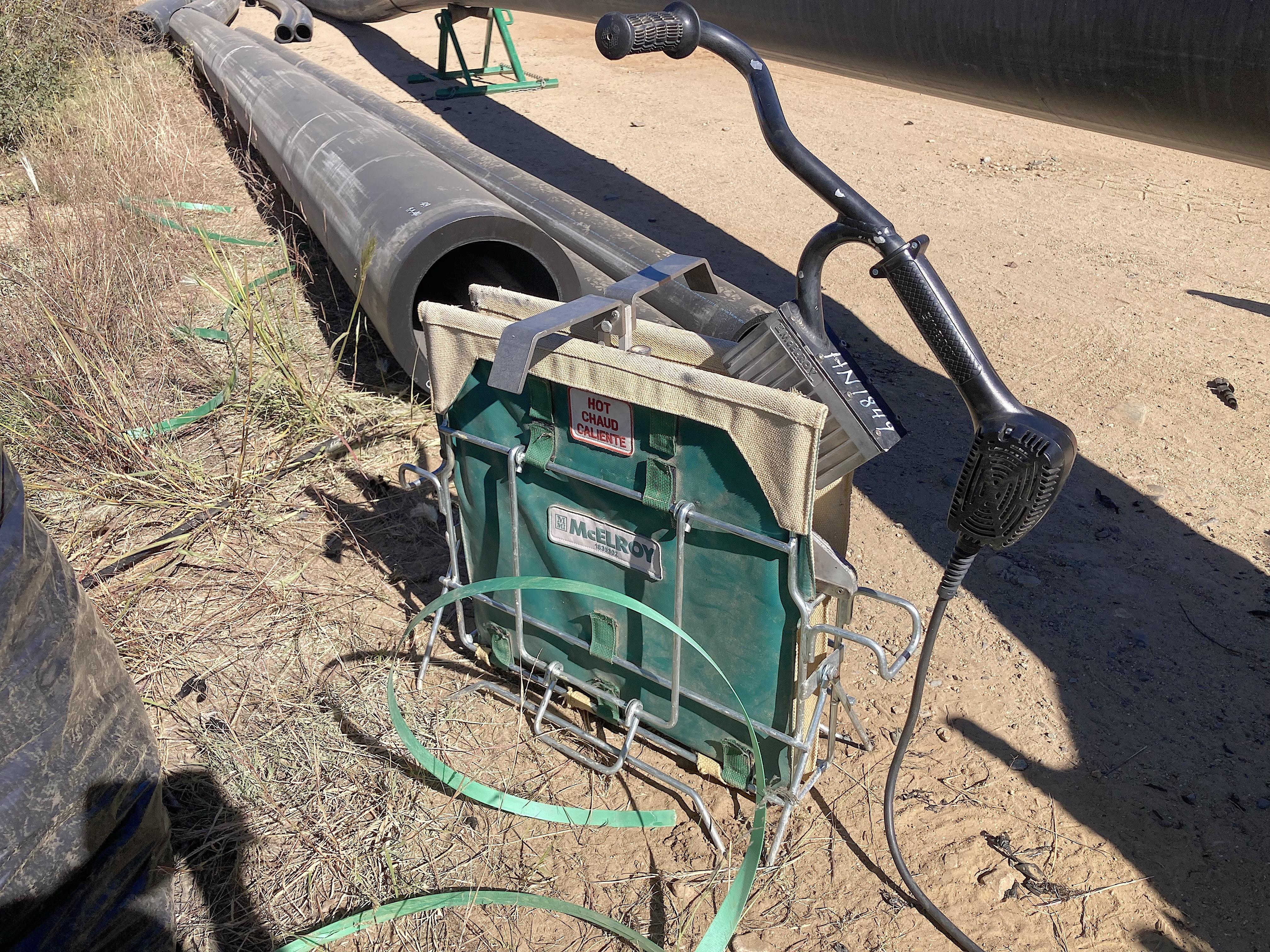

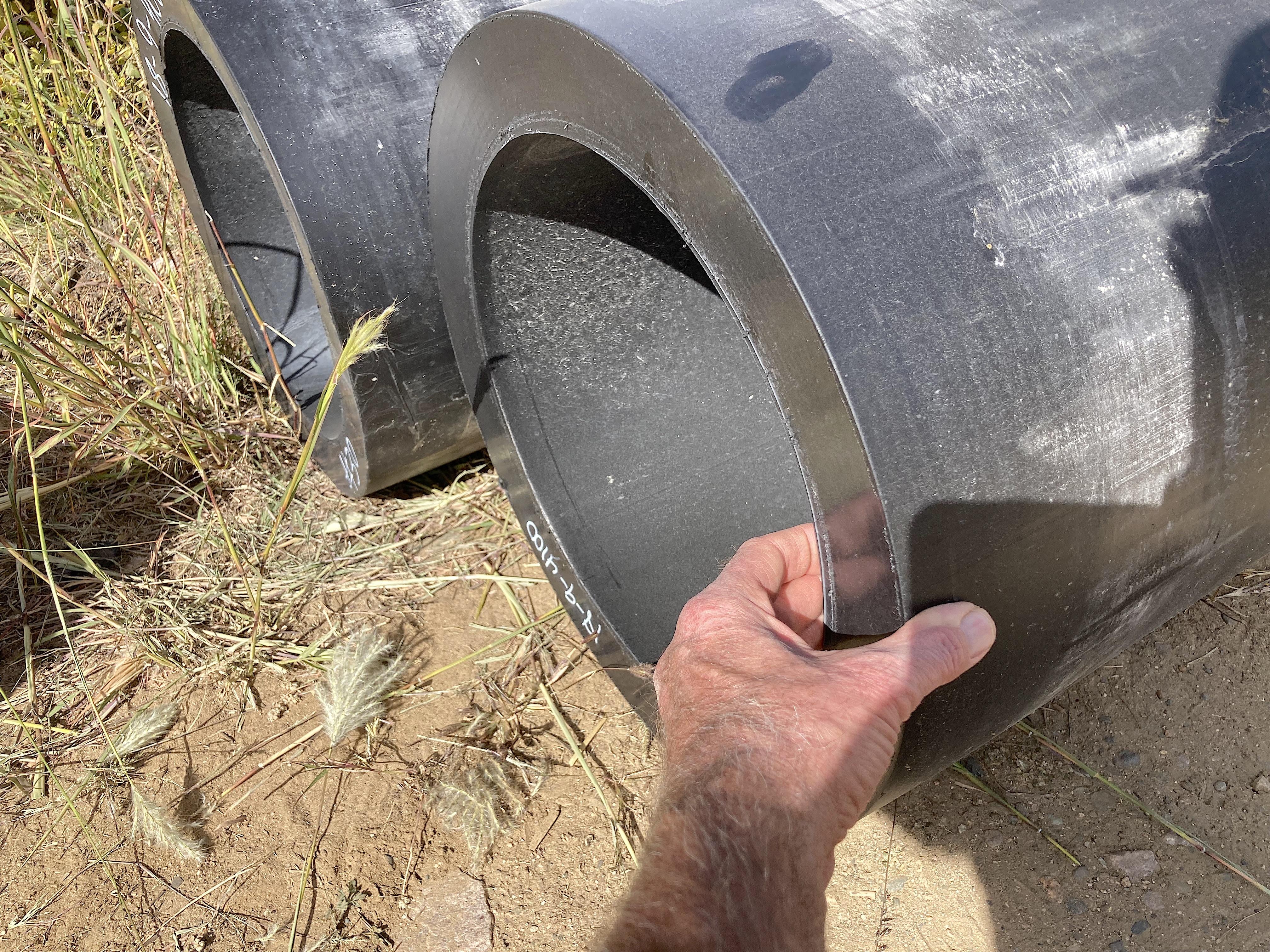

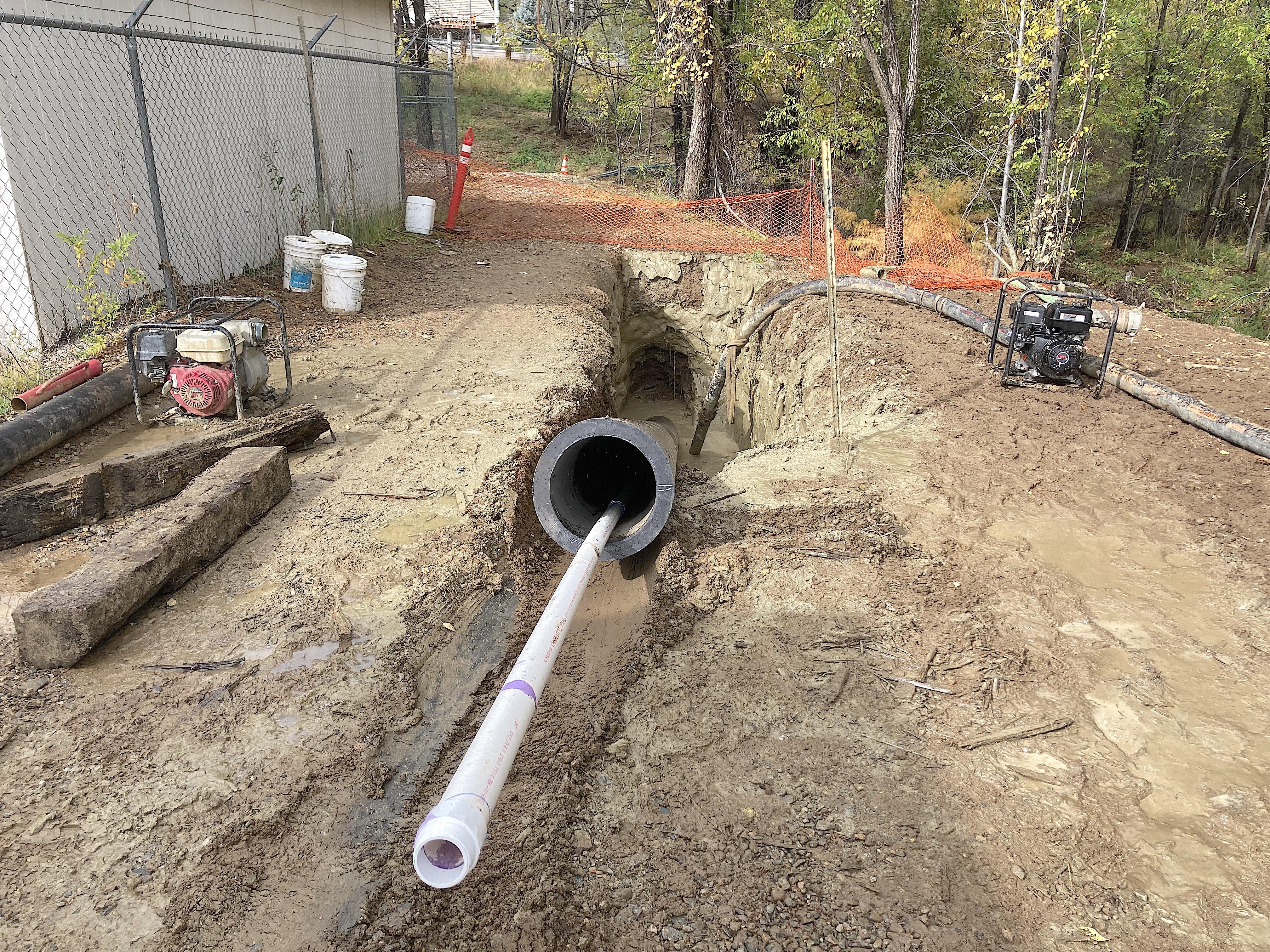

This is the sleeve pipe.  HDPE if I heard that right.  40 feet long, kinda heavy.

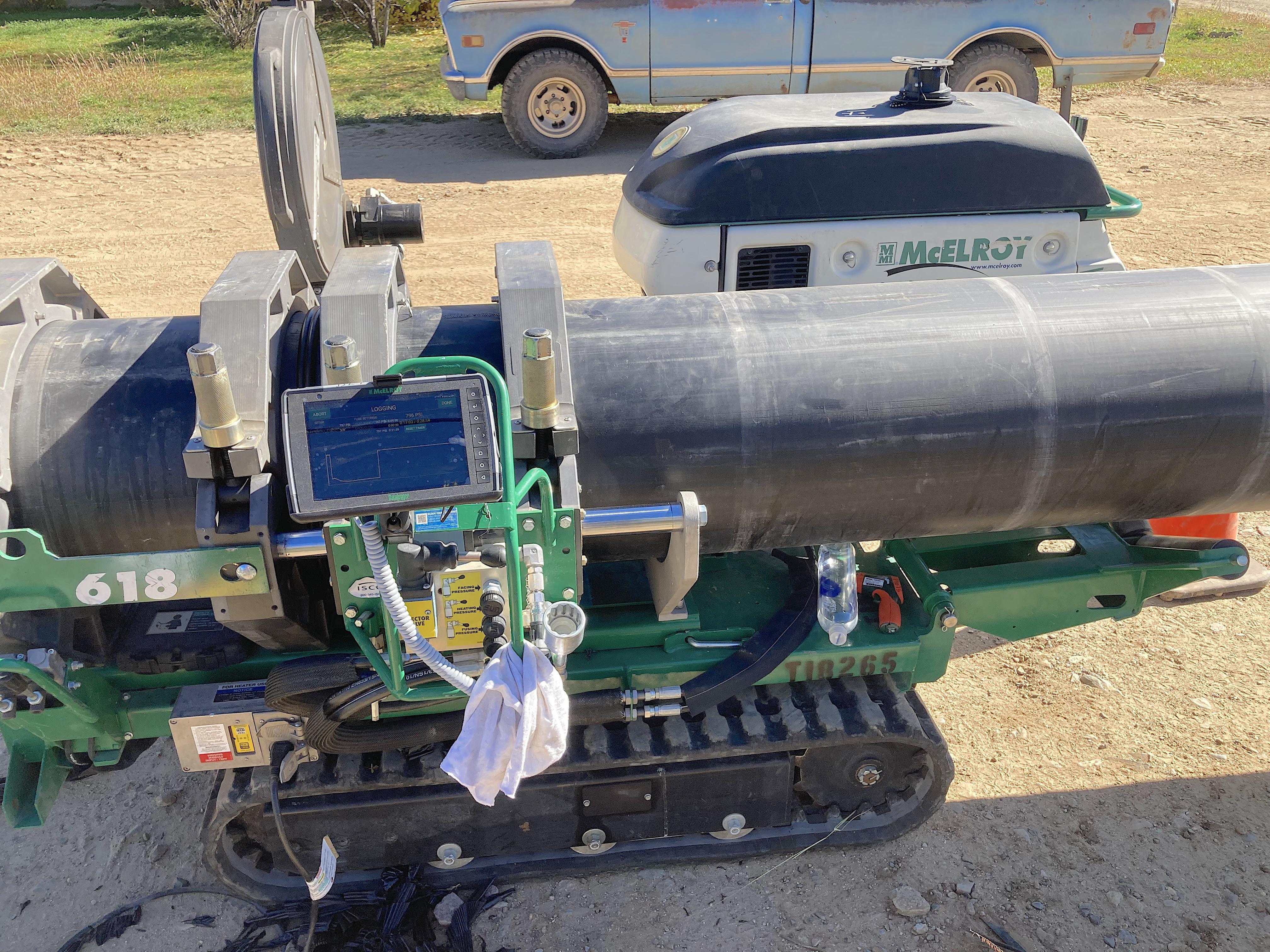

It's welded together.

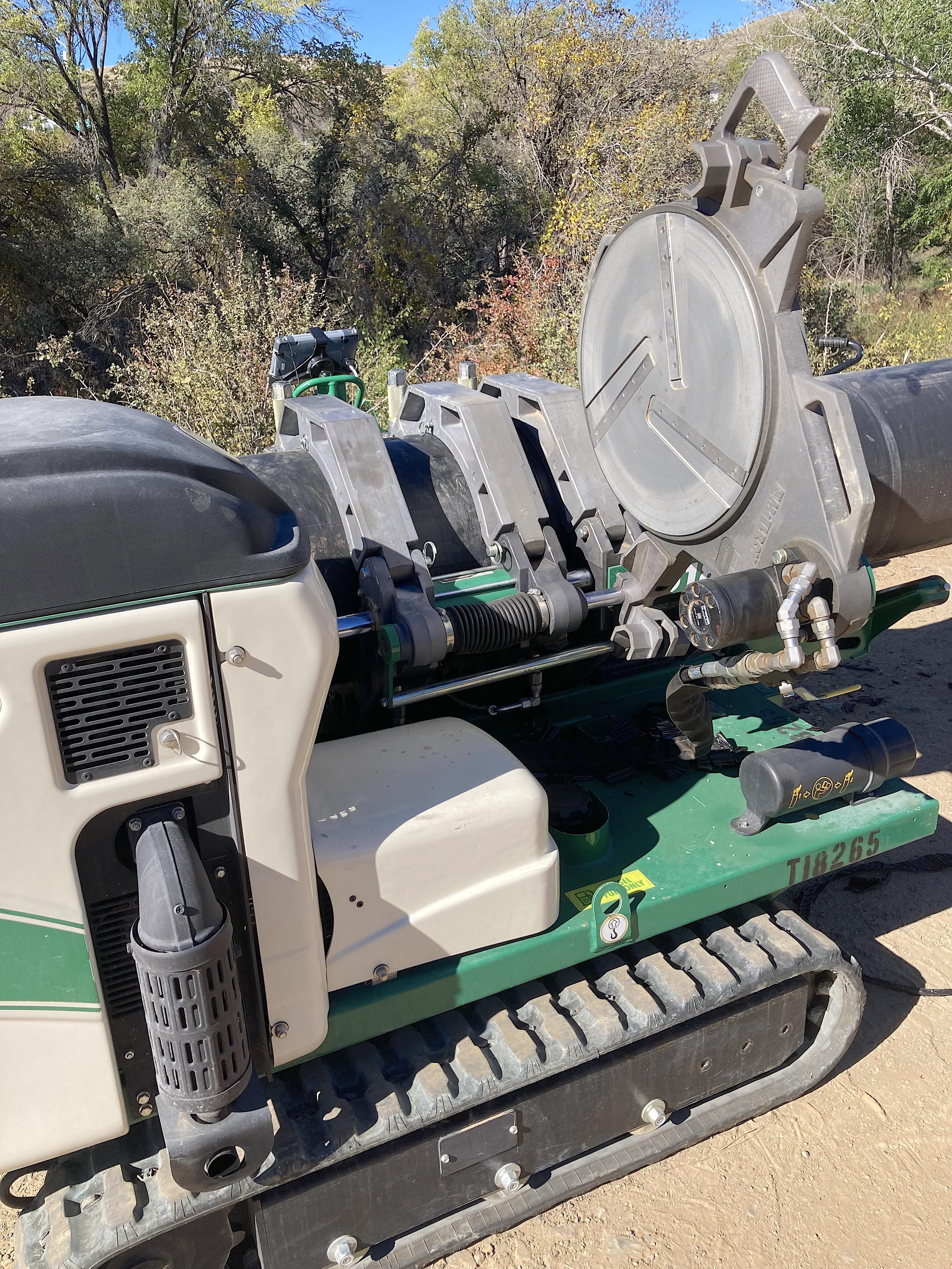

Using this machine.
The first step is machining the ends, then the heater melts the pipe, then the machine smashes the pipes together.  Then holds at 796 PSI, takes about 45 minutes when it goes well, data logs each joint.  They are going to drag it all down the street, then turn the corner and push/pull it through under the highway.

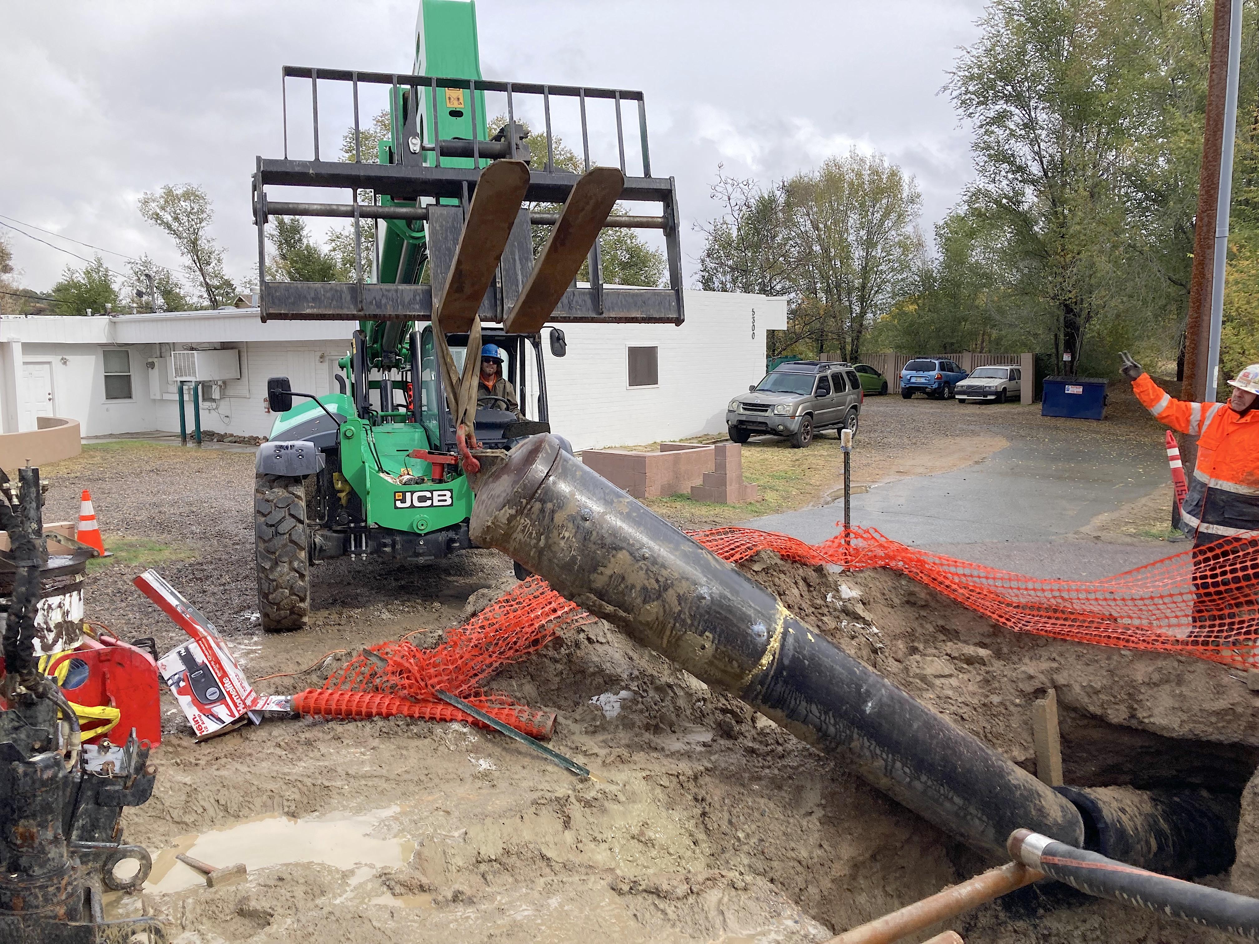

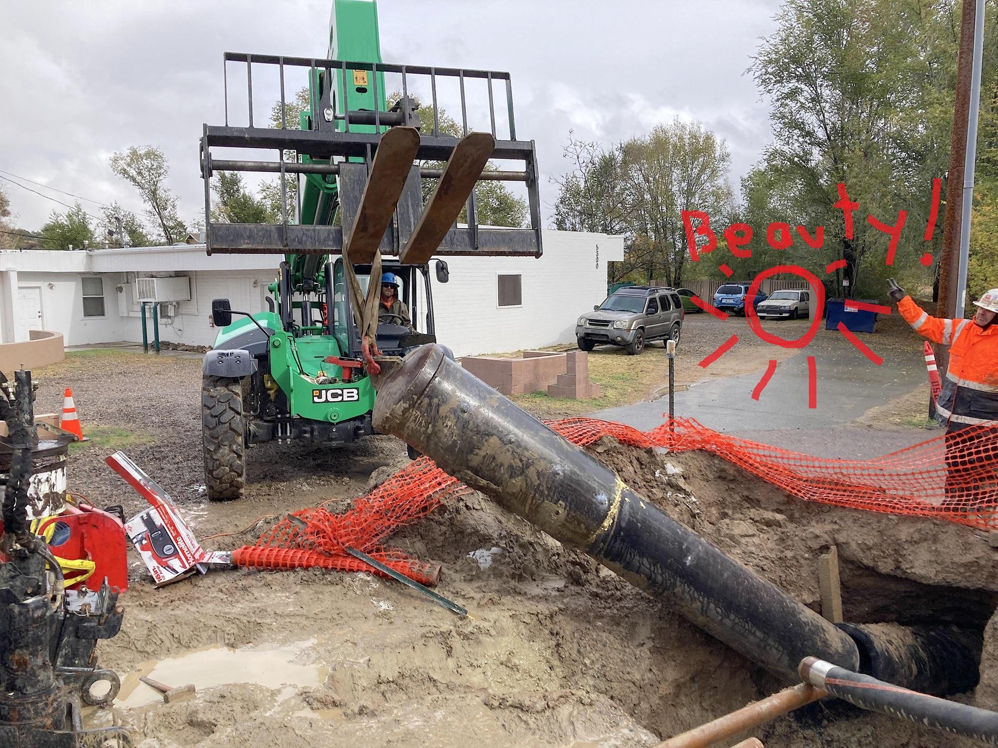

Boy where have I been?  Nov. 4, much has happened.  I missed a big step today because of an appointment made a month ago.   That big pipe was drawn through by the Ditch Witch.
Cut the other end with a chainsaw to start, finished off with the most versatile tool on any jobsite, the Sawzall. IMG_6084e.jpeg.179f2622eb574b2be224b2de055cd981.jpeg
I skipped a few steps, they went back and forth several times under the highway, making the hole bigger.  They plan to be decamping by Saturday.
