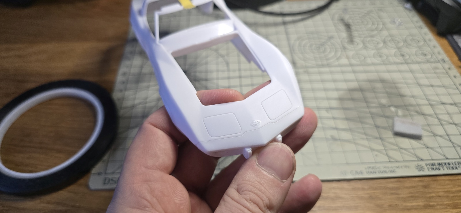

So, lets begin then. It's been long enough without updates. Decided i'm going to build this one as stock as possible. I like how the bodylines flow on this model so i won't glue the spoilers on. I think leaving them off, gives it a bit cleaner look. One thing i hated about this kit is the front daylight(?) running lights. They're molded into the bumper and the instructions calls for painting them. I don't like it.
So i grabbed my trusty old drill and went to town!
After that, i cut the part out with my hobby knife
Looks a bit neater already
Will try to create some lights into those sockets later.

I'm definitely not good at scrapbuilding, but heres how one can get a set of lights to their Corvette.
Step 1: Tape the hole and trace it with pencil
Step 2: Cut out the template from the tape and stick it to some scrap headlight lens
Step 3: Cut and shape......cut and shape..... until it fits into the hole :D
Step 4: repeat the step 3 on the other side
Step 5: Glue some scrap pieces to the other side
Aaaand you have a bumper ready for lights :D
In my opinion, it looks a lot better than just painted on headlights :D (Or are they daylight running lights? Or maybe blinkers? I'm not even sure)

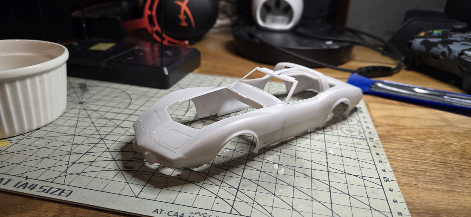

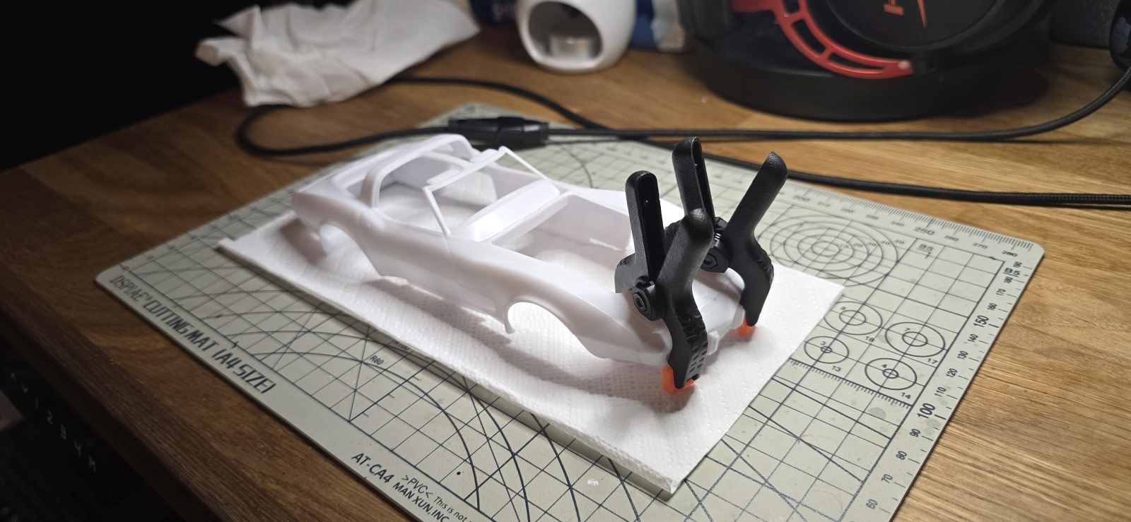

So i glued the bumpers on :D Used these clamp-thingies again. Really great and cheap tools to have.

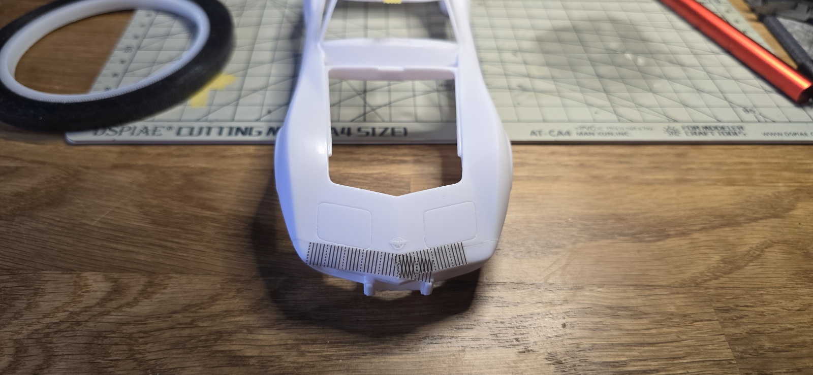

Wanted to clean up the edge a bit where the bumper meets the body. So grabbed some scribbing tape
Then scribbed some lines to it :D My trick is to count the times the blade passes over it. So its 10 times for every line. This way, you'll keep the lines nice and uniform in depth
After that, i added some extra thin quick drying cement into it and left it out to rest. You'll get a nice and crisp lines in the end :D (I'm not a pro so don't take everything i do too seriously)

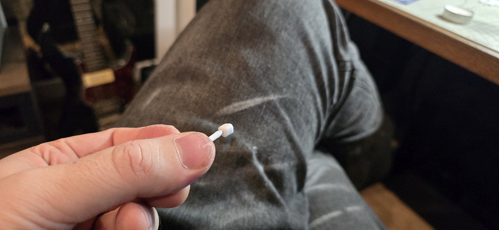

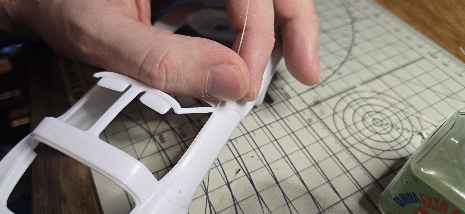

The 1:1 car has some thin chrome lines on the sidedoor too where the window drops into the door. I really like the look of them. Unfortunately in this kit, they are not molded. So i decided to do my own :D Getting ready to use styrene strips seems to be impossible where i'm from so had to be creative. I took some tamiya styrene strips, heated them up over candle and stretched them out to thin wire. Then glued them into the doors. Pretty happy how it came out. Will chrome them up later down the line once the body is painted.

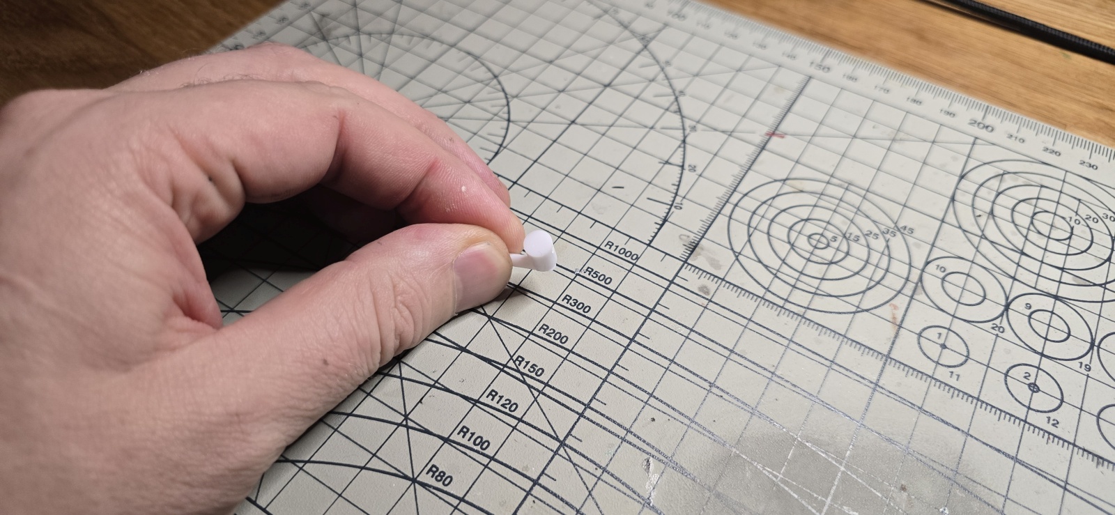

Then wanted to try out something new - scrapbuild my own parts :D I really suck at doing stuff like these. So the engine bay is pretty bland and boring on this kit and definitely needs some more detail. So decided to create my own expansion tank for it. Took some scrap piece i had laying around
Cut and sanded it into shape. Then glued some scarp piece ontop of it
Once dried, i cut it in lenght and heres how it turned out :D

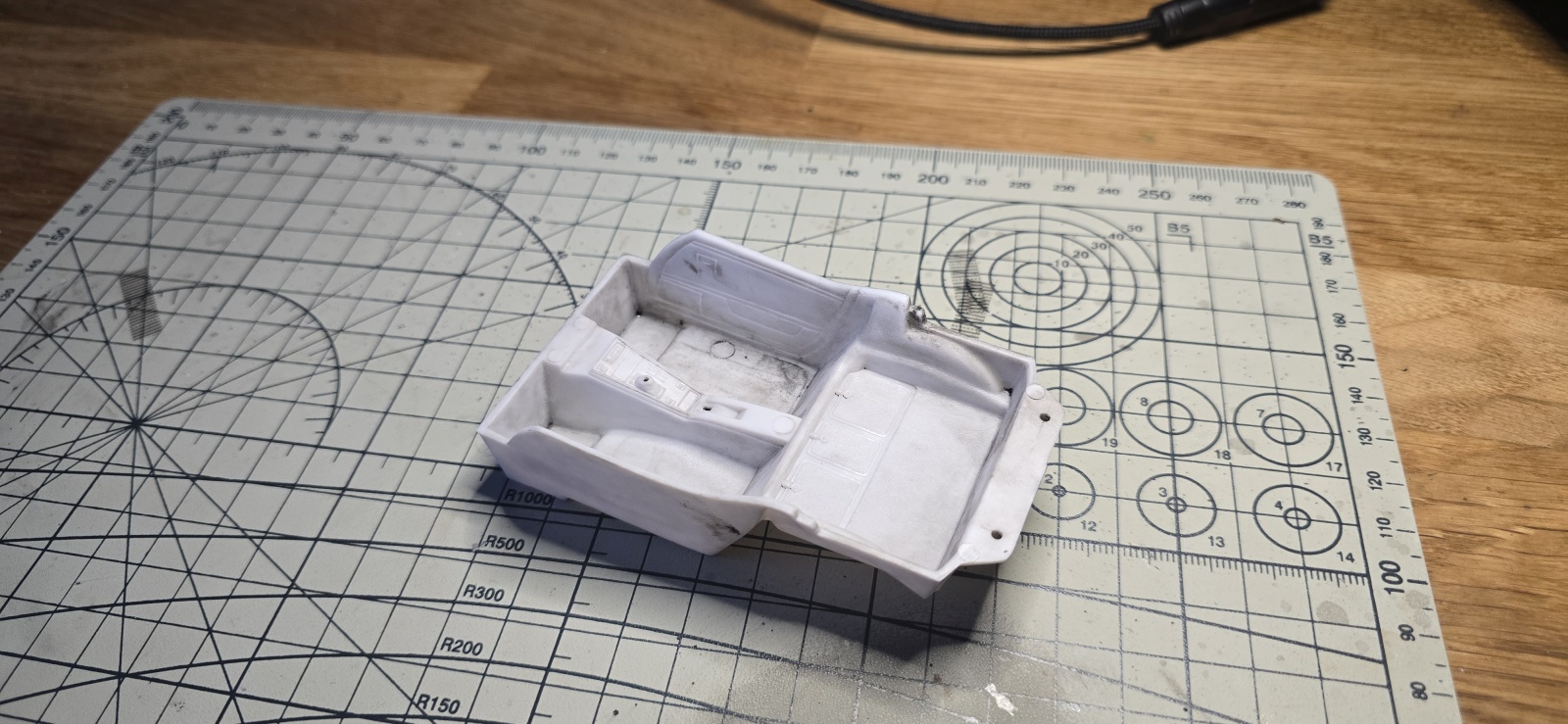

Then decided that the interior needs a bit more detail :D Really liked the chrome trim around the center console part in 1:1 car. So decided i'm going to create these in my model too. So dipped the interior tub and dash into some DOT oil to strip the paint. After that, glued the trim in place
Then repainted it and did some bare metal foiling (god, i hate this stuff. Its just so annoying to work with. With a lot of cursing and wanting to throw it out the window, i got it finally done. Looks pretty okayish. Will do the dash at a later date :D Right now, i don't want to look another metal foil sheet for a while.
