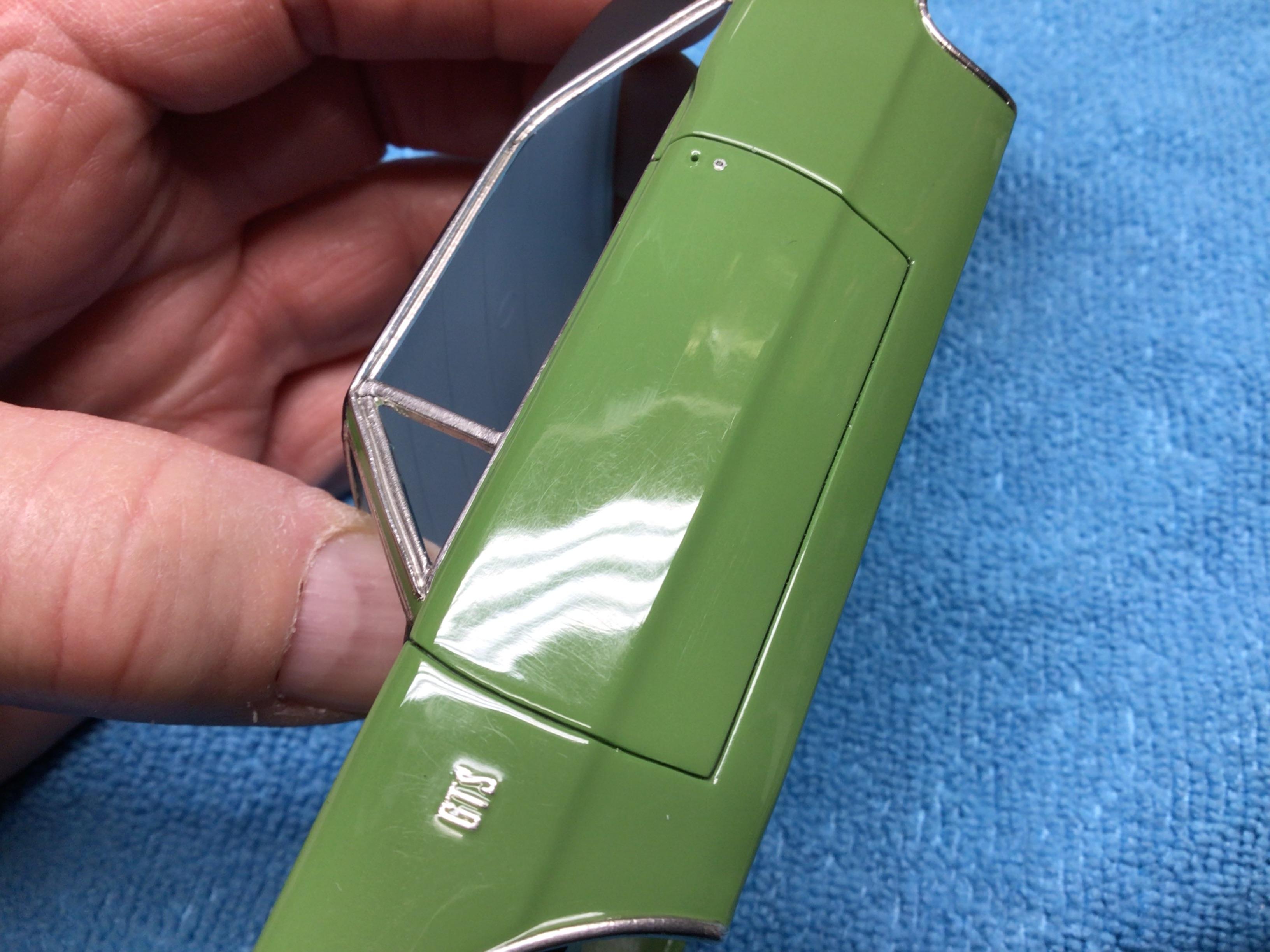

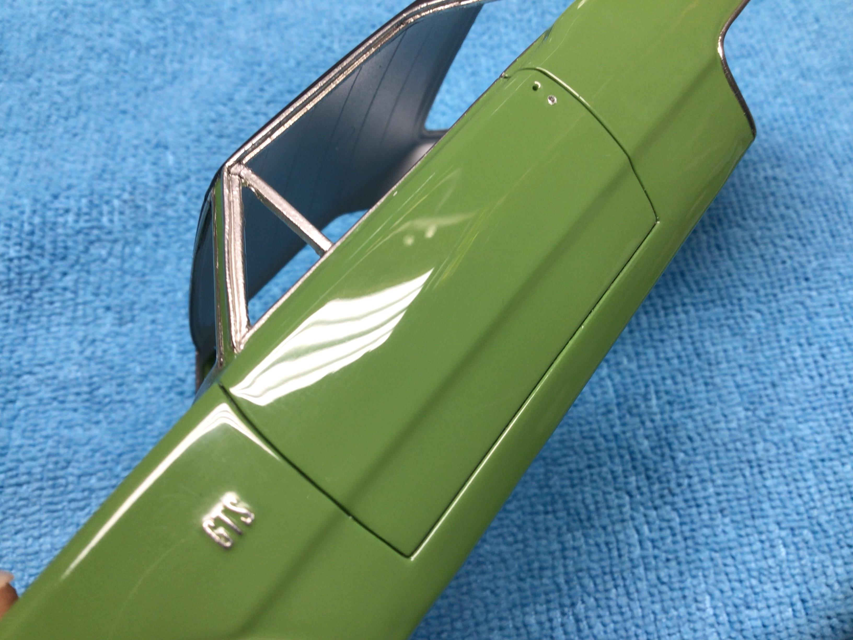

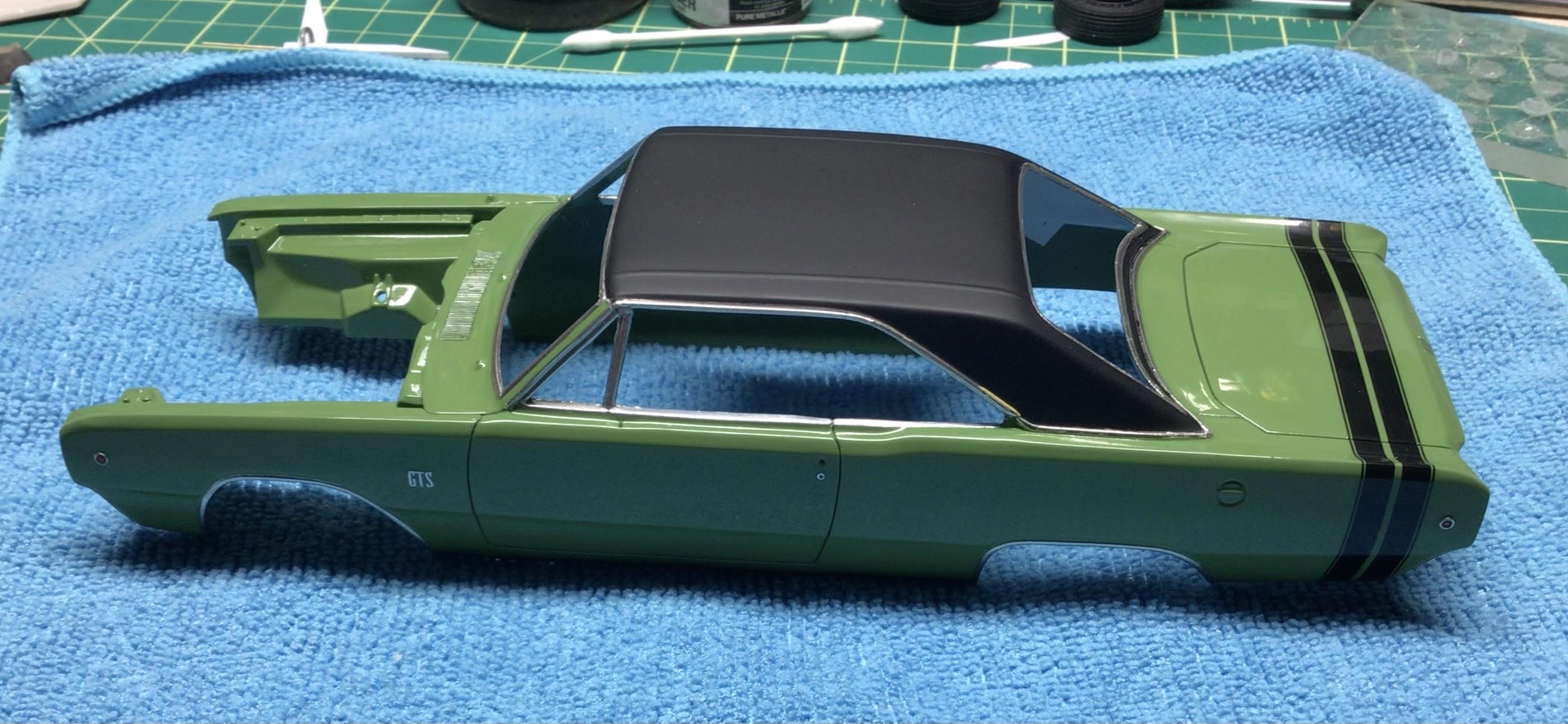

NOBLNG Posted 14 hours ago Author Posted 14 hours ago (edited) 2 hours ago, Bainford said: Yes, I know exactly the thing you are experiencing. Curiously I find it more prevalent with the Finish grit, but I think it is quite normal. I've been using Tamiya polishes for years and find this to be quite common with aggressive rubbing. When it does, I keep right on going, bringing out that great finish, trying to keep the pasty stuff on new areas and working it around. When polishing, I give at least two polishes of the Finish stuff. If I'm not happy, I go back and do a rub with Fine, then the Finish again. Be careful with that Course stuff; it can really remove some paint, especially at edges and panel gaps. If you sand to 10, 000, don't use the Course, and you probably don't have to go too hard with the Fine, either. Thanks Trevor. Good to know that this is how the compounds are supposed to behave. I polished this Dart and thought it looked good after wet sanding with 4,6,8 and 10,000 then the three grades of polish. But when I took a second look there were a lot of swirly scratches that I hadn’t noticed. So I went over the drivers door again with 8 & 10 then the polishes. I think I may just be rushing the process.🥴 I’m happy with the drivers door now and I put quite a few coats of clear so hopefully I can get the rest of it smoothed out. Edited 14 hours ago by NOBLNG 1
Bainford Posted 4 hours ago Posted 4 hours ago That looks great, Greg. I'm really digging your Dart; love the colours. I always finish off with a rub of Tamiya wax to add that little bit of luster, and to make finger prints easy to remove. Be aware, though, that the wax makes the body quite slippery to handle. 1
