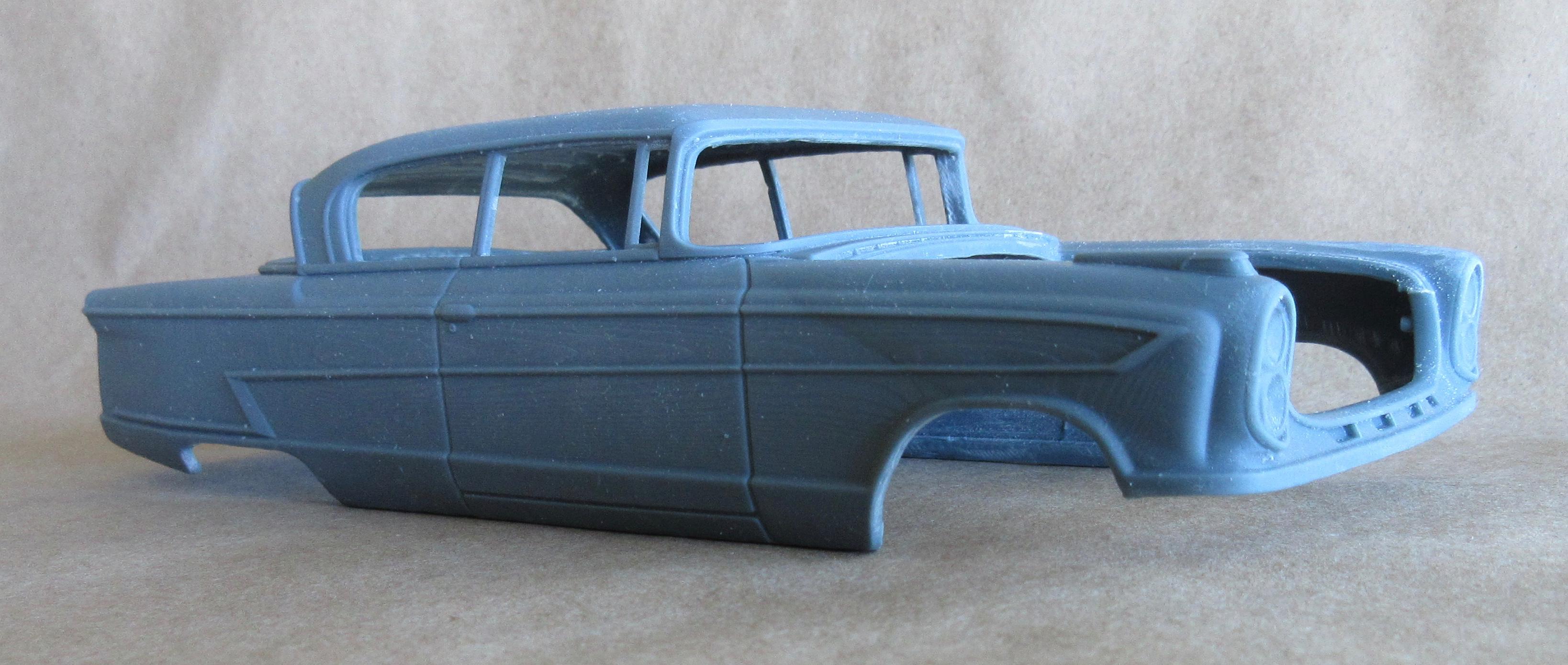

While taking a break from my 53 Hudson, I started this.  It's a 3D printed model I got off eBay.  It has a few inaccuracies but it's such a rare subject, and close enough, that I wanted to have a go at one.  I'll try to fix the inaccuracies as I go.

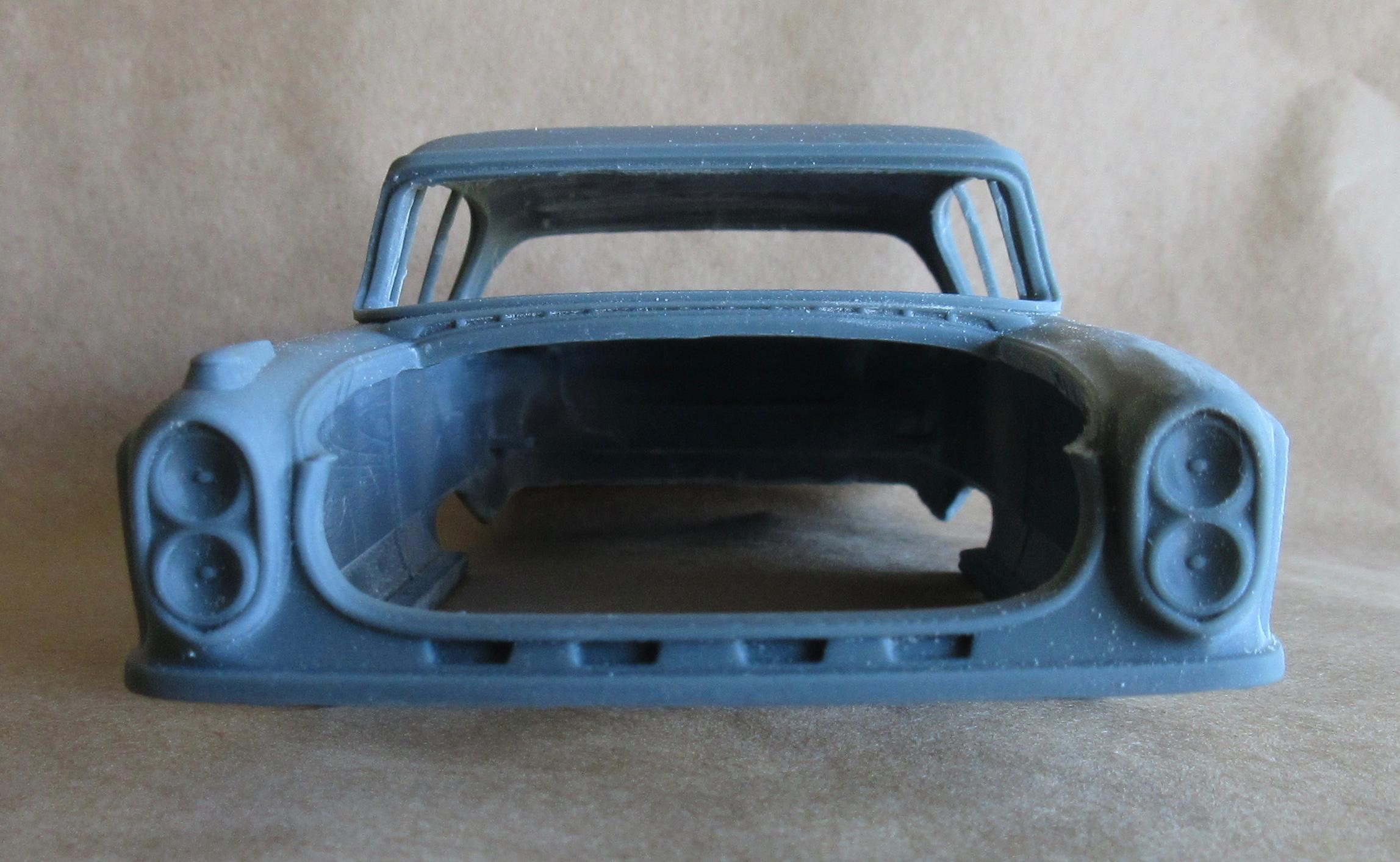

I took before pictures this time:

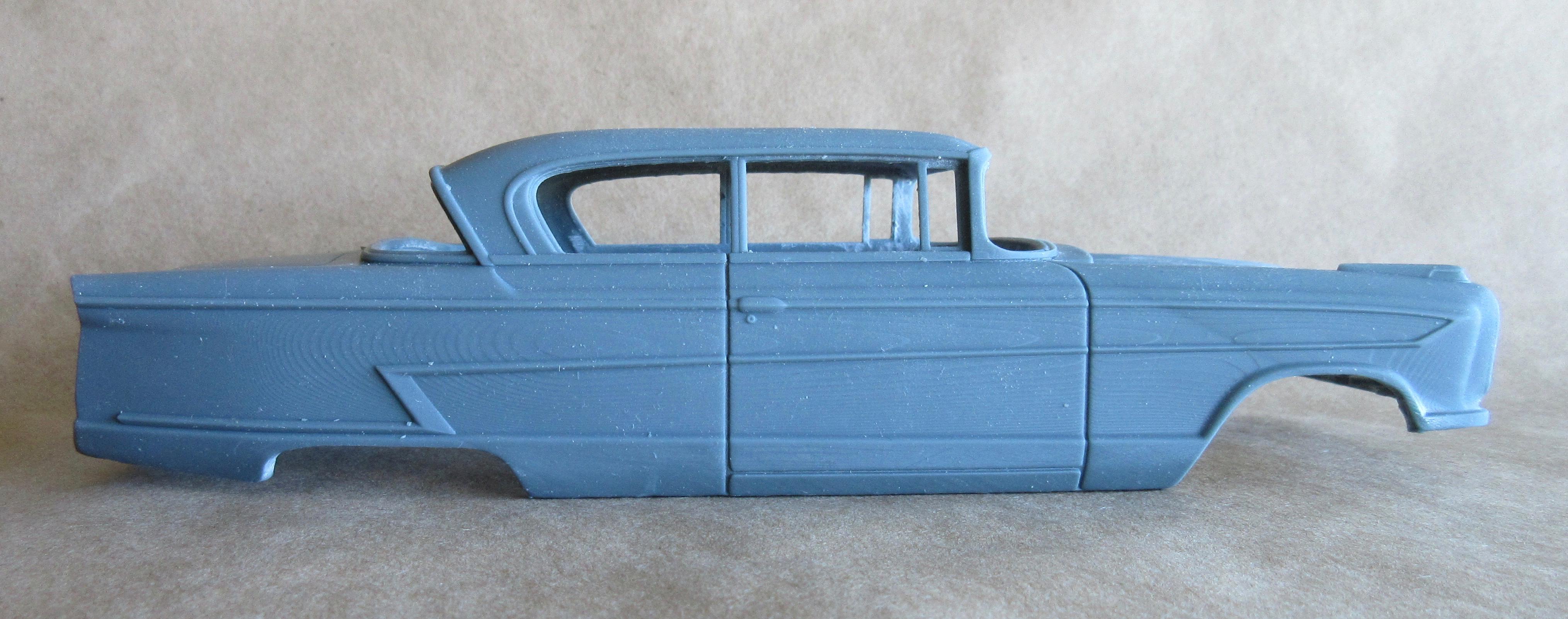

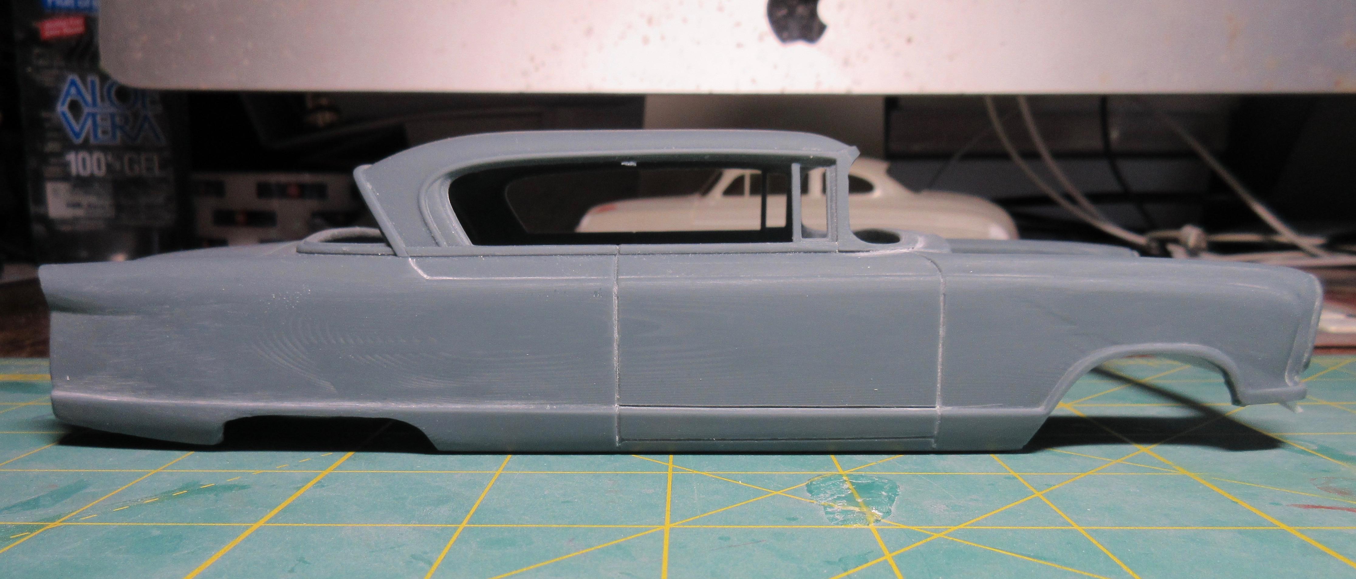

In profile, you'll notice the rockers are thicker at the rear then at the front.  Wedge shaped.  The lower door panel line is on an angle too:
It's not bad, but not perfect, the headlights and front end were done pretty well, but the parking lights are too big on top of the fenders:

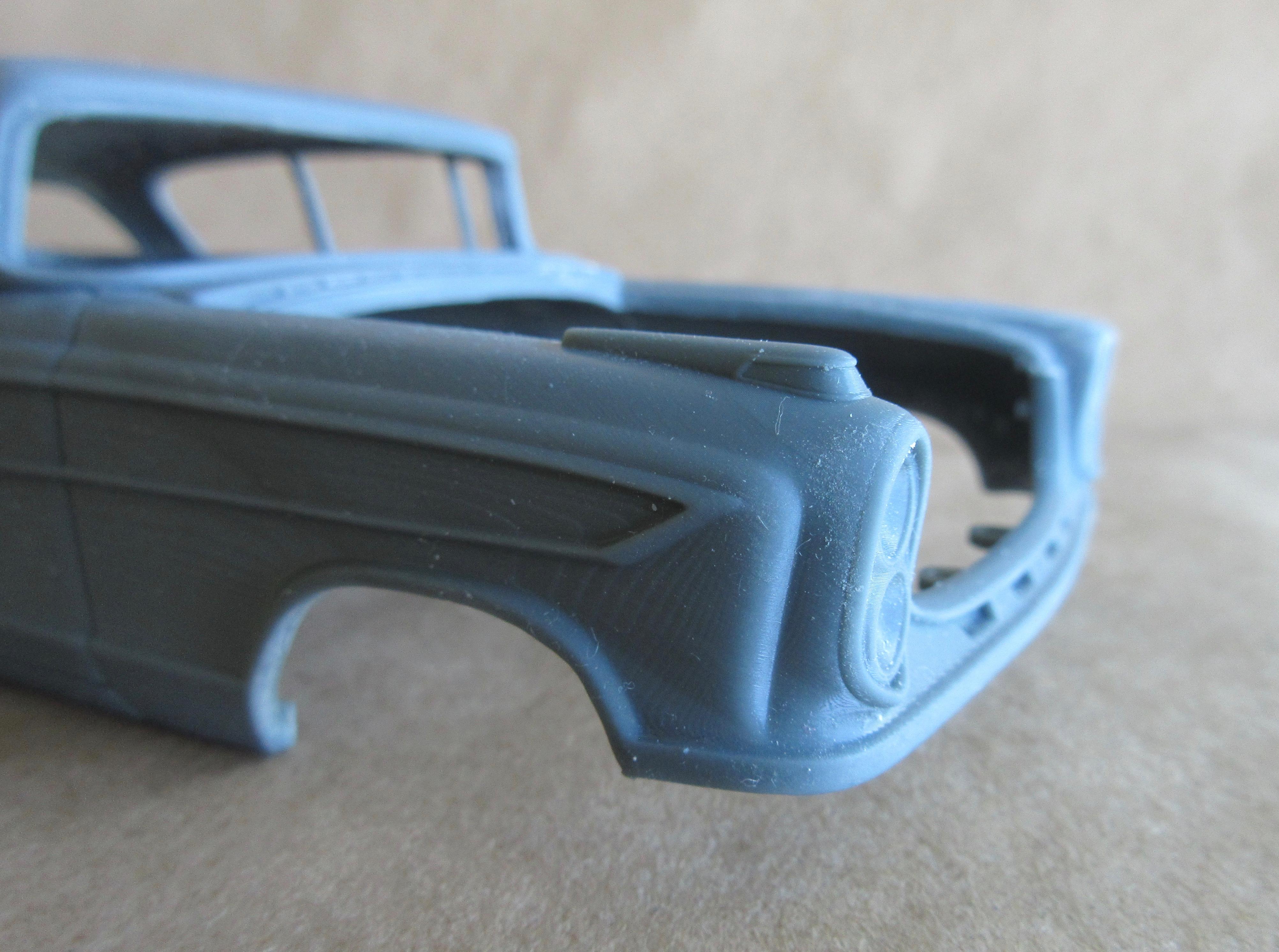

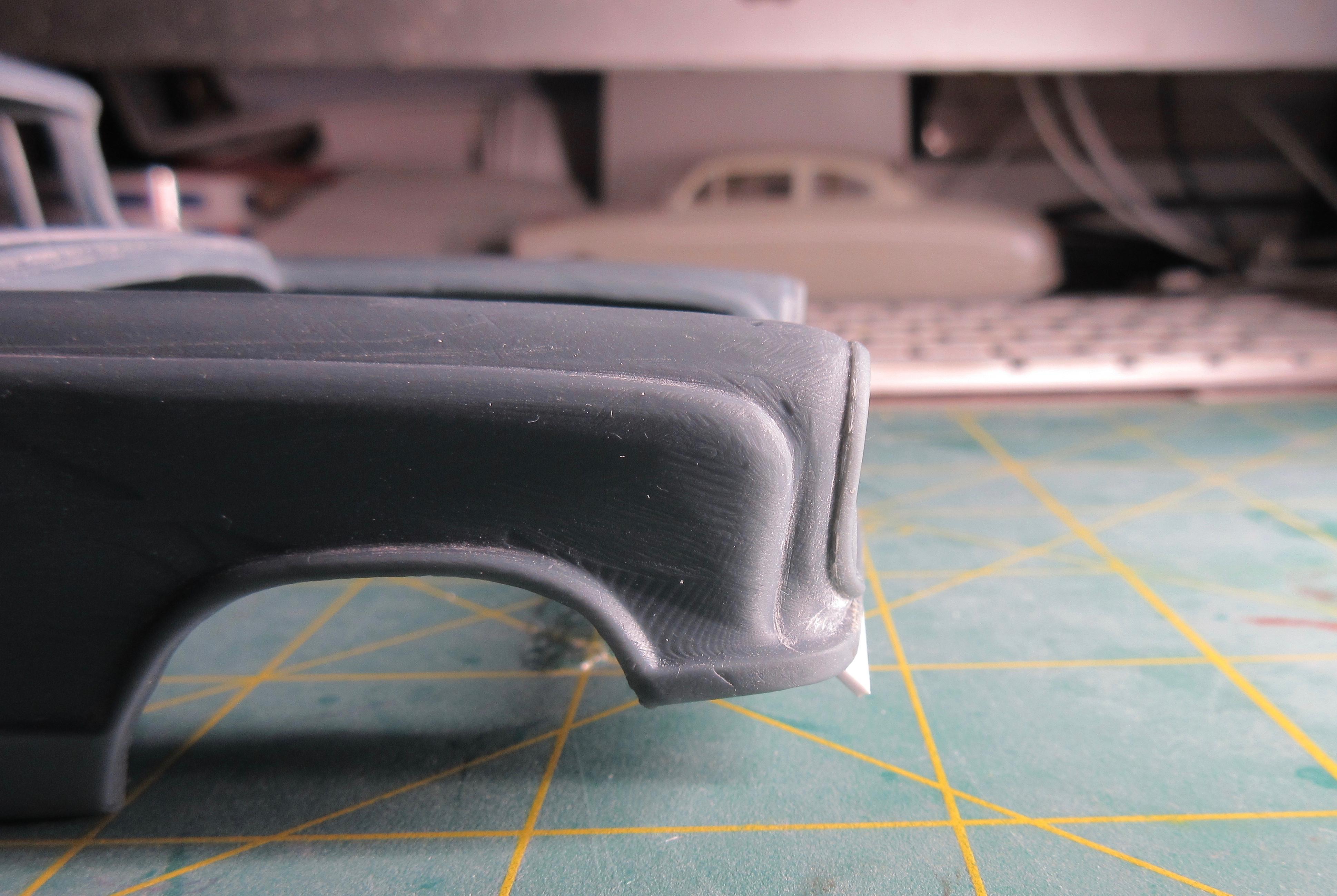

The character line that runs along the fender then down the front has the wrong curve.  It is much too sharp and will need to be re sculpted:
Ok. I started a bit of work before taking before pics.  You can see the parking light has been removed on the driver's side.  I almost never get pics before I dig in.  The vents bellow the grill are the wrong shape, but I'm not too concerned about them.  After all it's a kustom!

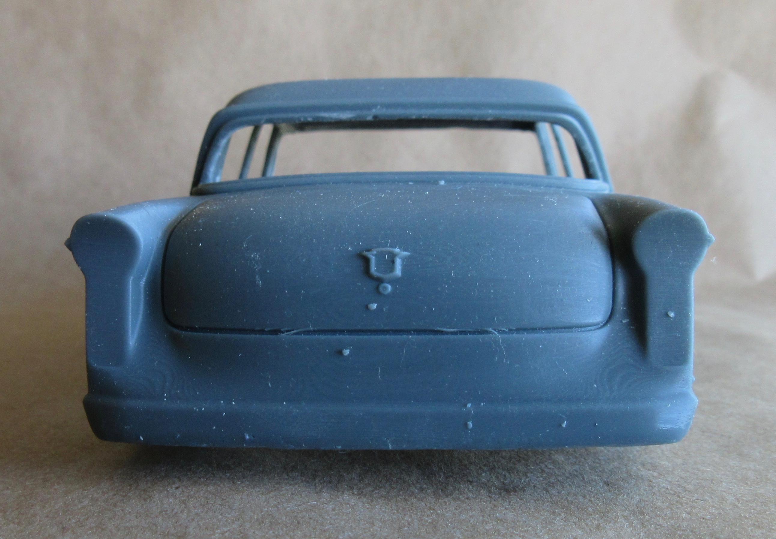

The trunk area isn't bad, nor is the taillight area.  The lower pan will probably stay just like it is:

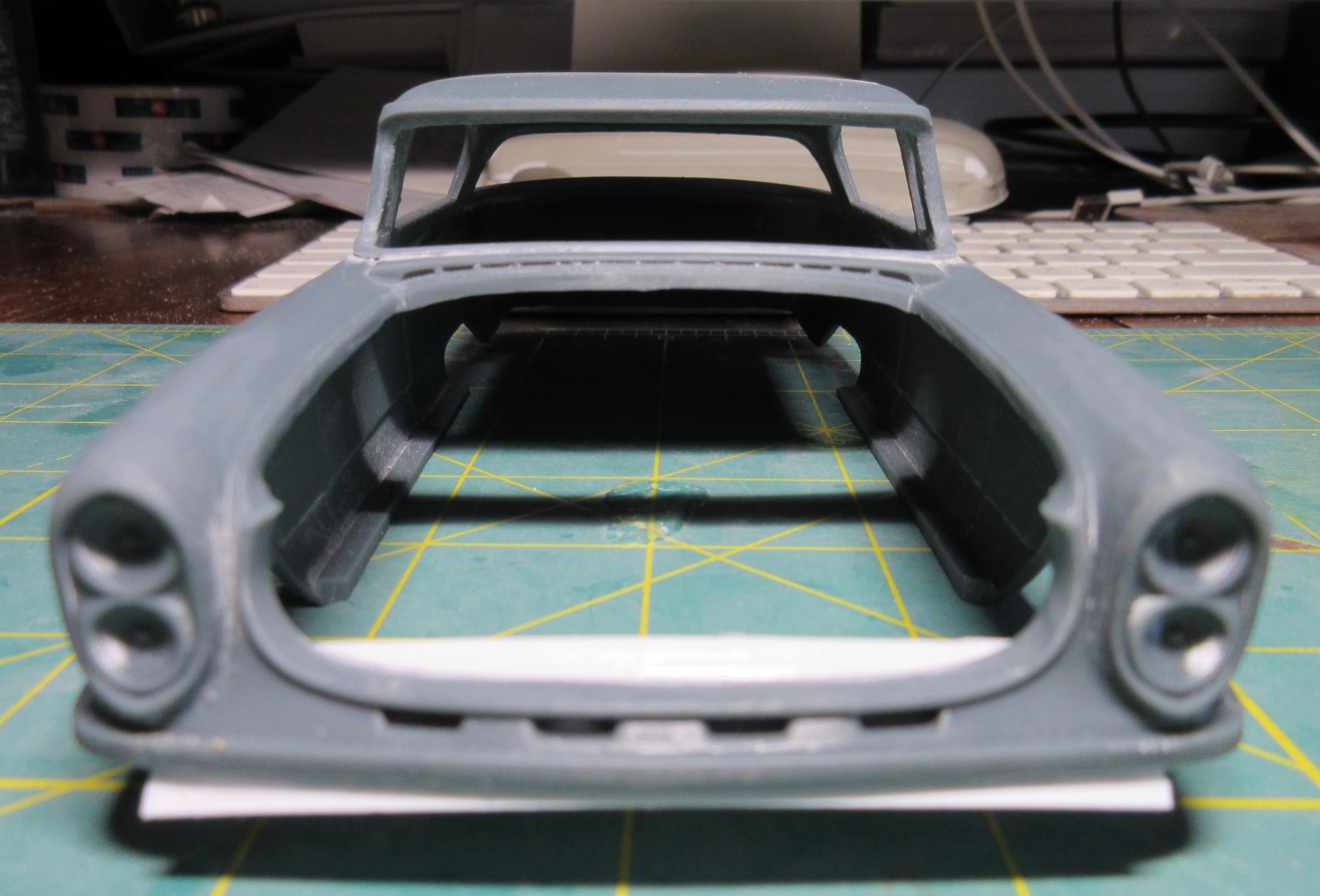

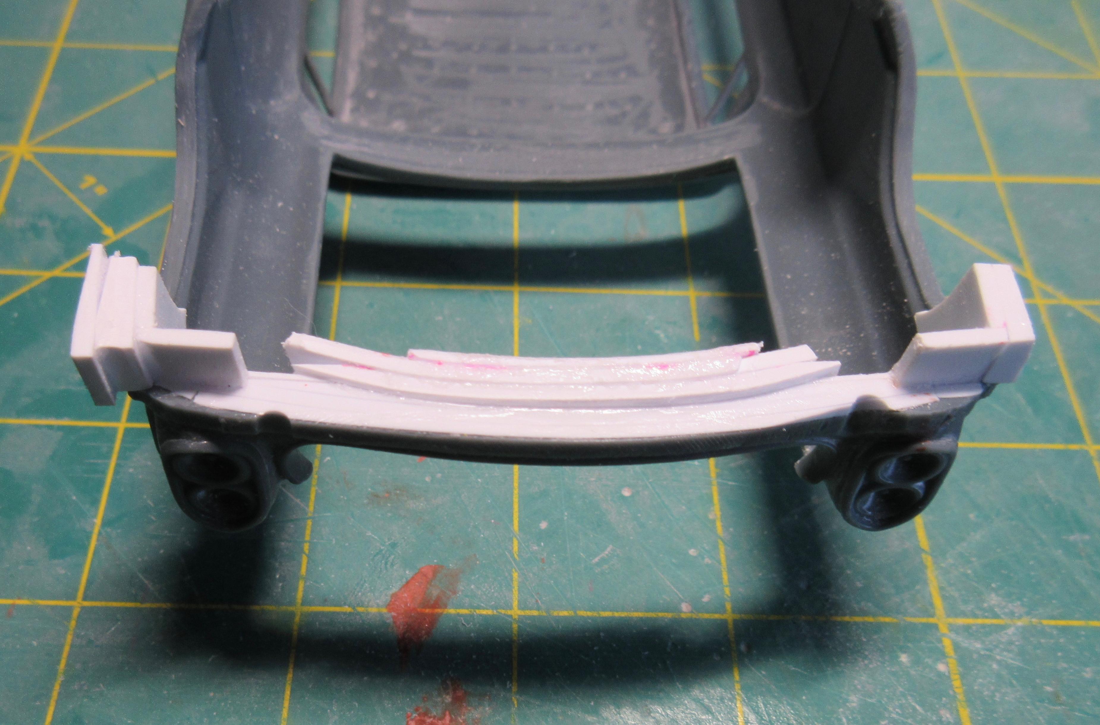

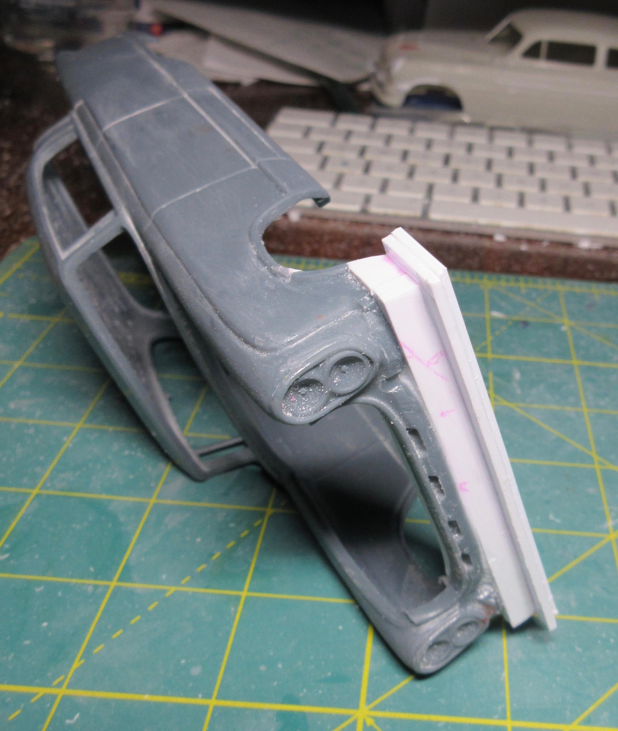

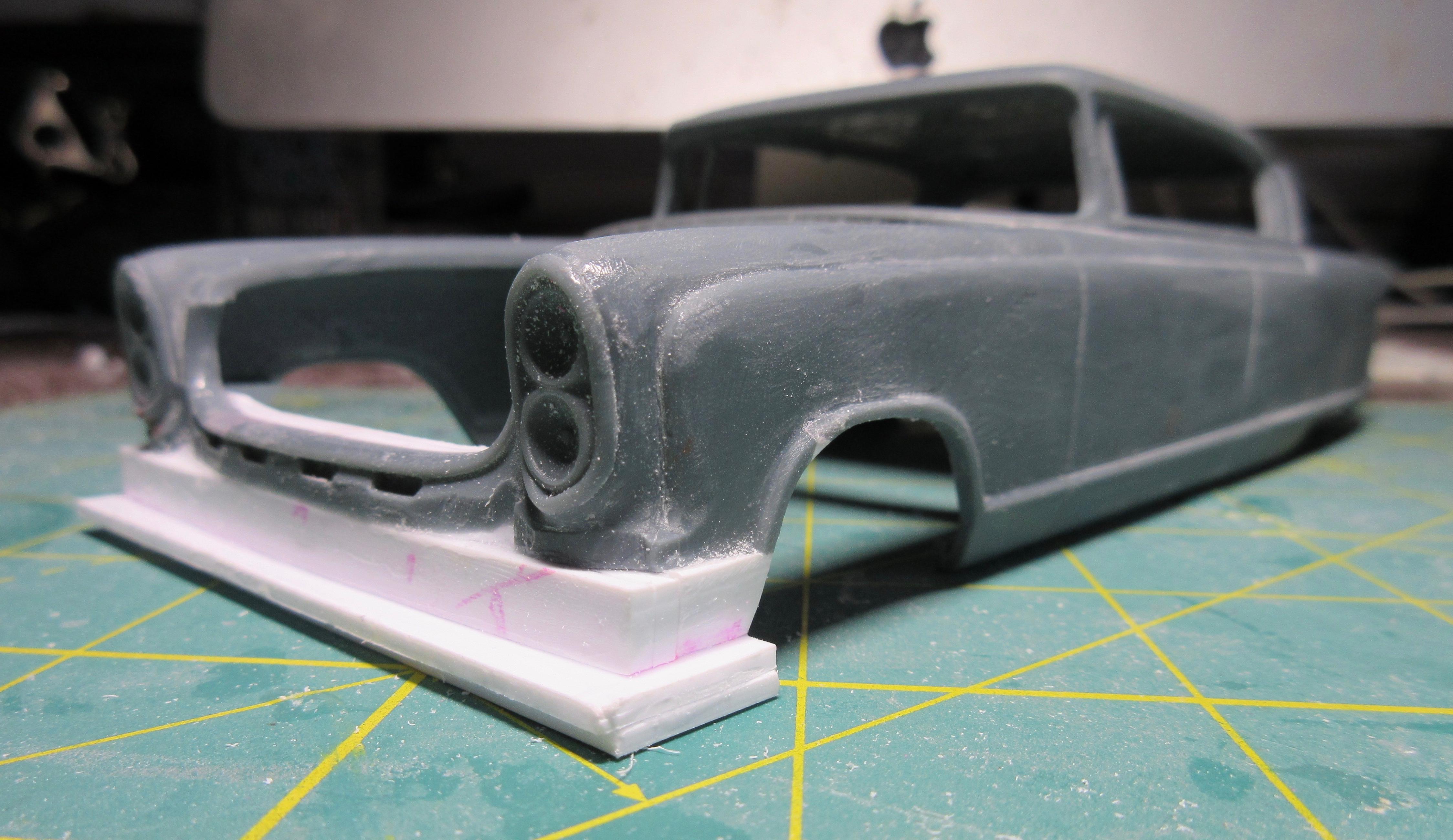

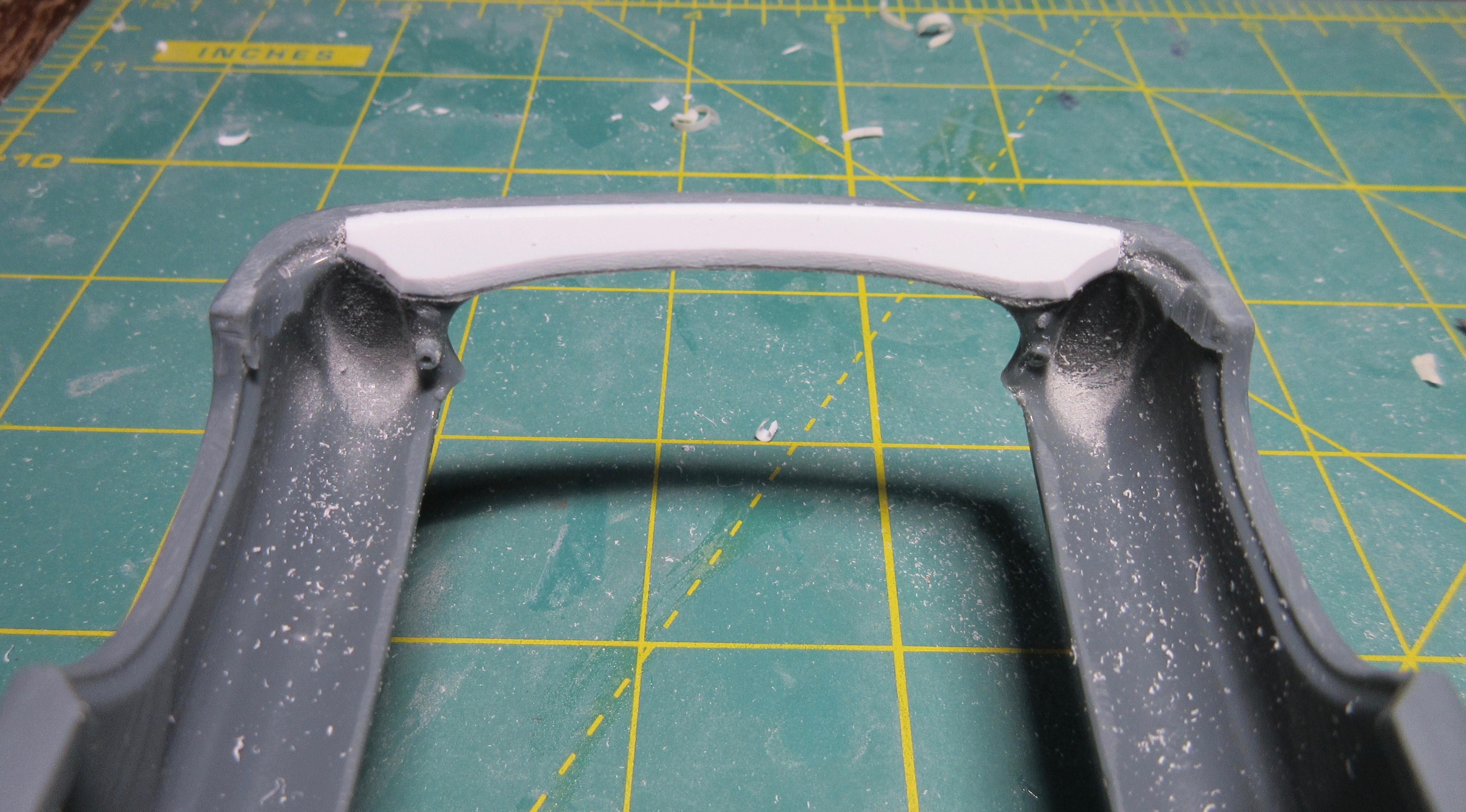

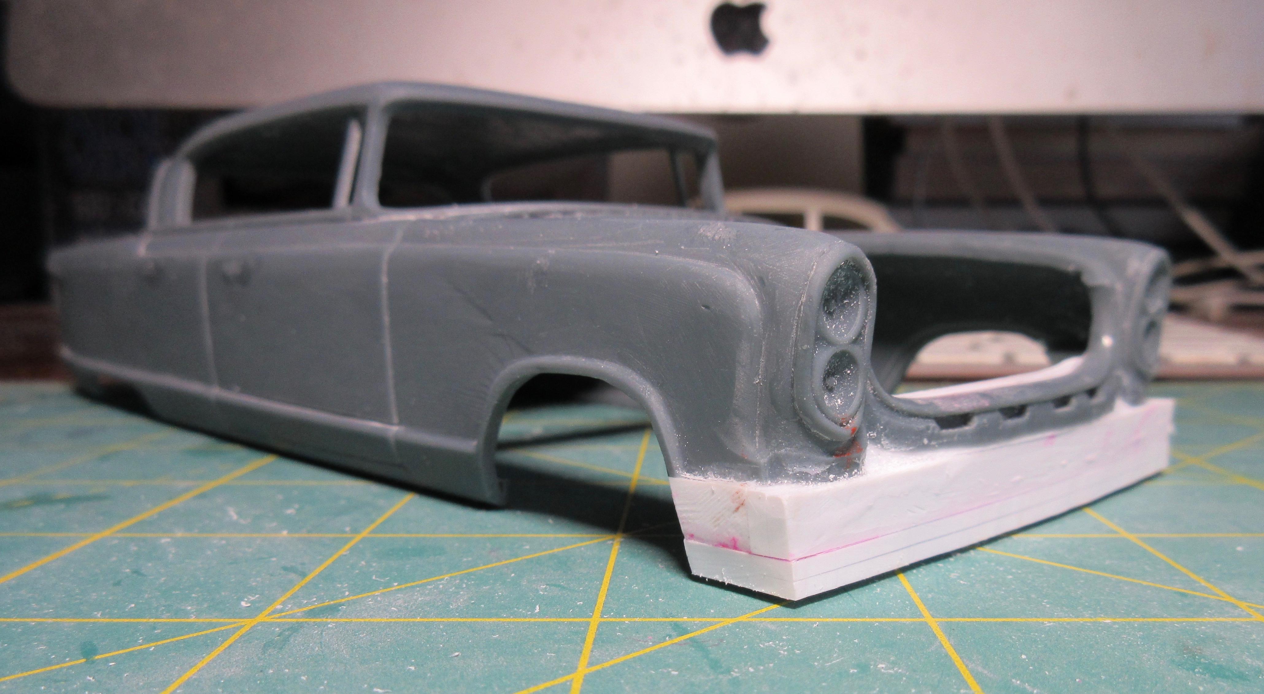

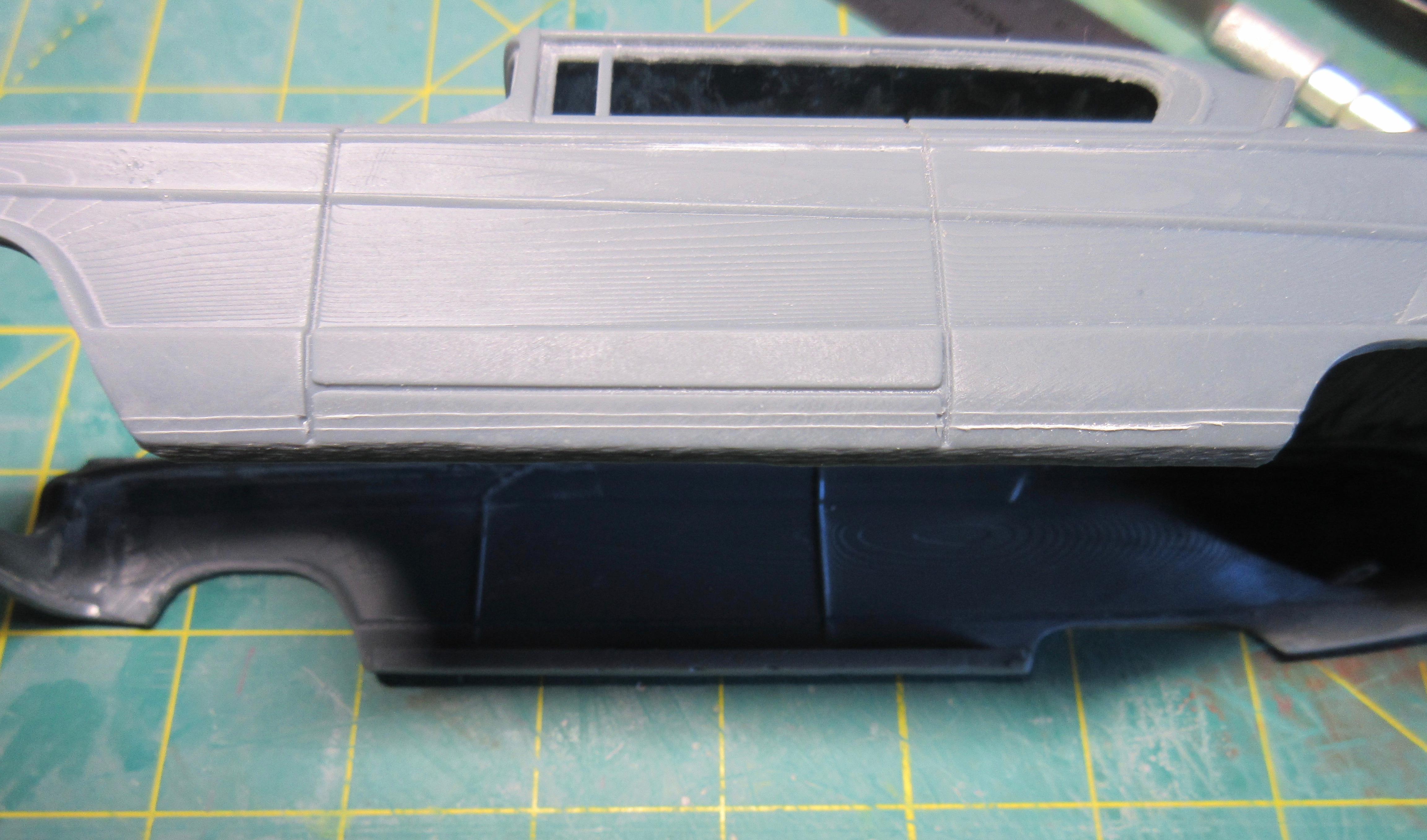

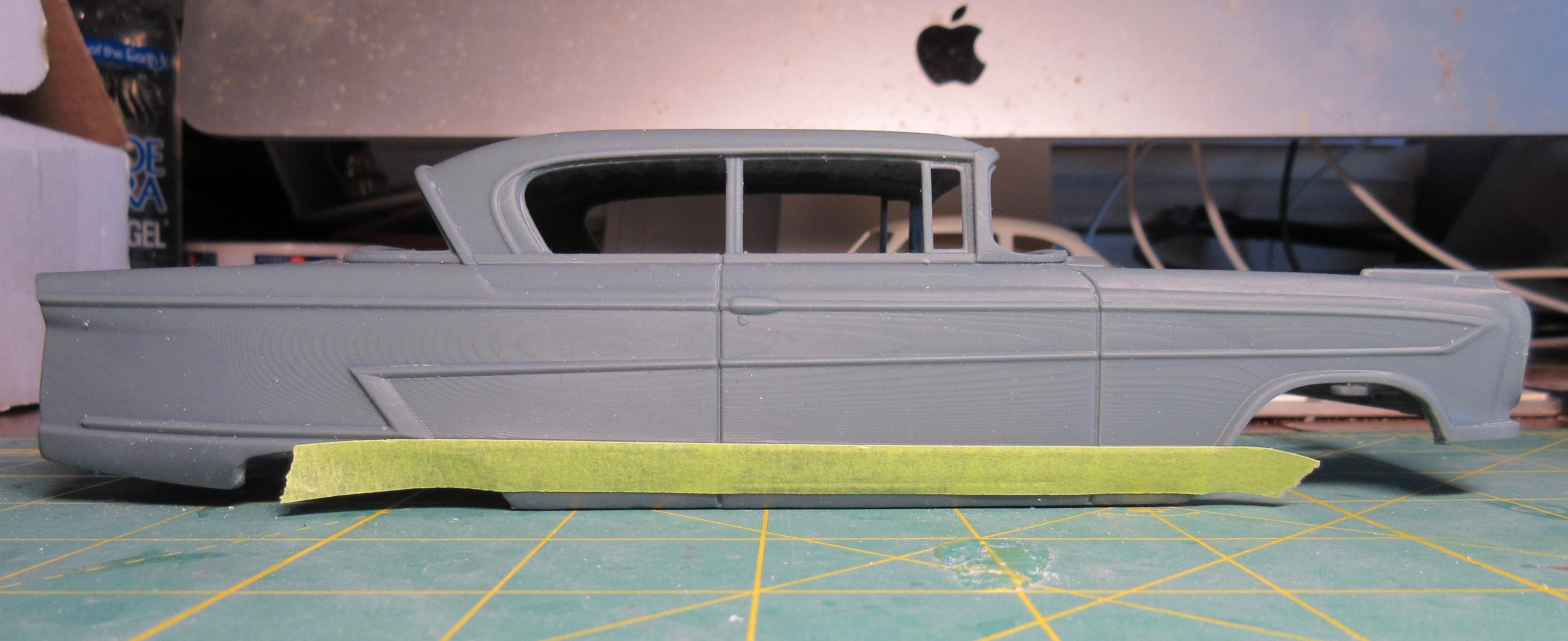

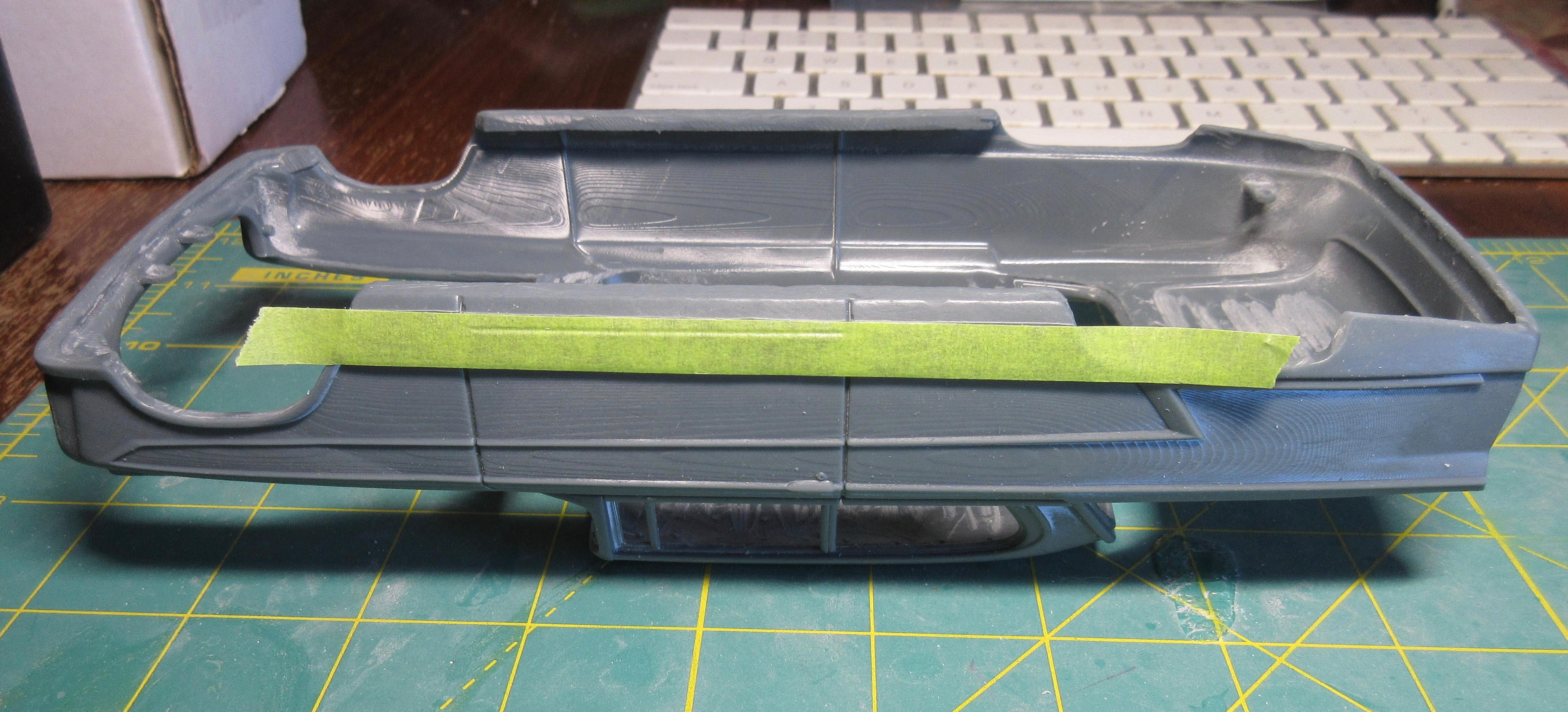

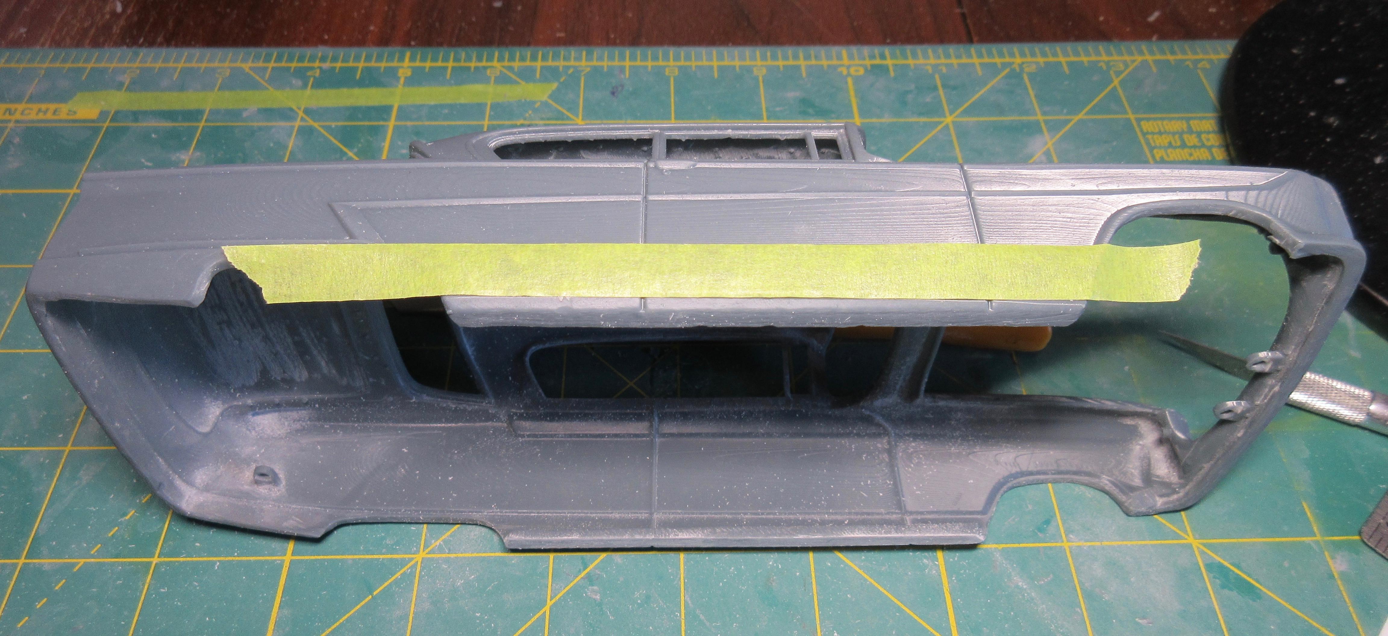

So I started with the rockers.
First I put a piece of tape 7mm wide along the character line:
I scribed a line along the bottom of the tape:
Turns out the line was too high and would not have looked right, so I repeated the process with an 8mm piece of tape:

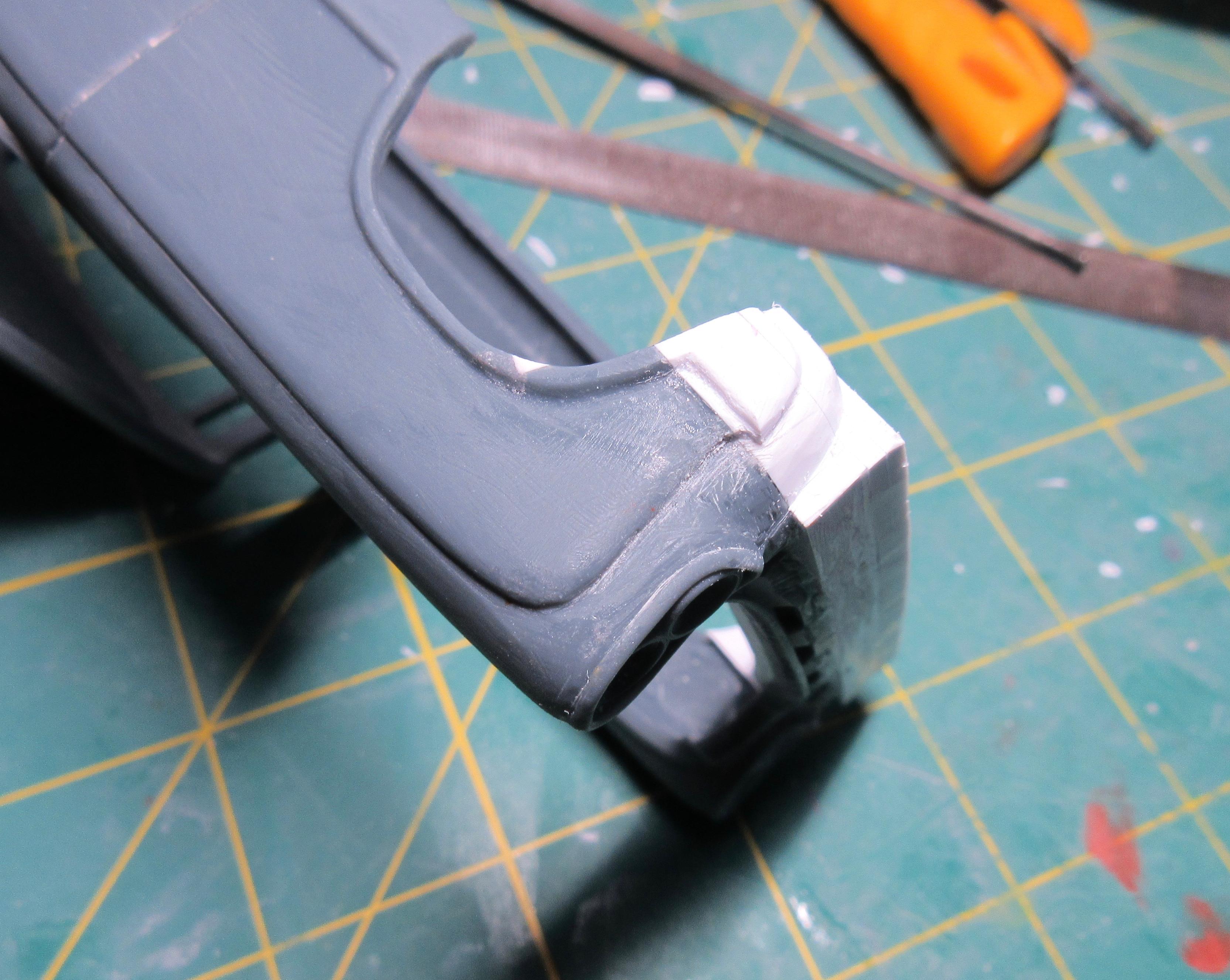

Here's the two lines scribed.  Didn't use the top one.  Cutting this stuff with a knife is really weird.  It flakes and crumbles.  So I just took the bulk off with a knife then took the rest in with a file to its critical dimensions:

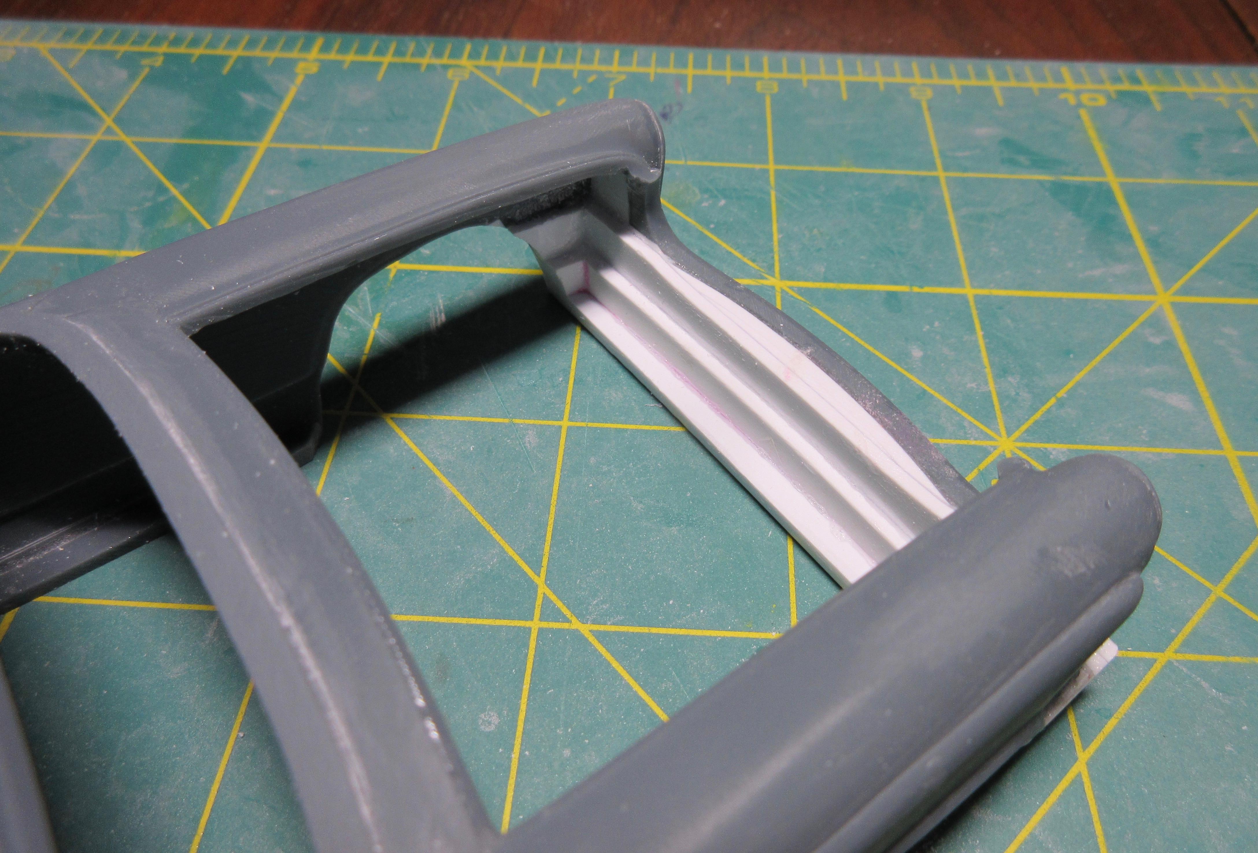

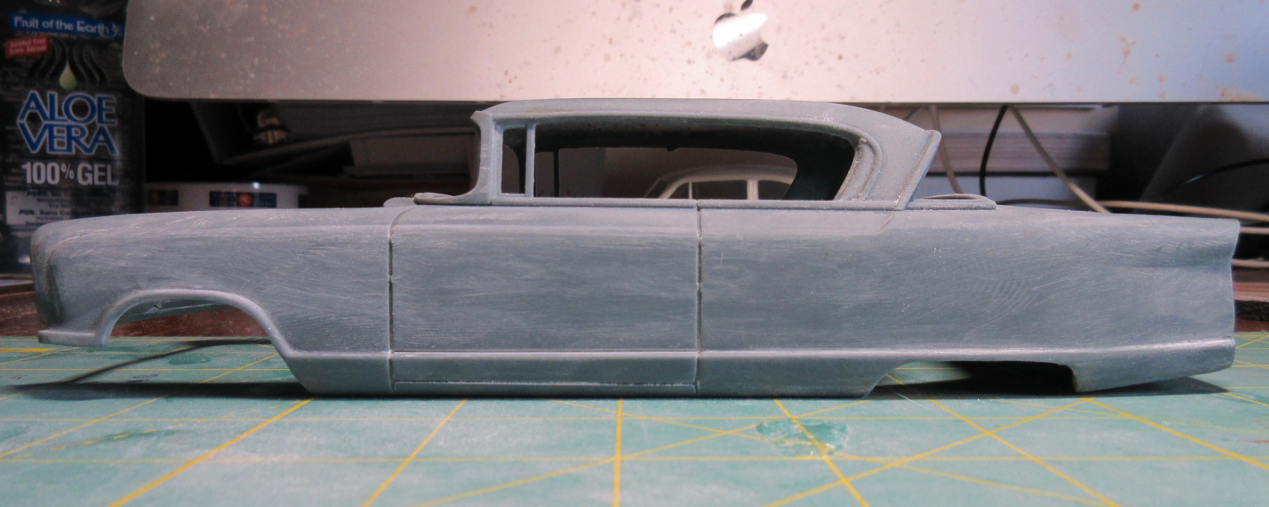

I took about 1.5 mm off the front of the rockers and 2.5 mm off the rear.  So I did a slight rocker job as well.  Then I contoured the rockers with a course file.  I think it looks much better.  The car is thick, but I like it and will be going with it.

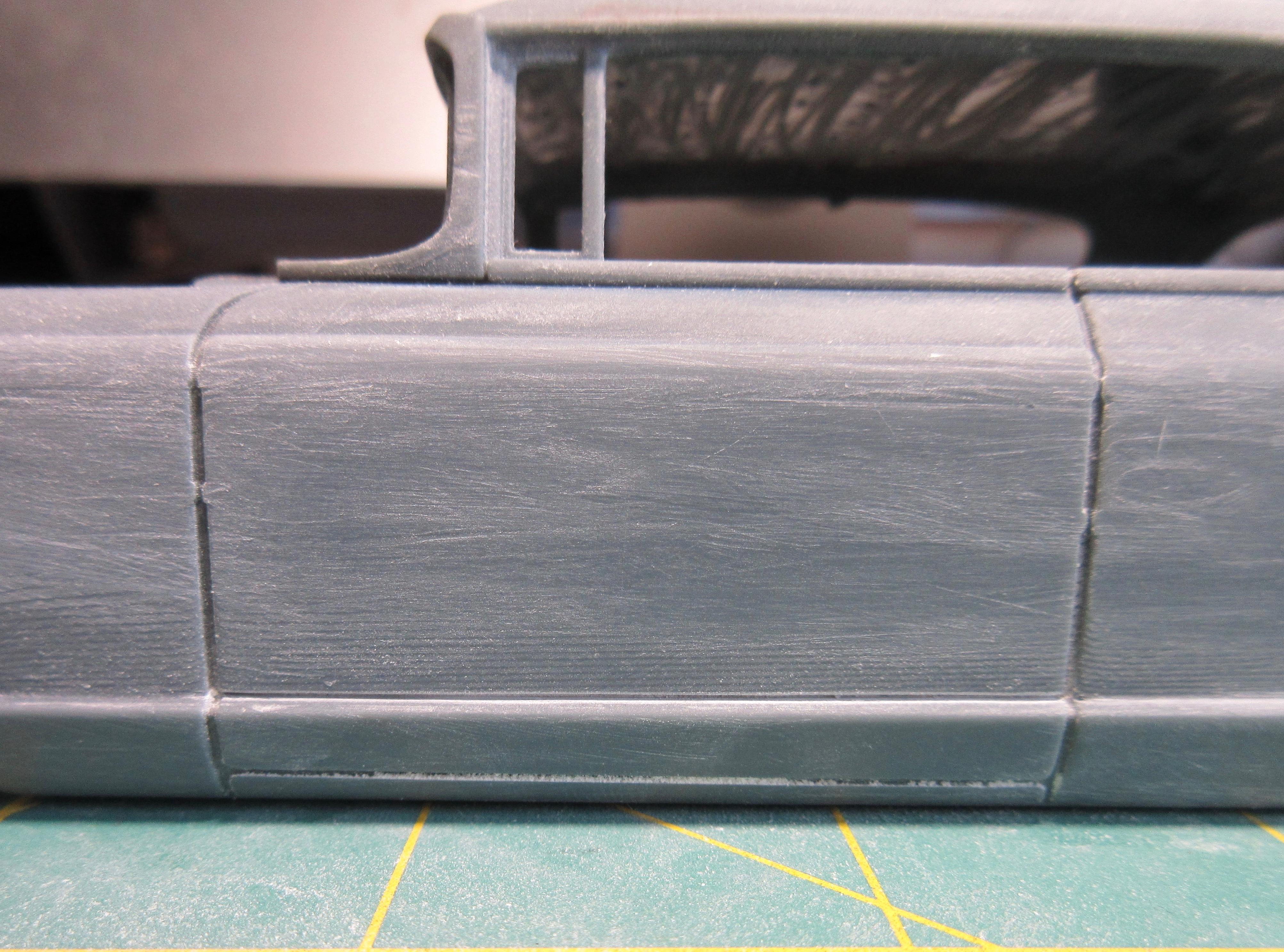

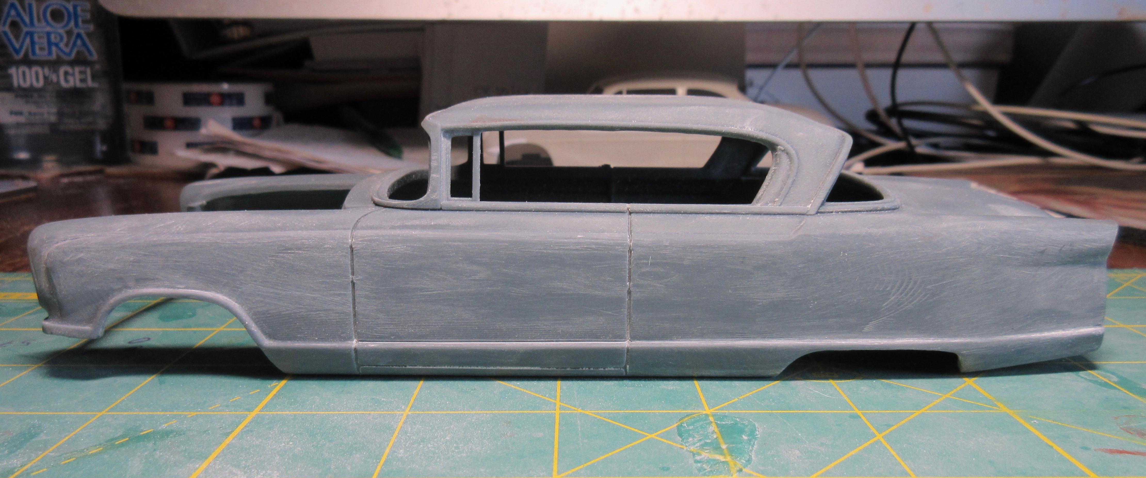

And that side trim had to go.  It was a pain to remove at the lower rear.  I'm not sure what they were thinking with that side trim, but I think it hid the natural body lines that look good and will lend themselves to a great two tone paint job:
57NASH10.jpg.4a486c32629c22021905246a6e0b7096.jpg57NASH11.jpg.7f80d2229baa3edb15dc4ff97d279540.jpg

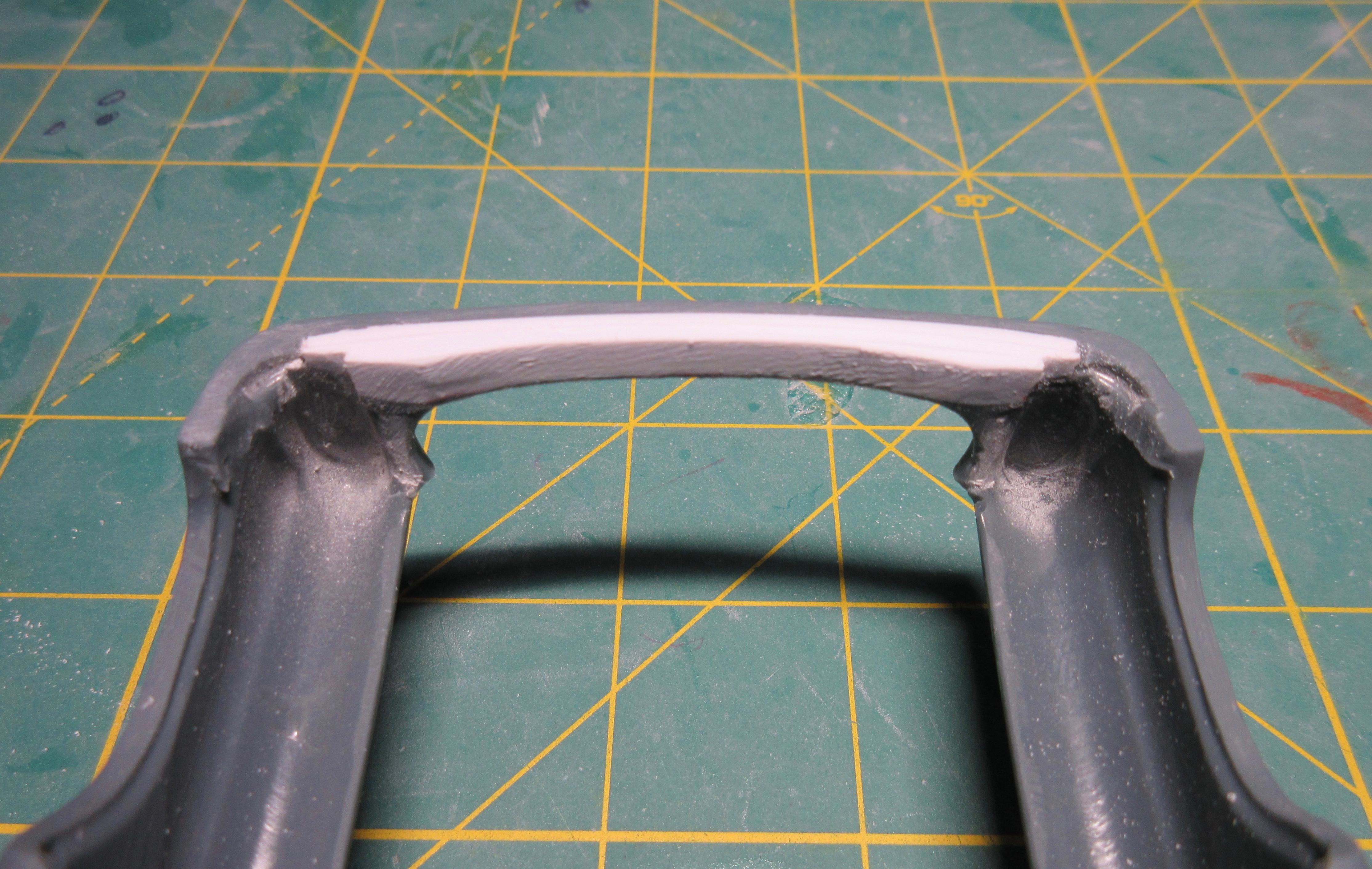

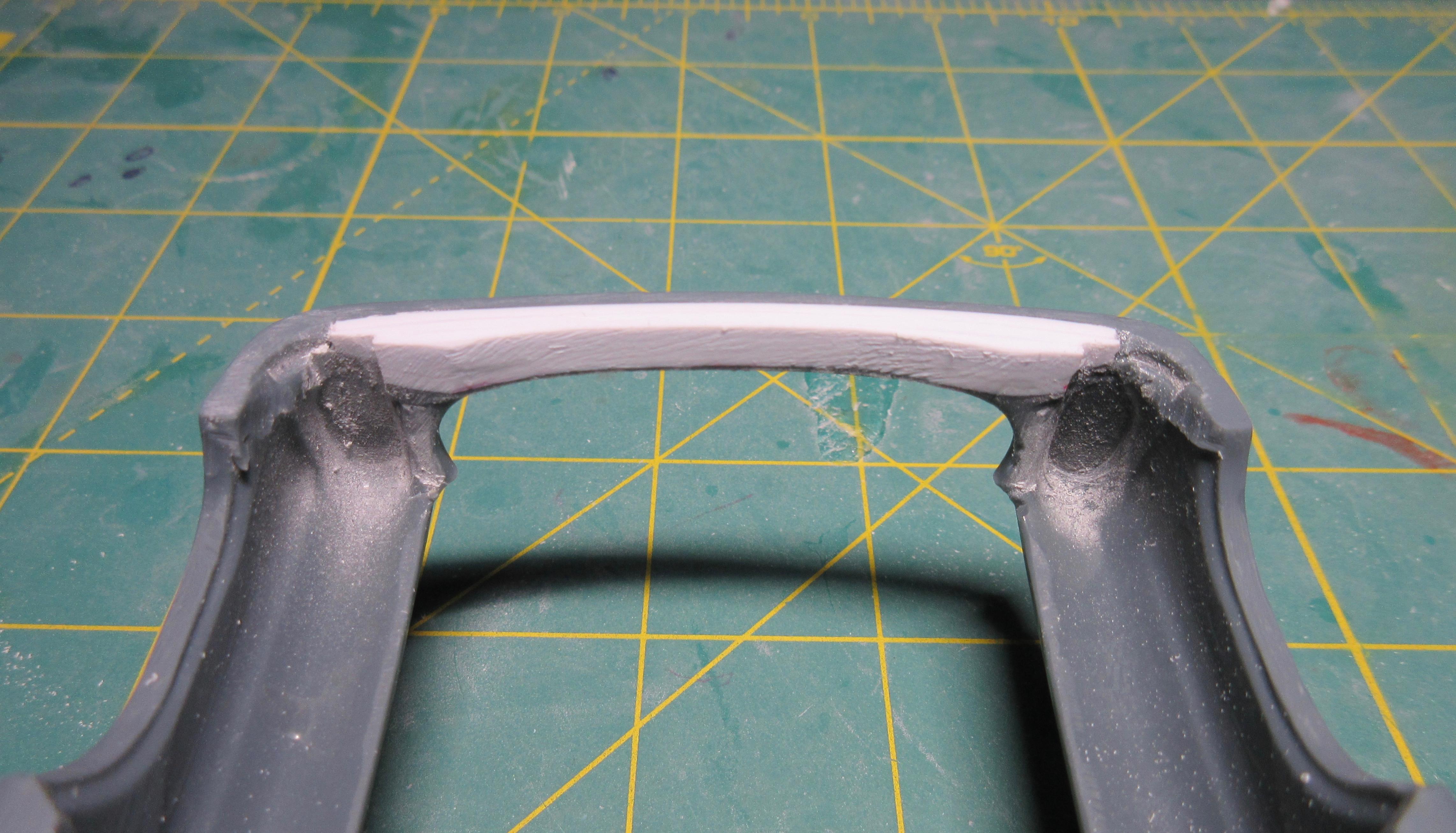

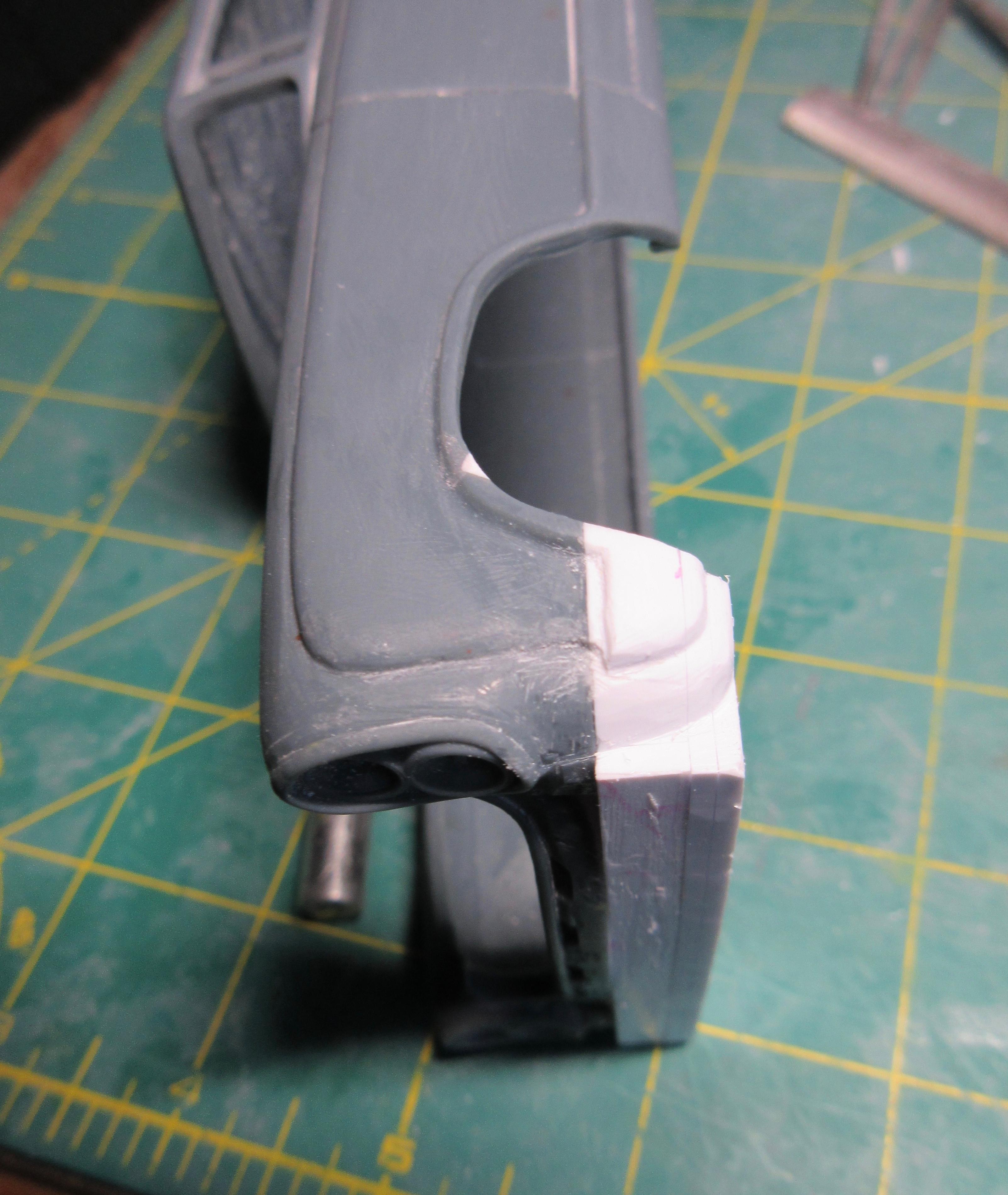

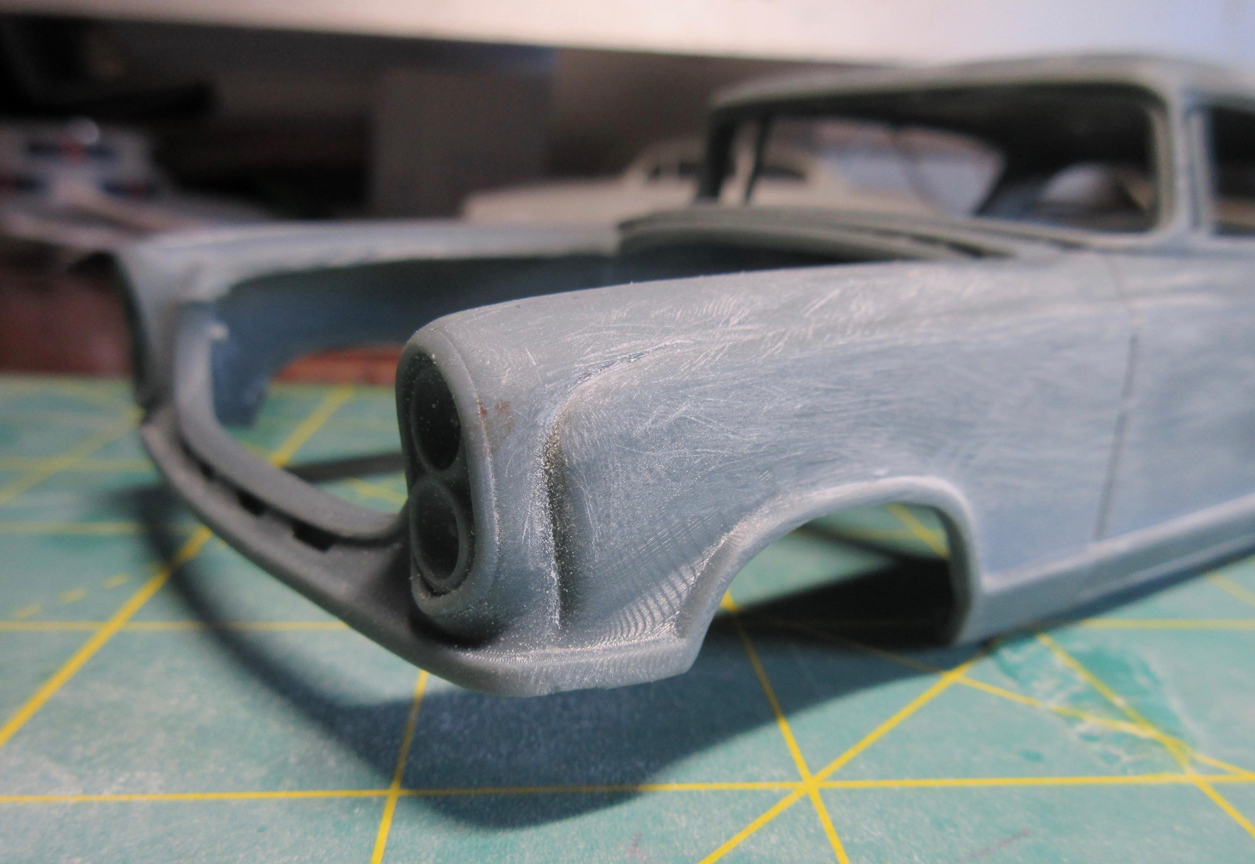

Here's a close up of the fender character line reshaped.  Now it looks like stock:
And I cut new door lines just above the lower character line.  I'll be filling in the panel lines on the rockers for a much cleaner look:
Now to make the other side match...

Another good one. I like your process of adding bulk styrene then sculpting it to shape.
For all of the file/sanding marks...do you sand them out entirely or fill with primer? A little of both?
  • Like 1
I usually sand the whole model with 400 grit before primer, including the file marks.  Then I go back and sand out what I missed once its in primer and I can see what needs work.  Sometimes after primer, I file then re sand with 400 grit if the marks are deep.  Then re prime until I don't see anymore marks.
Edited by Kanada Kustoms
