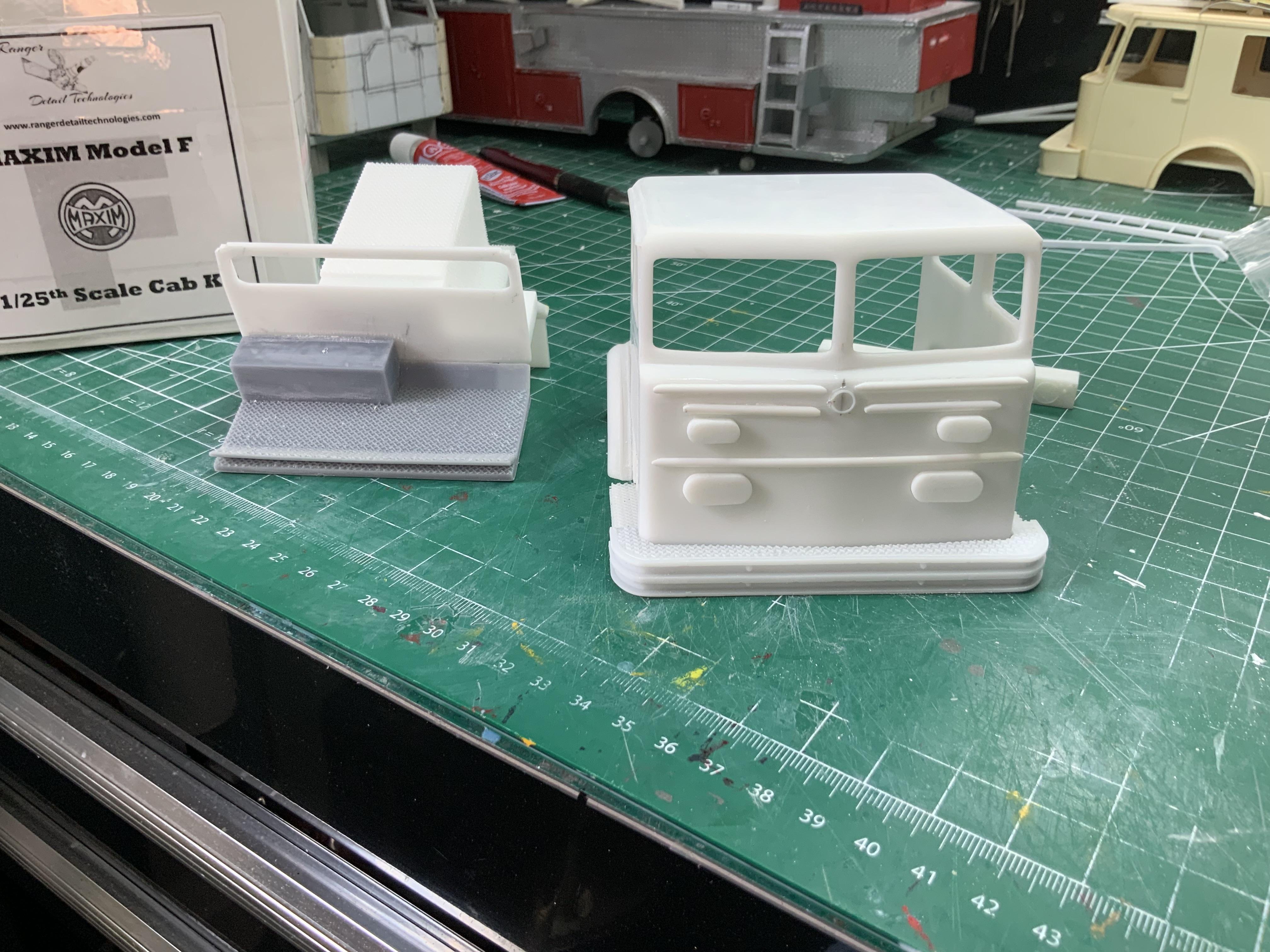

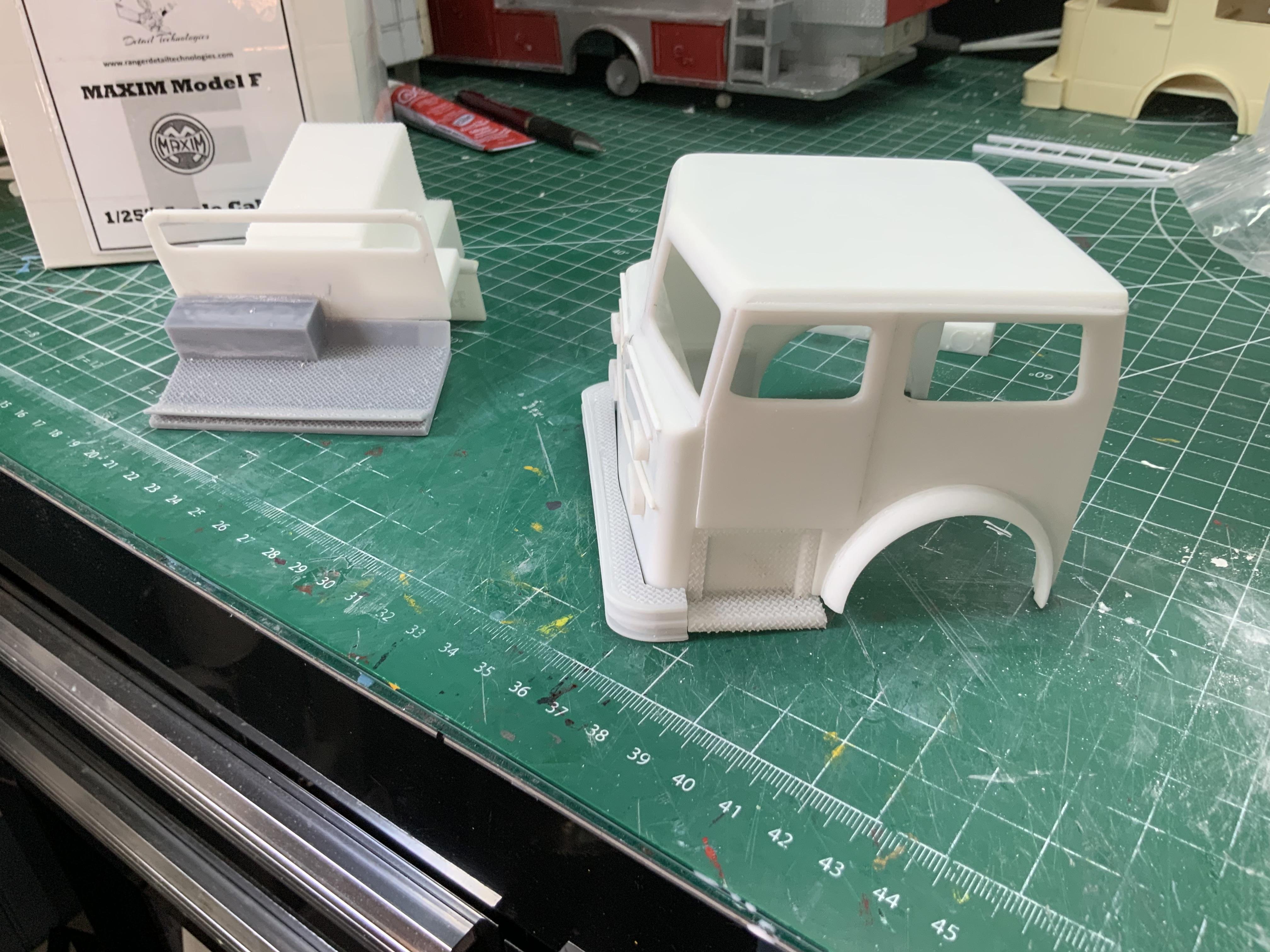

Firebuilder Posted yesterday at 03:58 PM Posted yesterday at 03:58 PM The industrial pumper is just about done. I have not been able to find decals that I need to complete it. So for now onto the next project. The cab is a Maxim F model. It is a 3D print from Ranger Detail Technologies. Almost Every thing needed for the cab comes with it, including the maxim decals. The was only minor sanding of some print lines that needed to be done. This is my first 3D print and I am happy with the quality and details of the print . I have not decided on what this build will be yet. Either a n aerial ladder , rescue or a pumper. I have started the assembly of the cab in the photos below. 3

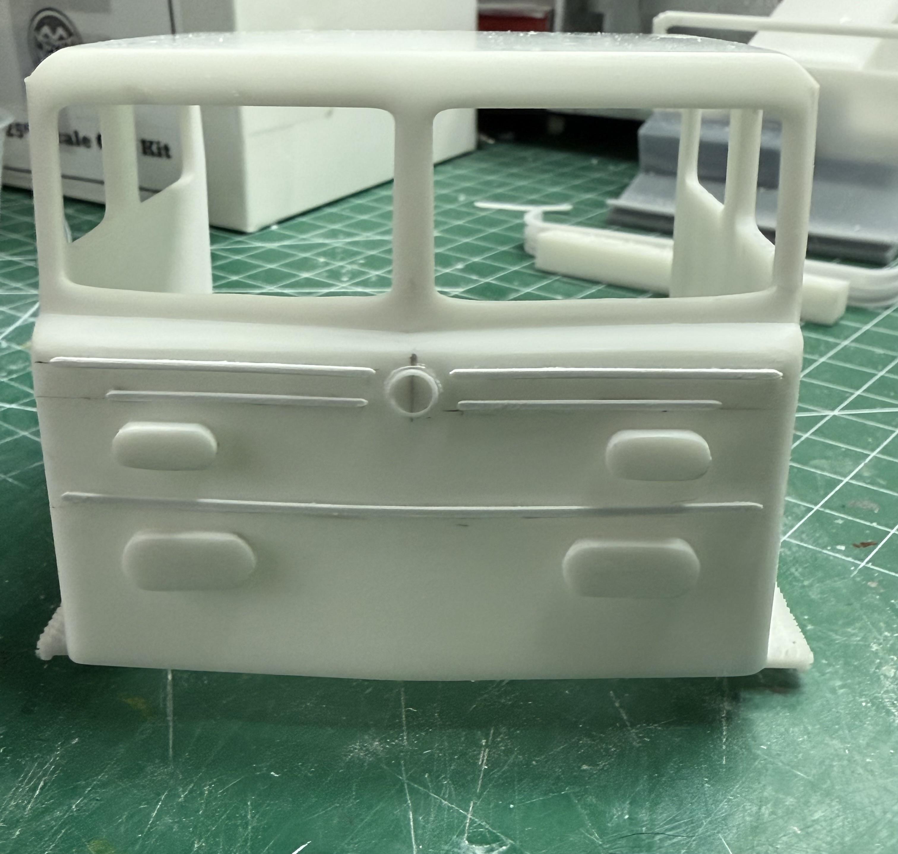

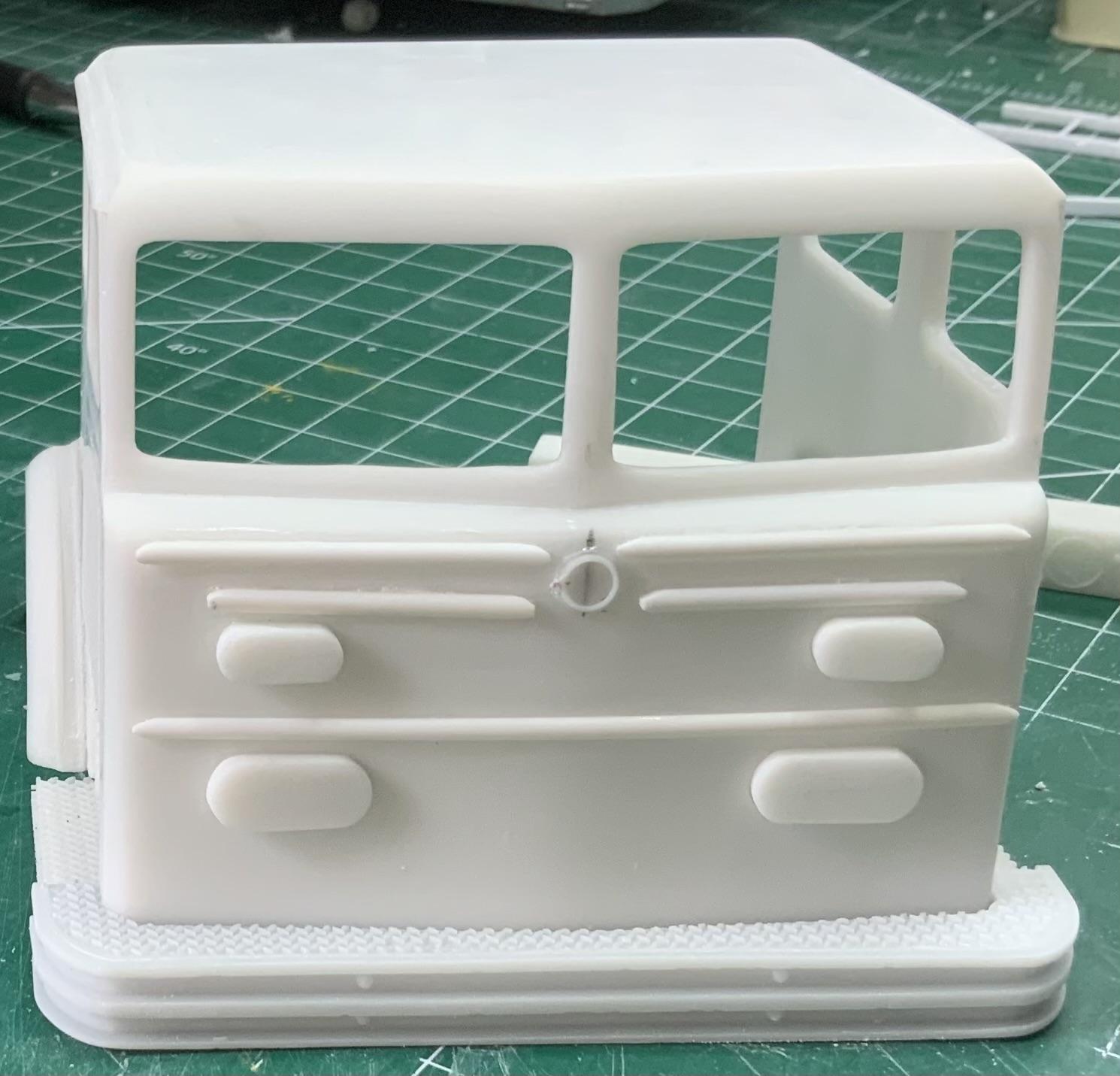

Chariots of Fire Posted 21 hours ago Posted 21 hours ago Got one of those cabs too. Have not made up my mind as to what it will be used for since there are so many Maxim choices out there. I remember Maxim building an airport crash rig with that type of cab. That would be one choice. The casting work on all of the parts is pretty good, although I think I would make the trim pieces on the cab face separate. The ones that are molded in seem to me to be too big. The real truck trim pieces were only about an inch across, perhaps 1-1/8" tops which means no more than 1.2 mm in scale to be correct. 1
Firebuilder Posted 6 hours ago Author Posted 6 hours ago Charlie, Where I was in North Jersey there were very few if any Maxims. The only time I ever saw one in person was at a muster. So for this build I am basing the cab on internet pictures. I did notice on later F cabs they added a blinker assembly. On this cab from Ranger the front trim pieces are not molded in, they give you 3 pieces of half round stock which has to be cut to size. I didnt think to sand them down to a thinner width, but now that you pointed it out, comparing them to photos, they do look a bit to large. I also liked your idea of an airport crash rig, but have not been able to find any reference photos for a maxim ARRF. The only one I did see was one with a different Maxim cab and the tires looked like they were from a tractor. Back to the trim I may try and pry them off and redo the pieces. Any other thoughts on this project from you are appreciated! Dom 1
Chariots of Fire Posted 1 hour ago Posted 1 hour ago Hi, Dom. If you don't use the kit trim look for some Evergreen half round of 0.030" . That should be close enough to a good size. The other thing is that the trim pieces are not round but flat with rounded edges. So if a piece of flat strip plastic is used glue it in place and then sand it with a foam sanding block. That might take the excess off the corners and give the pieces a rounded look. Try it on a piece of scrap first and see how the results look. Obviously the half round could be sanded as well, taking off most of the rounded surface. 1
