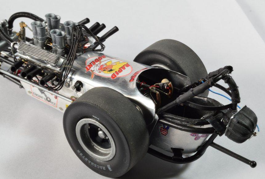

kenton44 Posted Saturday at 04:10 PM Posted Saturday at 04:10 PM (edited) Can anyone give some ideas or tips as to what to use for roll bar padding? Edited Saturday at 04:11 PM by kenton44
kenton44 Posted Saturday at 04:40 PM Author Posted Saturday at 04:40 PM Does this still work if you have to slit it to get around the bars?
sidcharles Posted Saturday at 05:18 PM Posted Saturday at 05:18 PM (edited) you can shrink the straight sections & go over the junctions with another piece scribed & unheated to suit. since heat shrink will get as small as half of its size, you may need a second size to do the overlaps. whatever you choose, be aware the heat shrink will also shrink in length when heated. the overlapped piece should be adhered with a vinyl safe adhesive. Edited Saturday at 05:19 PM by sidcharles
NOBLNG Posted Saturday at 07:17 PM Posted Saturday at 07:17 PM 2 hours ago, kenton44 said: Does this still work if you have to slit it to get around the bars? If you have to slit it, try shrinking it on a scrap piece of whatever the rollbar is made of, or wire the same size. Then slit it and install it on your rollbar. It might work? 2
Straightliner59 Posted Sunday at 04:22 AM Posted Sunday at 04:22 AM When I've had to slit it, I make zip-ties, to hold it in place. Here's a link to a how-to.
