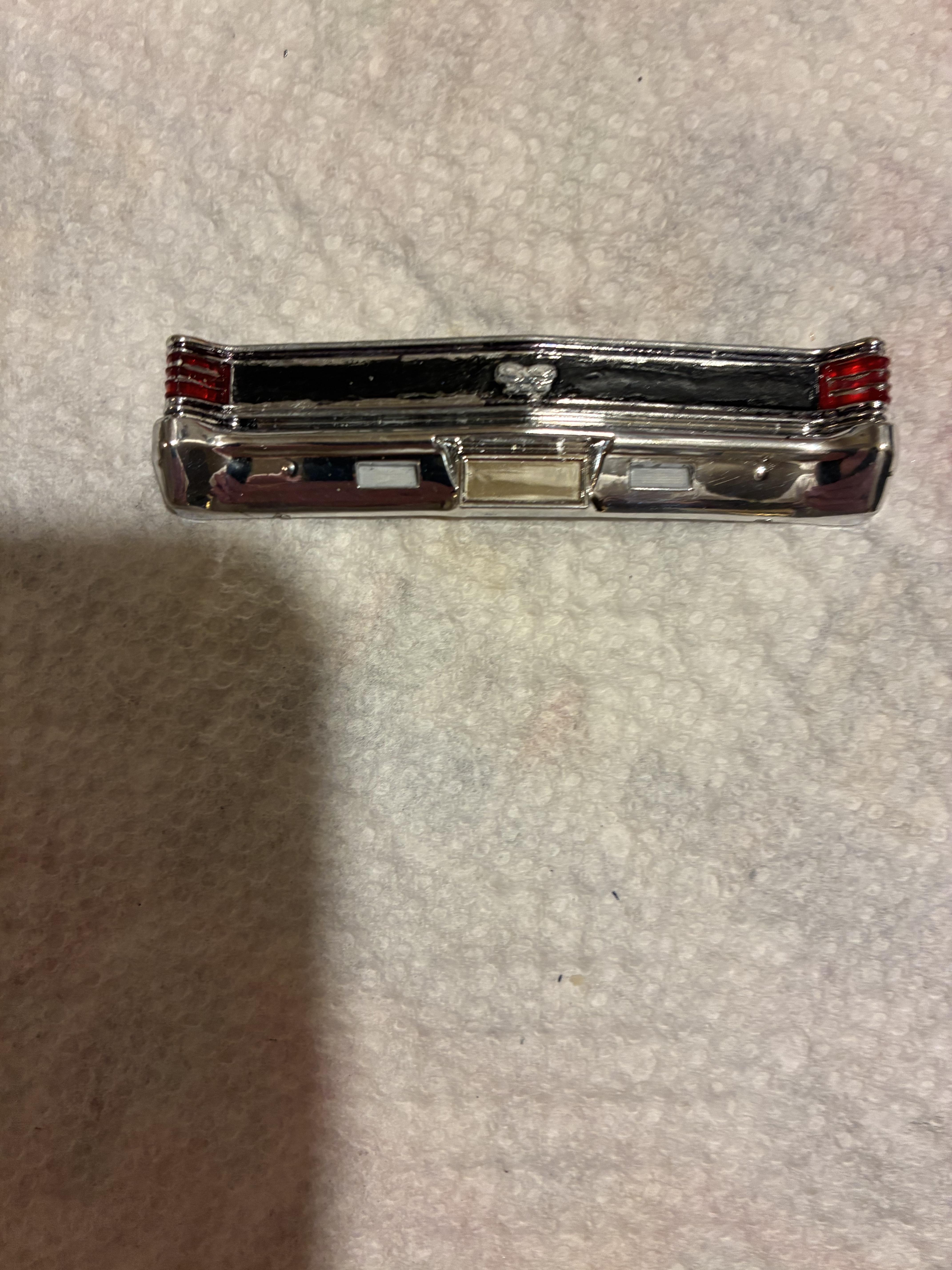

Kelly Posted 15 hours ago Posted 15 hours ago Help! I’m a beginner and I tried to paint trunk between tail lights and I found out the hard way you can’t paint over chrome So as you can see I screwed it up! So my next project is a 62 impala and I want to paint the same panel How do you remove the chrome on that part without removing the chrome on the whole bumper? Please 🙏 help this old man will be much appreciated Thank you Kelly
Shark Posted 6 hours ago Posted 6 hours ago What kind of paint are you using, I believe that's where the problem is. Might try washing the part in Dawn detergent before painting to remove any mold release. On bigger areas like a tail light panel, you could fold up some fine sandpaper and scuff that area up. 3
bobss396 Posted 5 hours ago Posted 5 hours ago I have cut similar parts apart being careful with a razor saw. Paint and rejoin them after. 1
johnyrotten Posted 4 hours ago Posted 4 hours ago Are you looking to completely strip and paint/re-chrome the panel? Easy-off oven cleaner will remove the chrome.

TECHMAN Posted 3 hours ago Posted 3 hours ago Everybody has a different method, so you should get several different answers....... Mine, like BOB's, would be to cut the bumper loose from the panel with a razor saw, toss the upper panel you want to paint into a "stripper" (personally, I use Walmart's private label bleach) to "de-chrome" it, then I use an oil-base paint (such as Testor's) to paint the part, glue them back together afterwards, and you should have the results you're looking for without tons of effort.... Hope that helps..... 😊 DJ
NOBLNG Posted 2 hours ago Posted 2 hours ago (edited) It is just the black area you need to paint so I have two suggestions. One would be to carefully mask and spray paint the black area. Then the paint could be carefully rubbed off the raised script with a Q-tip moistened with the appropriate thinner, similar to the BMF under paint method. Second, if you are brush painting it, would be to very carefully scrape or sand the chrome off the area to be painted. Spraying it should lay down smoothly over the chrome I’m guessing, but you could scuff the area to be painted for added adhesion. Edited 2 hours ago by NOBLNG 1

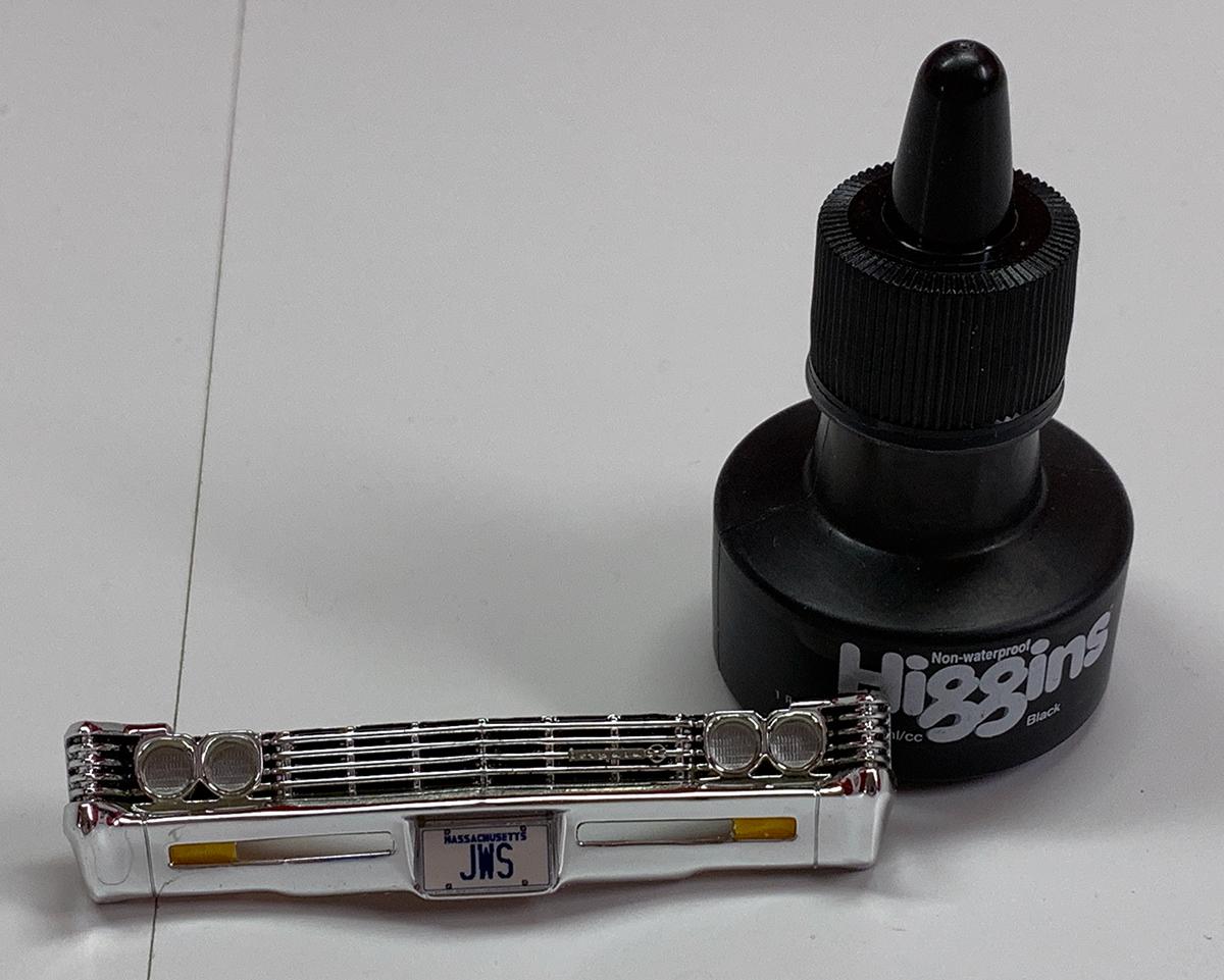

Shark Posted 2 hours ago Posted 2 hours ago It might be helpful if you recommend a paint that he should use. I've never attempted to paint over chrome myself I have used Testors and Tamiya bottles to paint on chrome with good results. I thought he might be using a craft paint or a water based product. When painting the panel pictured, I will thin down the color I am using and flow it up to the edges and around the emblems like a wash, then when it it dry, paint the rest with the unthinned paint. This way gives a nice sharp edge 1
Fat Brian Posted 16 minutes ago Posted 16 minutes ago It's hard to do something like that perfectly clean, use a Qtip with whatever solvent you need to clean your painting off quickly before it completely dries. Tamiya panel line accenter also helps with the narrow lines and emblems. Its also helpful to have a chrome pen of some kind to touch up the chrome because you can rub through if you work it too much.
