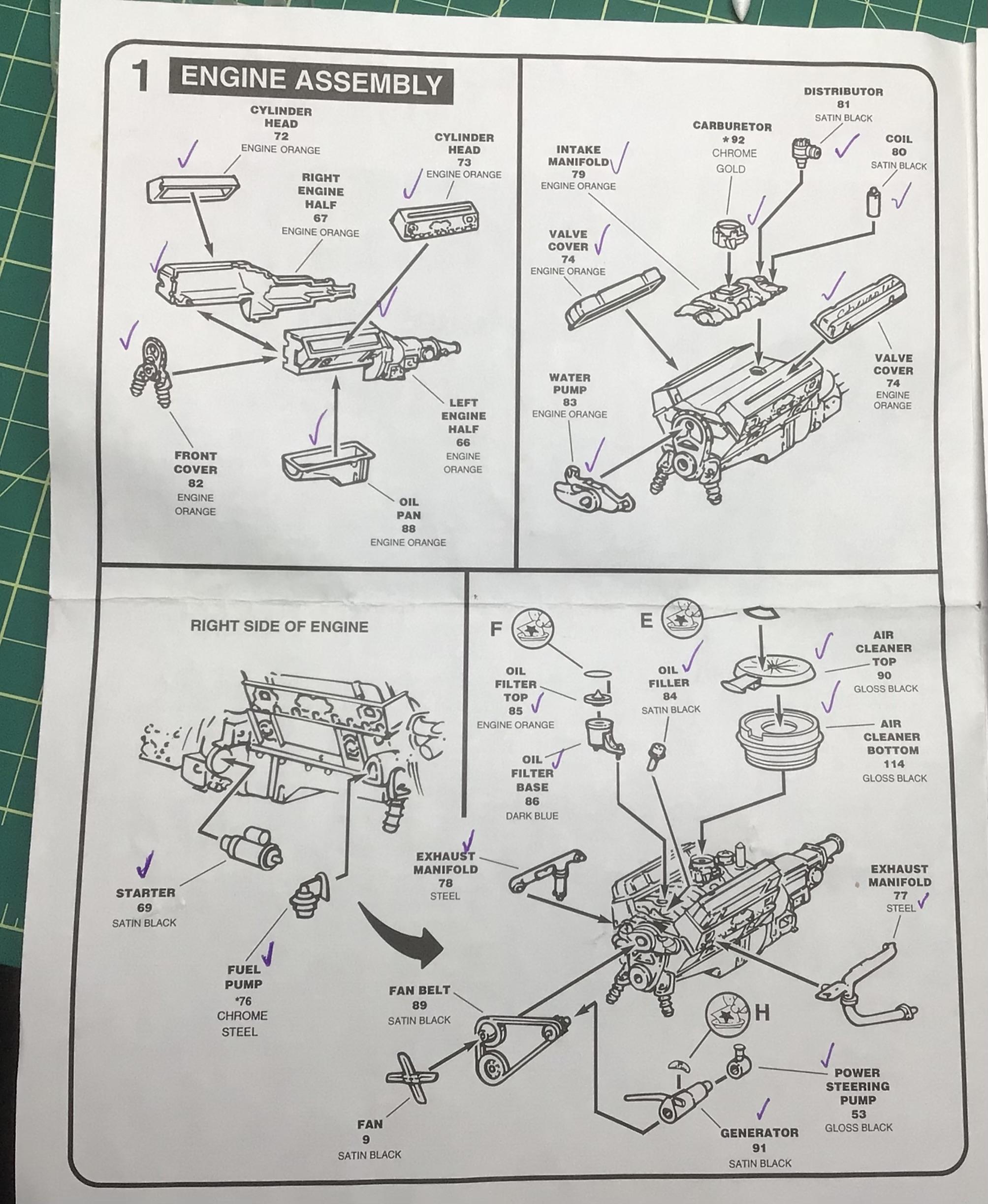

NOBLNG Posted 17 hours ago Posted 17 hours ago (edited) The Revell ‘56 Del Ray kit has a nice one…but no oil filter. The Monogram ‘55 Bel Air Convertible has a really nice 265. You might be better off looking for a 327 though. Edited 16 hours ago by NOBLNG
