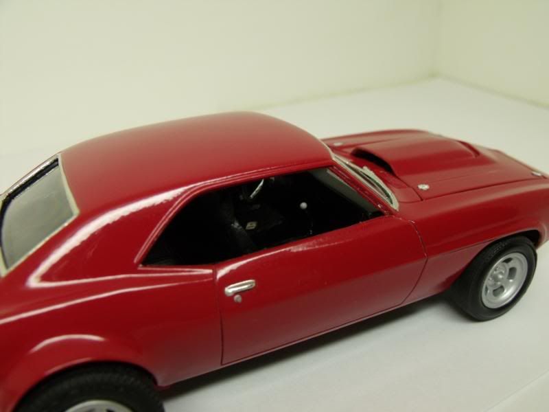

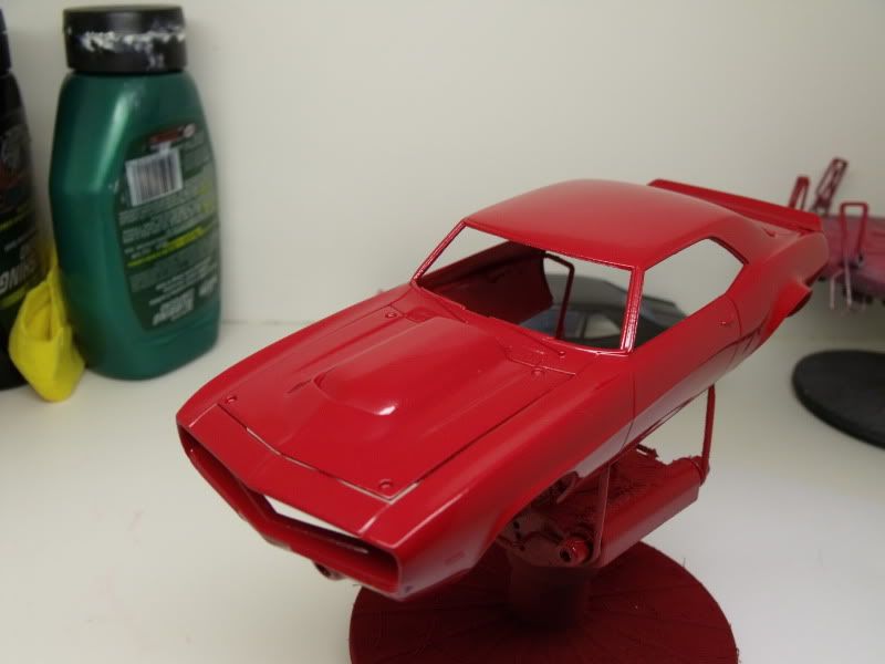

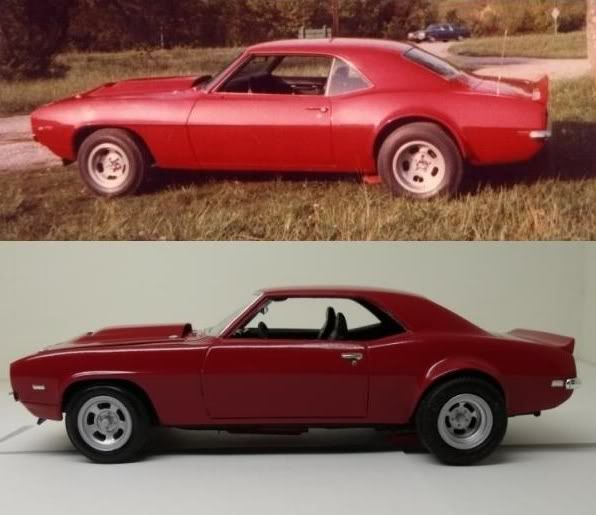

loudcherokee Posted June 20, 2009 Share Posted June 20, 2009 (edited) Hello folks, I just joined up here, and thought I would share my current work in progress. I'm working on my uncles 1969 Chevy Camaro Z-28. It was a car that he had when I was a child, and it is one of the only cars that sticks out in my mind from my child hood. Here are some pics of the car I'm replicating -- As you can see, it wasn't necessarily stock. Radiused fenders, and fender flares for the rear. Chrome trim removed, no badges anywhere, except the Z-28 badging, L-88 Fiberglass hood. My starting point was the Yenko 1969 Camaro, since it was a kit that I had laying around, and I couldn't find any more of the Z-28 kits locally. I started by sanding off the scripts everywhere on the body. and filling in the gills in front of the rear fenders - Then I started work on the fender flares. I used Evergreen strip styrene, and attached it to the inside of the fender by using plastic weld. Here's a comparison shot - stock vs non stock - Edited June 22, 2009 by loudcherokee Quote Link to comment Share on other sites More sharing options...

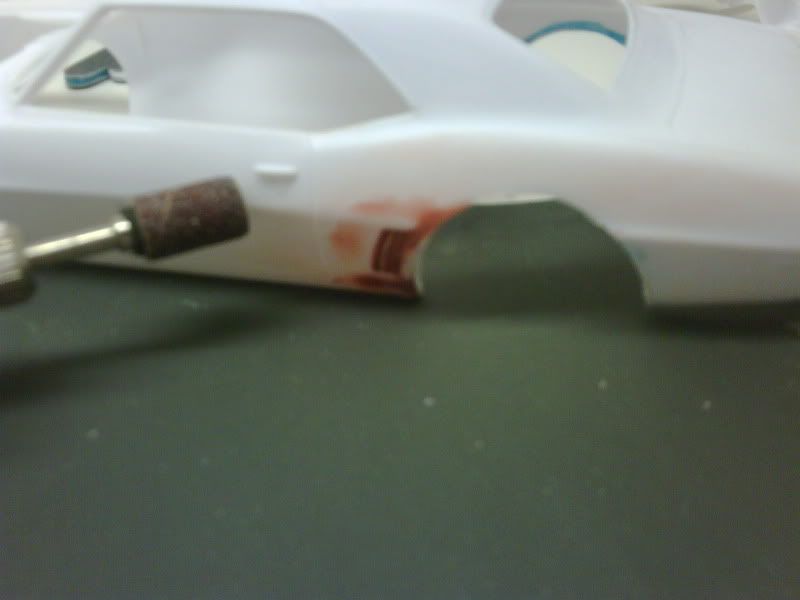

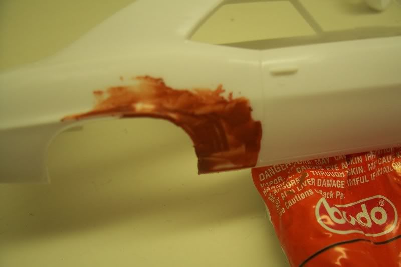

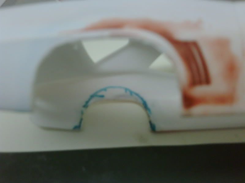

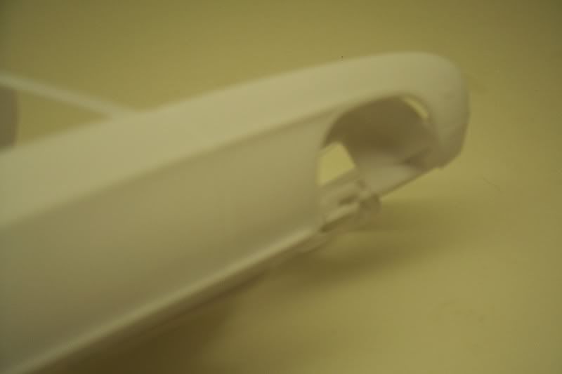

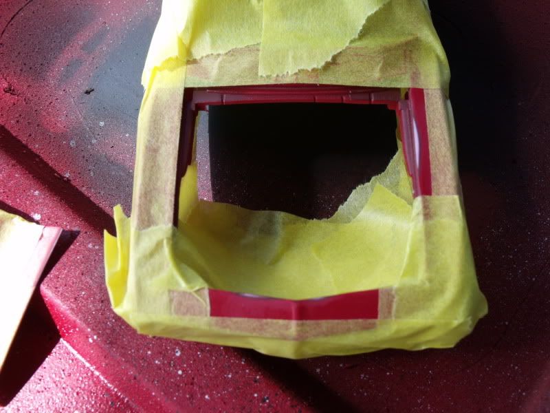

loudcherokee Posted June 20, 2009 Author Share Posted June 20, 2009 Now, at this point, I was ok with the flares, but still somewhat unhappy with the results. I looked and looked, and then finally seen that the fenderwell on my uncles car came up well above the body molding line in the rear quarters, so i decided to rip the fresh fender flares out, and grab my rotary tool. By placing the chassis in the body, I drew a line where the fender wells were at on the chassis, so I wouldn't go above the frame. I followed this line, and then was finished with radiusing the fenders The new fender flares match my uncles ride much better After this, I went through alot of trial and error with the flares. Bunches of bondo, superglue, and baking soda. Inbetween all of this, I was also working on the interior and engine. painted the seats and door panels gloss black, then hit it with testors dull coat. Added seatbelt material sourced from michaels craft store, and some photo etched hardware from Detail master, purchased at www.scaledreams.com A mockup of the ride height, before I sourced the L-88 hood from the baldwin motion 69 camaro, and after I obtained the 5 slot fenton mags from PSF hobbies. The tires at this point were still incorrect. The engine was painted with Chevy Engine Red, then wired with yellow ignition wire from scale dreams. Also used some detail master photo etch wire looms. I made 90 degree spark plug boots for the distributor end of everything with the boot material - Quote Link to comment Share on other sites More sharing options...

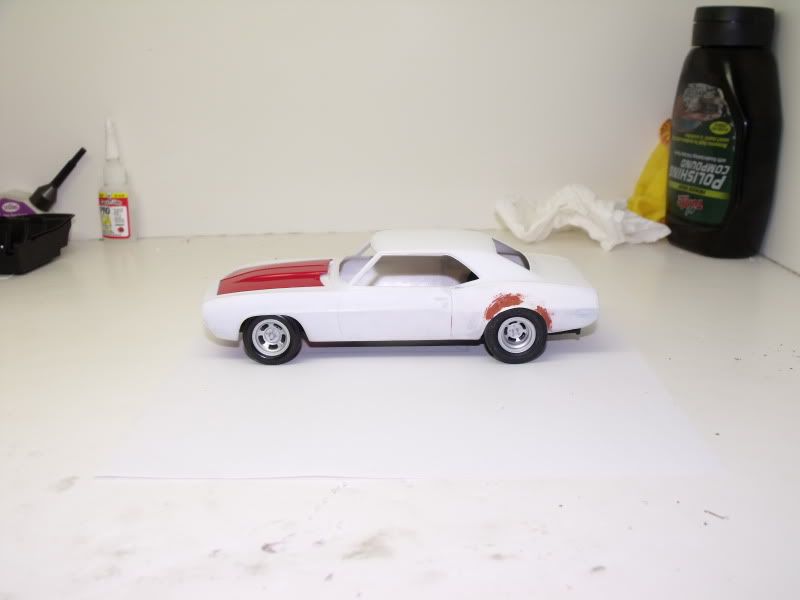

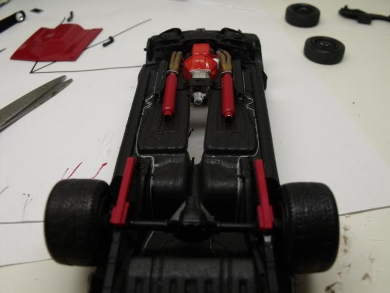

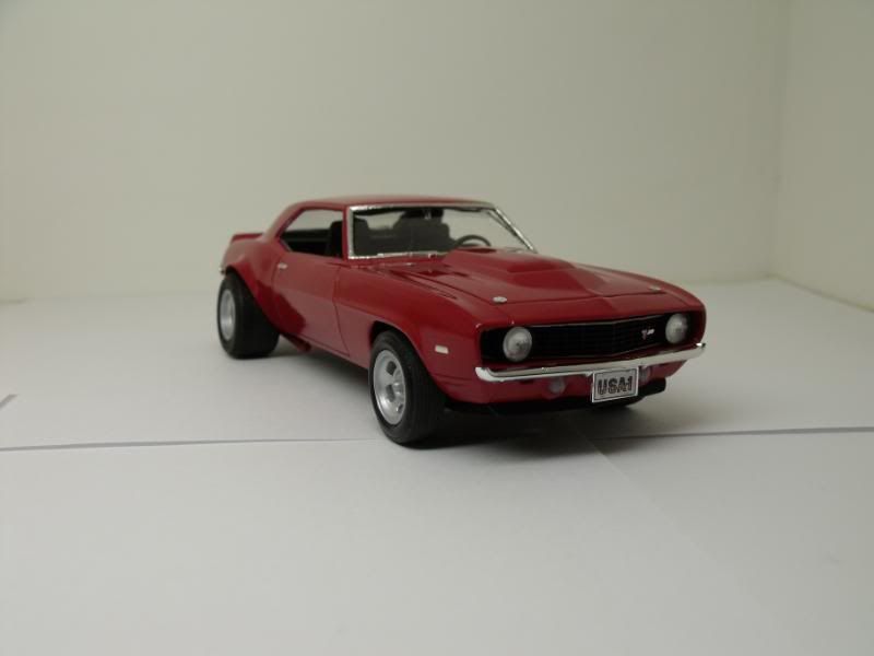

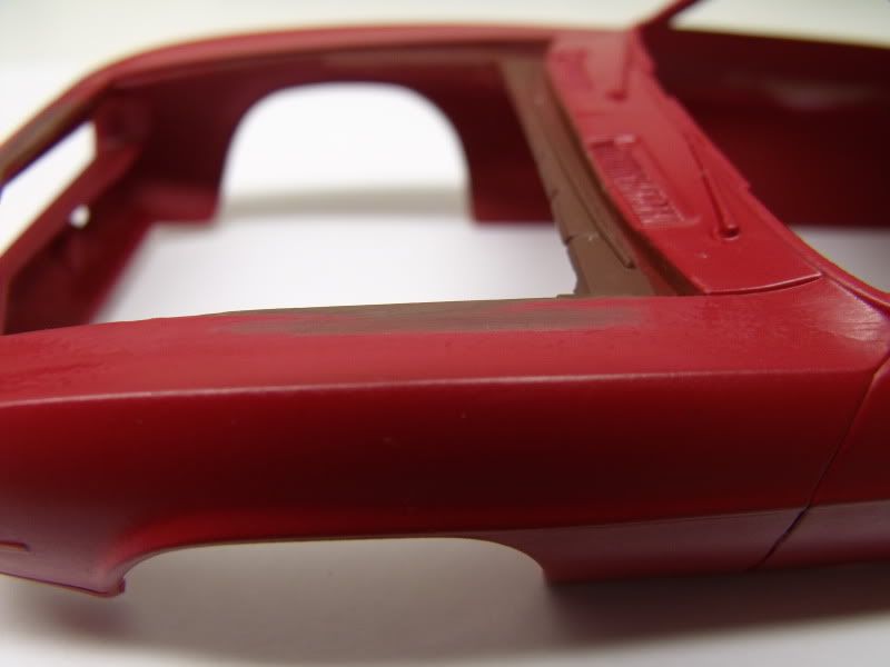

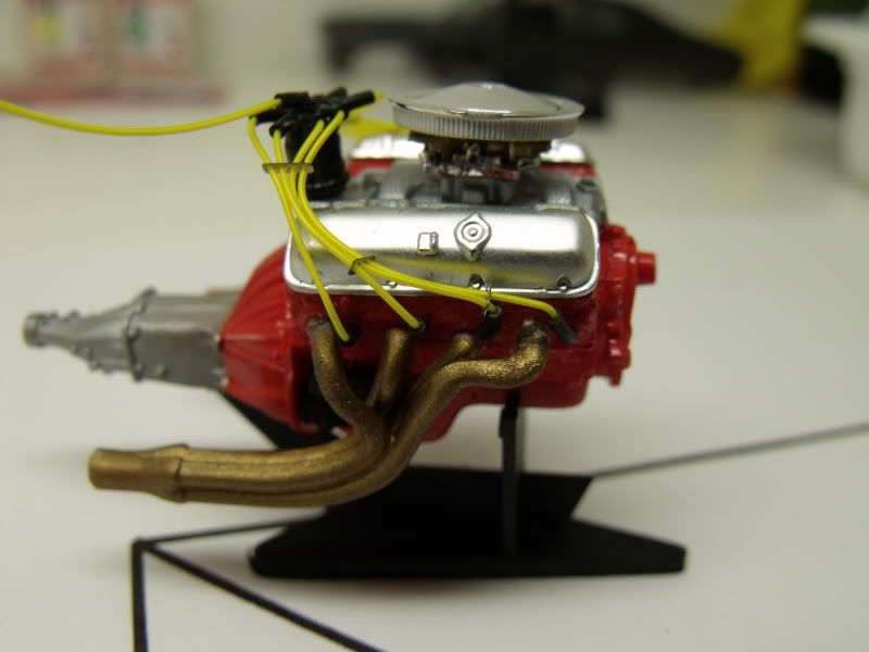

loudcherokee Posted June 20, 2009 Author Share Posted June 20, 2009 Also got the vanity plates and the USA-1 license plate on the front made with testors decal paper - When i had originally painted the car, I painted the hood shut. I was unaware of this, until I popped the hood off from underneath and it decided to take some paint chips with it from the fenders. I debated over how to fix this, and then decided to go at it like a 1:1, I masked off an area slightly bigger than the chips, sanded everything smooth, and primered it up. I then wet-sanded the primer smooth at the edges, to blend into the surrounding paint so there would not be a transition line - And now we are fixed! The latest things I've done are completed the chassis, and installed the Thrush glasspack mufflers that he had on his car. These are machined aluminum by scale repros plus, obtained from scale dreams. I scratch built the flanges from two pieces of strip styrene. I was able to obtain the correct tires through another forum member, and get the correct stance - So thats where I'm at. All that's left is to BMF the front and back windows, polish out the body, throw some wax on it, and finish assembly. Thanks for looking, and any comments/criticism are always welcome, good or bad. LC Quote Link to comment Share on other sites More sharing options...

VW Dave Posted June 21, 2009 Share Posted June 21, 2009 It's obvious the car was special to your uncle back then, and I'm sure he'll be thrilled with the model of it; you're doing it up right for sure. Here's my question, however: does your uncle know you're doing the model? I've done a couple of replica builds as surprise gifts in the past, and they never fail to blow people's minds. Quote Link to comment Share on other sites More sharing options...
Modlbldr Posted June 21, 2009 Share Posted June 21, 2009 LC- Man, that looks killer! It looks just like the photos you have. I'm sure that your uncle will love it. Glad to see that those Fenton 5 slot mags that I turned you on to at PSF Hobbies worked out. They look great. I remember your post asking where you could get some. It's one of the few times that I have been able to steer someone toward what they were looking for. I feel that I was able to help make this build a reality. Excuse me while I brush away a tear.... Later- Quote Link to comment Share on other sites More sharing options...
gilsdropshop1 Posted June 21, 2009 Share Posted June 21, 2009 awsome build like the fenders mod, and your attention to detail this is one BAD ASS Z-28. Quote Link to comment Share on other sites More sharing options...
dwc43 Posted June 21, 2009 Share Posted June 21, 2009 That's a great build. Looks just like the photos. Quote Link to comment Share on other sites More sharing options...

loudcherokee Posted June 21, 2009 Author Share Posted June 21, 2009 That's a great build. Looks just like the photos. awsome build like the fenders mod, and your attention to detail this is one BAD ASS Z-28. ohmy.gif Thanks guys. I appreciate the comments. This is probably one of my more intensive projects, and has provided a couple of firsts for me, such as the fender flares, use of photo-etch, resin parts, etc. I think I'm going to have to build something out of the box before I start my Chevelle that I plan on building for a contest. As another modeler put it, I need to "decompress" after starting that project, haha. LC Quote Link to comment Share on other sites More sharing options...

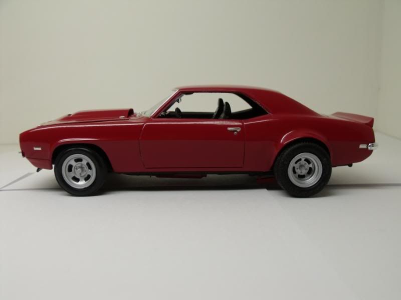

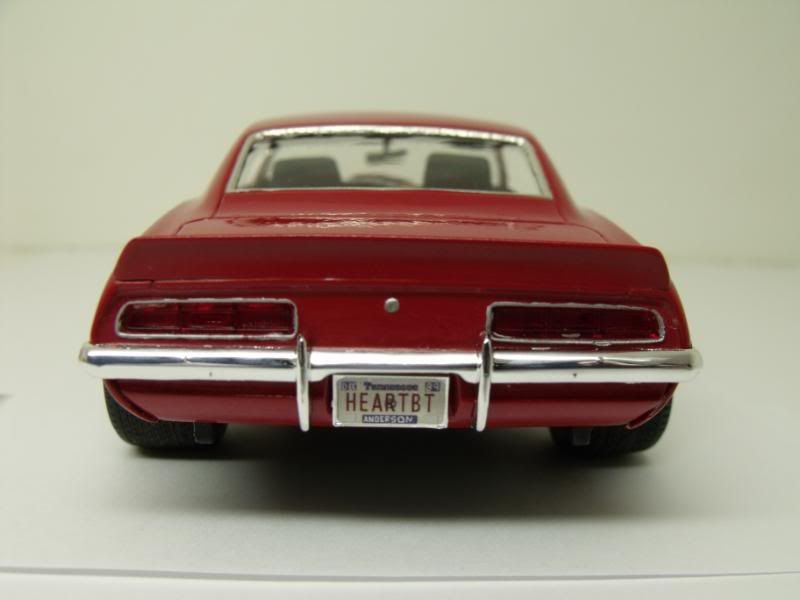

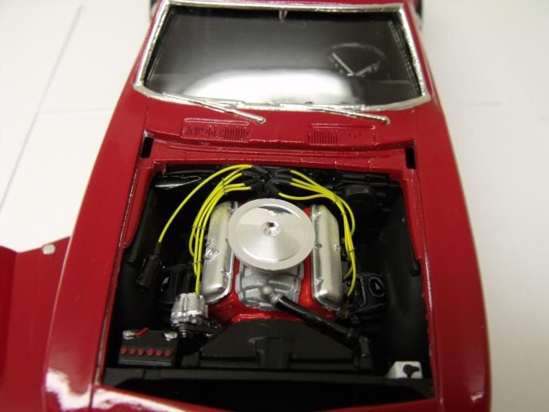

loudcherokee Posted June 22, 2009 Author Share Posted June 22, 2009 (edited) Here we go. All that lacks is to add the Z-28 logos to the front fenders, and painting the marker lights. I'm just too tired to do that right now, but I snapped some pics of final assembly. Hope you like them! I also need to touch up that little dot of silver sharpie I got on the rear lense LC More pics can be found at -- http://s40.photobucket.com/albums/e210/Lou...aro%20finished/ Edited June 22, 2009 by loudcherokee Quote Link to comment Share on other sites More sharing options...

leereyn Posted June 23, 2009 Share Posted June 23, 2009 (edited) Awesome build. I hope you don't mind I took the liberty of editing another comparison pic for you. I recently built a replica of my 81 Z28 and I know how hard it is to make a model look like the 1:1. If I were you, I'd have to built two. One to keep and one to send to the Uncle. No big deal right. lol Edited June 23, 2009 by leereyn Quote Link to comment Share on other sites More sharing options...
