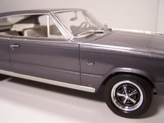

Depends on the finish you want, I shot a set of chrome plated nylon RC truck rims with Pactra Window tint and had it come out better than I expected it to, should be able to do the same with Testors/Model Masters window tint or Tamiya Smoke Black if you're willing to use an airbrush.

I just did this on the chrome wheels on a 1993 Ranger.
I used Testors Pla flat black enamel, stirred very thoroughly. Using a superfine Micro-brush, I barely dipped it in the paint, making the brush load more with tinted thinner than thinner/pigment and gently applied this to the holes in the rims and the center. A small amount of pigment is left at the top, and I used that to deepen the effect a small amount. Where the pigment at the top of the jar is something of a paste, you have far more control over it than a liquid medium.
It worked very nicely, my first time trying this. I'm quite pleased.

It really was easy...I used a small brush and brushed it where I wanted chrome...as it is blue when wet..just take your time. I used 2 coats and the seperation was perfect...the pictures do not do justice...after the TS smoke dried I lifted it off with tweezers!
