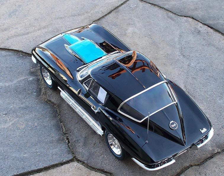

Anyway, I took the L-71 tri-power 1/12 `67 Corvette kit and converted it to an L-88. I also wanted a rare color scheme, and to my knowledge, only 1 L-88 was made with this color scheme, and only 4 other non L-88`s were made in these colors. Since the kit doesn`t come with blue decals, I had to mask these off and paint them on. You`ll have to forgive my photography skills. For some reason I can`t get my camera to properly capture the blue stinger. It is much more blue and less aqua in real life.

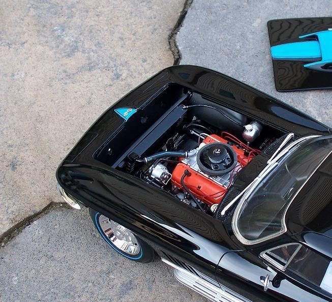

There were alot of modifications needed to convert this kit. The radio details had to be sanded off, and since it is in such a tight location, it was really difficult to do this and not damage the dash. I sanded and puttied and primered it like 4 times to get it right. The firewall needed to be modified since these cars came without heaters. The overflow tank was scratch built. The radiator needed modifications and the radiator shroud was correctly not installed. The filter on top of the carb required more creative scratch building, and took forever to get right. The foam around the edge is real foam. And of course, wiring and plumbing with "text" were added, and labels and chalk markings were added to the chassis.
And, as usual, a correct `67 window sticker and license plate were added. Please let me know what you think!
Freaking awesome build, but I question the blue wall tires.
Didja forget to wash the blue off the white walls ? heh heh heh.

Thought those were real pics of a current build.
But the Huge Plant gave it away.. :lol:

Thanks guys!! You all are too kind! And the antenna is being removed. :lol:

This is one fine piece of craftsmanship......only one observation though....L-88's were radio delete cars as you have here......but you added an antennae.....minor point but beautiful car anway.

Yeah, I originally started this as an L-89. Prepping the body is the first thing I do since I put so much clear coat and drying times are usually in terms of weeks. It was an oversight.
