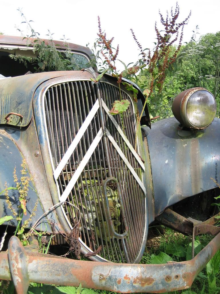

Oh, I definately second that. I found a few images on the net which may be helpful in establishing the correct location of the fenders:
I think they illustrate nicely, how low slung the car really is.
I'm hoping I can tape the hood in place to use as a guide to glue the front fenders on, or more, to attach the piece between the hood and fender to the fender correctly. This piece (79 and 80) does look like it wants to match the front edge of the fender and maybe that's all I need is to align as close as I can by eye.
I guess this image says it all for what to shoot for ...
Not quite, since this is a 11CV. The 15CV has a longer bonnet and the grille protrudes forward from the wing 'roots' in plan view.
