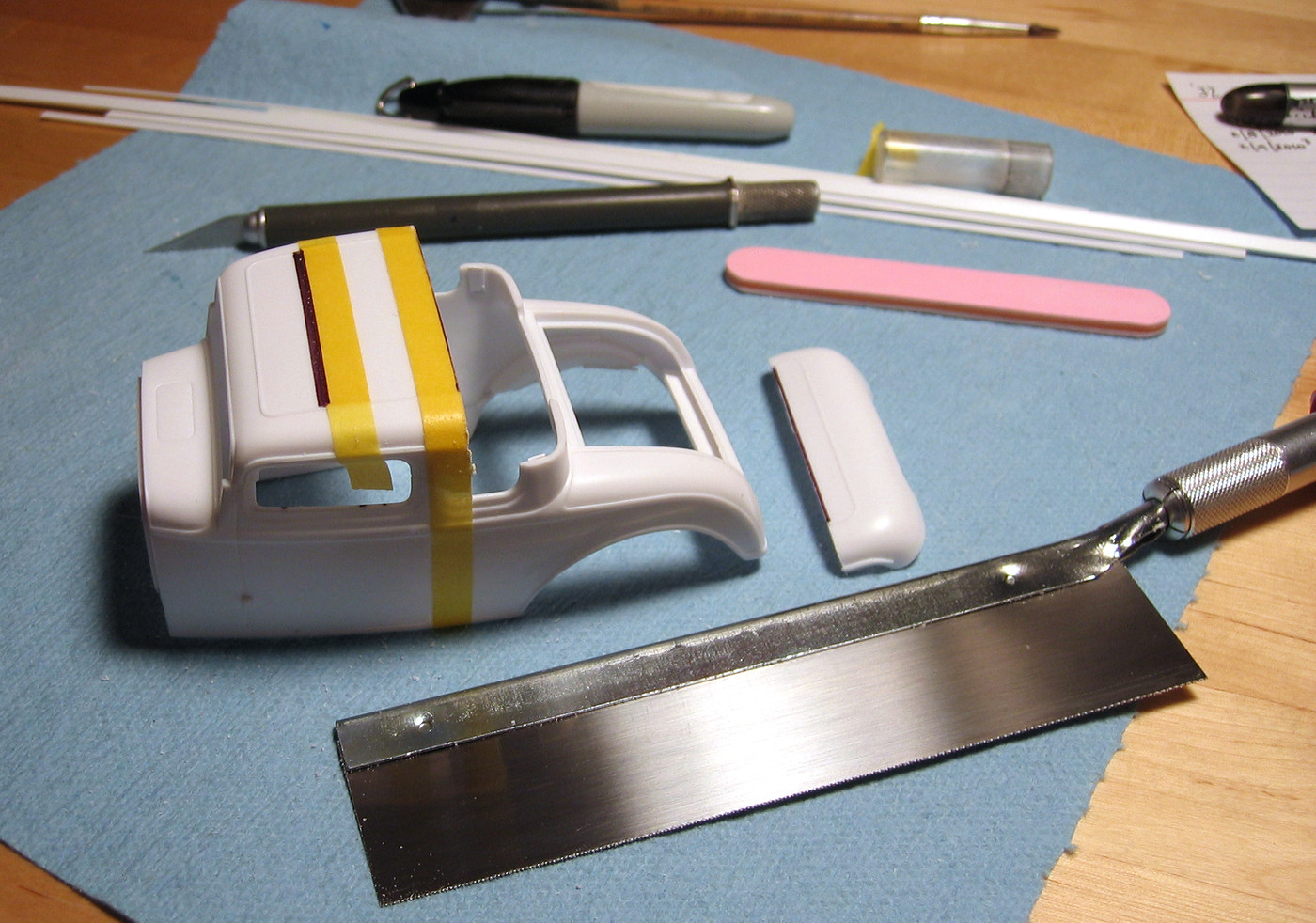

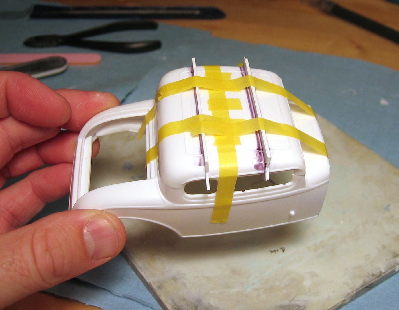

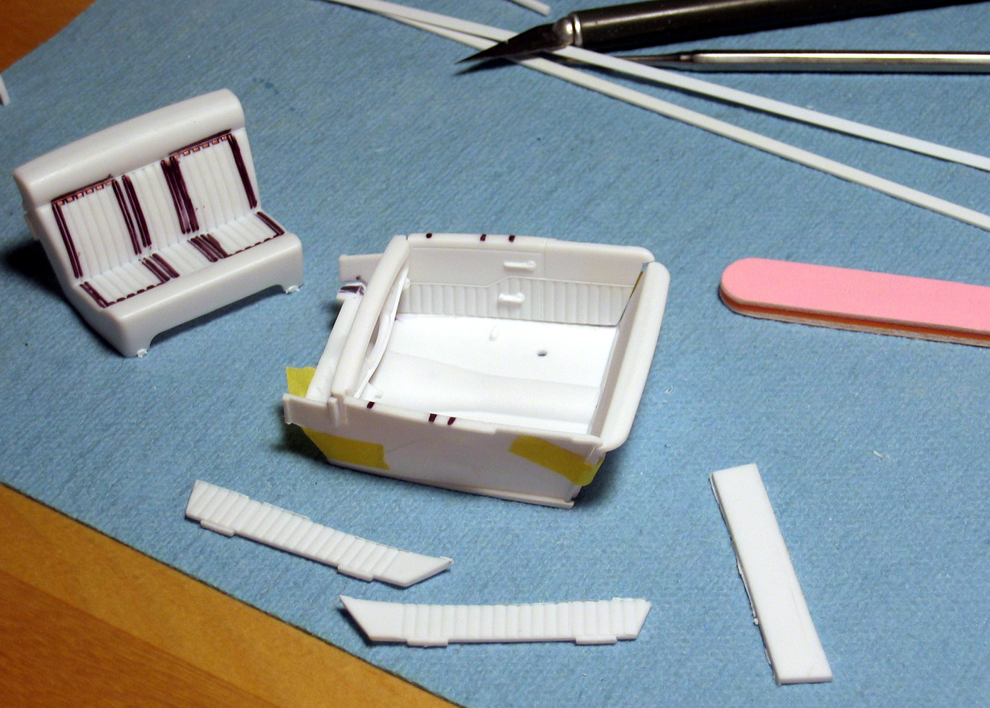

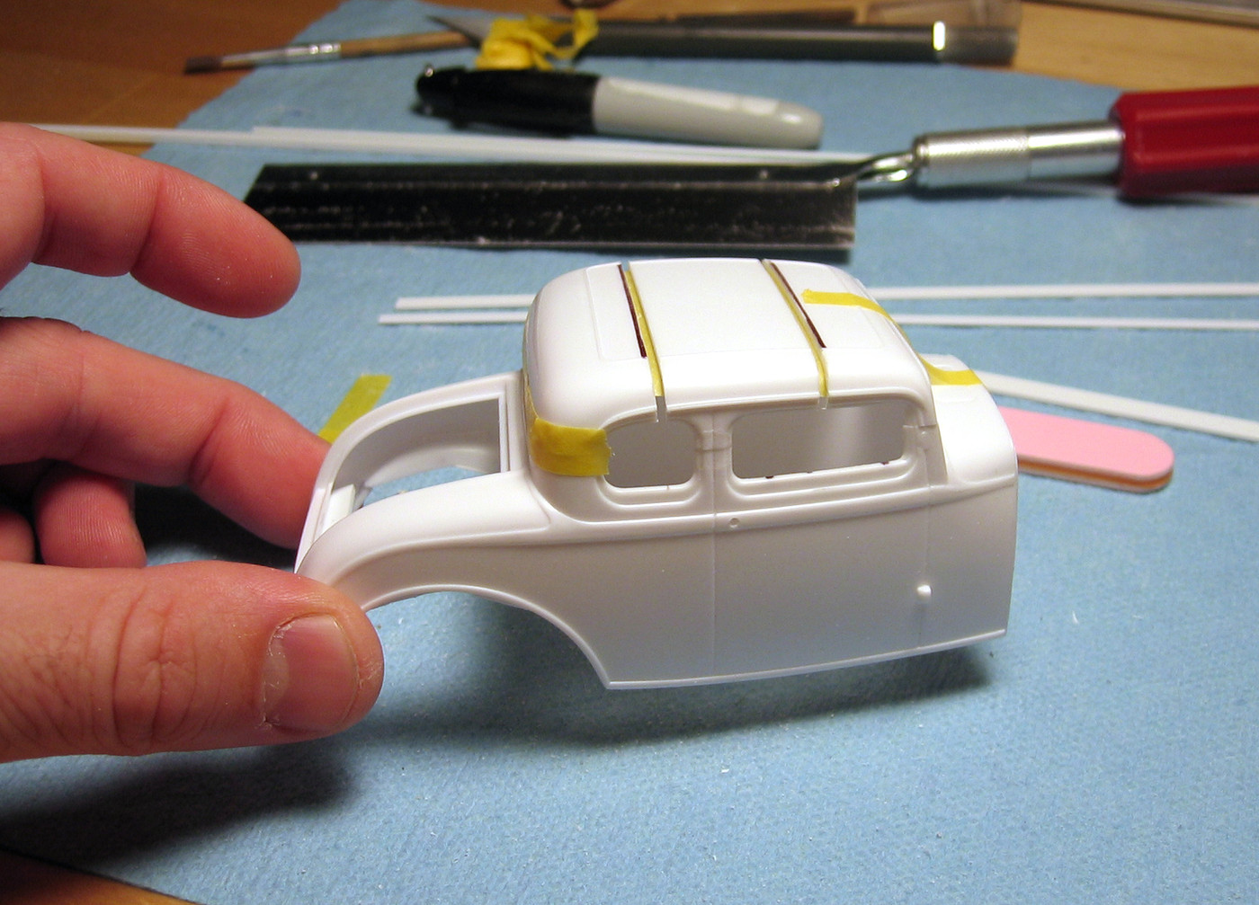

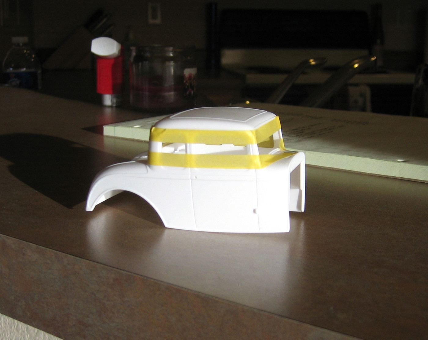

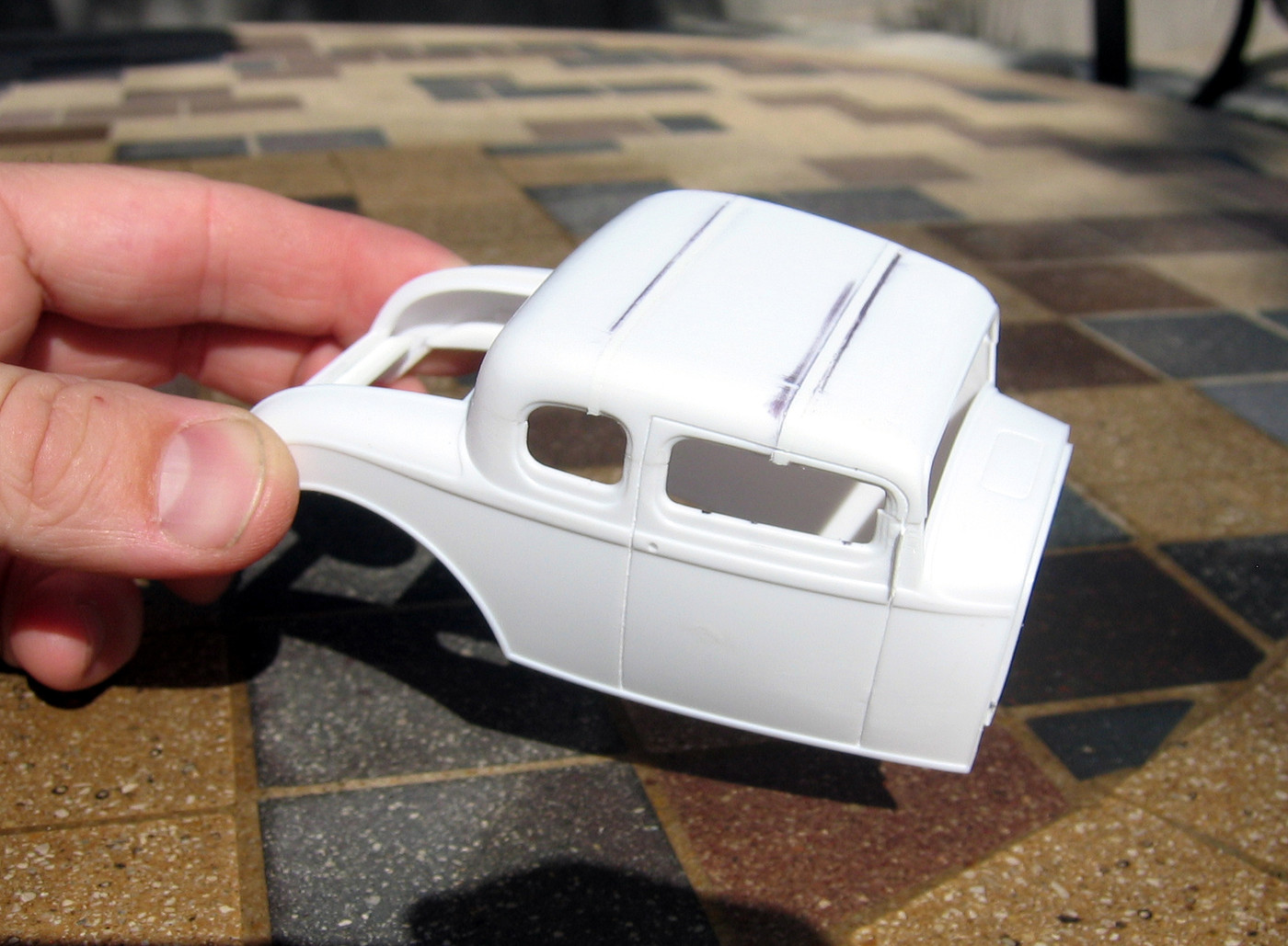

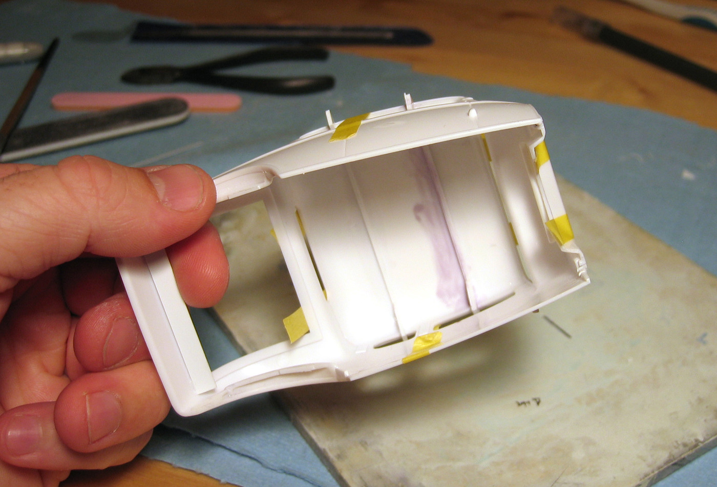

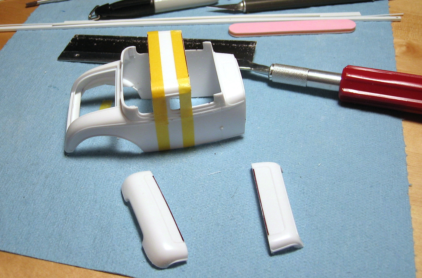

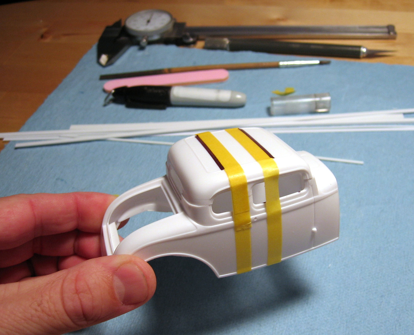

Mooneyzs Posted February 15, 2010 Posted February 15, 2010 (edited) As I am in the middle of my '06 Magnum wagon project. I have decided to start a 32 Rat Rod project to change gears just a little bit. Here is the start of the project. I am planning on channeling the body over the frame and Chopping the Top. I will probably paint it a Red Oxide primer color. Hopefully you don't mind the many pics in this post. Taping up the body for the chop. Back taping where I will make my cuts The Damage done after cutting the top. Setting the top on the body to see the new look After setting the top on the body I have noticed that I will be making 2 more cuts in the roof to get the front and rear post to match up. Worked on getting the interior tub cut down to fit for the Channeling over the frame. I took out 5/16" from the interior. Then for the seats I am thinking I am going to cut part of the centers out of the bench seat and do some scratch building to make something like an airplane bomber style seat. Then its back to work on the roof to get it back on the body but first I need to split the roof in 2 more places to stretch and make it a tad longer so that all of the posts line up correct. here is a pic of the interior tub tapped together. I am thinking of going with a white or aluminum color for the interior but not sure yet. I first started out with gluing the center post of the roof to the body. Then I figured out where I wanted my cut line at and laid tape down and marked the side that I wanted to cut with a sharpie. First cut on the roof. Second Cut on the roof. Edited July 9, 2017 by Mooneyzs
Mooneyzs Posted February 15, 2010 Author Posted February 15, 2010 (edited) After cutting both pieces off I tapped them back in place to see the gap that I need to lengthen the roof by. I used some evergreen styrene to make the extra length and used Weld-on #3 to glue the roof back together. I added tape to hold the pieces in the position I wanted. After the glue has dried, I will use my dremel to trim the styrene down, then use some sanding sticks and then add Bondo to complete the body work on the roof. Underside of the body so you can see the pieces added. Edited July 9, 2017 by Mooneyzs
walt francis Posted February 15, 2010 Posted February 15, 2010 Real nice job on the chop and channel, you make it look easy and I wish I had done mine.

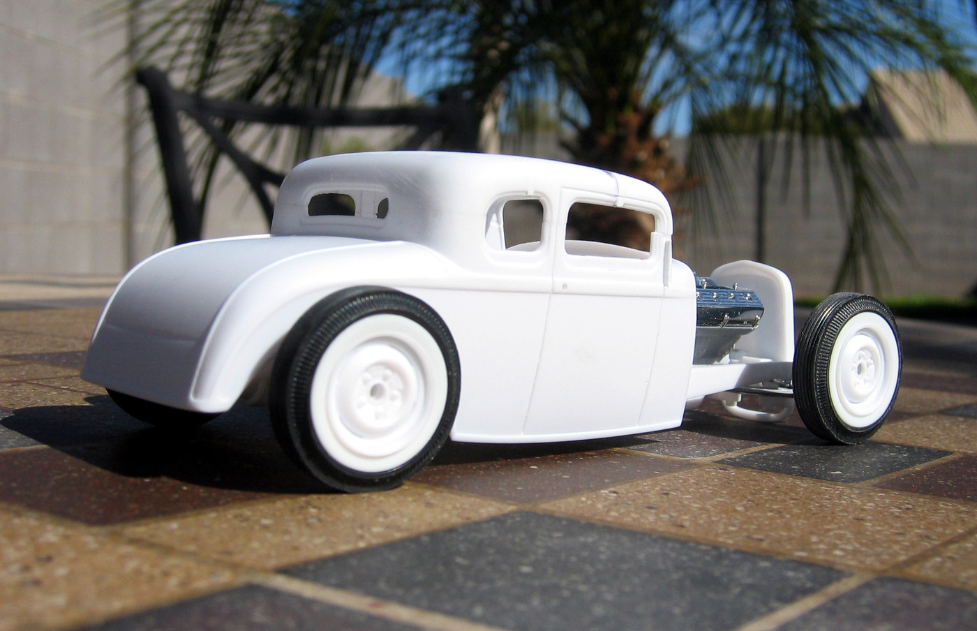

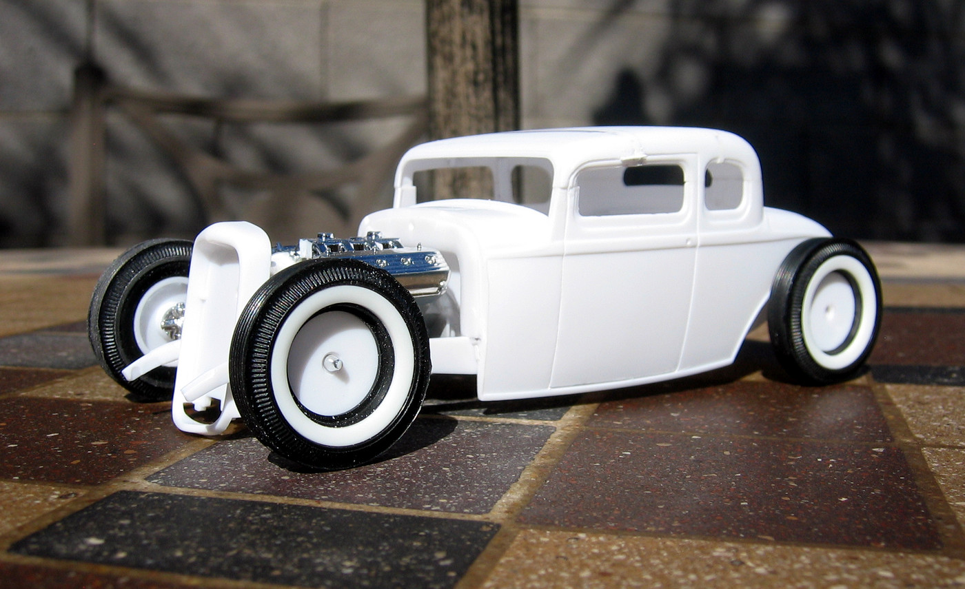

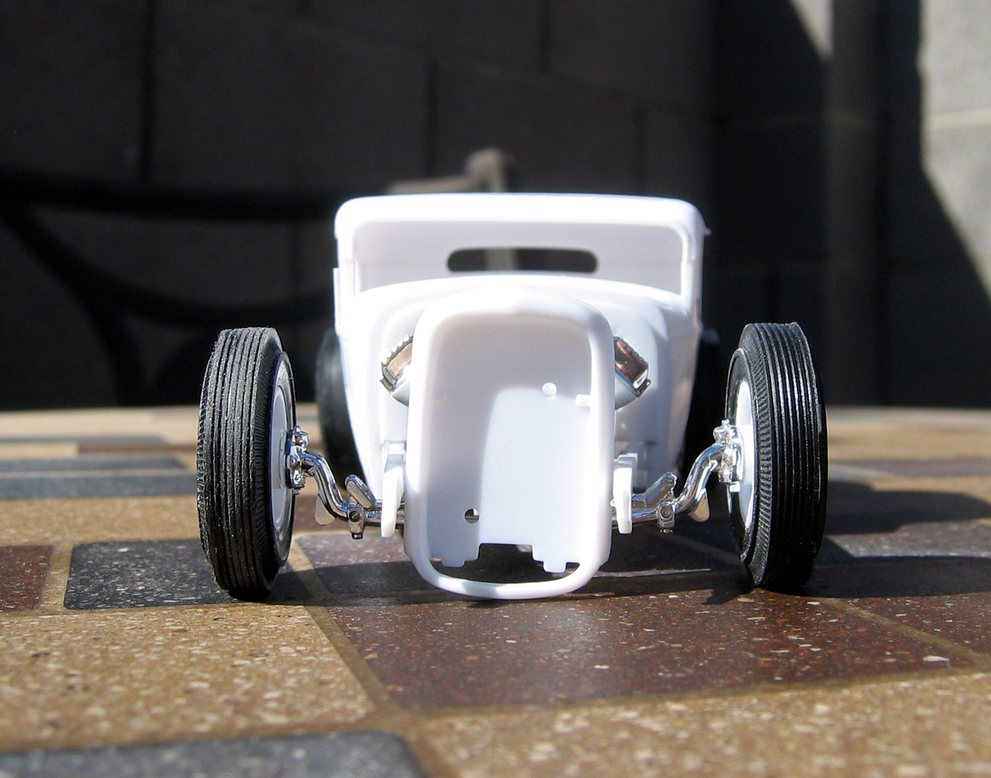

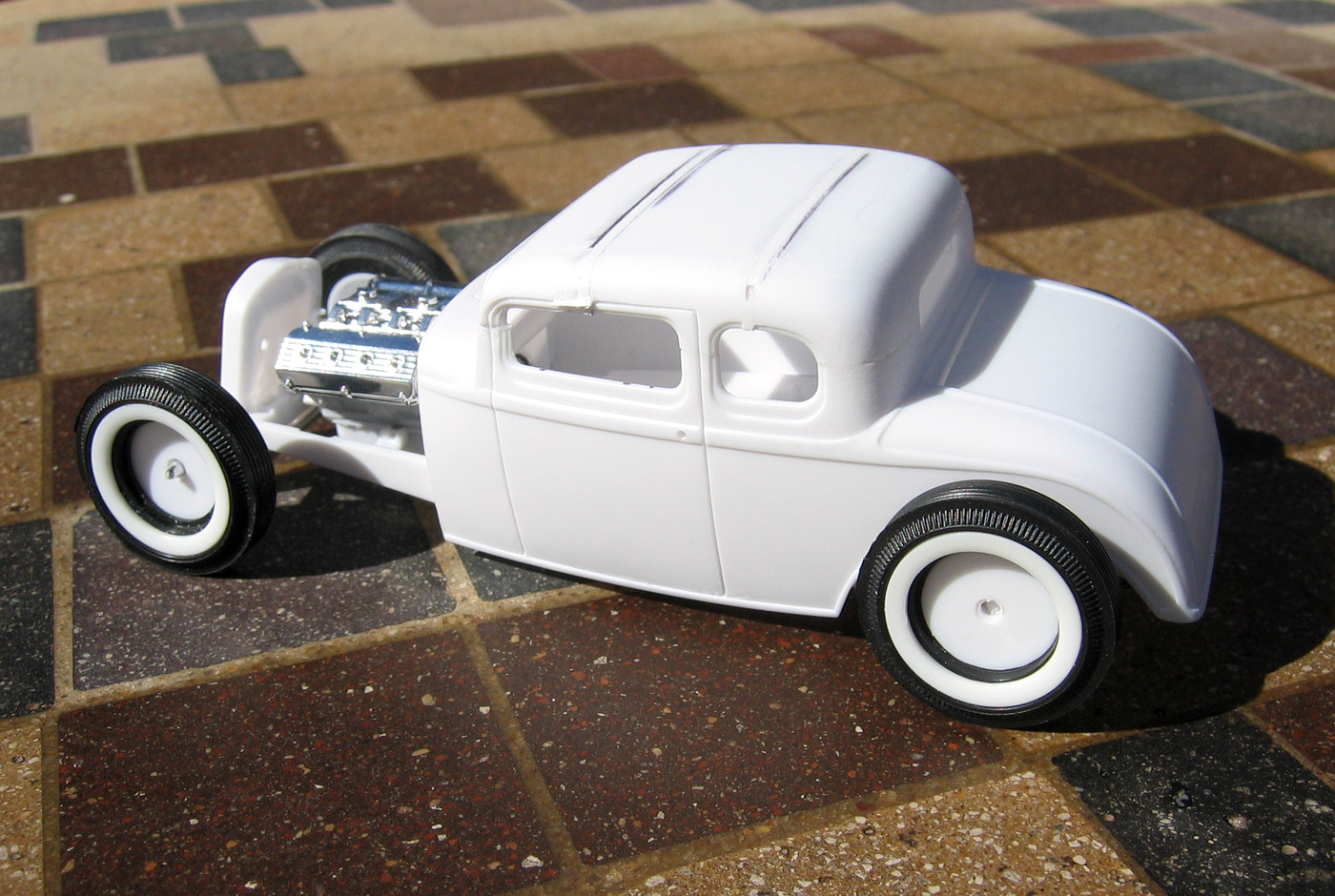

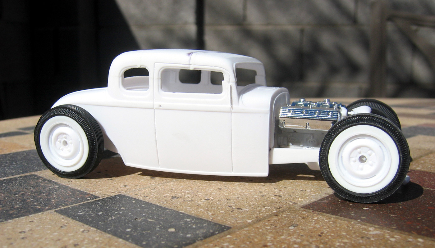

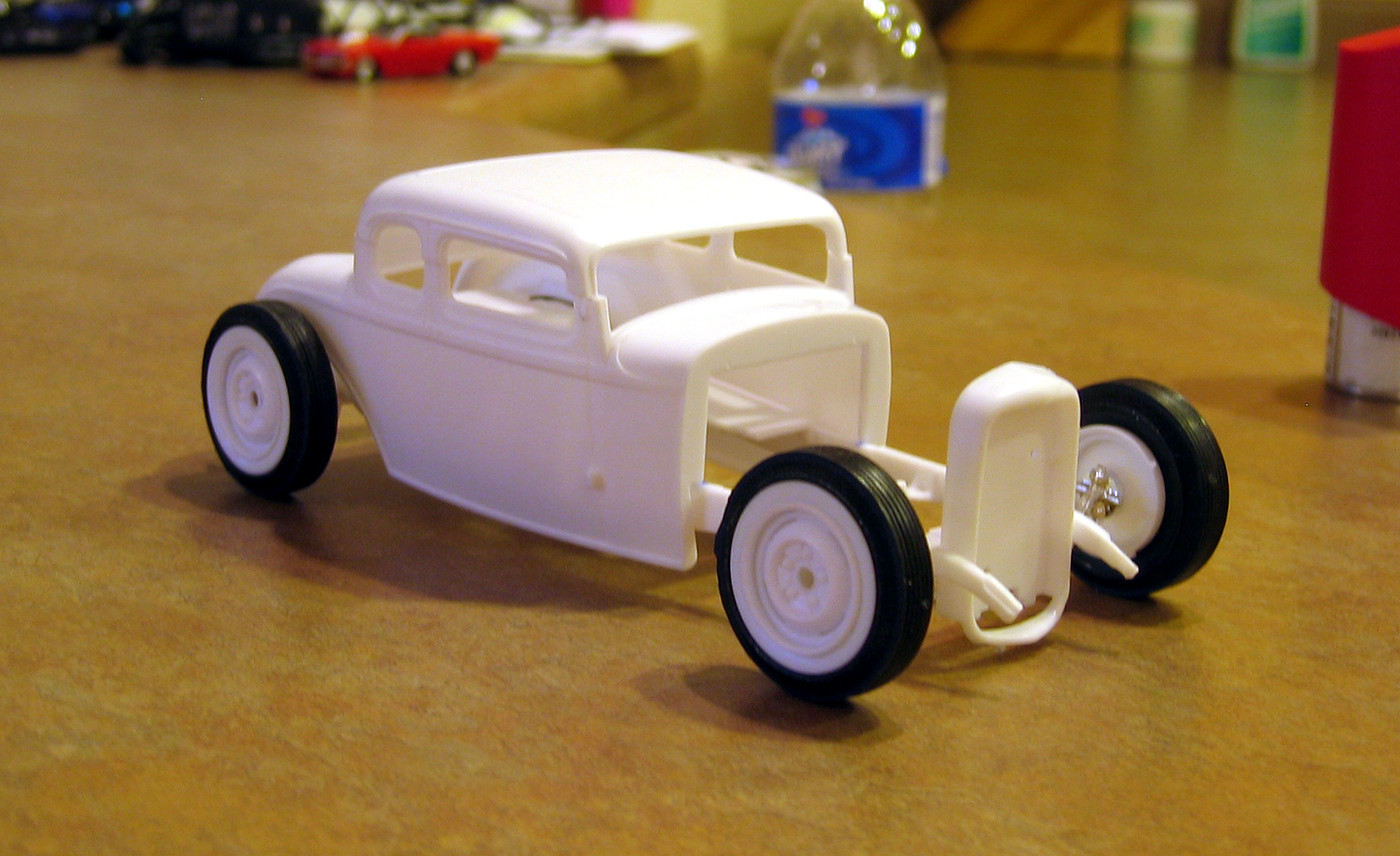

Mooneyzs Posted February 15, 2010 Author Posted February 15, 2010 (edited) Thanks MikeMc ok little update on the project. I have got the top a little more in shape but there is still work to do before lay bondo on it. I also had lowered the car a little more than what it was before. So here are some updated pic for you to see. Enjoy.... I got the top pieces that I added shaped down and am currently getting the pieces in the interiror shapped down which is tuff since there isn't much room...lol Front View Edited July 9, 2017 by Mooneyzs

801ryan Posted February 15, 2010 Posted February 15, 2010 very cool start...what mods to the frame and suspension?? I just picked this kit up and wanted to build pretty much the same way

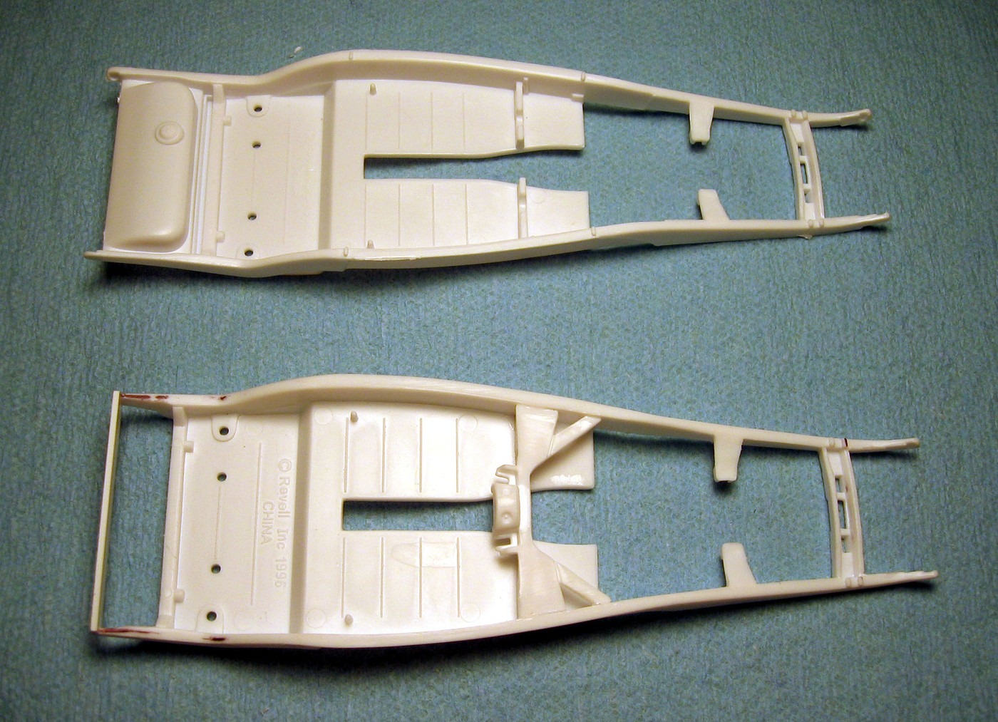

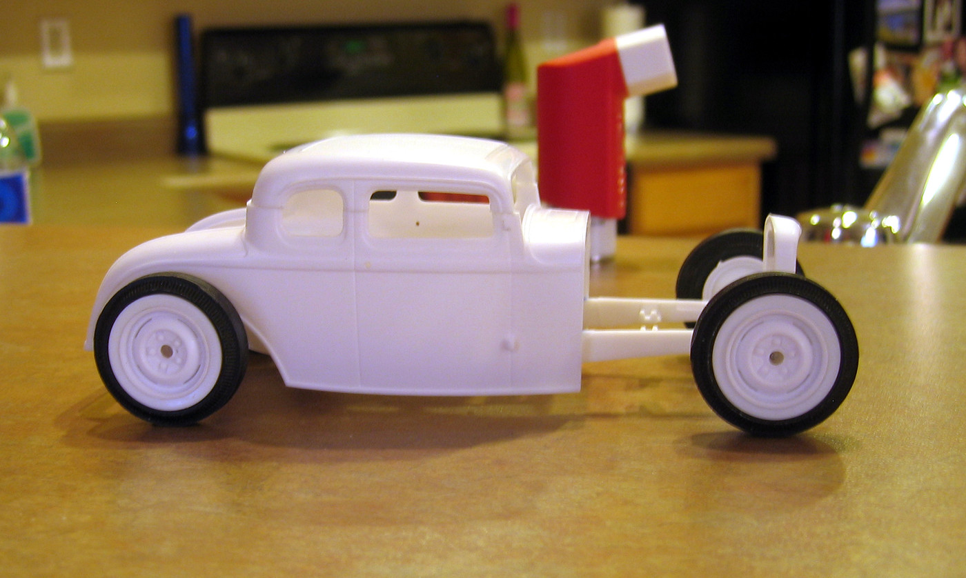

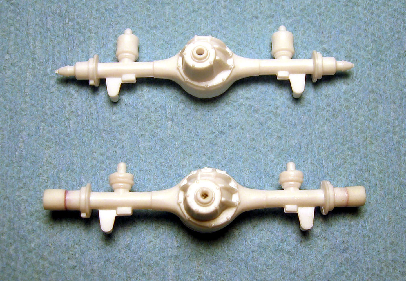

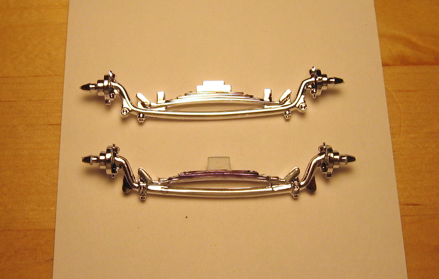

Mooneyzs Posted February 16, 2010 Author Posted February 16, 2010 (edited) Thanks guys!! 801ryan.... here are a couple pictures that I just shot to show you what I did to the frame and suspension on how I lowered it. I had another '32 kit that I took pictures against so you can see what I did. Ok here on the front suspension if you can see the two little steps on the center section. I had cut them down so it would be able to lower the center of the frame. In doing this you will also need to trim the two pieces to the left and right of the center part. Then I also took and sanded down the top leaf spring to get it to where I wanted. Let me know if it doesn't make anysense I sould of added some arrows and photoshoped the picture. If you need me to do that, let me know and I will edit the photo for you. Now for the rear end on what i did was if you can see here basically on the bag perches I cut a section out of the middle of them and glued them back into position but when I glued them I put the pieces back into the frame holes and was careful to glue in place so that the parts would line back up correct. as far as the frame goes, I first started out by cutting the fuel tank out. After that I shorted the lenth of the frame rails to the rear of the car so that the frame would sit inside of the body since I was channeling the body over the frame and then I added a piece of plastic to box in the frame and will making a floor section to cover that open hole area. I hope that these pictures helped. If you have any other questions feel free to as and I will help out as best as I can. Edited July 9, 2017 by Mooneyzs
801ryan Posted February 16, 2010 Posted February 16, 2010 Thanks alot for taking time to show that...that is the same way I dropped the front of my 3 window ...and exactly what I needed so see for the rear and fuel tank....Thanks agian

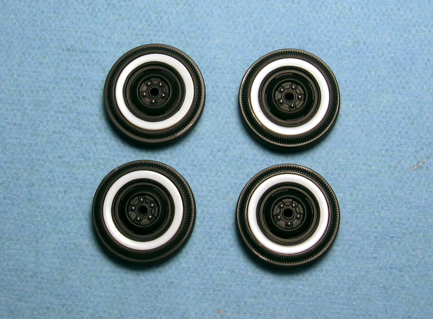

Mooneyzs Posted February 20, 2010 Author Posted February 20, 2010 (edited) ok worked a little more on this project today and was able to pretty much finish the wheels. They are all sanded and painted. Now all I have to do is glue them together but here they are..... Edited July 9, 2017 by Mooneyzs
