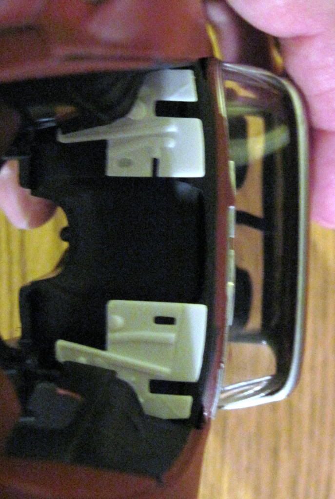

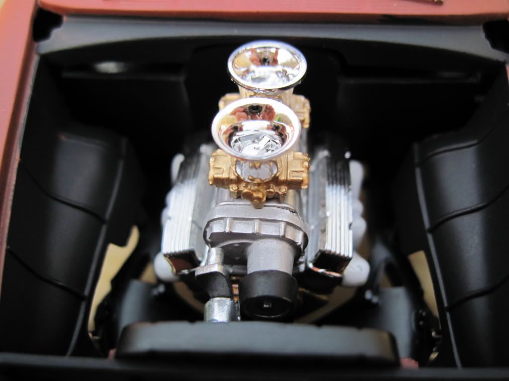

Duntov Posted March 31, 2010 Posted March 31, 2010 Oldschool: I am not familiar with this kit but a couple of ideas. On the firewall you are on the right track....fit / cut / fit etc sheet styrene to make a firewall cover. Maybe add a few parts box appliances to give it some definition. As for the dash and windshield fit.....that's a bit tougher. You might try lowering the entire dash unit by notching out the sides of interior so the dash sits lower on the door panel sides and mates up to the glass "better"....I would not grind on either the glass or dash top. Technically they should "match" each other so grinding on either one is a dicey deal......hence the idea to "lower" the dash in its position in the interior tub so it mates up as intended. Any way that's my two cents...... Regards Bill (Duntov)

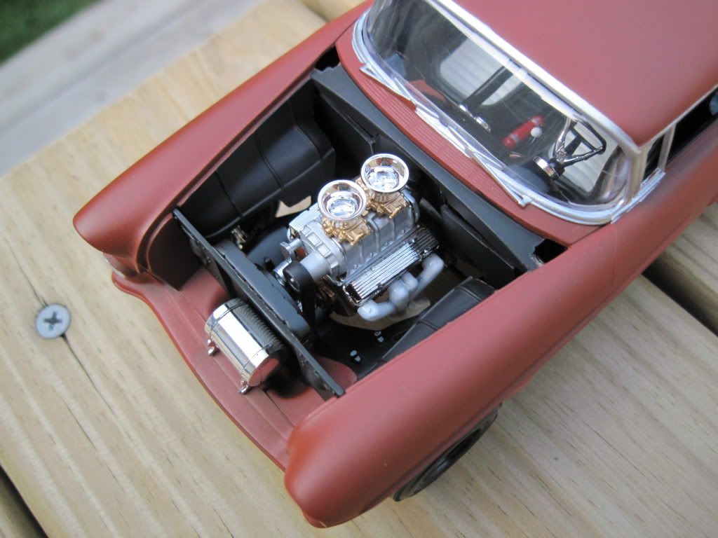

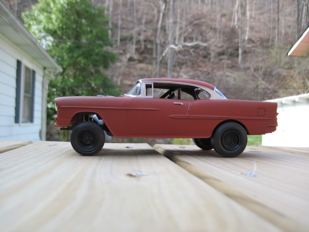

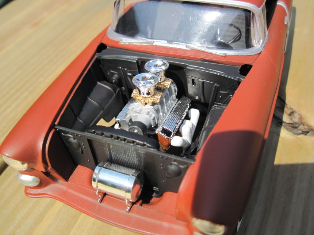

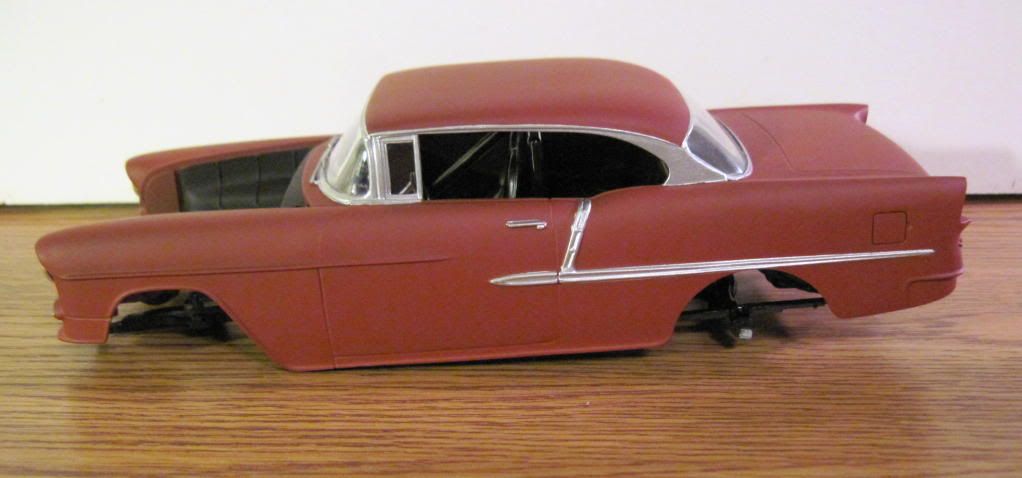

oldscool Posted March 31, 2010 Author Posted March 31, 2010 Well, I overcame the fit problem by trimming a little off the front edge of the dash and removing and sanding on the windshield. Now there's a slight gap at the top of the windshield but I can live with it. So this is where things are at now. Almost a complete mockup. I'll wait till last to attach the front suspension as it looks pretty fragile and I may change the wheel color yet. I'm going to scratch a radiator hose and cap as well as a cap for the Moon tank. I promise I will paint the side trim before I'm done. And I'm going to go with a black hood. The pics now show the look I'm going for.

Duntov Posted March 31, 2010 Posted March 31, 2010 BTW: Normally, carbs are mounted with the primary / secondaries fore and aft. ....the throttle linkage goes down the left (driver side) and the choke on the right (passenger side). Regards Bill (Duntov)

Duntov Posted April 3, 2010 Posted April 3, 2010 OOOPS.........don't I feel like the village idiot!!!!!! The carbs ARE SIDEWAYS on blower.....sorry for the misinformation.... Bill
oldscool Posted April 4, 2010 Author Posted April 4, 2010 Actually Bill, they could be mounted either way. oldscool

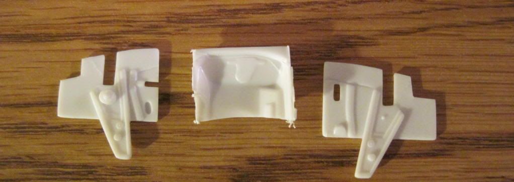

oldscool Posted April 4, 2010 Author Posted April 4, 2010 A solution to the firewall issue came my way sort of by accident. I bought the new California Wheels release of the 57 Belair and it just happens to include a complete sprue from the 55/56 Chevy kits which contains the firewall that won't be used on the 57. As soon as I saw it I knew I had what I needed. I can't use the entire part without cutting the front of the interior bucket away as it won't fit flush over the existing firewall so... this is what I did: After I fill the hinge slots it will cover all of the gap but the part at the top of the concave area as well as add some detail. This will work well enough to satisfy me. While I'm posting pics, here is one of the painted side trim. I actually masked this with Tamiya tape: She will be done in no time now. oldscool

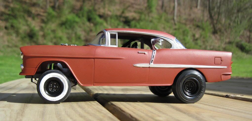

oldscool Posted April 7, 2010 Author Posted April 7, 2010 Thanks for the tip Dave. Since I will be using Acrylic semi - gloss black, I may be able to use alcohol rather than thinner. It scares me to put thinner on a finished part. I now have the body and chassis permanently glued together and the firewall done. It's not contest winning work but it looks a lot better than the big gap. Assembled the front suspension and it's a lot sturdier than I thought it would be. Now in the process of painting whitewalls on the front tires. Will try to have more pics tomorrow. oldscool

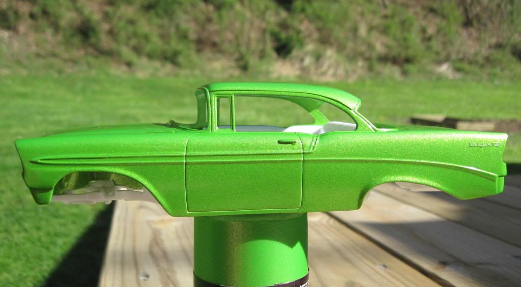

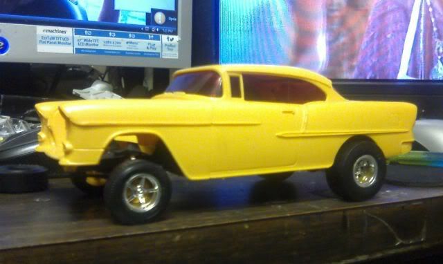

oldscool Posted April 9, 2010 Author Posted April 9, 2010 She's getting close to being finished now. Added whitewalls to the front and decided to keep the black wheels. Got all the body trim painted and will admit I have done better at painting trim. Still painting the hood and scoop. The hood will be flat black with an aluminum scoop to look like a home made sheet metal scoop. A cloud came over right when I snapped the second pic so I used the quick fix tool in my Dell image editor to lighten it up and it made the color a little off. Actually, it looks better And here is a sneak peek of where I'm going with the Monogram 56 Chevy.
Railfreak78 Posted April 10, 2010 Posted April 10, 2010 Holy Bright Batman! I like it though and certainly am not complaining!
Scalper Posted April 10, 2010 Posted April 10, 2010 I like that green paint.nice job I sprayed a 87 t-bird with that paint my next project. great product.
jedimastergary Posted April 10, 2010 Posted April 10, 2010 That gereen is great what color is it? I think it would be good on a few kits I have love how it is coming along
oldscool Posted April 10, 2010 Author Posted April 10, 2010 Hi Gary, that's Testors Lime Ice one shot laquer. I love this paint although it does take 2 coats no matter if it is called one shot. oldscool
