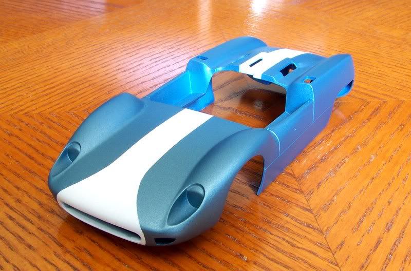

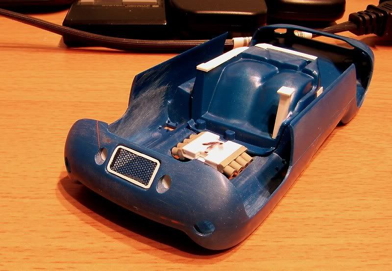

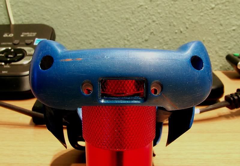

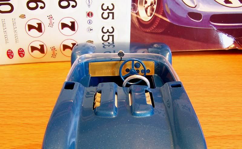

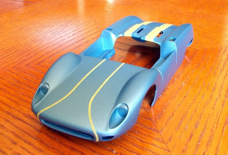

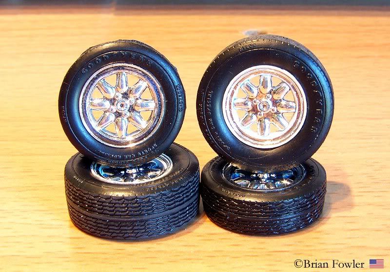

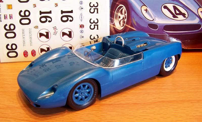

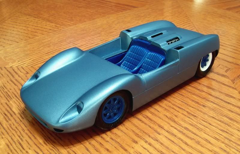

MonoPed Posted April 3, 2010 Posted April 3, 2010 Been working on this for a while, and made some more headway on it today. It's the old Monogram SSP reissue of the Mid Engine Scarab slot/curbside kit. So far, I've opened up the front wheels, and built new rear wheels using a pair of the slot car inserts and parts box rims: Fitted the dash panel from the long OOP Ricambi detail set (Thanks to Nicholas Henson!) and made a rollbar from aluminum tube: Cut out the rear of the body and made a new screen from some PE mesh and .010" sheet: Painted it Viking Blue (can also see the dummy engine insert installed): And got the stripe masked and painted this afternoon: Could have this one wrapped up in a couple days.
Crazy Ed Posted April 3, 2010 Posted April 3, 2010 Lookin' Good Brian. From the paint job I'd guess you're building the Team Meacom Foyt driven Daytona Car #35. One of these days I'm gonna find a set of those Decal sheets. Ed
Dragline Posted April 3, 2010 Posted April 3, 2010 Best looking rendition of this kit I've ever seen. Should look great finished. Bob
MonoPed Posted April 3, 2010 Author Posted April 3, 2010 Lookin' Good Brian. From the paint job I'd guess you're building the Team Meacom Foyt driven Daytona Car #35. One of these days I'm gonna find a set of those Decal sheets. Ed you are correct
jedimastergary Posted April 3, 2010 Posted April 3, 2010 Looks like a nice one love the color and ho you are adding detail to it
jbwelda Posted April 3, 2010 Posted April 3, 2010 >after seeing a few very nice buid-ups of it i think i should've grabbed one or two i will trade you one for a tamiya karmann-ghia...just the body even! great looking build there; i like the way the motor peeks out of the openings.
MonoPed Posted April 5, 2010 Author Posted April 5, 2010 great looking build there; i like the way the motor peeks out of the openings. Thanks guys! The dummy engine insert is made from resin trumpets left over from the Fisher Ferrari 512s kit and scrap plastic with the trumpets raised to the same approximate angle as the carbs in the Corvette Grand Sport kit.

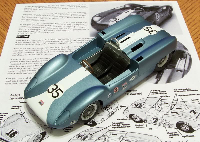

MonoPed Posted April 11, 2010 Author Posted April 11, 2010 AAAARGH!! Settled in at the bench for a decal session, and was almost done when one of the number roundels from the Ricambi sheet shattered when it hit the water and released from the paper. At some point, the sheet had been creased, but had been laying flat for so long that it didn't show up, until it got wet. Only had the two side roundels to go to finish it. So now the little Scarab is on hold indefinitely until I come up with another pair of roundels that are close enough to the ones already on it. Ain't models fun? And the needed decal:
Jairus Posted April 11, 2010 Posted April 11, 2010 Brian, you need the numbers too I take it? That type font is fairly unique. I can point you to a web site where they sell generic roundels and numbers. Maybe you can find something that will work. Although finding the exact dia is impossible that way. I would suggest you paint the roundels (mask and airbrush) and then lay decals for the numbers. Professor Motor is the place I buy all my decals. Good stuff, a little slow on shipping but reasonable prices.
MonoPed Posted April 11, 2010 Author Posted April 11, 2010 Yep, need the numbers too. All the decals were on the car except the last two roundels when it went south, so I'm not really wanting to mess with masking and painting. Good stuff at the link though, thanks!

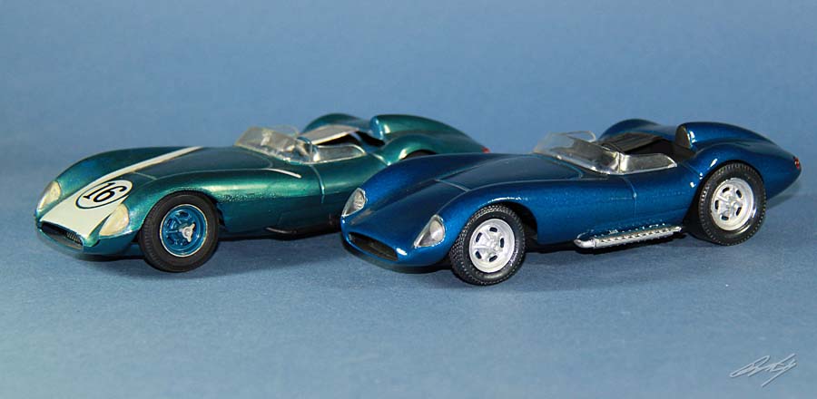

Plankwing Posted December 2, 2011 Posted December 2, 2011 Great models, Brian. Love those Scarabs. I have the MkIV kit, haven't built it. I have two of the Strombecker Scarab MkI 24th motorized kits plus one unbuilt "pristine in the box" that I just got today, snagged it on eBay. So pristine, in fact, that none of the parts have ever been removed from the box and the decal sheet looks fairly good but obviously aged. Photo attached of the two built models. The one with the decals was gotten off eBay already built, done straight from the box, side pipes are as in the unbuilt kit I just got. I built the dark blue one about 1964, glued the top and bottom halves together and filled the seam then cut out the bottom at about where the body would meet the chassis. I don't know where the side pipes came from, nor why no decals or why the two back tires are drag slicks. Toomanyyearsheimers.
