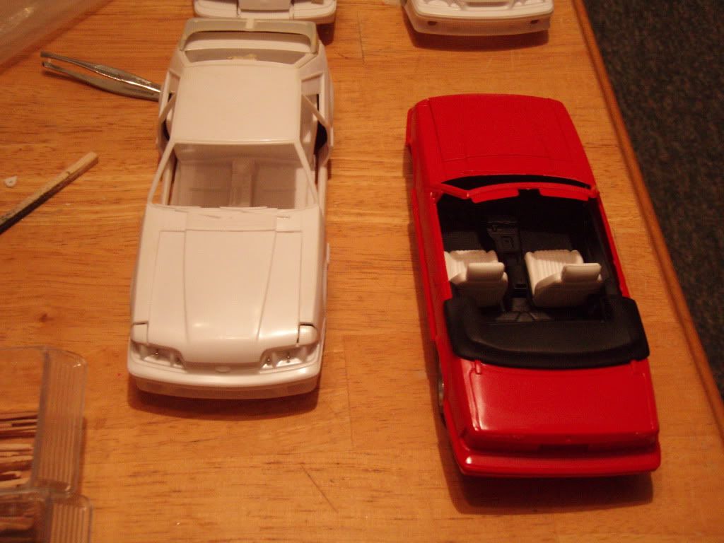

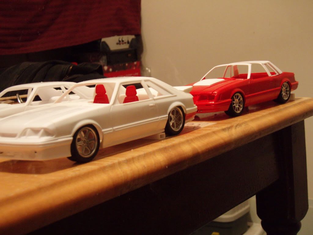

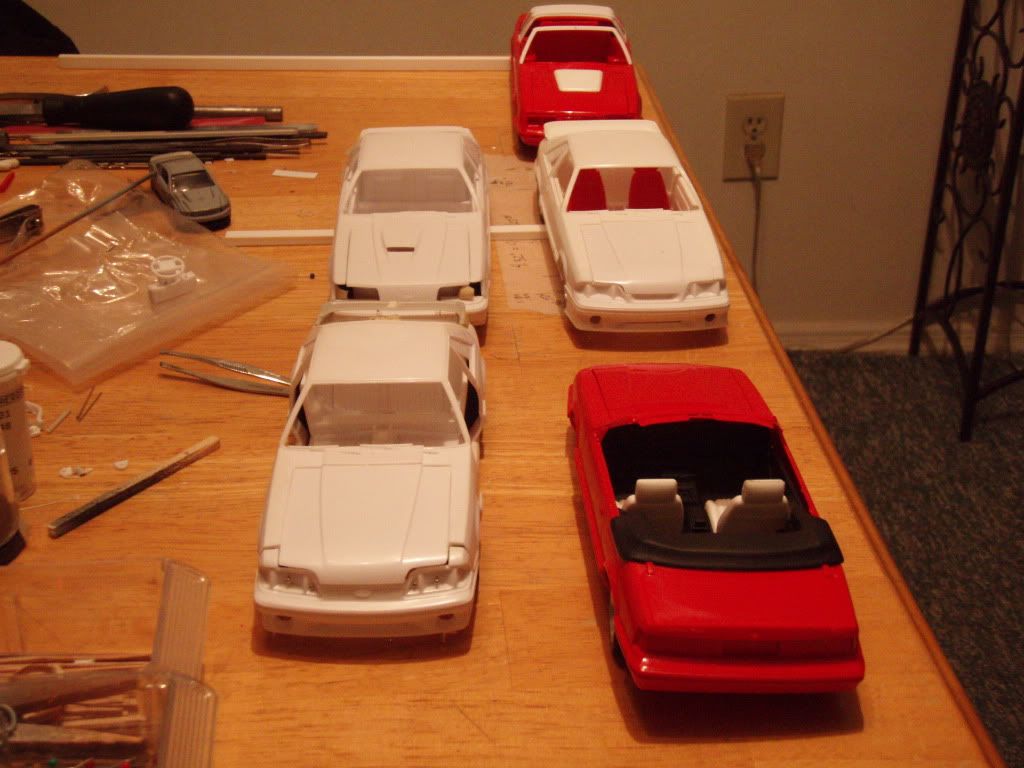

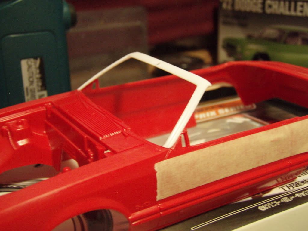

whale392 Posted September 22, 2011 Author Posted September 22, 2011 Alright, group picture here (OK, maybe a few pictures). These are just what is sitting on my kitchen table at the moment, not counting what are also on the bedroom desk or in the closet. , , , , Well, those are the 5 currently occupying my time; the 1983 GLX vert for this CBP, the 1991GT conversion (also for this CBP), a Faleen (as the wheels are 6 spoke versus 5, the body molding is GT versus LX, and the front end is Cobra...even though I am working on the correct Saleen lower), an 85 SVO with 2008 Bullitt wheels, and my current 1983 T-Top coupe project in its' very infancy.

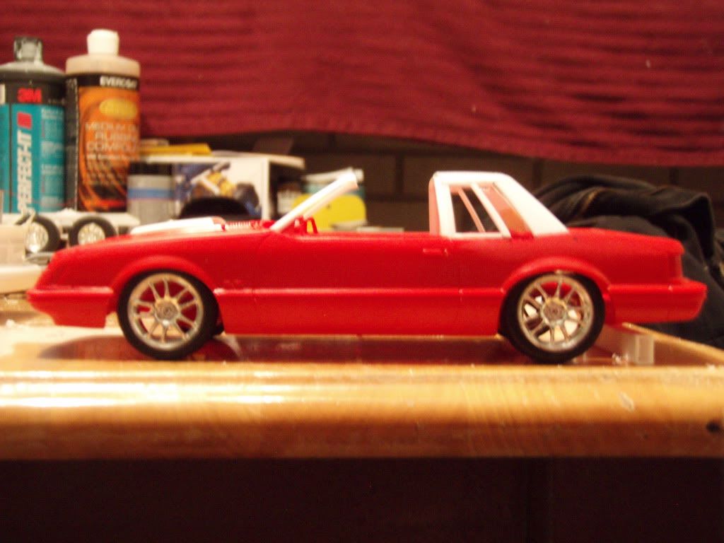

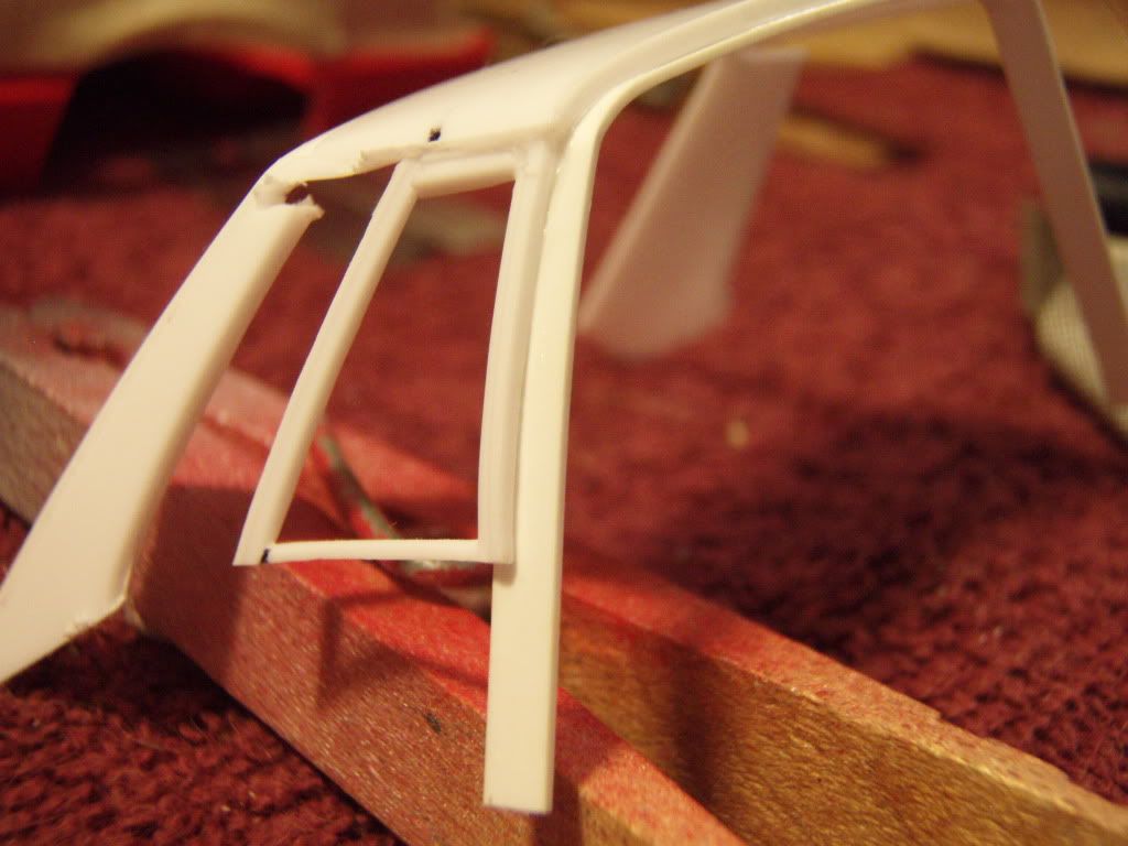

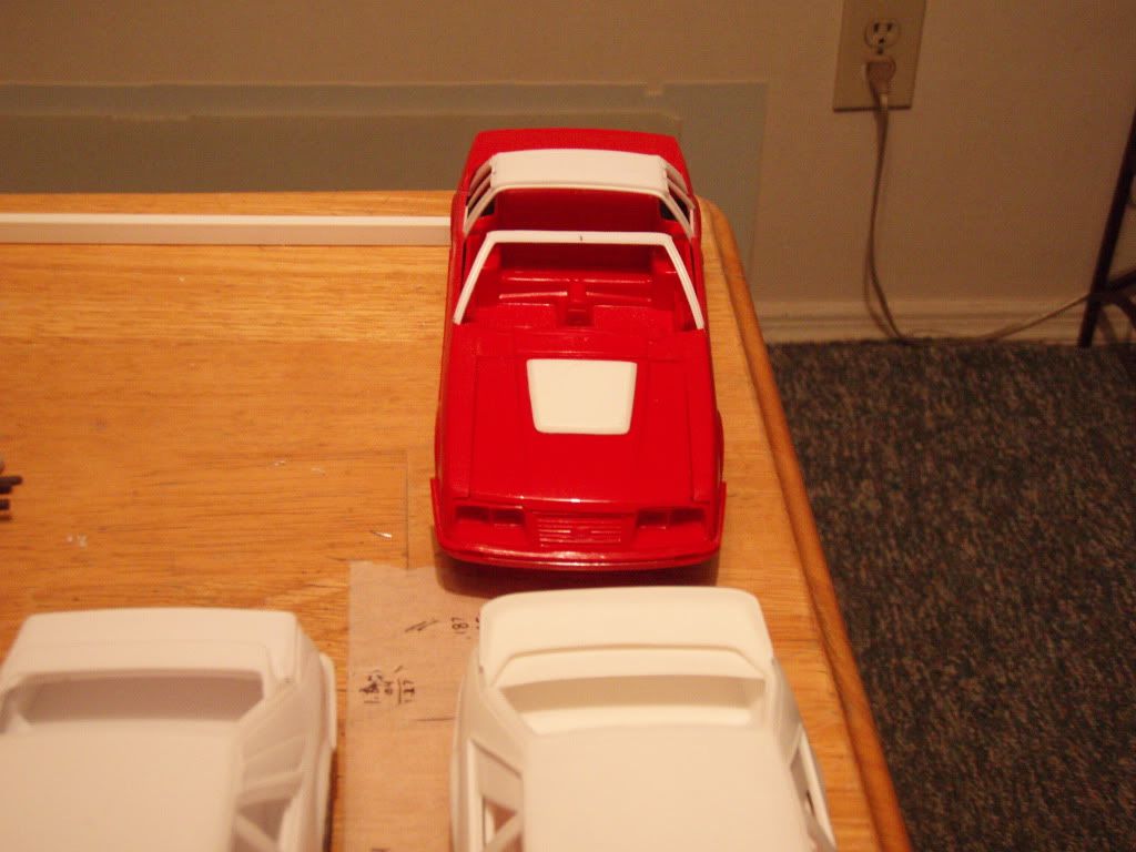

whale392 Posted September 22, 2011 Author Posted September 22, 2011 Now, just the T-Top Coupe by her lonesome.........she isn't anywhere near ready for the FIRST coat of primer yet. , , All comments are welcome, and encouraged. I am currently working on getting new Quarter Window (Gill) Spats made as the only available units (in 1/24th) are Hatchback units. This thing has been fighting me even just to this stage, but I will press on. Being a poor scratch-builder doesn't help my cause any either! looks like I will be re-doing the quarter window cases as well, as they broke apart on me when I dry-installed the top for test-fitting. I have more pics of all the cuts/stages so far, if anyone really cares to look through them.
GTMust Posted September 22, 2011 Posted September 22, 2011 Hi Brad....... Finally get to see all those Foxes that you've been teasing us with.... and all at the same time, too! What happened to your overseas trip? Have you already gone and come back? I'm looking forward to more of your T-top build..... I made some clear styrene tops for mine but had problems glueing the outer edge to the clear plastic..... it's an edge to edge situation and a very weak joint. (I cut the remains of the roof to get the edge pieces, if you follow my drift.) I couldn't make them in one piece from clear styrene due to the compound curves. Monogram's Camaro Z28 and '78 Trans Am kits have smoked T-Tops in them........ hmmmm...... wonder if they could be modified to fit? If you find a way to create yours..... I'll be watching... and trying to get some of my 1/32 scale antique and vintage cars and diarama builds for my museum finished...... so I can get back to a couple of Foxes! But I'll still be watching this and the SN95 threads from "behind the scenes", Good to see so many other Mustang guys joining in now. I have a few SN95 kits waiting for me as well.... I don't think I have enough years left!!! Tony
whale392 Posted September 22, 2011 Author Posted September 22, 2011 Hey Tony, thanks for the encouraging words. I know what you mean on the T-Top situation, as I too use the roof edges as T-Top edges (pretty much how Cars & Concepts did it when they converted these cars), but with a slight twist. Instead of butting the glass right up to the edge, make a notch into the edge the entire length (#11 blade and a tape-line to hold the edge). Then, Micro Krystal Klear glue the glass into the notch you just made (be sure to cut your glass pattern a hare long to provide fitment/trimming length). This adds considerable strength to the glass/edge union.

whale392 Posted September 23, 2011 Author Posted September 23, 2011 Thanks Stephen. I think I have got a handle on the quarter window issue now (I am making completely new frames and gluing them to a stiffener with a perimeter lip. That way, when I attach them to the body, they will have 270* of glue joint.

whale392 Posted September 24, 2011 Author Posted September 24, 2011 Thanks guys; I will be getting more done tonight. to me, even working directly from measurements, the rear roof section looks to be to far slanted forward. I will have to get in there and square it up before I go too much further. Hopefully, I can have this body in primer (the first coat anyway) for Toledo NNL (October 8th).
Abell82 Posted September 24, 2011 Posted September 24, 2011 They all look very good Brad! Personally I'd like to finish this one... But we all know how that goes...
whale392 Posted September 24, 2011 Author Posted September 24, 2011 Converted from an SVO I see, Jason! What is stopping you from finishing?
