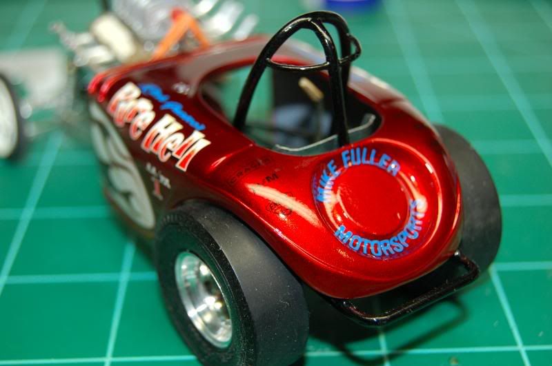

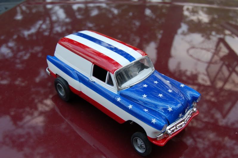

I use House of Kolors lacquers and mix them according to their directions. Without looking at my notes I believe its 1:1 on the basecoats and candys/clears is 2:1. I shoot through a Paasche External mix airbrush at 25#. The finish on the color will come out flat. I then follow up with urethane clear which gives me a pretty nice finish.
You can achieve the same finish with lacquer clear...
I'm hooked on the HOK pearls from TCP Global. I now have a stock of 16 colors. Using either the base gold or silver, that gives me the potential of 32 colors. I haven't even thought about mixing colors to get yet other colors.
