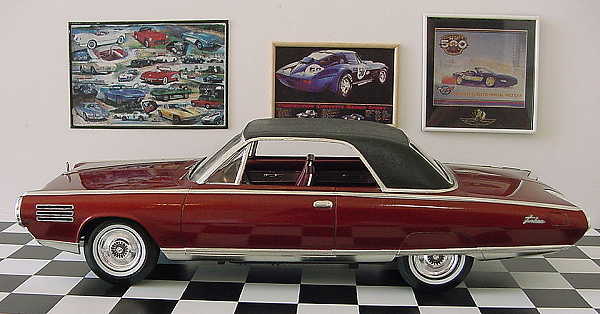

ismaelg Posted April 4, 2007 Posted April 4, 2007 I really love the color. It looks somewhat similar to the Corvette's Atomic Orange. I built the snap version of the Turbine car a few years ago and the color I used was darker. I don't remember exactly but it was a Duplicolor GM color. That was when close enough was good enough. I'm insane (and shameful) posting this build next to yours but yes, I'm nuts By the way, there is one and a half ACRES of BMF in this car... Thanks,

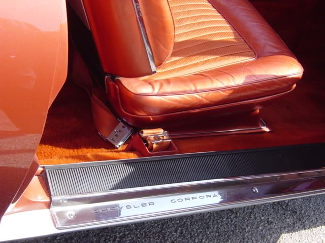

darquewanderer Posted April 7, 2007 Posted April 7, 2007 Watching you build this is absolutely great. Planning on copying it to file when you finish. I hope your aware that the interior's two tone. The bucket inserts are slightly orange(ier).
MrObsessive Posted April 7, 2007 Author Posted April 7, 2007 The bucket inserts are slightly orange(ier). Hmmm........I never noticed that! Thanks James! That gives me a heads up as I'm about to paint the interior this weekend sometime. I'm gonna respray the vinyl top, as it's still not to my liking. :?

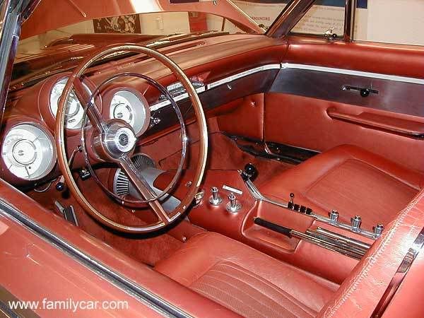

Harry P. Posted April 16, 2007 Posted April 16, 2007 Watching you build this is absolutely great. Planning on copying it to file when you finish. I hope your aware that the interior's two tone. The bucket inserts are slightly orange(ier). I wonder if there were variances among the cars. This photo shows a slightly different seat color: And the photos here seem to show a darker seat insert, possibly a different material, too: http://www.allpar.com/mopar/turbine-photos.html
MrObsessive Posted April 16, 2007 Author Posted April 16, 2007 I have a lot of photos for reference to do the interior...............and no one pic is consistent. I've painted the seats pretty much all one color as the differences are negligible. Ya gotta remember also that there is at least 44 years of age on those interiors............so some fading/wearing has taken place. :wink:
