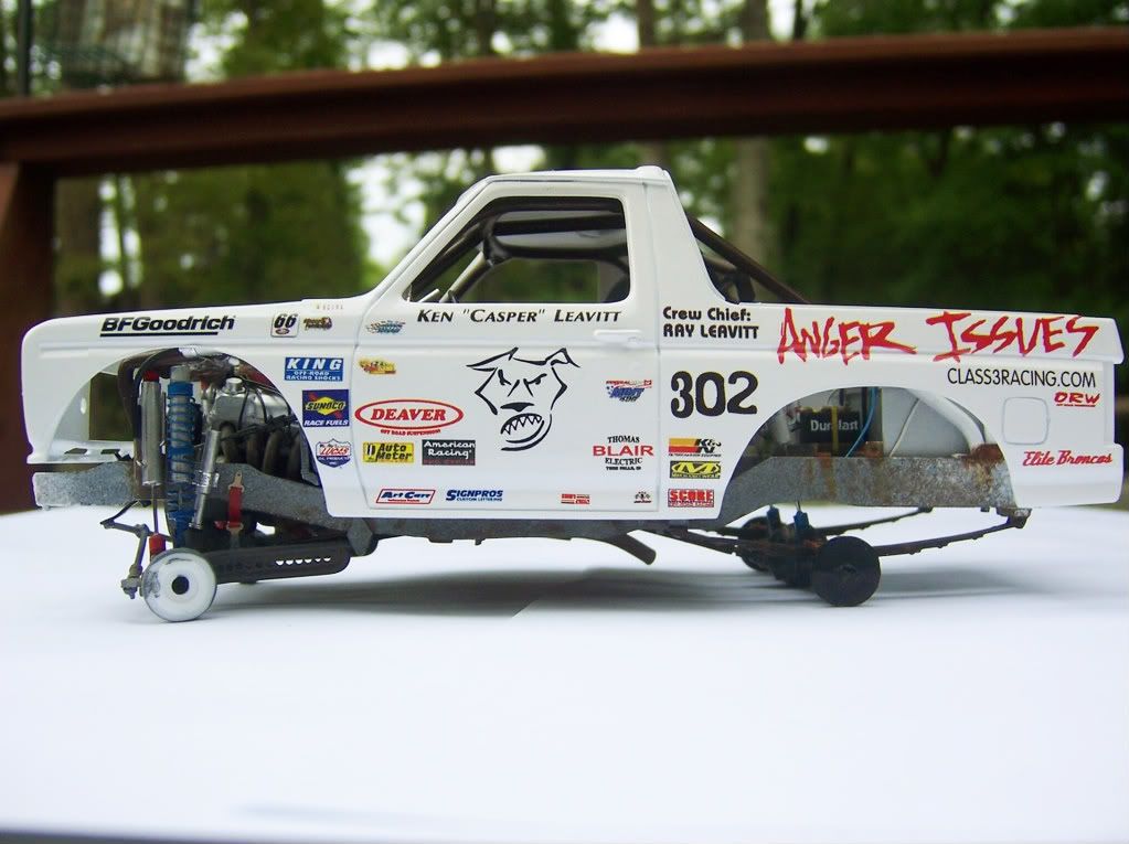

coopdad Posted July 9, 2010 Share Posted July 9, 2010 Yes, awesome job Tim. I too used white paper coated with Tamiya clear for my decals. Printed on a Canon Pixma inkjet (had terrible luck with our Dell laser printer) on the coated Photopaper settings. I used Illustrator to build the files. before adding dirt (a better view of the decals... sorry for the oversized photo): On thing I learned that made an effect was to double check that when making "black" art, make sure it is CMYK black, not RGB. I scanned the car number "302" and forgot to convert it to CMYK before bringing it into Illustrator. So it had a dot pattern because it was made up of many colors rather than only black ink. Not too noticeable as the registration of the printer is pretty good but it was a dumb mistake. John Quote Link to comment Share on other sites More sharing options...
