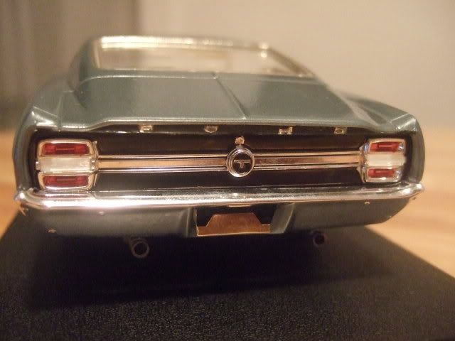

philo426 Posted August 4, 2010 Share Posted August 4, 2010 (edited) I use model master Flat Black and thin it down until it flows.Works quite well!Here is the rear of my '69 Talledega. Edited August 4, 2010 by philo426 Quote Link to comment Share on other sites More sharing options...
