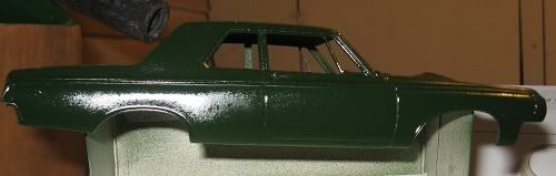

Mr. Show Posted October 7, 2010 Author Posted October 7, 2010 (edited) My airbrushing adventure went about as expected. My first attempt was fouled by my own ignorance pertaining to airbrushes, plus the manual made no mention of the fact you have to loosen the nozzle on the canister. So there I was, wondering why so little paint was spraying, continually thinning it into oblivion. I then saw a spring and threads and slapped my forehead hard enough to leave a dent. However, forgetting I had thinned the paint so much, I went to work. Well.. It looked good until all the paint started dripping onto the floor. It also looked much worse before I went at it with the thinner and 1500 sandpaper. Armed with basic knowledge (and paint not thinner than air) I gave it another try: Not quite smooth but I'll see how finishing goes. If it doesn't work out I'll try the brake fluid method that's so popular around here. At least the paint is cheap. Edited October 7, 2010 by Mr. Show

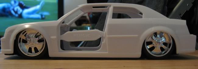

Mr. Show Posted October 10, 2010 Author Posted October 10, 2010 (edited) The 330's paint is curing and I should have pictures soon. In the meantime, I've started on a Chrysler 300C Hemi SRT8. It's part of Revell's "Uptown" line from 2006. It's a fairly simple kit but looks to be of good quality. Edited October 10, 2010 by Mr. Show

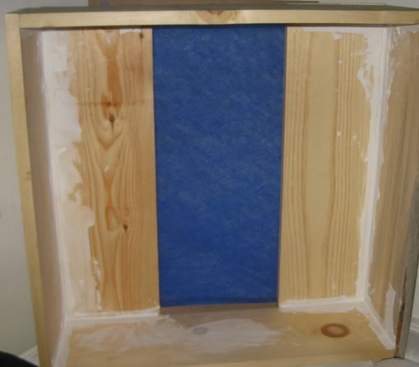

Mr. Show Posted October 11, 2010 Author Posted October 11, 2010 (edited) It's good to see your determination is keeping you going! This is how we all learned, and still learning, by doing it over .. paint till you faint! There are MANY threads here on painting which you might find interesting. Thanks. This forum is inspiring - without it I would have given up by now. My last paintjob was ruined by hair and dust since I was doing it outside. I built myself a ghetto paint booth last night so I can attach a fan to the back blowing out a window. Should alleviate particles getting in the paint. Extreme low budget solution. Once I get some free time I'll no doubt build a more complex, over-engineered version, but in the meantime it should work fine once I install the rotating platform and extend the edges with cardboard or something. Edited October 11, 2010 by Mr. Show

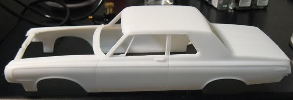

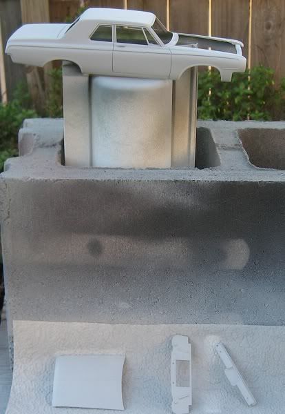

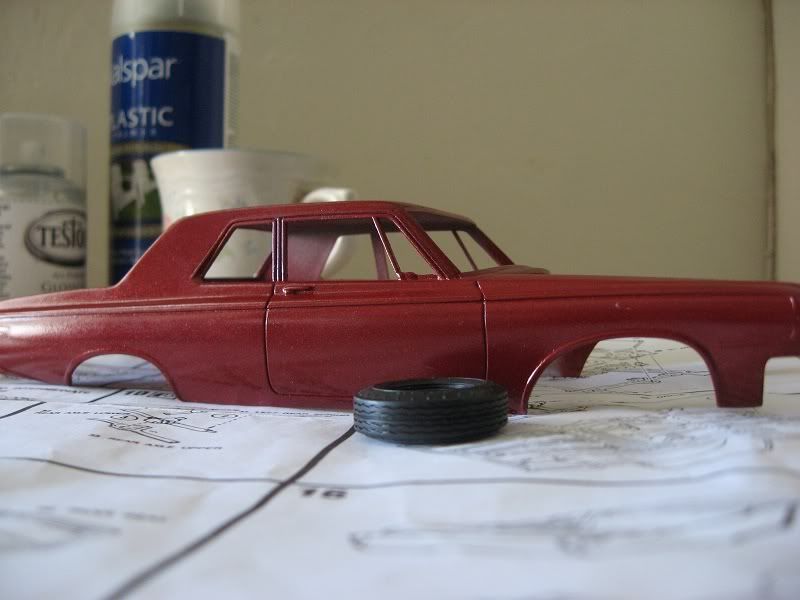

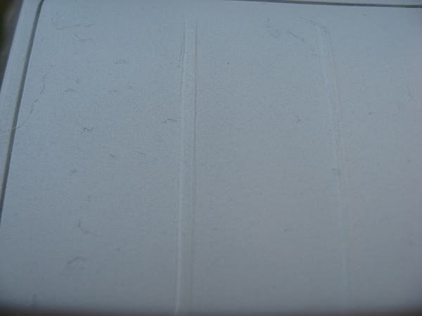

Mr. Show Posted October 14, 2010 Author Posted October 14, 2010 After hours of prep work that probably weren't worth it, I'm ready to lay down my final attempt at a topcoat. If it looks good, great; if not, I'll finish the build and move on, lessons learned. Color: Primed: No idea where those came from, but sanding should take care of them: And the finished product before clear. It looks much better in person, the reflections look strange in the picture:
oldscool Posted October 14, 2010 Posted October 14, 2010 Body prep is ALWAYS worth the extra effort and it looks like it paid off very well for you;). With a clear coat that paint will look fantastic. oldscool ( not always practicing what I preach)
Scalper Posted October 14, 2010 Posted October 14, 2010 Your Last paint job looks much better. Are you going to use the dog dish caps on this one?
Mr. Show Posted October 14, 2010 Author Posted October 14, 2010 (edited) Your Last paint job looks much better. Are you going to use the dog dish caps on this one? When I was still going to paint it flat green I planned to use the black steelies with steel colored hubcaps. I stripped all the chrome parts and planned to do those and the accents steel as well. Now that the finish is different I'm not sure how well that would work. Steel accents would probably look terrible with a glossy/metallic topcoat. May just go back to chrome and pilfer some wheels from another kit of the same era. edit: Anyway, hope to get the slant six parts painted today. It's more detailed than the 383 and has a separate transmission. Some of the 383's pieces are just awful; the fan is unusable. Edited October 14, 2010 by Mr. Show

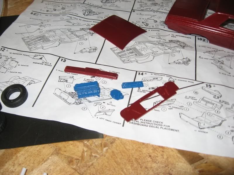

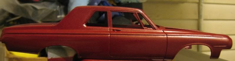

Mr. Show Posted October 15, 2010 Author Posted October 15, 2010 (edited) Got a coat of clear on and painted most of the engine pieces. I had no idea if the slant six was originally Chrysler Red or Blue. Instructions say blue, picture on box is red, all the pictures on GIS but a few are red. Oh well, I could never approximate the red anyway. Edited October 15, 2010 by Mr. Show

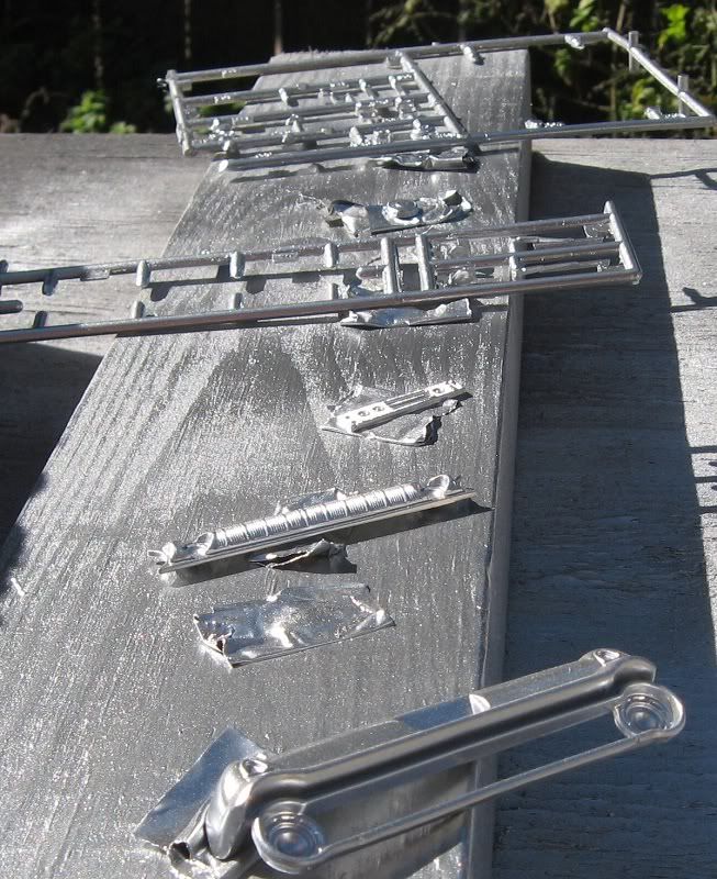

Mr. Show Posted October 15, 2010 Author Posted October 15, 2010 Re-chroming is underway. Just have to put on another coat of clear and the final chrome coat.

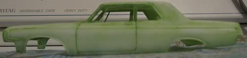

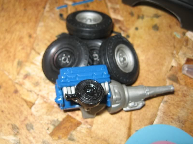

Mr. Show Posted October 21, 2010 Author Posted October 21, 2010 (edited) Well, I wasn't happy with the Testors one shot lacquer - even after two clear coats it flaked off quite easily on the edges as I was trying to polish it with a cloth. So back in the DOT3 lake it went. All the lacquer slid off like slim within 15 minutes - either my brake fluid has aged like wine or I should have sprayed the lacquer on thicker - it certainly wasn't a primer issue as I used lacquer for both. Also the Duplicolor "chrome" spray paint was a waste of $6. There is nothing I can do to make it look remotely good: gloss black basecote, future, bare, primed, so flat and glossy you can ski down it, etc., so Alclad here I come. Anyway, hours of sanding, smoothing and priming later: All flat (except that shiny blob thing which looking at it now is a drop of water,) but I may give it another coat of primer and sand that before the final coat. It's a tossup between pearl purple and just plain gloss black. I also got a little work done on the engine. I'm not too happy with it and I have no idea what happened with the air cleaner, but I'll just leave it. I'm not trying to make my first build perfect, even if I have painted and stripped the body 5 times. Anyone know if Boyd's spray paint needs to be thinned for airbrushing if decanted? Edit: I'll probably stop updating this until the model is finished or my skills greatly increase and I have something worthwhile to post. These middling shots probably aren't very interesting but I wanted to also keep a log for myself to chart my progress. Edited October 21, 2010 by Mr. Show
