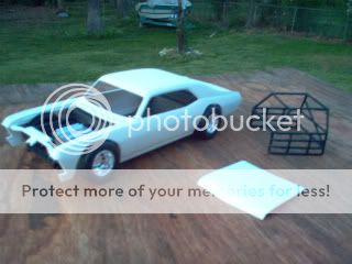

Yep. I think I have a you tube clip with that car on it. Keep um coming. Looks good. Is that one of Fred's roll cage kits?
Nope, them is good old Q-tips. They make great cages
Cool. I never thought of that. Been using styrene rod to make mine out of or using kit cages cut up and modified when needed. I'm working on a Petty Magnum. It should be interesting subject when I get it done.
