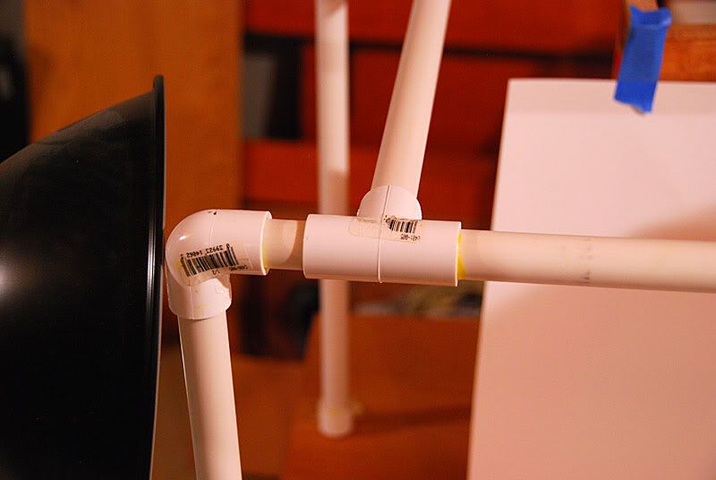

I used 1/2" pvc pipe that is at any hardware store. A few T's, elbows and end caps to put it all together. The dimensions really don't matter too much. I sized it to fit a table I had, but It could have been smaller for cars and the lights would have gotten closer.
I did buy some light stands, but I do a lot of tabletop photography. Still, that are pretty simple and work well. The front light is just a clip on desk lamp. You can use any lamp you have around that's convenient.
The bulbs I use are Longstar brand Compact Fluorescent Lamps, 30 watts and day light. Be sure to get "day light" colored bulbs no matter what type you get. These aren't extremely powerful, but they do a good job.
A white sheet draped over it all provides the light tent to diffuse the light. This can be used in layers to adjust the lighting.
Last is a TRIPOD .. this no matter what else you do!
That should give you a good idea for a simple and cheap setup.
