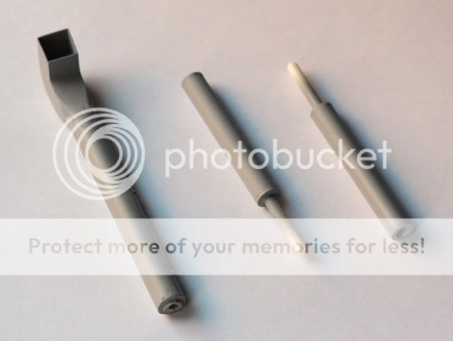

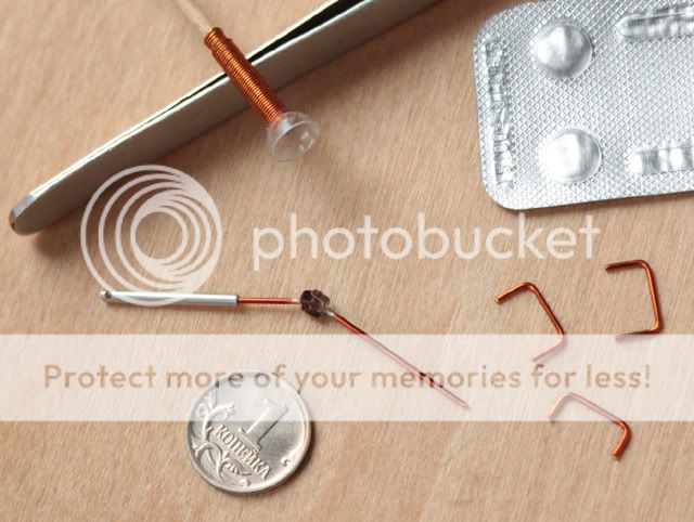

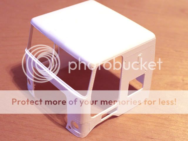

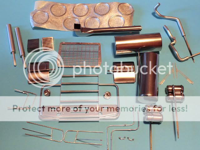

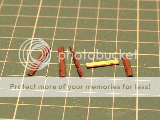

Sergey Posted December 11, 2011 Author Posted December 11, 2011 (edited) O-key, let's continue: Now I finished to scratch silencers and air filter inlet pipe: Cut out cab doors: Here is my way to make piano hinges. I used brass angles and 0,8mm brass tubes: Here is my jig to solder tubes & angles. Don't care about blue knob. It was made for rear springs scrach. Pieces of angle are holded in place by stepler pins: Cooper wire (twisted revers side of the jig) is holding the tubes: Edited October 29, 2014 by Sergey

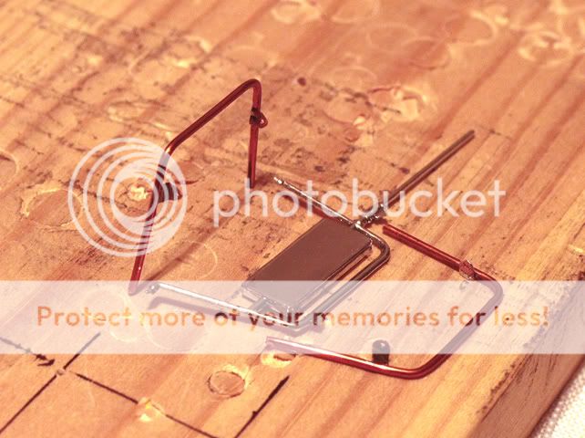

Sergey Posted December 11, 2011 Author Posted December 11, 2011 (edited) The result: The spare tube pieces (dark pieces on a previous pic) are filed down: The bullbar: Rear mud flaps will be made of this: Here we can see: abowe - uder cab part of gear shift slot, in a midle - steering linkage cardan between steering column and power steering, on the right - there are vent door handles: Thank you for interest Edited October 29, 2014 by Sergey

Tony Bryan Posted December 12, 2011 Posted December 12, 2011 Sergey Those parts are getting smaller and smaller, nice work on the detail, Are you using vanish coated wire ?

Sergey Posted December 22, 2011 Author Posted December 22, 2011 Are you using vanish coated wire ? Forgot to say - Yes Tony, all cooper wires are varnish coated. Thank you, Mike!

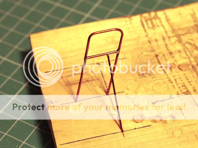

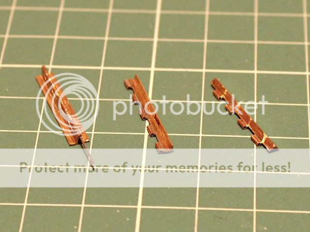

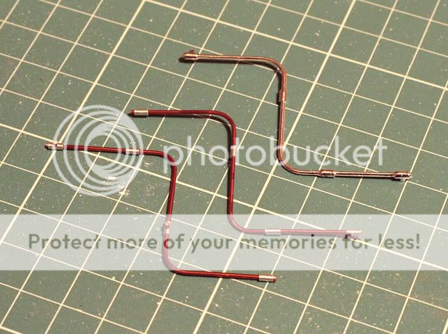

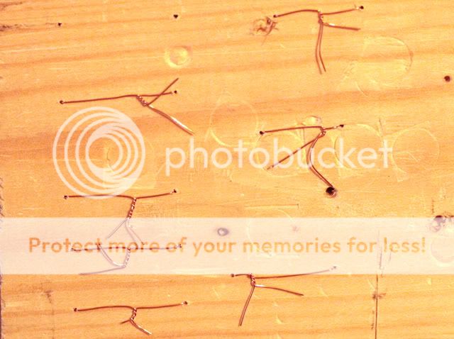

Sergey Posted February 1, 2012 Author Posted February 1, 2012 (edited) Thank you guys. Very kind of you. A little progress. I decided to alter hand rails, steps and mirror arms because of seams they have: Here is the jig to solder steps There are hand-rails of cooper wire below and kit part above: Mirror arms: Finally all the parts (which should be) were chromed: Thank you for yuor interest. Edited October 29, 2014 by Sergey
Jim B Posted February 1, 2012 Posted February 1, 2012 Excellent job. Did you chrome them with Alclad?
