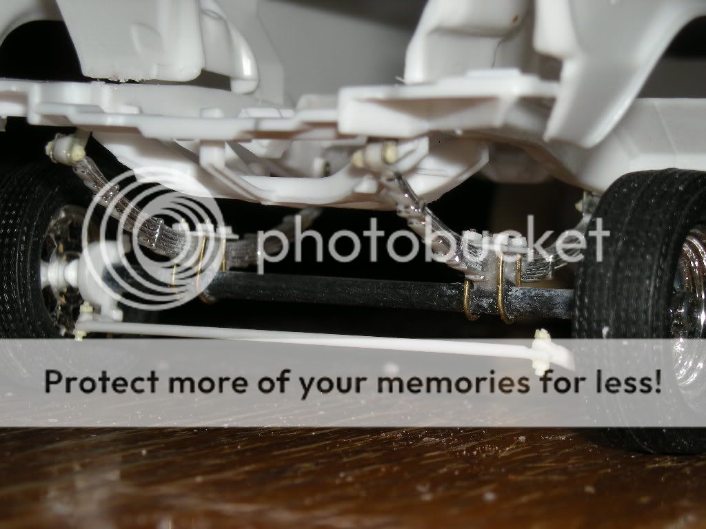

W-409 Posted May 8, 2011 Posted May 8, 2011 This one is going to look good when finished... Well, it looks good already. I like those tires, they are huge! And when it has raised suspension, the tires are going to look very good on this. Nice work with front axle system... Nice job with it so far, I'll keep watching this one.

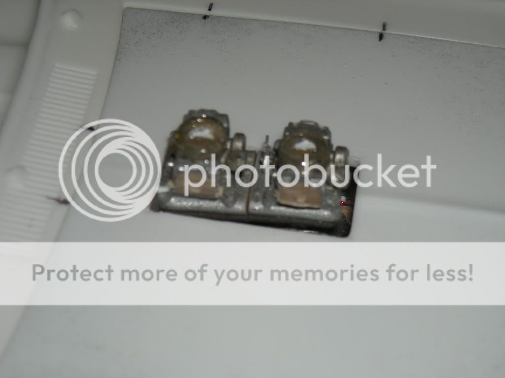

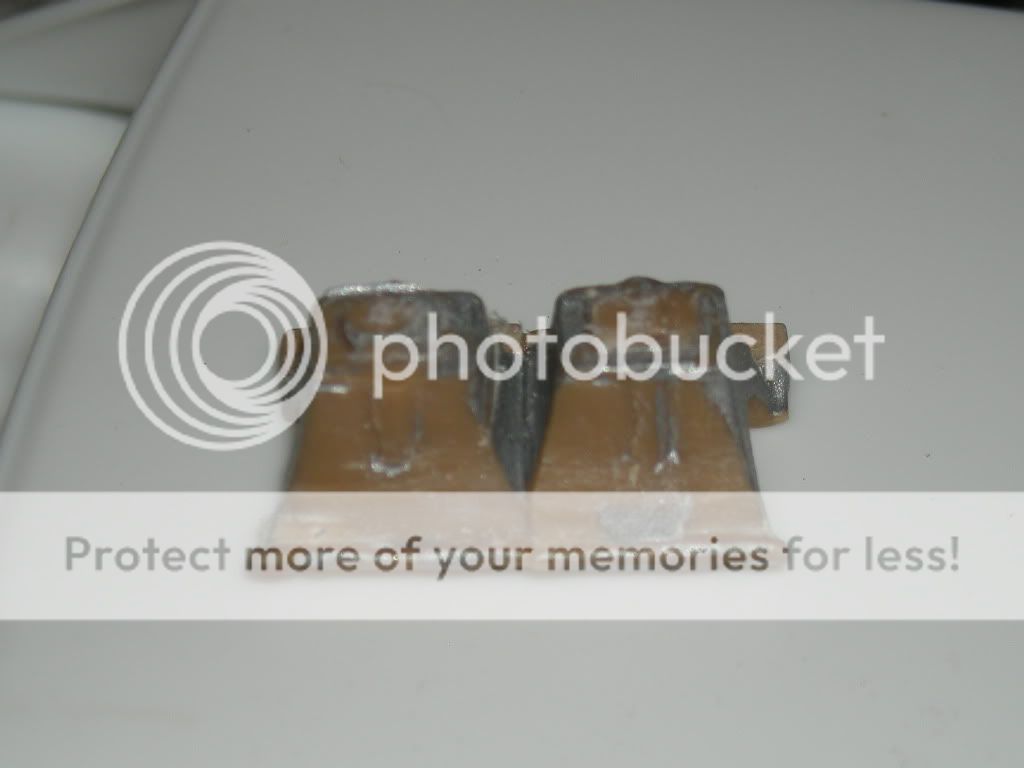

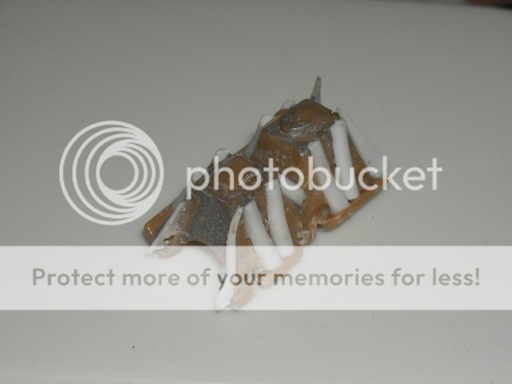

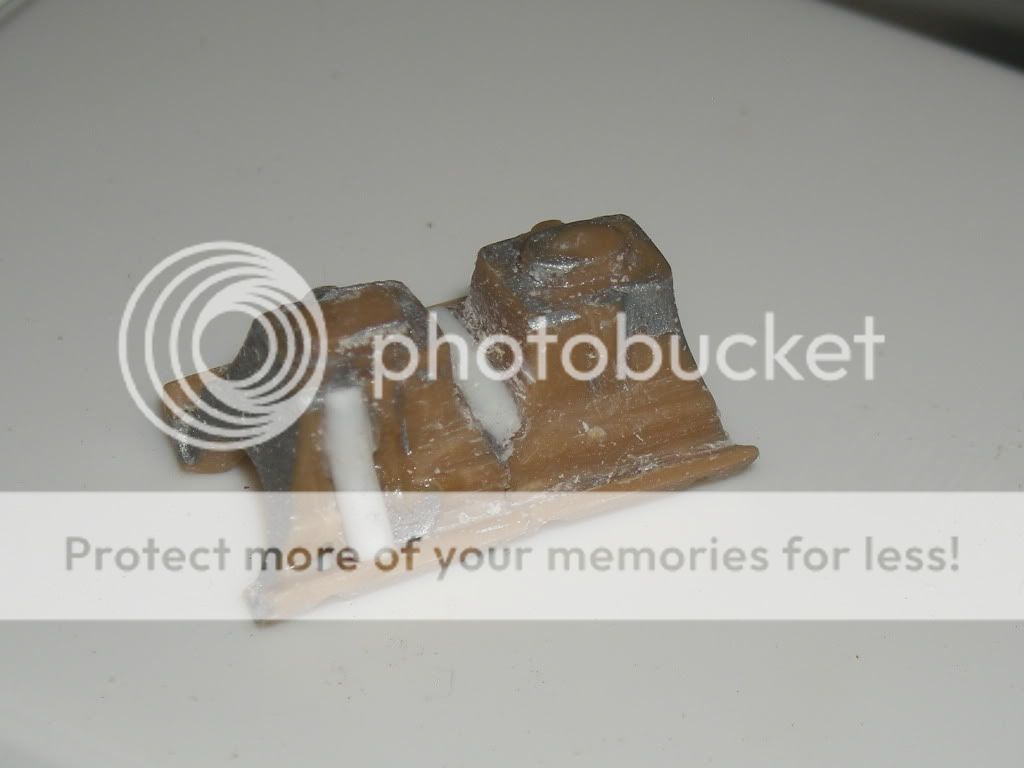

Modlbldr Posted May 16, 2011 Author Posted May 16, 2011 Thanks for the great comments guys. It's keeping me going, although at a snails pace. Started a new job this last week so I'm still trying to figure out the schedule. I'm working nights. Anywho- I got a chance Friday to do some work. I couldn't find a tunnel ram that looked anything like the one on the car, The closest I could find was the 1/24 scale one from the 70 Coronet. The one I had was already assembled from an older build. I tore it apart and cut about two blade widths out of the center between the two stacks. Then I glued it back together and shaved off the inlets because they were directed wrong. Next I filled the V section in the center so I could reshape it flat and began adding the inlets using sanded down rod. Eight inlets later and this is what I had. I also added some triangular bits on the ends as molding fins (Love the technical terms?) and began shaping them and the bottom flange. I also worked on cutting the hole in the hood. I think that it is where I need it. Check out the old X-Acto packs a friend of mine gave me. I've never seen packs like these. Not sure how old they are. They are 5 packs. My next session will be cleaning up the tunnel ram, painting the engine block the proper Orange color and painting the hood. Thanks for following along. Later-

seeker589 Posted May 21, 2011 Posted May 21, 2011 (edited) I'm building a replica of a 66 Belvedere straight axle drag car using the 67 GTX and I have a question regarding the K member. I can't see the front suspension well enough to tell if they kept the K member intact with the frame and added leaf springs and a straight axle ala 60's drag or whether they scrapped the entire k member and just attached leafs to the chassis with the straight axle. Would it be necessary to retain the k member for rigidity or would it even make sense? If I have to keep it, I could just cut the spindles away from the molded in k member add a set of front leafs and the axle, no problem. Or, I throw it all back in he box and just go with the leafs and straight axle for the nose high look. What's your take on this????? Any help? Later- Sorry - I just found this thread. If I remember correctly - many times drag racers that wanted to do the AWB/big engine set-back thing - would just hack off the stock frame rails from the firewall forward. Then fabricate frame rails out of 2x4 tubing with similarly fabricated cross-members and motor mounts and/or motor-plates. Simple and lightweight - keep thinking weight transfer to the rear wheels. Traction! Edited May 21, 2011 by seeker589

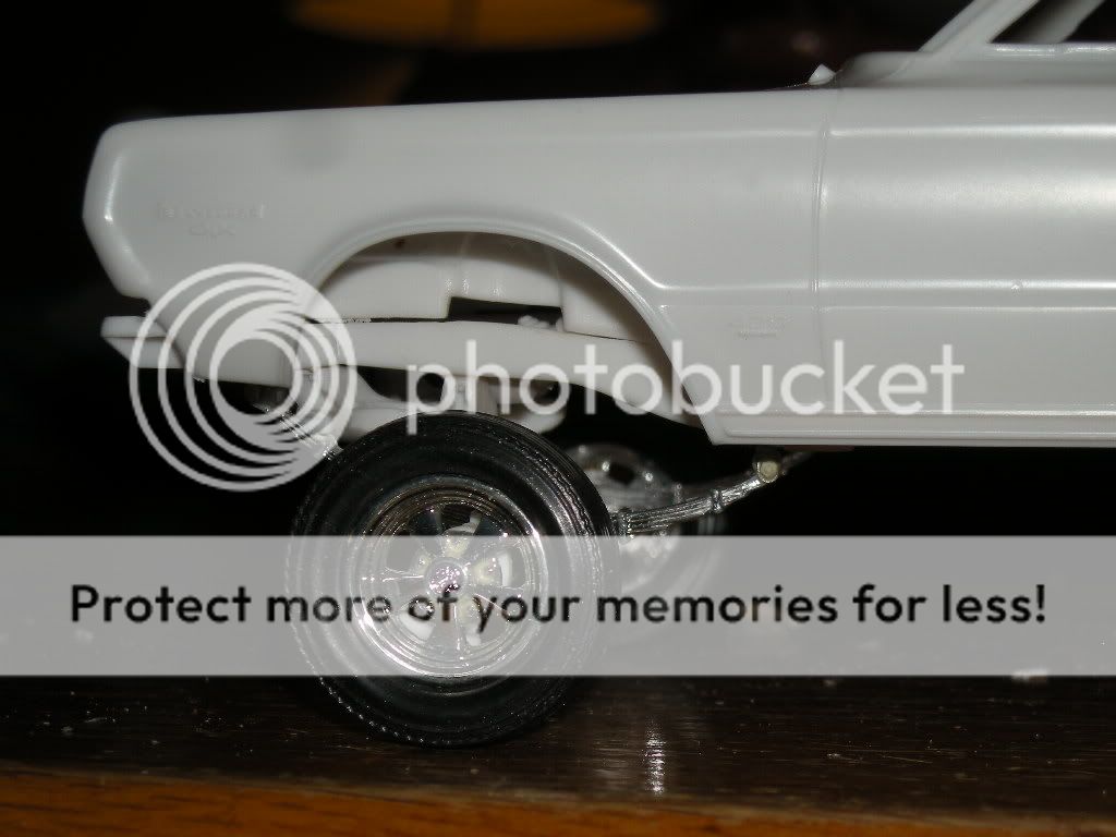

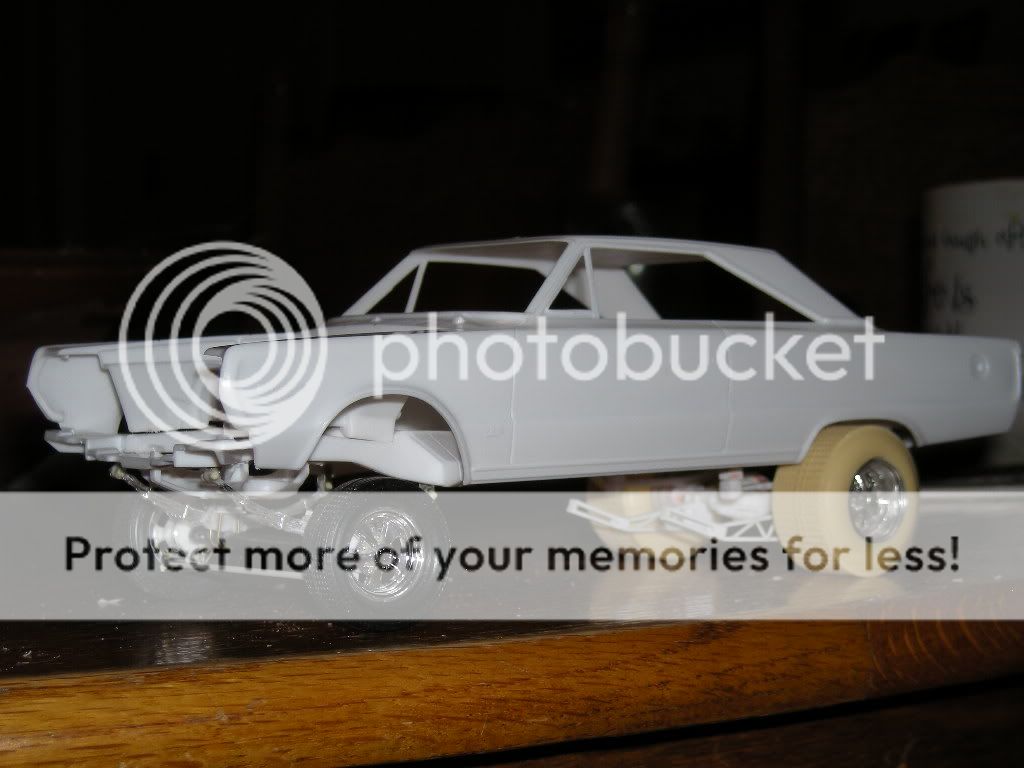

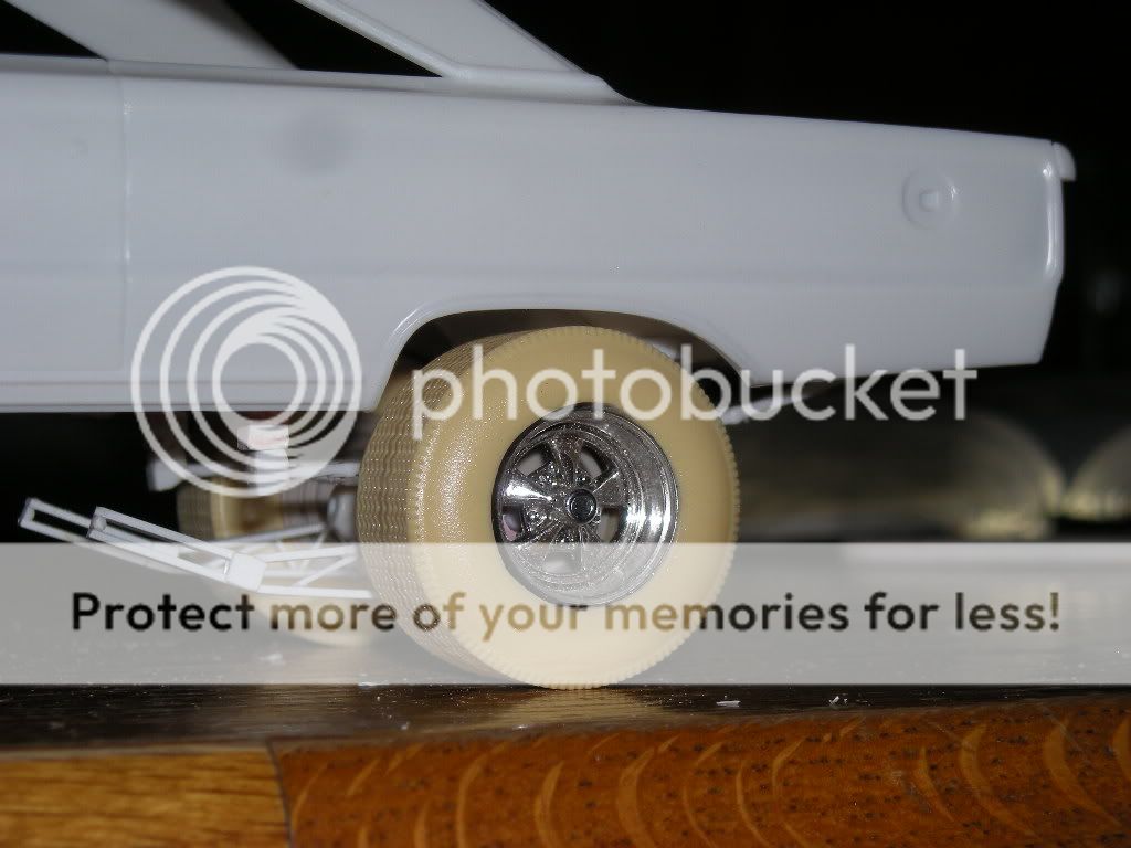

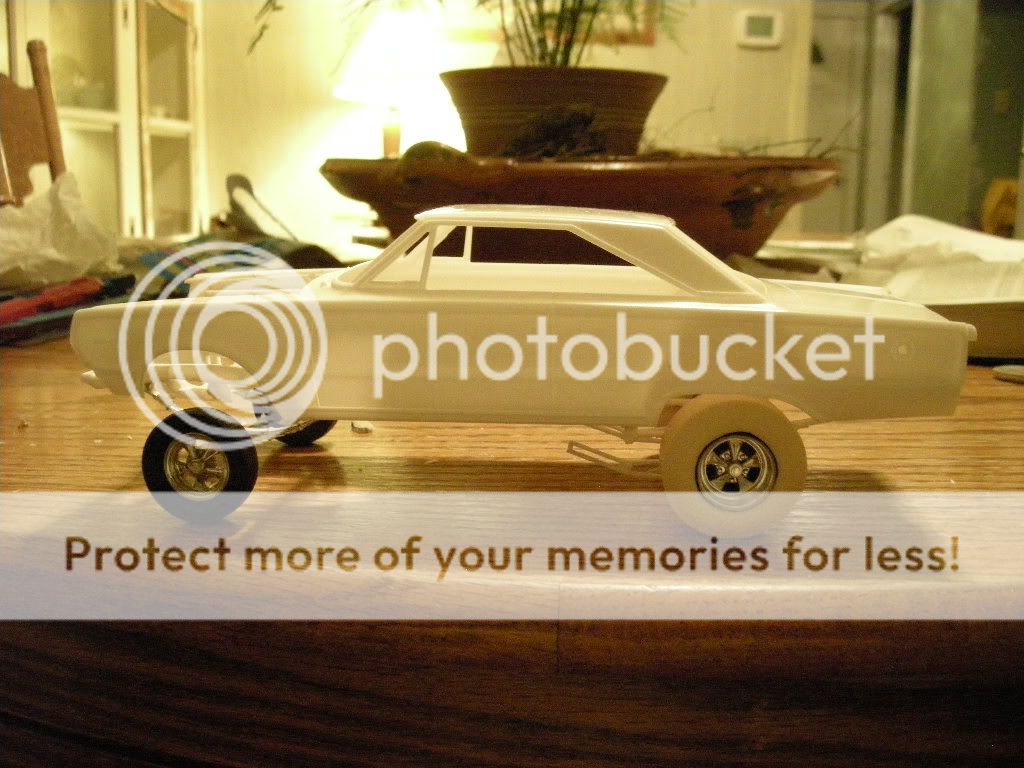

Modlbldr Posted October 30, 2011 Author Posted October 30, 2011 (edited) Well, it's been quite a while since I updated this but I've been working at it here and there between other projects. Tonight I sat for a while and restarted the design of the rear suspension. The original that I had put together sat a hair too far forward and the axle was too wide causing the wheels to sit out too far AND.... the suspension wasn't tall enough, causing the rear tires to touch the wheel wells. All completely wrong. I had torn it all apart earlier this week. I angled the rear shackles toward the rear a bit more, which gave me the move back I needed. Then I narrowed the rear axle about 3/16 inch causing the leaf springs to line up directly above the rear frame instead of outside of it and then glued crude blocks onto the frame for the front of the leaf springs to connect to. I still need to reattach all of the PE shackles. Here is how it sits now. I still think that I need to lower the front a bit. This is just an extra GTX body I have for mock up. I already have some paint on the other one. The pictures are terrible, but it was a last minute photo shoot. More to come. Later- Edited October 30, 2011 by Modlbldr

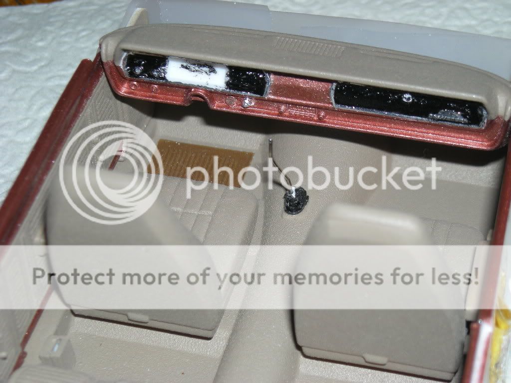

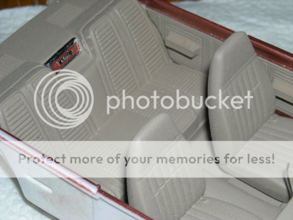

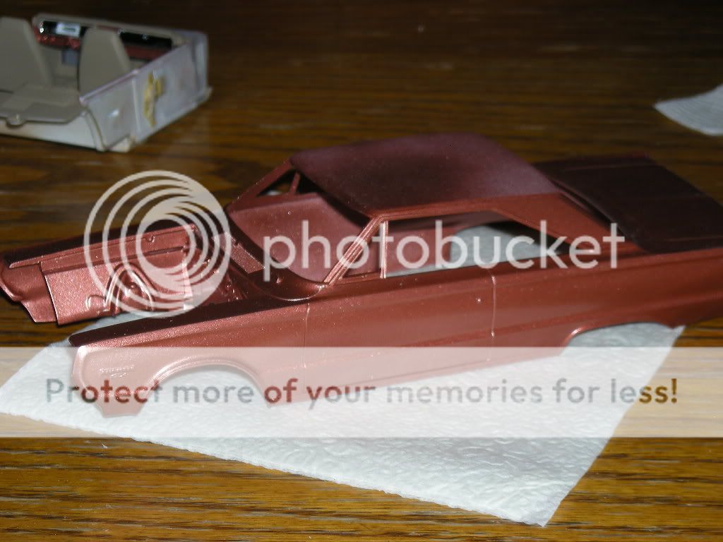

Modlbldr Posted October 30, 2011 Author Posted October 30, 2011 I have also been working on the interior. I used the seats from the Chevy Citation kit because they closely resembled the ones from the magazine article of the 1:1. I painted the interior Fabric Tan and body color and started the detailing of the dash. I also detail painted the taillight panel and the front grille. The body also got a few coats of the Testors Mopar Bronze. Still quite a ways to go but I just wanted to update this after such a long time away. Hope you all enjoy this and comments or criticisms always welcomed. Later-
W-409 Posted October 30, 2011 Posted October 30, 2011 Great to see this one back! I like the interior, it looks like straight from the factory. And body color is very nice. Stance looks great, that front axle system is really nicely done. Nothing wrong with the rear end, can't wait to see more work with it. Keep going.

High octane Posted December 26, 2011 Posted December 26, 2011 Both the GTX and the Dart look as they would topple over going around the corner and that's not very streetable in my book.
FASTBACK340 Posted December 26, 2011 Posted December 26, 2011 Pro street cars are a handful too in the corners, they just rolled over at a lower altitude! I remember this fad when I was in high school and I didn't like it then either, but it does make for an excellent modeling subject. Function-ability be damned.... build-on!
