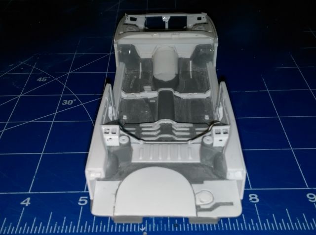

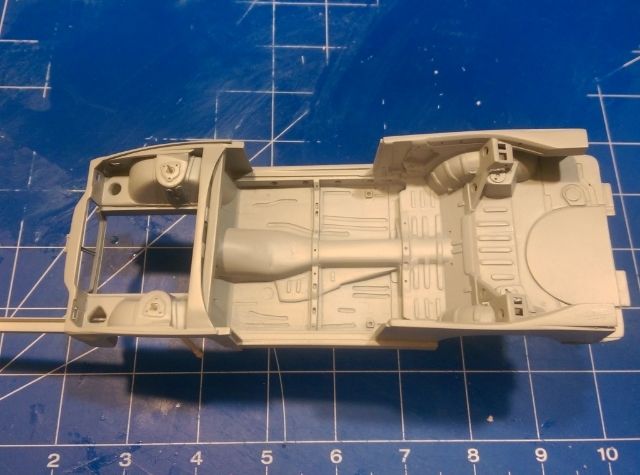

I'm planning on updating this one regularly as I've got some time to work on it now. My friend that I'm building this for wants a car with a stripped out interior...that meant a lot of fabrication. Then, I went to finish the engine bay. I initially made it too short. I extended the front by 3mm, built a radiator support, and added some more stamped details. Here's how its looking so far:
Sorry for the bad pics as they are taken with my phone. Now, to wait for the glue to dry before I can finish sand the chassis before primer.
Thanks for looking!
Jimmy
Thanks guys! Its nice to get back to building.

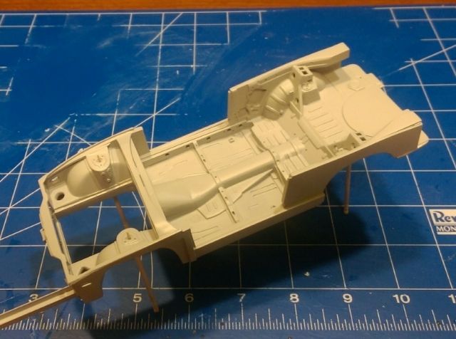

I got around to shooting a coat of primer tonight, and was happy to see that I don't have to do a lot of remedial filling...just a couple of spots that I initially had trouble with.
Now,the waiting game begins on the primer to cure before pressing on with the rest of the interior.
Jimmy

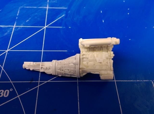

This update was a long time in the making. Fujimi molded an auto gearbox in the original chassis...that is why I deleted it from mine. So I hit up a factory service manual, and fabbed up a FS5W71C 5 speed gearbox. The bellhousing was a piece of cake to make, but the tail housing was a challange. I made multiple attempts before I got a box I was happy with. I'm going to cast this tranny in two pieces since a lot of Nissan trannys use tail housings that are of a similar design. That way I can use the tail housing over and over, with me only having to fabricate new engine specific bellhousings.
Thanks for looking!
Jimmy

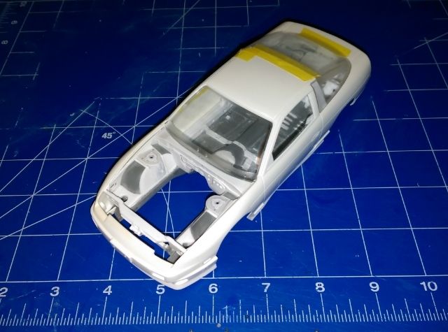

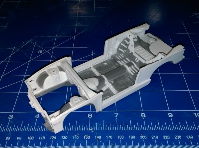

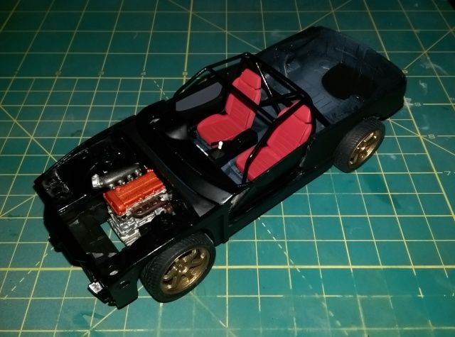

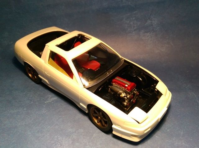

Been away for a while, posting my work on my FB blog page :  Crewdawg Works.  Chassis complete, engine copied in resin, and body work almost complete.  Here's some progress to get you up to speed.

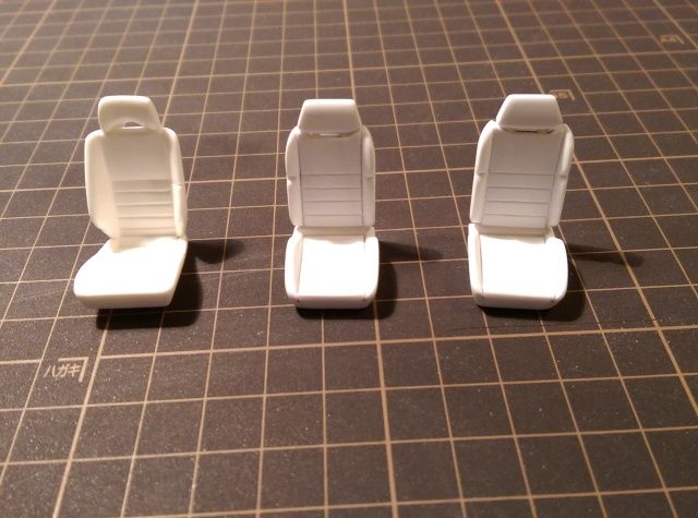

Scratch built S15 Silvia Seats
Chassis progress
Engine

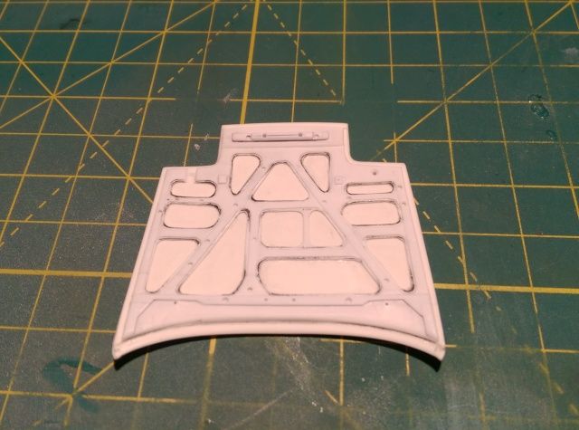

Body mods:  Hood underside bracing, rolled rear fenders, opening/closing sunroof, opening/closing headlights
Thanks for looking!
Jimmy
