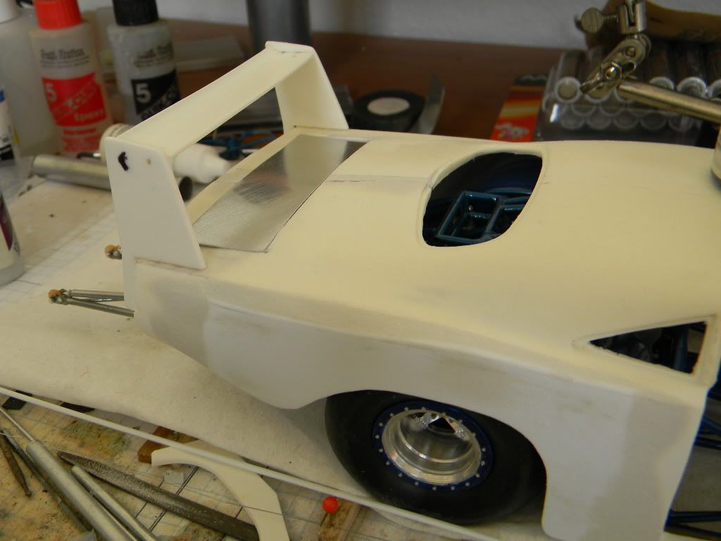

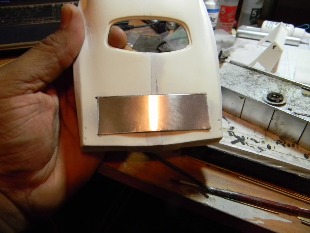

Romell R Posted August 20, 2011 Author Posted August 20, 2011 Thx Brandon glad you could share my vision I'm working slowly I was able to get the rear access hatch cut and fabbed the door. enjoy

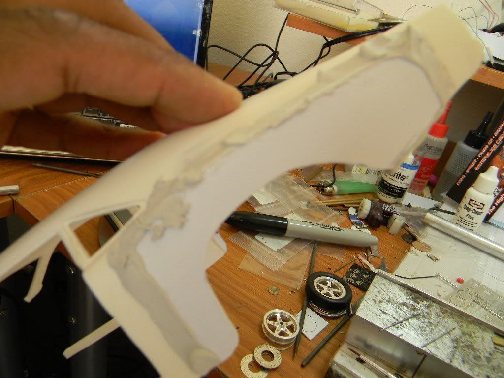

pharr7226 Posted August 21, 2011 Posted August 21, 2011 (edited) Ok I got the fenders widened but I still need a tab bit more room so I cut the body down the center and install a wedge that will give me 2mm more on the sides heres the fender with putty on it Here's the wedge installed now all I have to do is make it all look like its not there. see ya on the next update Rom, I see you like a girl with wide hips. Don't tell you wife I said that. LOL. Edited August 21, 2011 by pharr7226

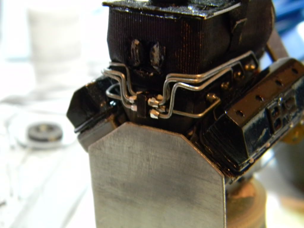

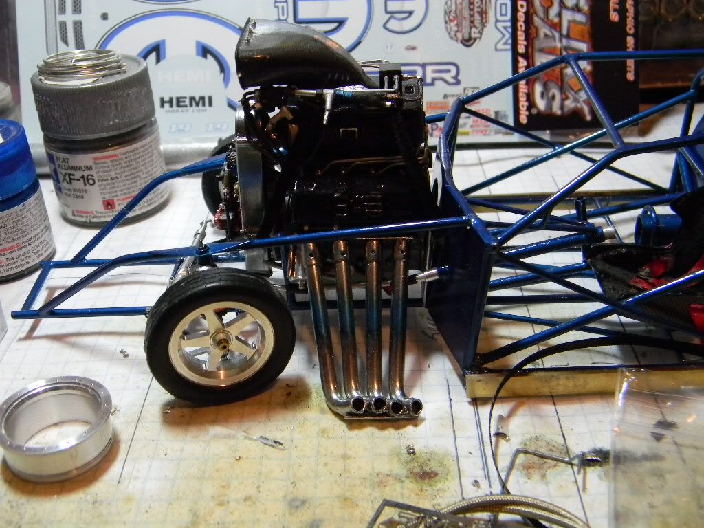

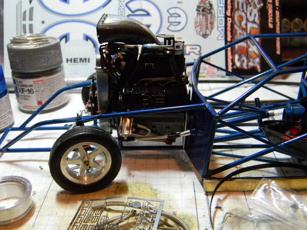

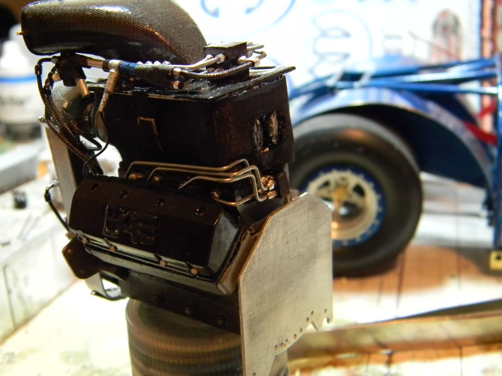

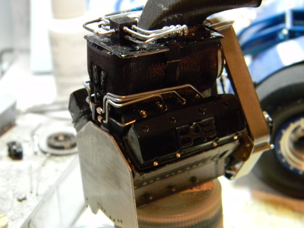

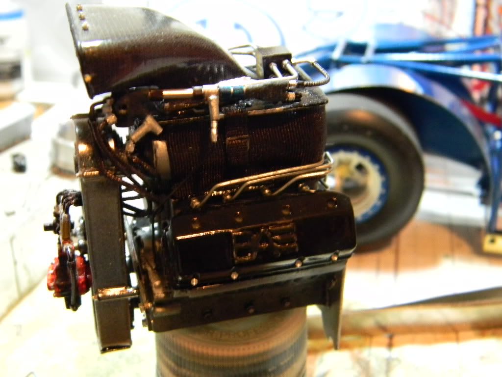

Romell R Posted August 23, 2011 Author Posted August 23, 2011 John :Thx for the sincere compliment Mark : somehow I knew you would get it. Dave: This is your world brother im just trying to get a pass to be in it. Jeff: you have a cold piece of work going on there your self keep it up man! Fellas I just have another small update I was able to get the lower injector lines hooked up I hope you enjoy See ya soon.....

Dragracer Posted August 23, 2011 Posted August 23, 2011 Rom, the lines/engine are looking good!noticed that you set up the sensor line running from the barrell valve to the fuel block, nice detailing!
Romell R Posted August 23, 2011 Author Posted August 23, 2011 (edited) Romell......look`s GREAT!!!!!!! man.......you gotta get this build finished.....i`m anxious to see it done. John thx man you have a few builds i cant wait to see in person. Keep up the good work ! Rom, the lines/engine are looking good!noticed that you set up the sensor line running from the barrell valve to the fuel block, nice detailing! Good eye Richard most wouldn't have caught that one. Thx for watching Edited August 23, 2011 by Romell R

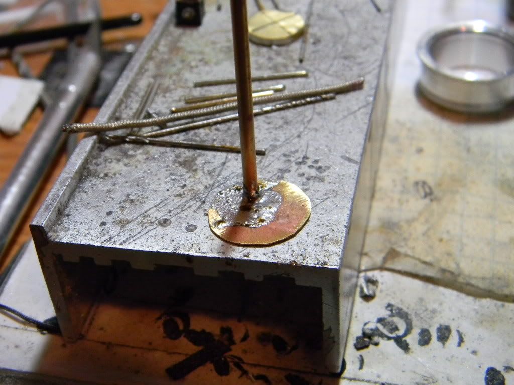

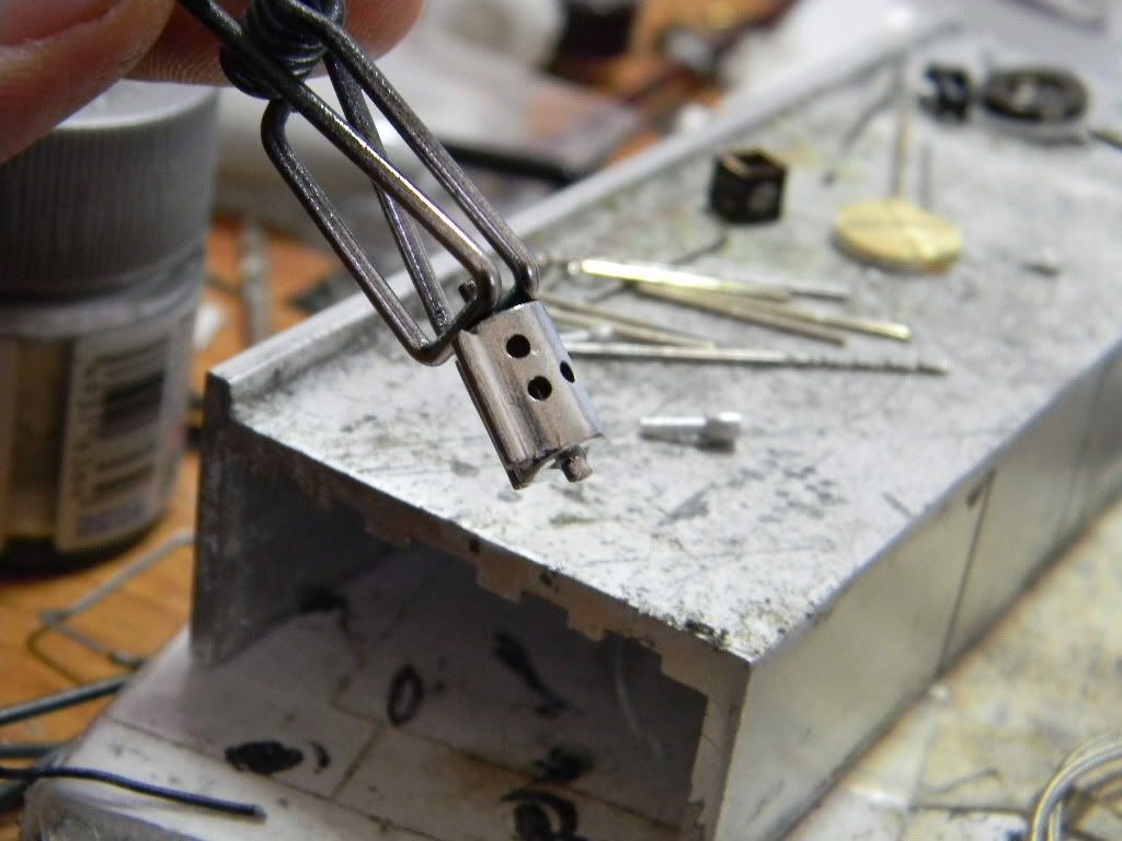

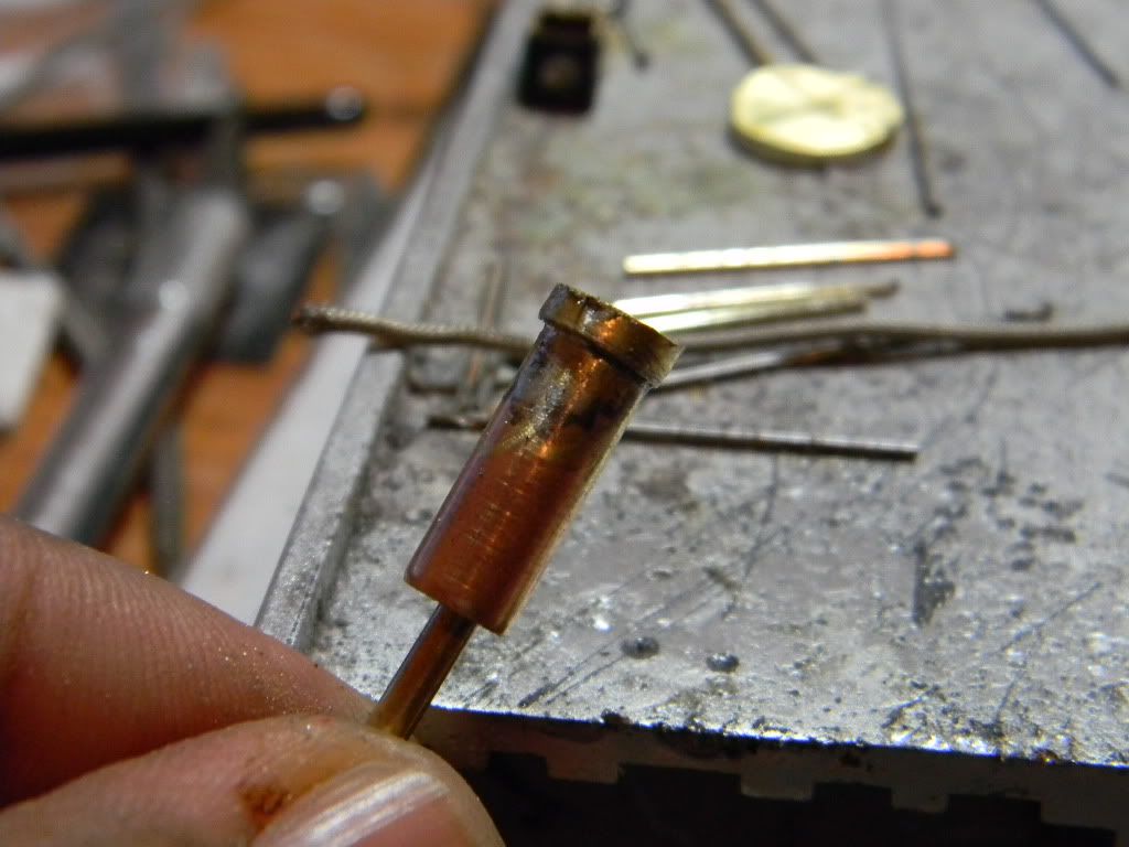

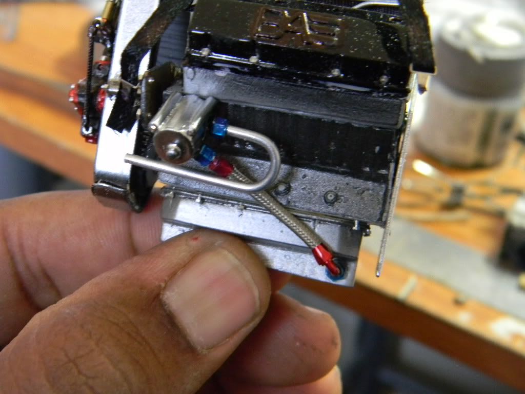

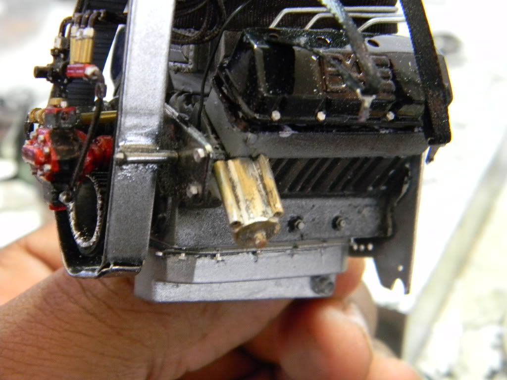

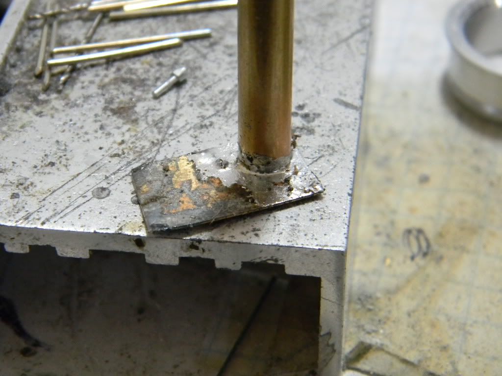

Romell R Posted August 24, 2011 Author Posted August 24, 2011 Thx for all the great comments fellas , and Andy I can only put you in as a back up driver ......Cause this one's gonna have my name painted over the drivers door LOL! Well fellas got another update for ya. I fabbed the oil system today from brass heres a sorta step by step, soldered a piece of tube to a piece of sheet to make a closed cylinder then added a center shaft this will serve the purpose of attaching to the motor a little more detail added ok now i'll clean it up and see you in a few seconds

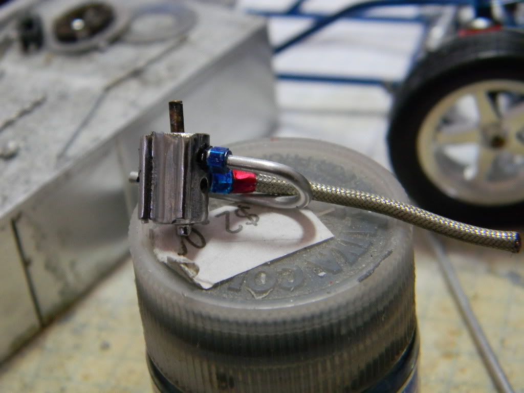

Romell R Posted August 24, 2011 Author Posted August 24, 2011 Ok Im back told you it'll only take a few seconds this is where the pump will mount, one test fit now on to the paint man I love Alclad partially plumbed and ready to install on the motor And here we are the installed oil pump system I hope you enjoyed ......

Romell R Posted August 24, 2011 Author Posted August 24, 2011 hey thx Randy Im looking forward to more on your project buddy Chris your comments are always welcomed thx for the kind words Hers a parting mock up hope you enjoy.....

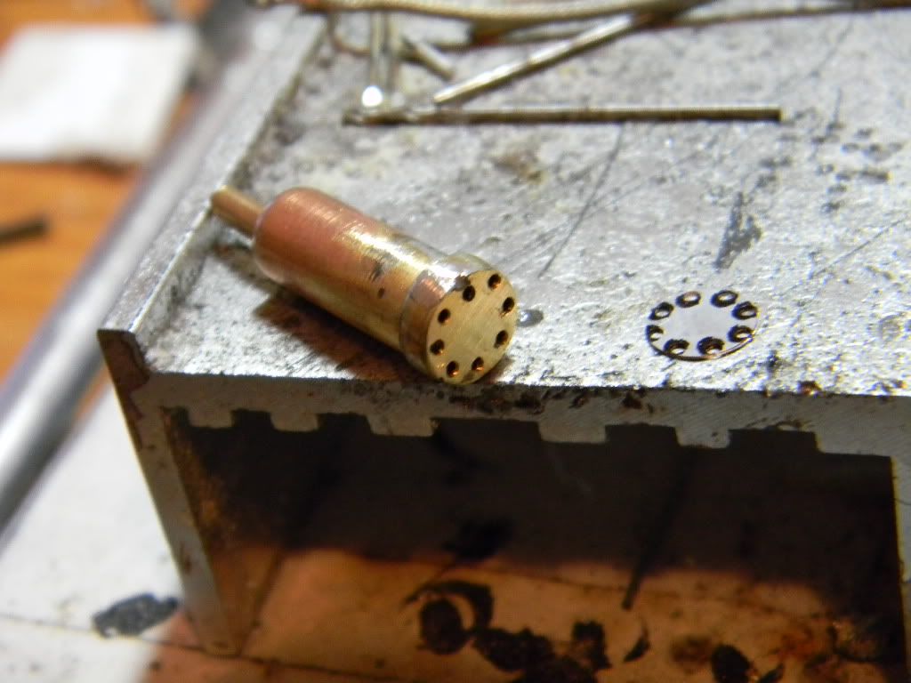

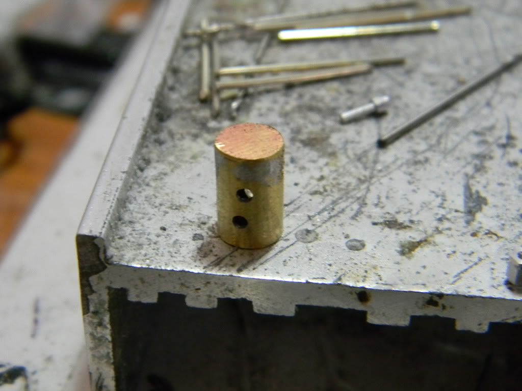

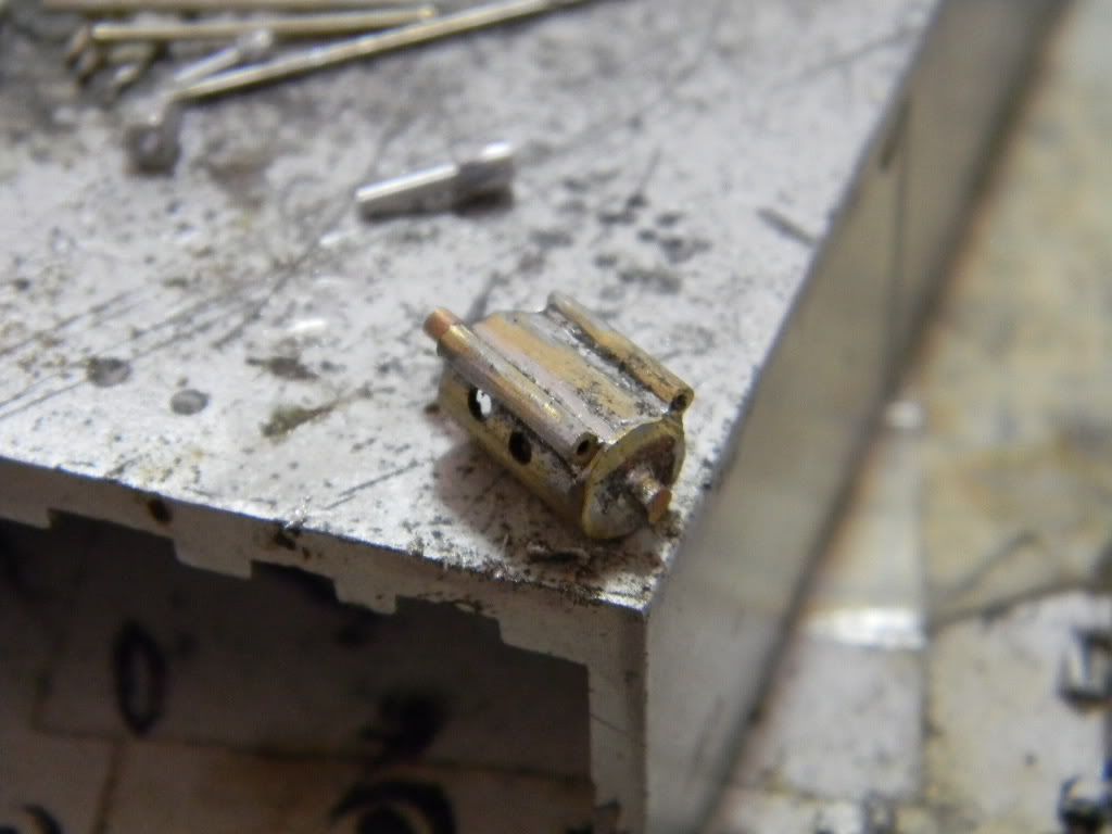

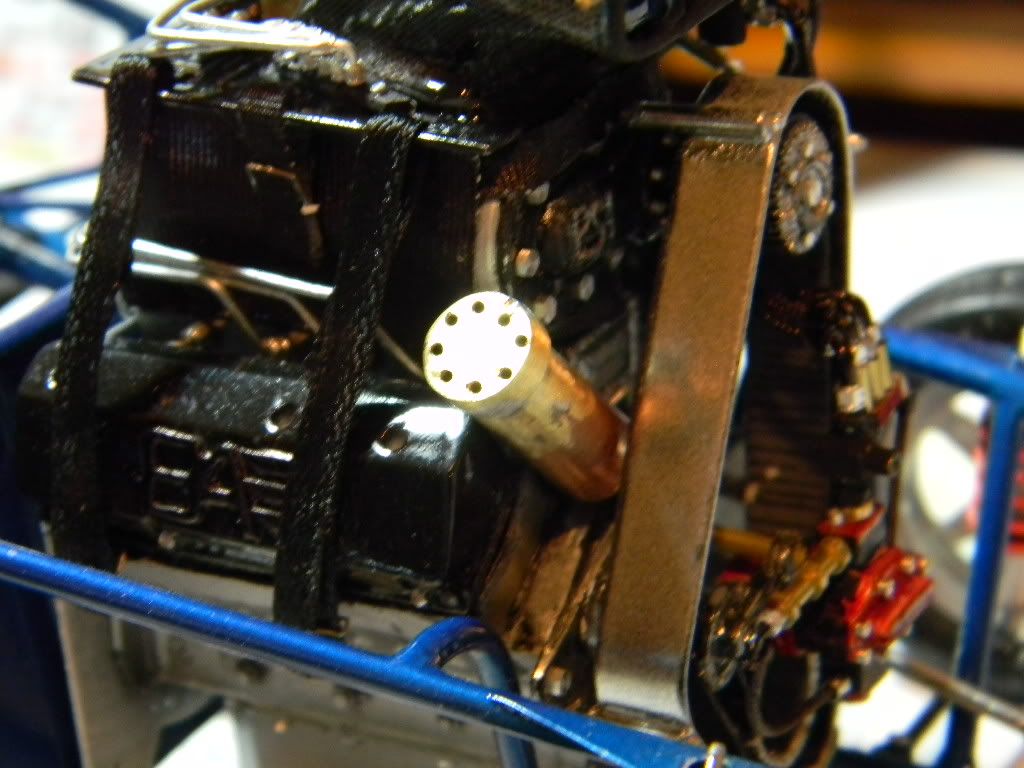

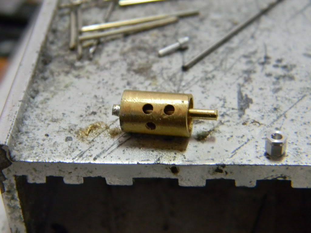

Romell R Posted August 25, 2011 Author Posted August 25, 2011 Ok fellas time for another update, getting the smaller details out of the way now, I made a MSD distributor from brass it not quit finished because I still have to wire and paint it cant wire it unit my boots get here from RB Motion. hope you enjoy.... I needed to solder a rod in the body so that i would have something to install it with once the distrib. was done then once that was done I could solder the body together..... Ok so maybe I skipped a few steps but I can only post 4 pics at a time now here it is before paint for a test fit....whatya think... see ya soon.....
