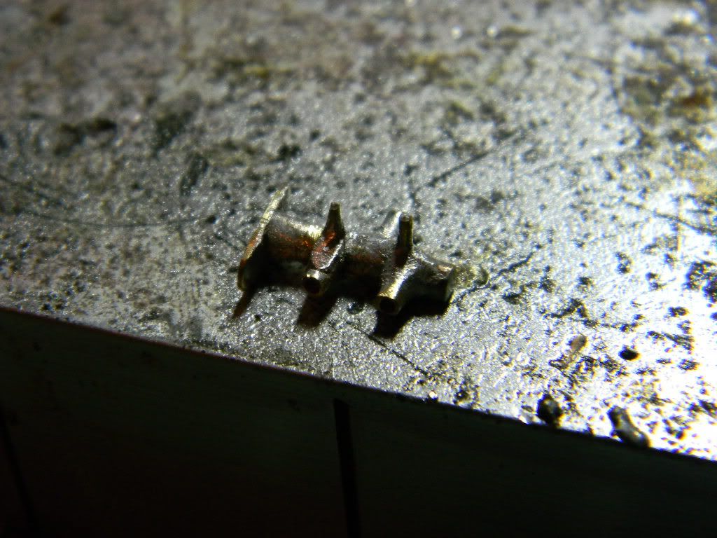

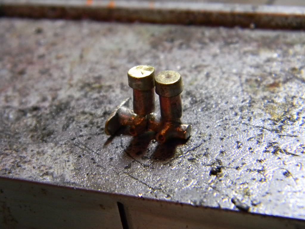

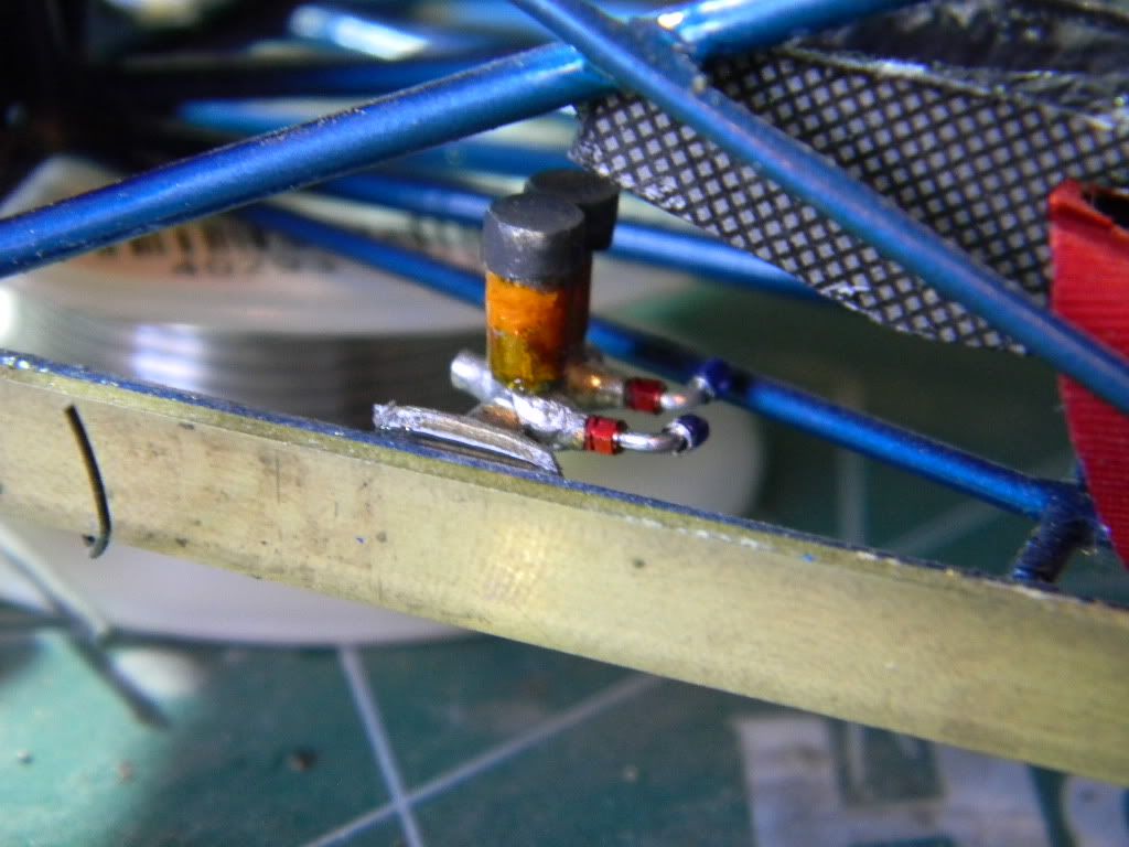

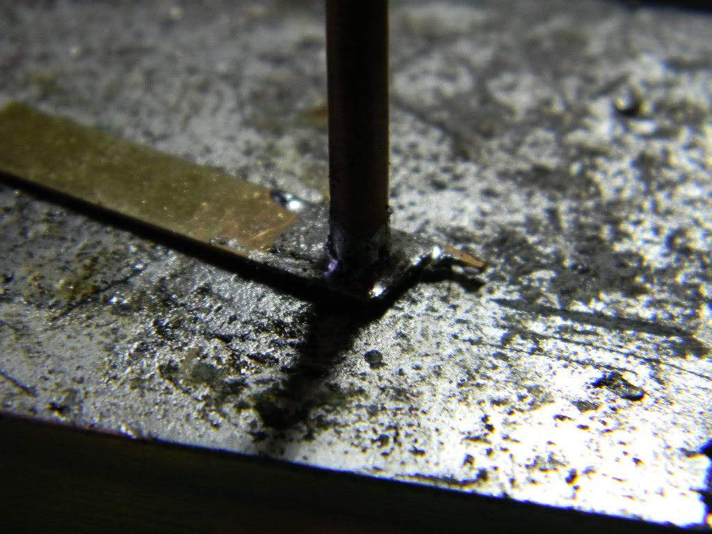

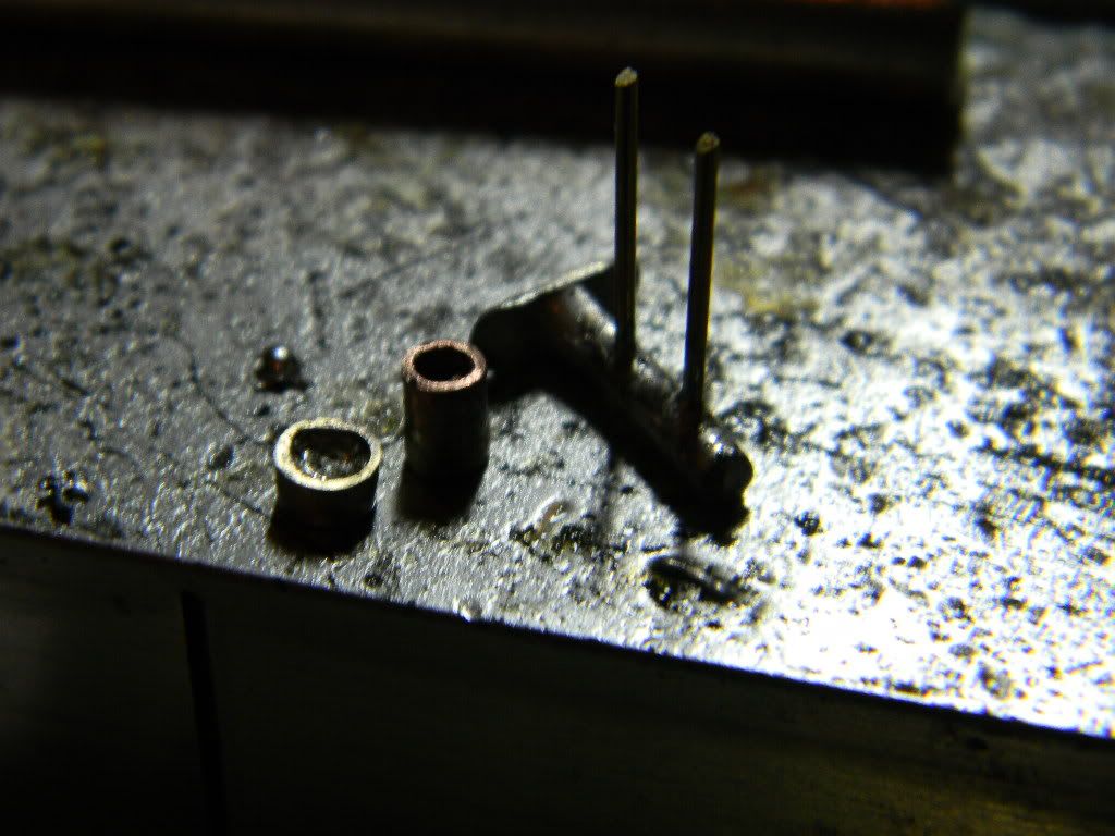

Romell R Posted February 14, 2012 Author Posted February 14, 2012 Hey Fellas made a little progress, decieded to make the brake master cylinder so heres a quik update. Didnt feel much like typing I hope the pics are enough.....

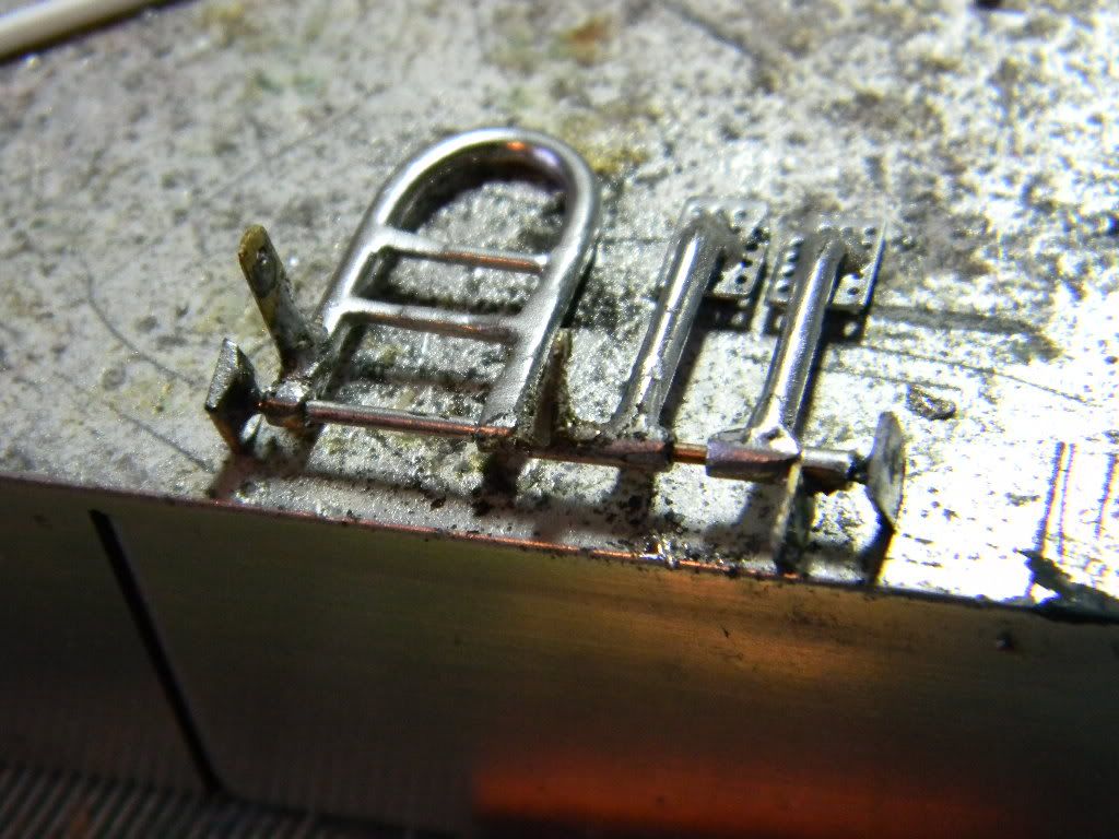

Romell R Posted February 14, 2012 Author Posted February 14, 2012 oh I forgot to add the pedels... I had to add tabs to them so I can hook up the links, once everything is cleaned up I'll install it all in the car.
FASTBACK340 Posted February 14, 2012 Posted February 14, 2012 (edited) Ummm.. are the order of the pedals reversed in the above picture? or do they floor mount? Awesome details my friend, awesome work. Thanks for the ongoing lessons! Edited February 14, 2012 by FASTBACK340

Romell R Posted February 14, 2012 Author Posted February 14, 2012 Ummm.. are the order of the pedals reversed in the above picture? or do they floor mount? Awesome details my friend, awesome work. Thanks for the ongoing lessons! Hey Johnthe pedel order is correct there just upside down so you can see the tabs I soldered on. Thx for your sincere compliments Rom you are doing some fantastic work man. You have some scratch building skills for sure. It has sure been fun watching this build come together. keep doing what you are doing. Hey Chris as alway thank you for your support and know that your builds are always a insiration.

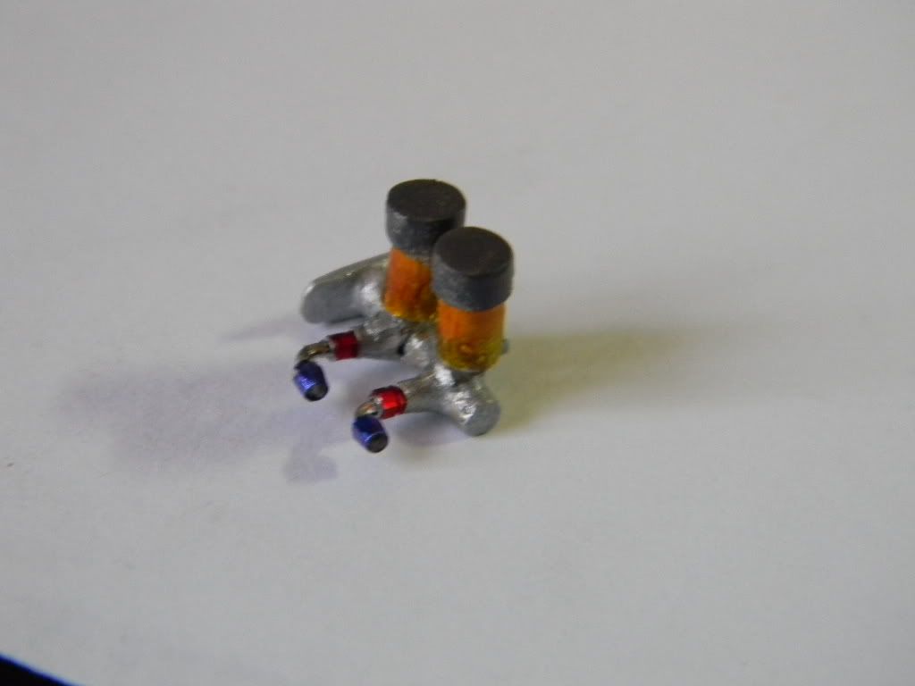

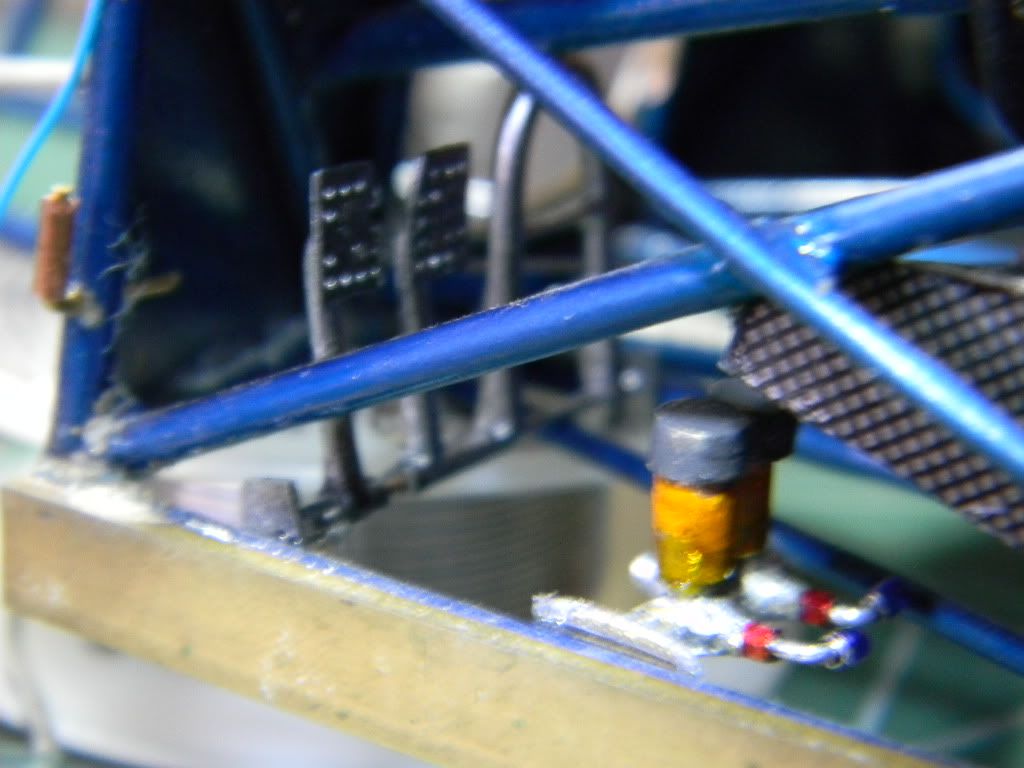

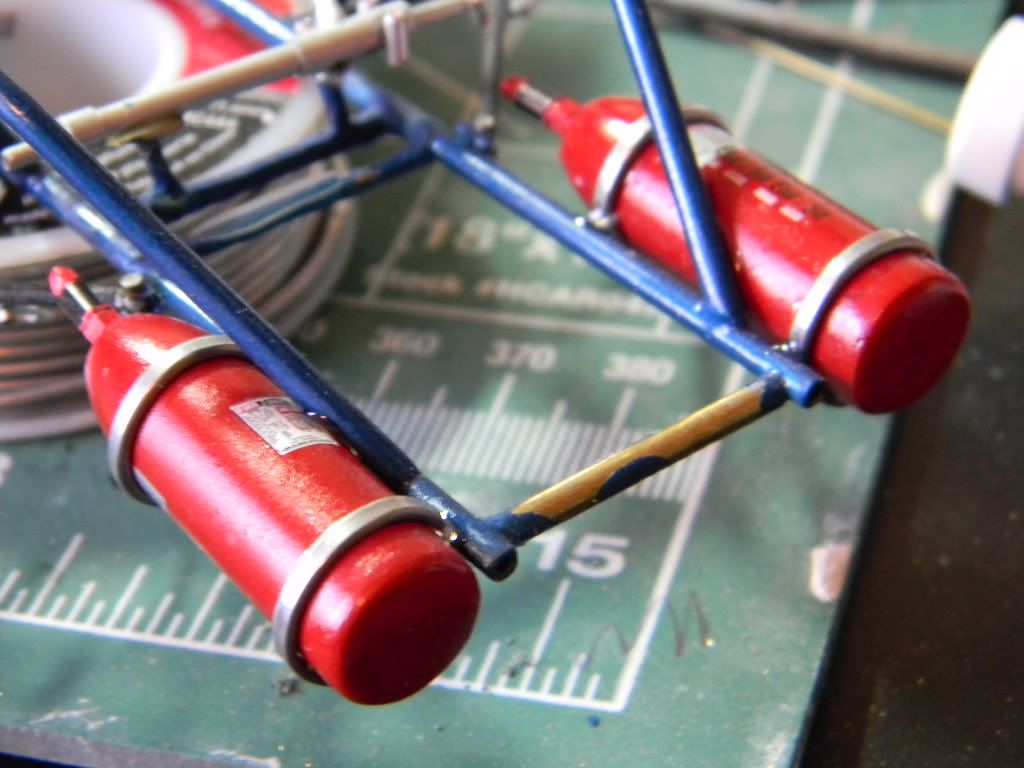

Romell R Posted February 15, 2012 Author Posted February 15, 2012 Heres a lil more on the brake cylinder. i was able to get it painted and installed in the car its also partialy plumbed as well. I was also able to get the pedels in place and i'll connect everything up tonight. I hope you enjoy! Heres the plumbed and painted brake cylinder you can see in this pic the cylinder installed under the seat. here the pedals have been installed..... oh and I started the fire surpression system... Ill be back very soon with another update.....

eviltwincustoms Posted February 15, 2012 Posted February 15, 2012 I can't tell ROM, but is your Mastercylinder mounted under your carbon seat? Based on the picture I am trying to get a bearing on how you have it mounted up. Tell me if I am wrong or not. But it looks like the master cylinder is mounted perpendicular to your brake pedal and not parallel to the direction in which the pedal moves. Am I off base in my understanding of your second to last picture? Thanks,
Romell R Posted February 15, 2012 Author Posted February 15, 2012 I can't tell ROM, but is your Mastercylinder mounted under your carbon seat? Based on the picture I am trying to get a bearing on how you have it mounted up. Tell me if I am wrong or not. But it looks like the master cylinder is mounted perpendicular to your brake pedal and not parallel to the direction in which the pedal moves. Am I off base in my understanding of your second to last picture? Thanks, Yep Bart I did mess that one up , and the sad part about that mess up is I know better. I would have never been able to hook up the rod between the pedal and the cylinder. Ill fix it tomarrow and re-post pics thanks for spoting that goof up.

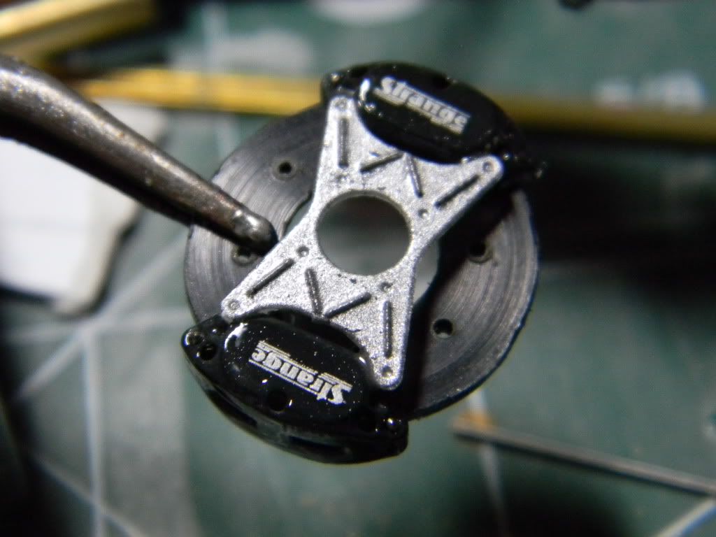

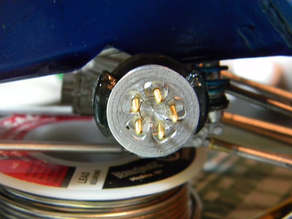

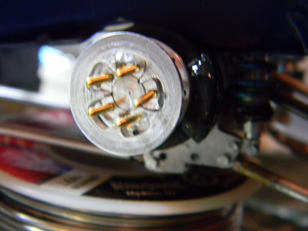

Romell R Posted February 16, 2012 Author Posted February 16, 2012 Thanks Joe i hope You can get that together, Dr. David Thank you much for your sincere compliment , but i believe you can do whatever you set out to do. Big Ed (larry) Brother its good to see you around again ,you and me go way back like two flats on a cadilac (whatever that means ) Thanks for joining me on yet another build. I have a small update I was able to put together the double brake system with carbon fiber brake disc (disc from Micro Nitro) I'll plumb it all tomarrow I hope you enjoy. heres a mock up , actually you wont even be able to see these once the wheel is on , why do I do this to myself.... Sorry it so short ill try to have a better update tomarrow im soo sleepy
