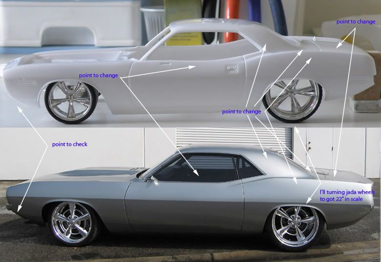

Cesar Bossolani Posted June 8, 2011 Posted June 8, 2011 Hey fellas! I need some help... I'm planing to build another '70 Cuda. Some time ago I saw some threads about mistakes on body and way to fix it. But I can't found. 2 hours searching and I didn't found. Could you help me, please? Cesar
slantasaurus Posted June 8, 2011 Posted June 8, 2011 The mistakes on Revell's 70 AAR Cuda kits are many and it depends on which kit you have. Their first attempt (green car on box art) has one set of problems including a Challenger length roof. Their second attempt (yellow car on box art) has a different set of problems including misshaped quarter panels. Both kits have the wrong wheelbase because they are both based on the old Monogram Challenger T/A kit. Your best bet is to take the grille and tailight panel and adapt them to one of the Monogram/Revell 71 Cuda kits as a builder on this forum is doing right now (see the On the Workbench section).

Cesar Bossolani Posted June 9, 2011 Author Posted June 9, 2011 Thanks for help fellas! I'll try this soon: I'm studying do mods without kill my '71 Cuda body... Maybe it's possible build a nice Cuda from '70 stock body... I'm doubt... Thanks Cesar
MrObsessive Posted June 9, 2011 Posted June 9, 2011 I second Chris's idea! You're MUCH better off finding the MPC (rereleased by ERTL recently) '74 Cuda and work from there. That can easily be transformed into a '70. They're out there on the 'net as that kit was discontinued not that long ago. Not to step on anyone's toes, but that "redone" '70 AAR 'Cuda by Revell still doesn't look right to my eyes..............reworked body notwithstanding. The problem lies in the roof shape to my view, as well as the hind quarters starting midway at the doors. Even Monogram's '71 never quite looked right to me for basically the same reason. If you REALLY want a nice 'Cuda body..........see if you can seek out Johan's '71! To me that was the most accurate of all of 'em. Testors re-boxed that one not too long ago with metal wheels and such. You'll have to scrounge up a decent chassis, but it'll save you a ton of body work on a model that should have been correct from the get go. If I'm not mistaken, Modelhaus sells the '70 front end and hood for that--------as well as the rear bumper since those are 1/25 scale.
