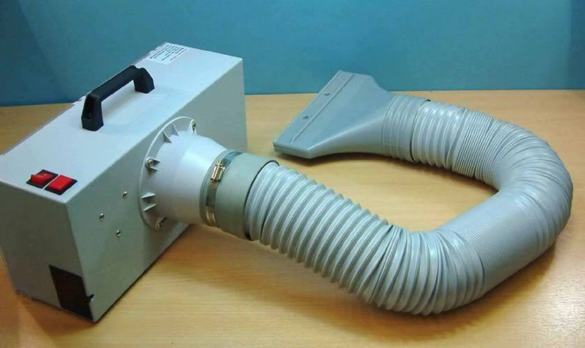

I've got one of these, had if since the beginning of the year, and use it with the ventilation extra hose that fits onto the back, I've used acrylic's, enamel and cellulose lacquer in it, I've just cleaned out the filters this weekend, and while I got out quite a bit of paint dust out of the filters, non had got through to the back part of the filter, so I don't know why they say

Yes, I do use the unit indoors, I have it upstairs in my hobby room, and simply pop the window open and put out the extraction hose, you only have to open the window about an inch, because of the shape of the end of the hose.
