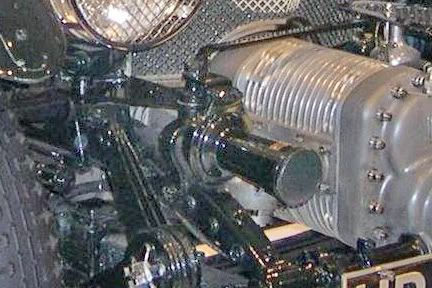

Harry P. Posted July 7, 2011 Author Posted July 7, 2011 There has also been some progress on the other end of the car.. Like I said earlier, based on all the reference photos of this car that I found, no two are exactly alike. So the particular details of mine are sort of an "average" of all the photos I have. For example, the strap between the horns is mounted in different places on different cars; I did mine this way. (the strap itself is more of that leftover PE "sprue"... very handy stuff! ). The carb stone guard was made with more of the leftover PE strips, and the mesh itself is the same fiberglass window screen that I used for the mesh on the gas tank. In the case of the stone guard the mesh is a bit large for scale, but close enough for me. (BTW, this stone guard is completely missing from the kit): Another angle. The license plate is a satin chrome plated piece; I just added the black background with a fine brush and a lot of patience! And finally, the kit is also missing the brake lever adjusment mechanism, so I added that detail with various bits of brass rod, Plastruct tube, wire, etc: More photos as they become available...
sjordan2 Posted July 7, 2011 Posted July 7, 2011 This keeps getting better and better. Nice to see such excellent progress. Great work on the fuel lines and the exhaust hanger (that little peg keeps coming unglued on mine) and all the metal braces, plus the carb stone guard. I don't know what you still plan to do with what's visible in these shots, but one easy little detail would be to add the fine black mesh over the front of the horns.
Harry P. Posted July 7, 2011 Author Posted July 7, 2011 I don't know what you still plan to do with what's visible in these shots, but one easy little detail would be to add the fine black mesh over the front of the horns. I don't know what that is over the horns. I don't see any mesh, it almost looks like a piece of cloth. I was just going to paint it sort of a grayish color like in these photos.

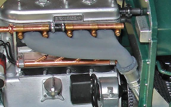

Harry P. Posted July 7, 2011 Author Posted July 7, 2011 A few more details... The flange where the exhaust header connects to the exhaust pipe is molded as a separate piece (I have no idea why!). So to make the connection a little more realistic, I took a razor saw and cut a groove around the flange to simulate the two parts of the flange–the top half that would be part of the exhaust header, and the bottom half that would be part of the exhaust pipe. Then I painted the two "halves" to match the part they are supposed to be a part of: At first I wasn't going to wrap the steering wheel, but I changed my mind. I used the same thread that I wrapped the springs with, then painted it with a brownish wash, then rubbed pencil graphite into the wrapping to "dirty" it up a little. It's impossible to wrap the wheel neatly, because the finger grips on the back of the wheel force the wrap to jump into the grooves, so the wrap has gaps and unevenness in the front. But since the photos of the real cars show the wrap also being pretty sloppy, I guess it's "realistic!"

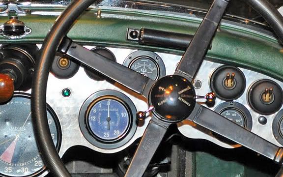

Harry P. Posted July 7, 2011 Author Posted July 7, 2011 Nice wash on the floor. Why are there markings on the left side of the steering wheel hub? I've only seen them on the right. By the way, your detailing of the seat backs is brilliant. I sprayed the floor with Testors Transparent black window tint. Here's a shot of the wheel that I was using:

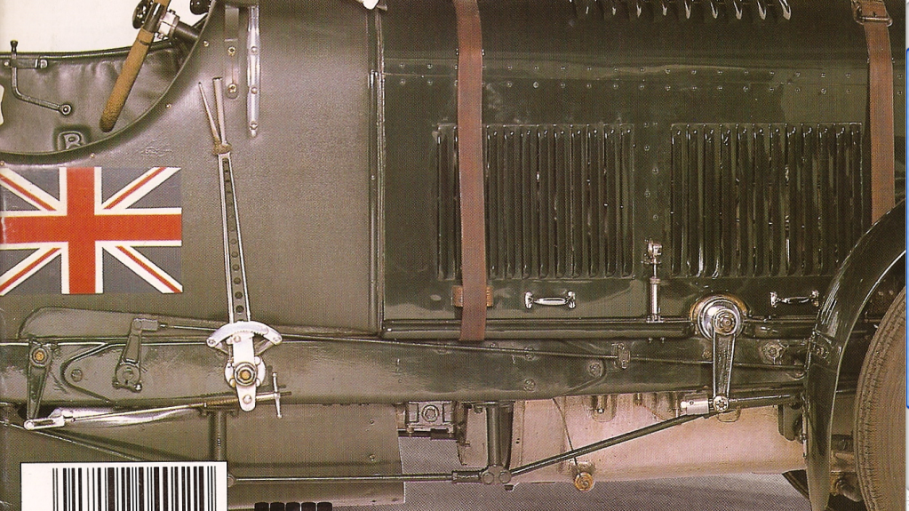

sjordan2 Posted July 7, 2011 Posted July 7, 2011 Please don't hate me for asking...but there's a seam running F-R on the cowl. Is that something you'll smooth later, or did the 1:1 have it? Or is it just something in the design of the kit that you're OK with leaving there? That is probably my fault. I have a huge reference file on this car, and I told Harry not to worry about the seams because they were on the 1:1. That is true for the rear of the car, but I think the front cowling should not have a seam.
Harry P. Posted July 7, 2011 Author Posted July 7, 2011 That seam is on the real car. And I have photographic proof! BTW... I've cleaned up a lot of little things on the model that I really didn't even notice until I looked at the photos. The camera shows every tiny flaw and makes it look even worse... it sees more than my eyes do! I've gone back and fixed the foil on the hose clamps, touched up the paint in certain areas, etc.
sjordan2 Posted July 7, 2011 Posted July 7, 2011 That seam is on the real car. And I have photographic proof! BTW... I've cleaned up a lot of little things on the model that I really didn't even notice until I looked at the photos. The camera shows every tiny flaw and makes it look even worse... it sees more than my eyes do! I've gone back and fixed the foil on the hose clamps, touched up the paint in certain areas, etc. I went back and looked at my reference and realized I wasn't bonkers. There is, indeed a fine seam running from the middle of the cockpit down the cowling in the middle. Whew, I'm not crazy (at least in this case).
