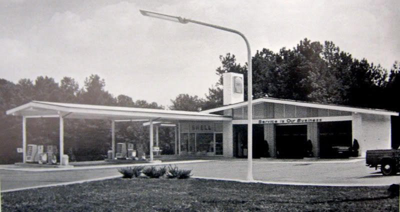

disabled modeler Posted July 28, 2011 Posted July 28, 2011 I like this build a lot....I use to work at a Shell gas station years ago but I use to go to a Clark station as a kid for soft drinks,etc. Cant wait to see the progress on it.

Repstock Posted July 28, 2011 Author Posted July 28, 2011 (edited) I like this build a lot....I use to work at a Shell gas station years ago but I use to go to a Clark station as a kid for soft drinks,etc. Cant wait to see the progress on it. Is this the style of Shell station? Edited July 29, 2011 by Repstock

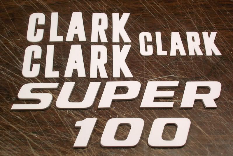

Repstock Posted July 31, 2011 Author Posted July 31, 2011 It is useless to try and find the exact font in the exact size I need, so I had to carve out my own. I have since noticed the "100" is slightly larger than the "super", so I'll have to redo the "100".

Eshaver Posted July 31, 2011 Posted July 31, 2011 Tom, the smaller "Clark on the right is the closest to the Font you need . Yes , the 100 is larger than the word Super . Oh , what Mike sent you IS VERY TYPICAL of what a Clark station need to look like . Look , If you want , I can send a P- M with my personal E-mail and re send the Fotki pictures off that to you . Send me a P-M with a E-mail to you . Ed Shaver

disabled modeler Posted August 1, 2011 Posted August 1, 2011 To me it is cool ether way....it is still a gas station and a great way to display built models. We had a Clark gas station just a block from us when I was growing up and looked a lot like the photo Ed posted.
