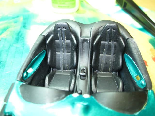

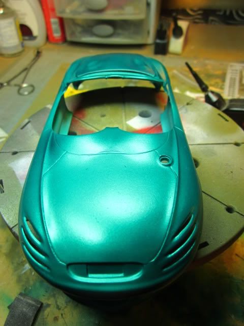

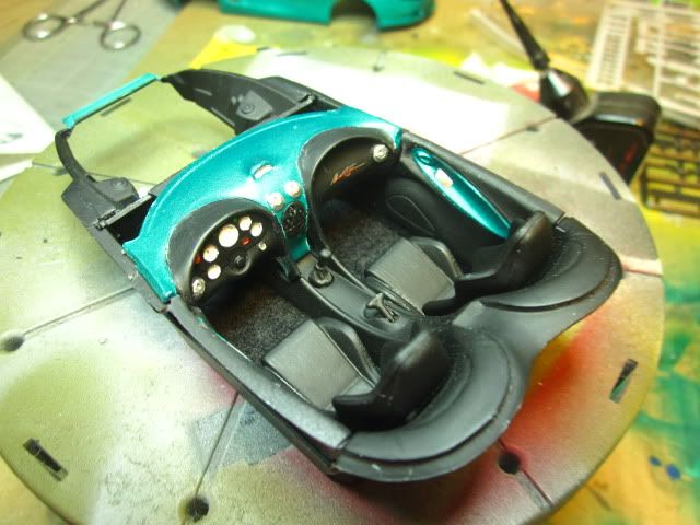

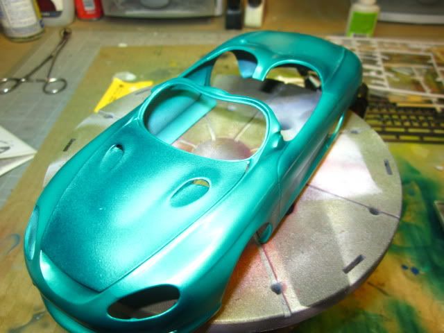

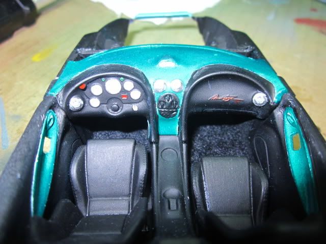

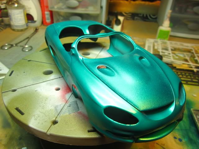

Dirkpitt289 Posted February 10, 2012 Posted February 10, 2012 I've been working on the Mustang Mach III for a little while and thought since it is a direct decedent to this group of Mustangs I'd post some of the build here. So here is my fat bottom girl the Mustang Mach III There she sits with two cotes of color Interior shots You can find the full story and build here http://www.modelcarsmag.com/forums/index.php?showtopic=53174 Thanks for looking

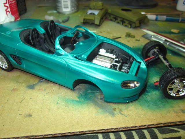

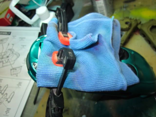

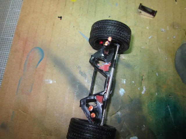

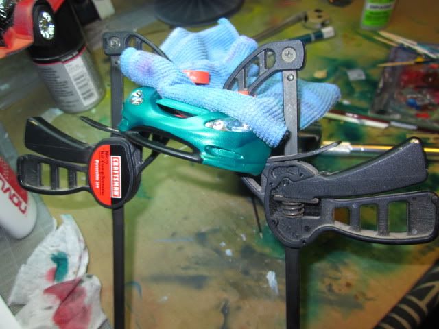

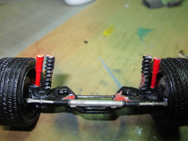

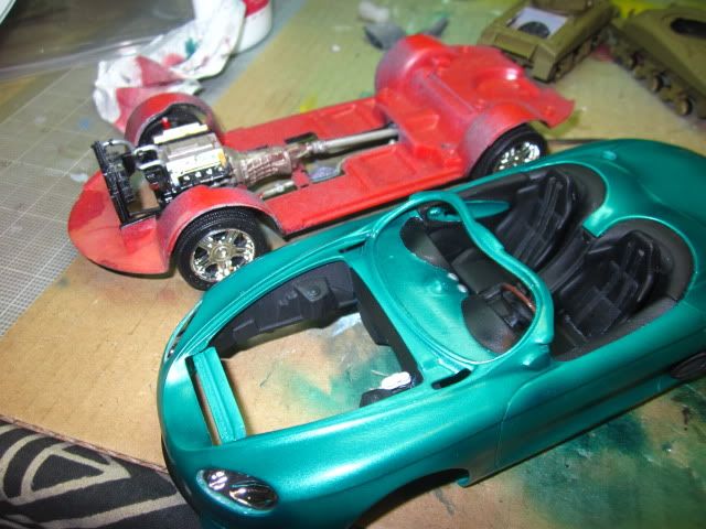

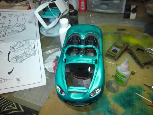

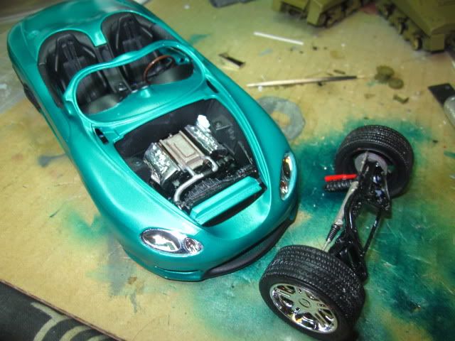

Dirkpitt289 Posted February 10, 2012 Posted February 10, 2012 Fitting the interior tub into the body I don't have any photos to show this next issue but after fitting the tub in place which fit nicely in the cockpit area I found that the engine compartment walls didn't match up with the body. There was almost a 3/16 inch gap. Using some clamps, a soft rag to protect the finish and some CA glue I forced the kit to see things my way I rarely win any arguments with my models but I won this one. Time to mount the body and interior on the chassis. Well things are back to normal. I lost the battle with this one but not the war. The cost was that the front suspension fell off the car. As I tried to remount the front suspension another issue arose that I wasn't suspecting. For some unknown reason the front of the car was riding high. Sorry no pics After lots and lots of fiddling it appeared that the springs and shocks were topping out in the wheel wells so I chopped them down a bit and remounted the front suspension. It helped a little but not as much as I hoped The only other thing I could come up with to lower the front was to start shaving the frame where the cross member meets the frame. I also ended up grinding down the frame. the amount of plastic removed does not accurately reflect the height the car was lowered but it is a bit better. Thanks for looking
